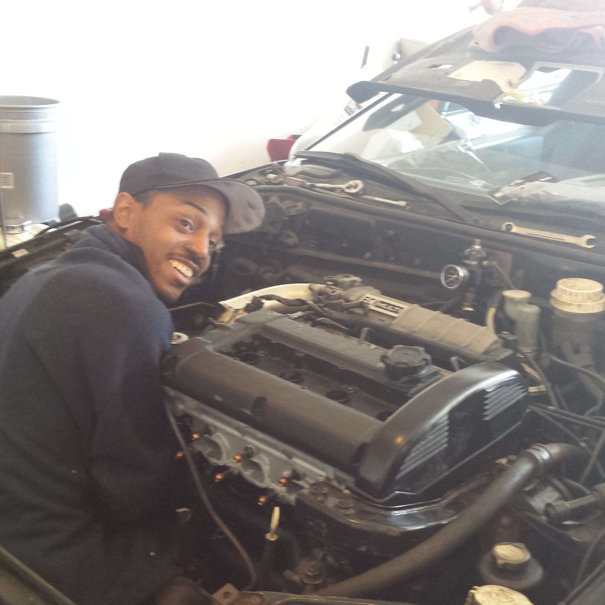

Went to tre again today got ly flywheel inspected, running a South bend clutch I had a chance to see the factory a hour from my house. She's getting there

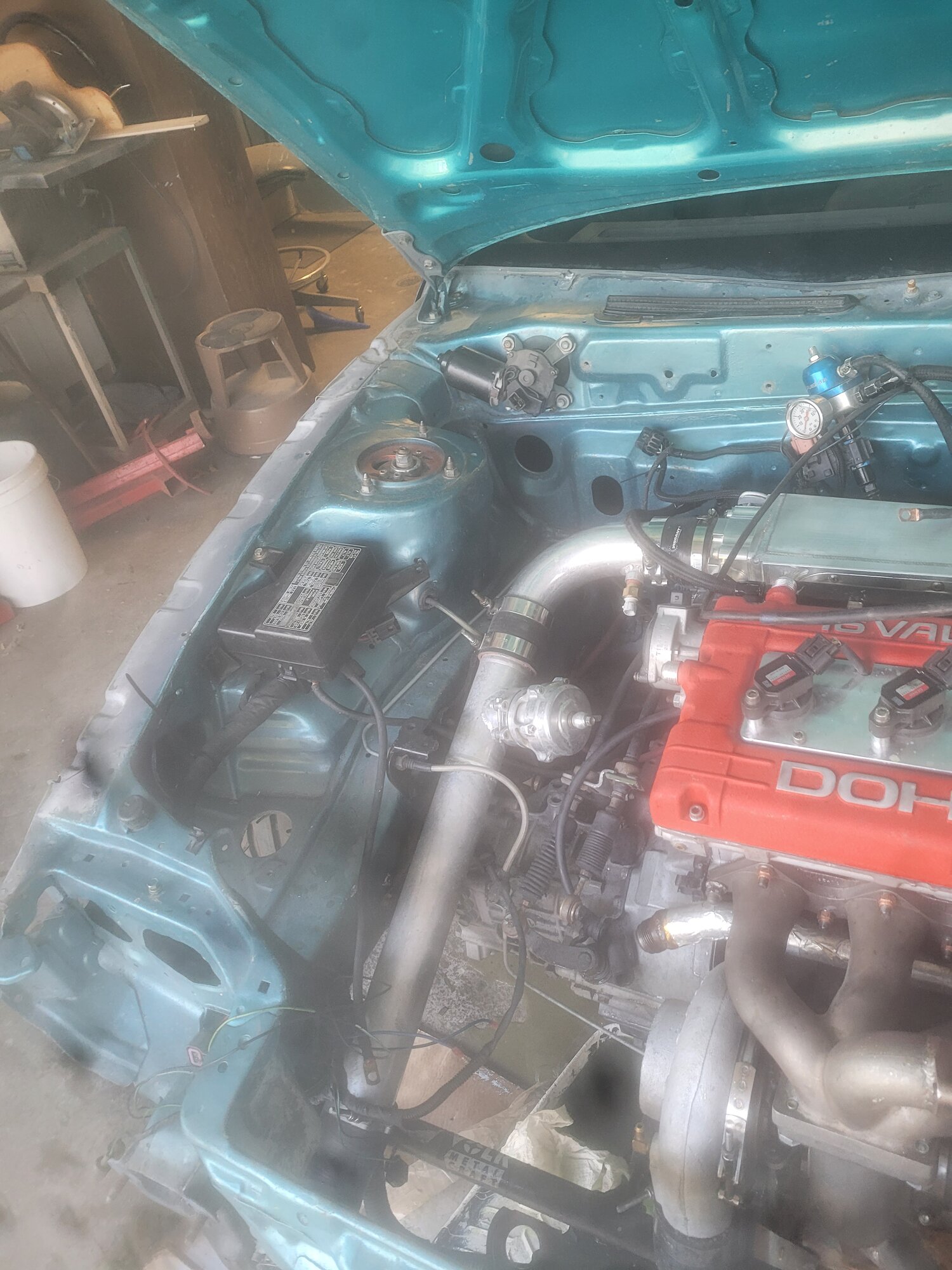

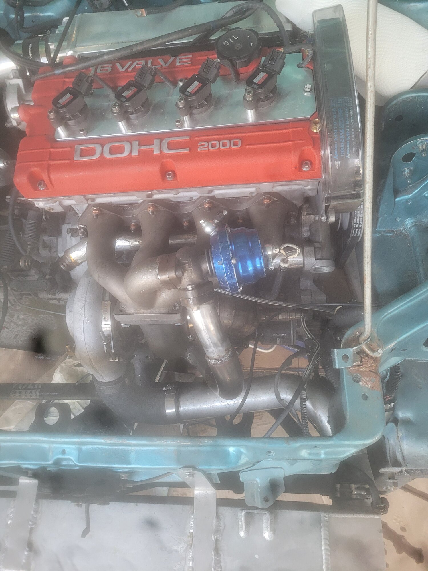

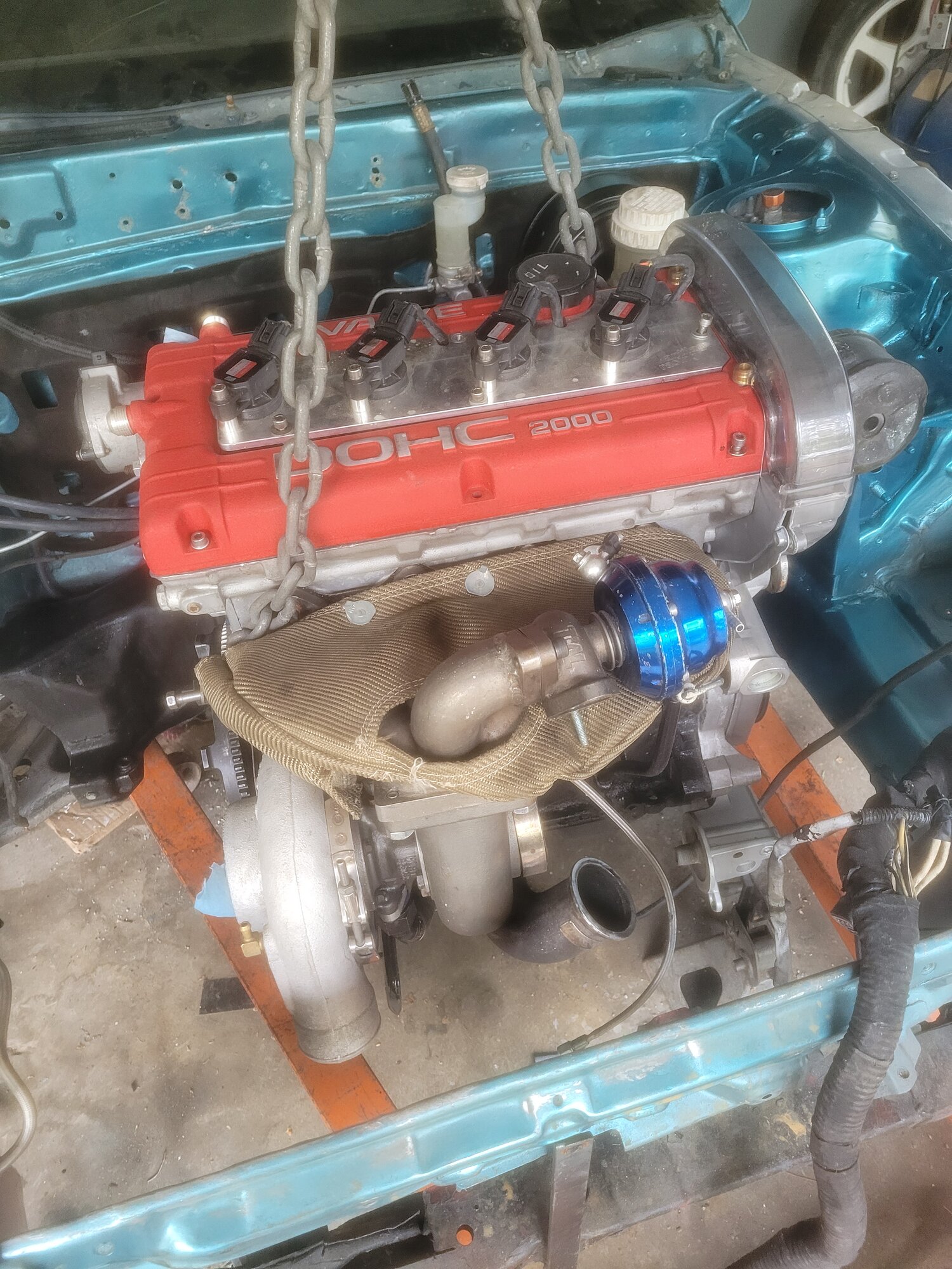

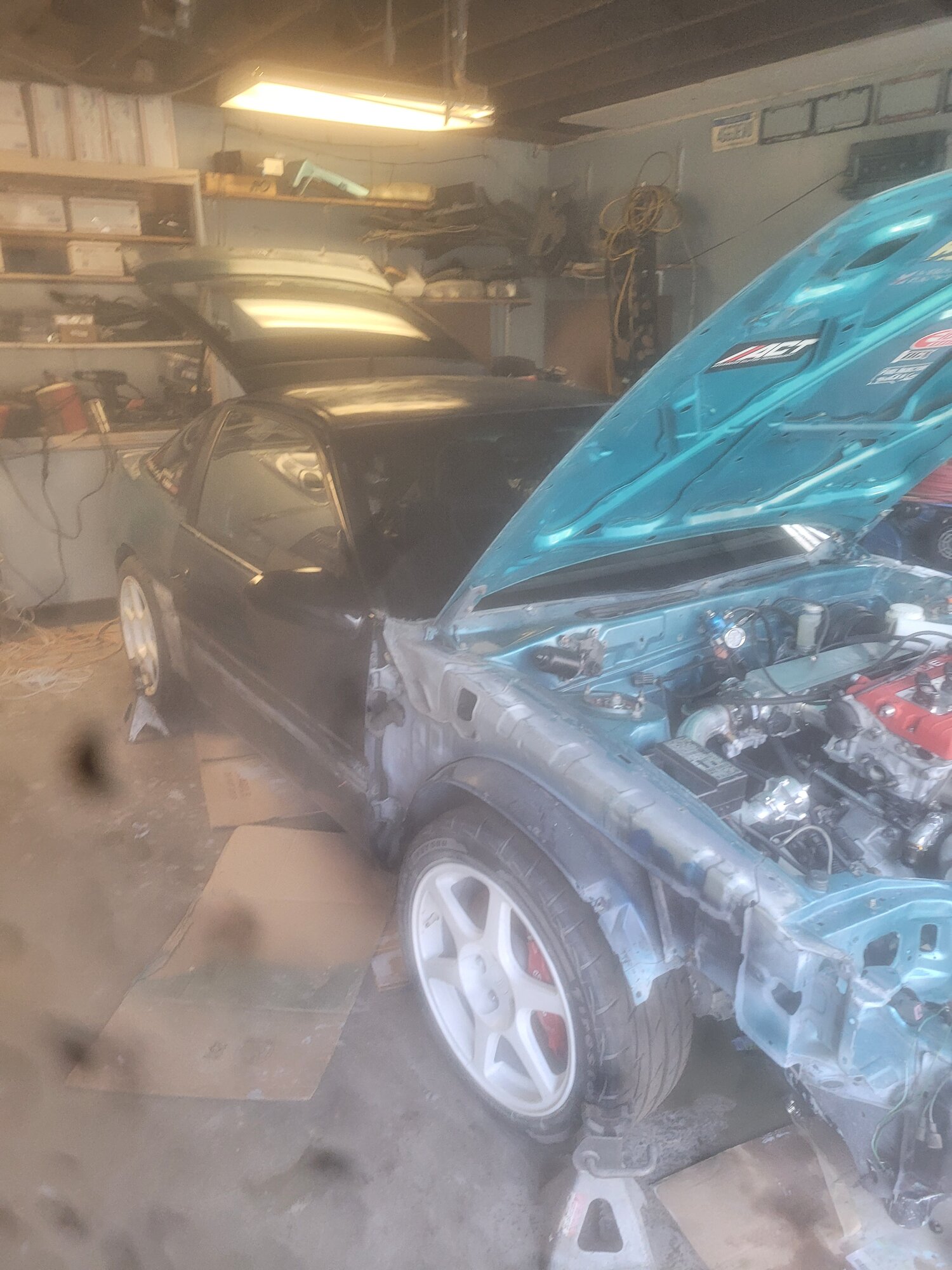

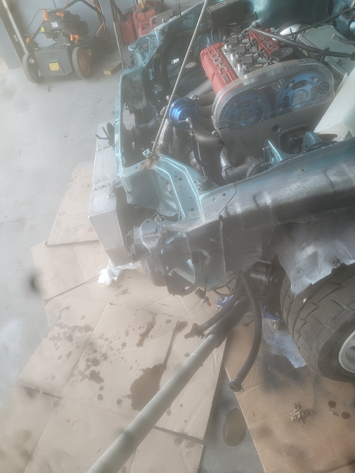

I've been busy waiting on powder coat stuff so I can install the engine. Wiring still to do and some odds and ends n thanks to Wayne in here for his first help and rafal and goonie for support. Tranny goes in any day now can't wait she's all cleaned up and upgrade..

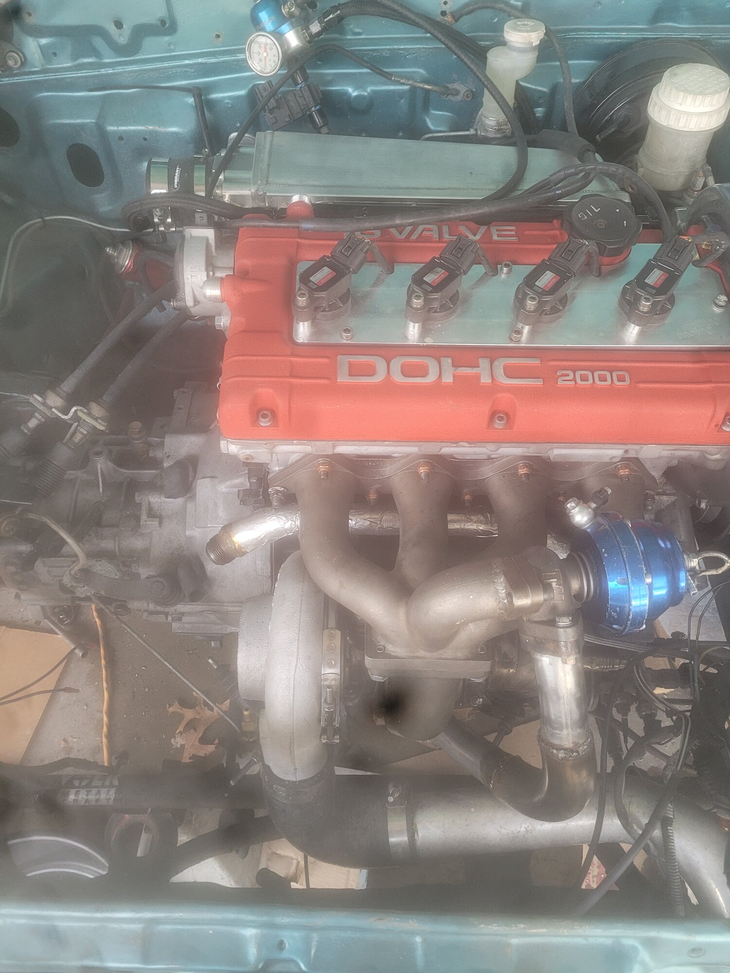

The matte red valve cover looks good. A little Ferrari-esque. 😉

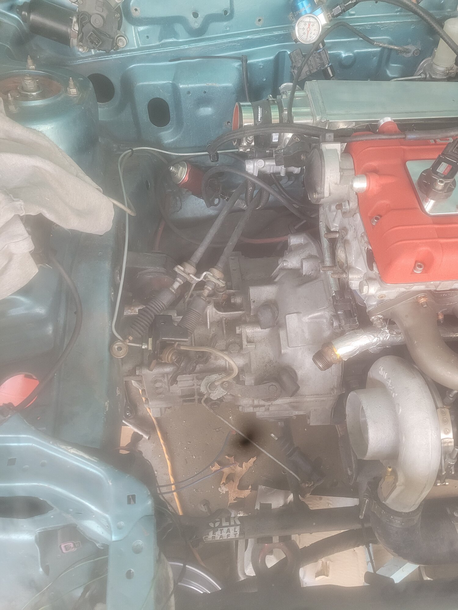

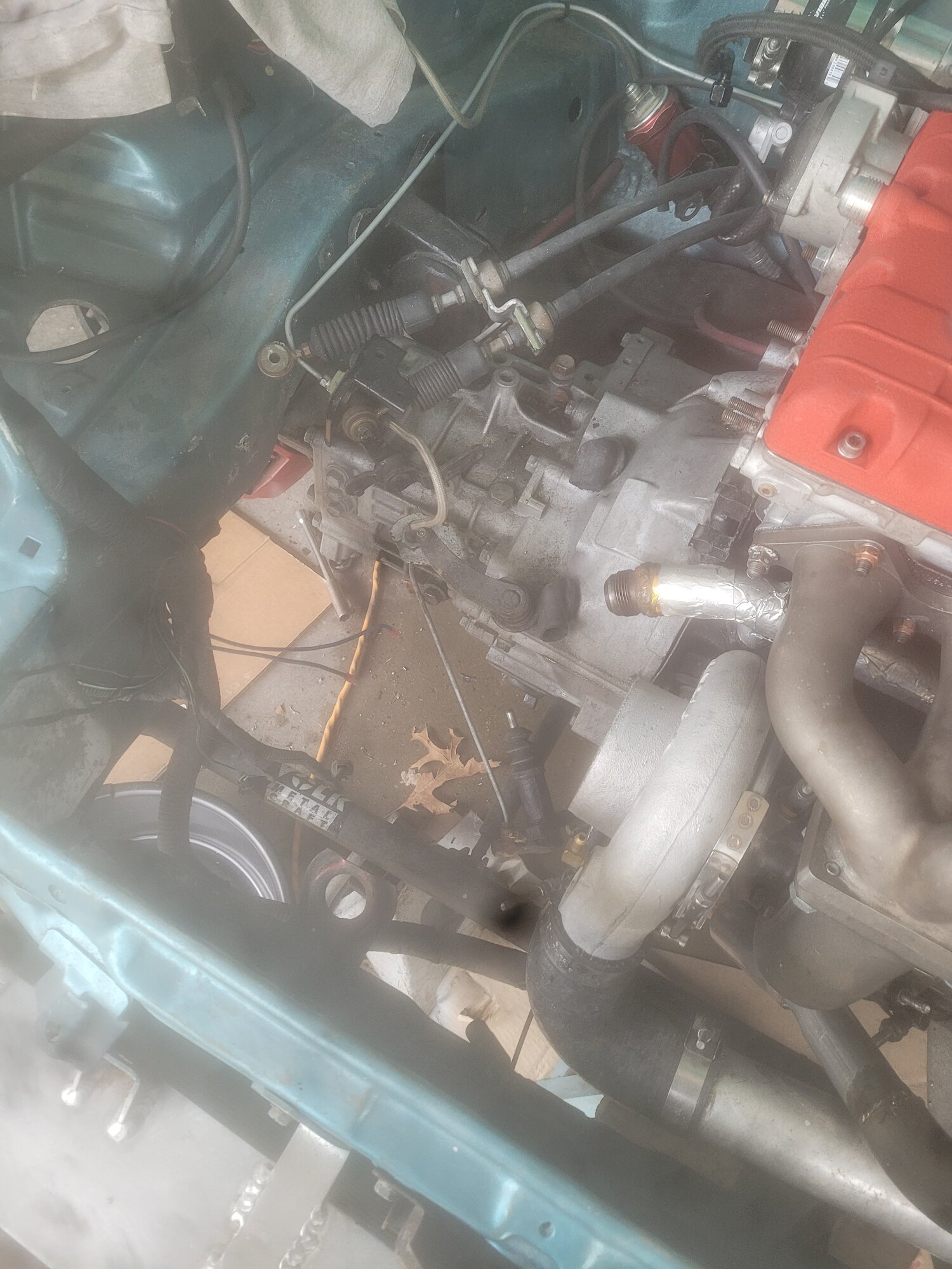

Well shes back from tre got a little work done didnt need much but she looks amazing in person, ohio bound, im really exicited it turned out good. This will be a reliable for my goals for the street. Everything it needs to do its job, and keep it together the builder arron its a pretty much a new transmission inside and out. Couldnt do much more no need for it 4 spider installed and cleaned up stuff inside shot peened gears again. 90 gear set installed years ago about 12 years ago to be specific, ive been a tre a lot for months, just to hang out really but i couldn be happier with my service for over 20 years when he rebuilt my fwd turbo. More pics coming of before and after and internals.

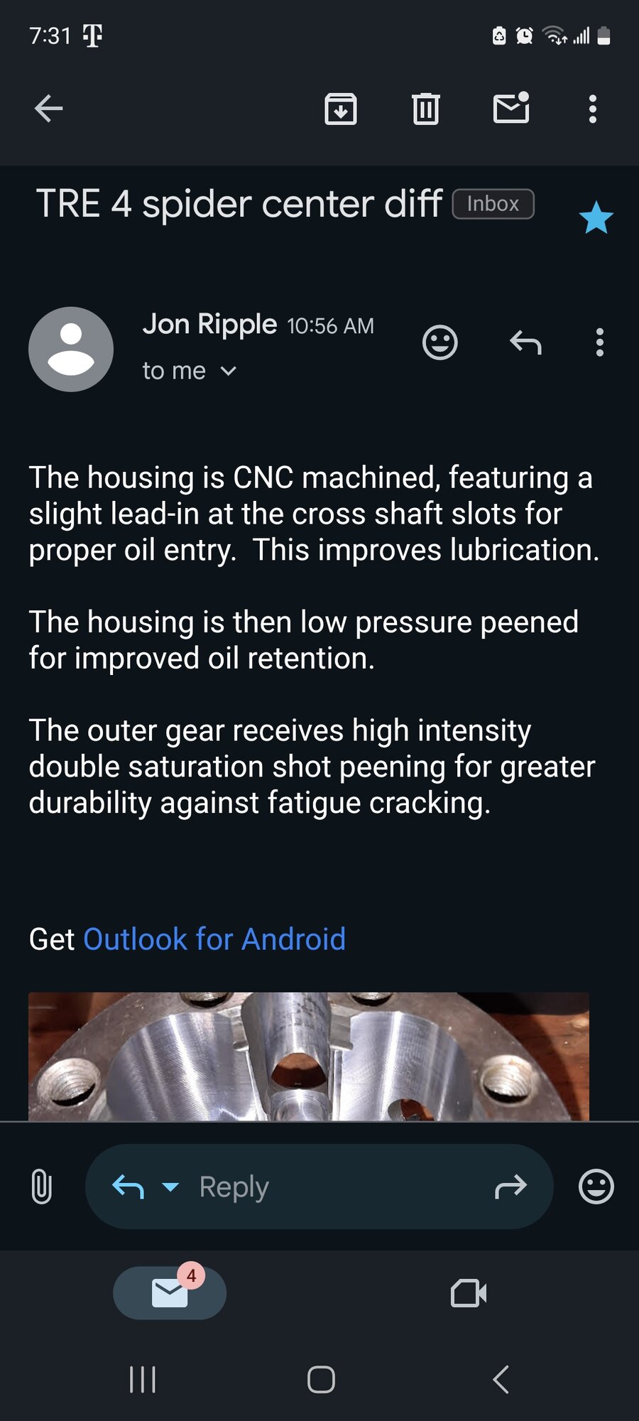

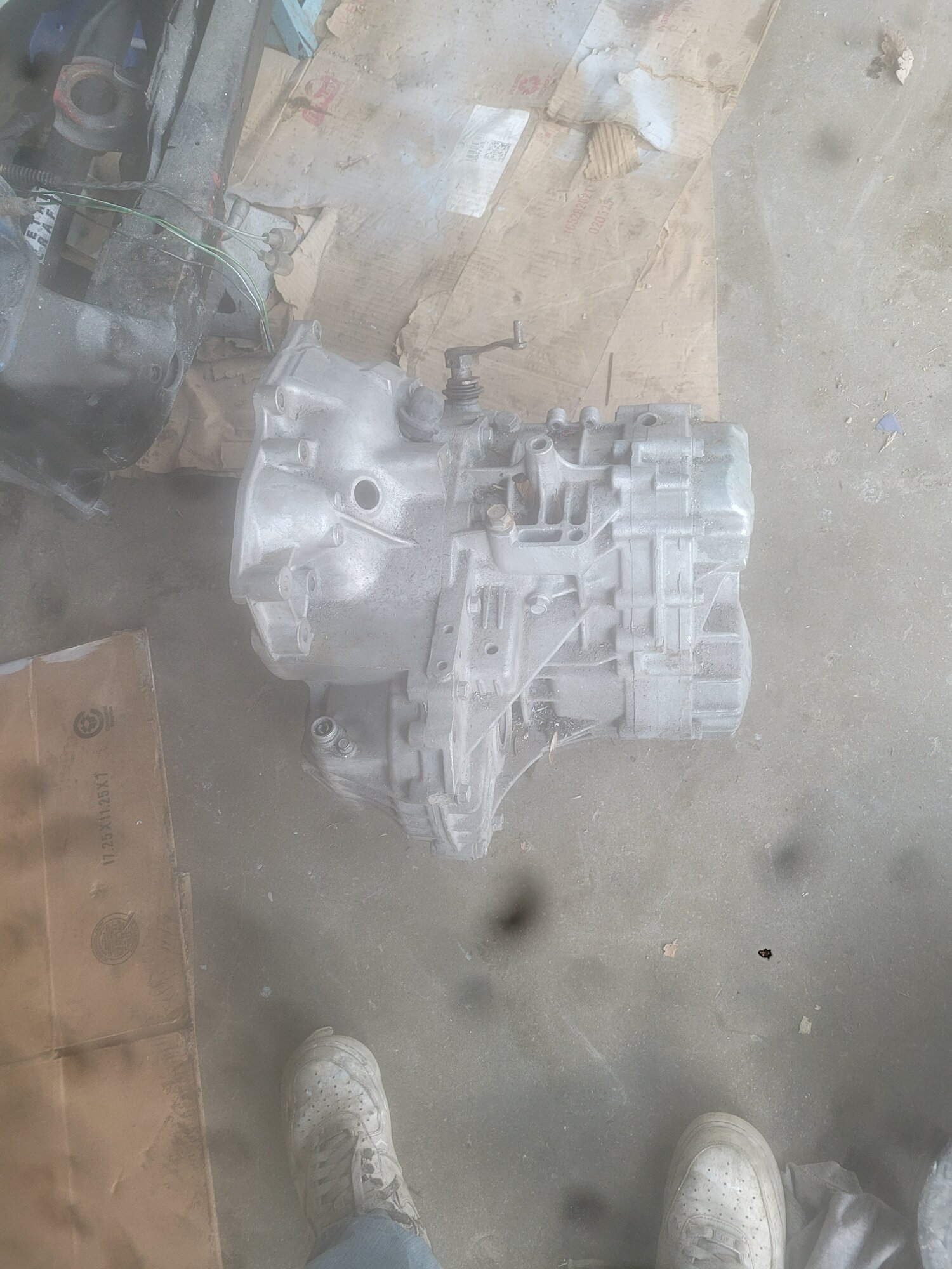

Went to tre today for some bolts and received some pics and information. Good little chat about my setup.

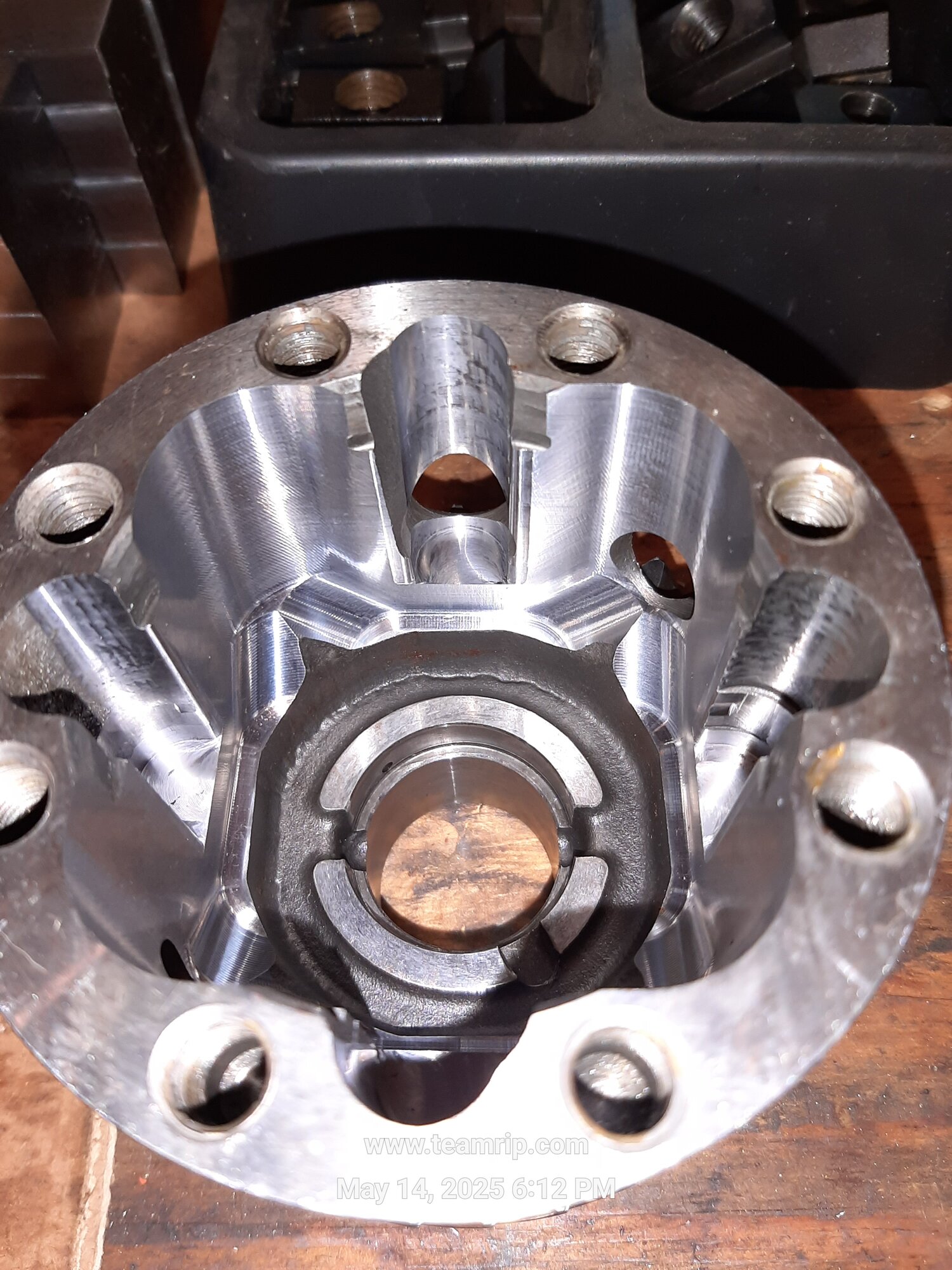

Can anyone send them their Center diff and have this done? What’d you use for extra spider gears and a cross shaft?
He modded mine and he makes his own gears would email him I don't know I just wanted a beefier transmission and I got it. Matching with south bend clutch from Tim and this is going to be a reliable fun set up for years its no drag car or track but he's set me
up for ly goals .
