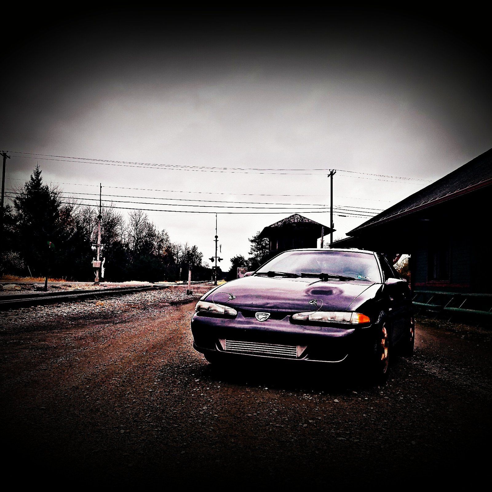

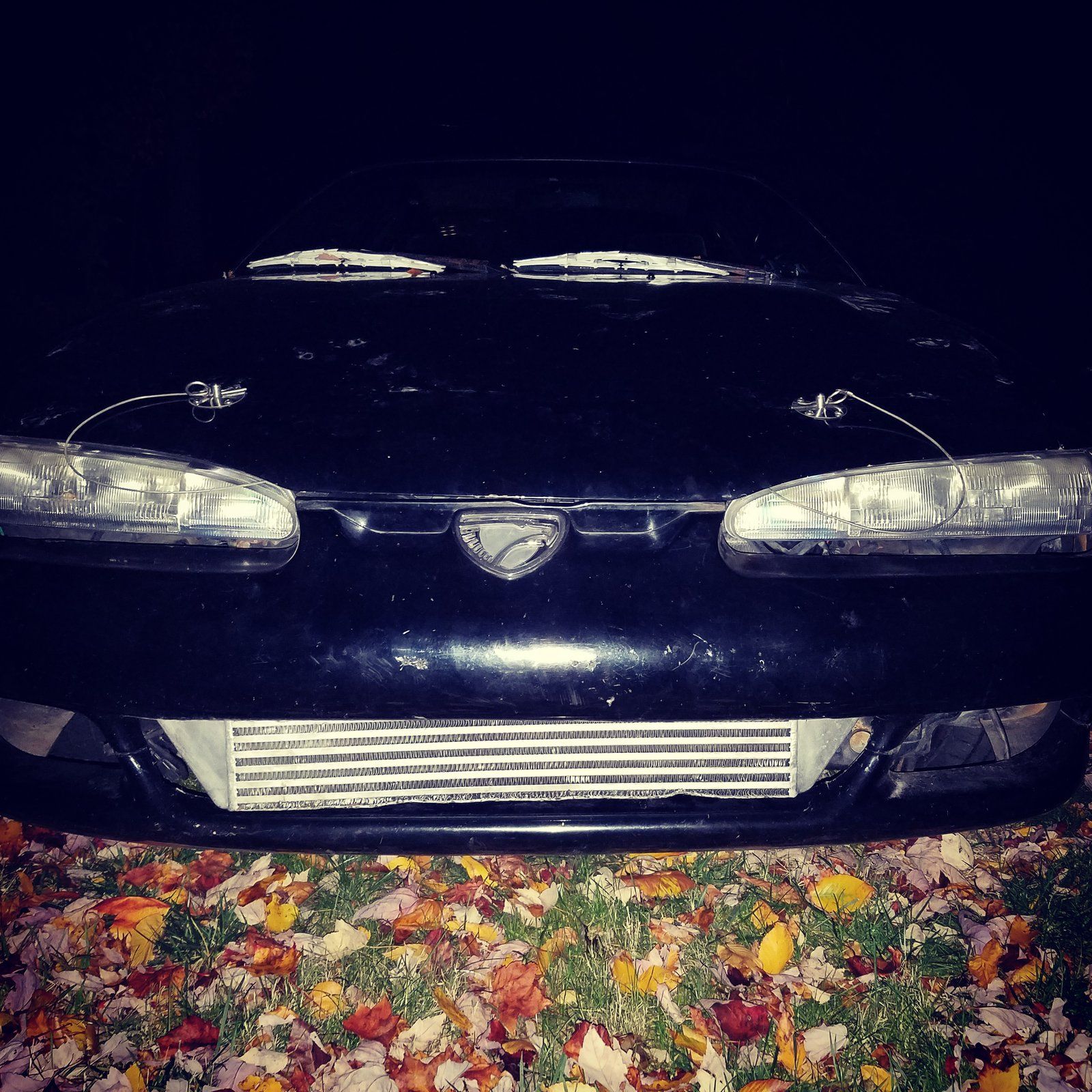

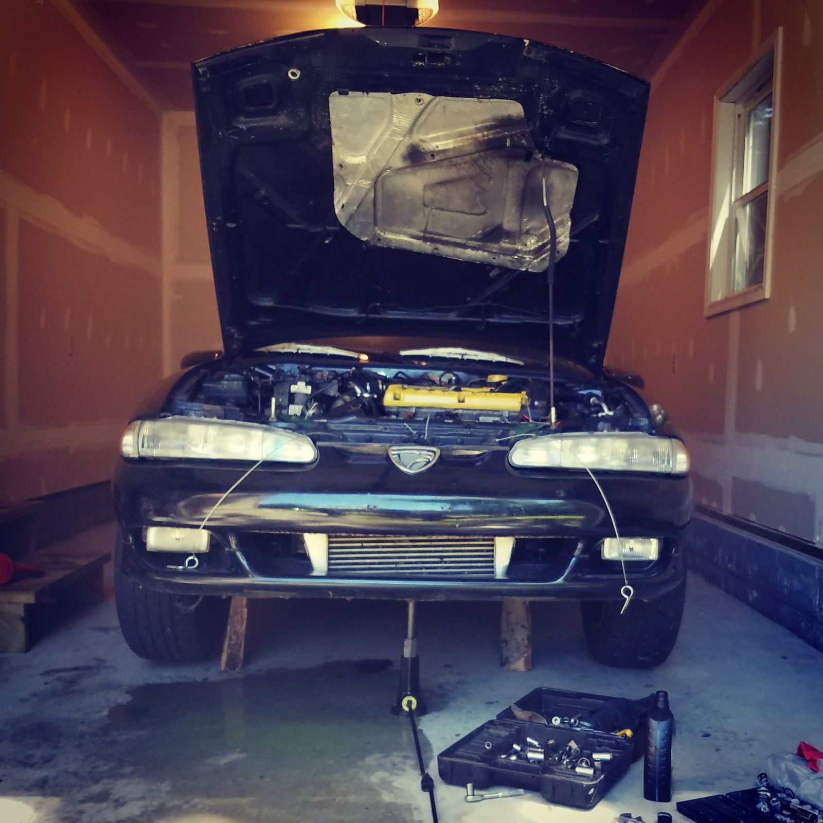

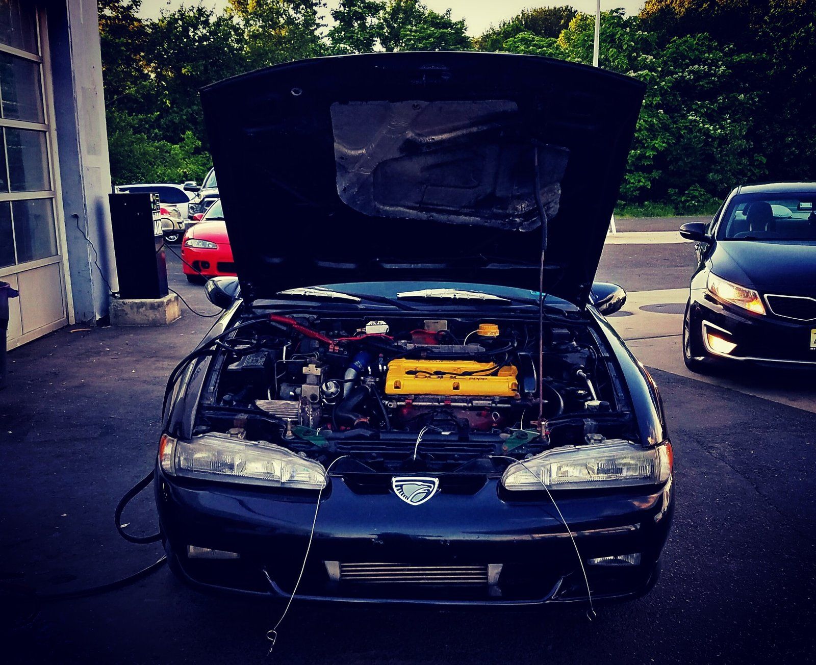

So for awhile I've been working on a 92 tsi awd that bought for 1500.
I'm still working on fixing some of the things the previous owner had done and I will say it has come a long way.
It's currently on fic 550cc injectors. Wally 255 fuel pump rewired. Small 16g turbo, link v2, and Vrsf fmic.
Plans are to build the head, go with 1250cc injectors, and Borg Warner s300 turbo. I also plan on updating to v3 and going speed density but first like I said still replacing thing that previous owner mucked up.

Great plan, S300SX with the 80mm wheel and 1.00-1.05AR would do it on pump gas. A really efficient 4" intercooler is a must in my opinion so if you have an ebay core ditch that for an ETS with sufficient flow for your future built engine. A large unrestrictive intake pipe and exhaust system with a well flowing top mount divided T4 manifold with 38-44mm wastegates as well.
