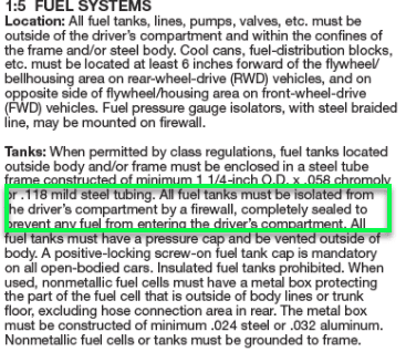

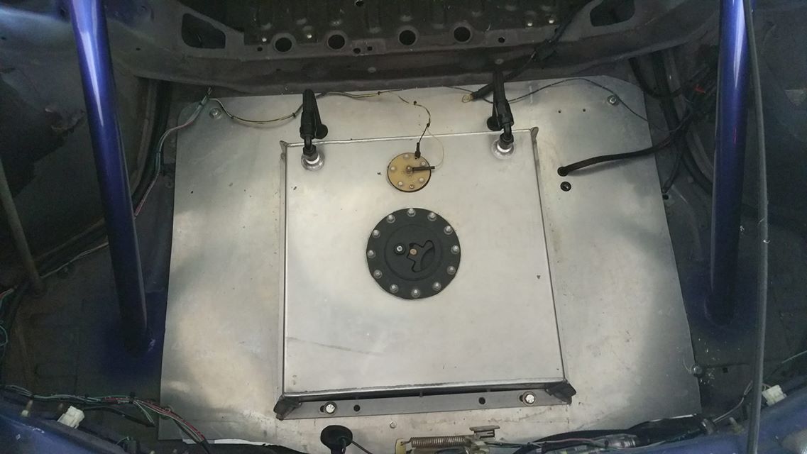

Just out of curiosity, the way that fuel cell is setup is not NHRA approved correct? I have a 15gal speedway cell mounted in the trunk, working on a fire shield. Never thought of that design where its a big cutout to the tank, that would be wayyyyyy easier than what Im working on.

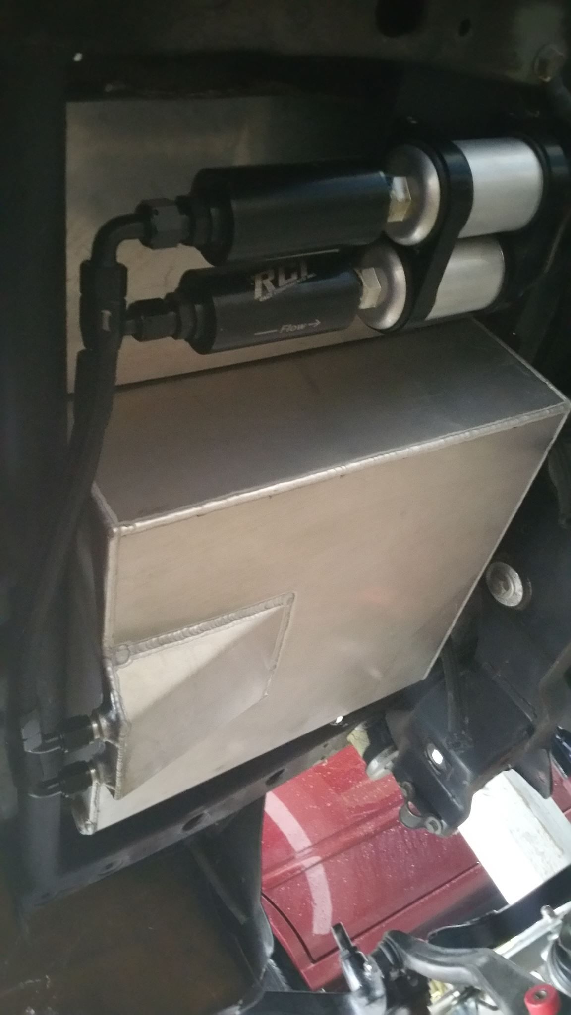

It is does not meet the rules but it passed tech. In the blue car where the cell is actually located the plan is still to build a firewall for the increased safety and to actually comply with the rules.
