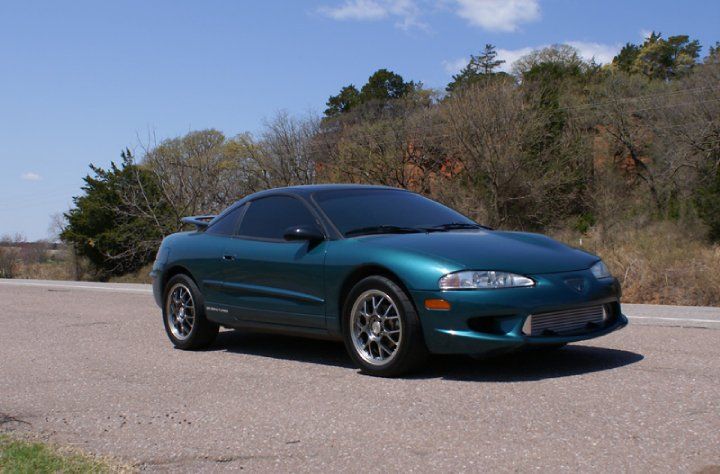

Chassis:
-1998 Eagle Talon TSi AWD
-Full interior, plastics, headliner, dash, carpeting
-POWER EVERYTHING WORKS, door locks, windows, drivers seat, heat & A/C, wipers, headlights, etc.
Suspension & Brakes & Wheels:
-KYB Shock/struts
-Eibach springs
-AEM Big brakes w/ 12.5" rotors
-EBC pads
-ADR M-Sports, 17x7.5
Body:
-76K mile car, from Oklahoma originally, It's been mine for the past 7 years(2nd owner), and I bought it when it was 100% stock.
-Clean and clear Oklahoma title
-Tagged, titled, and insured
Driveline:
-TRE Stage 2 trans.
-LSD rear diff, welded center diff, LSD front diff.

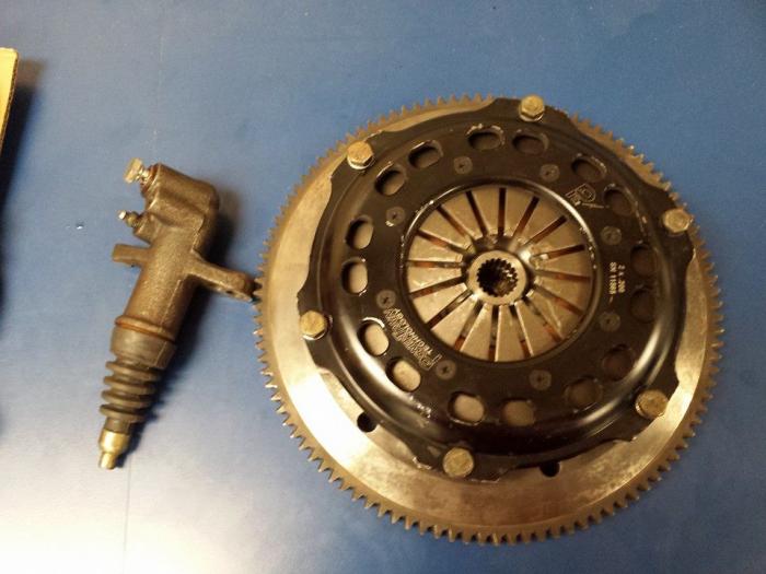

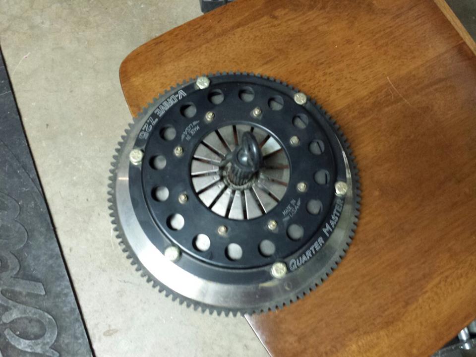

-PTT twin disc sintered iron clutch assembly, lightweight flywheel.
-Modified issuzu clutch slave setup
-DSS 3" drive shaft
-B&M Shifter, solid bushings

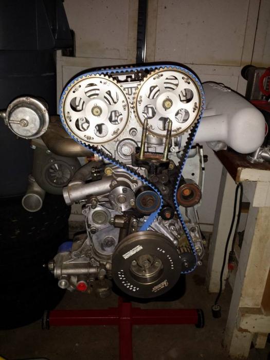

Engine:

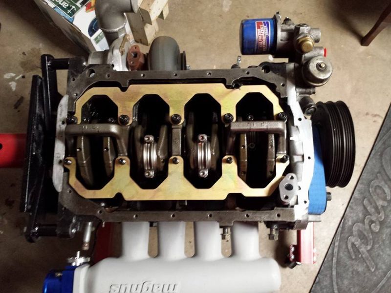

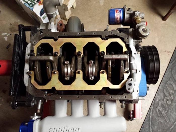

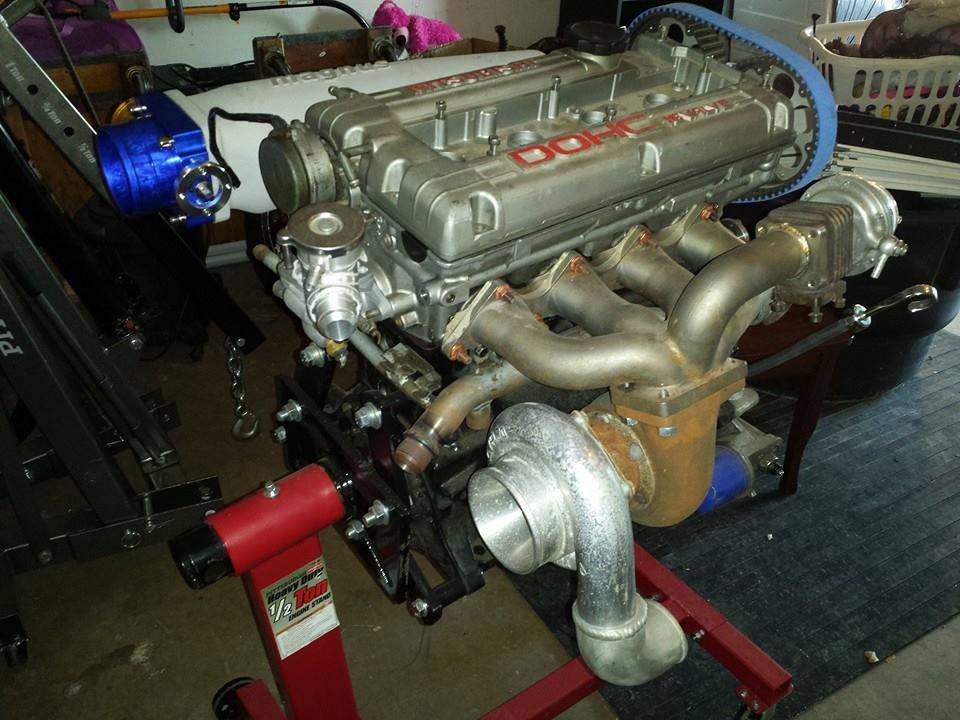

-2.3L Race Shortblock with Eagle rods, JE 9:1 pistons, 22mm pin

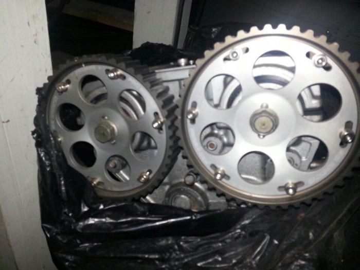

-Stage 3 Performance cylinder head,
-BC280 cams & valvetrain.
-ARP headstuds
-All the proper oiling mods for extended high RPM/boost abuse

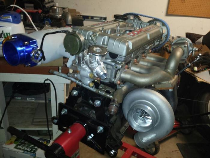

-Magnus Cast intake manifold
-90mm billet throttle body
-3" aluminum charge pipes

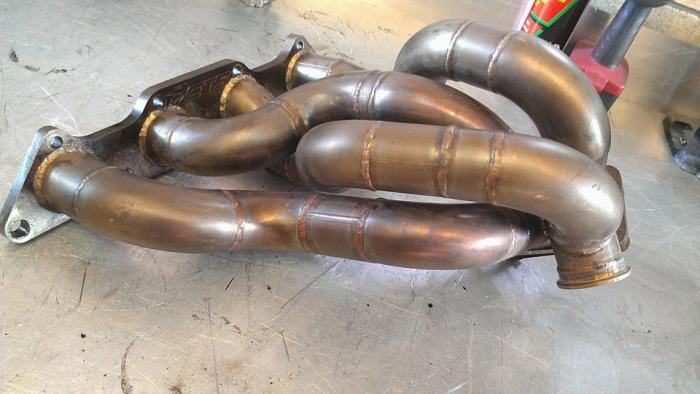

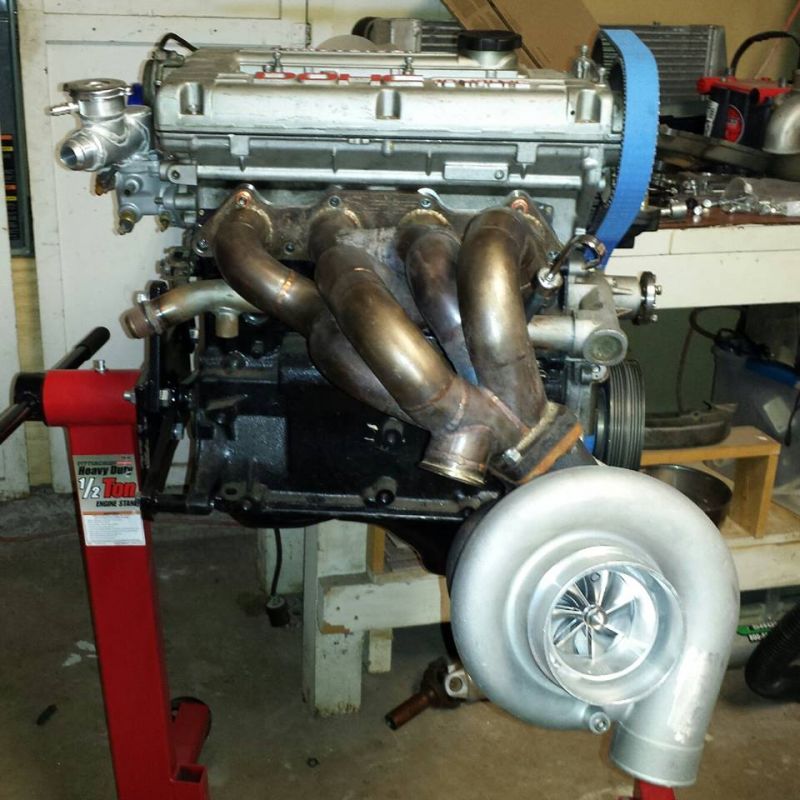

-Hollands Performance Forward Facing stainless T3 manifold
- FrozeBoost.com Air/Water intercooler with fmr and ice box.
-Forced Performance Super94
-3" SS downpipe to 3" aluminum rear exit v-band exhaust
- TiAL MVR wastegate

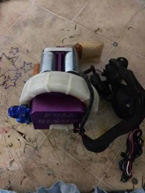

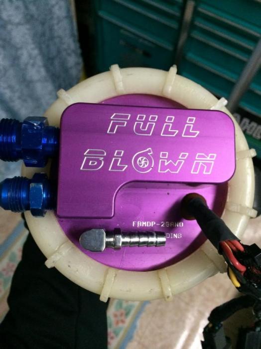

-Full Blown billet double hanger w/twin 340lph pumps
-Aeromotive regulator
-10 AN feed, -8 return

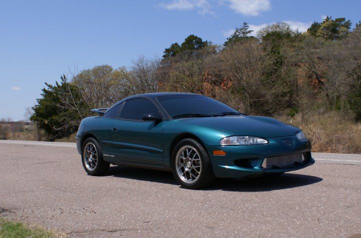

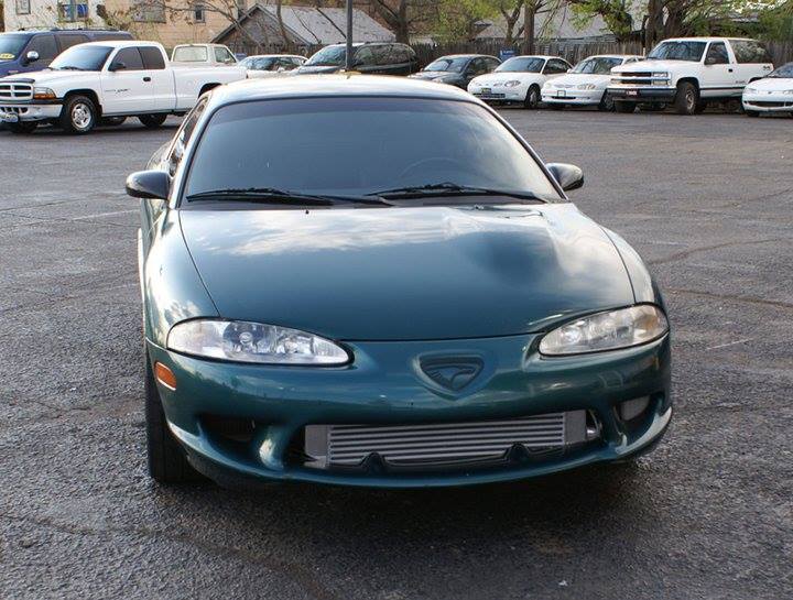

That talon looks sick. It sits perfectly. Love the Turbo inlet and exhaust. When will it debut down the 1/4?
The only thing I lack right now is my intercooler solution. Once I get that resolved, I'm hoping to make my first track passes at the IFO here n April then to back it up in September when it comes back thru!

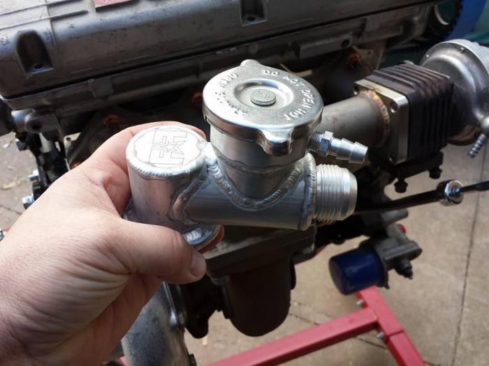

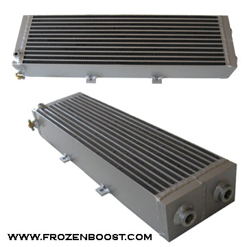

And now I have my intercooler solution. I'm going with an air-water setup from FrozenBoost.
Looking to go with the Type 15 intercooler and probably mounting it in the stock side mount location. Then using a 24x7x3.5 radiator for the water mounted more to the passenger side for clearance of the turbo/manifold.

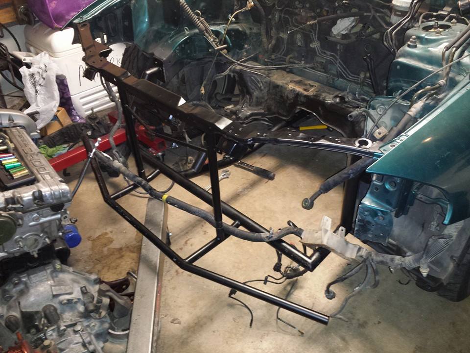

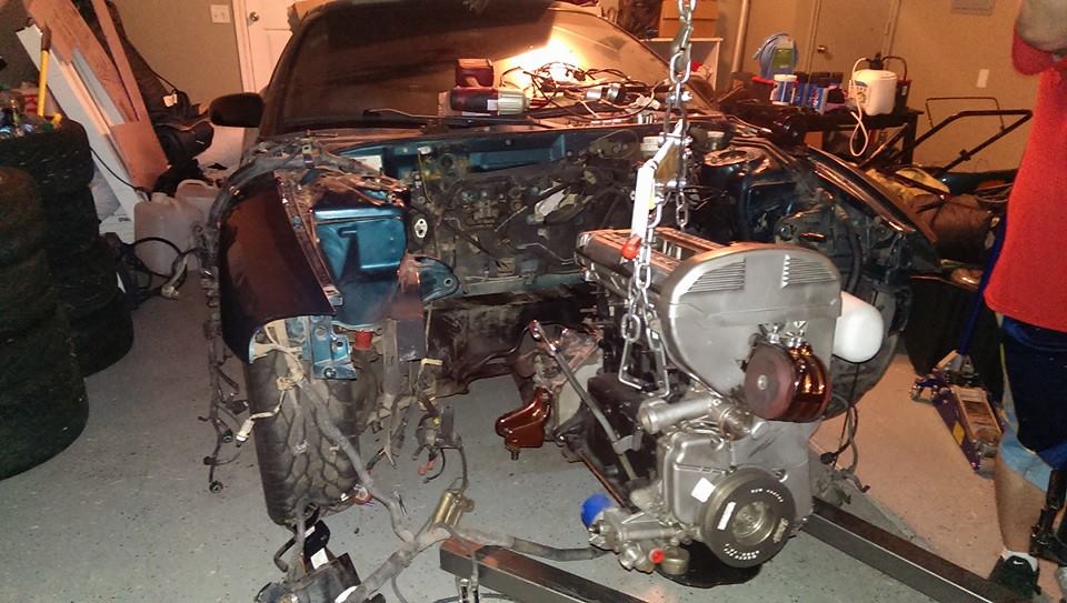

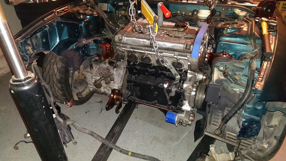

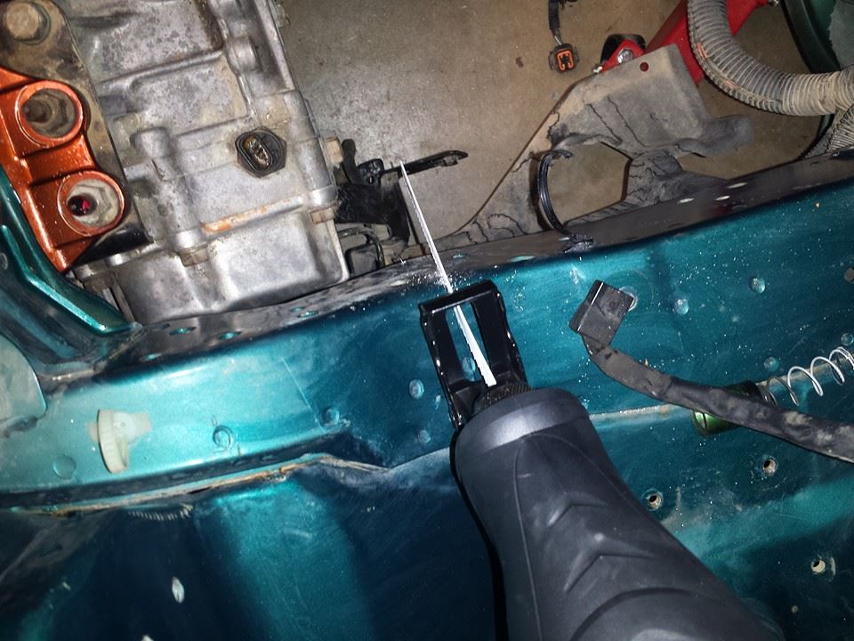

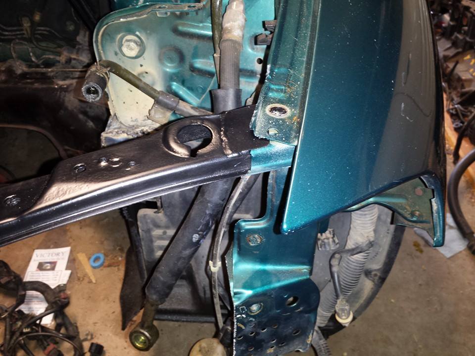

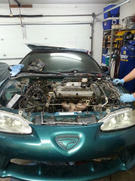

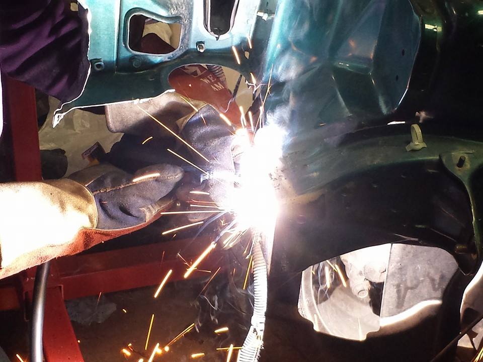

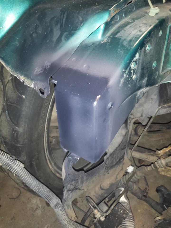

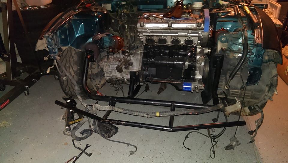

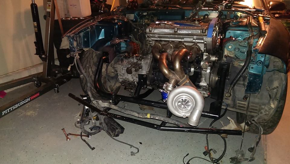

If the weather hold out, I'll be cutting the front end off this weekend. I'll post plenty of pictures of that, nothing has changed the last couple weeks because of the cold. My garage is not climate controlled.
