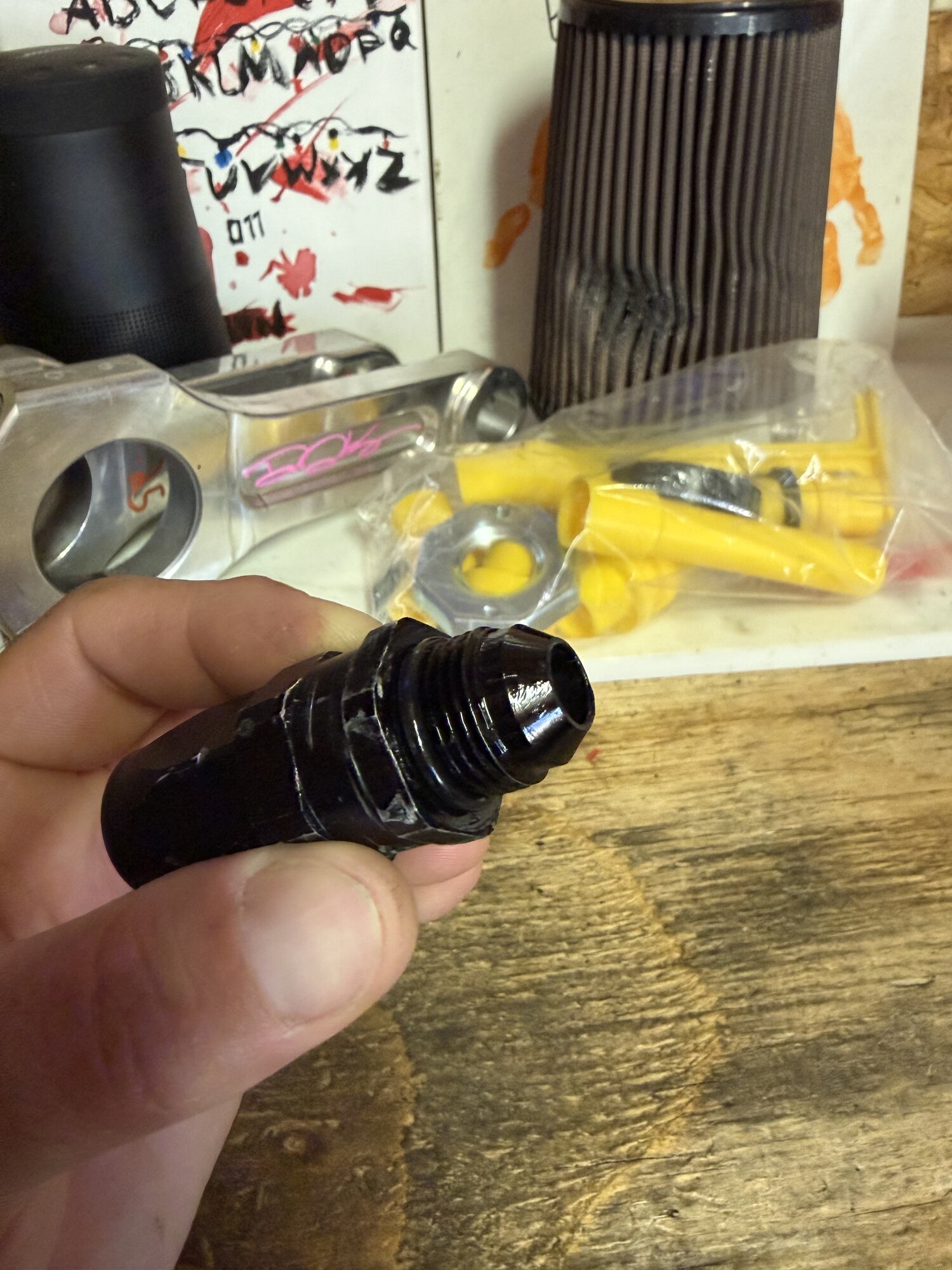

So here’s the fitting that was leaking, it now has a O ring which it didn’t before, I can’t remember if the other side had one or not, I’m not cracking it loose to check because it’s NOT leaking LOL, so as of now I don’t think I need a new filter, I was thinking the threads were stripped but they’re not, hopefully when my new 8an line shows up tomorrow if I can get everything re buttoned up quick I’ll try again. I’ll activate the pumps via ecmlink to check for leaks, if she’s good I’ve now got the plugs in ready to fire🔥

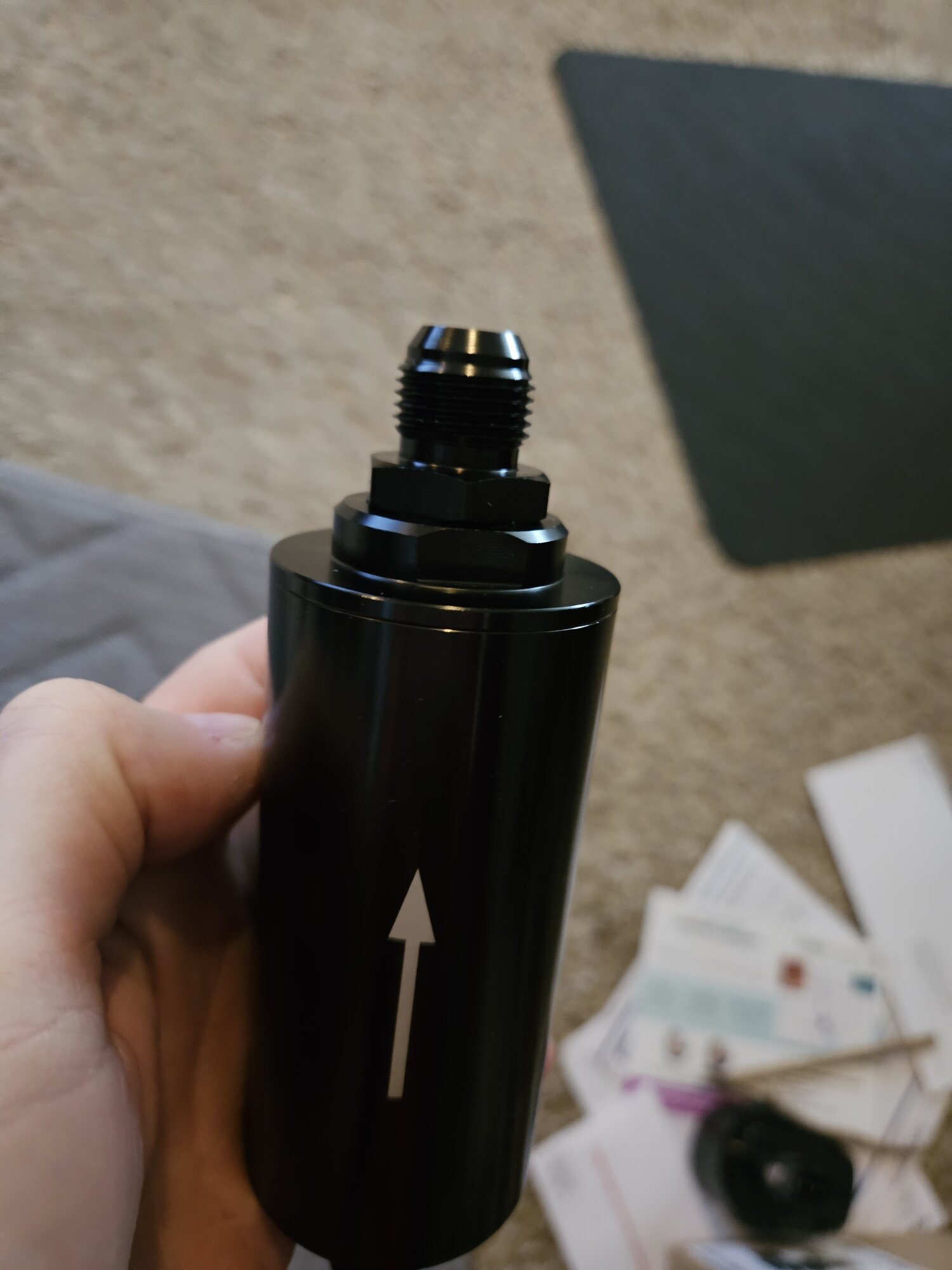

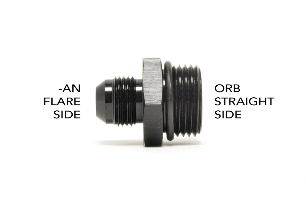

That doesn't look right. That type of fitting isn't supposed to have an o-ring there. I don't think there is a proper groove for it to keep it from blowing out, is there?
Anyway, the ORB fittings are the only ones that use an o-ring like that. Are you sure that filter isn't supposed to have an ORB fitting there?
I went and pulled out a new, inline, fuel filter and it doesn't use orb fittings. None of my cars have a oring on the filter except for the canister itself, on the end caps.
That makes sense, I guess I need to replace the filter housing and the fittings?
You may be right, the fittings I have I bought coupled together with the filter from stmtuned
Only if the housing is leaking. It is probably just the fitting on the end but IDK what filter STM had sold you.

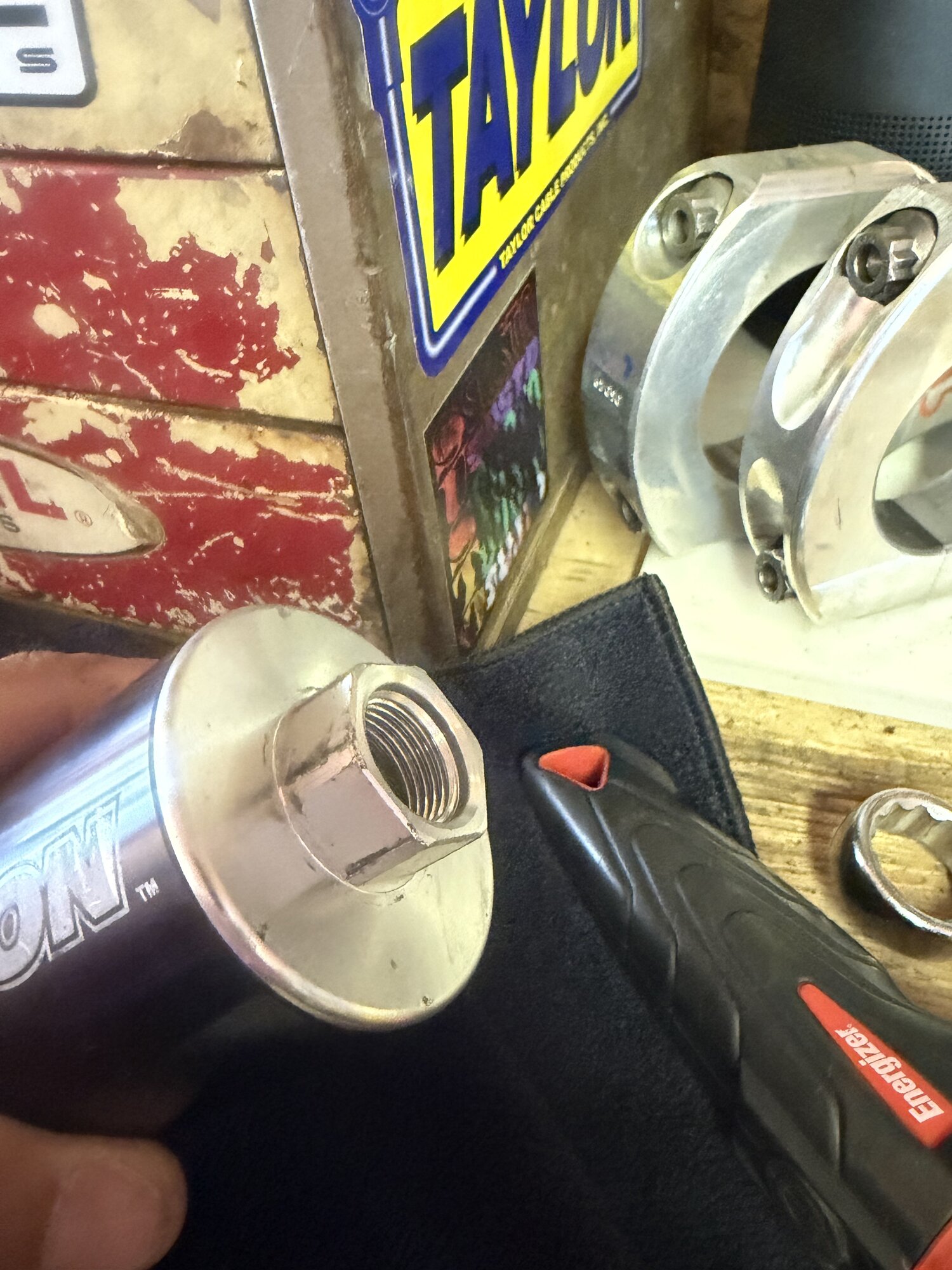

UPDATE!!! Fuel leaks fixed! With orings LOL
The filter housing has a chamfered end, I test fitted either side with an o ring hand threaded in all the way then backed it out, it wasn’t chewing up the o ring, anyways I replaced the bad section of line, put o rings on the filter fittings and Viola!

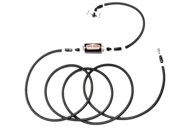

Jeremy, I noticed on the Vibrant page for Straight Hose End Fittings, Male AN Flare (which is what you have on the end of your hose) it says "Pair with an O-ring for an ORB seal". I think they mean like how you are using it. So I guess that is ok as long as it doesn't leak at 85-90 psi of fuel pressure.
The normal way though would be to put an ORB fitting with a male flare in each end of the Weldon. Then your hose end fittings would need to have the female flare.
That's how STM does it in the tank to rail kit which uses a Weldon filter.
They show ORB fittings as a related part at the bottom of their page for the Weldon filter.

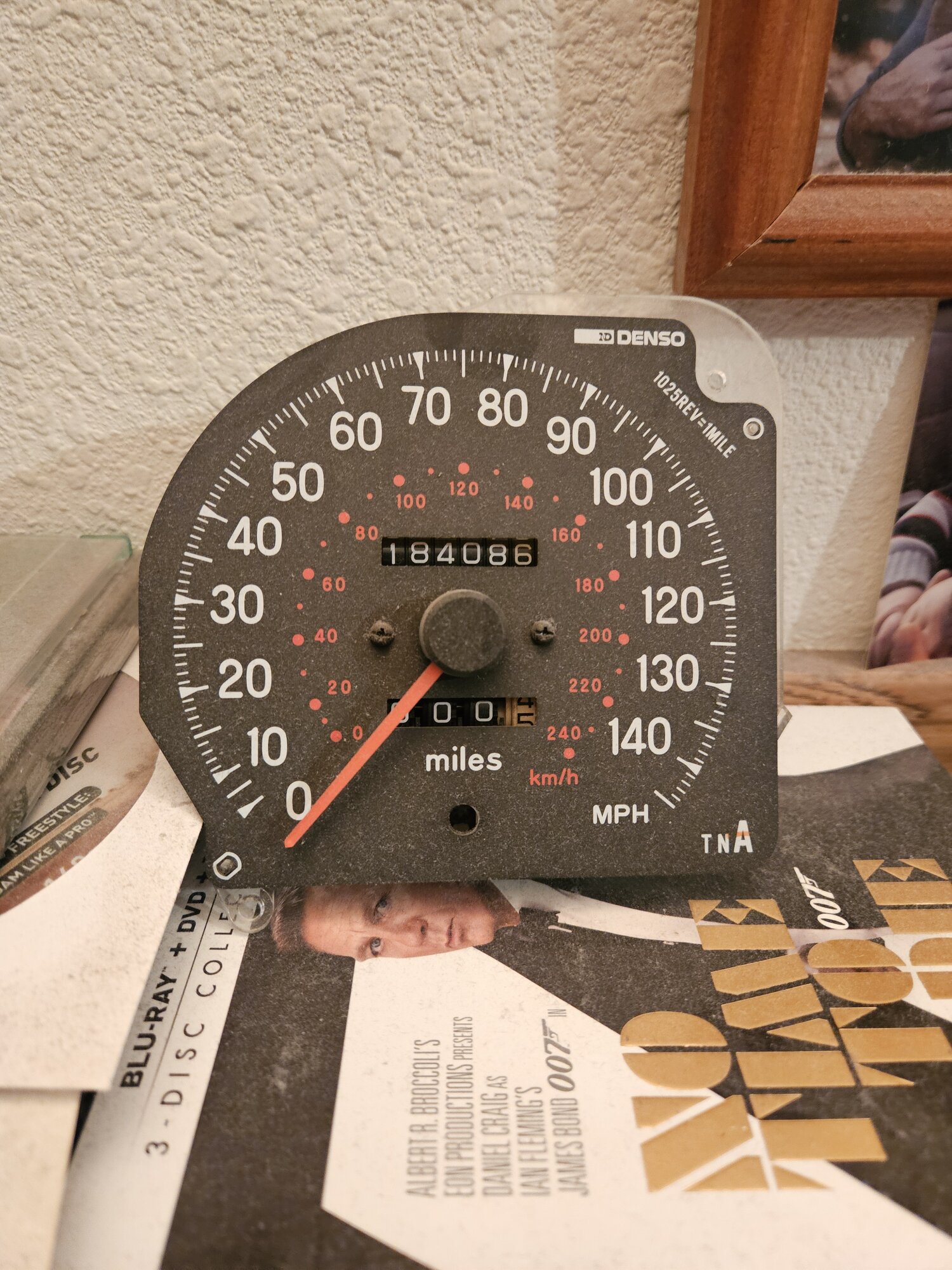

It may have something to do with the speed reading Jeremy. The 1g cars VSS comes from the speedometer cluster. I had to change mine out after mine quit reading, but only at like 20mph. The cable snapped and told my car I was at a stoplight so it shifted down into 1st rather quickly. It was abrupt but like I said I was luckily just in town driving between stoplights. Glad it is starting to put a smile on your face, you've done it all man! ✌️
Here is my old speedometer. Its a "mantle piece" as far as a auto car goes. I think my replacement was out of a 5 speed but they all had VSS.
