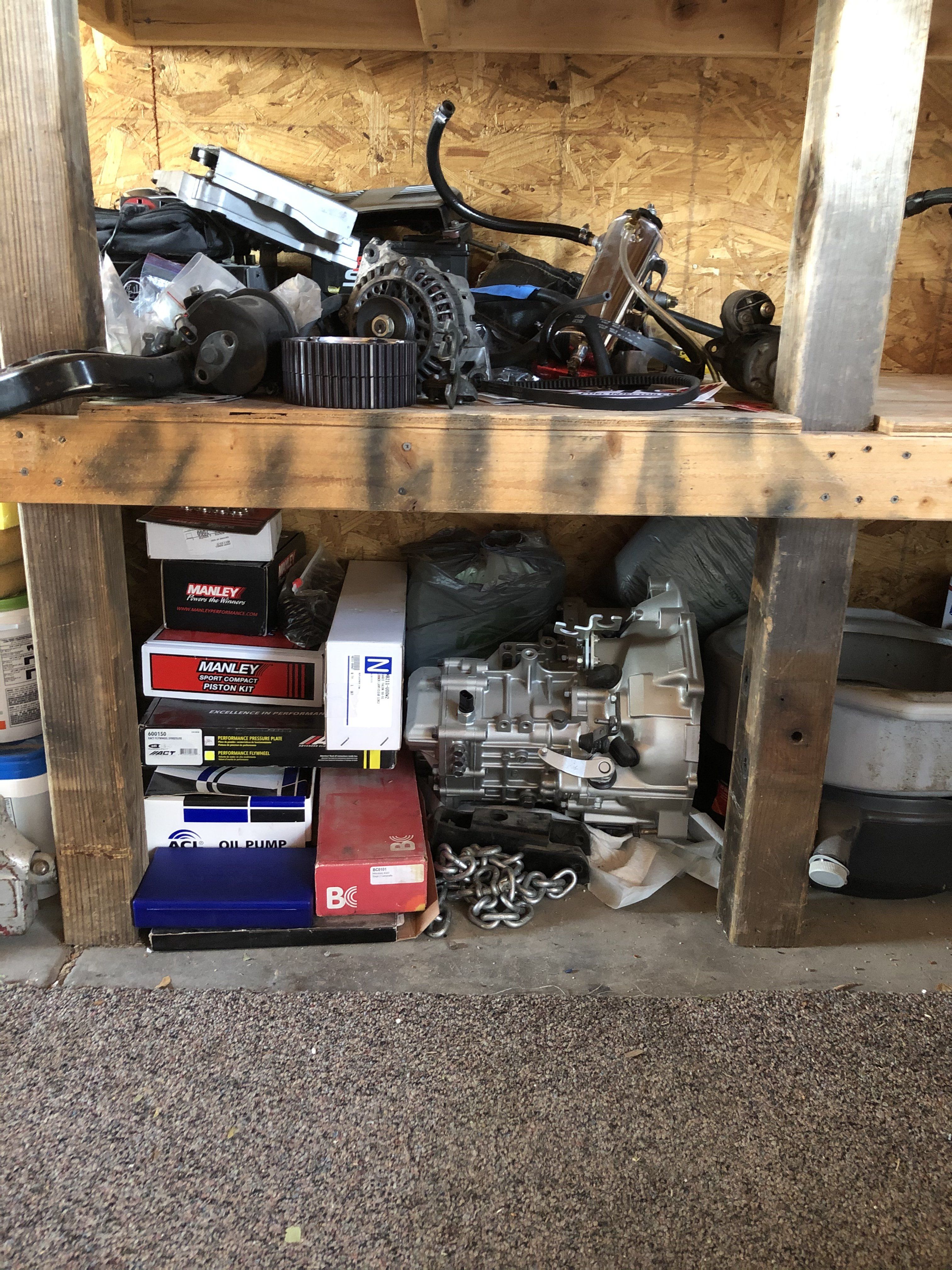

I just picked up this jacks hd drag trans off eBay! Super stoked to finally have an upgraded trans with a 4 spider diff, also gonna be pulling the motor for forged internals and upgraded valve train. Ever since I picked up a nice jh racing t4 divided manifold my mind has been spinning with new options and goals on the car. Super excited to have a new stout set up:hellyeah:

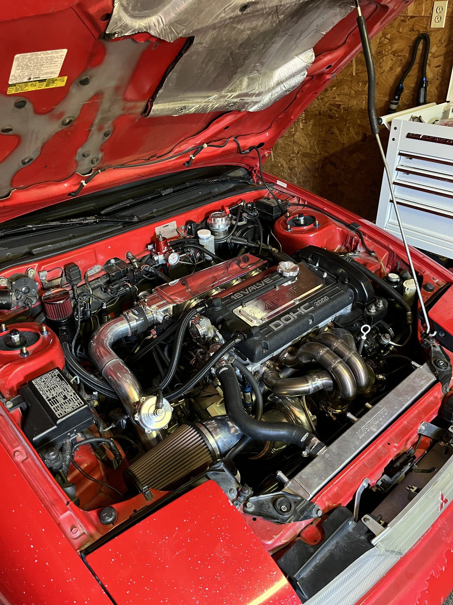

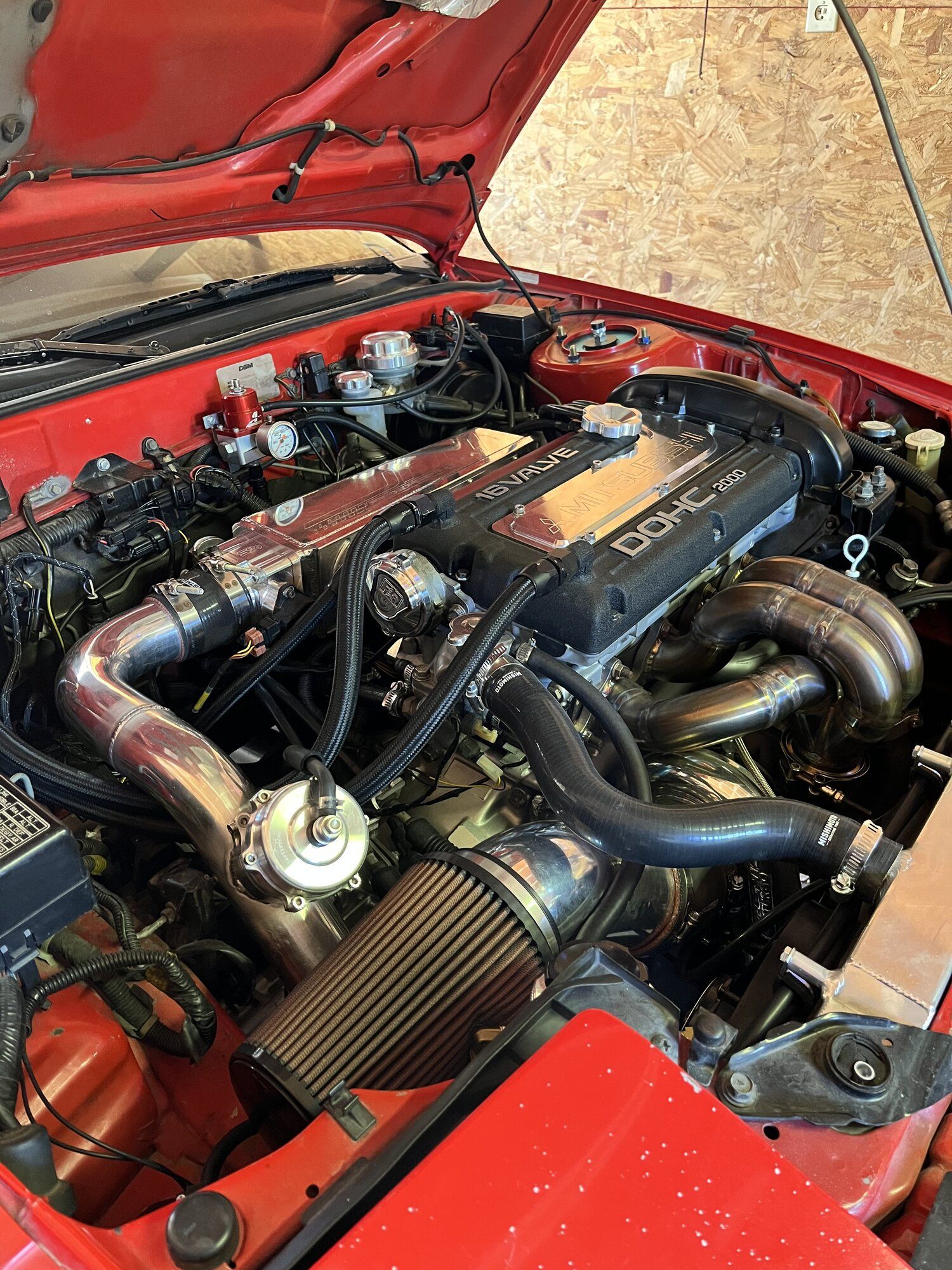

So here’s my car currently, I’ve decided to pull the motor again and rebuild it right to handle some power. I was originally going to simply throw on a new turbo and run the new trans/clutch set up, but I figured with the fluids drained, tranny and axles out I might as well just rebuild the damn thing and not worry about the stock bottom end breaking LOL. I’ll try and ad updates as I move along, it’s a boring build thread I know but I figure I’ll give the whole participation thing a shot LOL
My goal is 600whp, I’m planning on going with some manley h beams/pistons, and upgrading the fuel lines and intercooler while I’m at it. Hoping the rewired 450 with the addition of a Bosch 044 and hi z 1650’s will get me there, and while the block/head are at the machine swap I’ll delete the ac, and throw in my 4 bolt rear end:thumb:

Got her on the stand ready for tear down, I’m excited to see what the pistons and bearings look like, this was a stock rebuild that only has a couple thousand miles on it. I also picked up a new act flywheel a while back and some Manley pistons! Their 9:1 with the thicker wrist pin.
