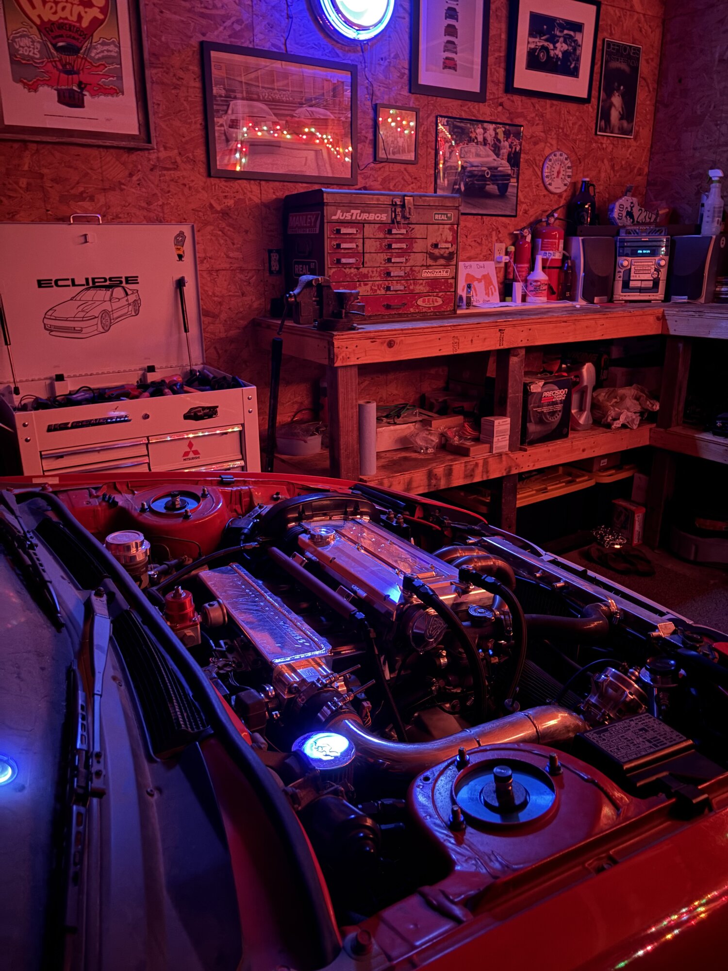

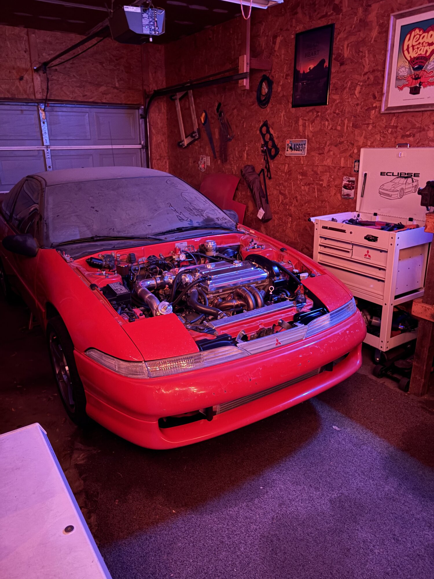

Hey guys, it’s been a minute! Figured I’d make an update on this thing I’ve been slacking LOL, I’m a week away from ordering a new walbro 535 and calling it good. I sent both my shift box’s out to Shawn at forcedfour to make sure those were good, they checked out fine, after a buddy’s help and some AI suggestions I think my fix to the rpm issue is to simply change the PPR(pulse per revolution) number from 2 to 4. The other big issue was my fuel pump relay harness getting hot enough to melt LOL. I’ve now got an HD relay harness with 10awg wire for the power wires. I’m also going to simply pin a plug/plug connection in the tank instead of hardwiring the pump with the solder/heatshrink connection, I’m sure that’s been my issue, but I like the idea of simply running 1 pump, if I ever max out the 535 I might consider a Bosch 044 or something but I doubt that’ll happen LOL, I don’t want anymore power for a street car, anyways she’s close, tonight i finally thru the bumper/lamps back on :thumb: :)

Hey guys, it’s been a minute! Figured I’d make an update on this thing I’ve been slacking LOL, I’m a week away from ordering a new walbro 535 and calling it good. I sent both my shift box’s out to Shawn at forcedfour to make sure those were good, they checked out fine, after a buddy’s help and some AI suggestions I think my fix to the rpm issue is to simply change the PPR(pulse per revolution) number from 2 to 4. The other big issue was my fuel pump relay harness getting hot enough to melt LOL. I’ve now got an HD relay harness with 10awg wire for the power wires. I’m also going to simply pin a plug/plug connection in the tank instead of hardwiring the pump with the solder/heatshrink connection, I’m sure that’s been my issue, but I like the idea of simply running 1 pump, if I ever max out the 535 I might consider a Bosch 044 or something but I doubt that’ll happen LOL, I don’t want anymore power for a street car, anyways she’s close, tonight i finally thru the bumper/lamps back on :thumb: :)View attachment 801179View attachment 801180
Engine bay looking good, the garage looks cool, but damn, the layer of dust on the roof/windshield! 😆 Keeping the cabin well insulated.

Clean that windshield and roof or we gonna have to change your name....mayne. :idontknow: ROFL ROFL ROFL ROFL:sneaky:
First stop will be the car washROFL
She’s been there awhile LOL
