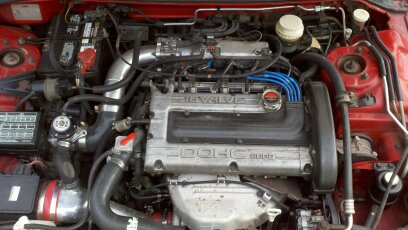

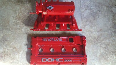

since I still have a powdercoating hook-up the first thing I wanted to do is clean up the engine bay, so Xeiros picked up a valve cover from a guy on here for me since hes a proven member. it looked to be in good shape so I blasted it and had it coated only to find out it was cracked in 2 places. :cry:shit happens and jb weld works wonders, LOL. got my hands on a 2g intake manifold from dsmgraveyard, and when I got it there was a broken bolt that hold the coilpack. WTF!:mad: Ican't win.

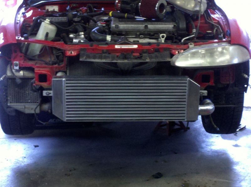

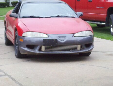

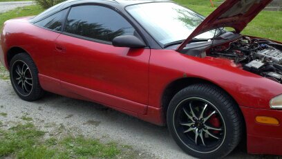

as promised, here is the fmic and 2gb bumper install pics. not very detailed since there are tons of write ups on how to do this. BIG thanks to Xeiros for the help today, if not for him I'd probably still be there f**kin with it!
there ya go, no more g*y-smiling-fish!!!
