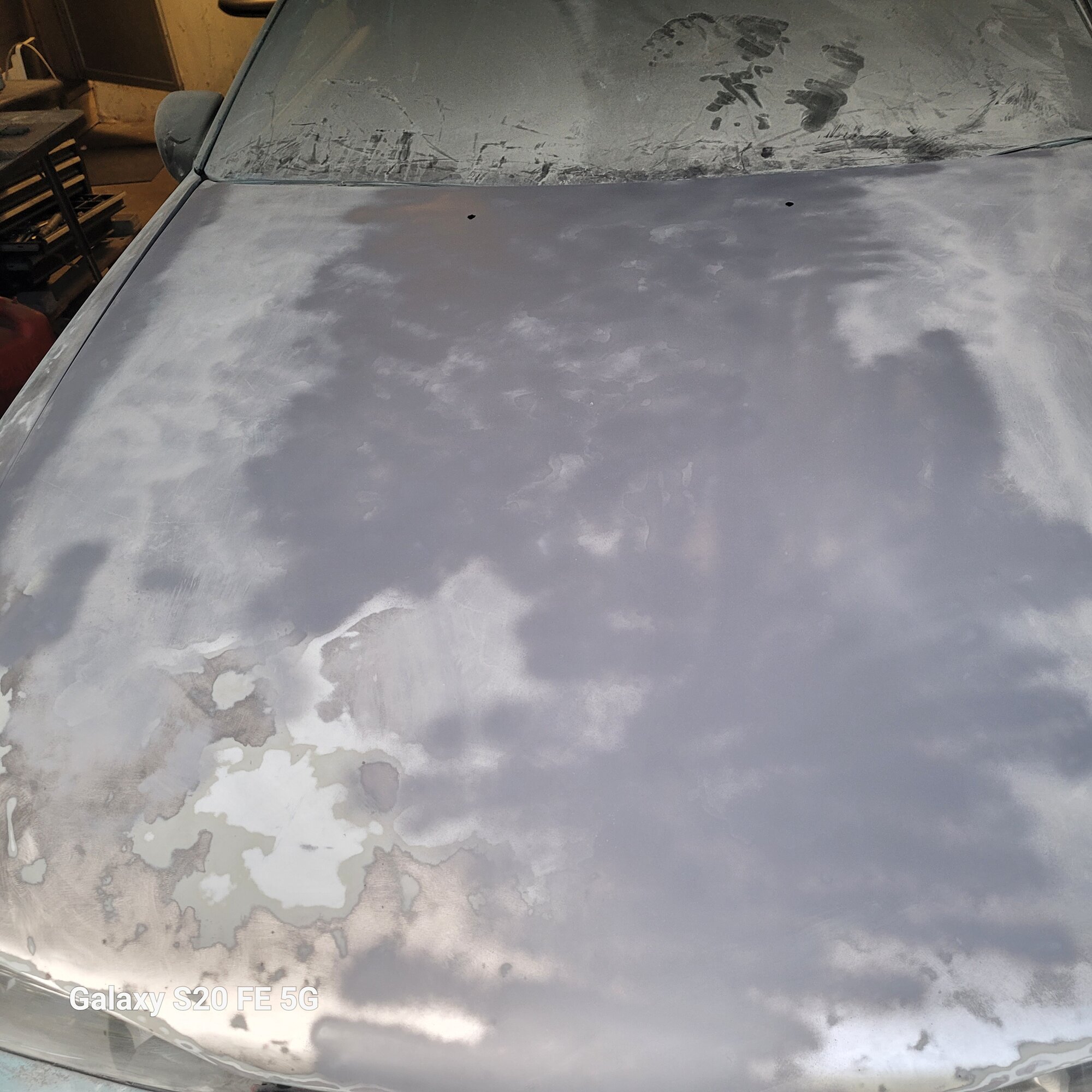

Make sure to read the cut sheets. Clear needs to be applied within a certain amount of hours or you’ll need to sand and re-shoot the base for proper adhesion. Looks good though!

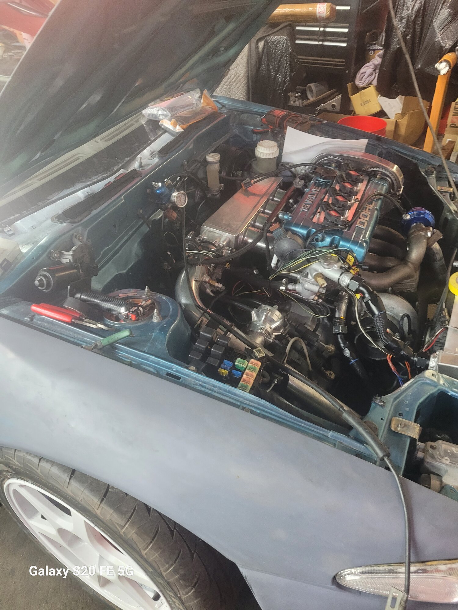

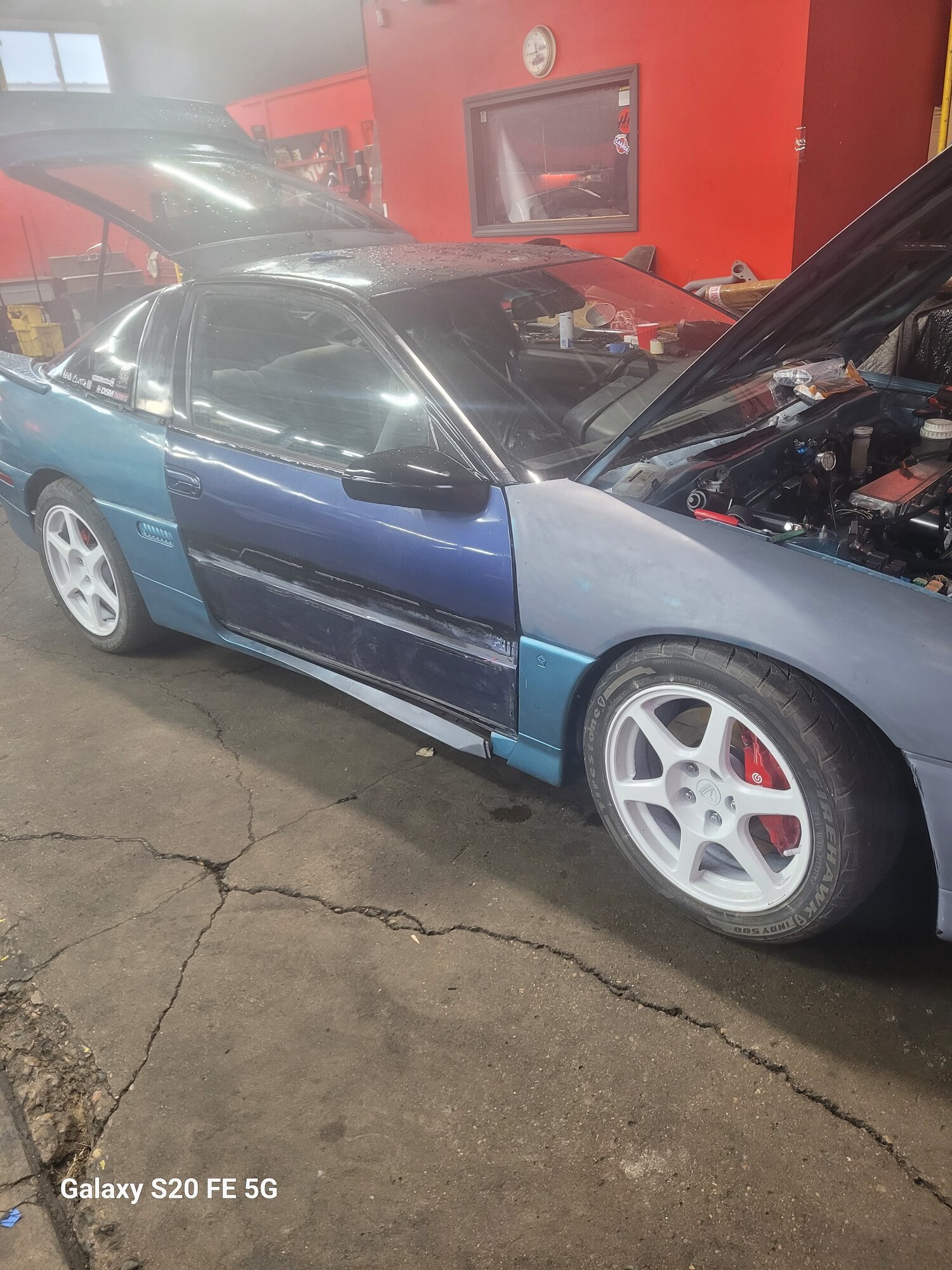

Well miscellaneous stuff now paint can wait till next year. Still needs a tune, shootout Still up but it's coming along nicely.

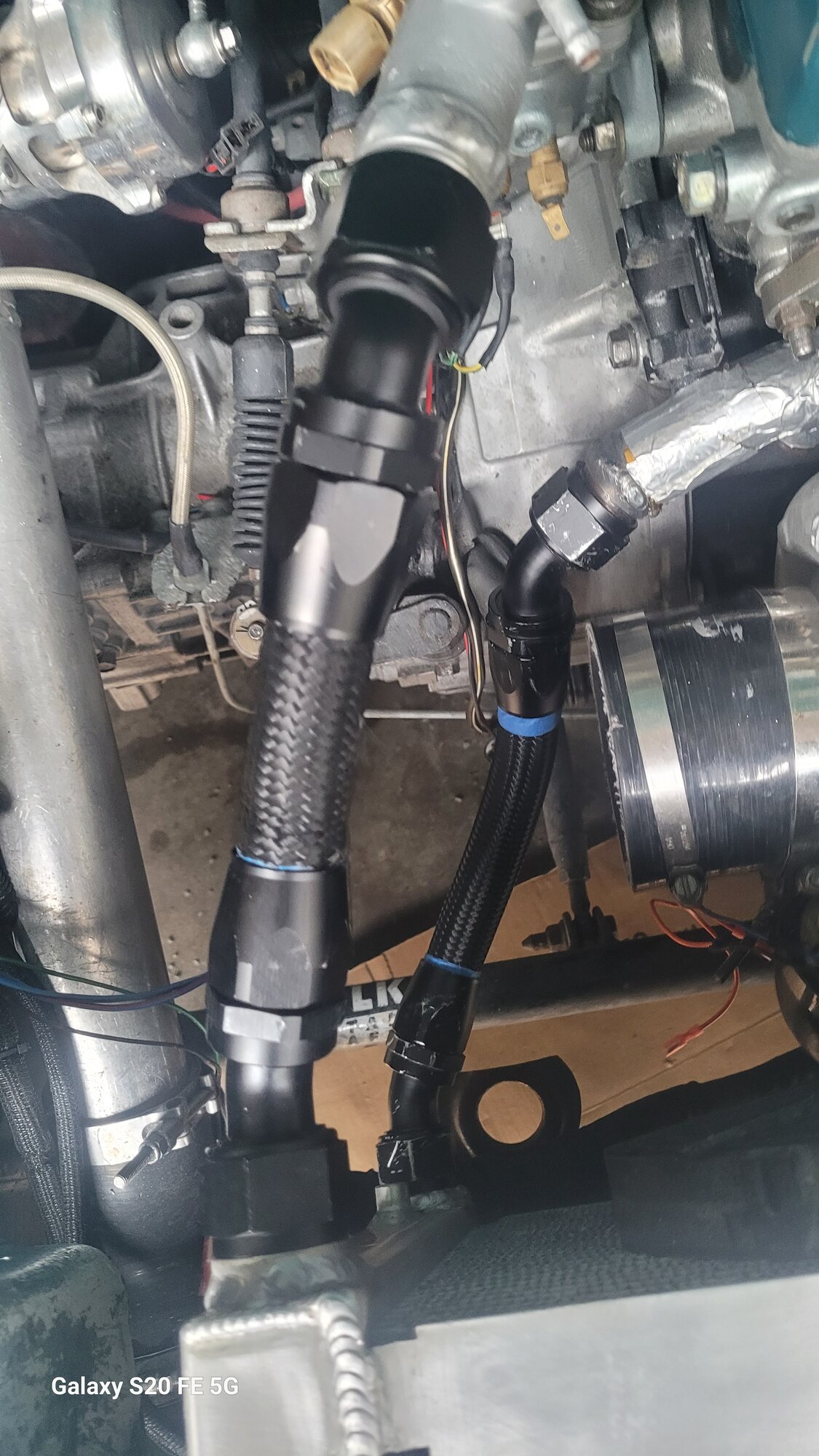

Picked up a set of cats eyes and a anti lag cop set up its soo nice. It's coming a long lots to clean up for next year's. Shootout bound in a few weeks anyway.
Well, its been busy i got the car almost where i wanted it to be, but still short of my goals i do plan to get it to Ohio where we can sort out some stuff. I'm happy with parts i got for her, but next year we will be ready to jam
early in the year. I just want to enjoy for a few months, this fall, winter will be making a new list of goals, and finishing touches to the car, with that said watch for updates .

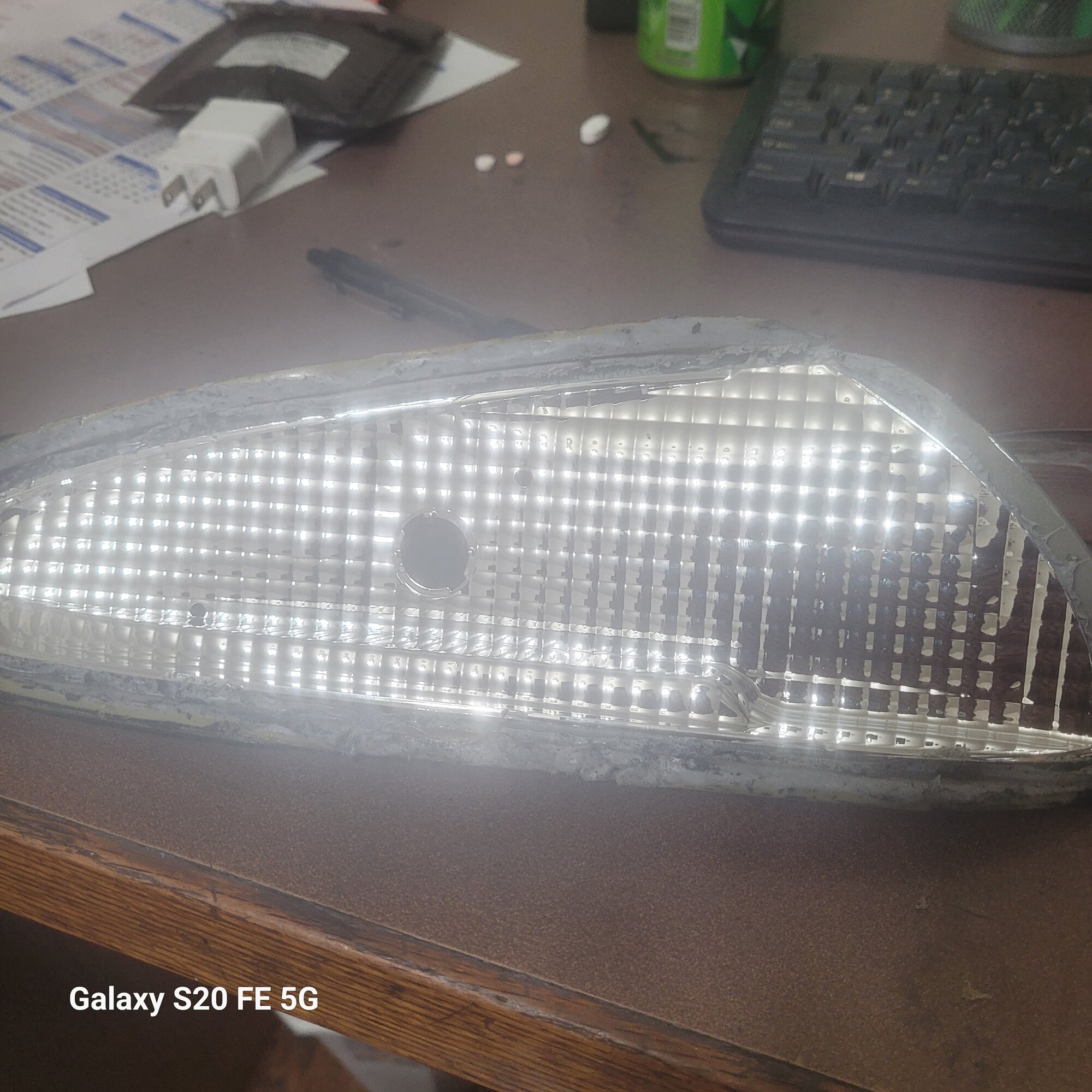

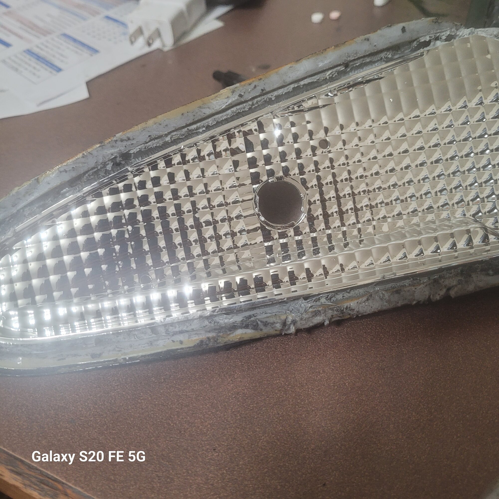

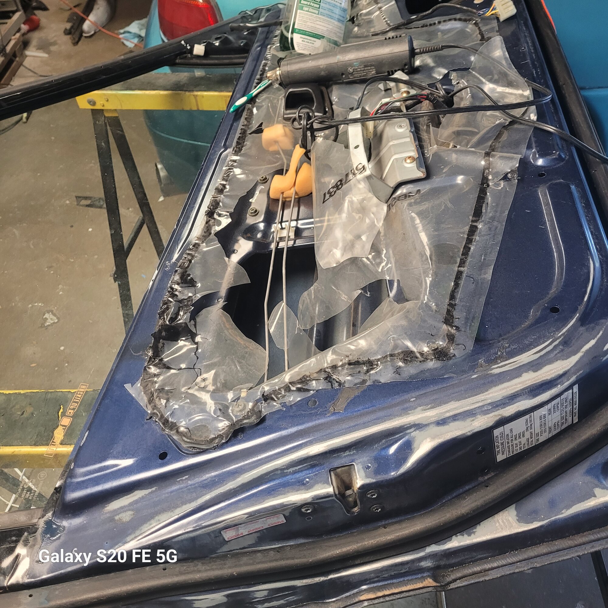

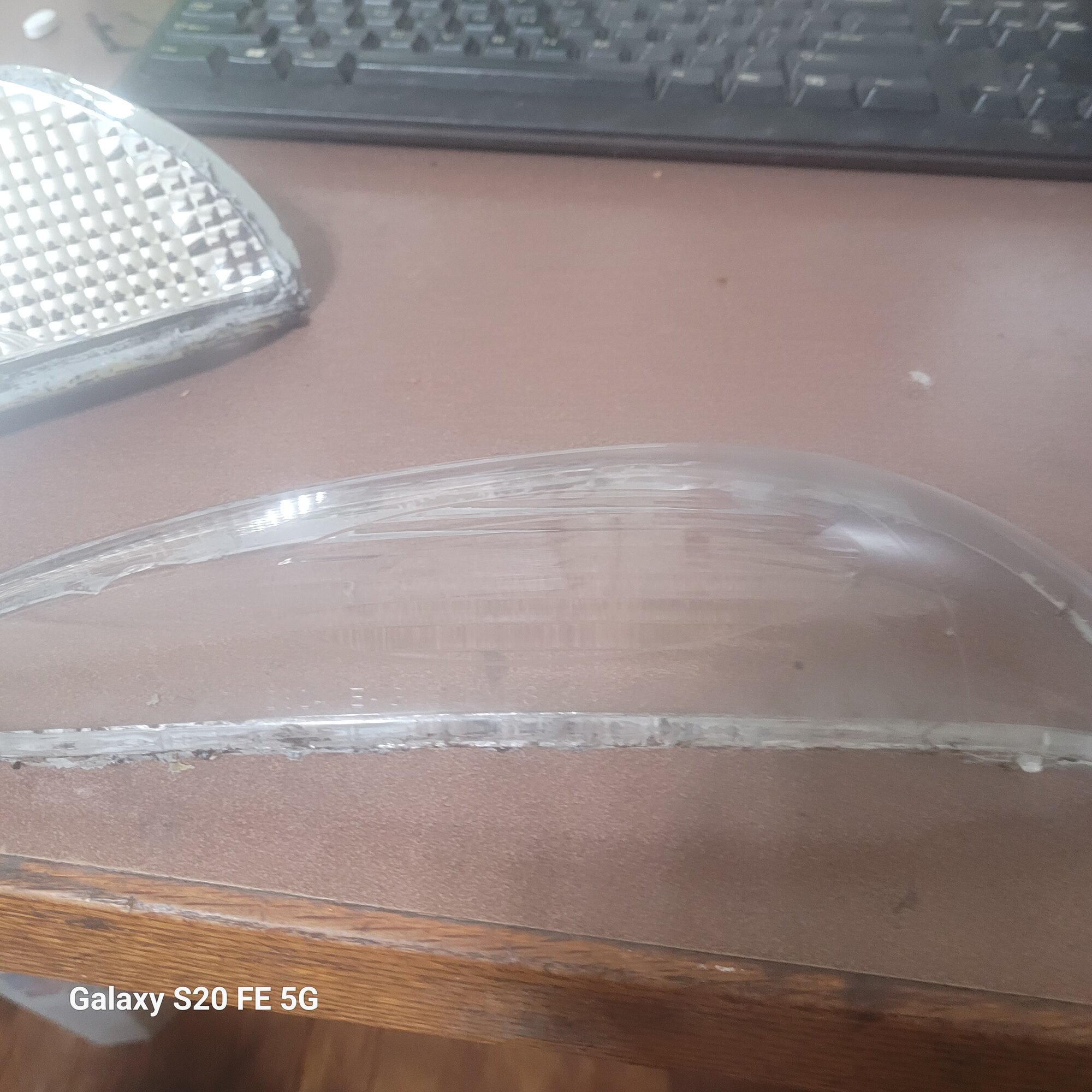

Decided to open this up to replace a black corner I had. I used a heat gun and a razor. Oh yeah gonna paint the inside flat black and seal her back up. I was so determined . Gonna work on the head lights this winter to clean to clean then up. This took less than a hour anyone wanting to do this its certainly easier than using the oven method.
