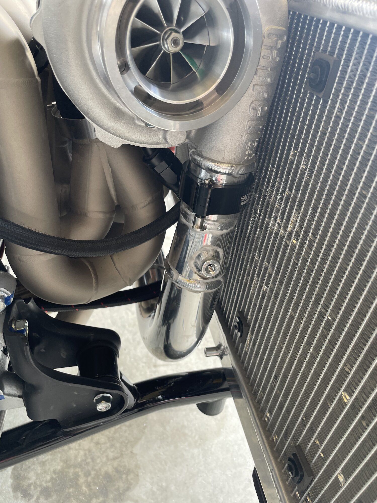

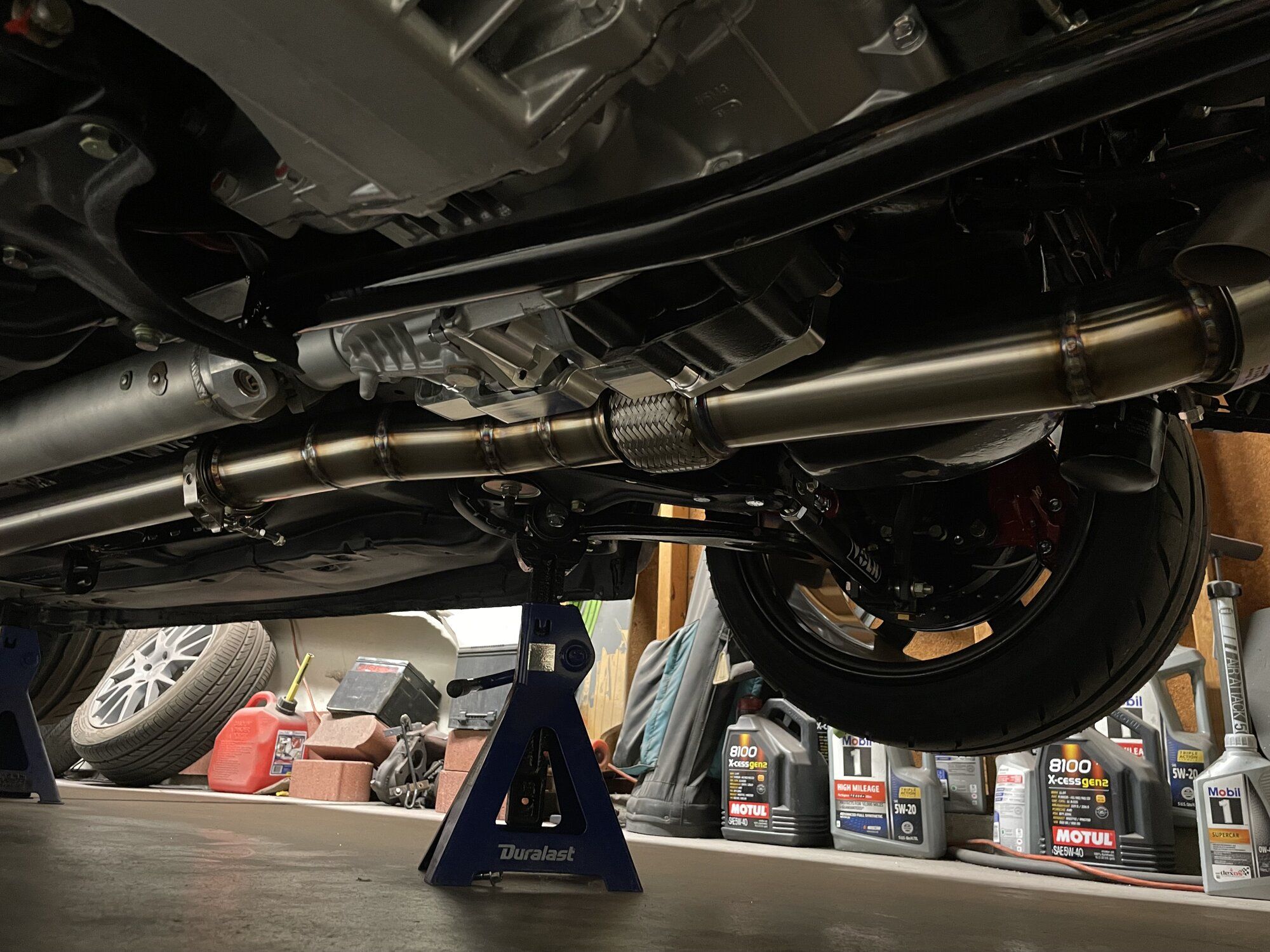

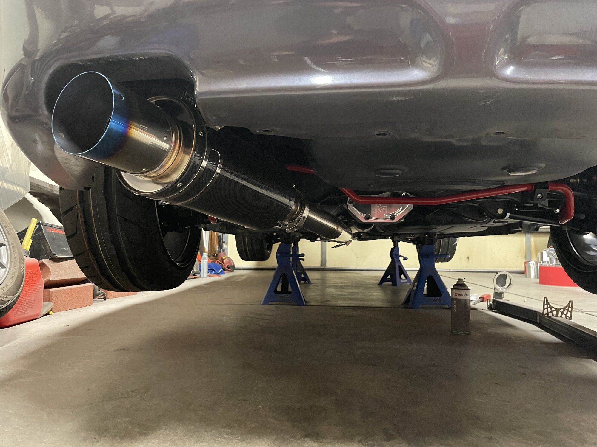

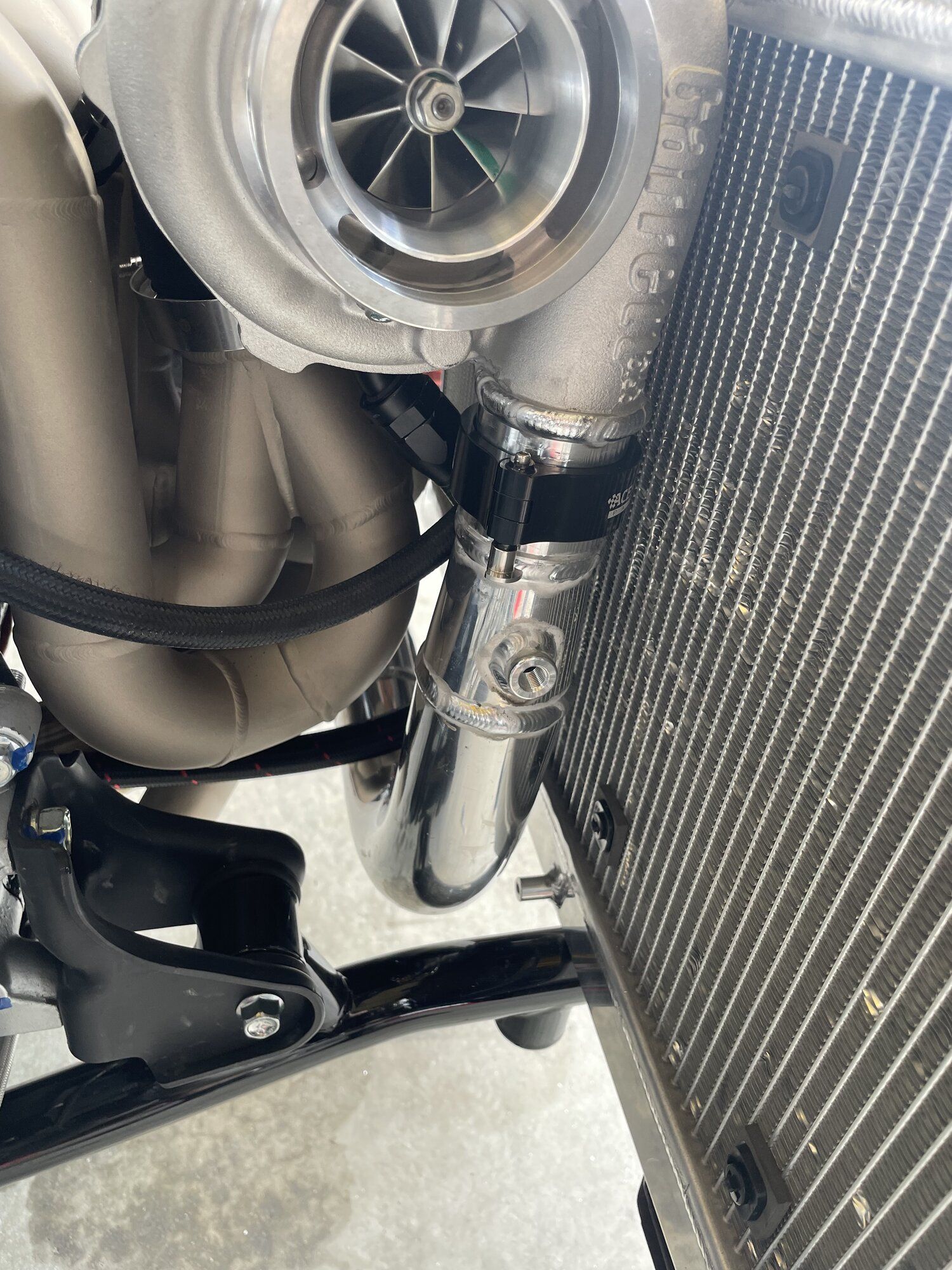

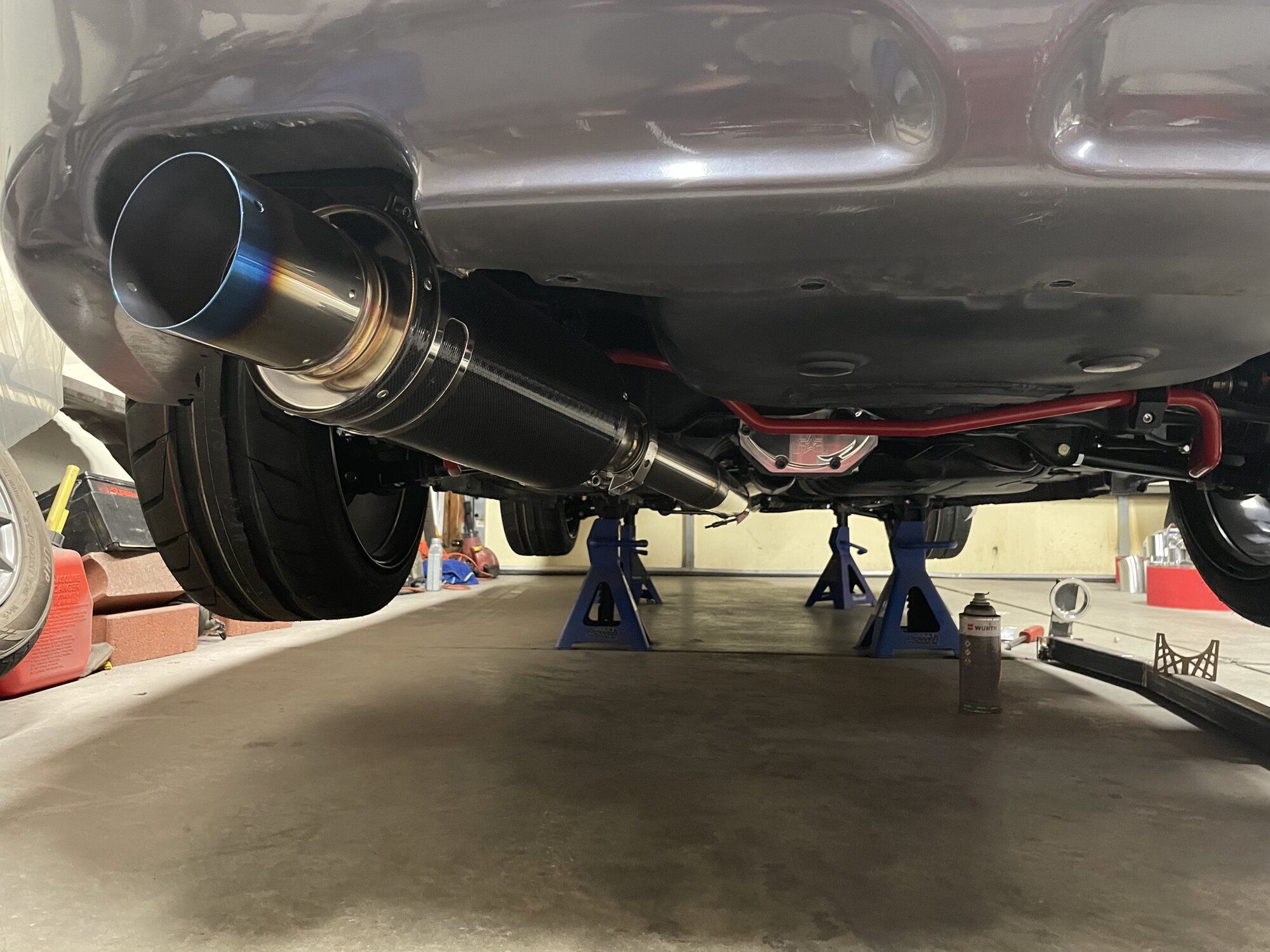

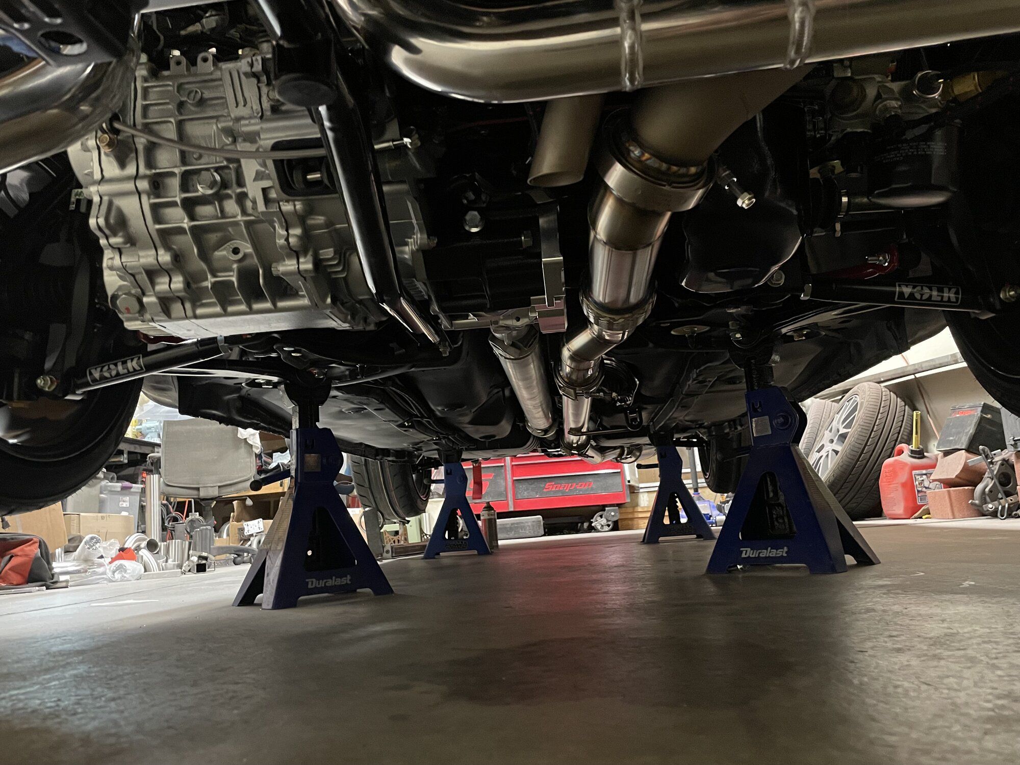

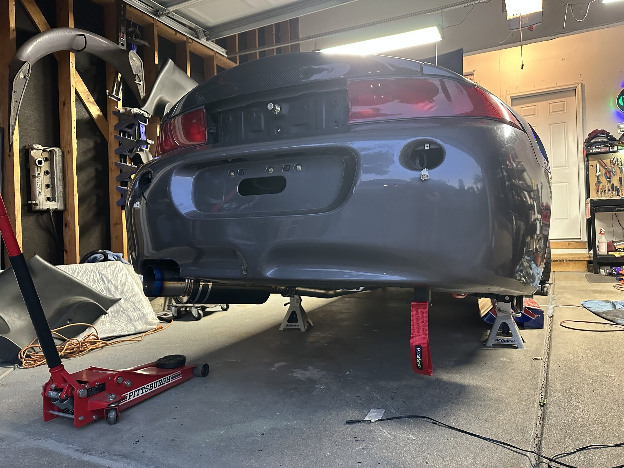

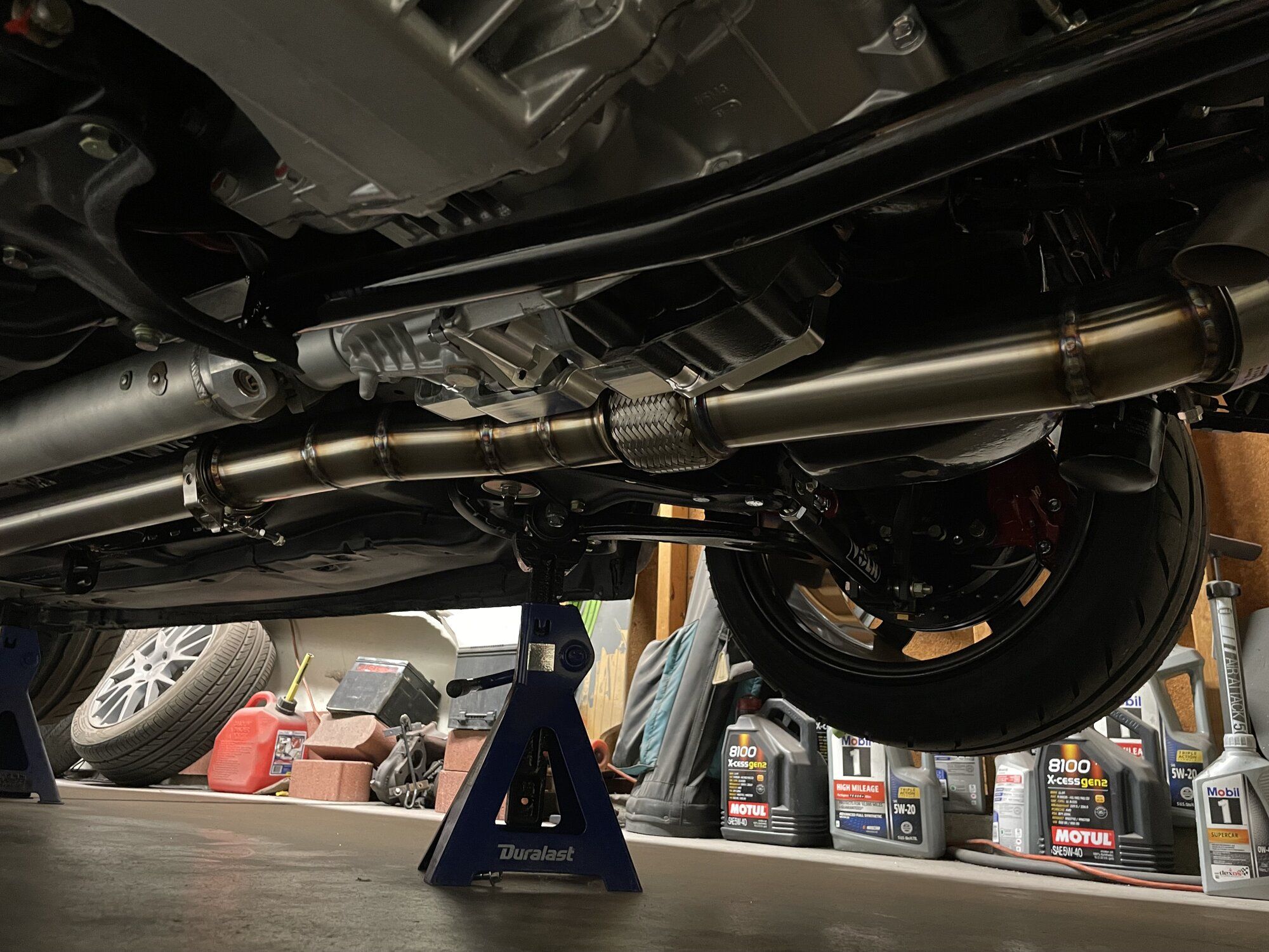

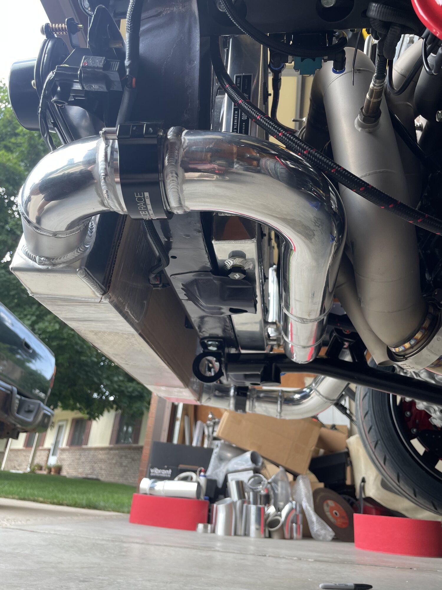

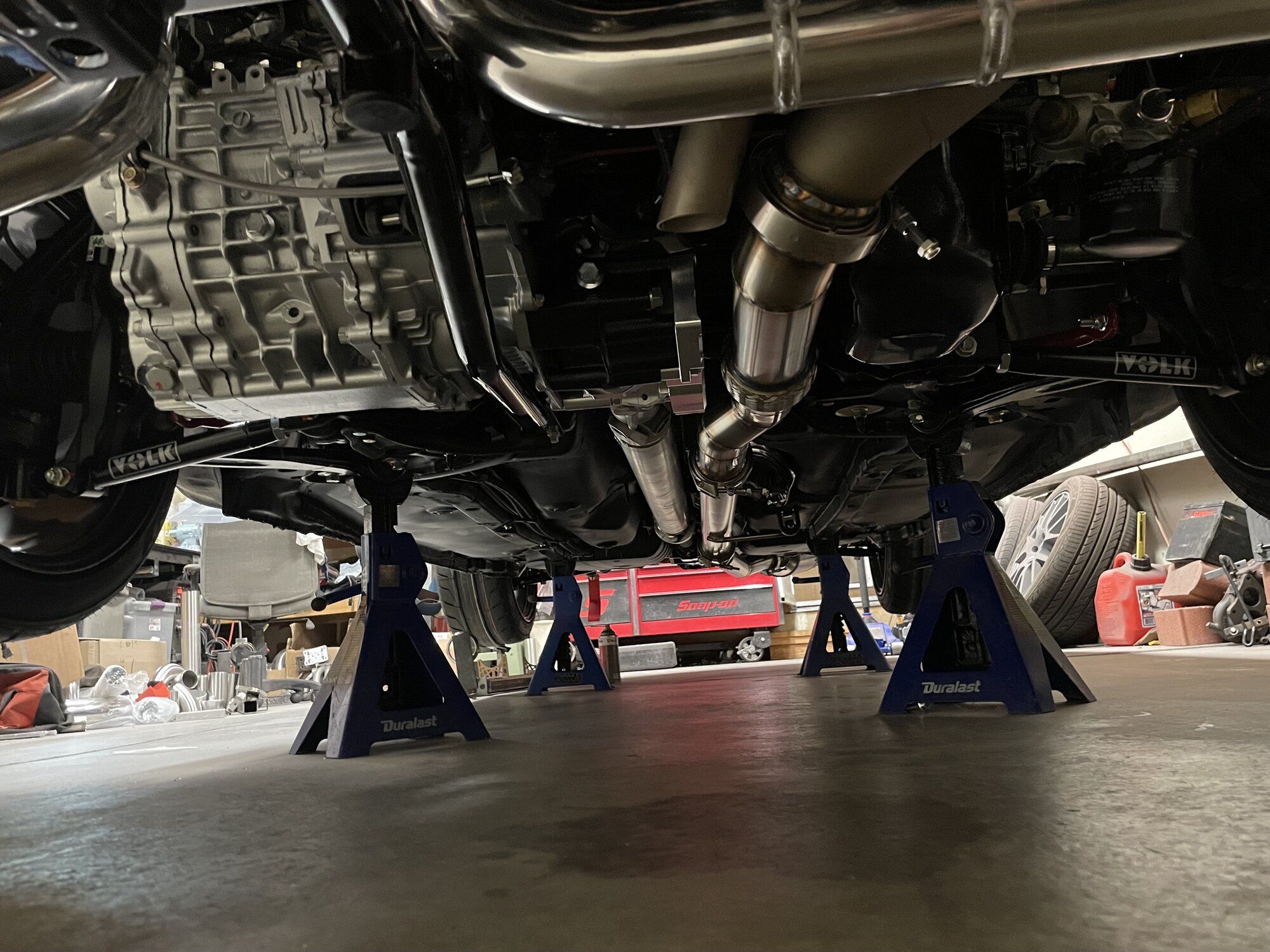

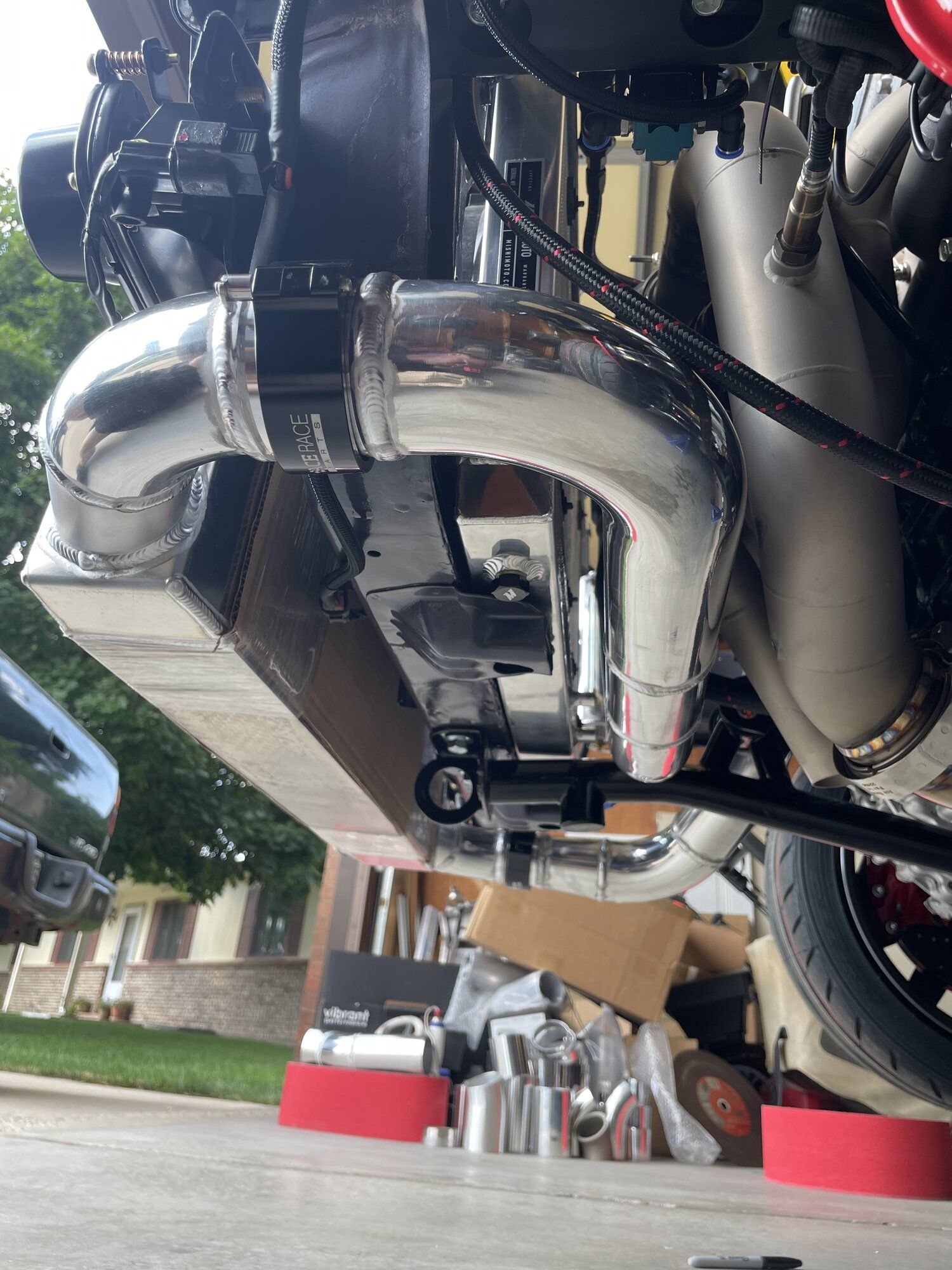

Huge update guys!! @CCdesign wrapped up the work on the intercooler and exhaust and it’s sooooo sexy!! I am so happy with it and the quality is so exquisite. Beware of the beauty that follows everyone..
Everything is done with vanjen style connection so it’s easily removable and reinstalled. Now for exhaust!!

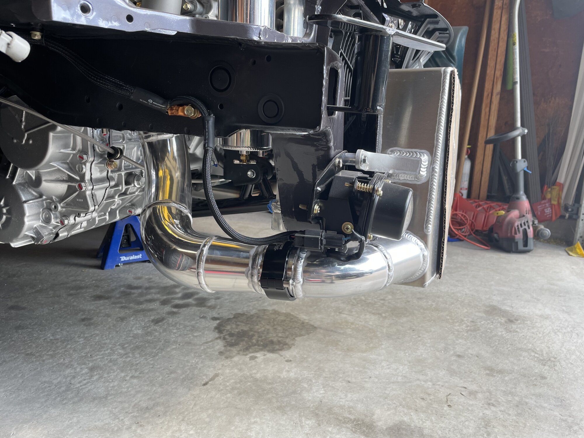

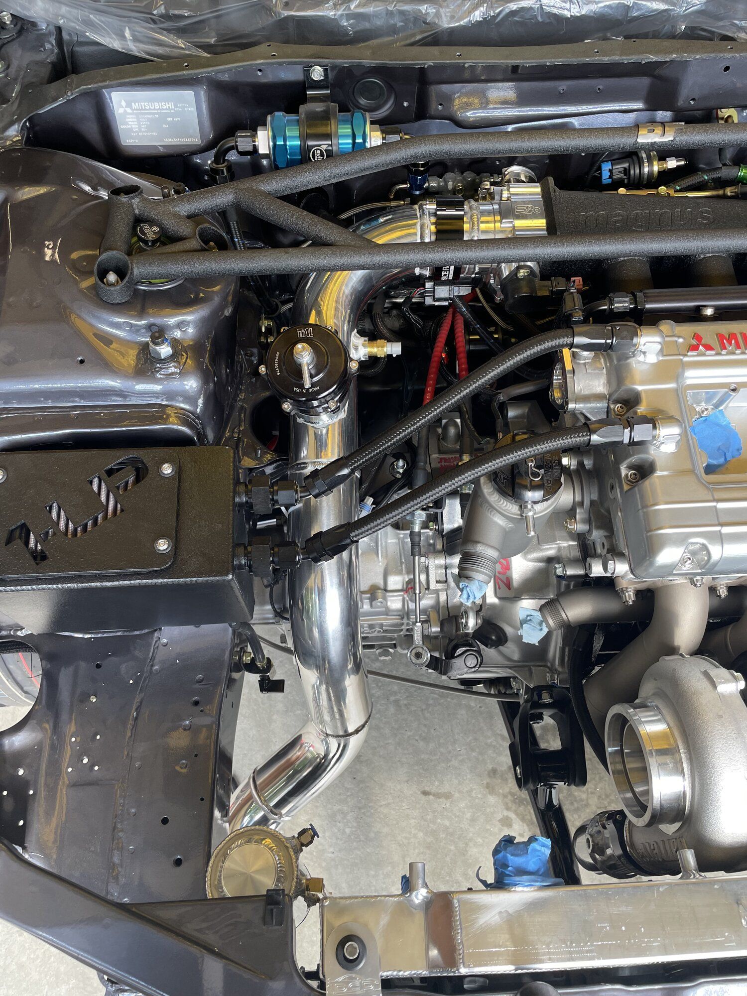

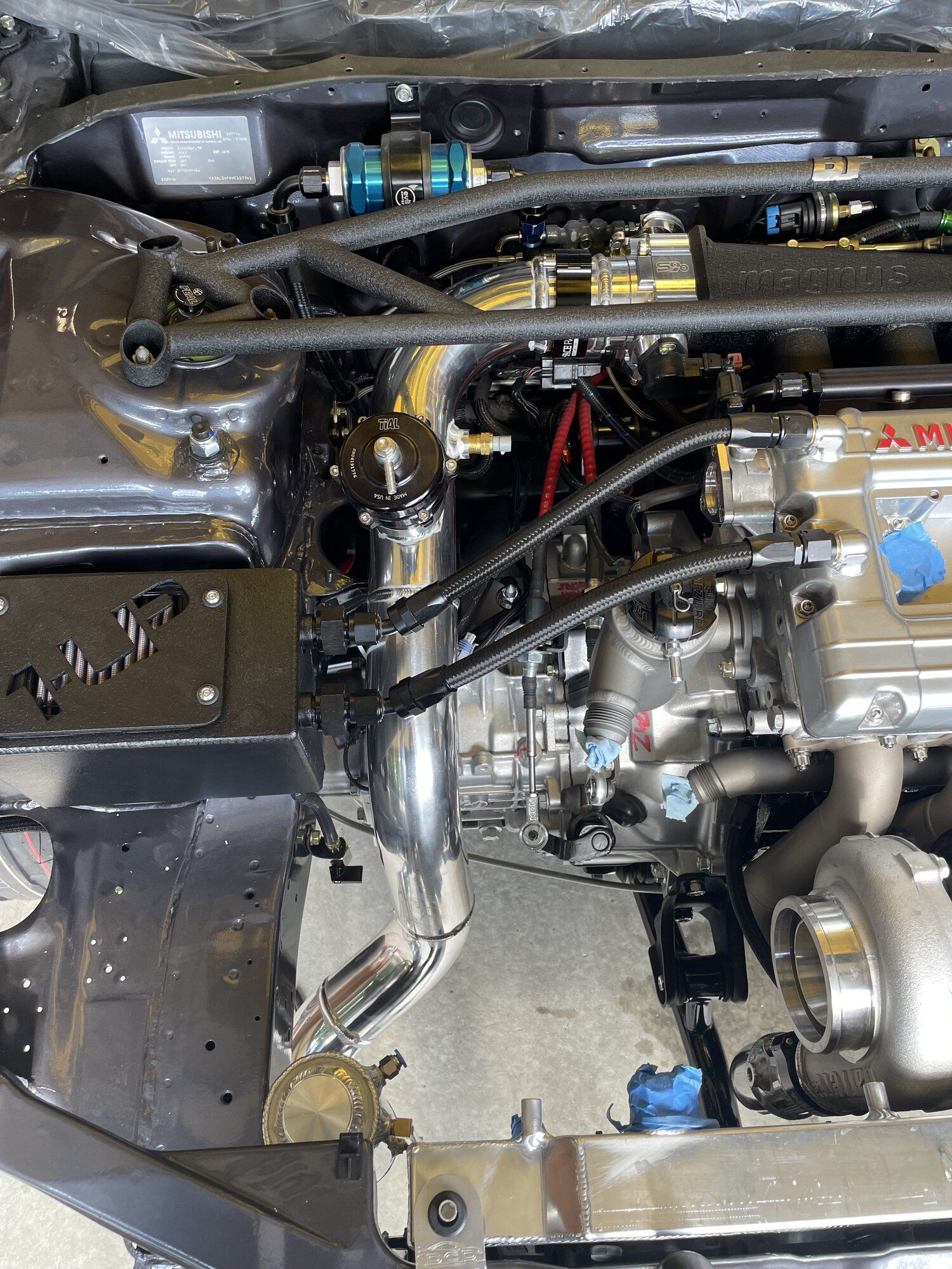

Chugging right along! Finally put power to the ecu and so far everything looks really good. Also turned the car over and we have oil pressure and compression! So far it’s looking good to at least MAKE shootout, but we will see. Tuning starts next week. Oh and got a fan issue fixed, drivers side fan was not working but troubleshot it and it was installer error LOL.

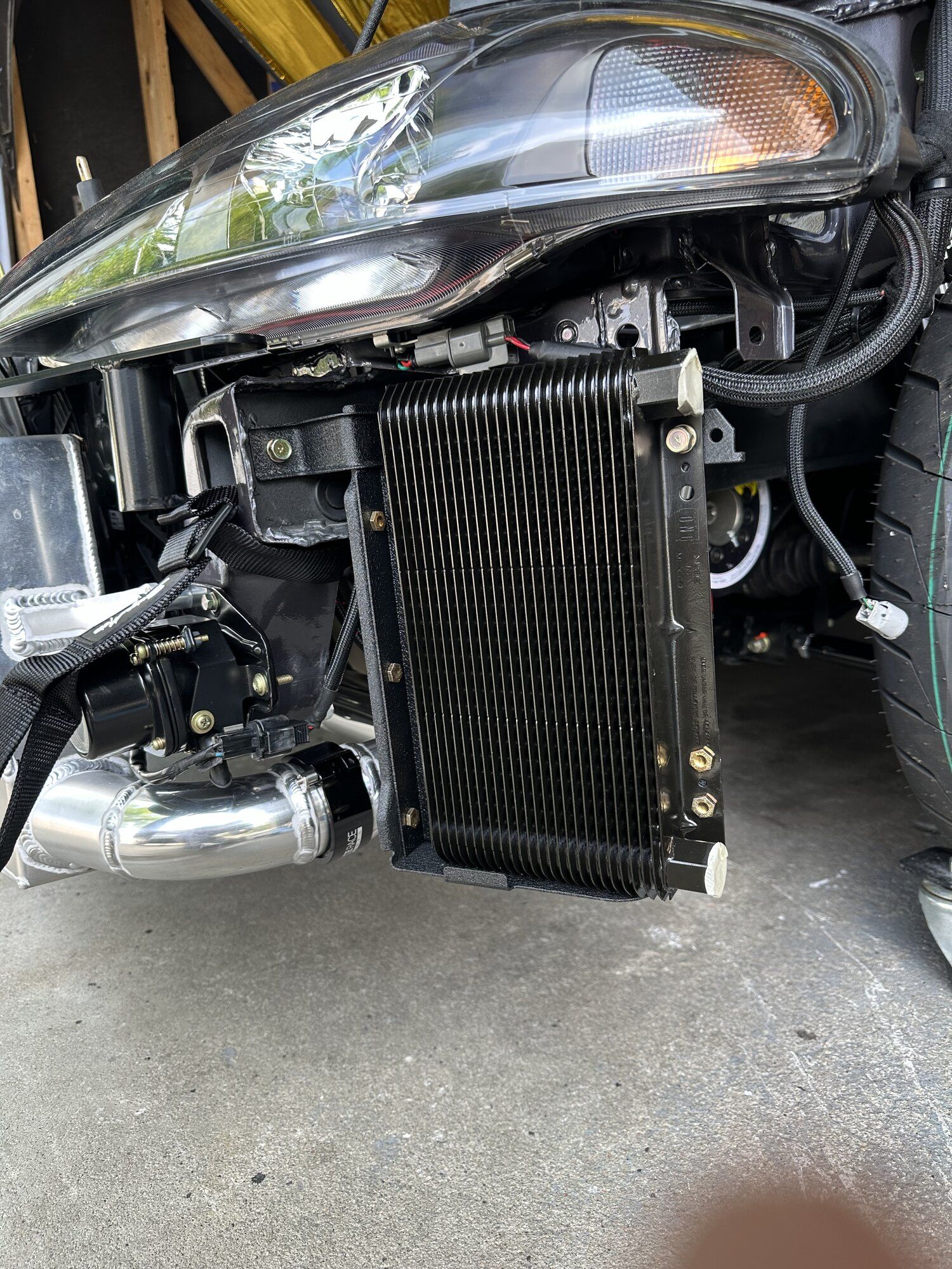

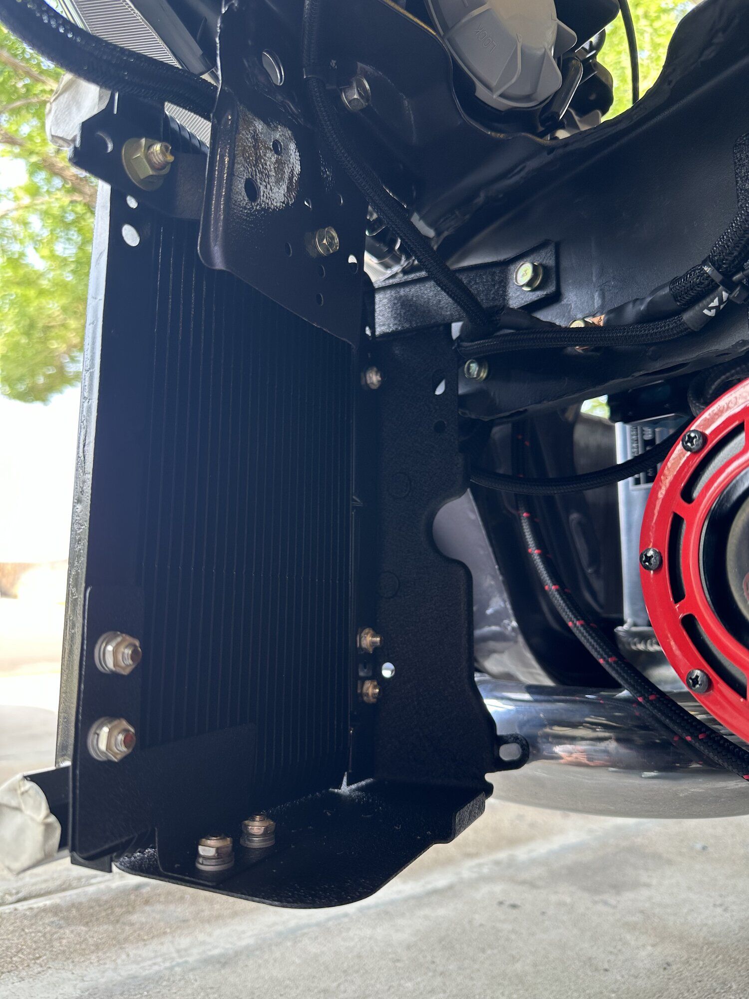

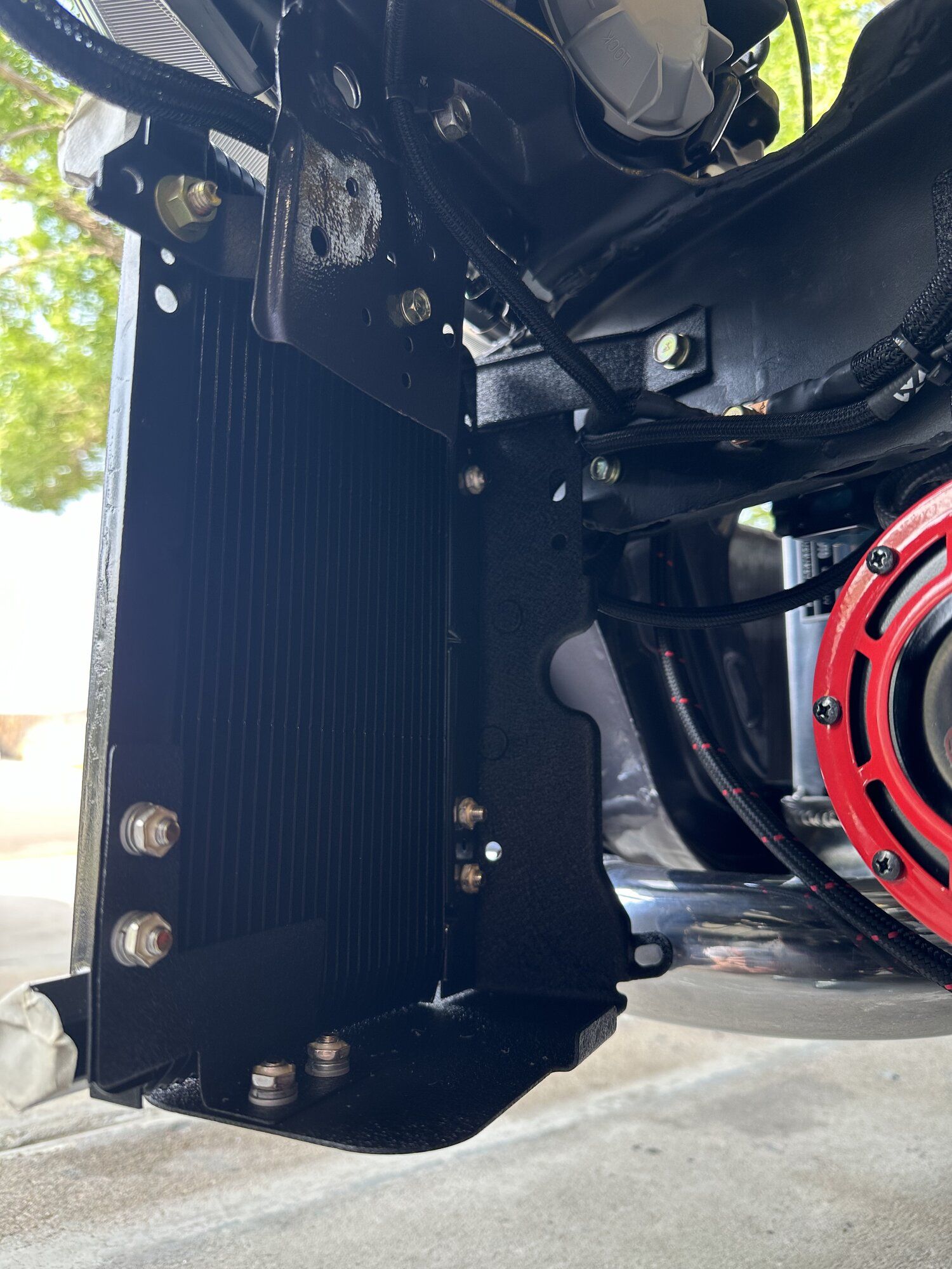

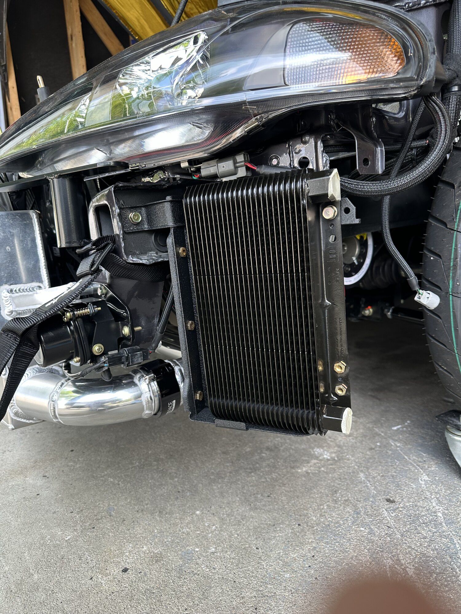

Finally got the freaking oil cooler mounted as well. Plumbing the AN like from the accumulator that’s mounted behind the rear seats.

I used a b&m cooler and used the 97-99 charcoal canister bracket for the base. The side is mounted on aluminum angle and the rear lower is also aluminum sheet stock I cut. The rear upper bracket is actually the oem horn bracket that I modified to hold it onto the small metal area behind the bumper. Pretty wild I know, but should work awesome here. I would imagine a trans cooler could definitely work here as well, but the lines would be pretty long and awkward to route I would think.

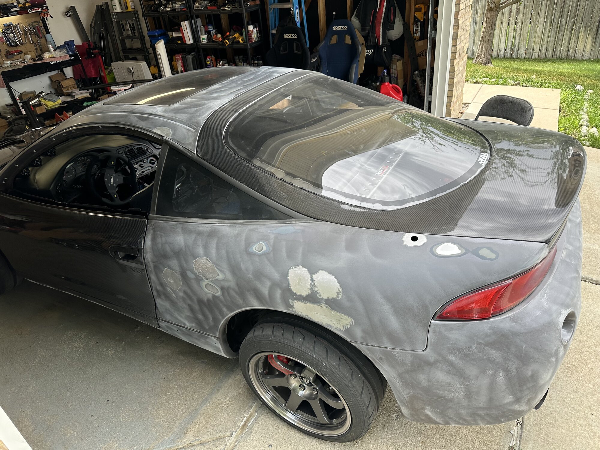

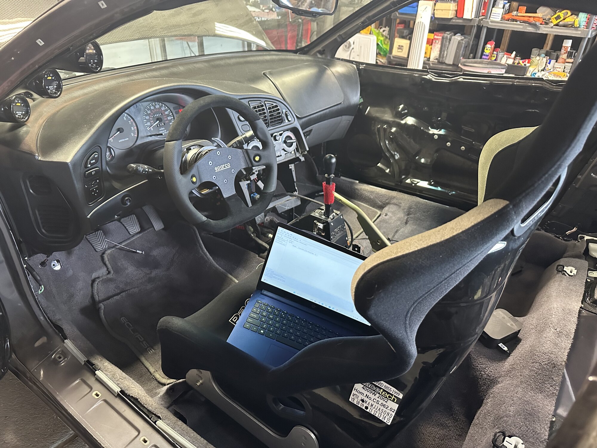

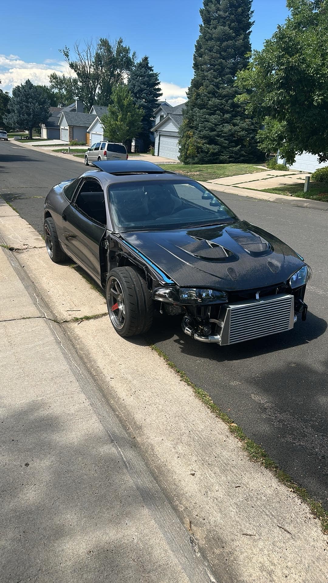

Been a little quiet with the updates but here is what’s going on with the build. I am still really really pushing to paint the car before shootout but it’s not looking good. Running out of days LOL. But finally got the car driving and now tuning. Had some hiccups during the first start ups that were of course installer error. But nothing major and now the car is starting WOT tuning.

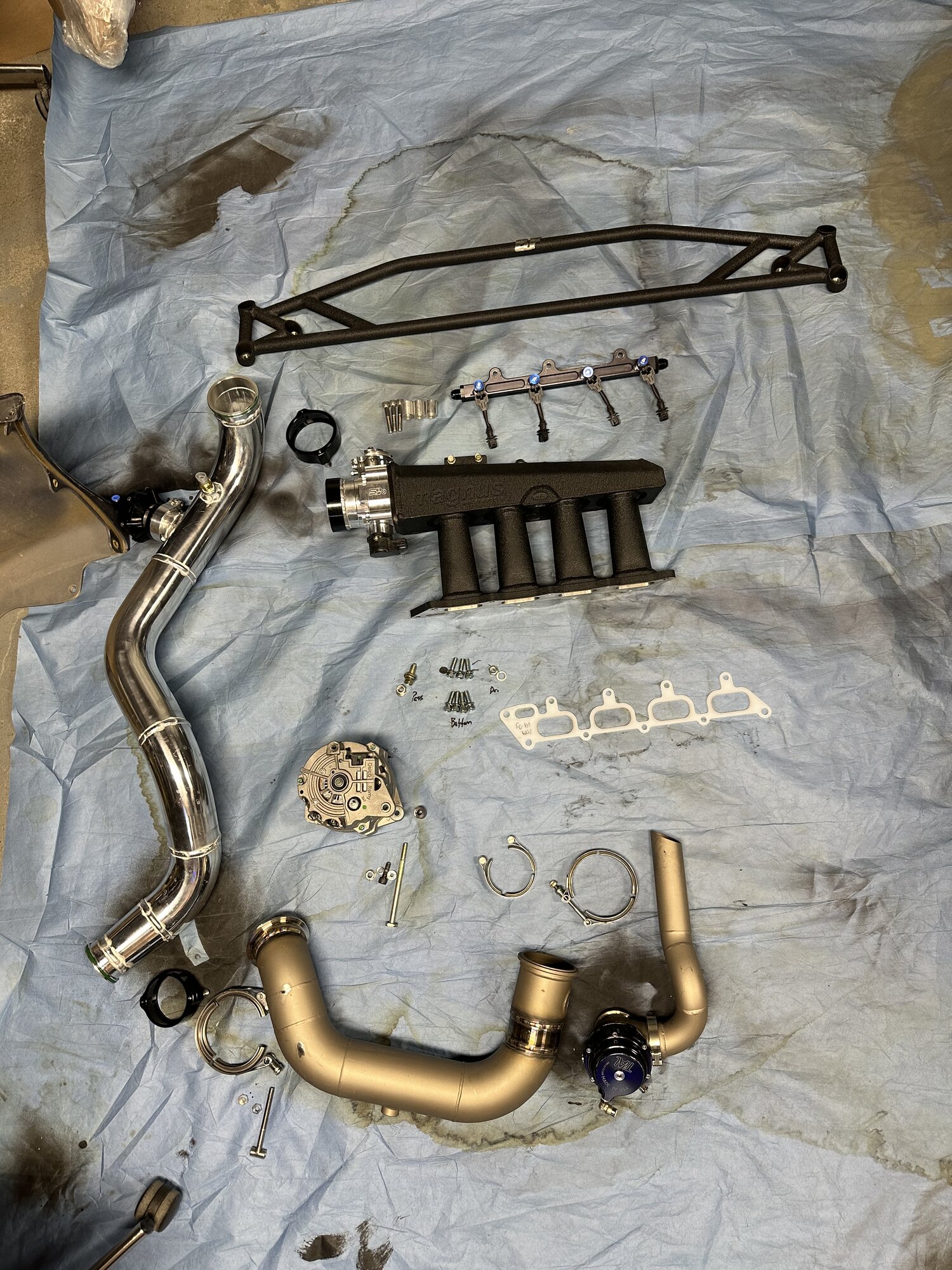

Ended up having vacuum leaks and a dead “new” alternator so the entire intake/injector rail has to come out to get another alternator in.
THEN, during the first test drive the freaking rear DSS axles were popping in and out, so ripped them out and built a set of oem with Evo inner cup axles.
Next WOT pull and no axles issues or clutch issues. Here she is looking all sexy without some clothes on.
And yes, she will be lowered LOL, not looking like an SUV sitting there. But since I’m going in and out of my humped driveway a lot, she is raised up to avoid any unfortunate scrapes.

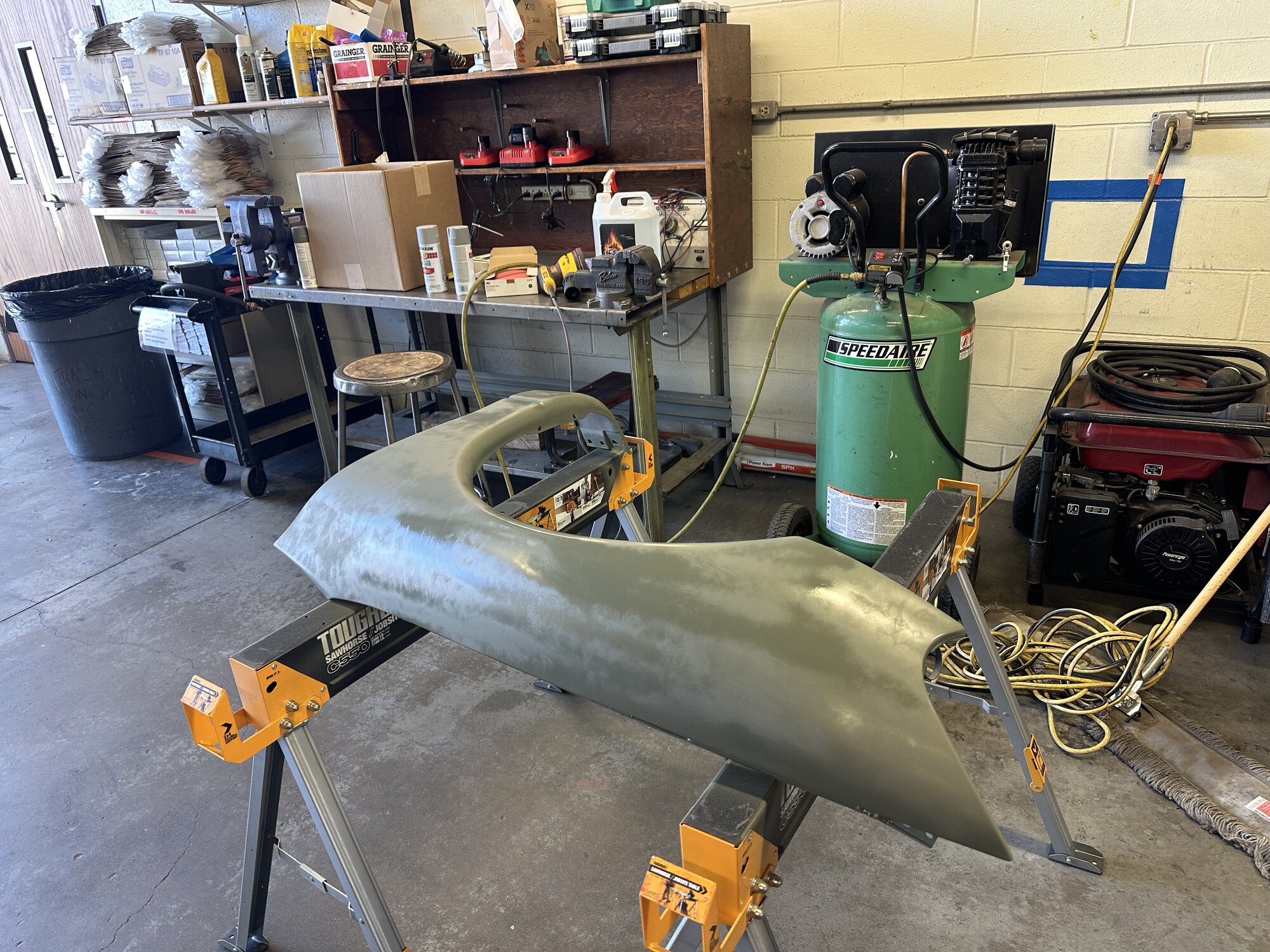

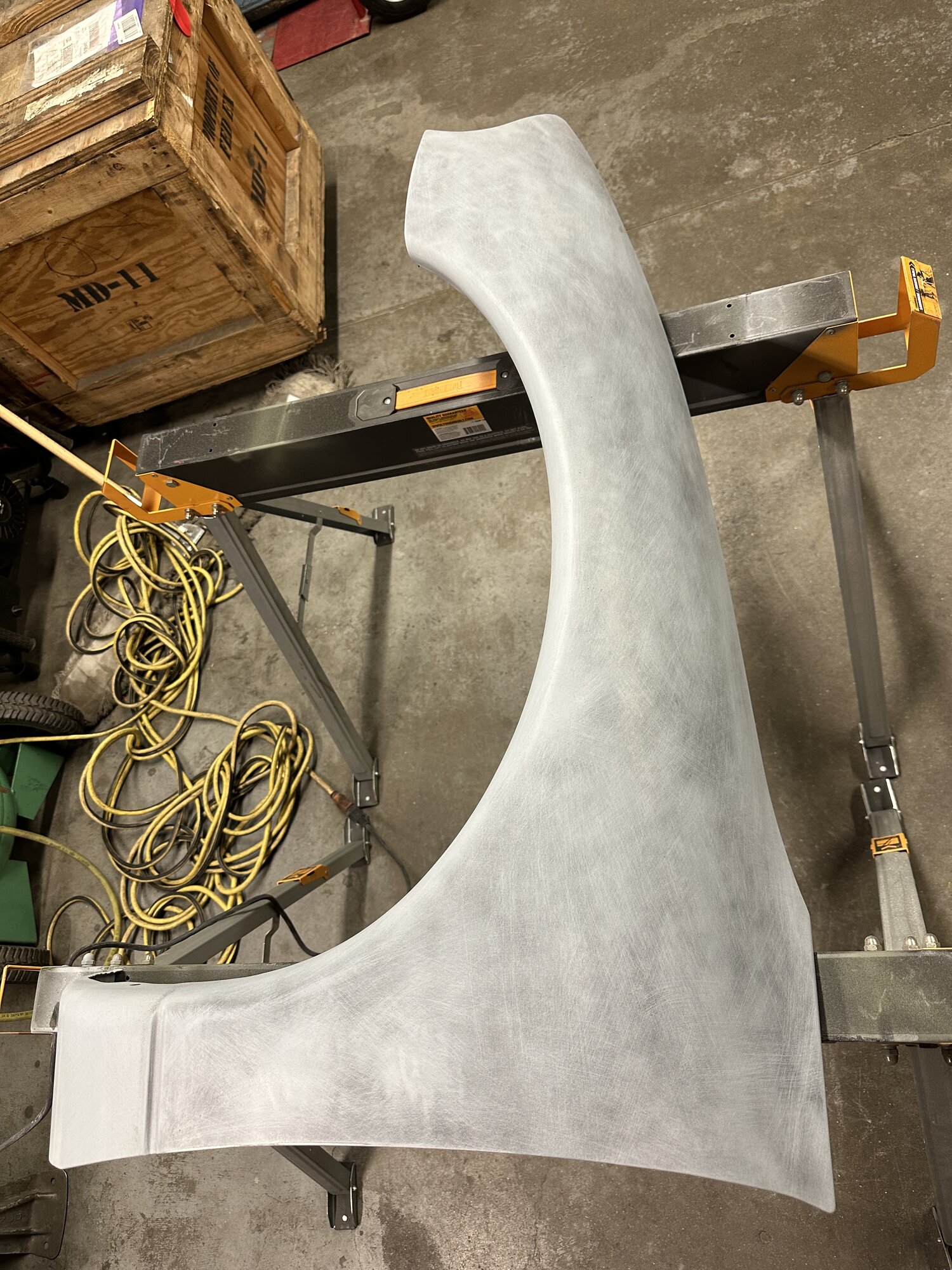

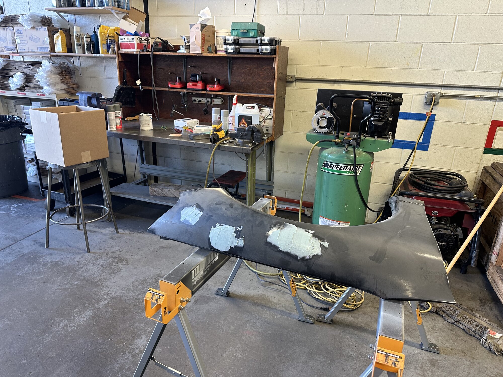

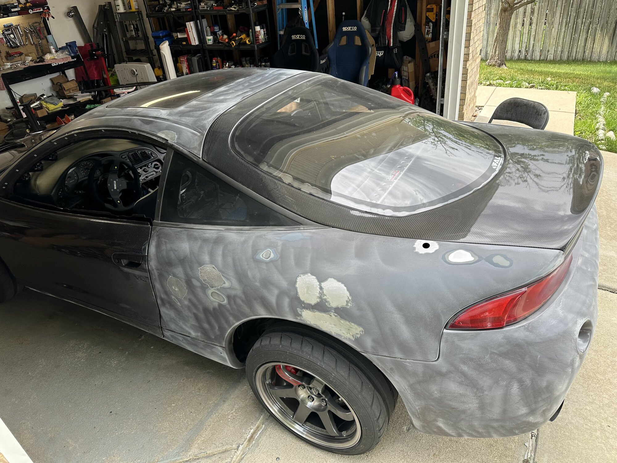

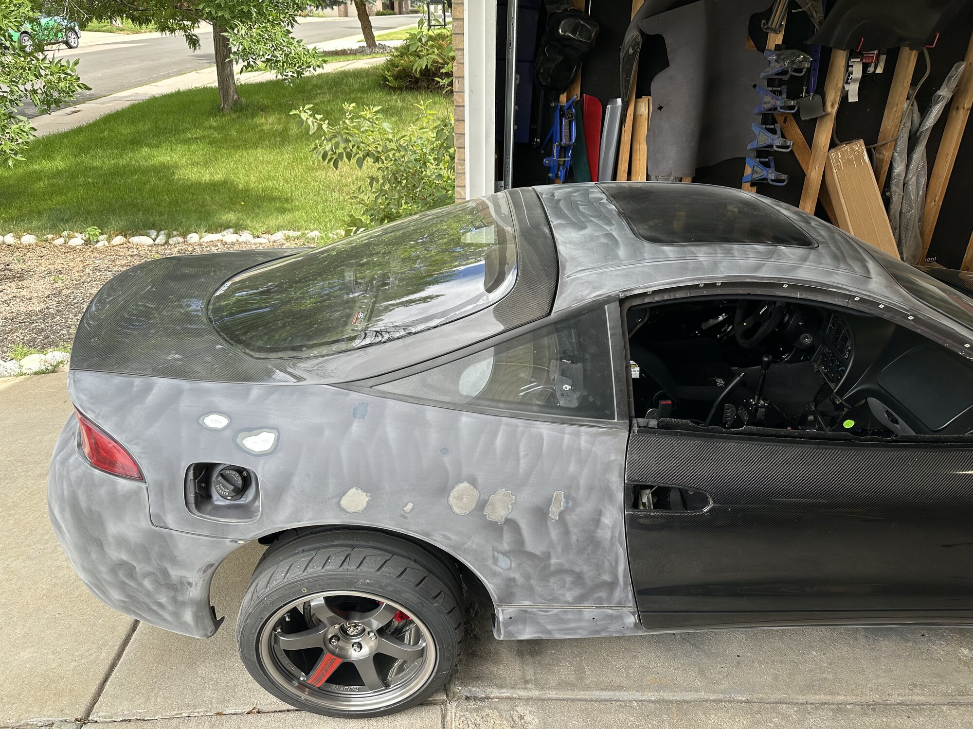

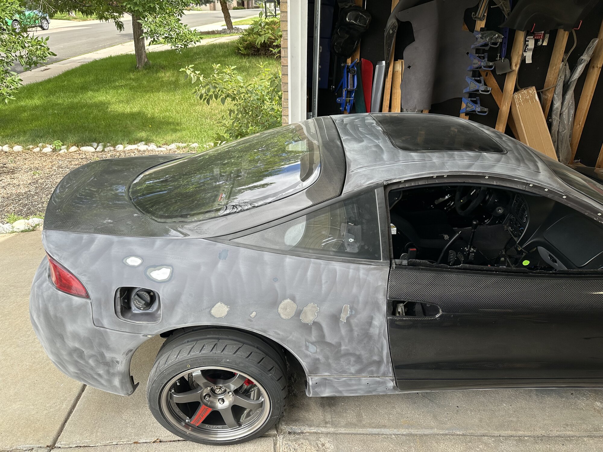

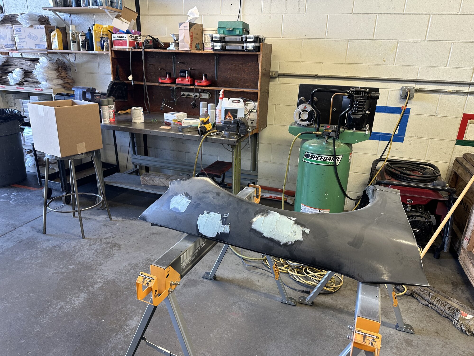

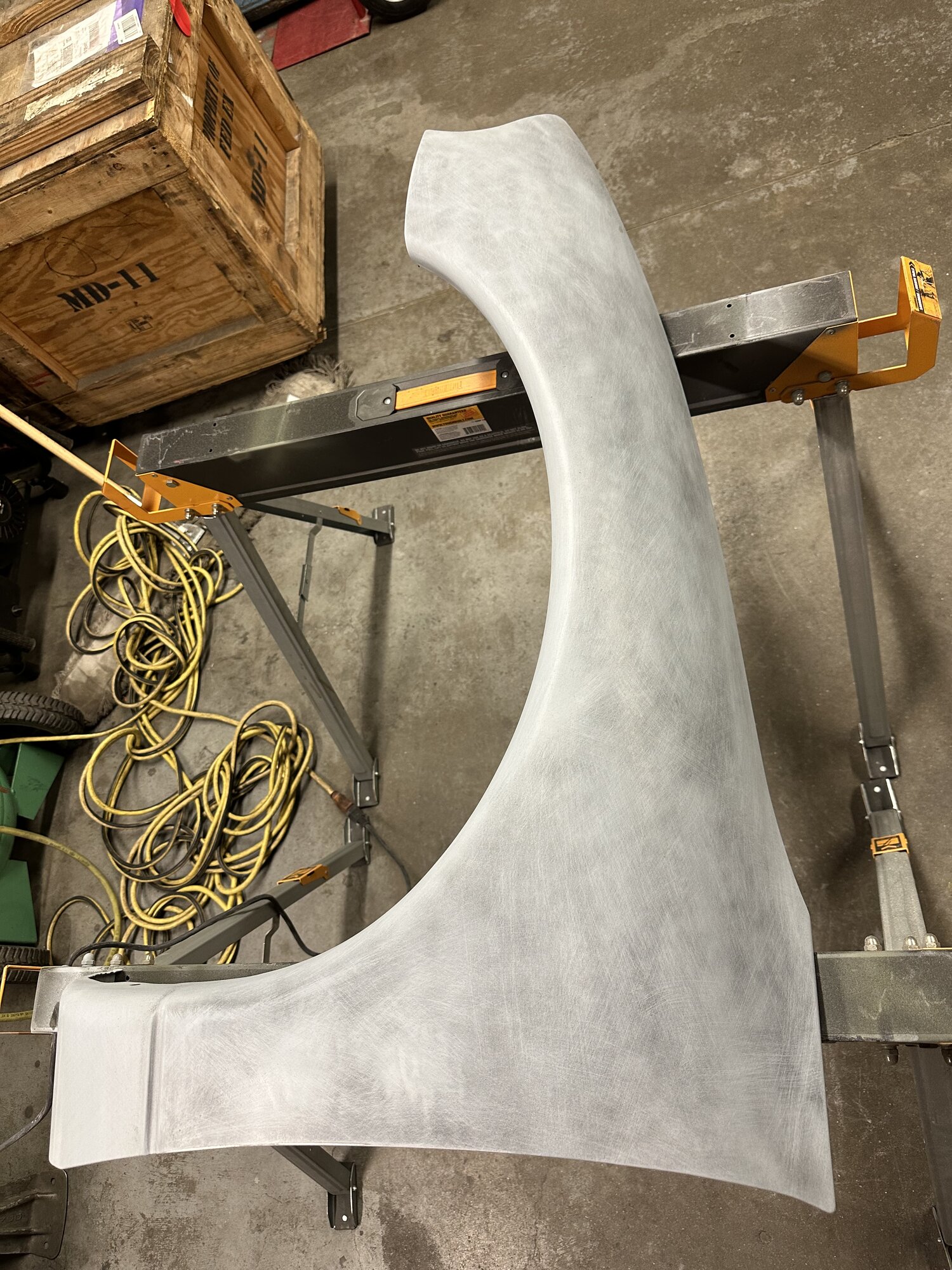

So against all better judgement I decided to start the body work three weeks before shootout LOL. BUT, tuning is 90% done on pump gas.. still have to swap to e85 but pump will work for now. Here are some body work pics, and god bless all the professional body work guys out there. I hate it and it’s sooooooo time consuming to get perfect.
Have an apt to get the front windshield and quarter glass next week. Fought the final two seams I had not stripped and new seam sealer installed.
Doors are next! Then front bumper since I’m still fitting it to the huge front mount. More to come soon.

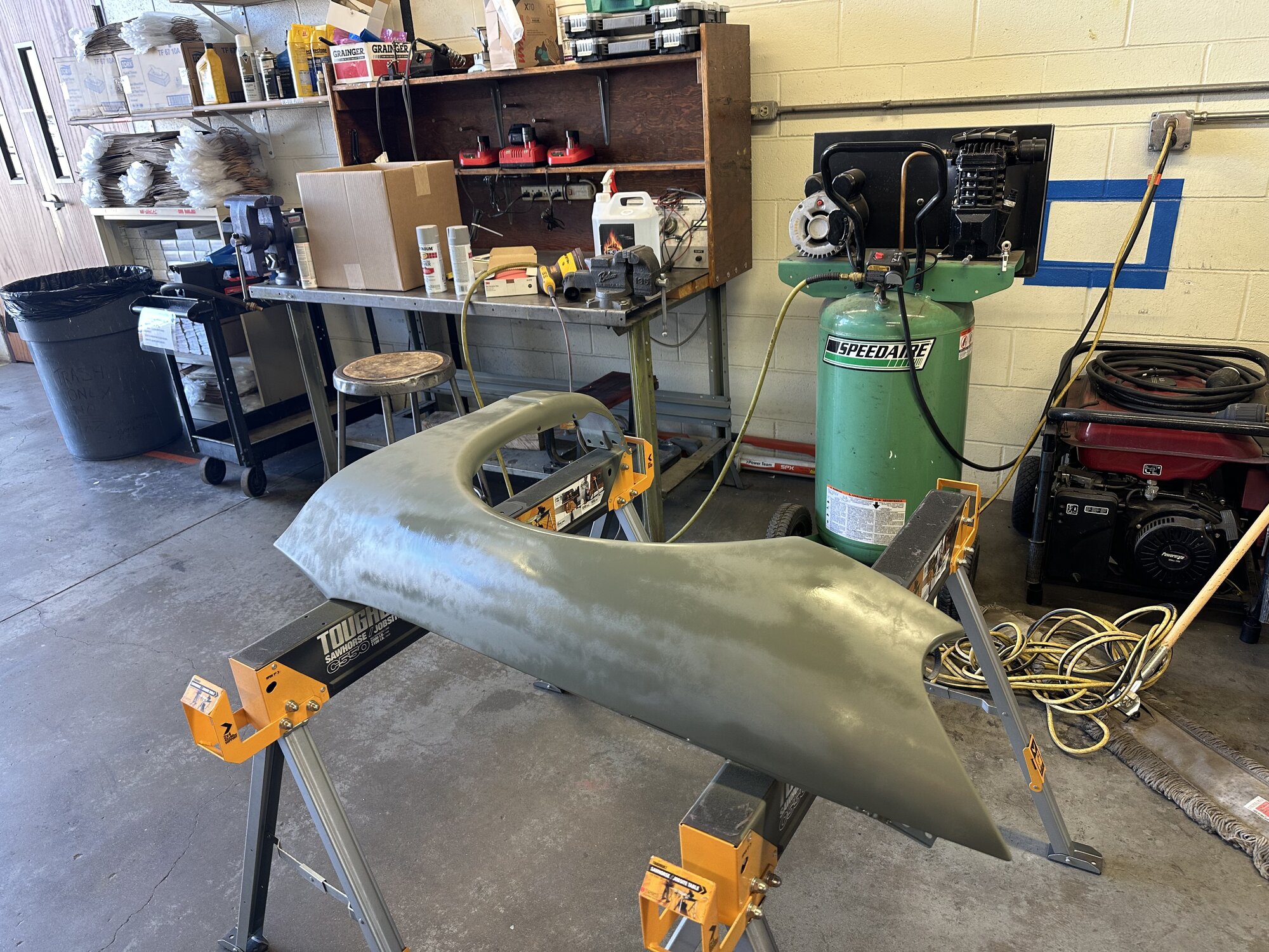

So far it is on track to be completed, but we will see LOL. Thankfully it does not need a ton of work, just some spots here and there. Have to get it sexy so that tuners sticker looks even better on it haha!
