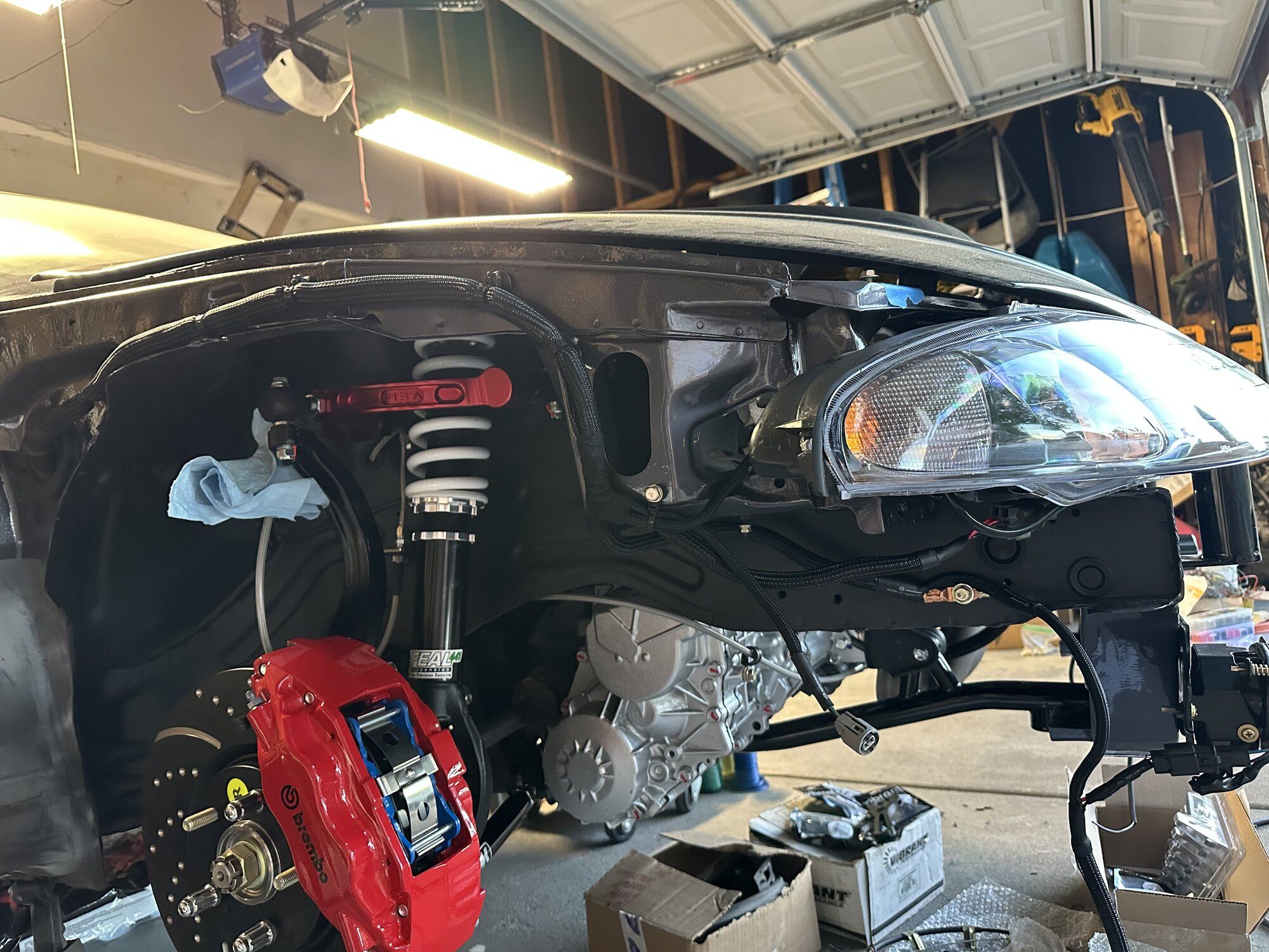

Well, all the wiring down the sides is finally done! Have to wait on the fans, radiator is currently being fabed up right now. Besides that it’s all buttoned up. Only things that run down that side are on each respective side. No cross over under the rad support or things that are not in my build. Also made new grounds for everything to help share the load and provide better points throughout the chassis.

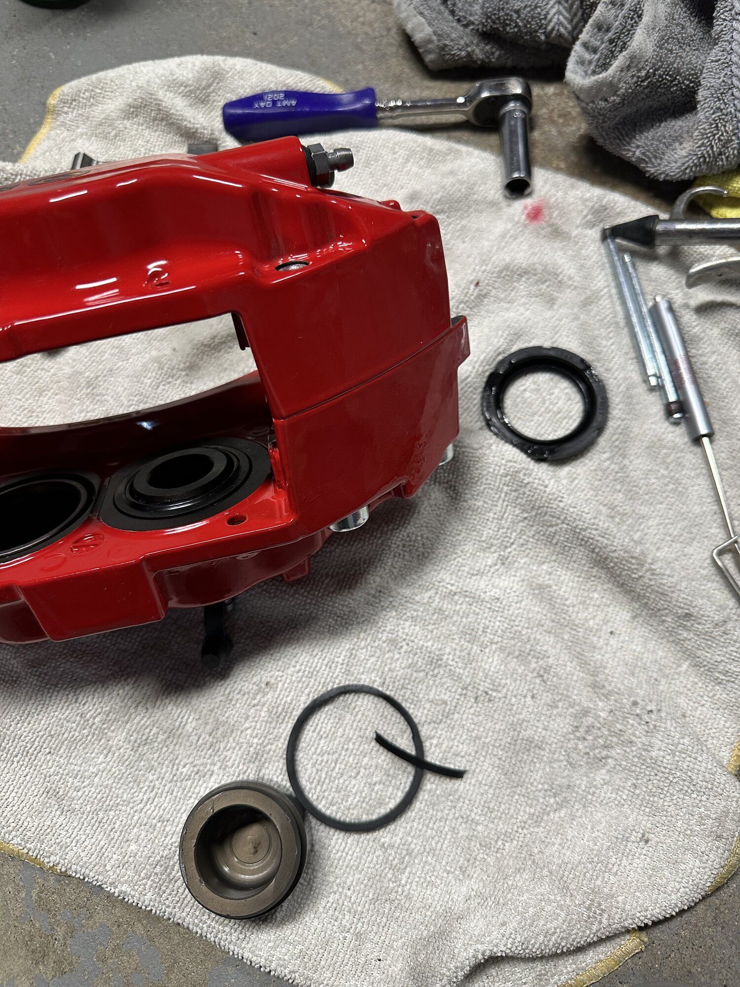

Had a blow out bleeding the brakes but got it replaced with spares and just waiting on crush washers.

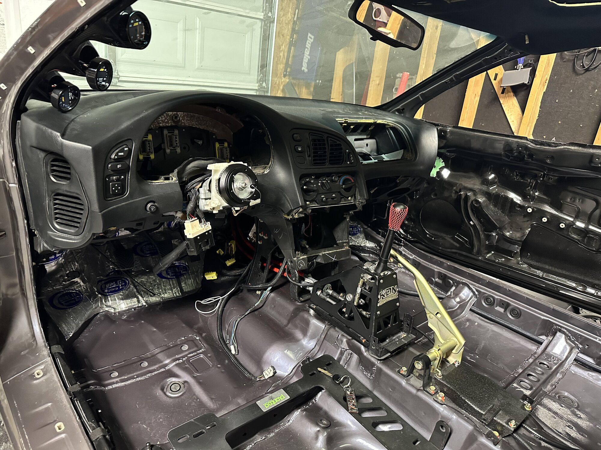

Dash is ready to go in soon!

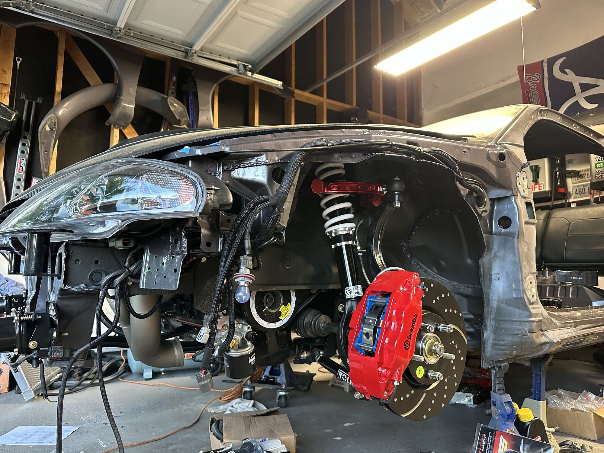

Hey what kind of brakes are those I've been wanting to upgrade the ones that I have on here on mine from stock to something larger for better braking power I've noticed that the stocks are underpowered.

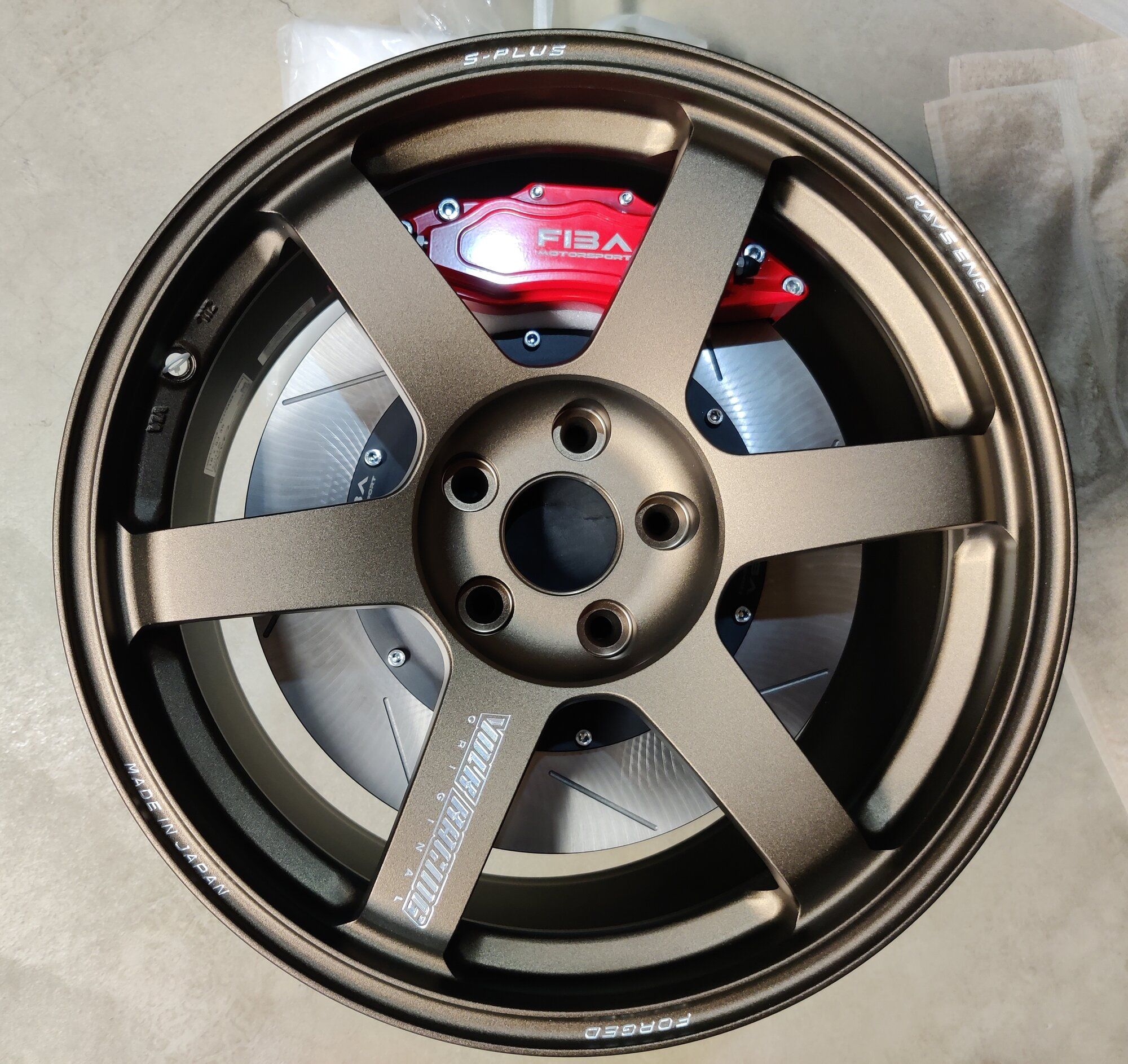

I did the Evo 8/9 Brembo brakes all the way around. The front ones I used the bracket adapter which entails filing down the knuckle and the calipers too. If and when I do it over again I will NOT be going this route however. I would just get the hyundai knuckles and they mount directly to them. I have used the Wilwoods in the past and loved those, but they are pricey as well. Like @92Turbski stated, there are other upgrades like the oulander, mustang, ctsv and even the 3000gt brakes that are better than the oem gsx brakes. Just have to decide what works best for you. Hope this helps!

Oh I def know all about Bobbys stuff. Budget was not really a concern, but the fact I already had all the parts/powder coating done on these and honestly, just kinda wanted to see how it went was the deciding factor. Already in talks with a set-up through FIBA next season though and many other huge changes as well, that is IF I do not sell the car first hahaha.

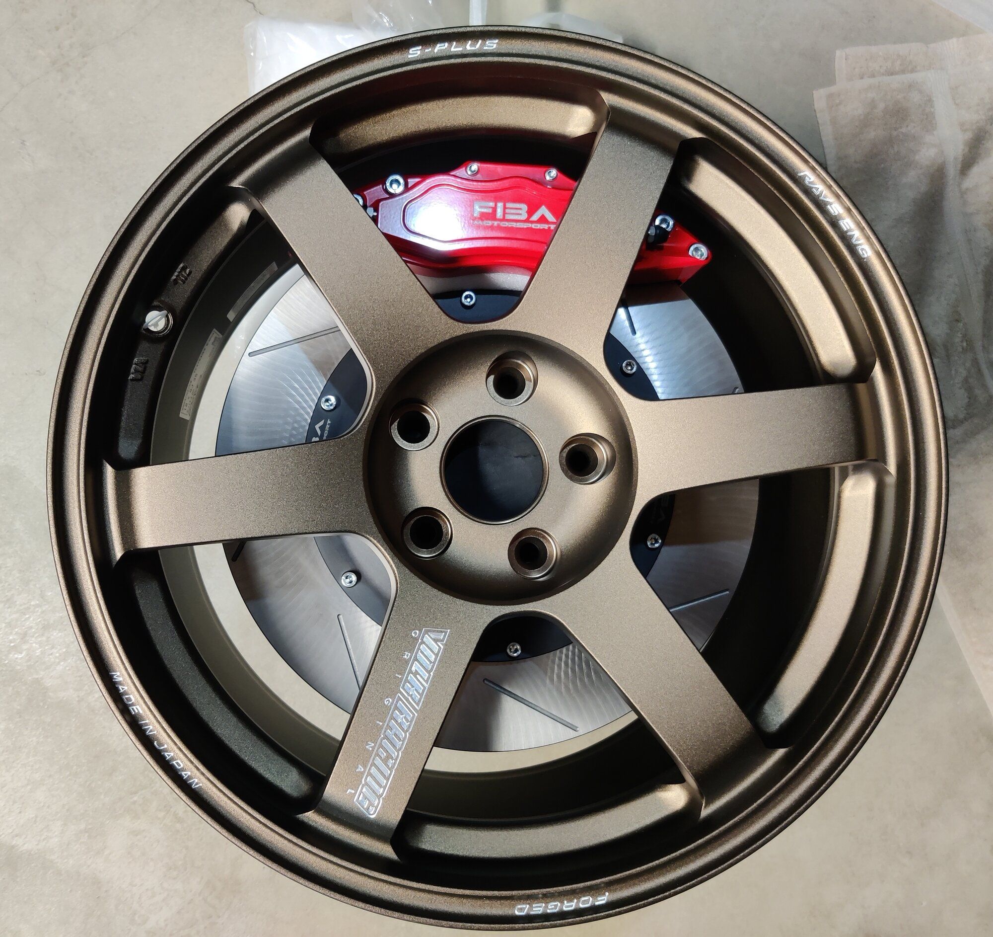

but the GSX twin piston is the most basic and miles better then a single piston swap. I did this to my friends 1G AWD as its was pre twin piston as standard and he loves it but is not a racer or pushes it hard, he can notice a difference though. had he not on kept it stock which is always the plan he would of gone bigger to my kit but our aim is to always keep his car stock forever! even when I get it the chassis will remain stock!
Thanks for the tags and pictures of the brakes you lot. glad you all like them and happy to help anyone else seeing this should they need anything from me. So just reach out as I am always around

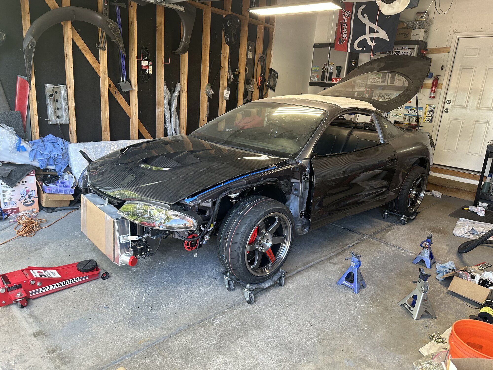

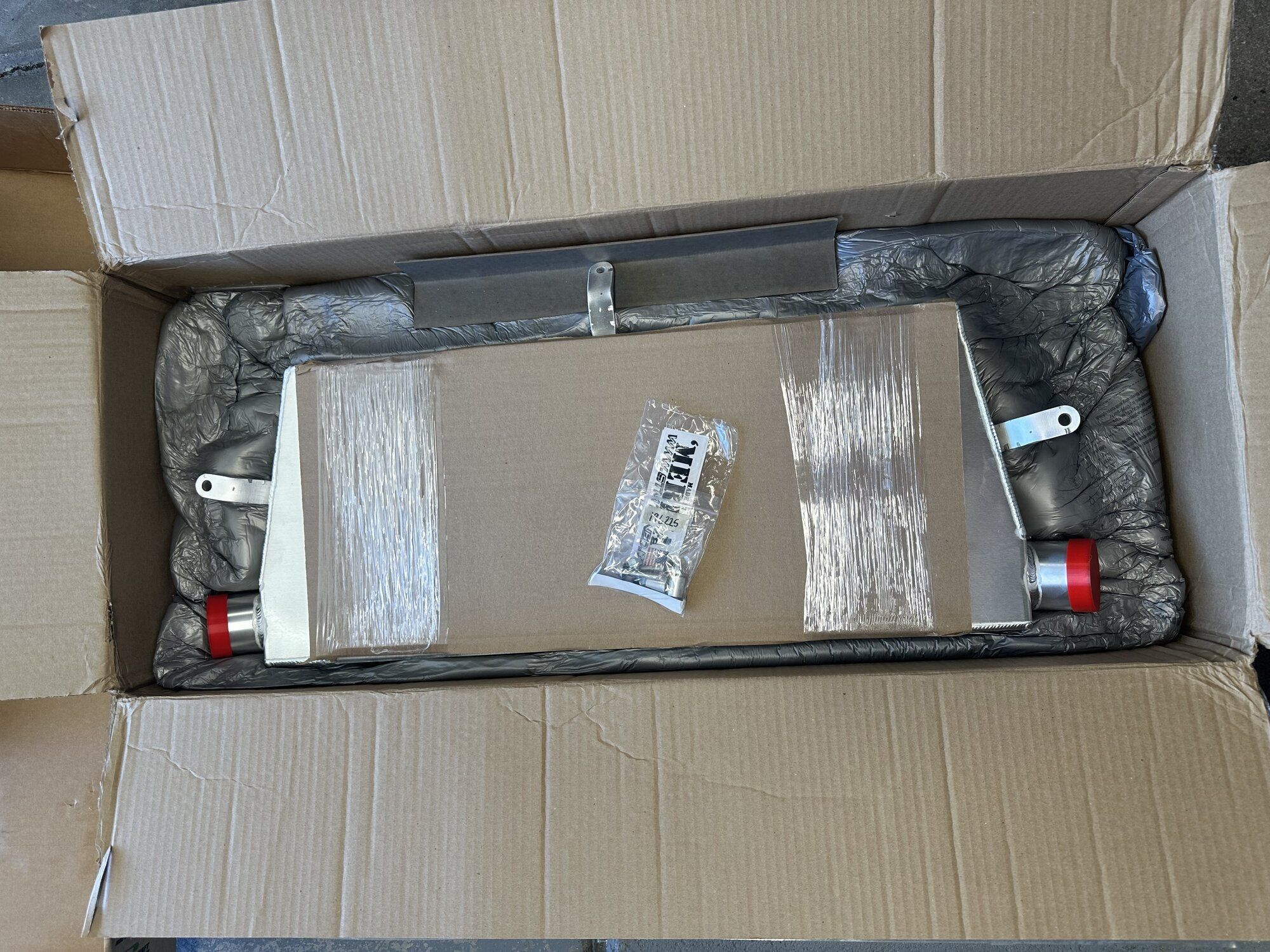

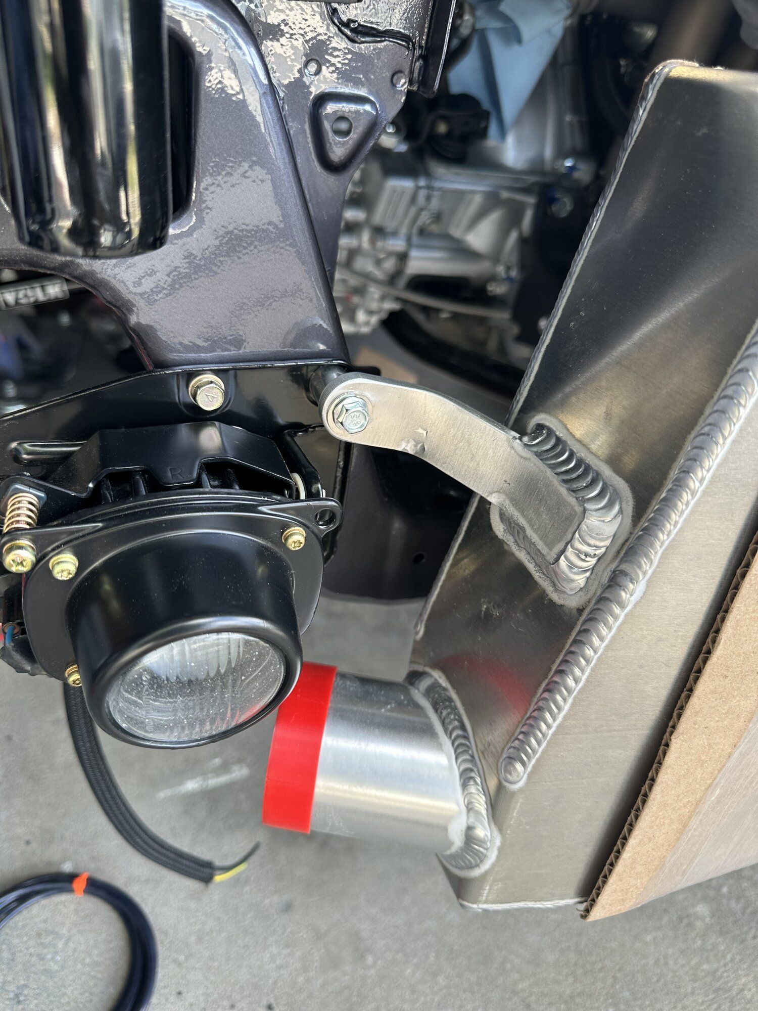

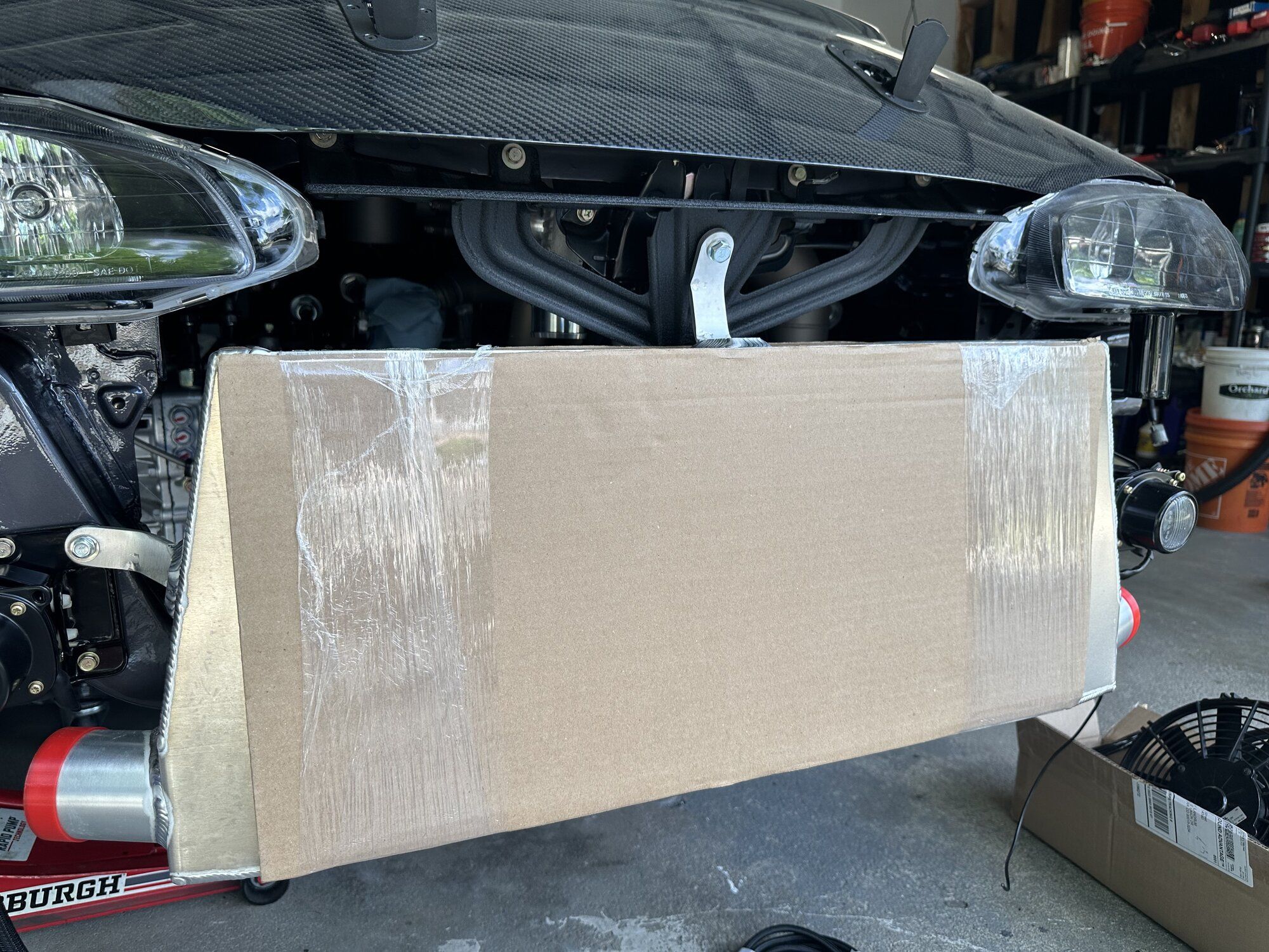

So the stm tuned intercooler and dss 850hp axles finally got here. Intercooler was a piece of cake and installed no problem.. axles.. not so much.

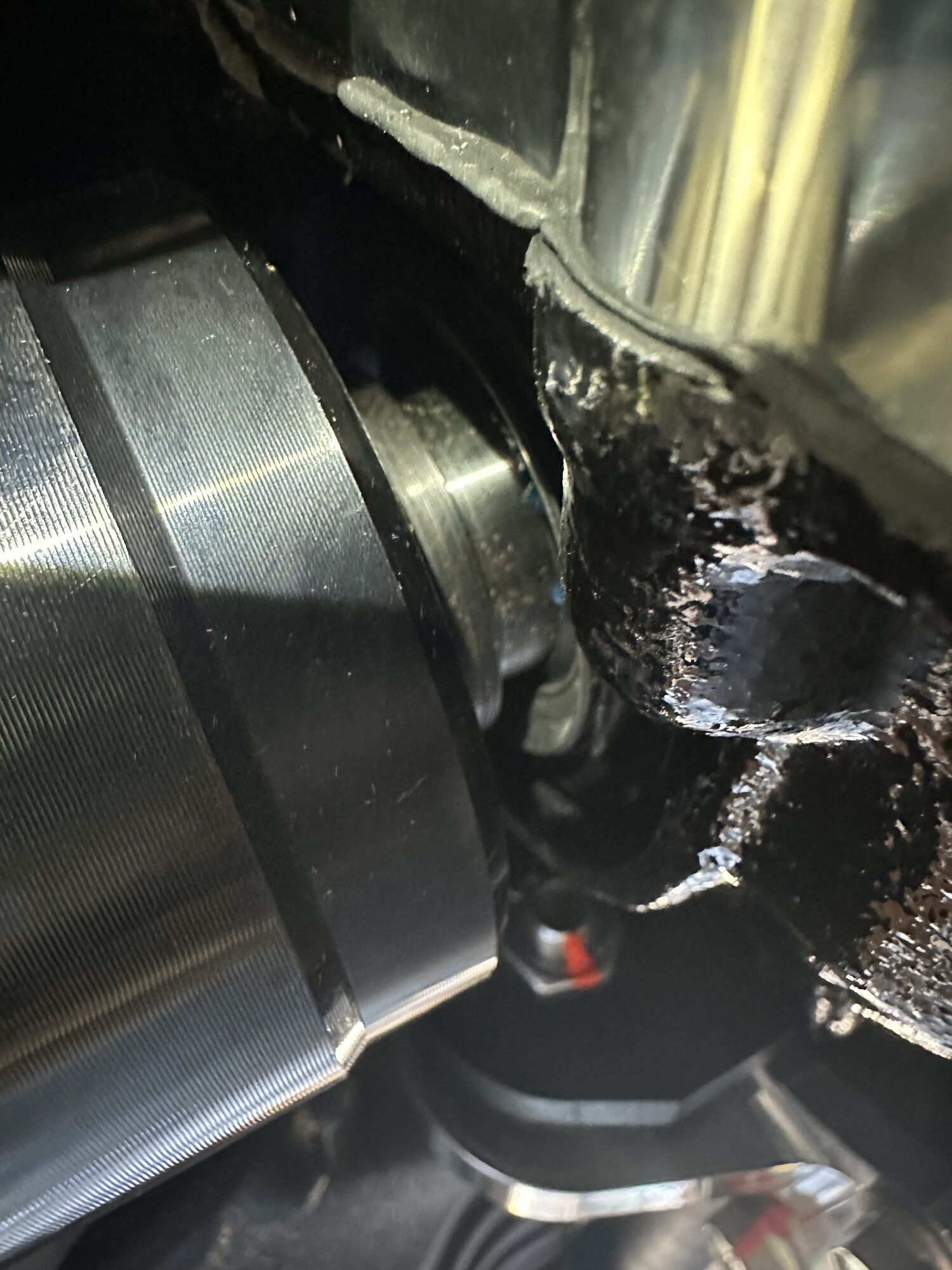

So for the axles, at first I thought everything was fine until I realized I could pull them almost all the way back out by hand. They would not seat and the c-clip would not “click” in. After partnering with Tim Zimmer I decided to pull them and measure against the oem Evo 8/9 inner cups. Turns out the total length was right on but the distance from the inner tip to the c-clip was 3mm too long. This kept the axles from fully seating into the Evo 8/9 diff. Machined it down and then they clipped right in. Gotta love paying over $1k for something and it not be machined correct. Anyway, they are in and once the tires come in it’s finally off jack stands!

Alright HUGE updates. Got the dash in finally and also 98% of the wiring is finished.

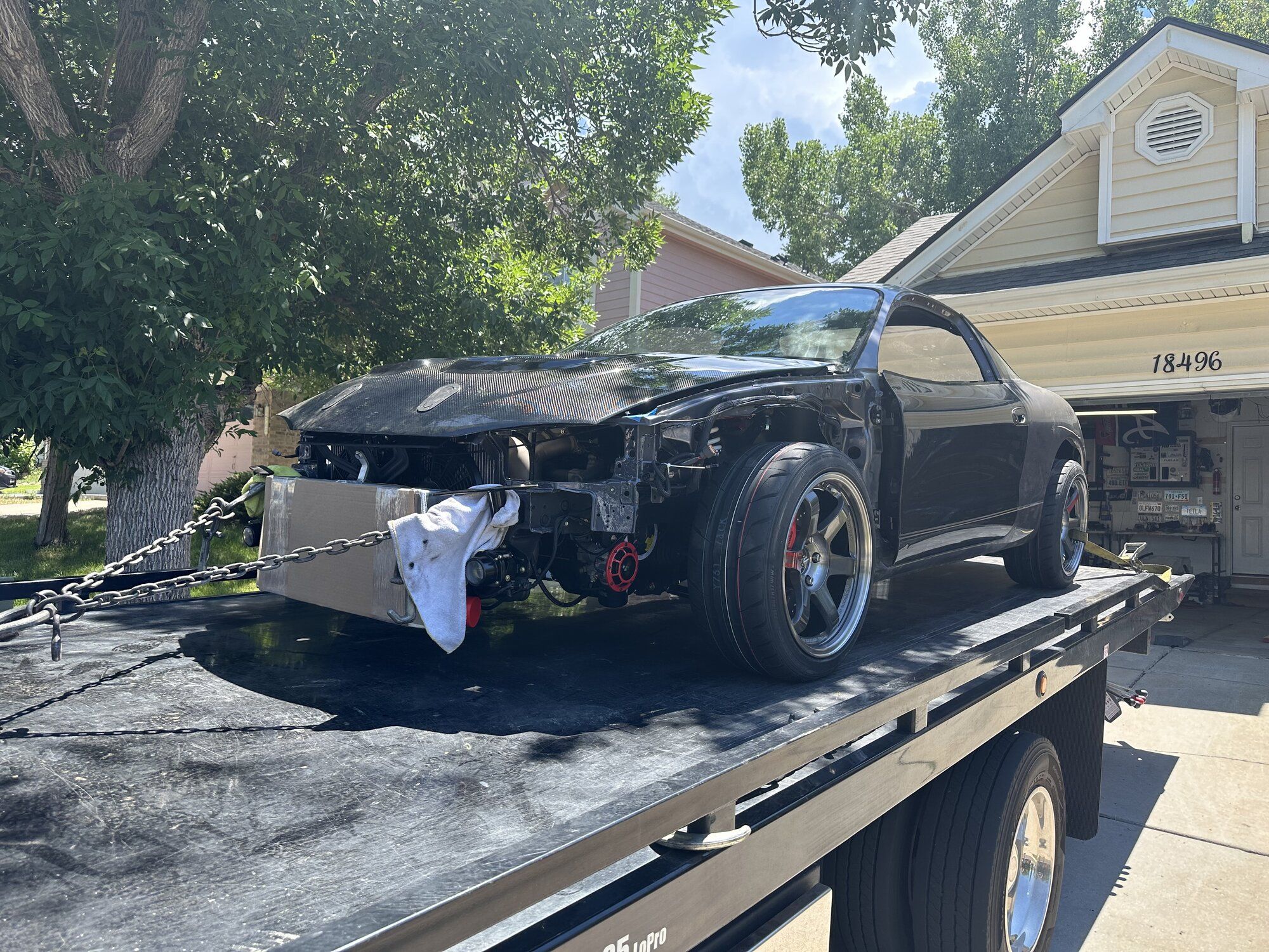

Still having issues with the rear dss axles but for now the car is off the jack stands and headed to the fabricator @CCdesign for intercooler piping and exhaust.
Here she is loaded up and ready to go.. been two years since she has been out of the garage hahaha.
