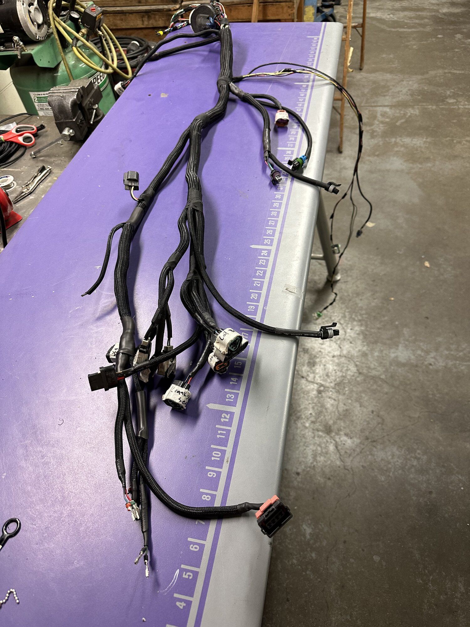

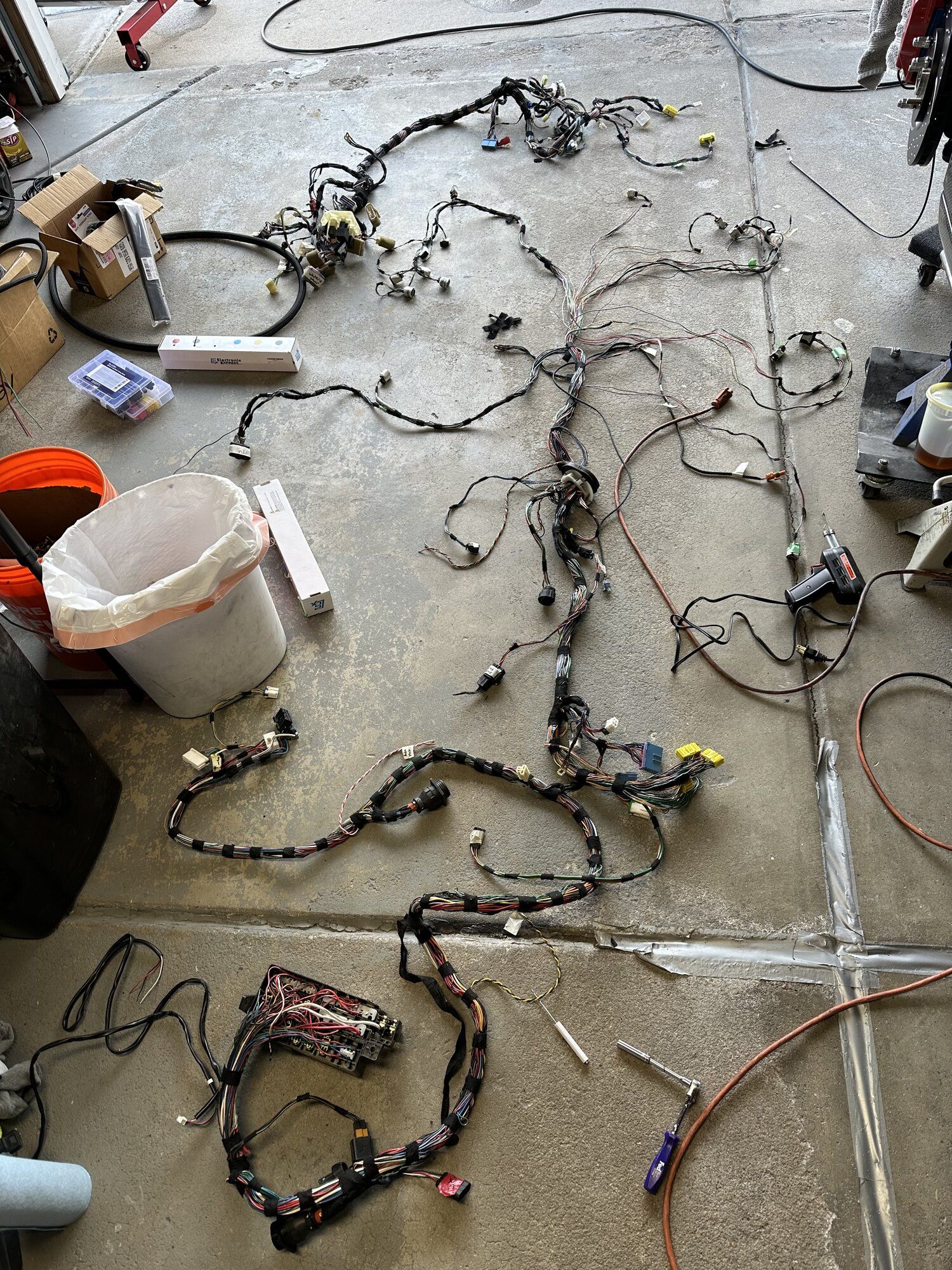

Made more progress with the engine bay harness. Takes a lot of work to get everything to correct length and location. Put it in the car, measure one thing, take it out… alter, put it in the car… rinse and repeat. But almost done and can loom everything maybe next week. Added the Hobbs switch and aem boost gauge to the loom too. Flex fuel sensor, AEM 5bar and SD also spliced in from ecutuning harness.
These are two separate harnesses btw.

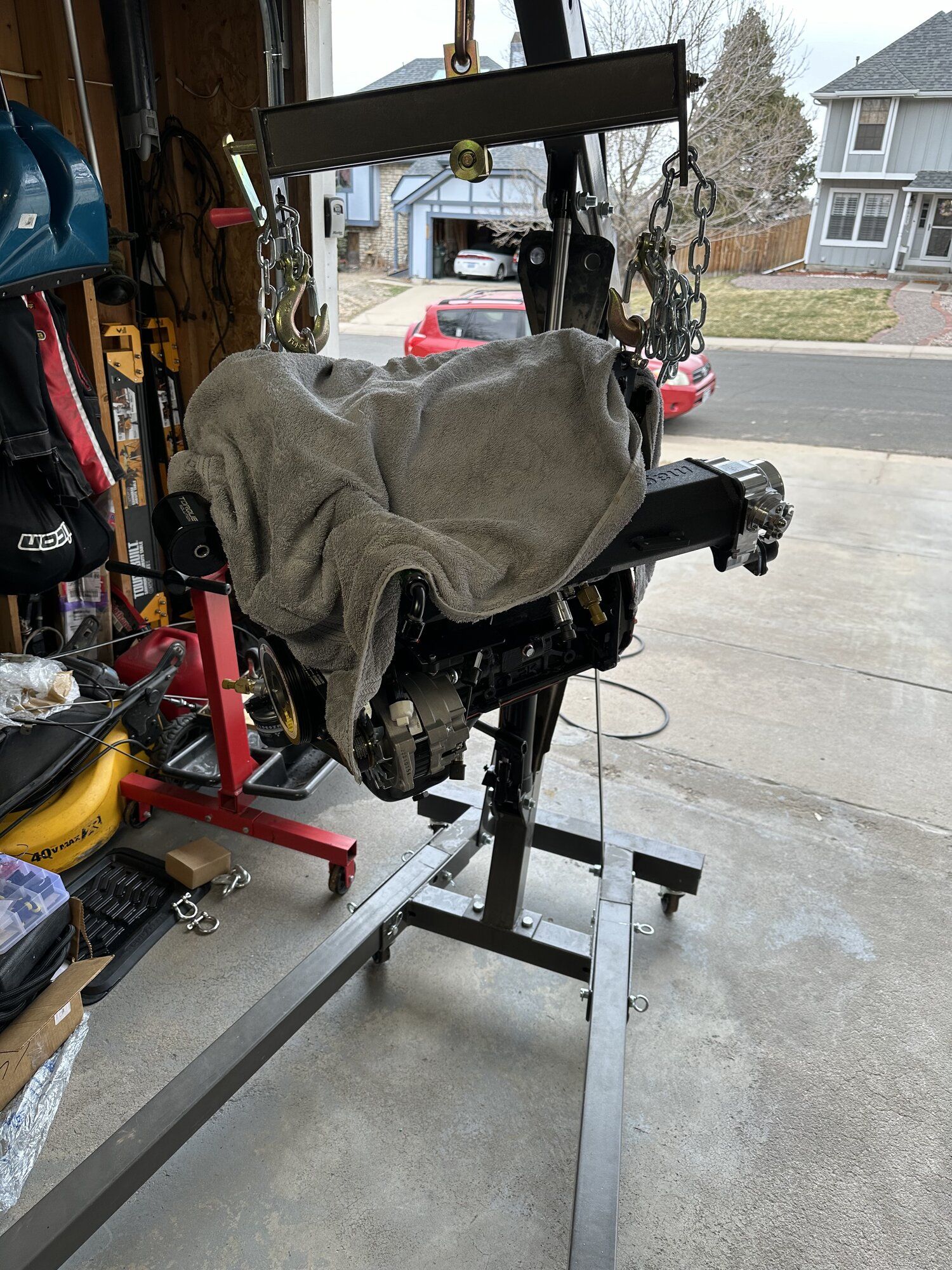

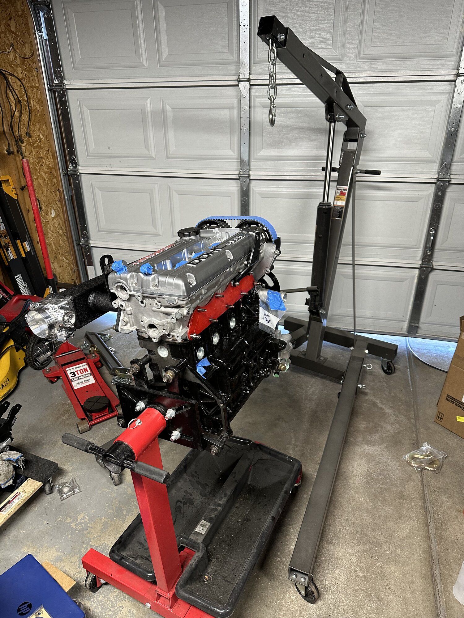

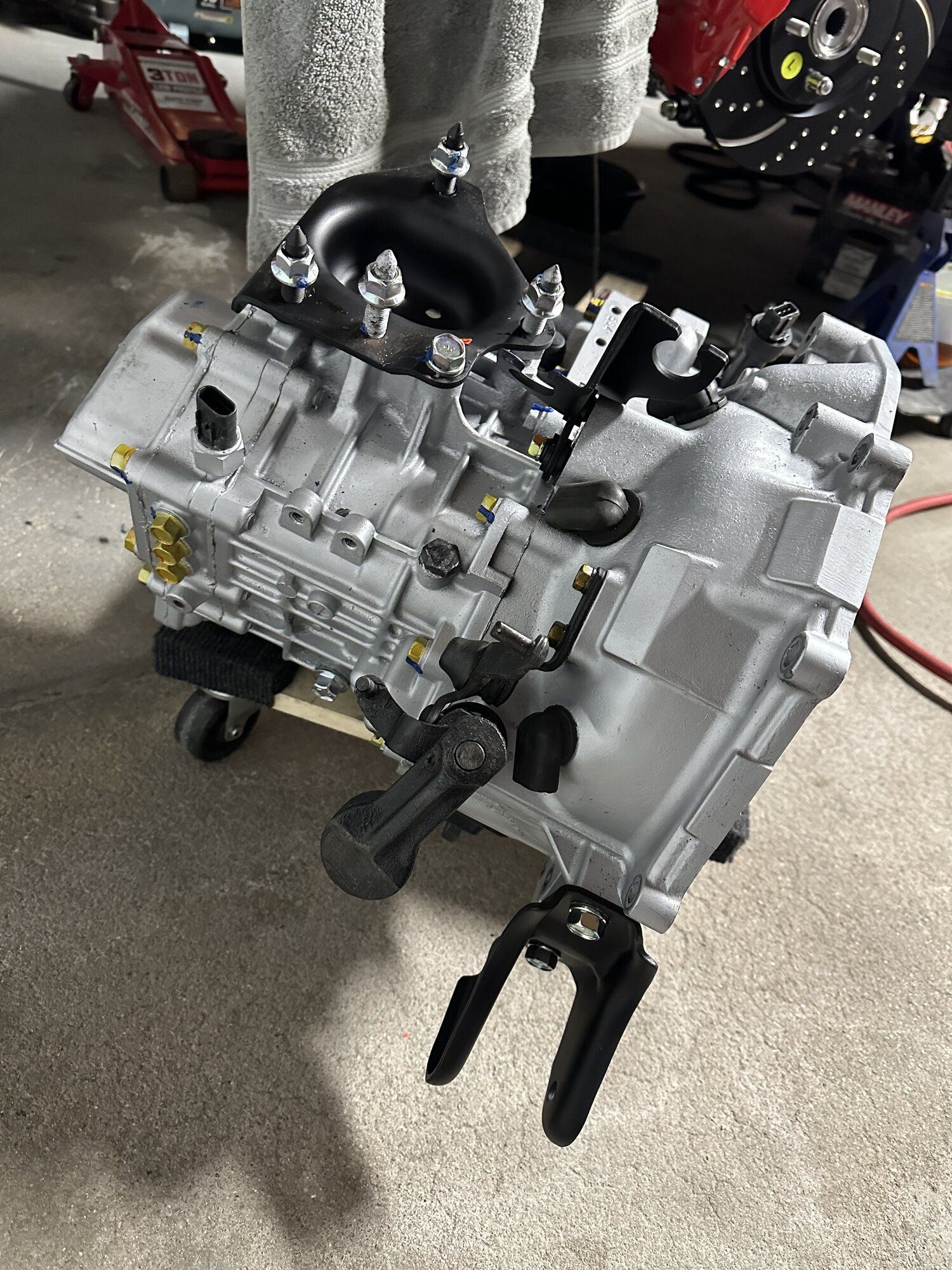

Well, finally getting around to installing the engine and trans. Scooped up a 0mile shep built trans from back in the day that has sat on a shelf in the original bag for years and years. Got everything mounted on it and ready to get everything hung hopefully Sunday. More to come..

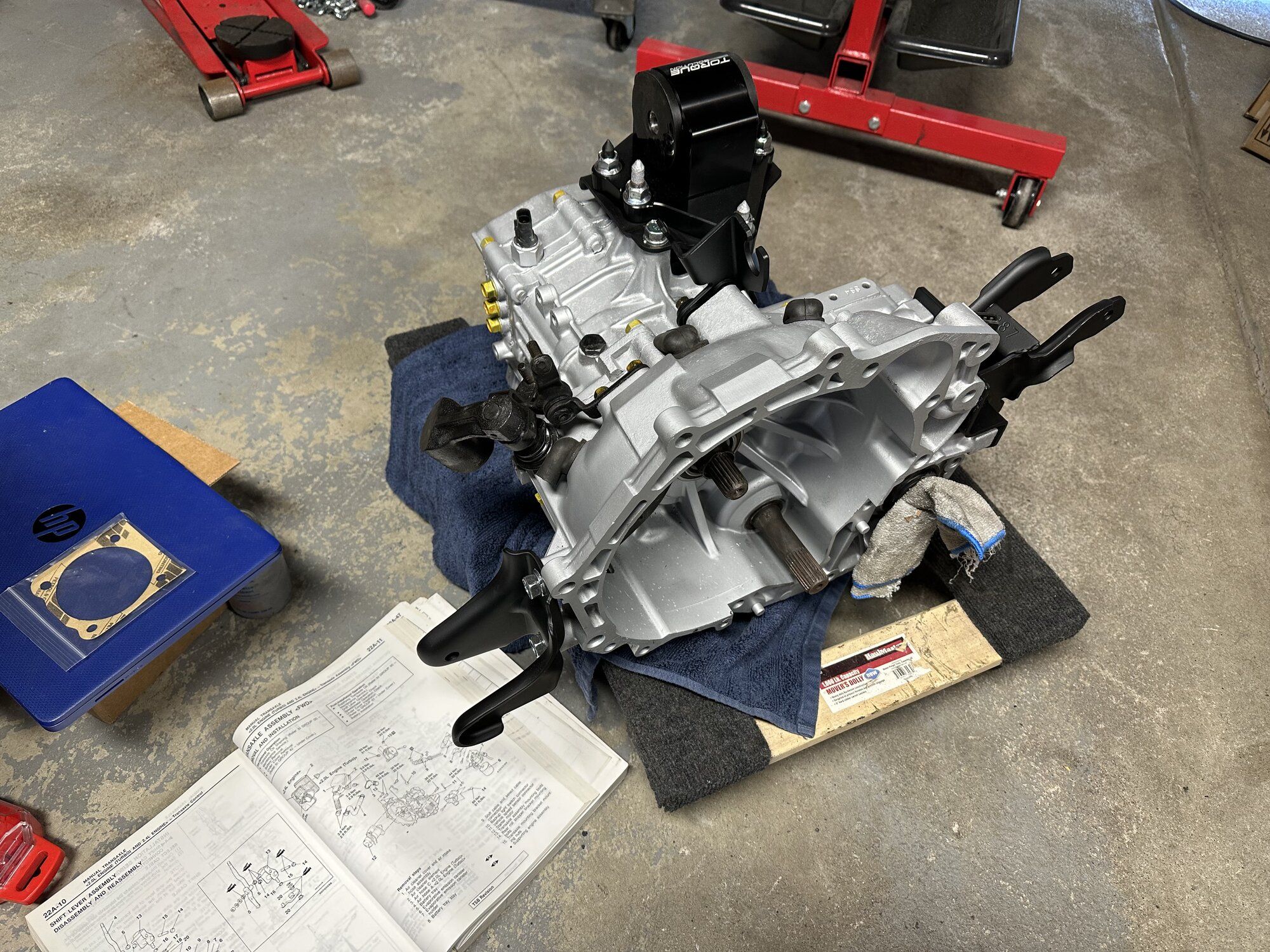

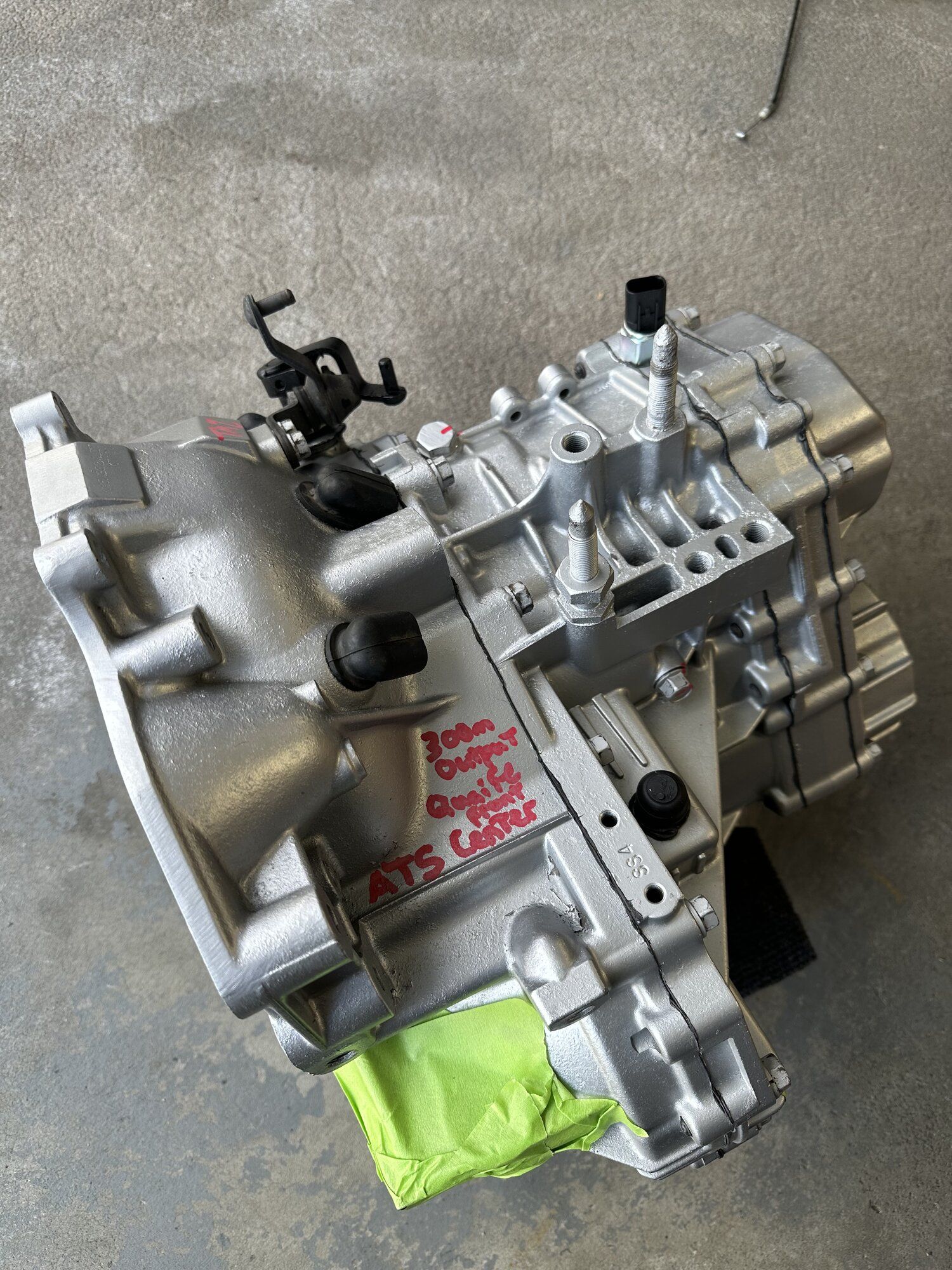

Turns out it was AMAZING news. It truly is a built trans and even has the ultra rare Kaaz center clutch type diff. Evo3 rails and gears and tons of other goodies. I did go ahead and get a Quaife front diff installed as well as the boosting 300m output shaft too. So now I should have full lock up and amazing rear power too. Rob really came through with the trans and so did Tim with the build. So freaking happy.

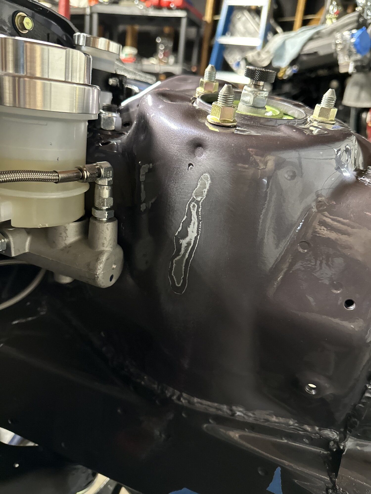

Had to pull the motor again to fix a scratch we made hanging the engine. Way easier to pull second time around and got the scratch sanded/prepped for paint.

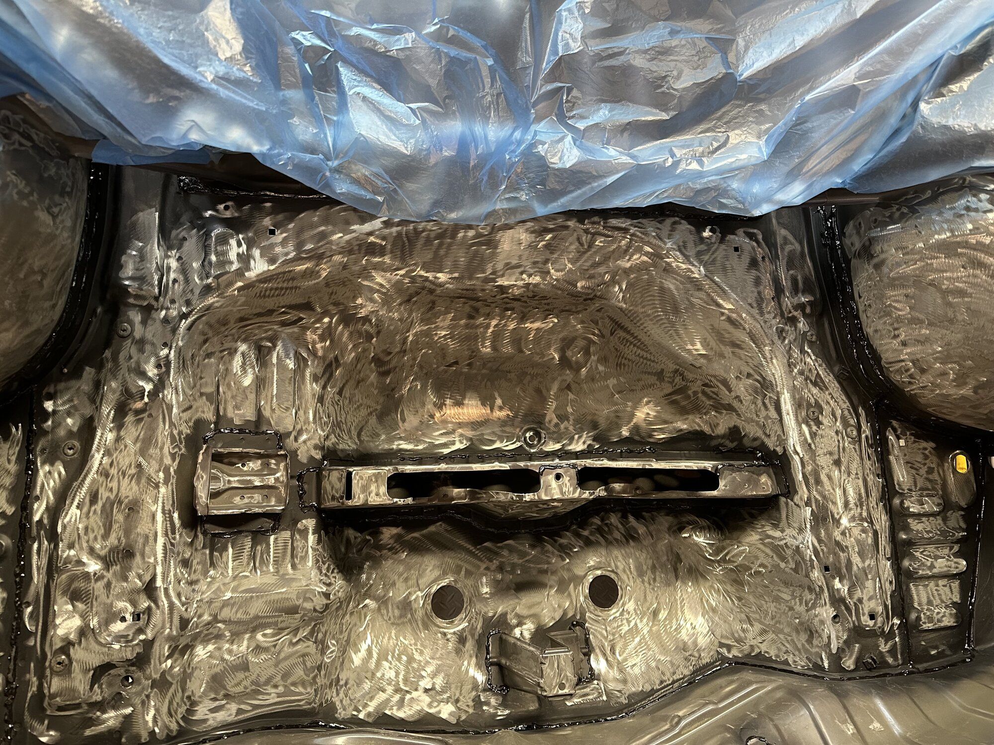

Also FINALLY got the rear sanded down to metal and going to paint at the same time I do the engine bay scratch..

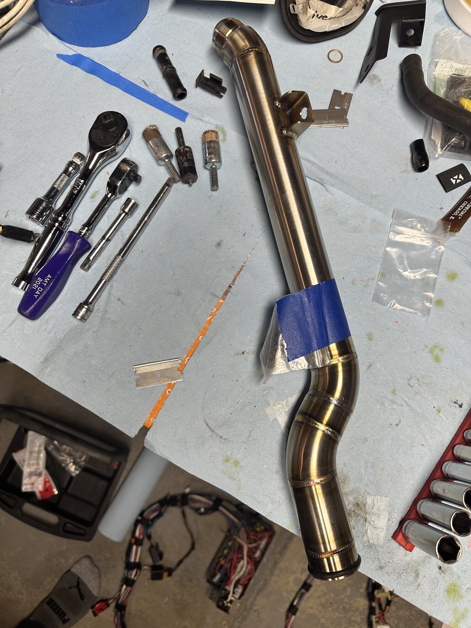

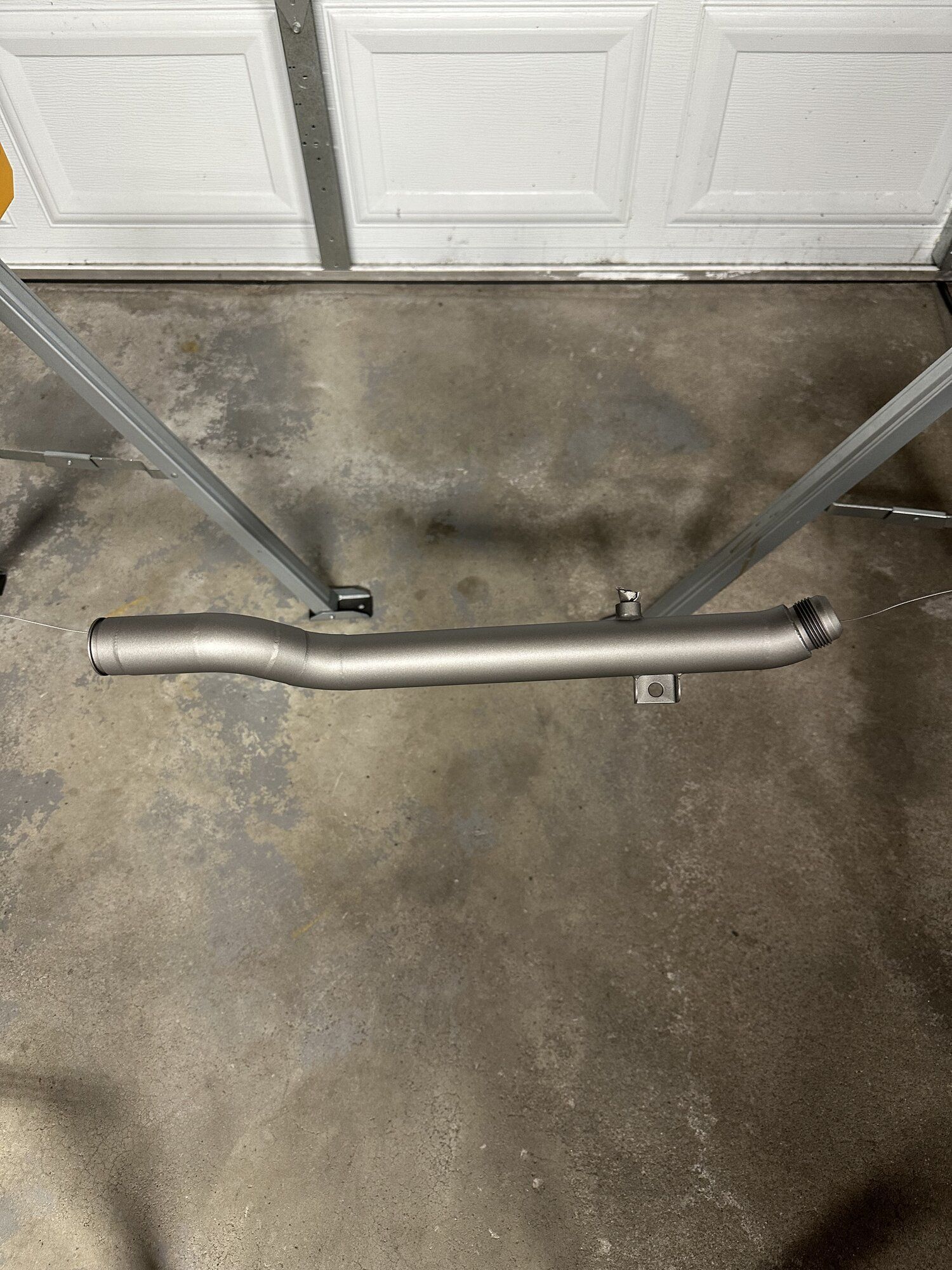

Now for the really good update. Water pipe and thermo housing finally arrived from Raven Fab and got the water pipe cerakoted

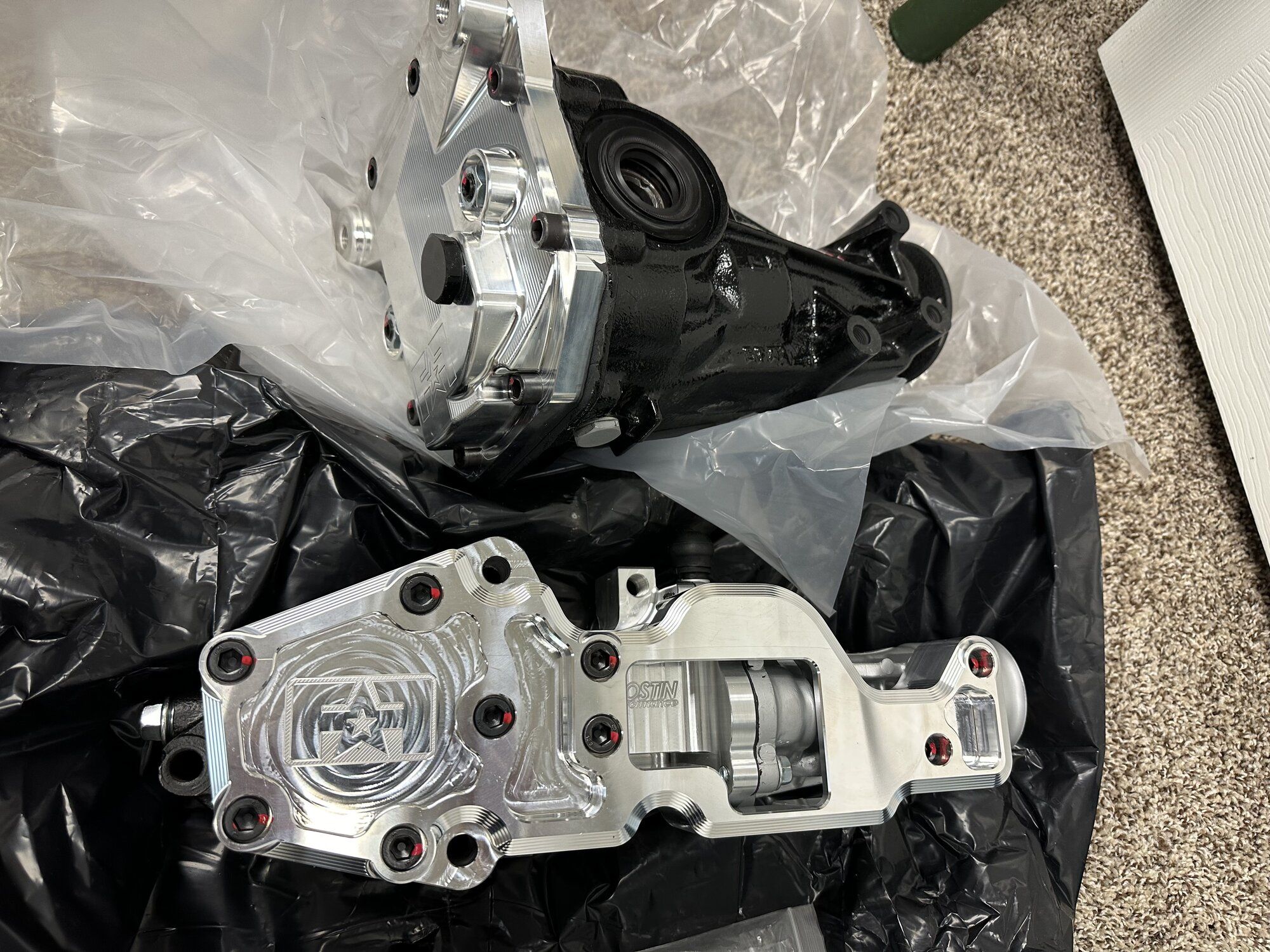

Also, Tim came through with the rest of the drivetrain too and finally got the xfer case built. Gears took 9 months from liberty gears to finish. But can’t freaking wait to run these. Rear diff is Evo 8/9 lsd with upgraded weir clutch disks and FAB caps with cover.

So its neither. I actually originally sent it to Tim because I was afraid it did have a welded center diff, which is opposite of my build plans. When he got it opened up it turns out the center diff is a super old school Kaaz center diff that is a clutch type. Apparently it is super rare even back in the day. I do have pics of it open I will try to post soon.

Finally got the trans back and it was even more built than I had originally though. Figured while I was at it though might at well throw a 300m shaft and upgraded front lsd. Now it’s as built as it could be internals wise before going dog box. Waiting on dss axles which are being built now and then the entire drivetrain will be ready to go in.
Also finished up the custom harness for the engine bay. Had one connector break while de-pinning so waiting on that from stm. Getting there slowly but surely.

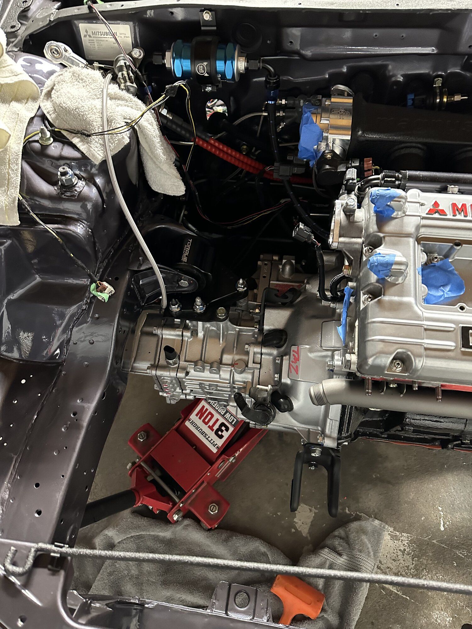

Got some time in the garage today and got the trans mounted back in. Also ran the main tucked wire harness and got everything finalized besides the trans connections. Next will be mounting the xfer case and rear diff!!
For anyone wondering. This turned out to be waaay easier than mounting the engine/trans mated up together. Doing the engine first, then the trans separate was still a pain but easier. I have a few tips and tricks if anyone wants to reach out while reading this.
The fastest pull and replace I ever did was on a lift with a hoist. Raise and lower the car as needed to remove everything in the way until L & R motor mounts are left, then just off ground, hang the engine on the hoist, unbolt the motor mounts, and lower the engine to the floor.
Raise the car away from the motor, mark the spot on the floor, slide or lift the trans/engine combo out of the way, and then execute the reverse using the marks on the floor to position the setup so nothing gets crushed when you bring the car back down over it.
