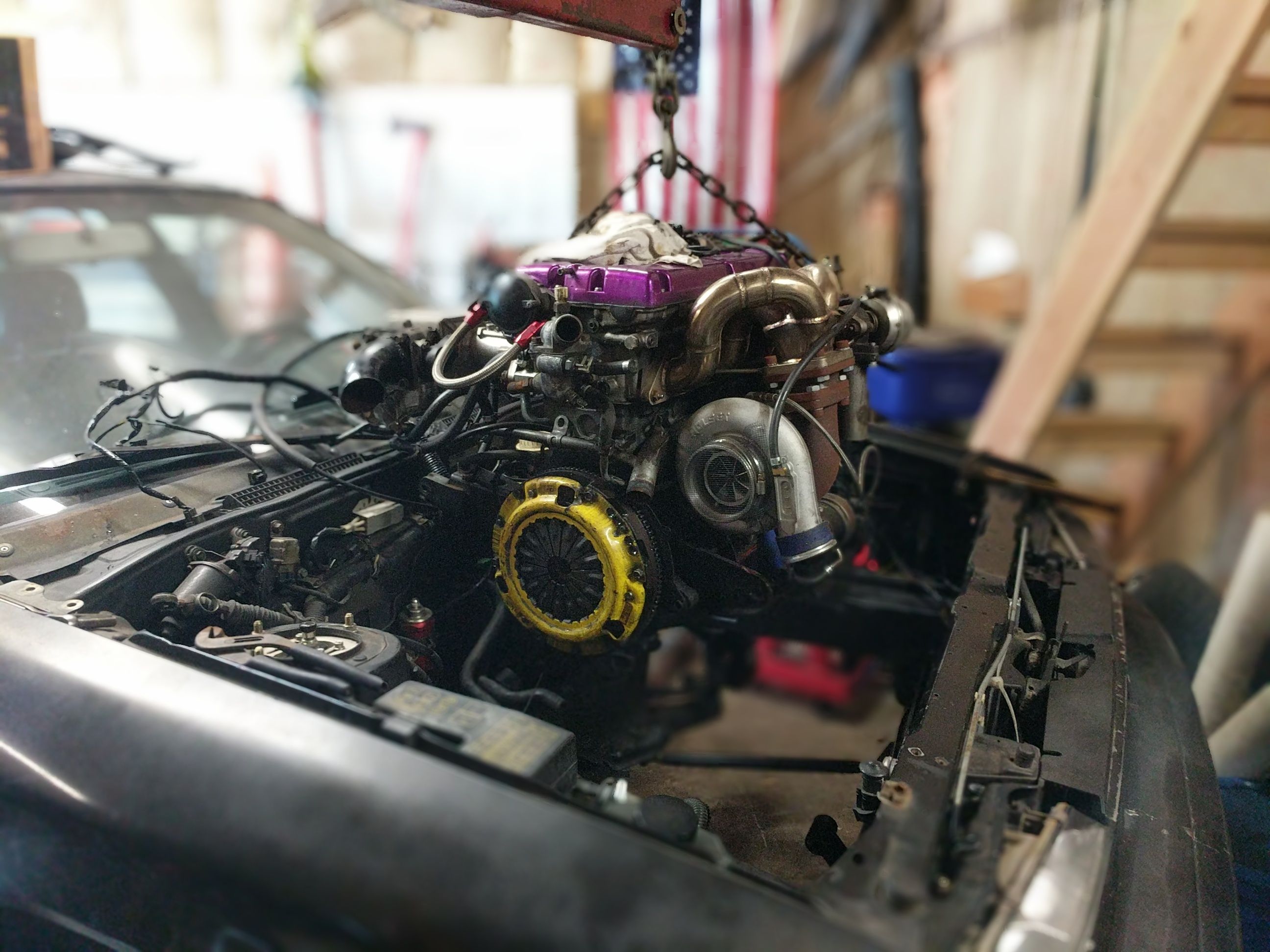

Restoration of Galant hopefully in time to run 10s at the 2019 Shootout

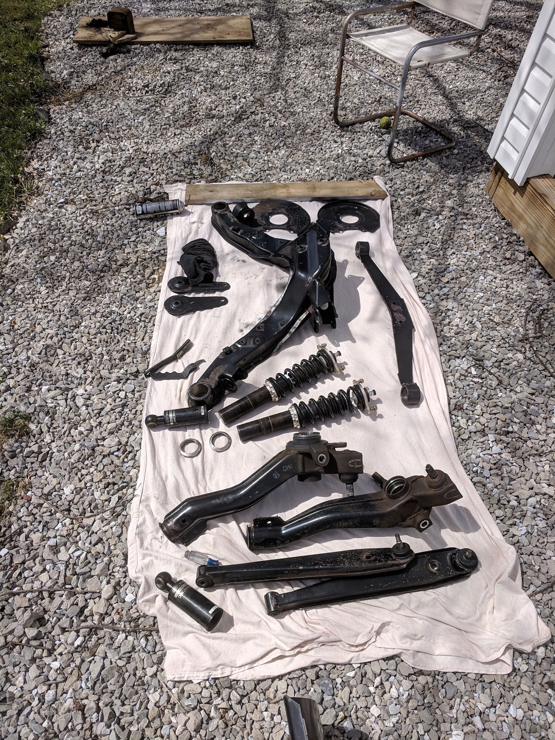

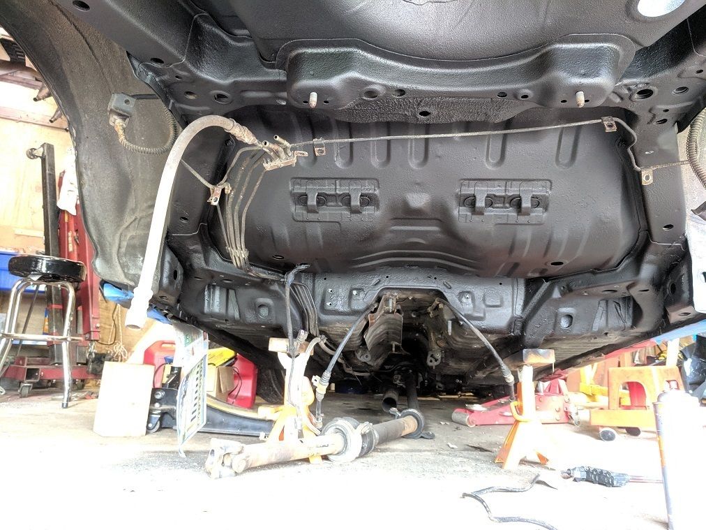

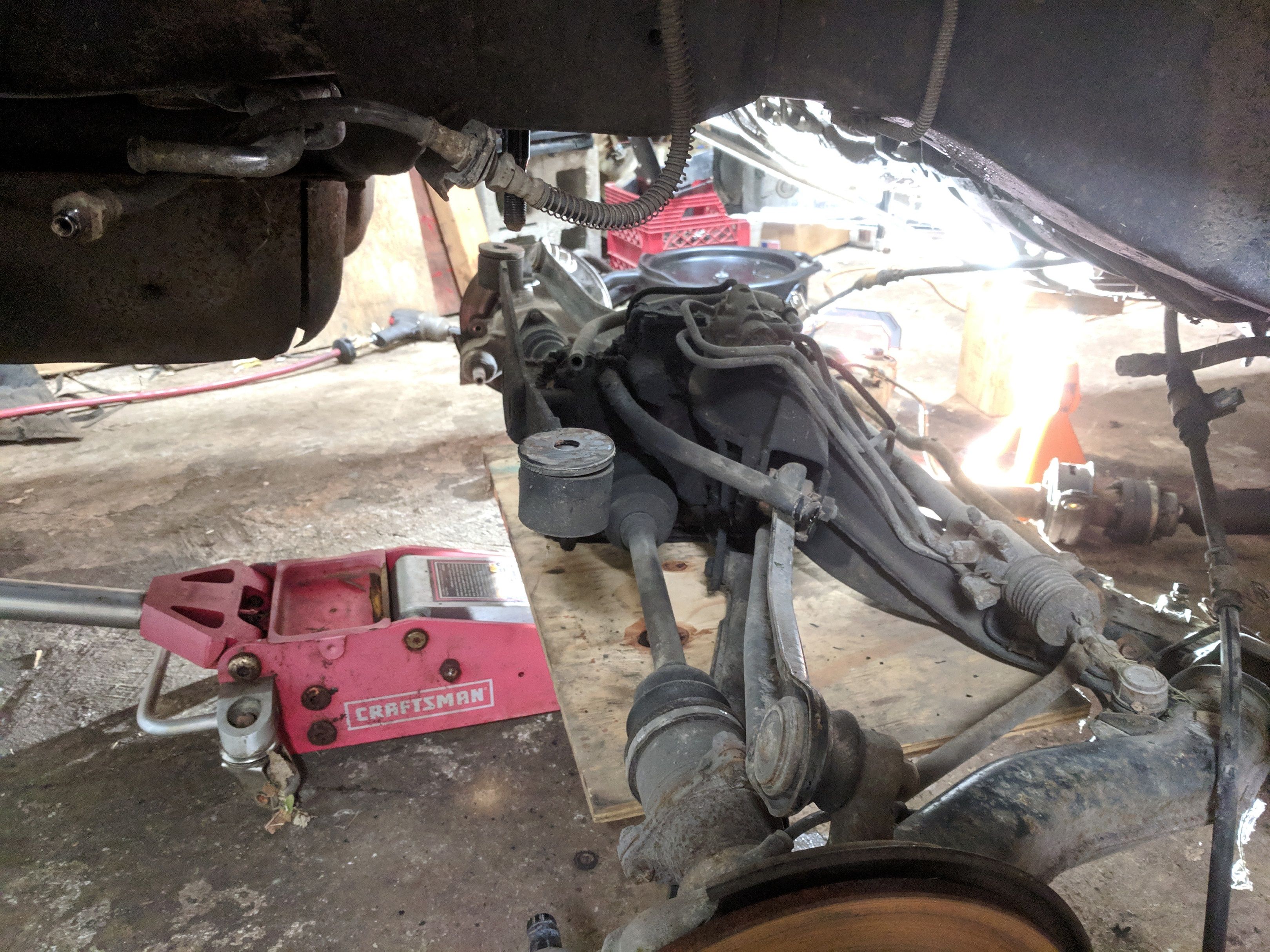

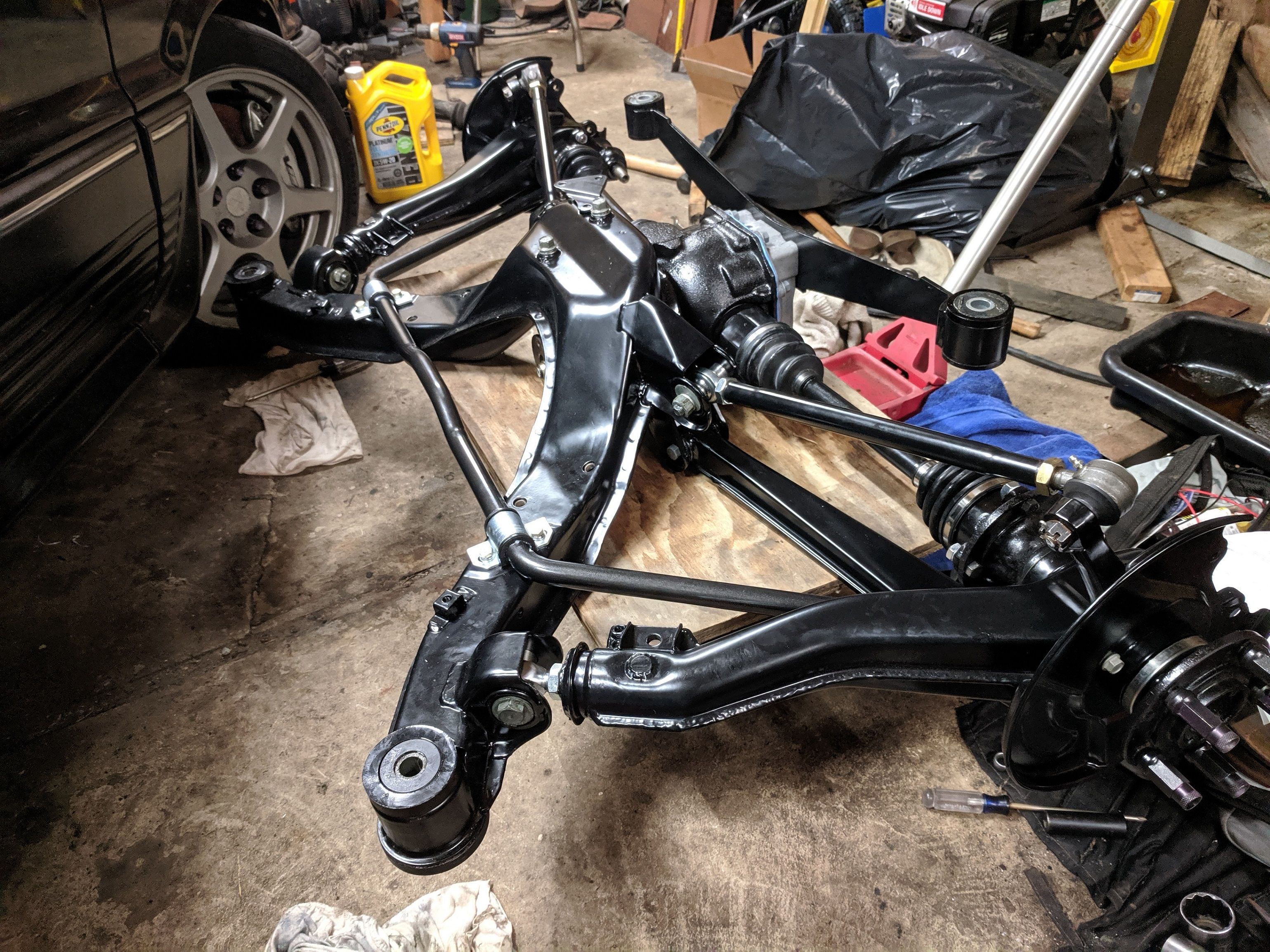

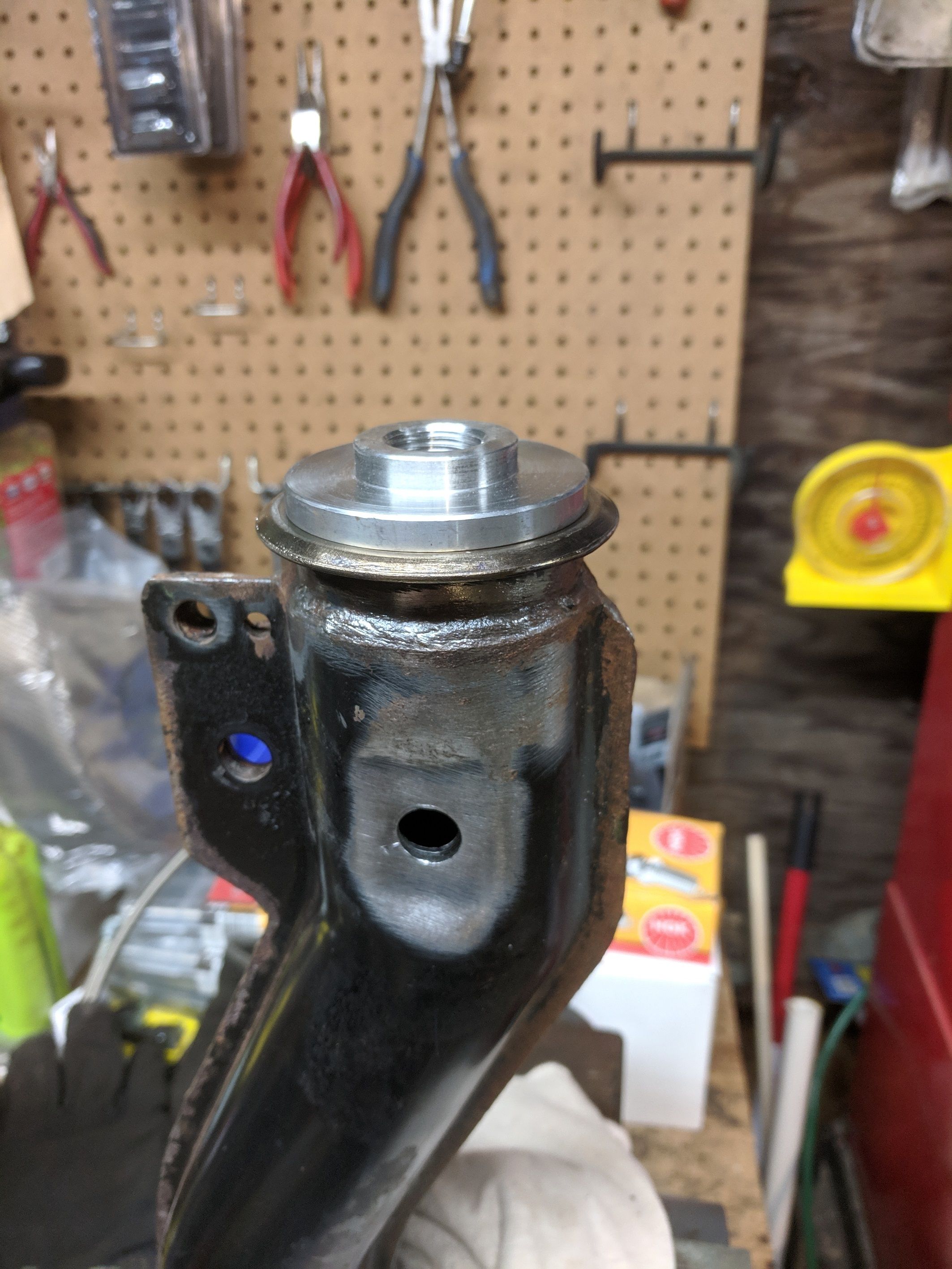

Rear diff has arrived; subframe and suspension components are at the powder coater; rear hubs assembled with new seals and bearings; Zinc plating setup is coming together to replate all of the fasteners.

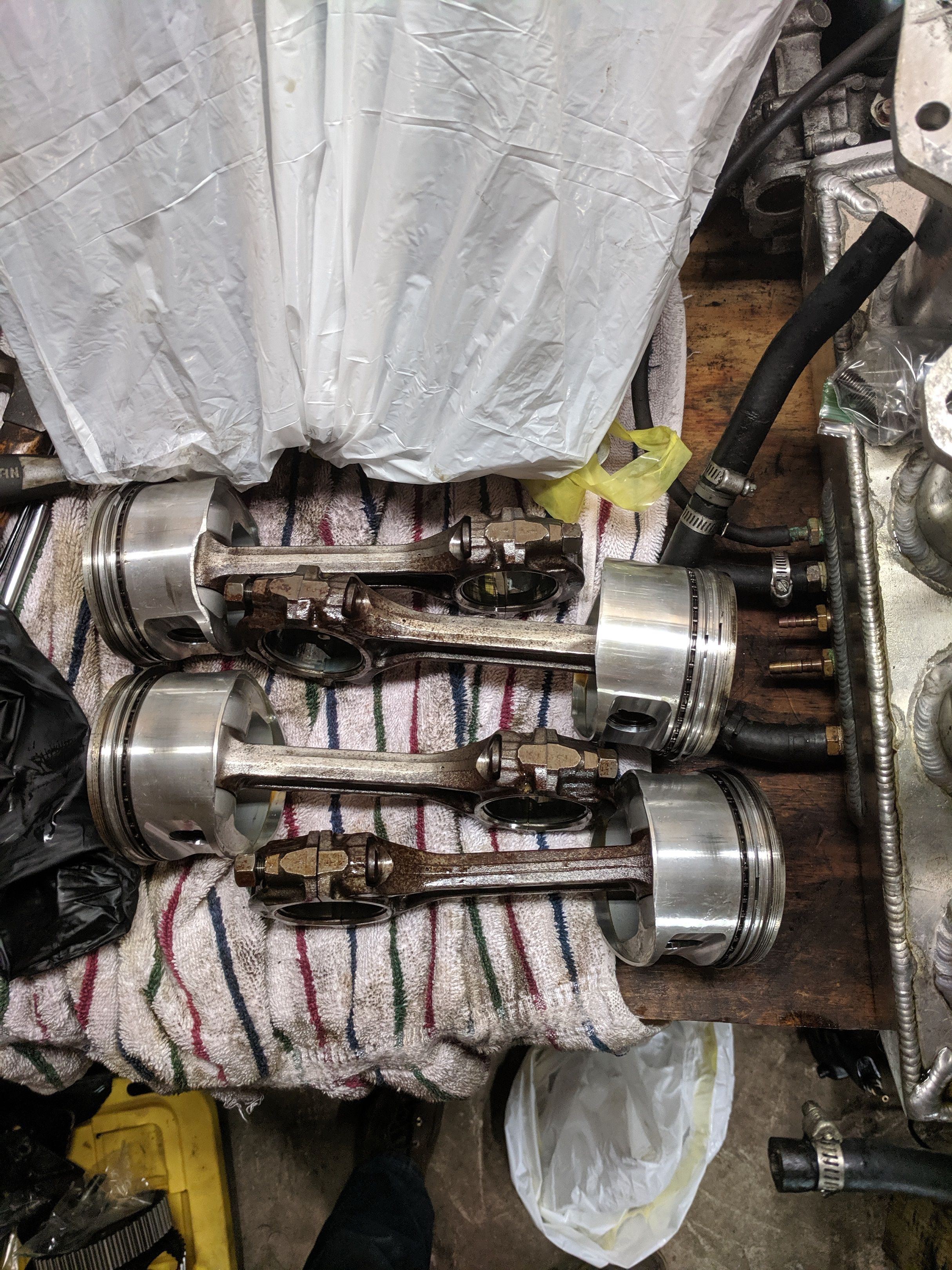

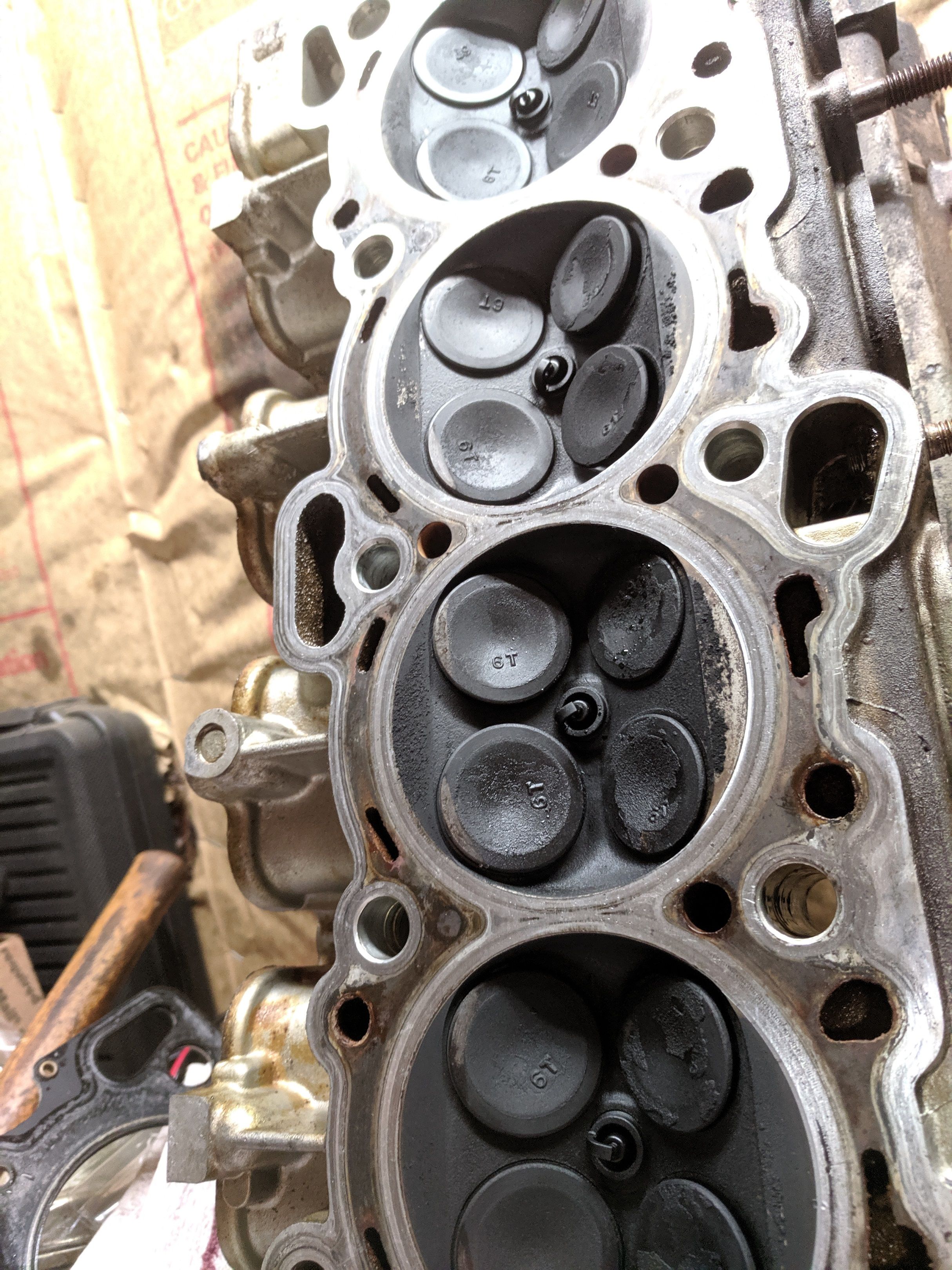

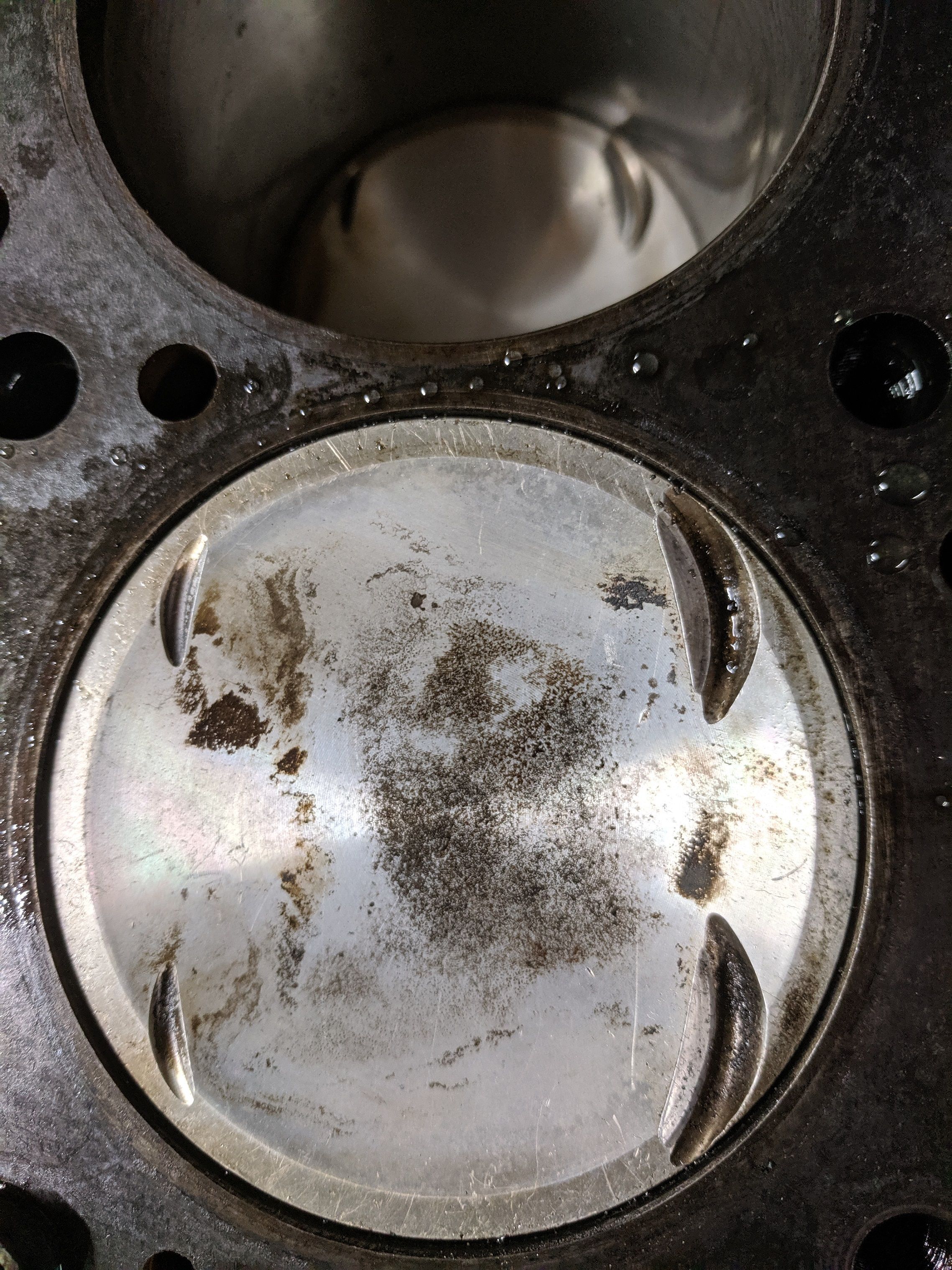

A previous owner, Turd Ferguson, set the intake cam 1 tooth advanced so the valves made some relief space in the pistons. Also, someone decided to reuse a garbage piston by die-grinding the bottom edge of the skirt. At least I discovered this before snapping a valve head off at high RPM.
