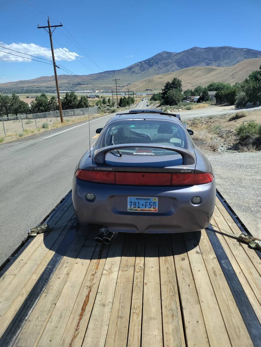

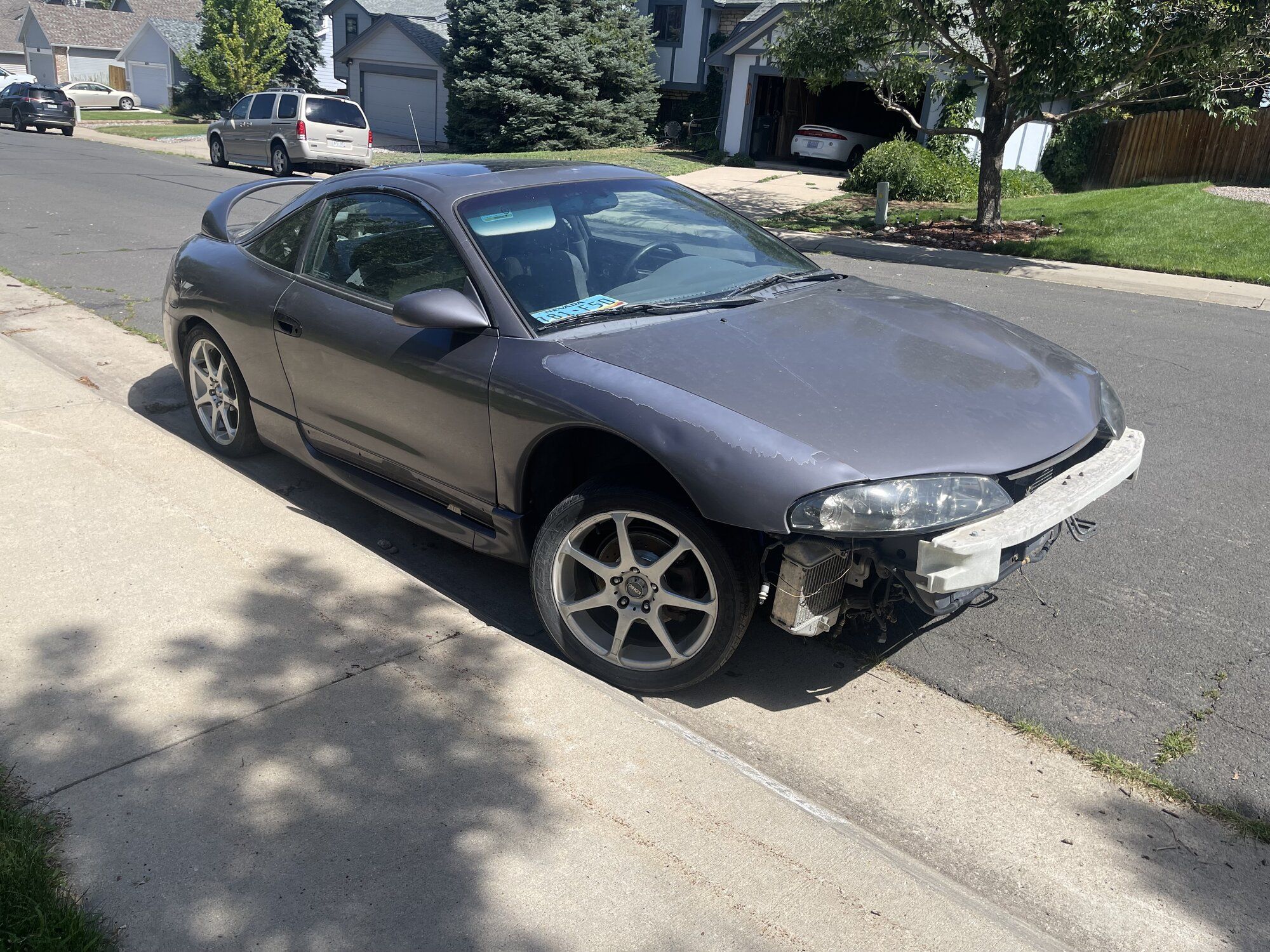

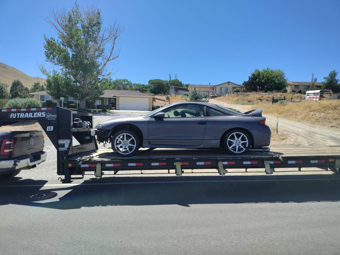

So for now here are the off the trailer shots and some things I have done so far!

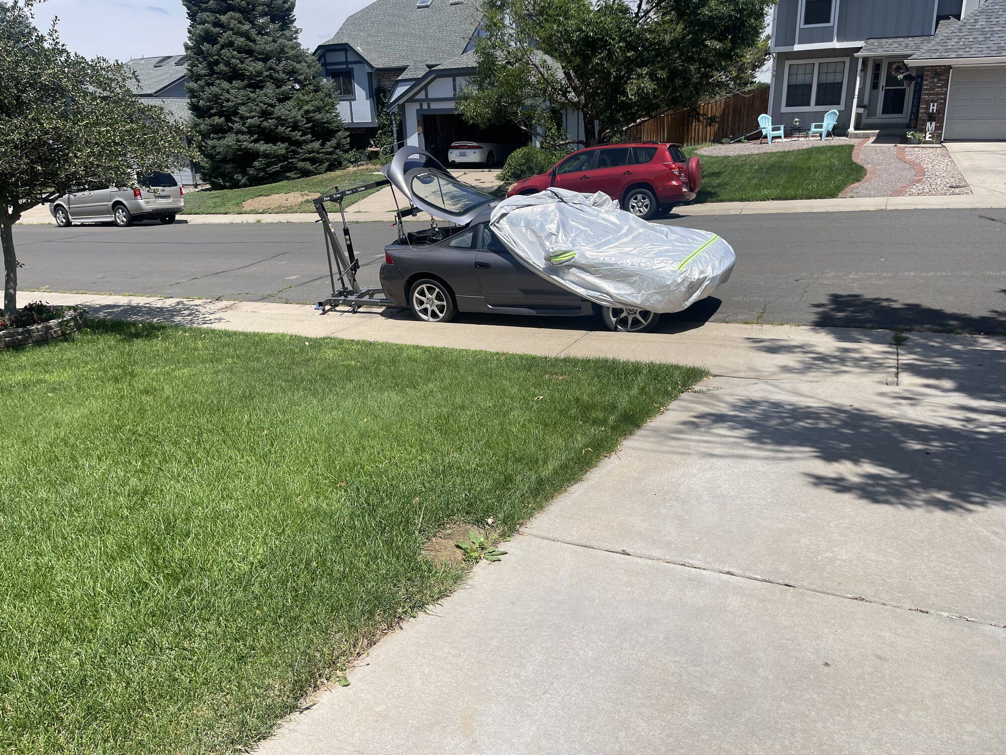

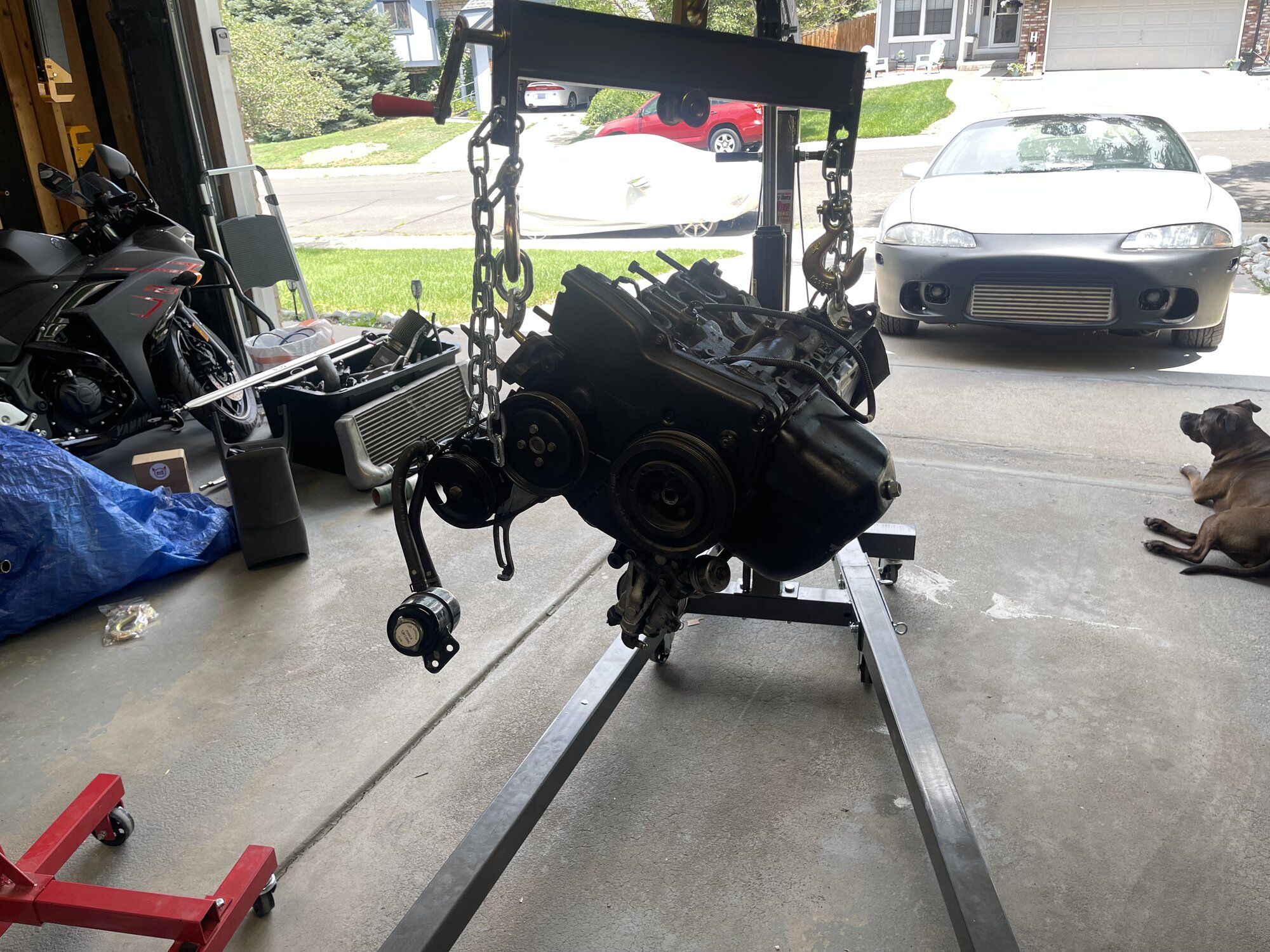

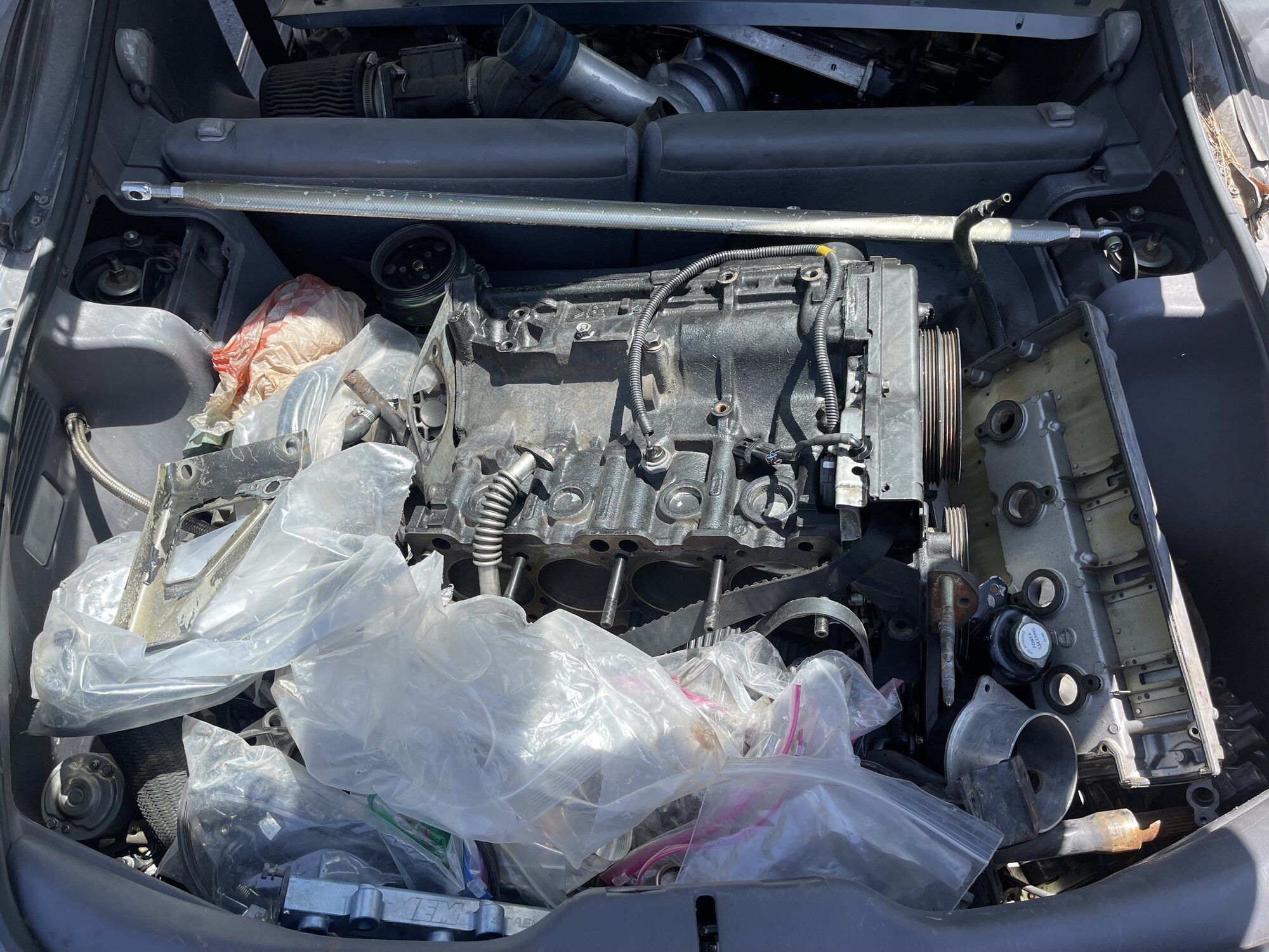

Picked the vehicle up with the entire drivetrain removed from it and shoved inside the vehicle inside the cabin and in the trunk. Got to work on sorting everything and seeing exactly what I had and what things looked like. Seller said it was complete and didn’t need anything but just to be put together… we will see about that hahahaha…
I haven't seen a DSM with an engine in the trunk since back in the day when Vinny Singh put one there. Looking forward to the build.
Oh no, the car is not a rear engine powered, it was just thrown in the trunk when it was shipped. Can't complain though since I would have paid what I did just for the completely rust free shell, so getting the drivetrain with it was a huge bonus.
Looks pretty clean, all in all. Taking on that scope of project (engine in the trunk) would be too much commitment for me, but as others have said, looking forward to following your progress posts.

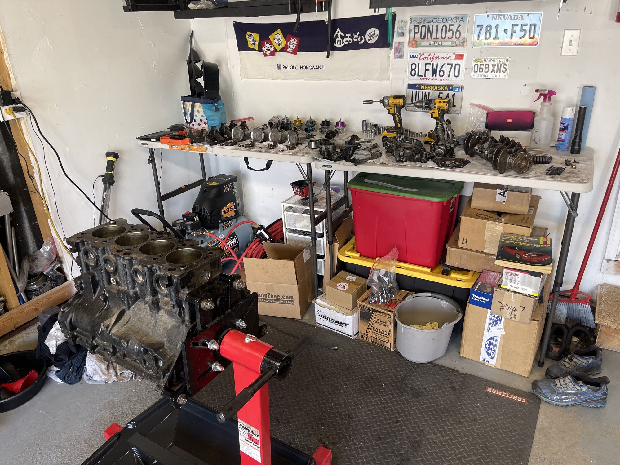

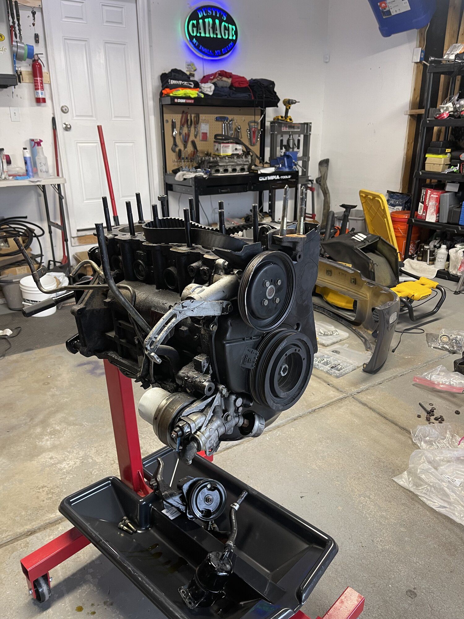

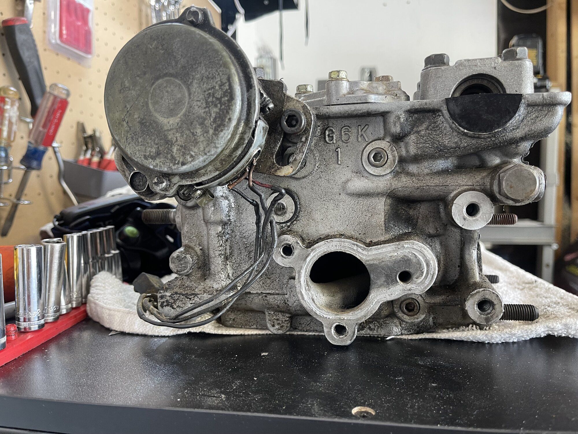

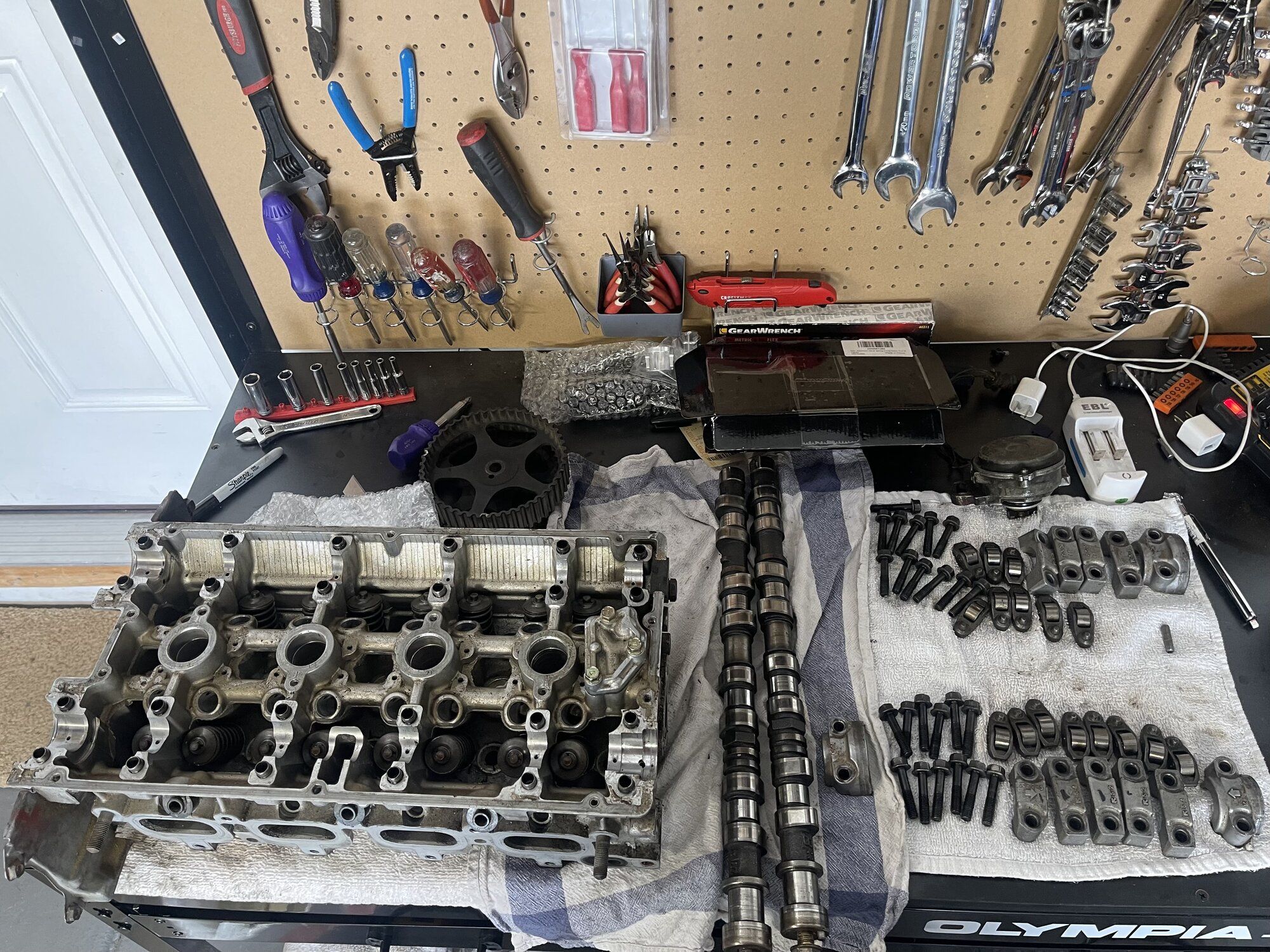

Well I did get around to breaking down the block and started on the head as well. Plan was to send everything out to be hot tanked/bored over and then high temp painted. Now I am not really sure I want to bore it over. May just keep it pretty stock and just replace the rings. Crank/journals-cap/pistons all look really good. Was praying for a 97 split thrust block but no luck there. Also, have no idea why but once I started taking the head apart I stopped when I realized it was a 6bolt head.. so probably going to throw it on the shelf and hoard it for no reason like a typical dsm owner haha.

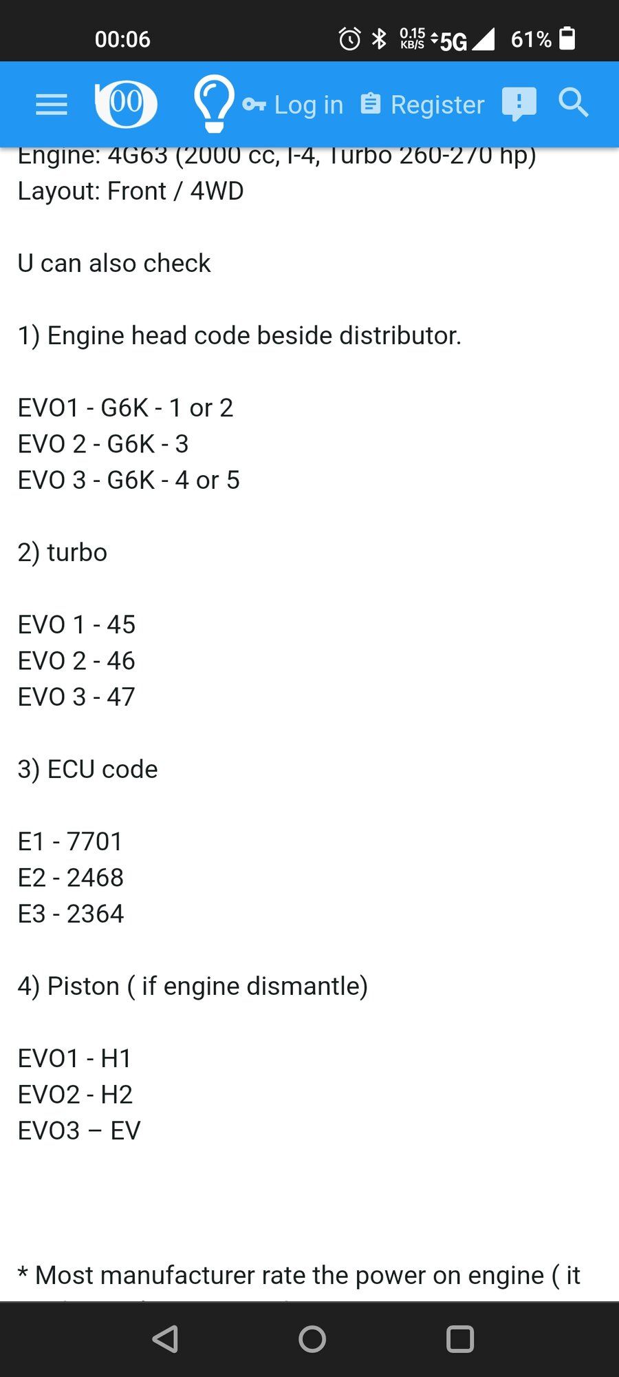

That's a head from a 2.4L. I would check the block as well. The whole thing might be a 2.4L. Looking into it a bit further because it confused me a bit. That's a 7 bolt head but that stamping screams 2.4L which was only available in DOHC, correct me if I'm wrong, on the Galant?
Edit. I think I'm wrong about it being a 2.4L. Further research leads me to believe this may be an EVO 1 head.
I also did a quick google search and does seem to be an Evo head. It has the small runner features of the 2G but thermostat feature of a 1G haha. I am not sure if I should even keep it or give it to someone that may need it. We will see I guess. I am also now going to double check the block when I get home as well. Thank you for the heads up.

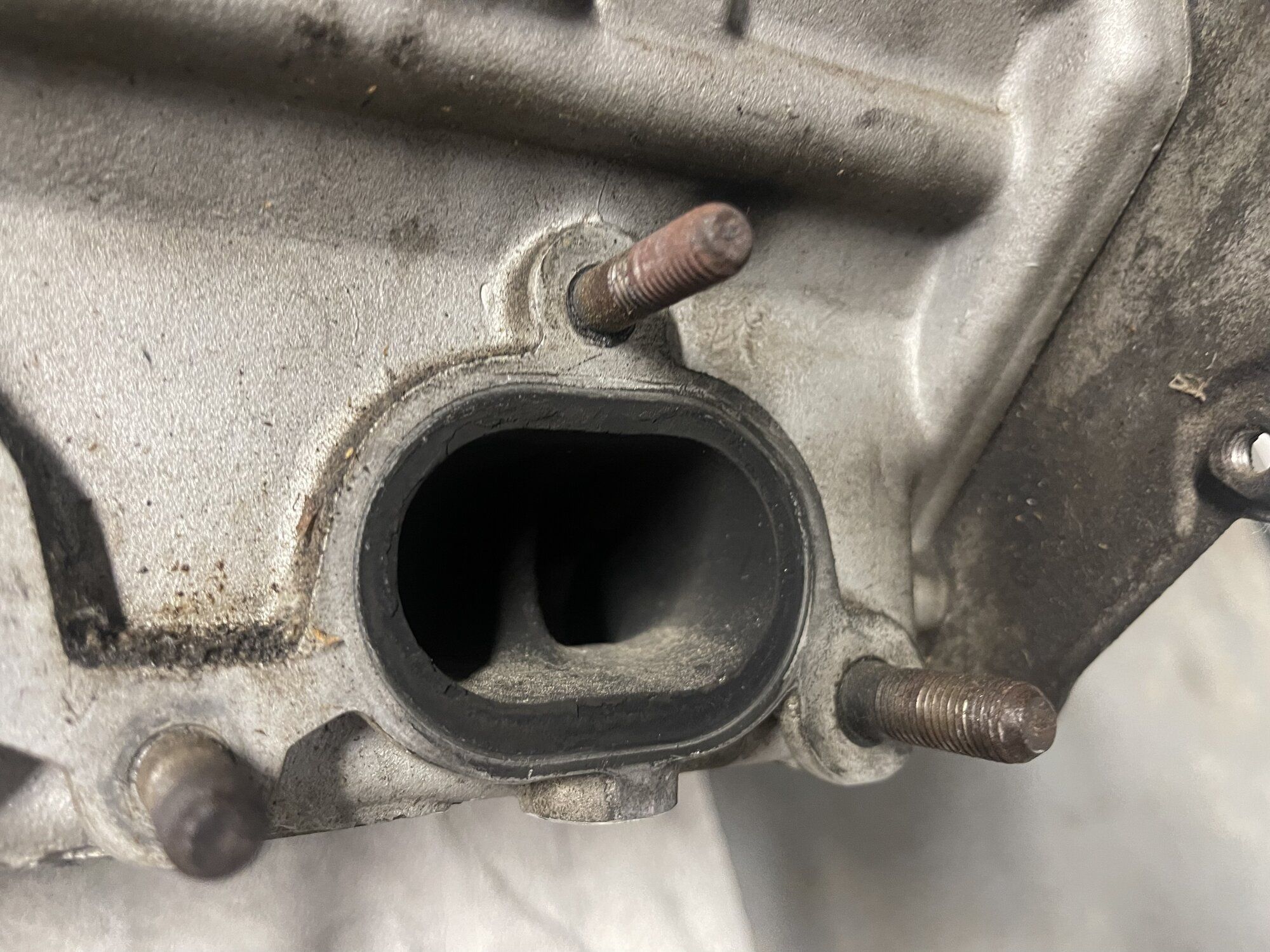

Also, the thermostat housing bolt pattern looks like a 2g as well. Check the exhaust manifold bolt sizes. 2g will have 2 larger ones on the outside.
So looked at it again and it is a hybrid of a 1G and 2G which makes me thing it’s def an Evo head. It has the thermostat housing of a 1G but runners and exhaust stud sizes of a 2G. Either way it’s going on the shelf since I have plans to use the magnus intake I bought years ago haha. Glad you caught my little pun too haha. Just came to me off the top of my head last night..

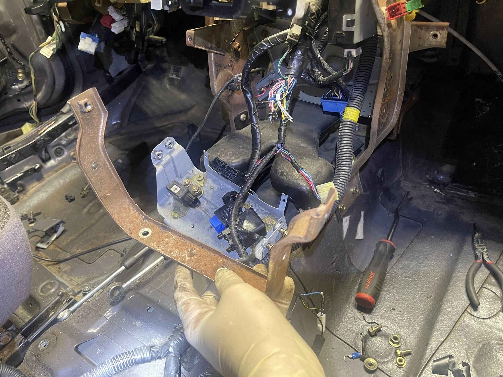

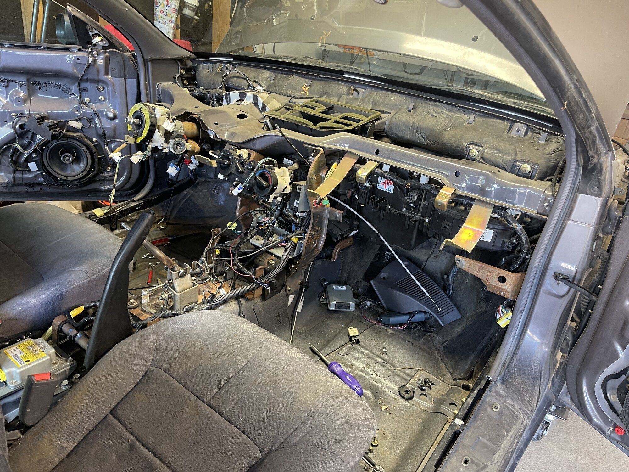

Well, got started on the interior since I need to get at the pedals and everything related. Removing every single metal piece I can to be powder coated so there is never an issue with this ugly surface rust that develops on everything. Dash is removed and all metal mounting brackets now removed. Also removed all pedal assemblies for powder coat. Tunnel parts are next.
