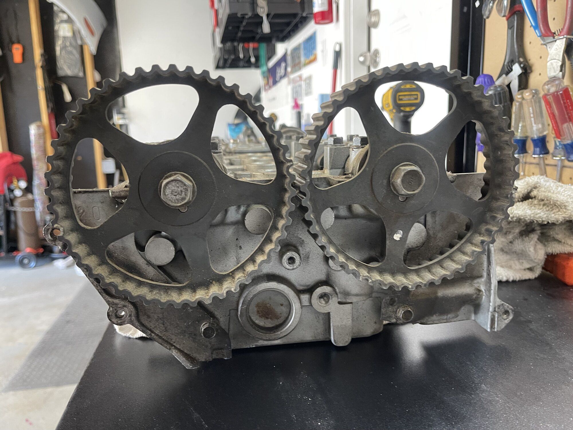

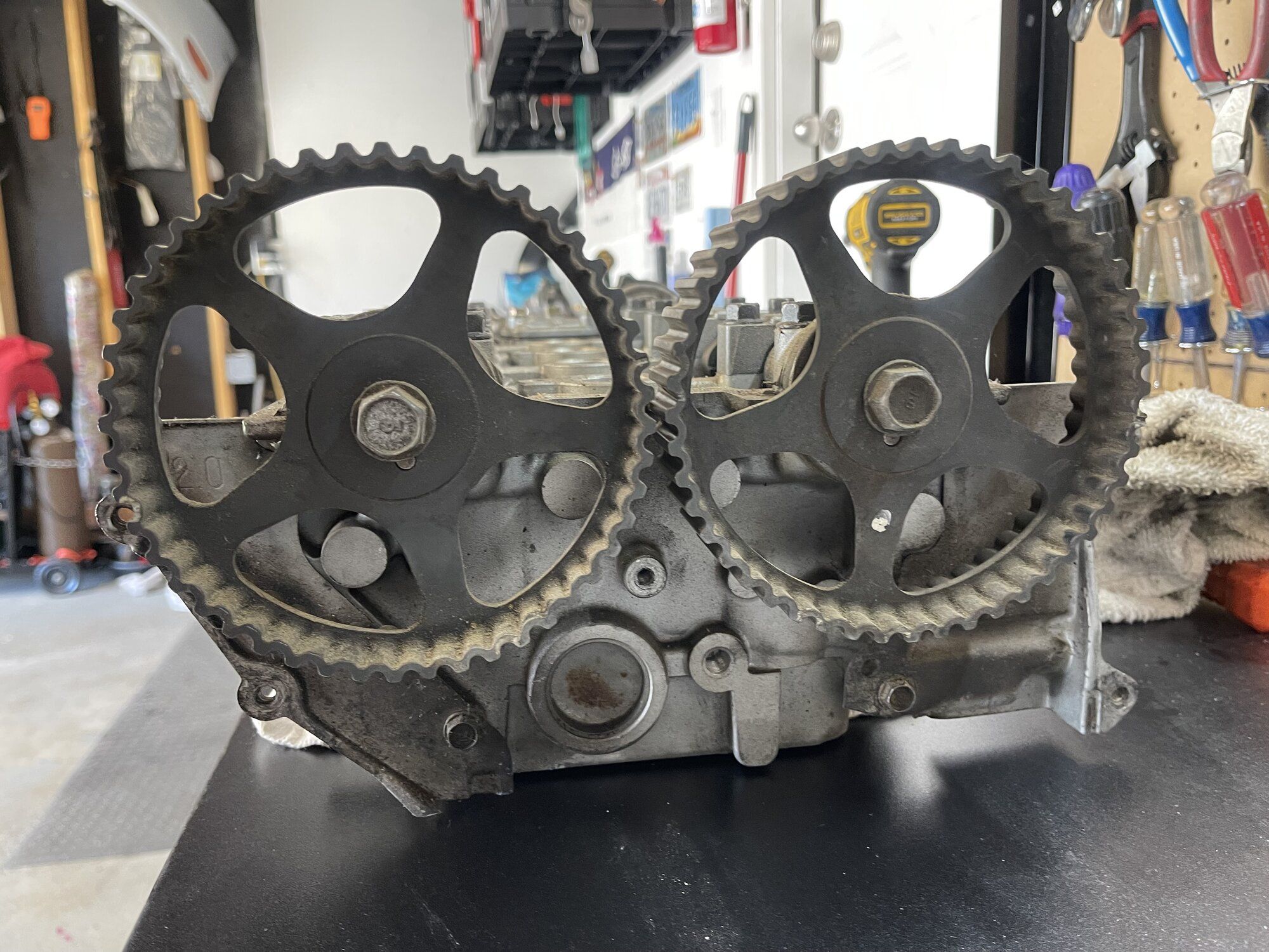

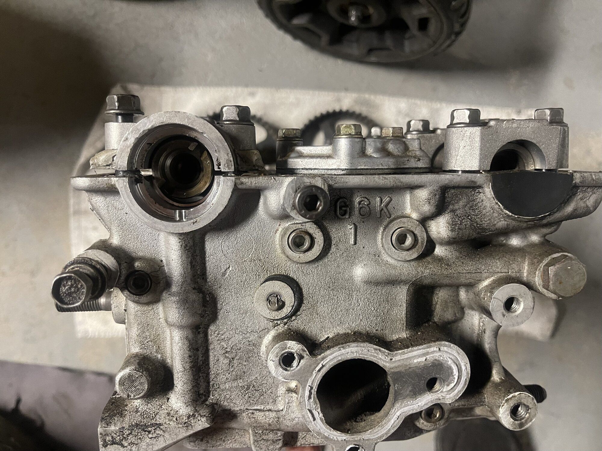

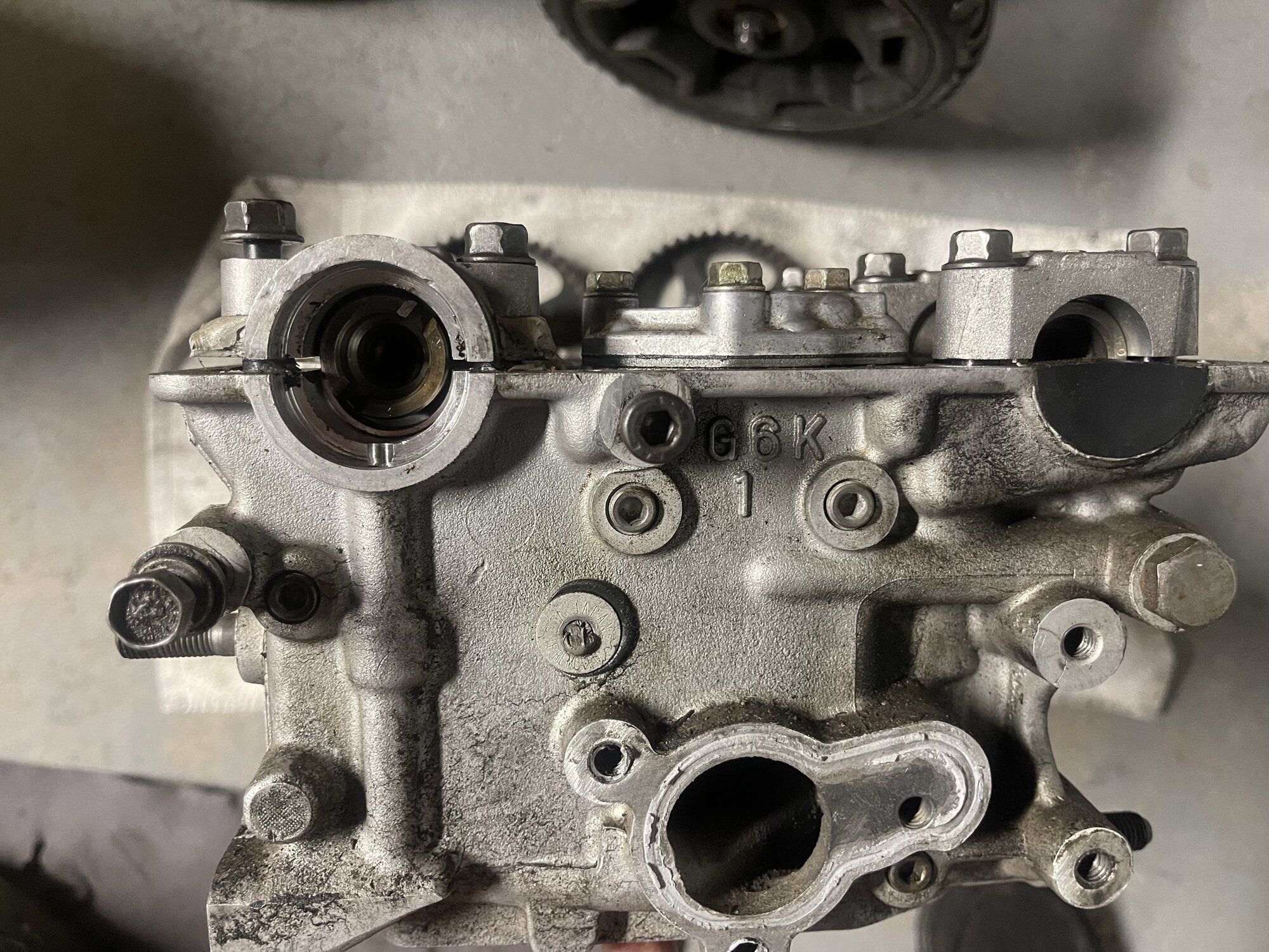

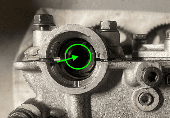

What do the head intake runners look like?
And is the CAS end of the intake cam threaded?
Is there a place to bolt a 95-96 CAS under the intake CAM gear?
Ok so got a chance to look at the head a little more. Here is the cam side for the sensor and no there is not a way to mount a sensor on the cam gear side.
Lol I know that. He asked if the cam side where the sensor mounts is threaded and I took a pic to show that no, it is not threaded. I also found there is no sensor mount on the gear side either.
Or is there?
Can't tell from that photo. The mounting points are behind the intake cam gear. Location circled. Are those 2 points drilled and tapped?
OK - Cool - look where I have circled inside the end of the CAM - If it is a 2Gb cam it will have threads inside where a bolt goes to hold on the 2gB CAM angle sensor adapter. - No threads here means you have older CAMs, like 1G cams.

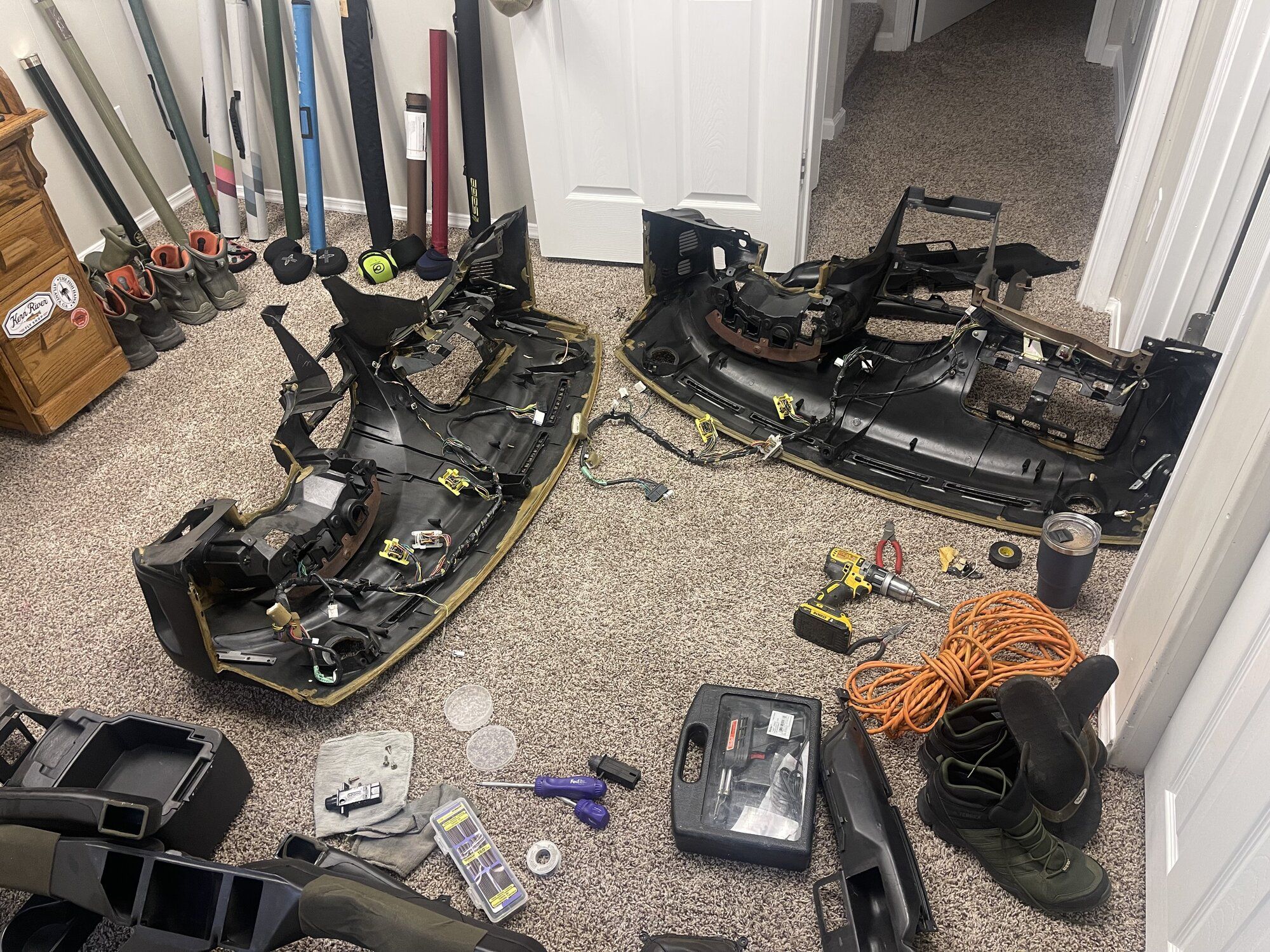

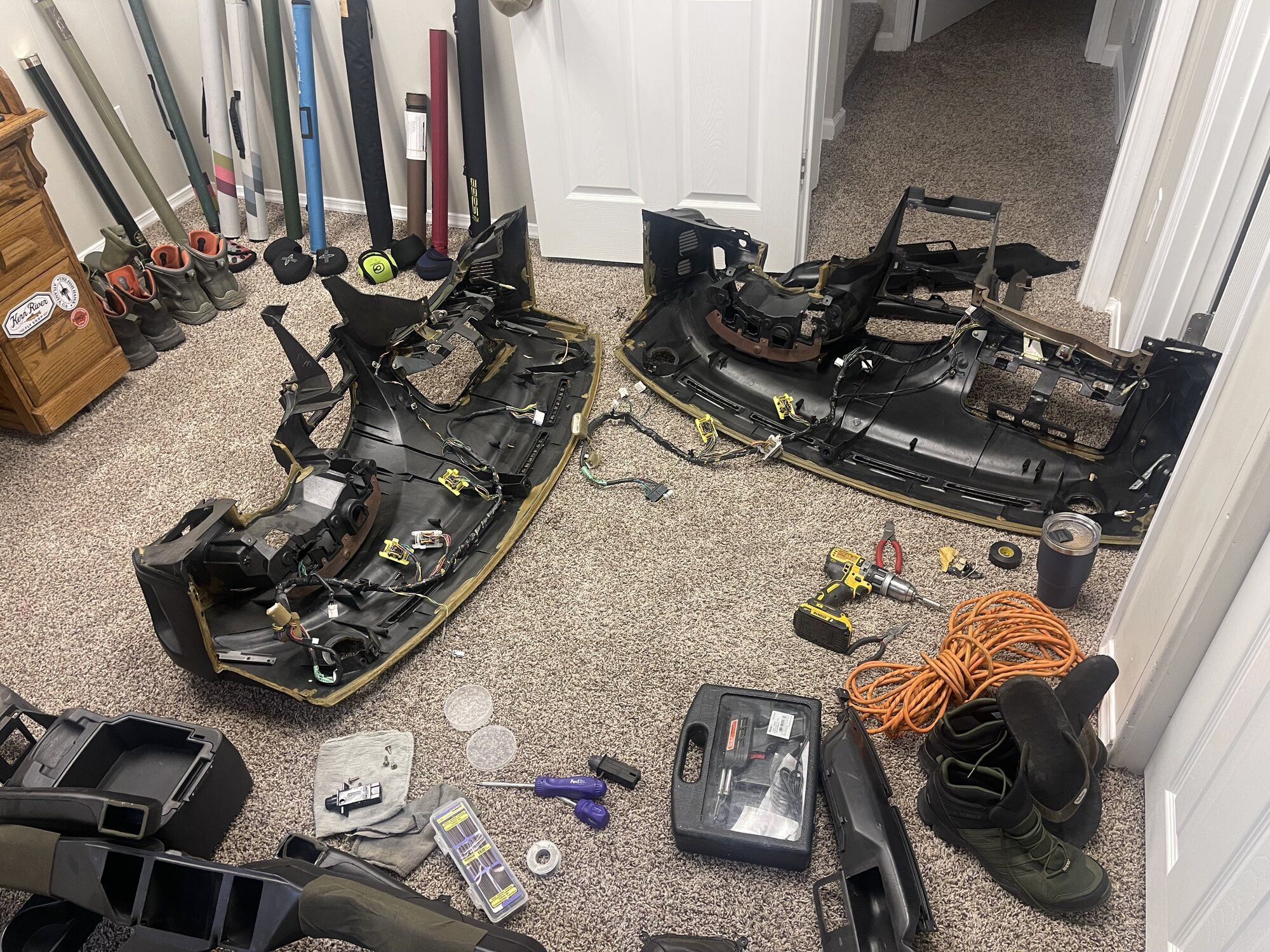

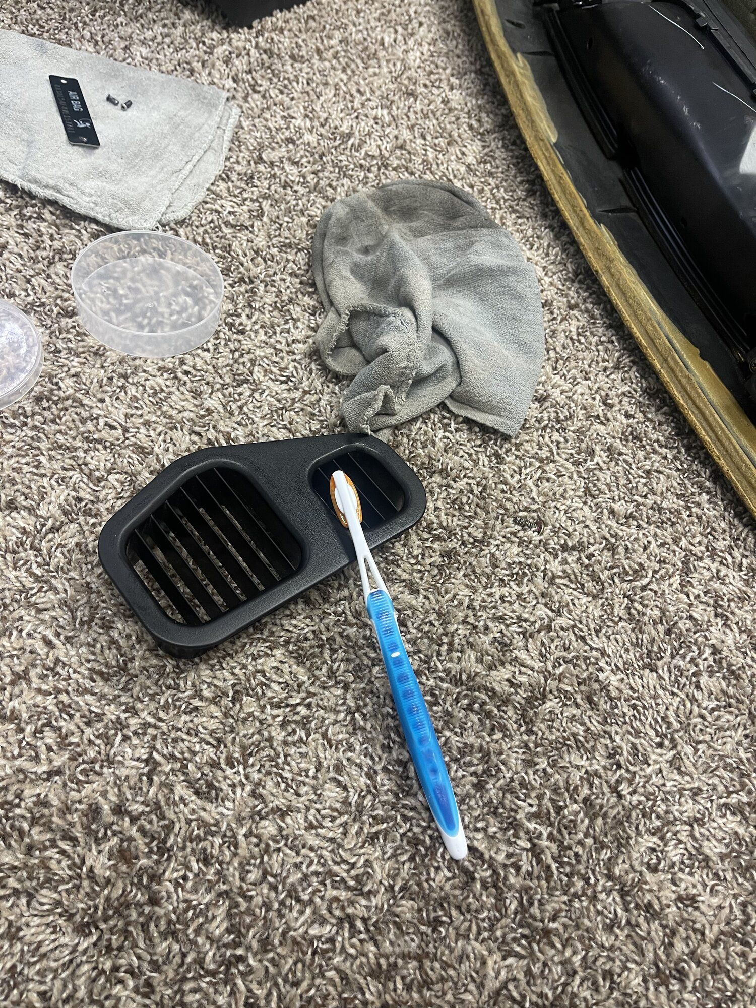

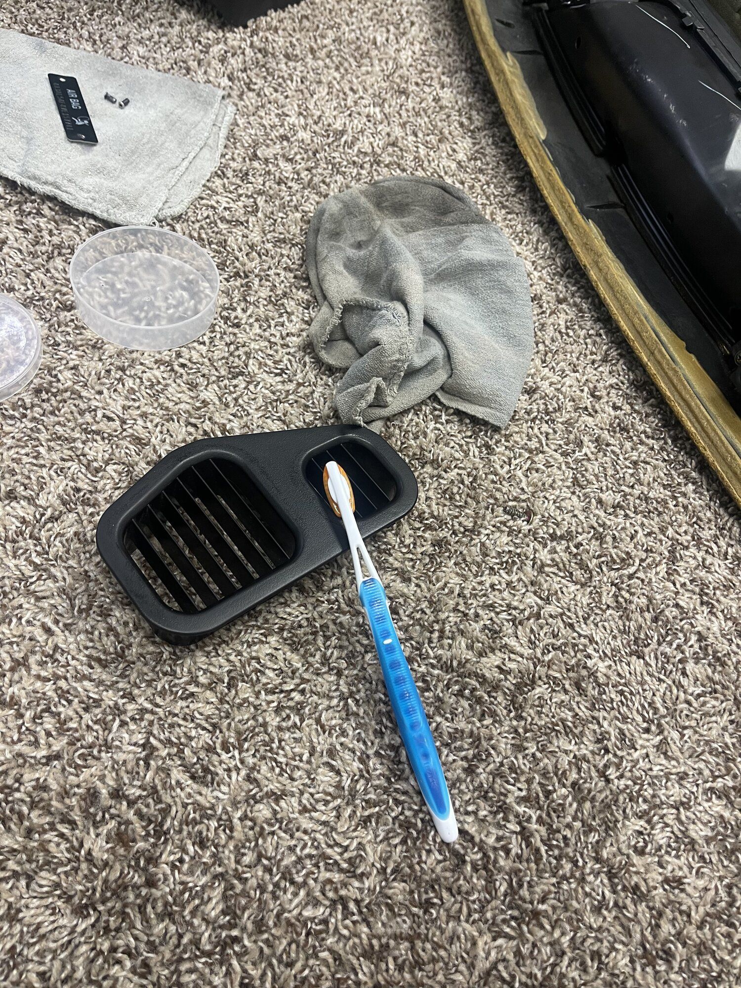

So I will start another post about this mystery head I got so we can all solve it but I kinda want to get back to the actual build. I have no intentions to even use the head but may keep it as a spare once we nail down exactly what the hell it is. But anyway, I finally got around to swapping the harnesses for the black dash going in and also took the time to detail the vents and stuff that is hard to clean once installed. To me this is what separates me from most all other builds. Detail and effort.
You're not messing around. 👍

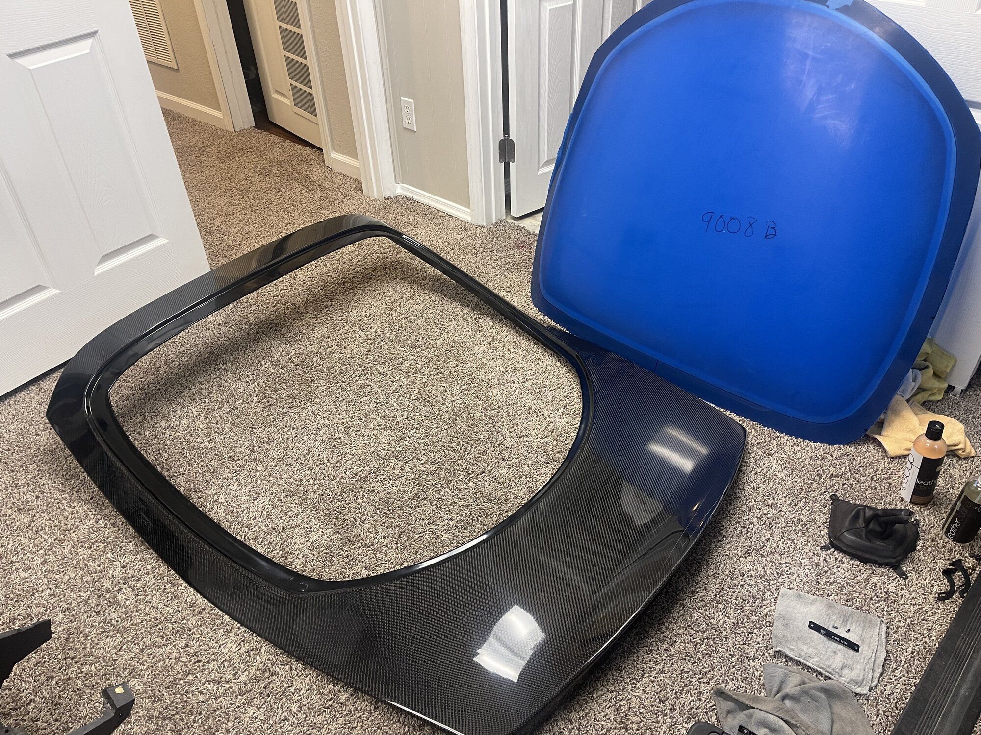

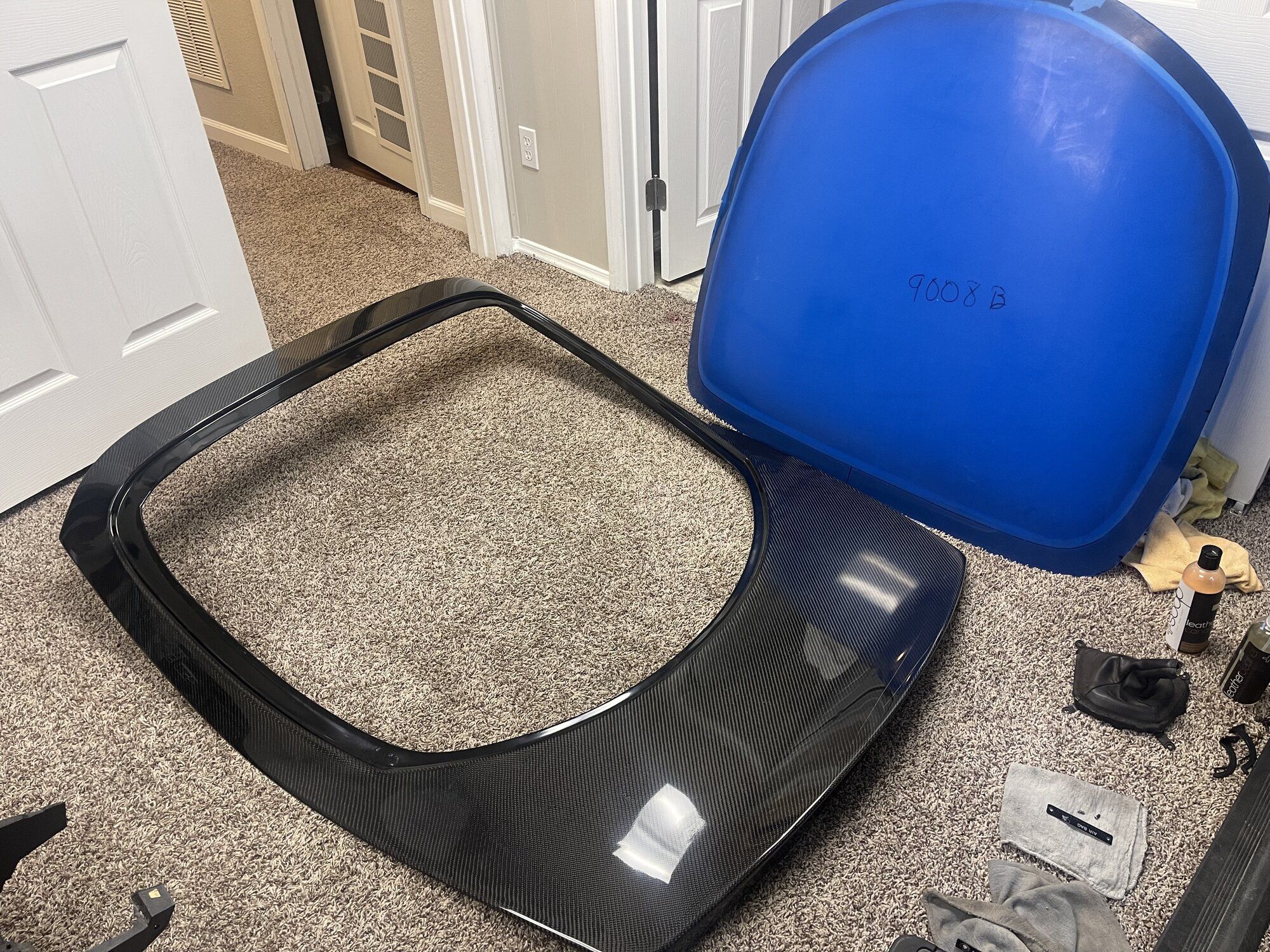

I had planned on waiting until the build was MUCH further than it was for really large purchases but I couldn’t help snag this from a local dsm guy. It was on the build plan the entire time and now it’s a reality. So happy about it and it comes with the plexiglass!!
Lead time is very long for CF parts. Other things too, like side skirts and drip moldings. Its smart to keep an eye out for the really hard to locate items.

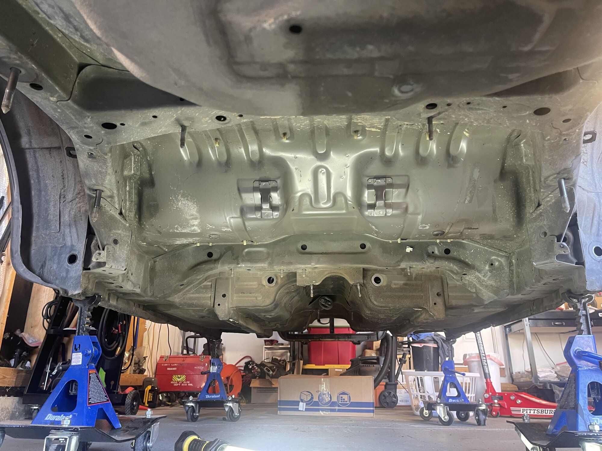

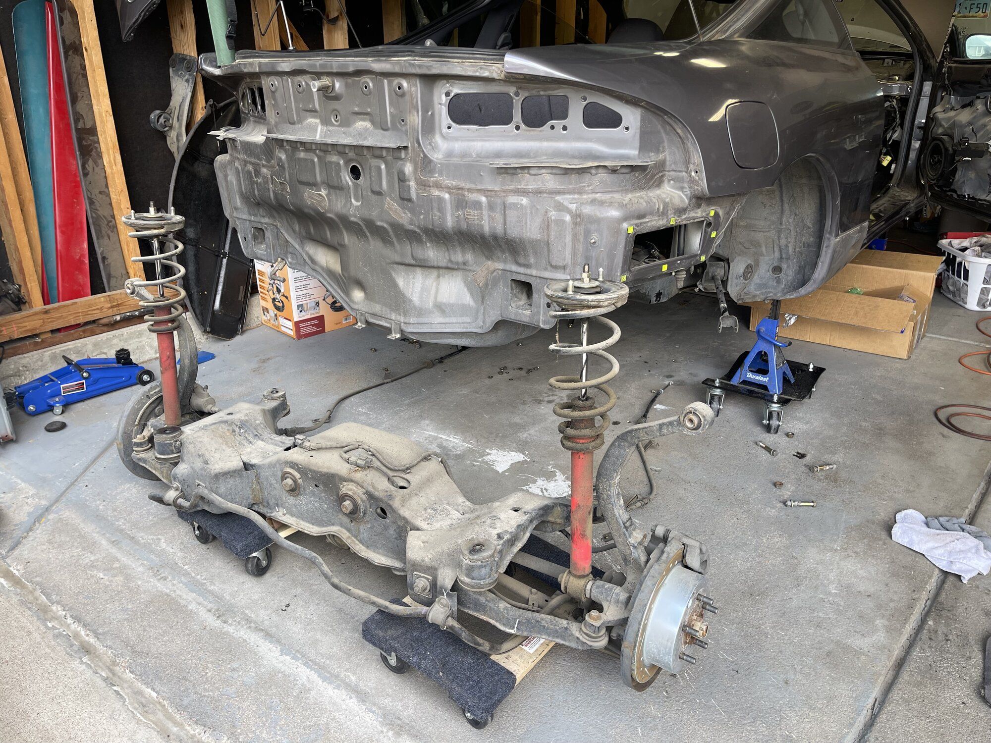

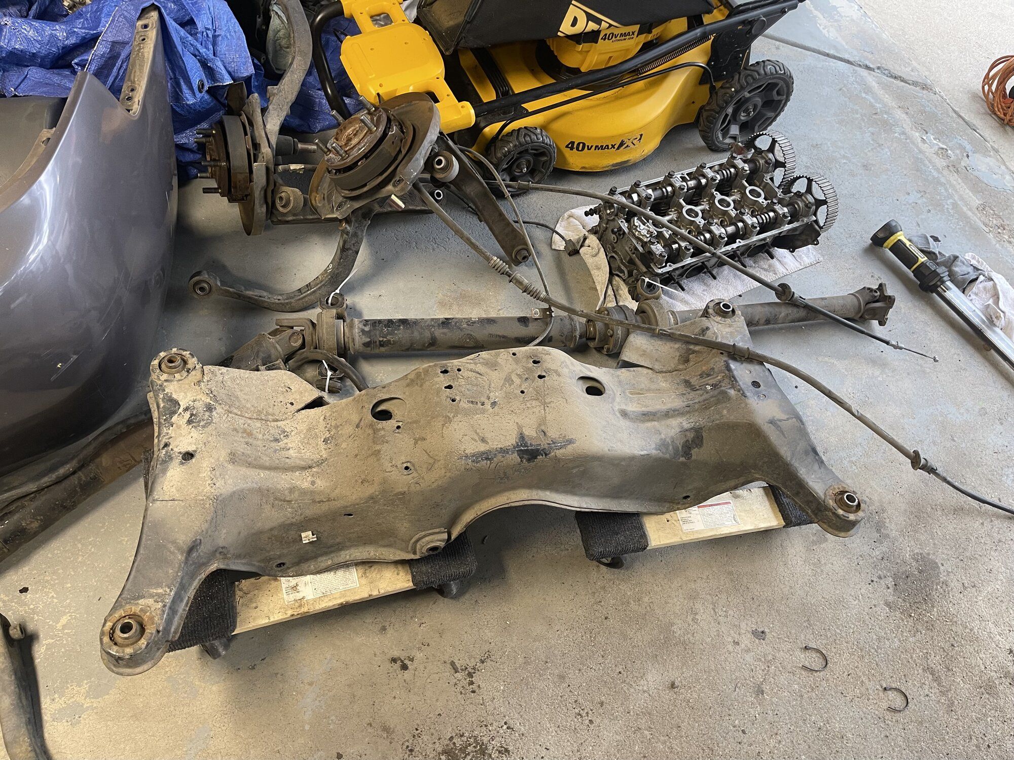

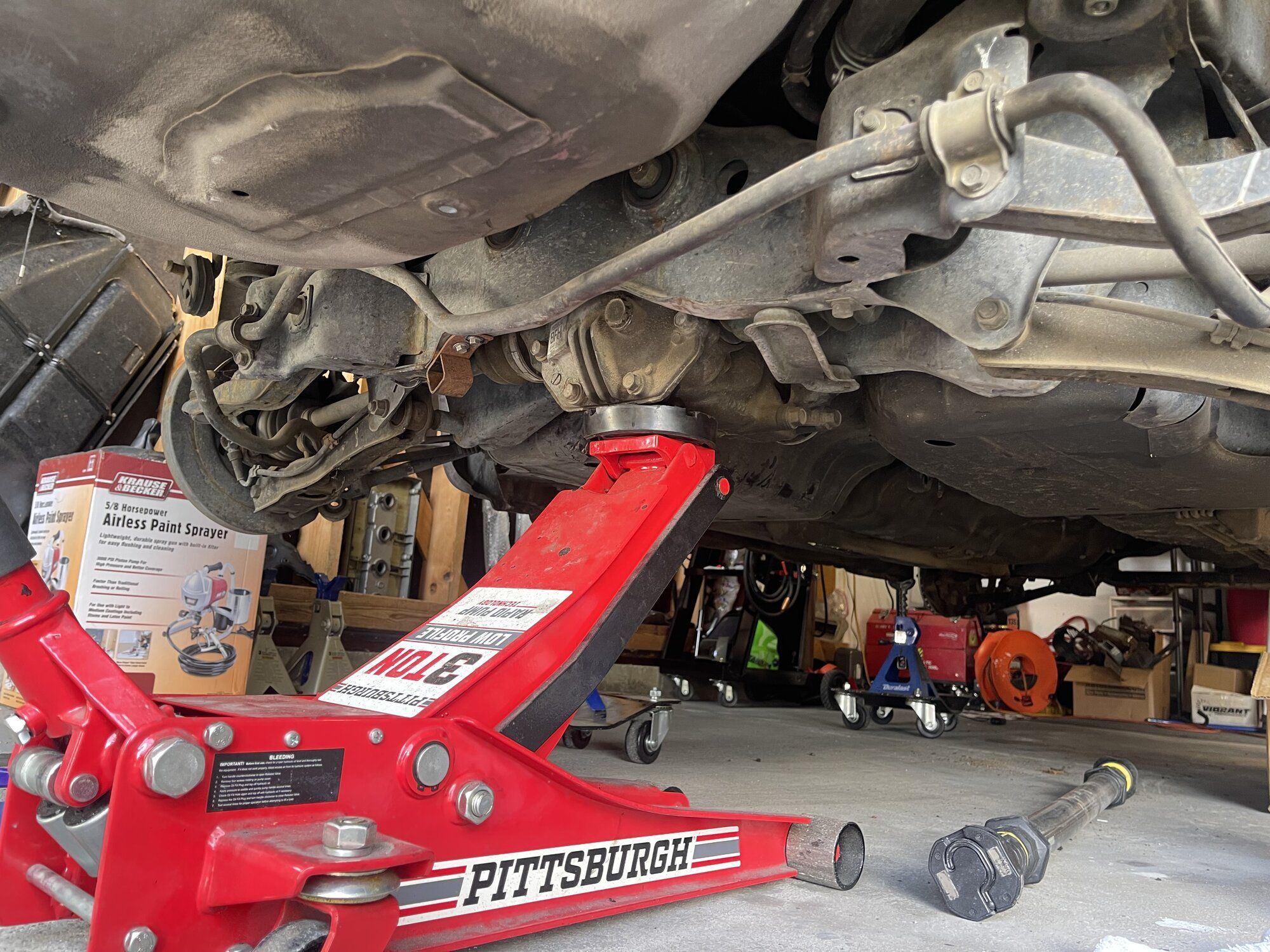

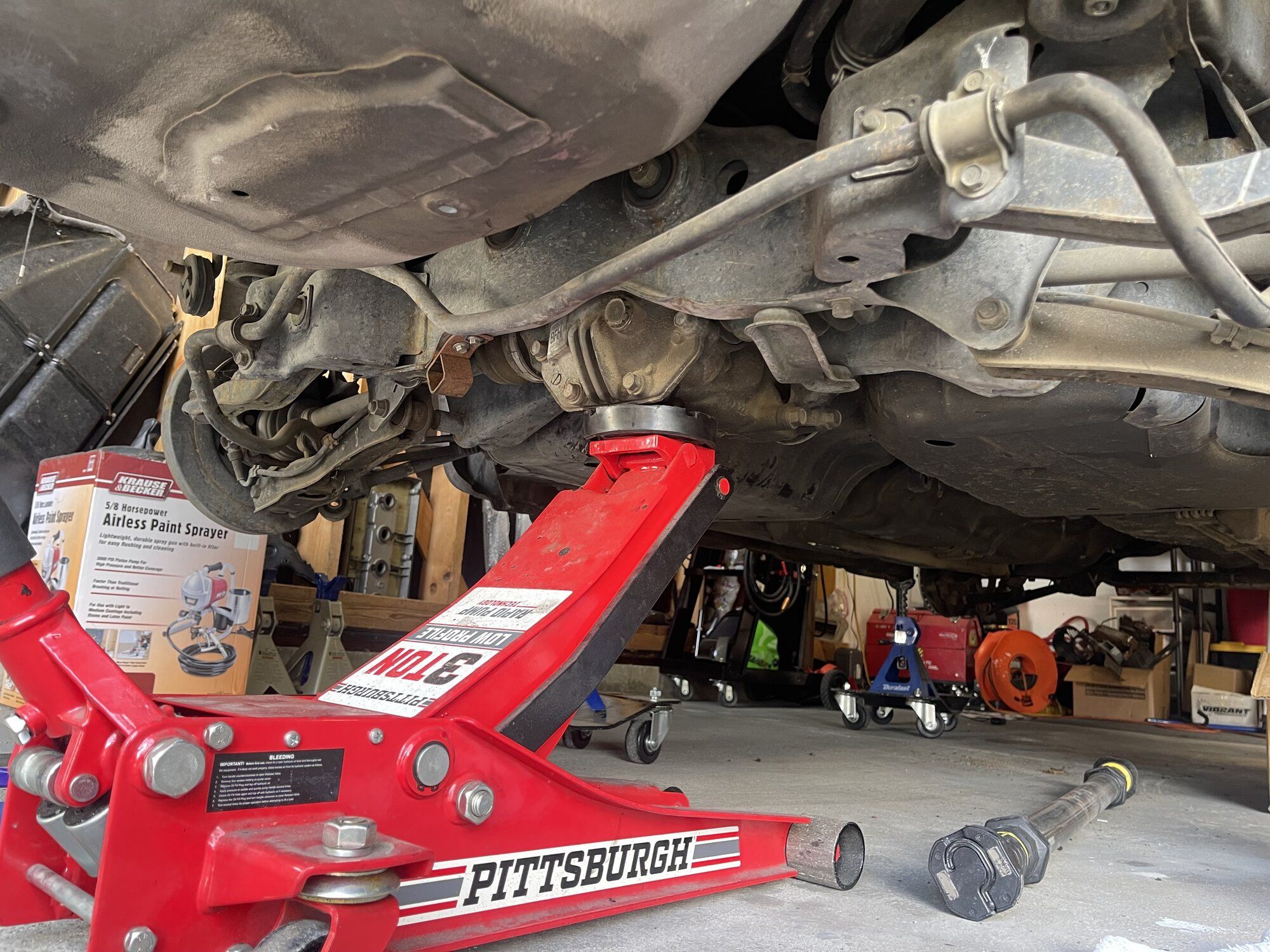

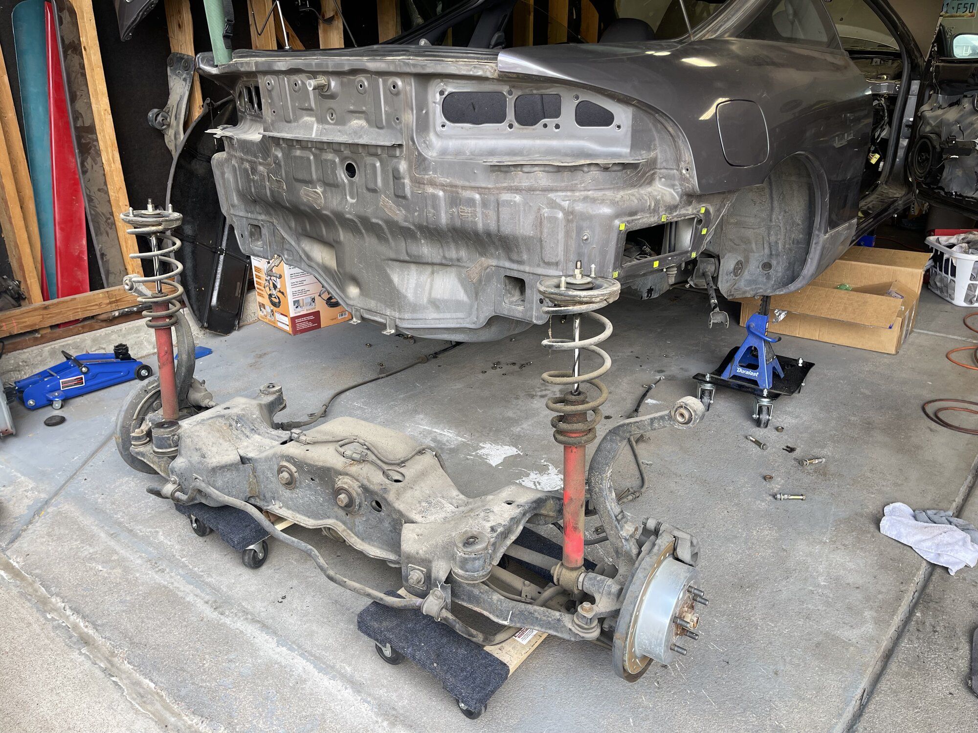

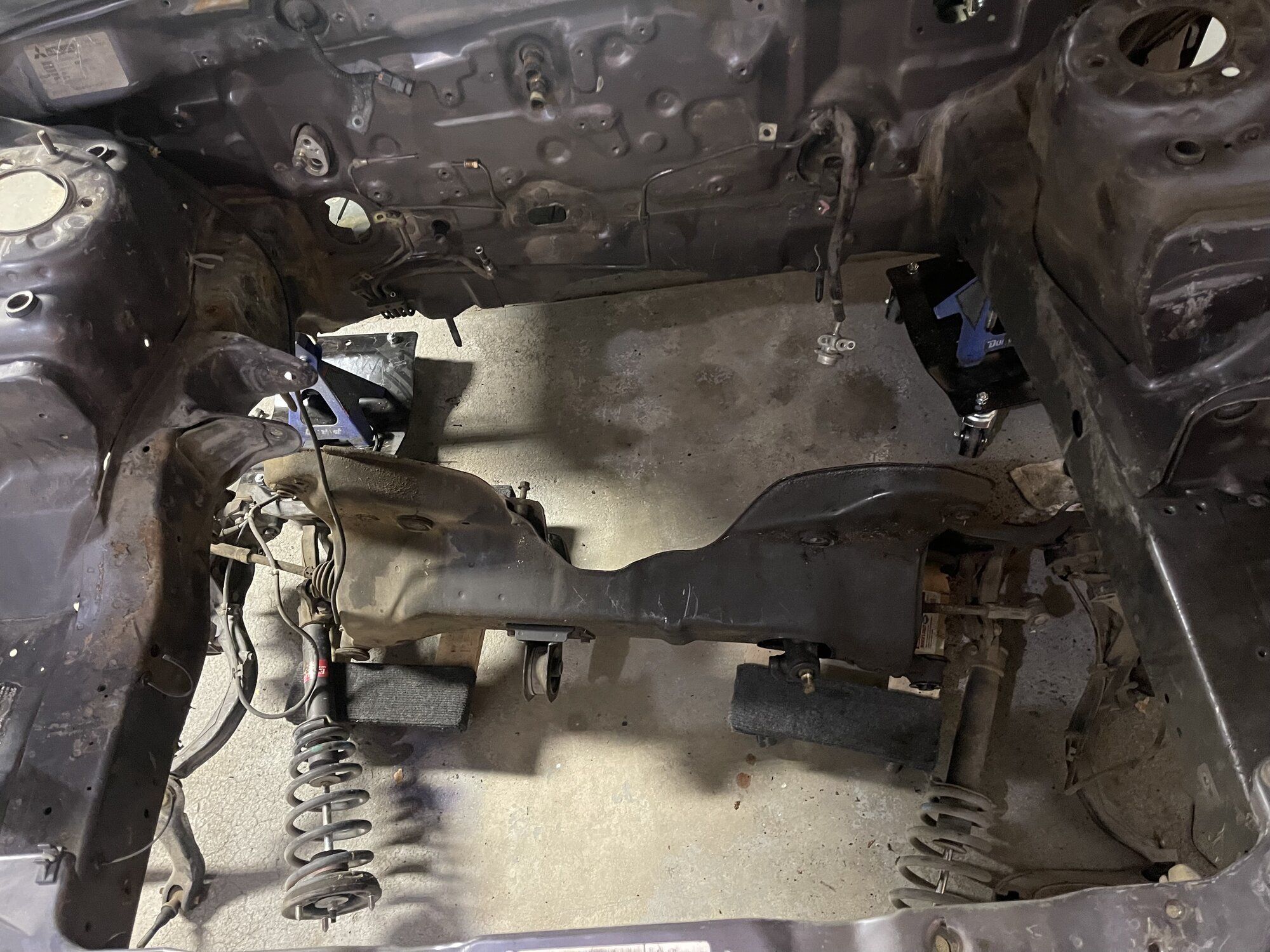

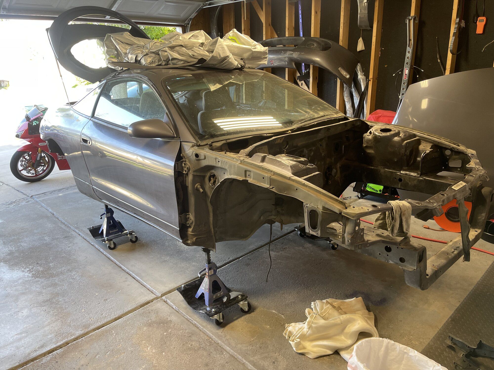

Well, can’t say that I am not putting some work in. After this weekend I know it would be a while before I had a chance to touch the A87 again so went ahead and hammered out some tough work today. Need access to the entire frame to restore it just like the previous A52 GSX so here is the biggest part, dropping the rear subframe. I was thinking, should I create a quick how-to on dropping it??? I remember having trouble finding info on it last time I googled it.
Also, dust shields are in perfect condition!!!
I've never seen a car on stands on rollers... I'm just sayin.
I was wondering how long it would take for someone to point that out! I got the idea when I was using an aircraft tool at work that is very similar. I remember from the first restoration that the biggest issue was once the car was up on jack stands that’s where it stayed and if I needed more garage space I was SOL hahaha. So I put it up on the casters with the stands on it and tested it for a couple of days. My garage floor is level and luckily there are no bad creases to worry about. I will still put a weld bead down on the stands though.
I started to do the same thing but didn’t trust the stability, that’s why I made mine the way I did.

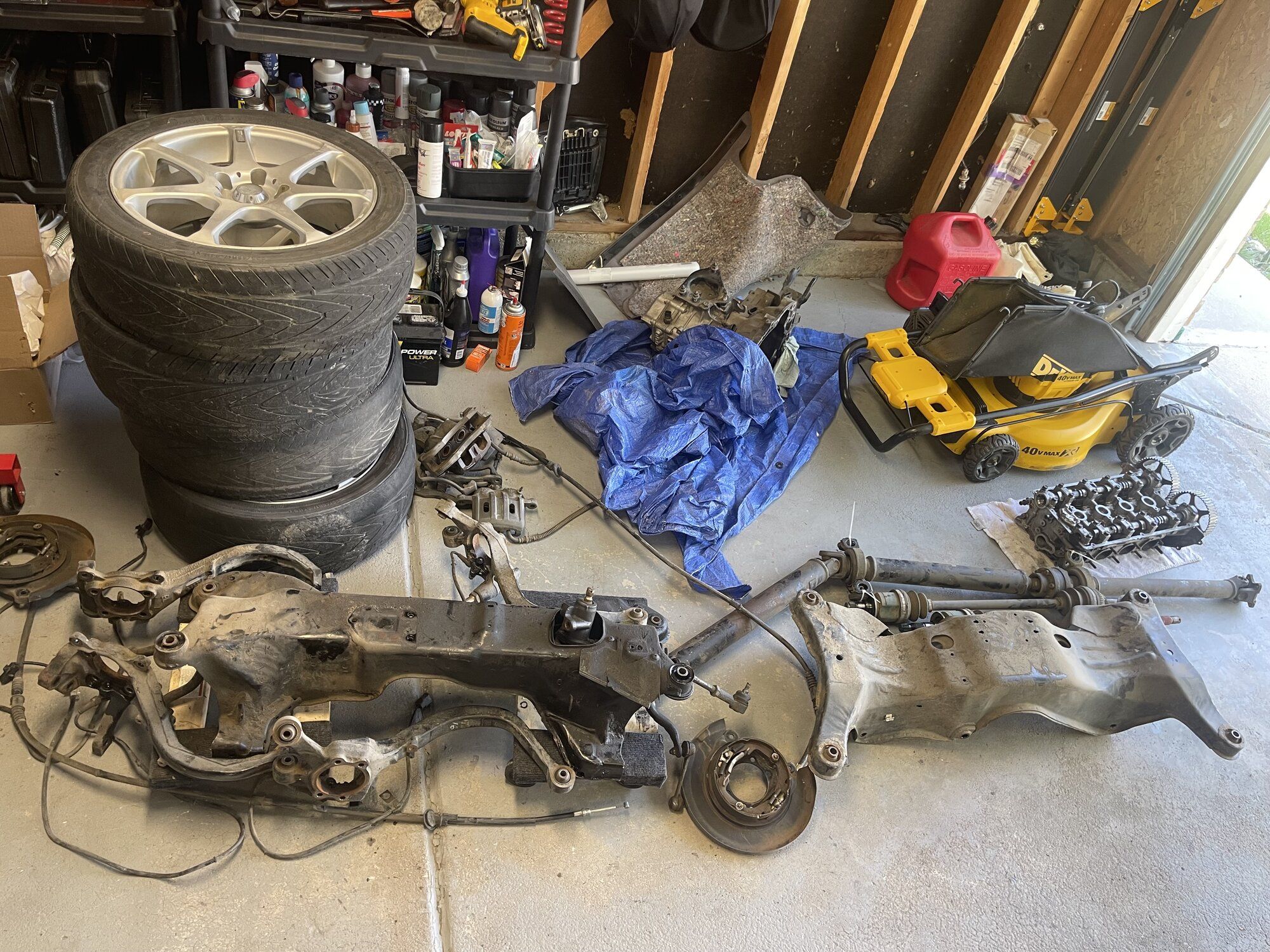

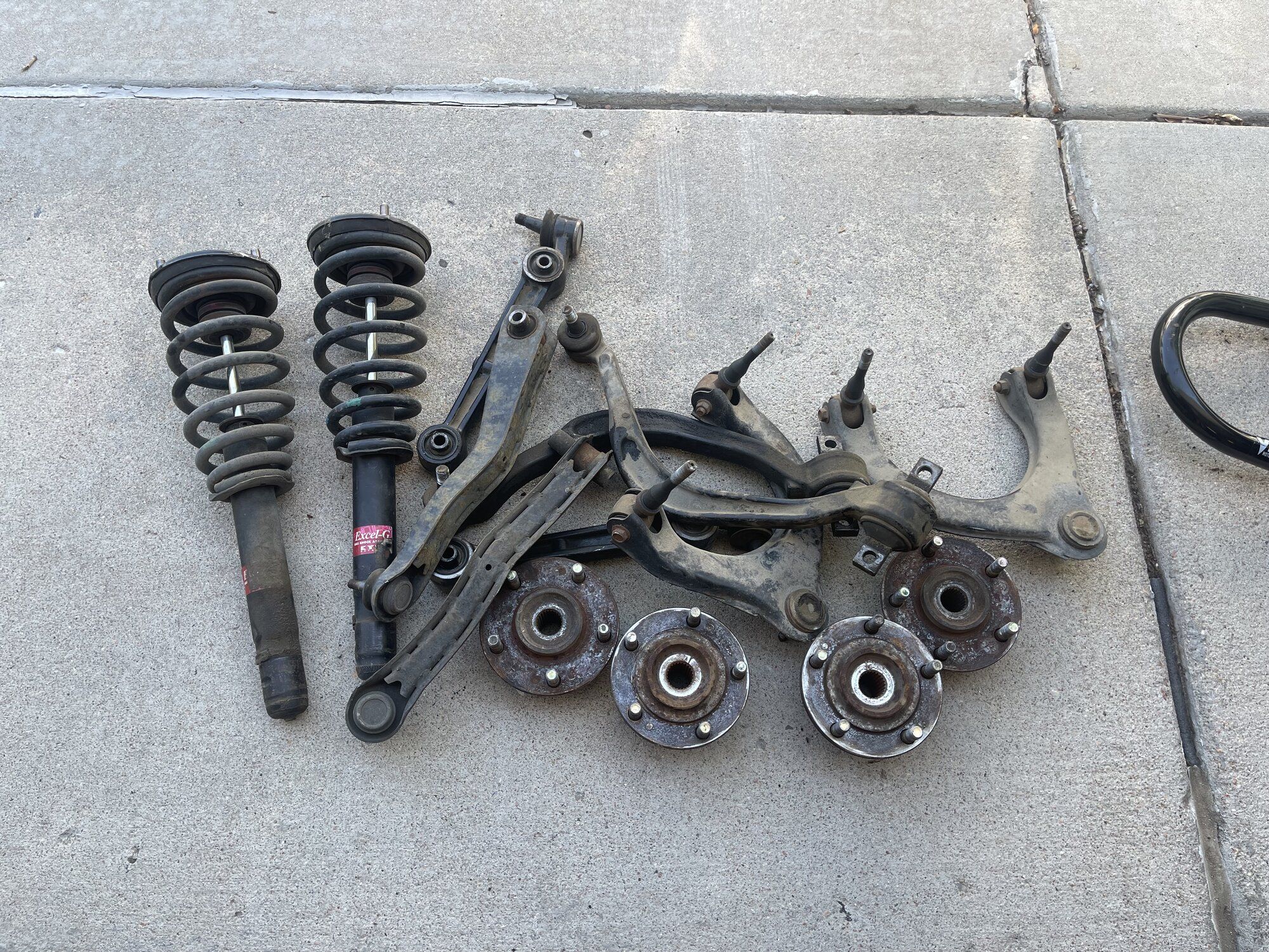

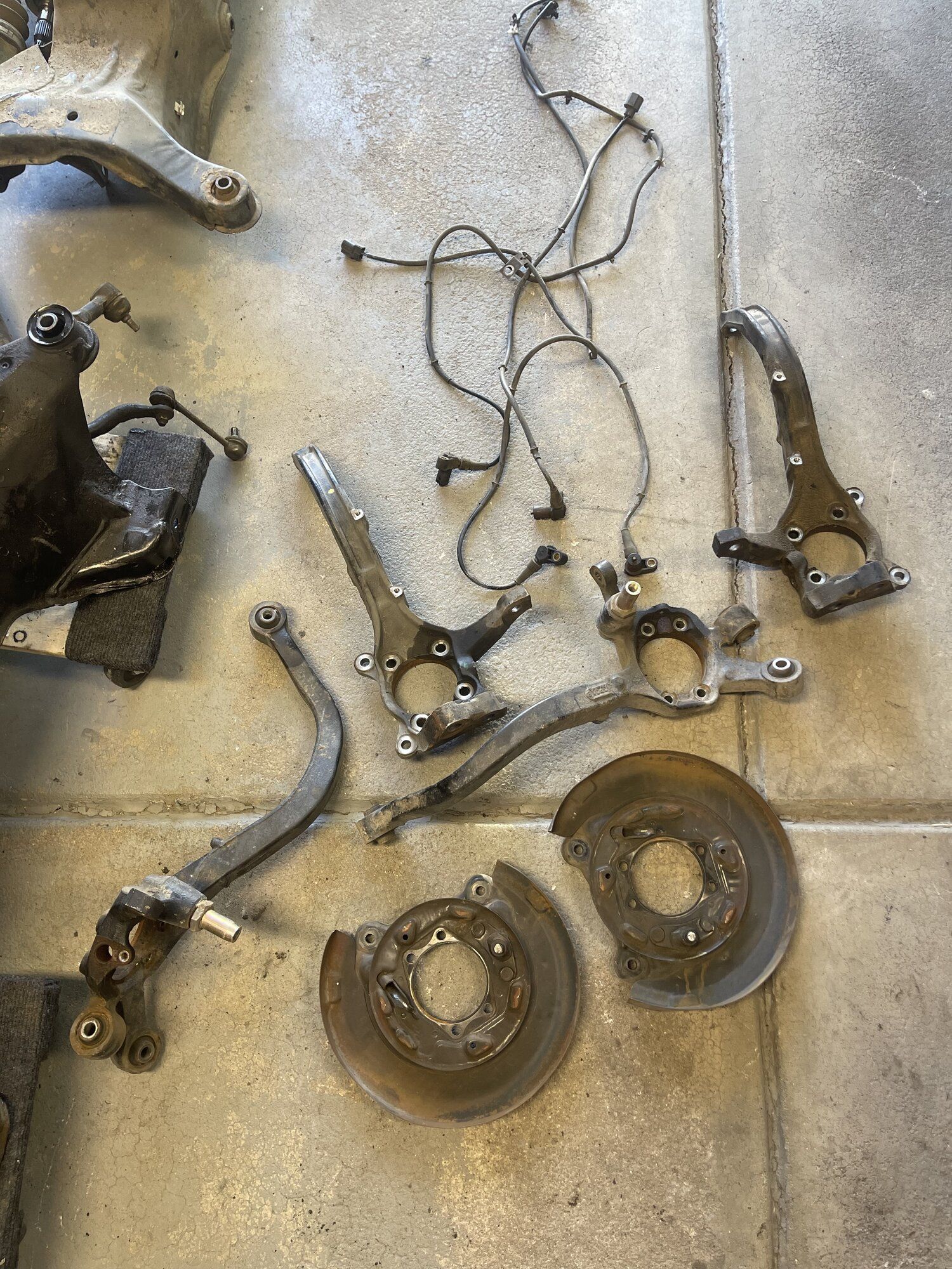

Lowered and pulled the front subframe and broke everything down. Have a nice pile for the scrap bin now as well.

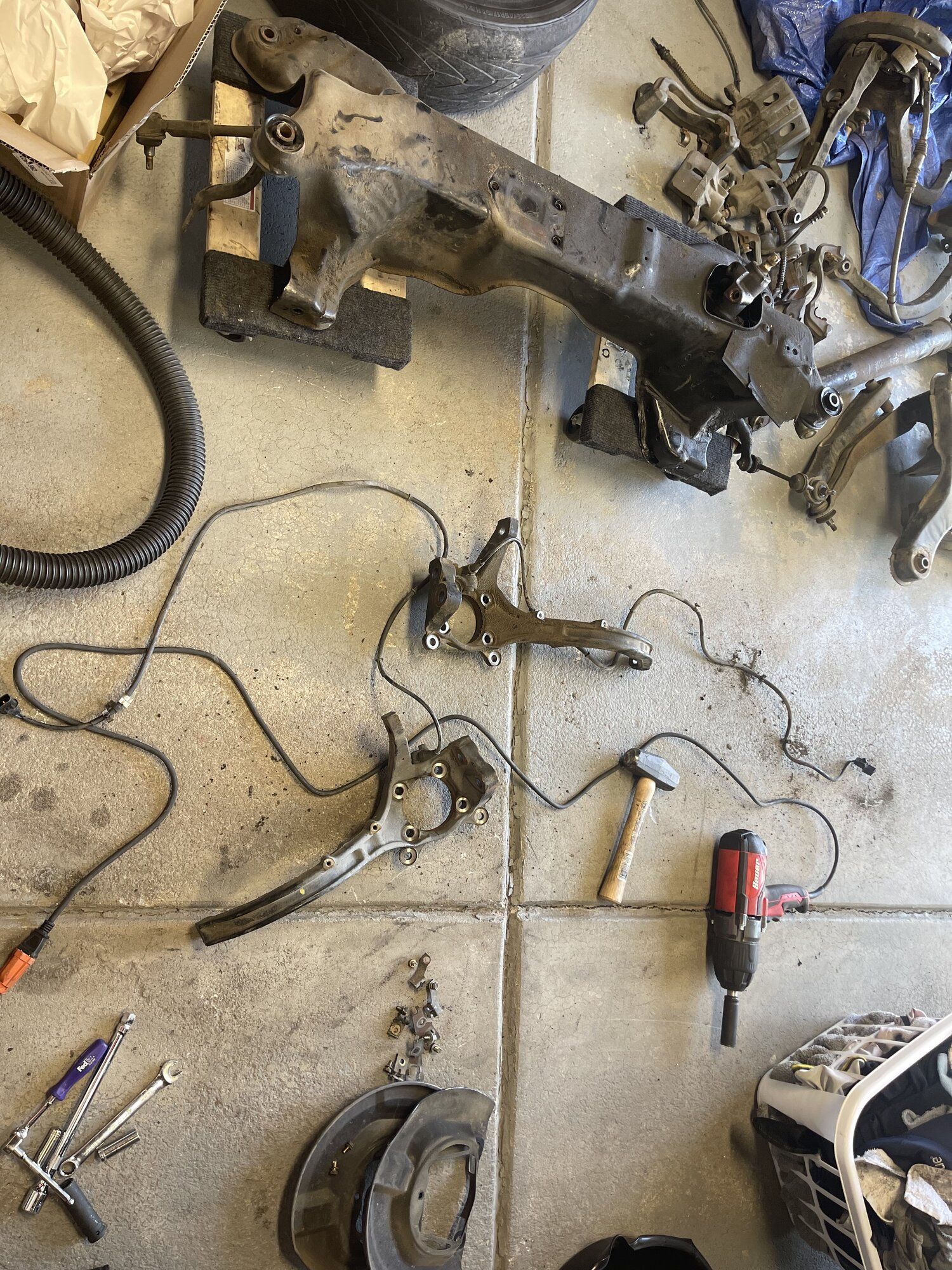

Anyone want to take bets on if the abs harnesses slide out or not hahaha? I have them soaking in kroil right now and a couple of them look OK, but two others looks rough as usual.
Well for those that were curious, the abs harnesses slid right out. No fighting or hammering at all. One little twist and popped right out. Says a lot, to me, about how rust free this shell is.

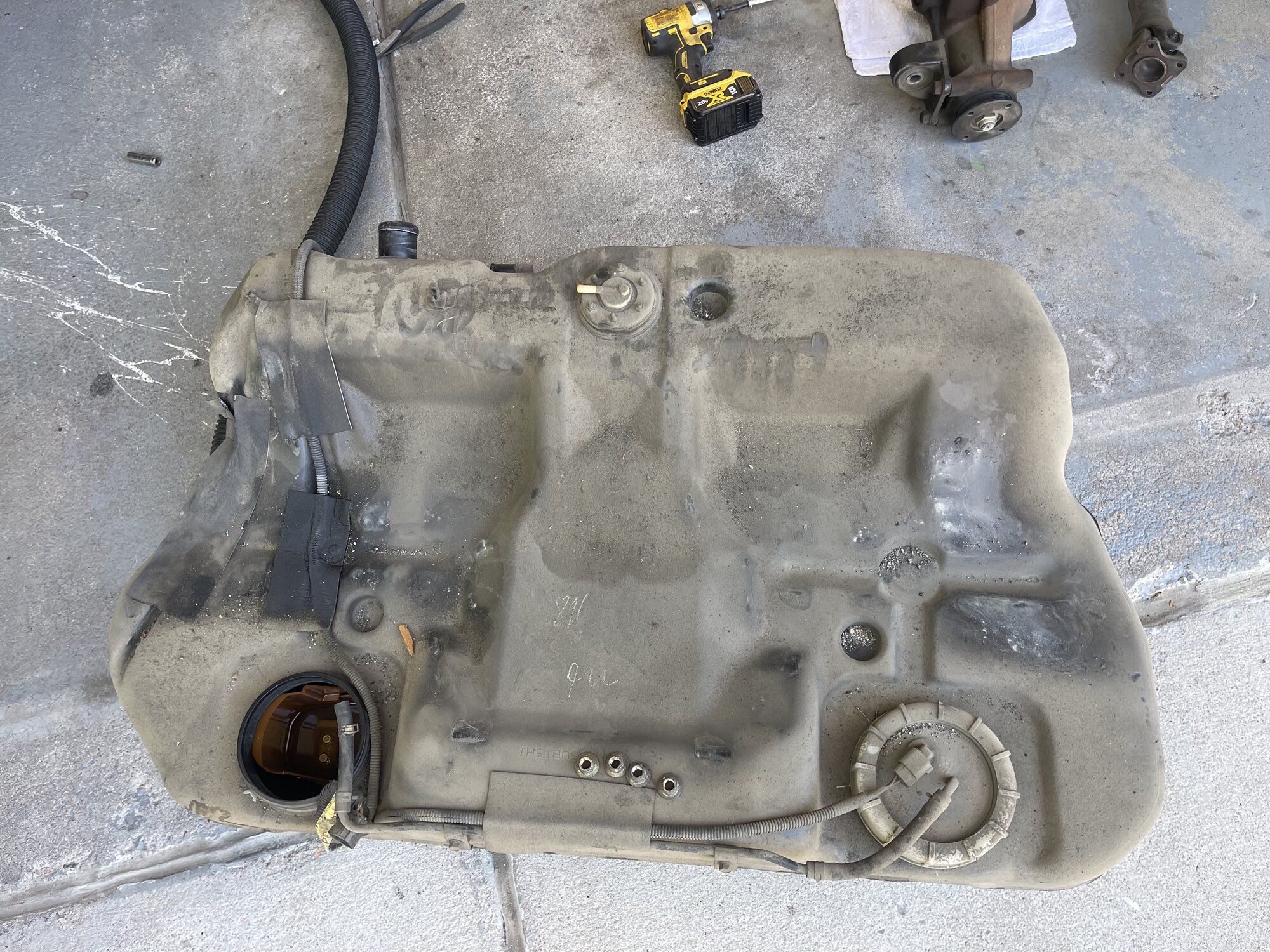

Yeah I have found that I have ZERO stamina still and working in the garage is very tiring. I may have over exerted myself pulling the tank and everything as well but did get it done. I never lost taste or smell but I was vaccinated to maybe that is why. Getting better day by day though.

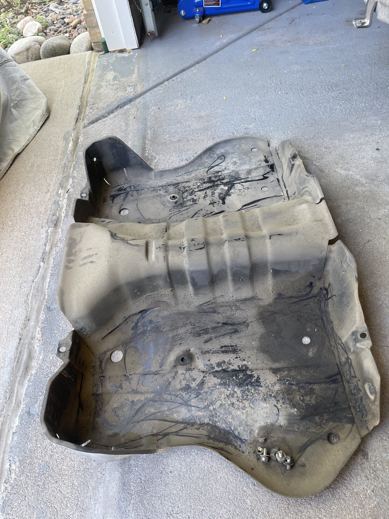

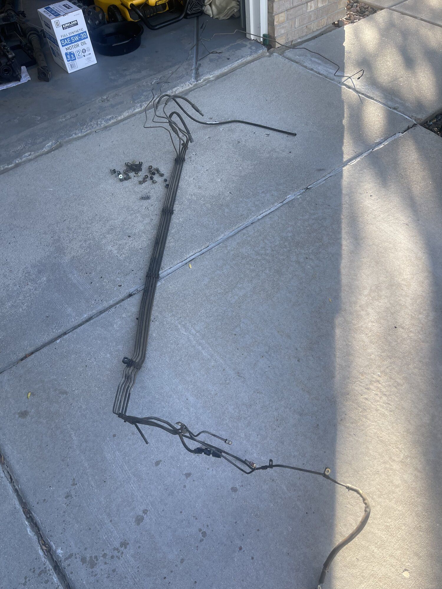

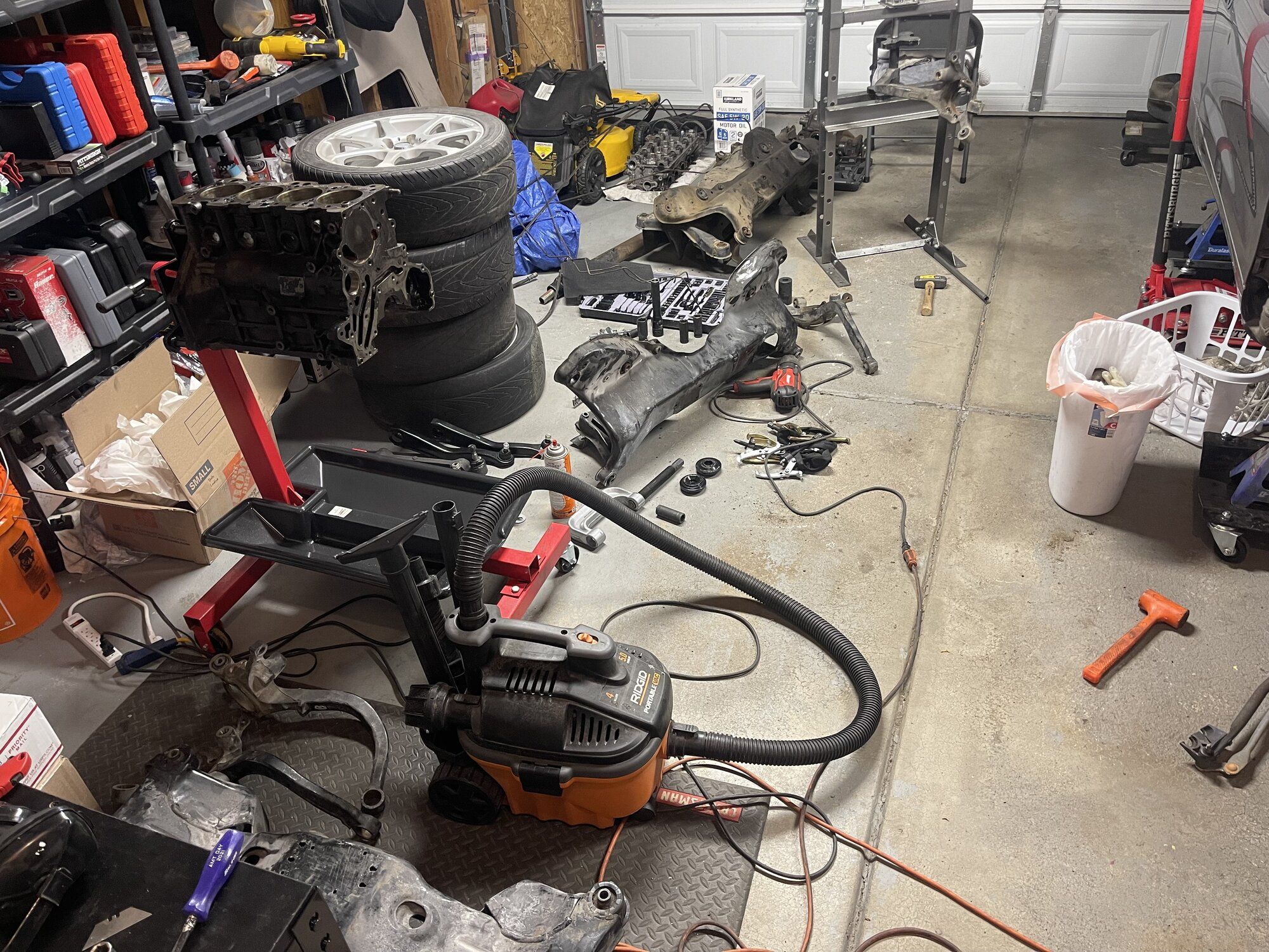

Ok, back at it!! Seem to be fully recovered and did A LOT of the A87 to get it ready for resto. Dropped all the fuel and brake lines since I am running new fuel lines and also need the full access.

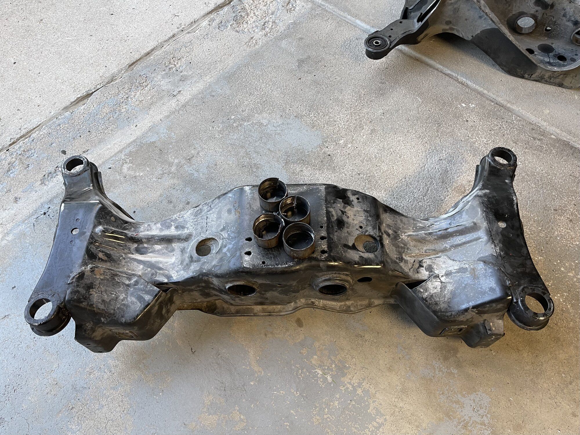

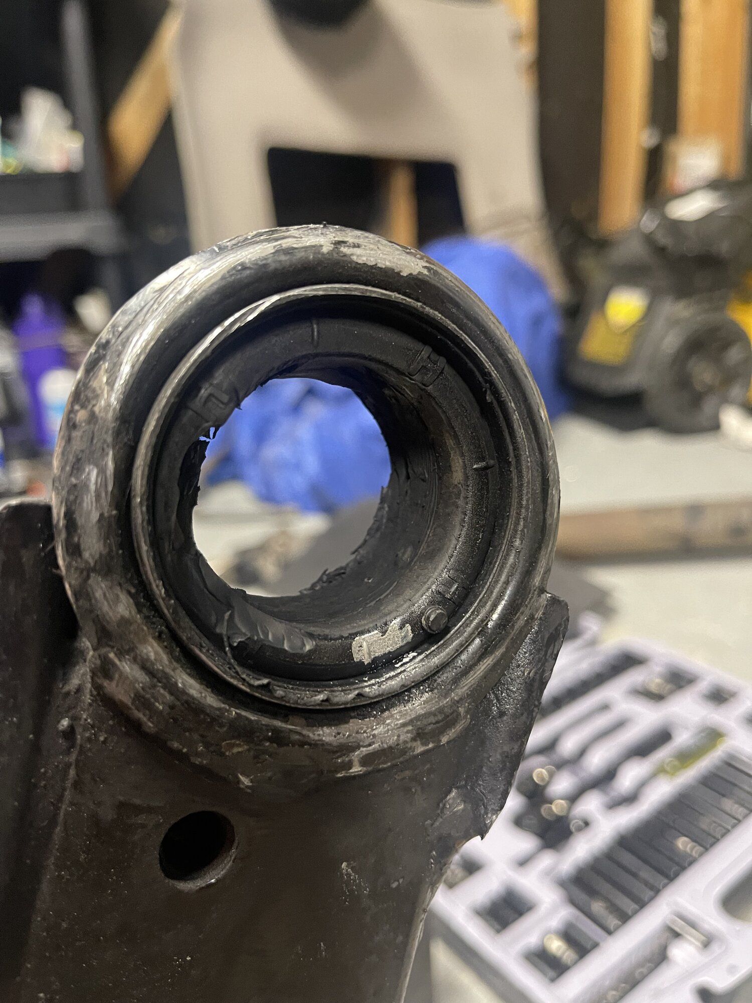

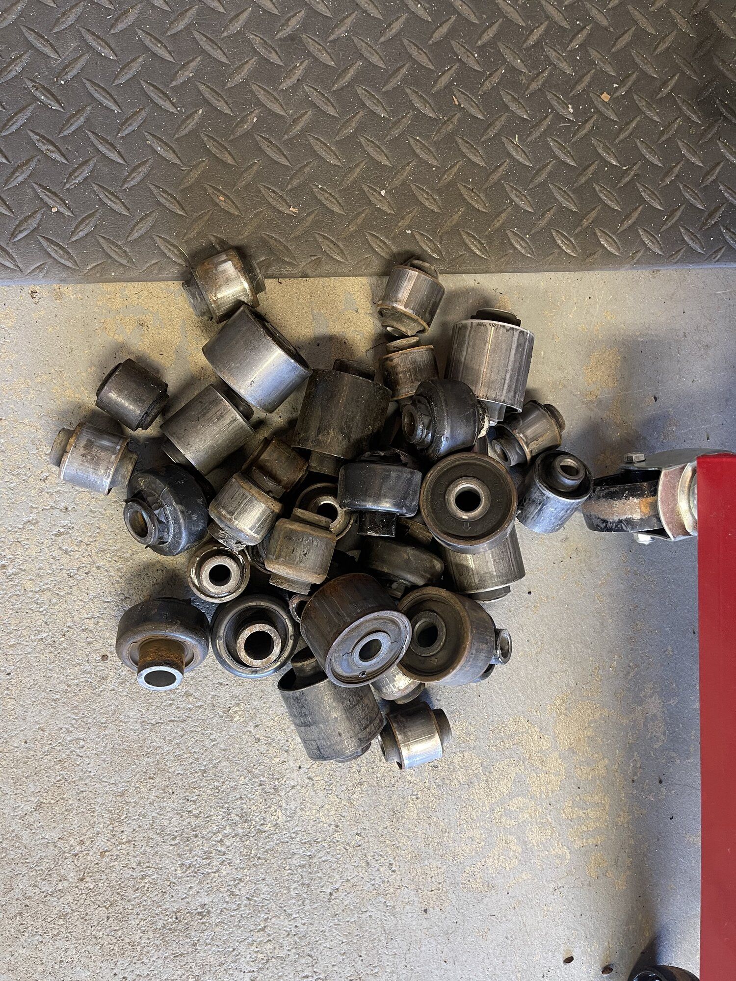

Also has soooooooooo much fun pressing out bushings and helping another member gets theirs out too. Floor press has now paid for its self 10 fold with how much I have used it.
Organized chaos for sure..
Well, definitely had some fun pushing out all the bushings in my build and @bettfootball as well. Some of it takes creative thinking to get them in the press and for others I had to use the all thread and sockets method. For the rear subframe bushings it took even more extreme work but got it done.

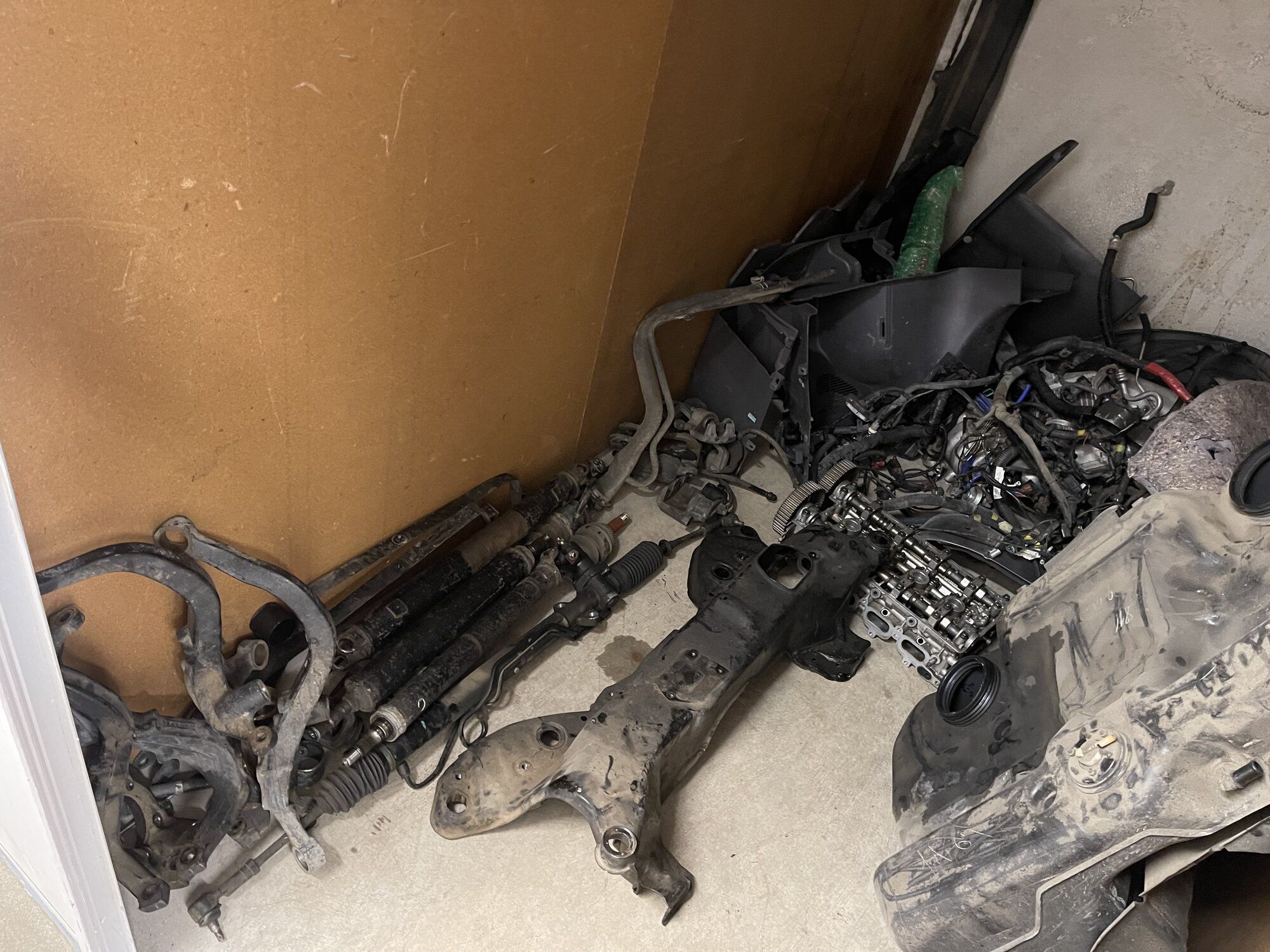

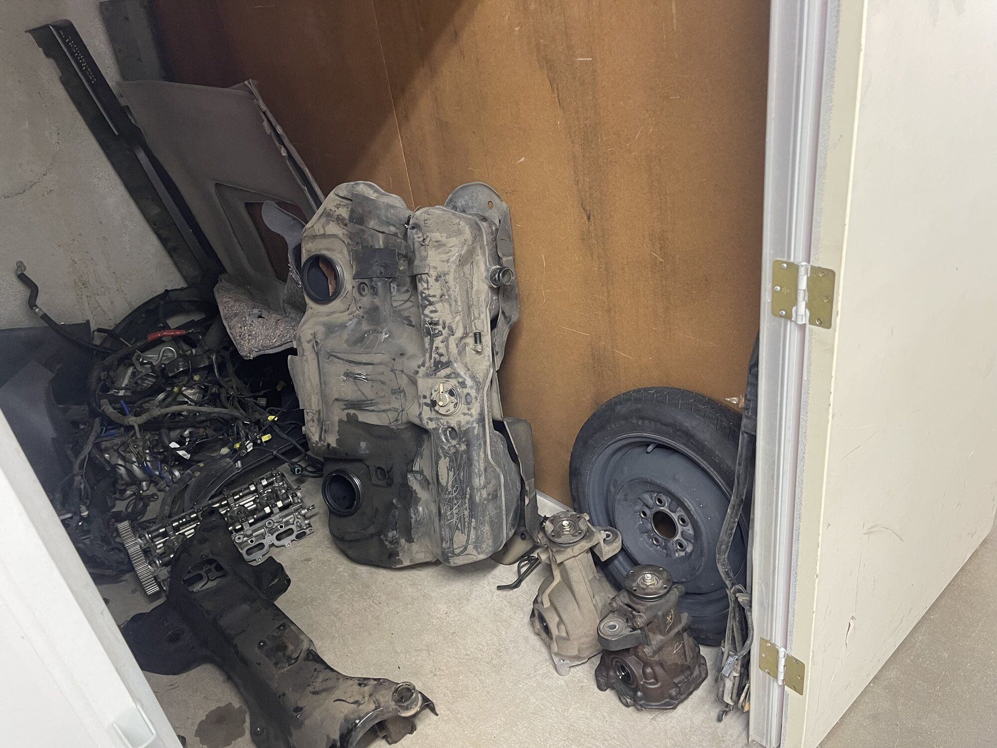

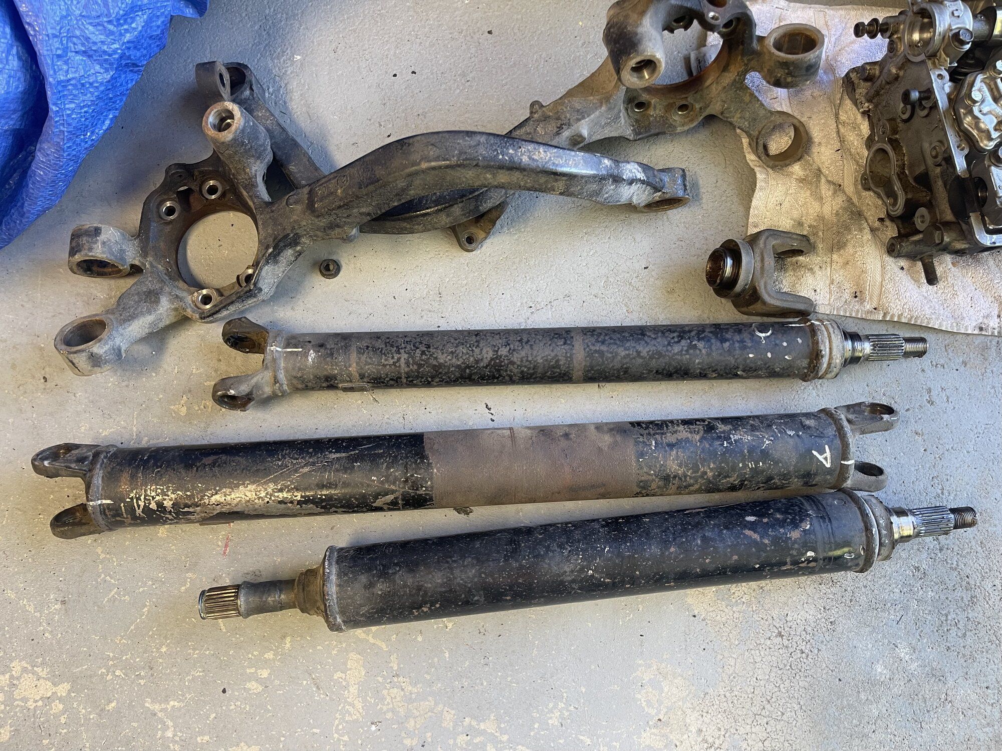

Also broke down the drive shaft and got everything into storage. Last thing to do is pull the steering column and heater core box so the engine bay is completely bare.
