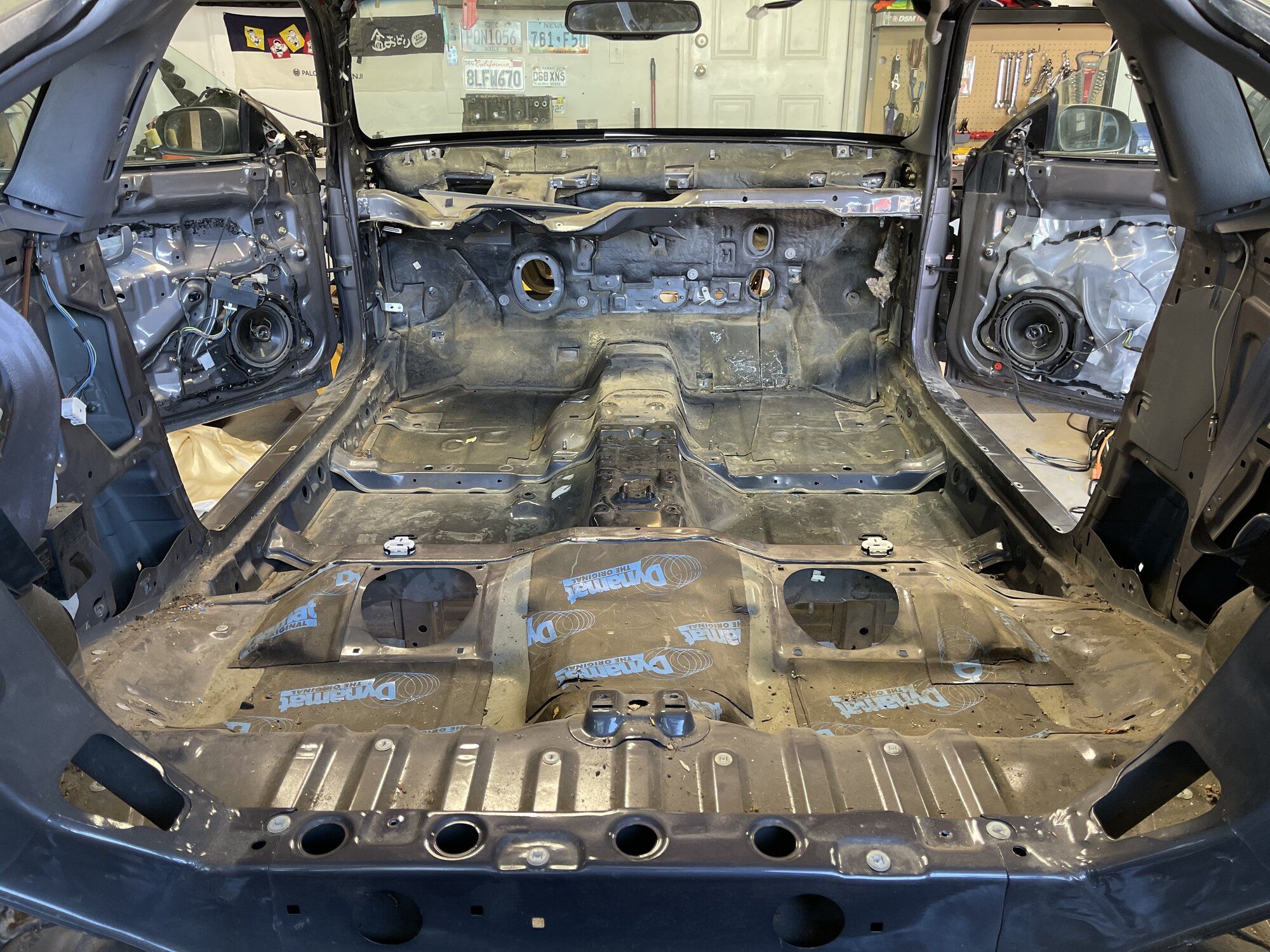

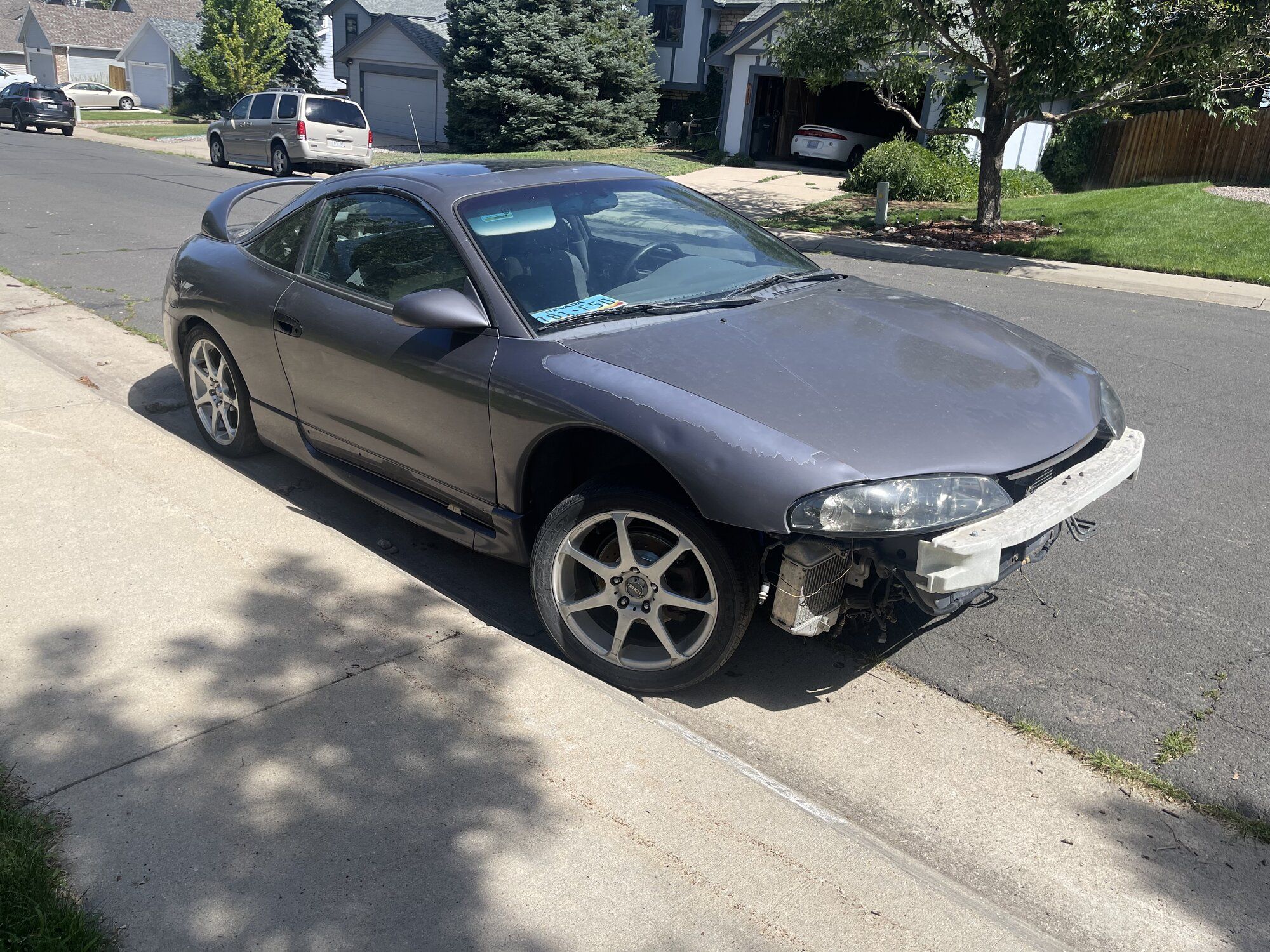

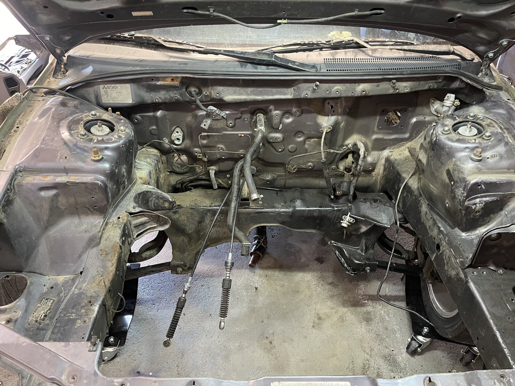

COMPLETED a tear down and complete restoration of my dream GSX. Always wanted the A87 paint code and I finally have the perfect "rust free" base to start with.

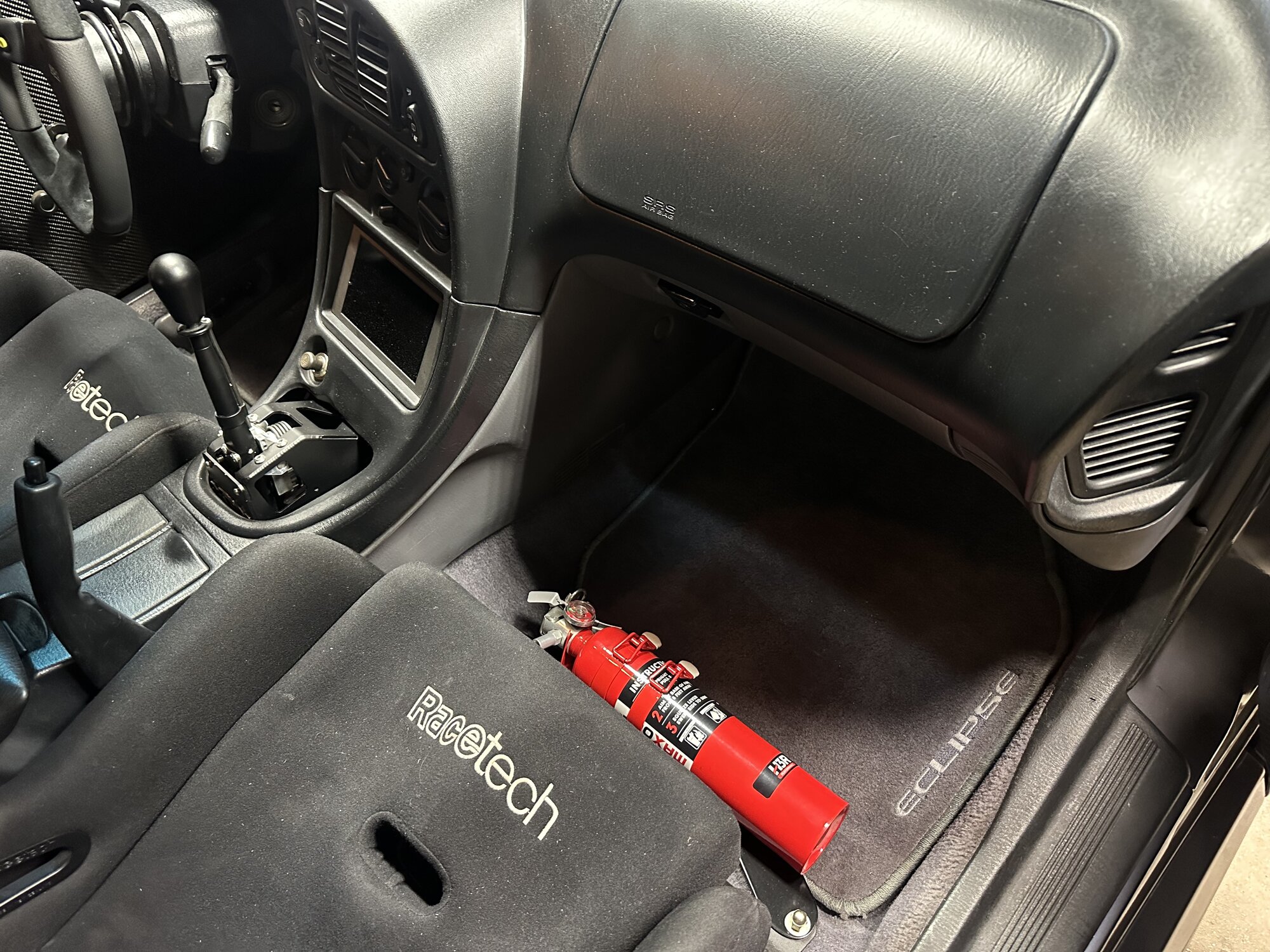

Well it has been a while since an update, buuuut that’s because nothing has really been wrong! So that’s a really good thing. Installed the fire extinguisher since rather have one than not.

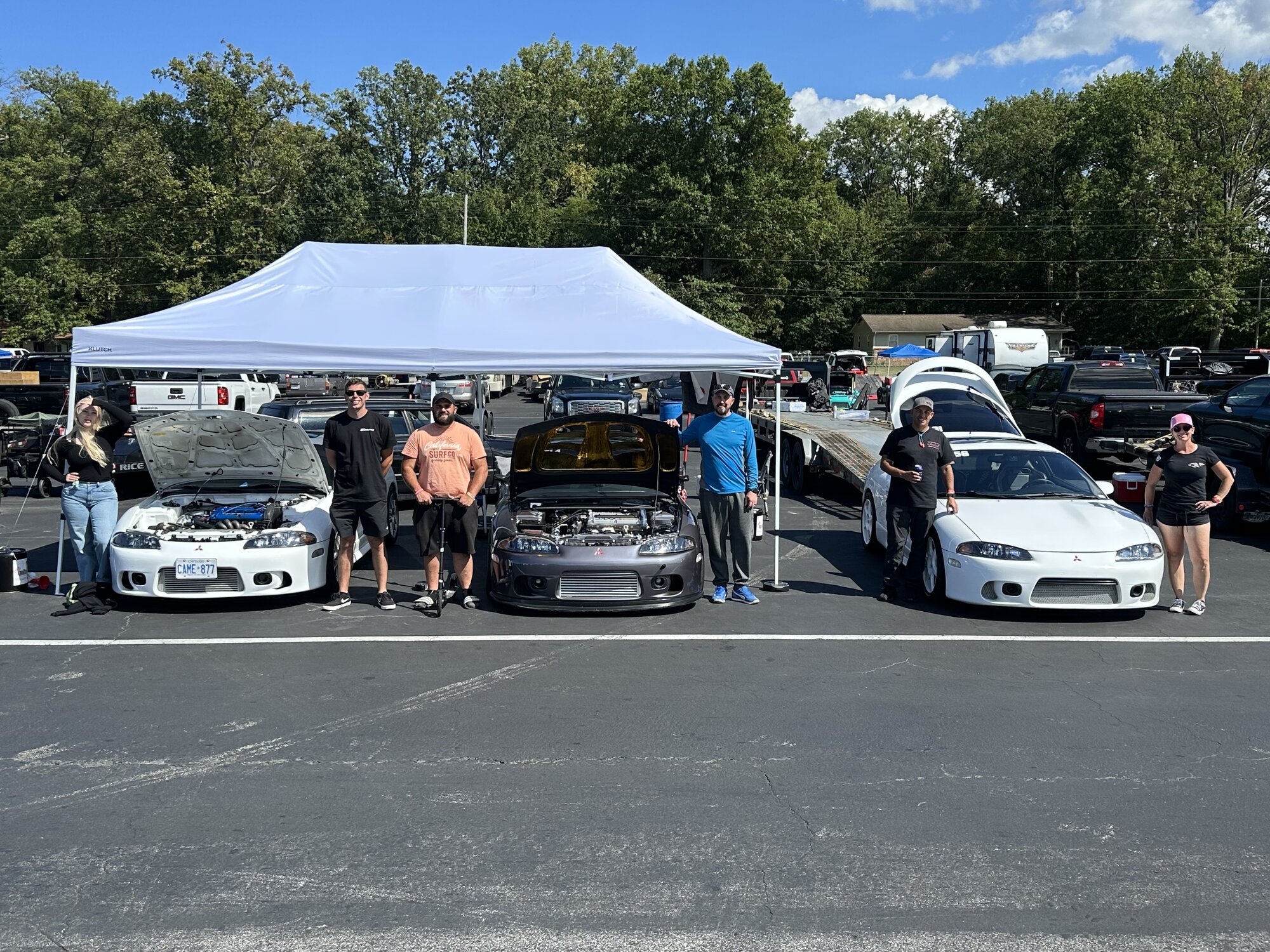

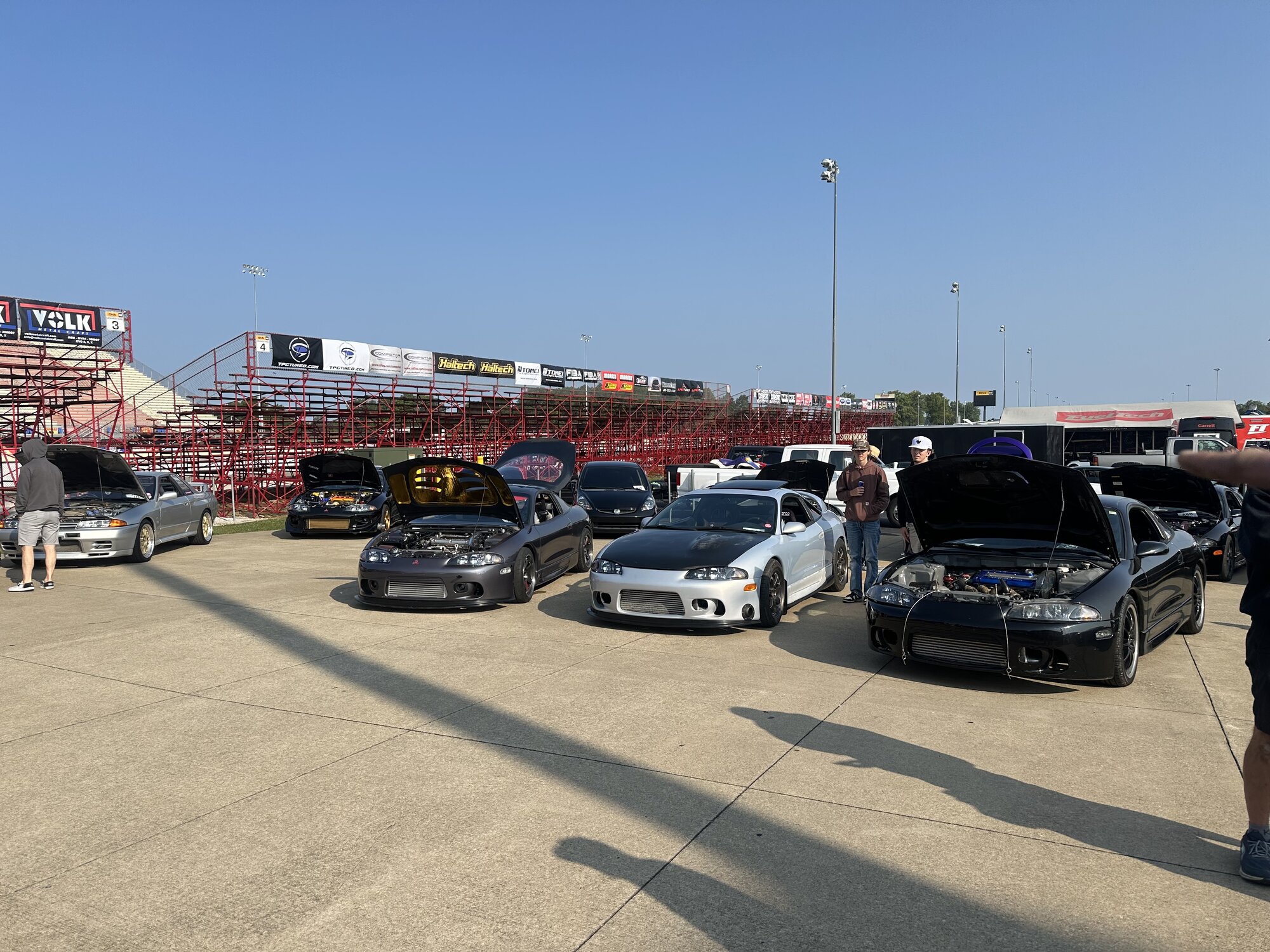

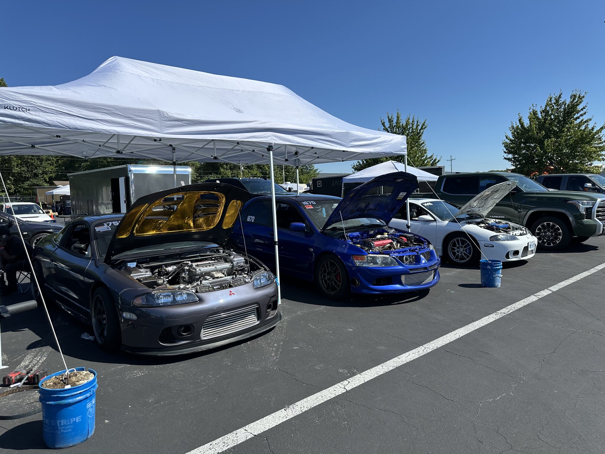

So I don’t want to over post since I connect through all my other media as well but the shootout went VERY well I think, considering it’s a new build and was on low boost. I learned sooooo much and I already can’t wait for the next one. I am going to first and foremost work on my launch and 60ft.. I really really struggled slipping the clutch and light reaction time hahaha. But that’s where pure seat time is priceless. Nothing was broken and I drove it off and on the trailer again!! Win/Win.
Also, HIGHLY recommend poker run to those that have never done it or have taken a break. It’s so much fun and love seeing the parade of mitsu cars going everywhere.
Shootout pics with the top being my favorite. Love my family crew I have found.

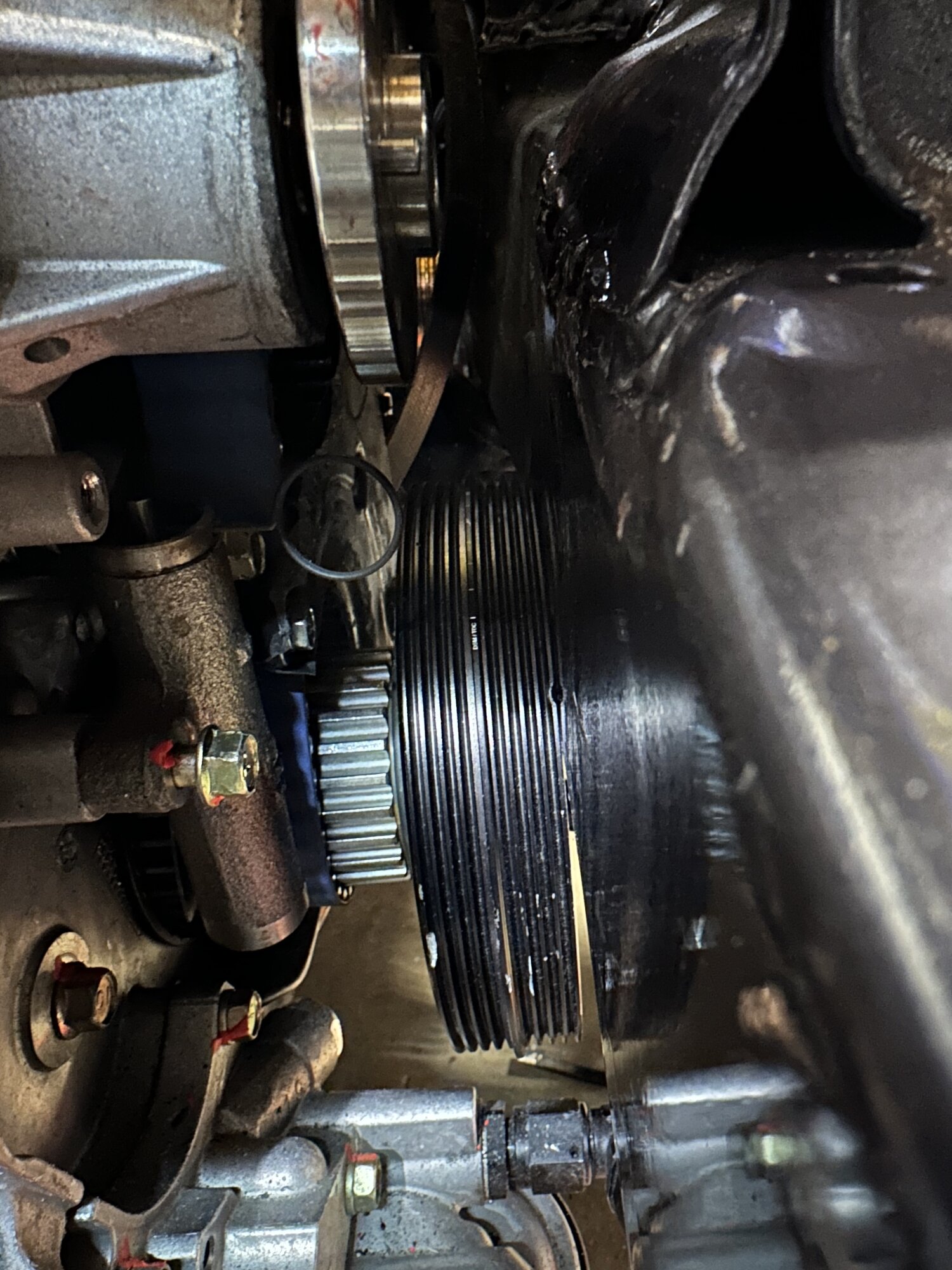

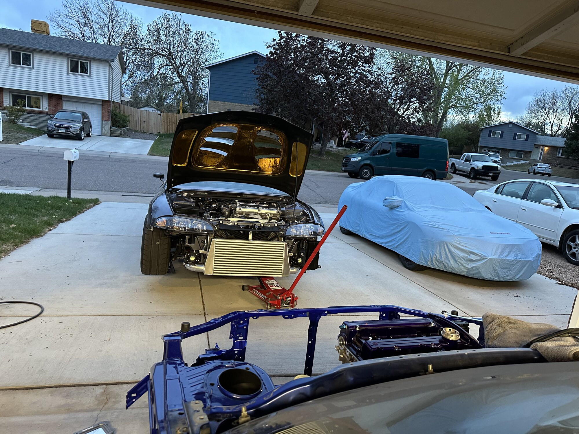

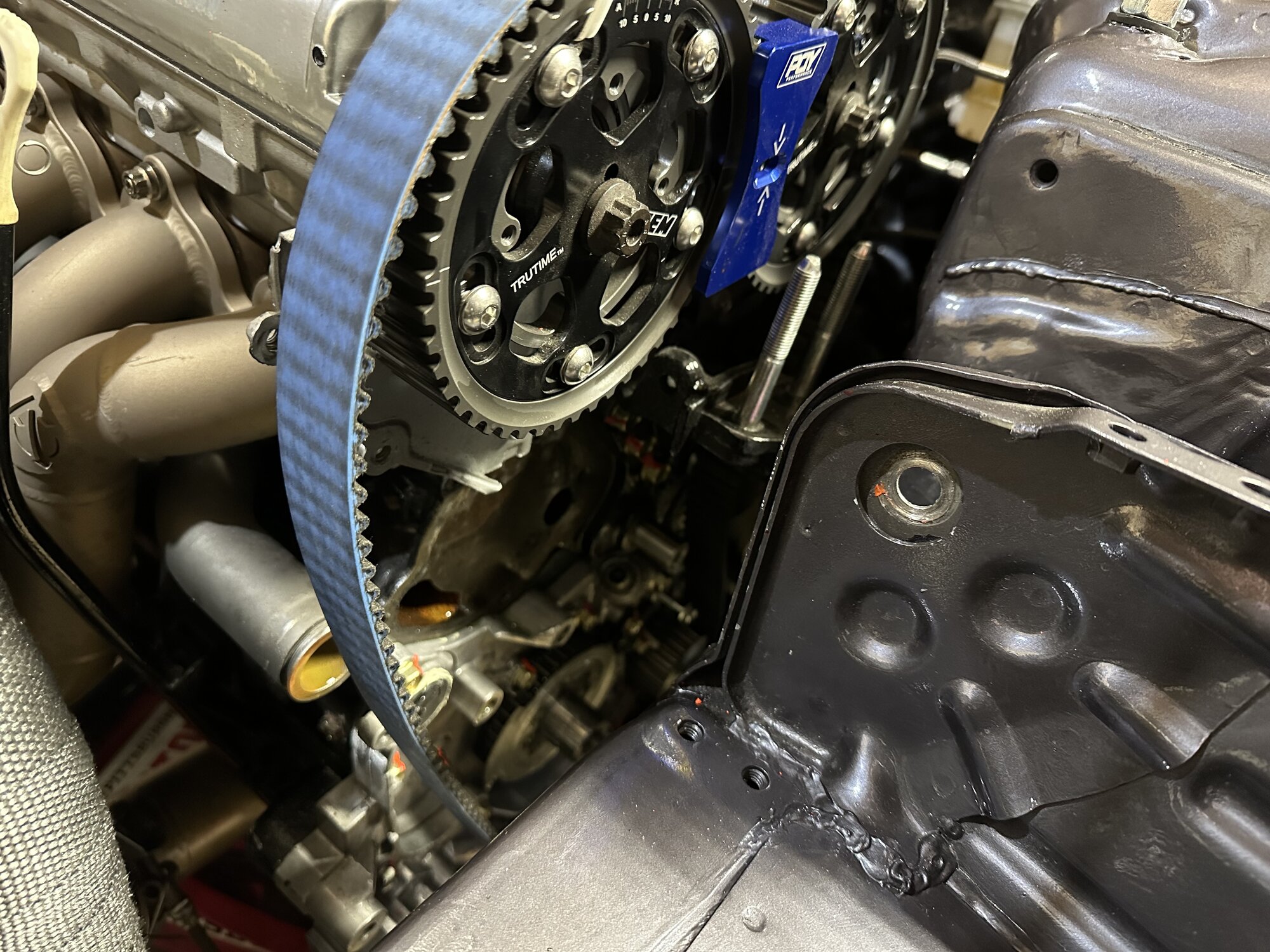

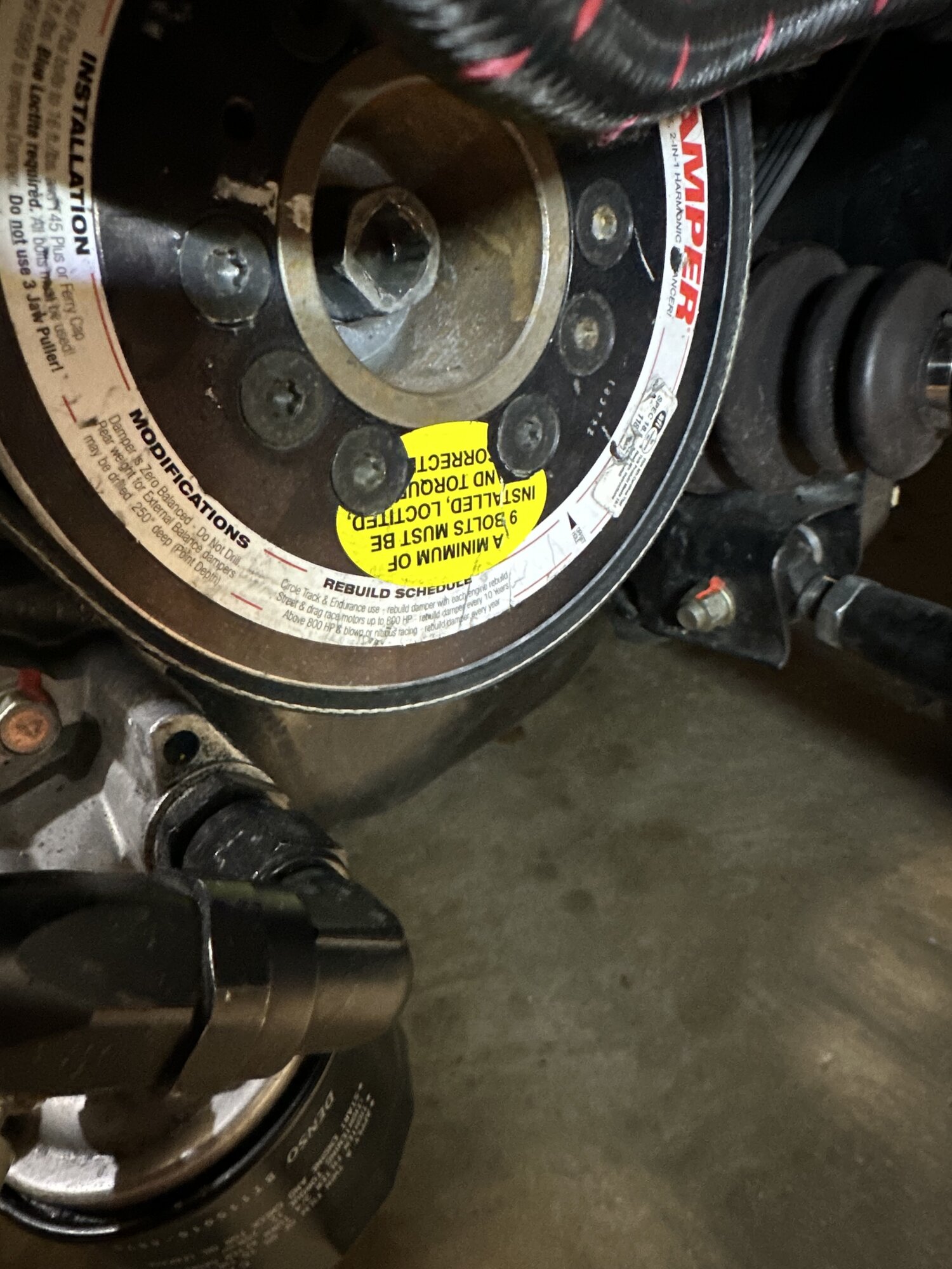

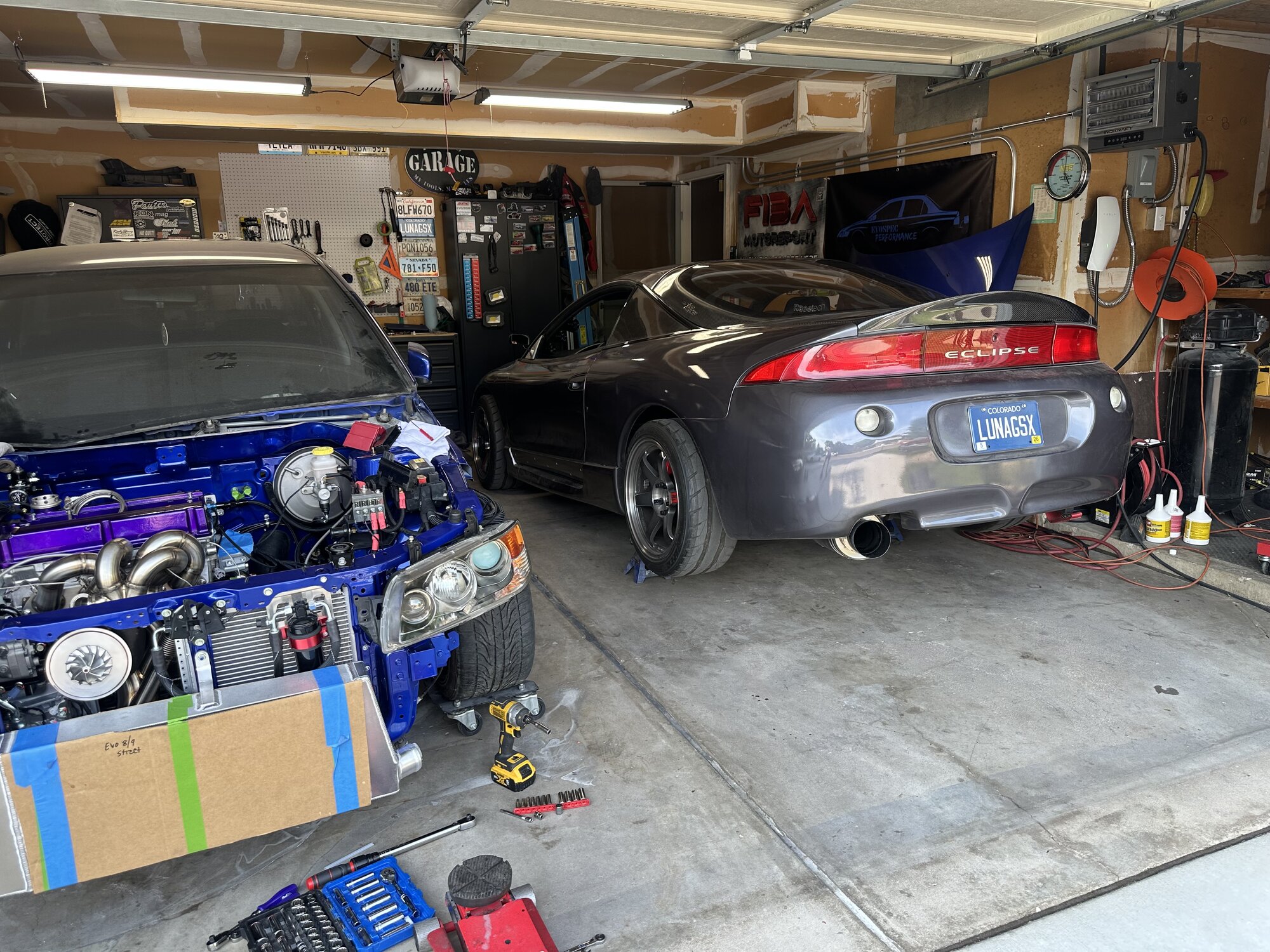

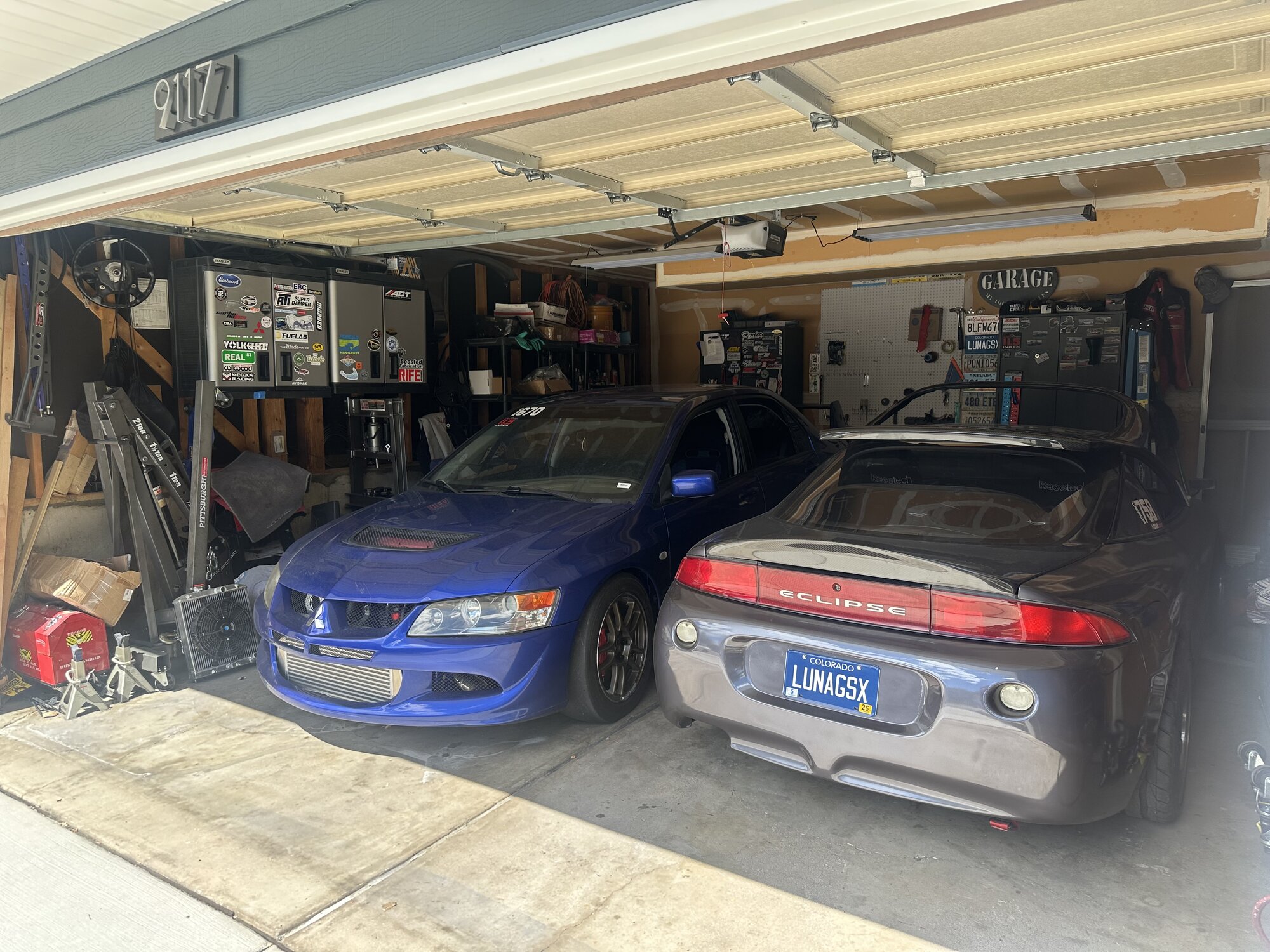

Realized I have not posted in FOREVER, and since I have been working balls to the wall on the Evo, the GSX has taken a back seat. But I did finally get the water pump and balancer issue finally figured out. Was huge, huge pain to get the ATI off and threw it in the trash when I did. Had to drop the motor 6” to be able to get it pulled off with balancer puller. Put a fluidamper on it now. One problem solved. Next will be to get these race seats pulled out and some Evo seats back in. All in time. Here is a photo dump.

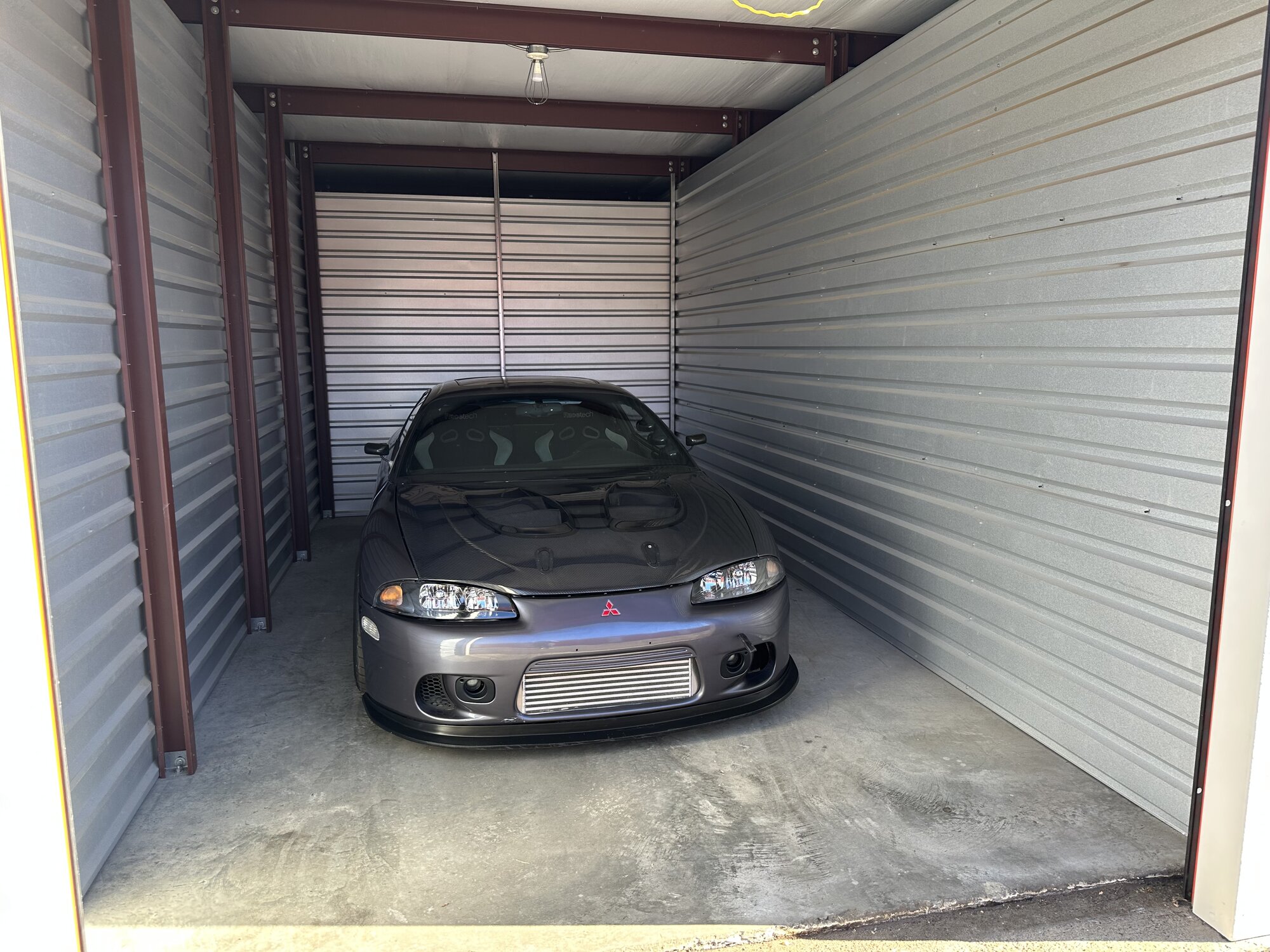

Aaaaaand back into storage she goes..

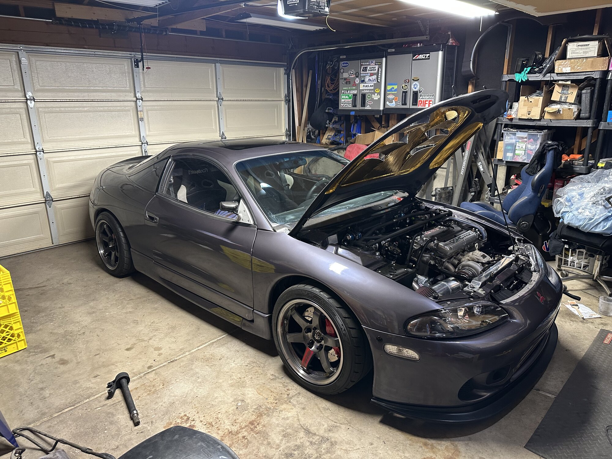

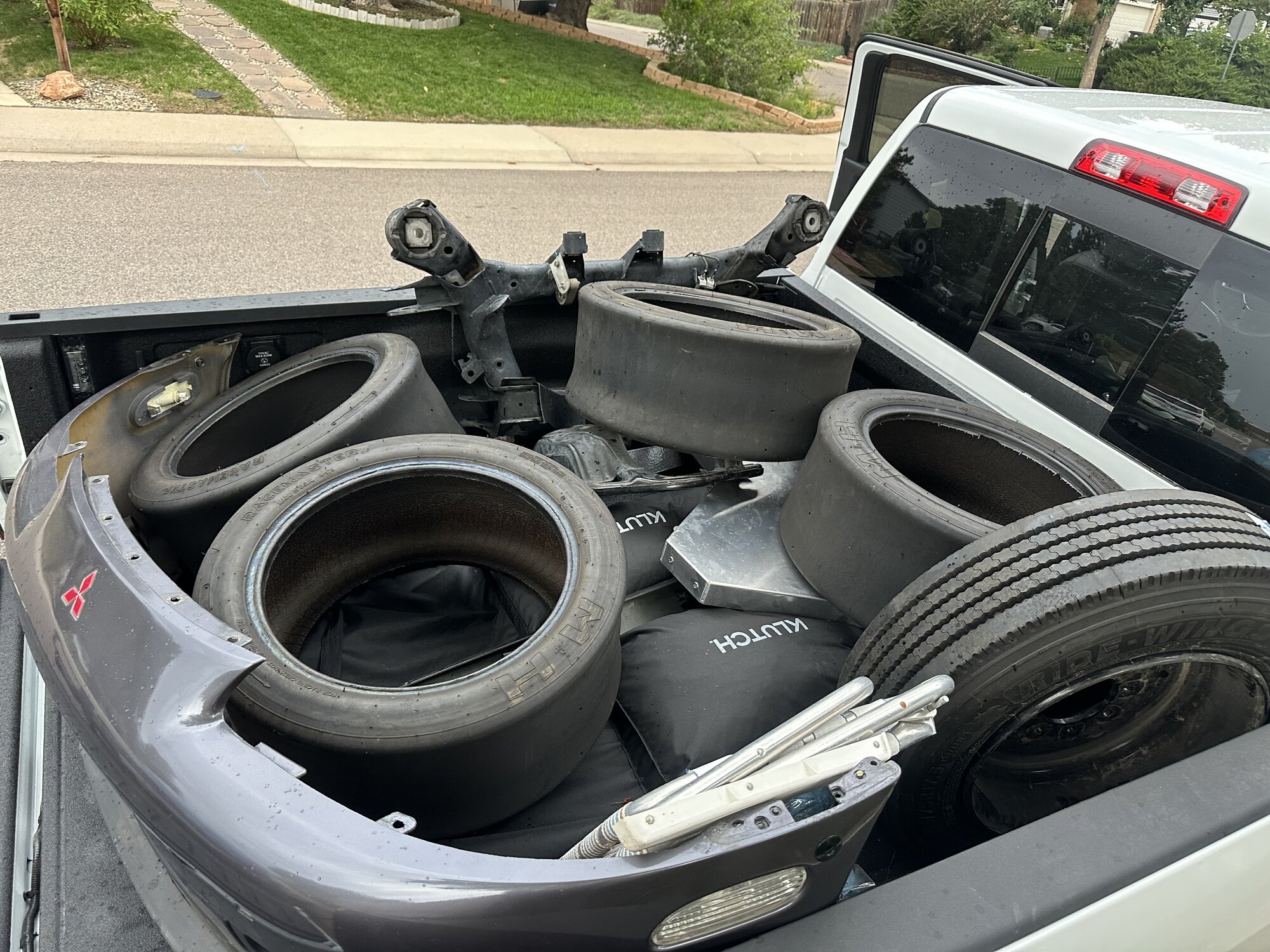

Well, been soooo long since I have had an update. Unfortunately the Evo build is taking up all my time, energy and effort. BUT, thanks to some good dsm buddies I finally for the GSX out of storage and knocked out some things that needing wrapped up. Only a few pics but she is back up and ripping.

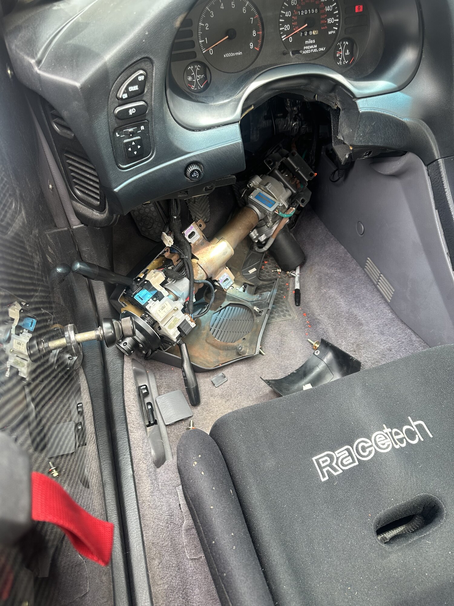

Welp, has a few issues come up I had to deal with. Steering rack joint cap decided to leave the chat and thank god I still had steering. Got another lower joint and welded the caps in this time. Always fun dropping the column and pulling the lower joint.
Next was an issue with the rear end. I thought I had smoked the diff but turns out it was the driveshaft ripping itself apart at the joint from the dss aluminum to oem section. New hardware, some red loctite and paint marker and it’s good to go. Not much to dial in before shootout with the dsm but a LOT do work left on the Evo. See everyone at shootout soon.
