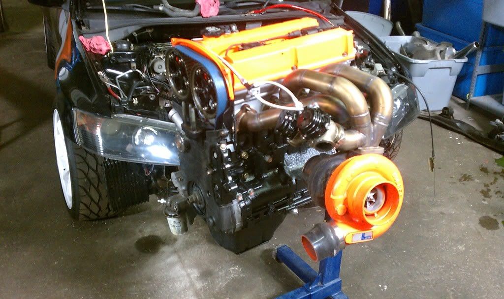

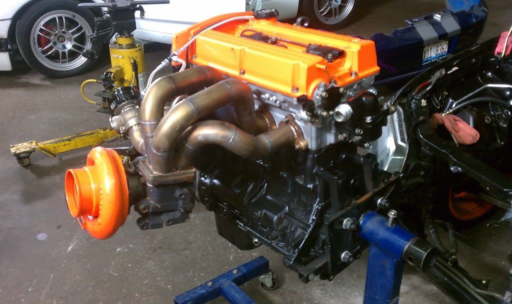

Update for everyone.. Engine is back together fuel setup iris started on and some cleaning in the engine bay taking place. Here are some pics. .. Now we are just waiting on the trans from TRE once we get that everything should come together in a day and be back on the track.

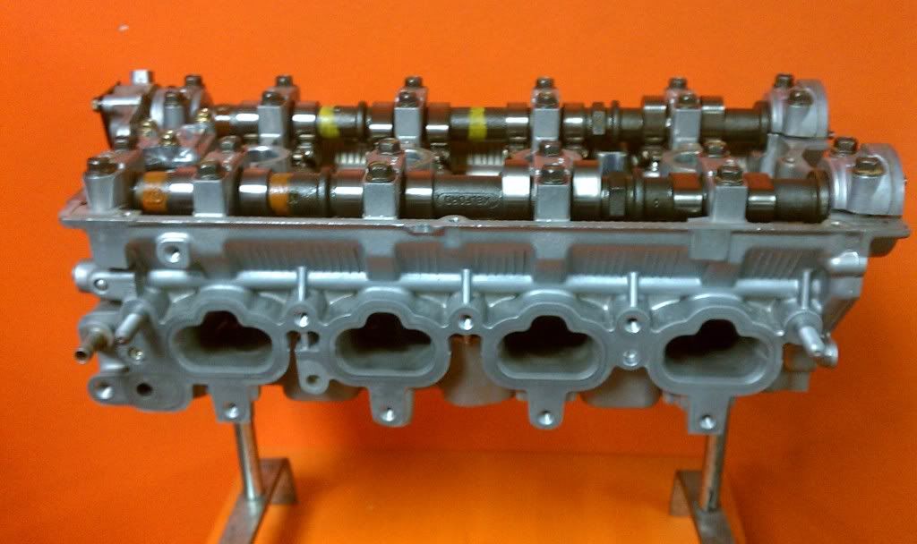

The head

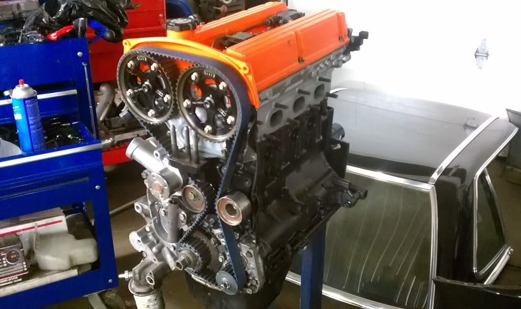

The long block

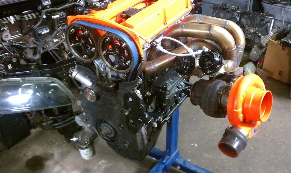

With the turbo setup

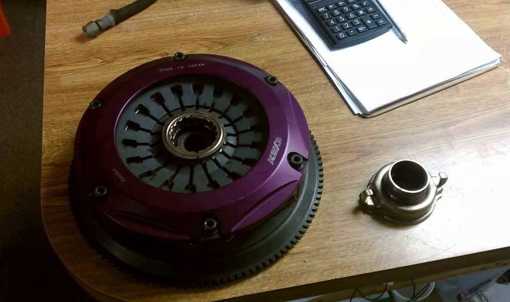

Exedy HD Twin disc
