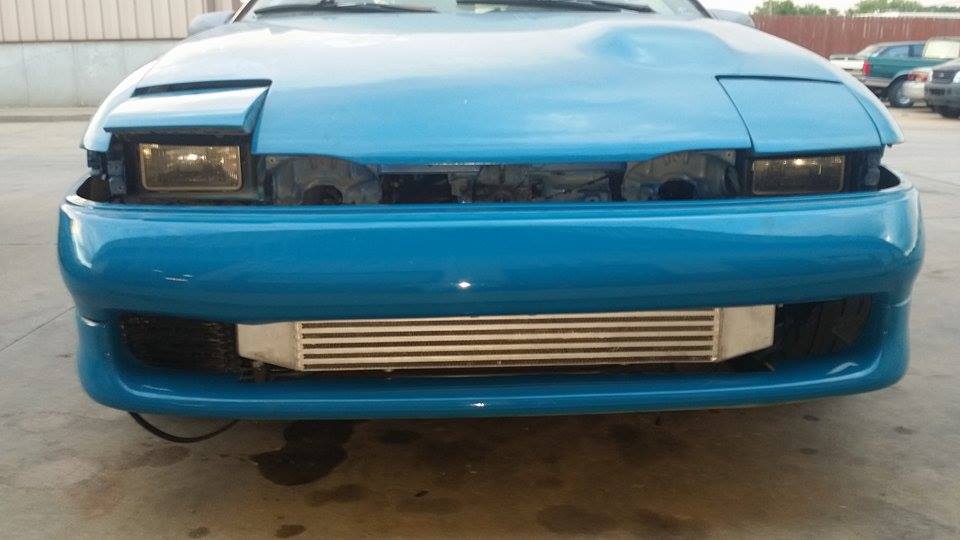

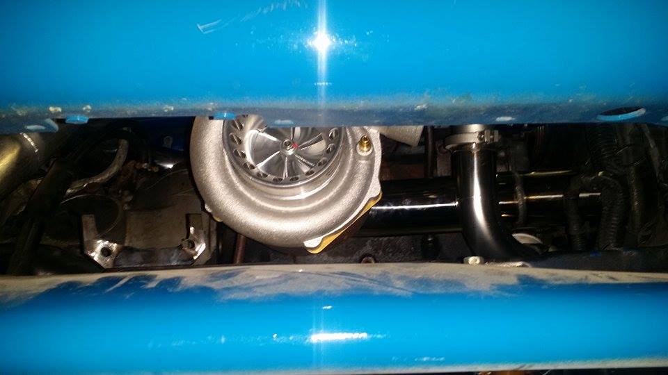

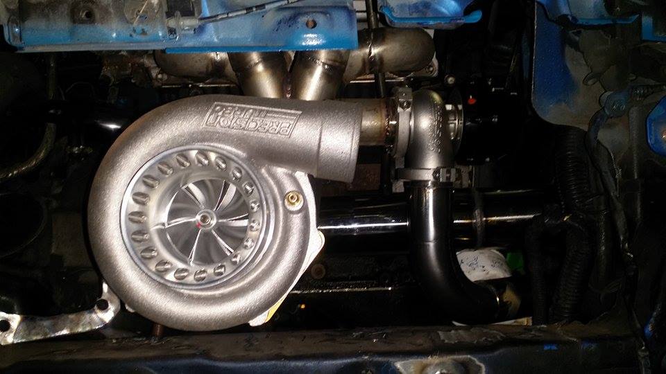

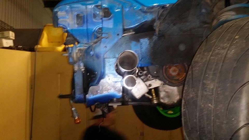

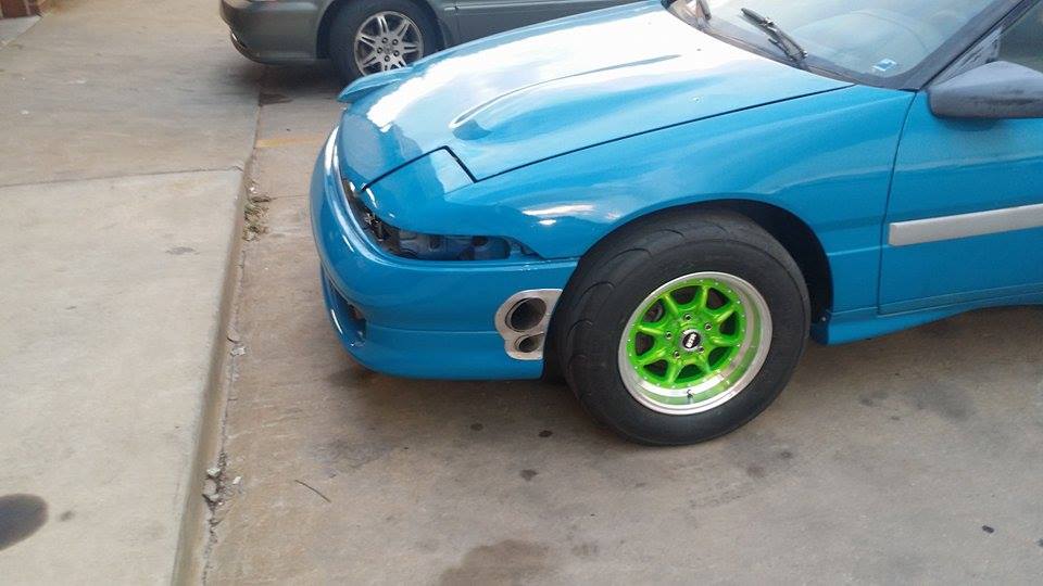

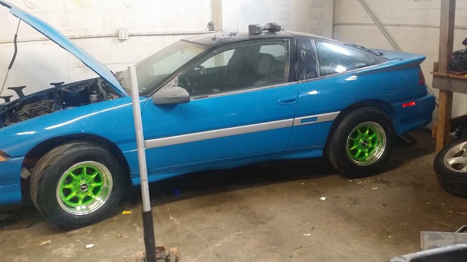

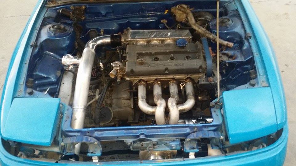

time to bring this back from the grave with some pictures
Looks good, what size/type of wheels are those? I'm in the search for some new wheels for a slick setup.
They are 15x8 25 off set they are str racing wheels cheap but they serve what i need so im not bitching.
Drag radials hook good too. The reason I use them is mainly that they don't run out as fast also driving on slick on the street can get wobbly from time to time.
