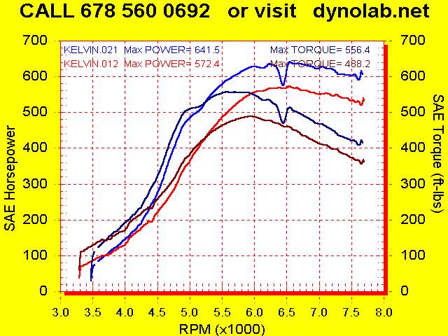

That's awesome if its working no need to fix! I just couldn't find success with them! Comparison pte 6266 cea dbb .82 ar blue line vs comp 6467 extended tip triple ball bearing billet wheel ct4 .63ar red line almost same boost pte clearly was superior! This is my setup. Keep up the good work on your build you have an awesome vision!!
Yeah I'm just basing my experiences but if you look at my old setup compared to anyone running say a GT4202 my Comp put them to shame and has always spooled up very fast and I have never had one issue with there turbos period! :hellyeah: Thanks its a work in progress but I'm hoping the end is near! :thumb:
I feel ya and I think it speaks volumes when it comes to your setup. As I look over your build you seem to know what you are doing and your parts seem to be well chosen. Just don't close your mind to your turbo options, is all I am saying. I personally don't think comp imo will get you into the 8s their turbos are just not engineered for the smaller displacement 4g63 engine. Supras yeah but dsm no. You have to really tach the heck out if their heavy billet wheel to make any power not to mention bad boost recovery in between shifts I think you could have ran close to 8s and maybe could have trapped 170 on your old set up with another turbo bedsides comp IMO based on my own personal experience with them.

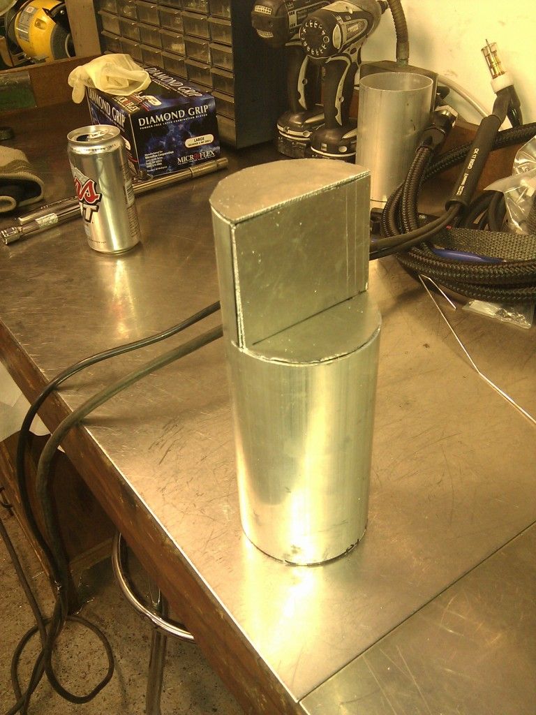

Was looking at the chute lever that came with my chute and decided to change it up alittle :)
Think this one looks a lot nicer :)
Then while I was at it thought I might as well make a new detachable chute mount and light weight chute holder
New chute lever and chute mount look awesome! :thumb:
Thanks I know I shouldn't be waisting time doing stuff like this because I need to get the car back together but now atleast the whole chute system is complete :) :hellyeah: I need to get some more fab work and wiring done next days off and then I should be getting real close!:hellyeah:
