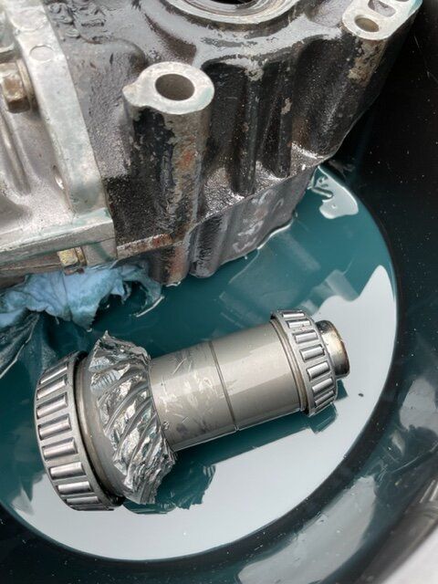

  • Took the car to Cecil County the next weekend - Went 9.13 on the first pass, won first round in Pro Dial but broke the rear diff at the hit second round

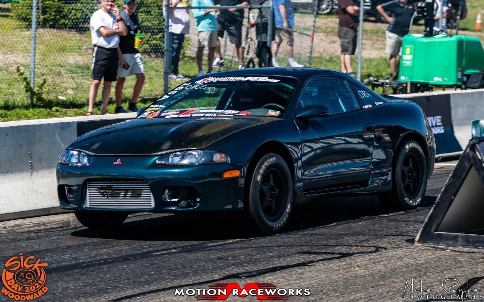

  • Got invited to Roadkill Nights and got to race on the historic Woodward Ave - Ended up making the top 8 in small tire out of ~150 cars but lost to Mt Dew first round

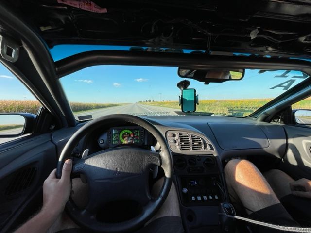

  • Put a bunch of street miles on the car on the streets of Detroit going to/from Woodward.

    • The rest of the week went incredibly uneventful for us, long drives, late nights and some great times. We ended up putting nearly 1300 miles on the car that week, towing a very loaded down trailer.

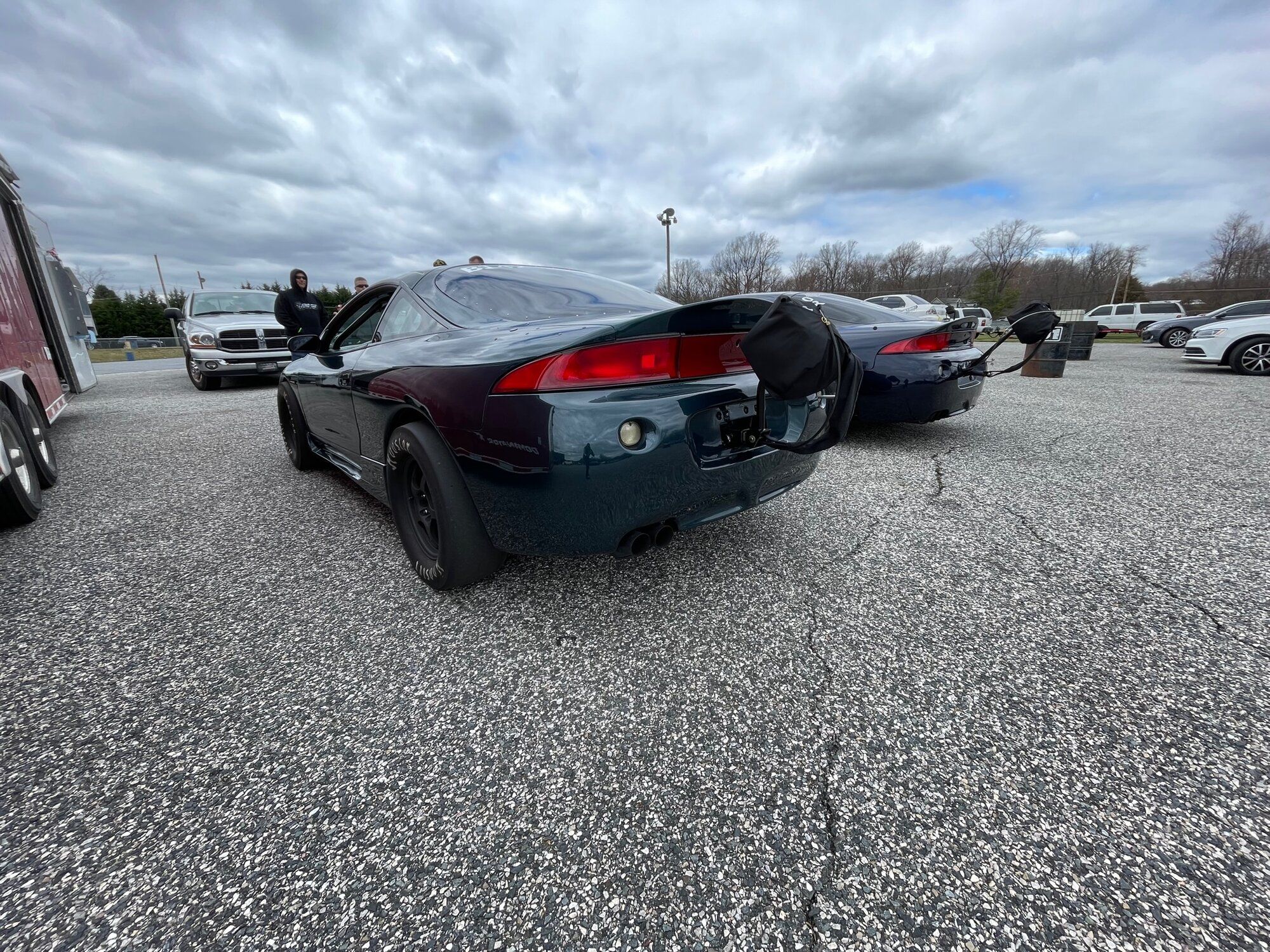

  • 8's! A few weeks later I decided to drive the car to Atco with Martin Borton from RX4Speed with the intention of running 8's and driving home, or blowing it up. We only got 4 passes in but the final run (and literally one of the last runs of the day) was an 8.96 at 152 mph! Still pump gas with ethanol described earlier. And she drove home 100% fine.

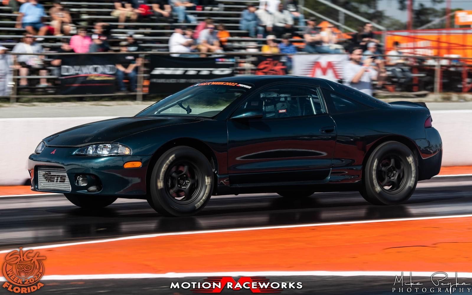

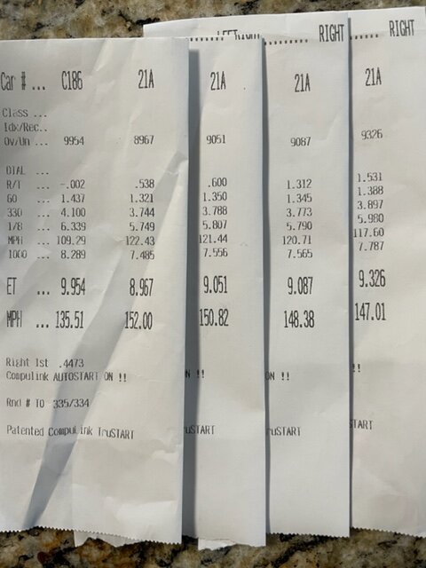

    • Averaged 9.23 at 147 for this event and went a 9.03 at 151 on the final day!
    • Won quickest 4 cylinder
    • Won Sick Week Freaks - a class that is basically everything except V8's (diesels, electric, 4 and 6 cylinders and rotaries)

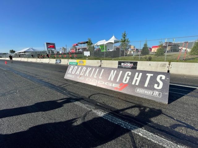

Historic Woodward Ave!

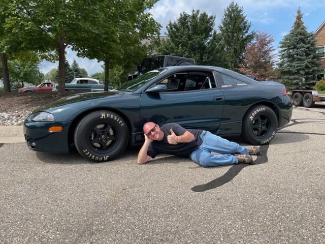

Me and my dad

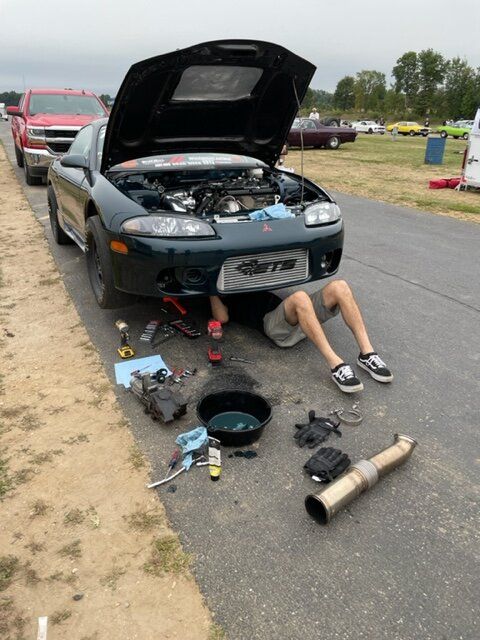

Dragweek day 1 carnage - huge thanks to TRE for building and delivering a new 300M tcase!

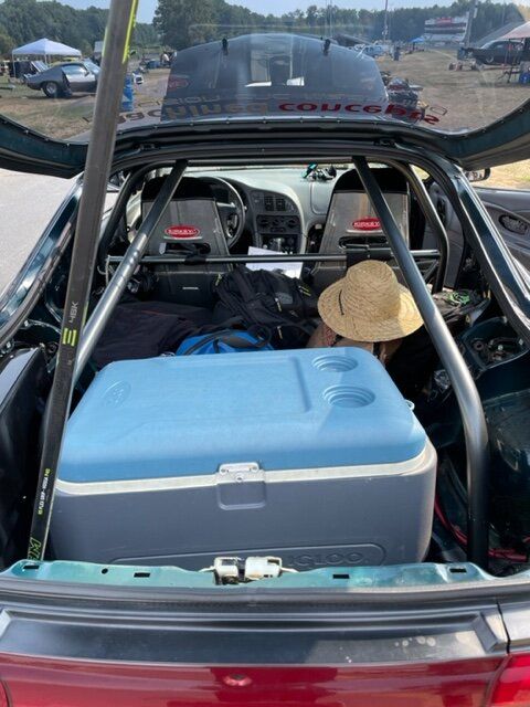

You can fit a lot of stuff in the back of a 2G - this is what it looked like the whole trip

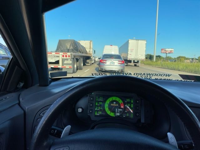

Chicago traffic at rush hour. Street car didn't care.

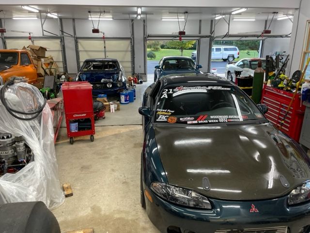

Back home - incredibly messy - spy the new mustang in the background and the dragster to the left

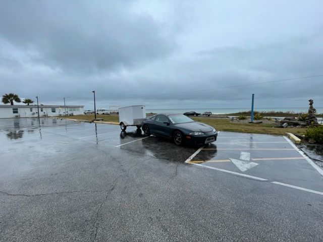

Just a bit of heavy rain - towing a trailer - in florida - in an 8 second DSM

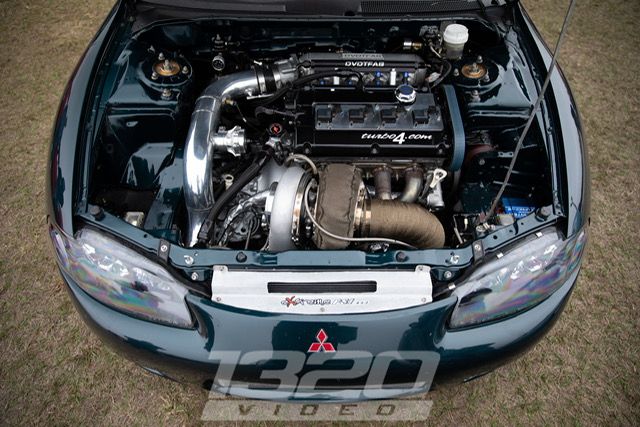

More 1320 video pics!

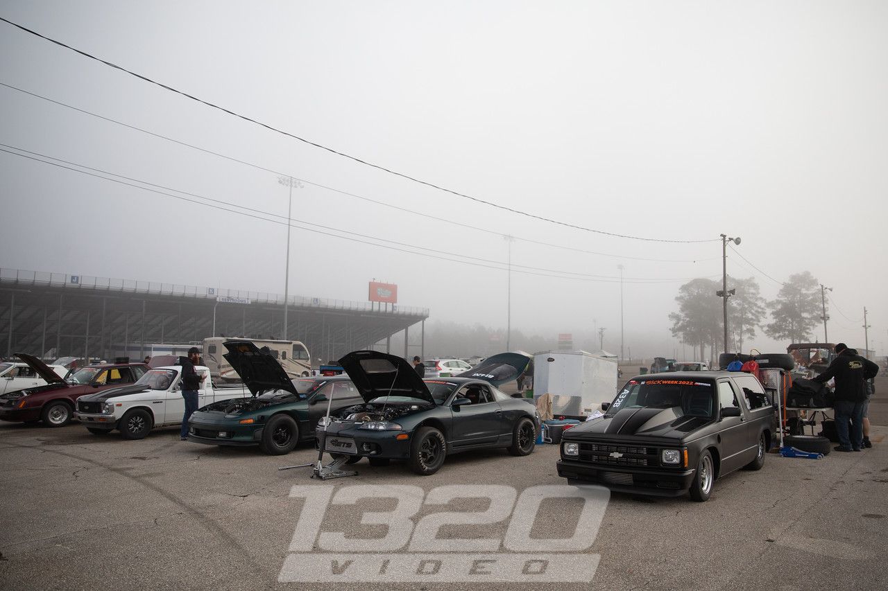

Some crazy fog in Gainesville - we couldn't even tell if we were at the track when we were pulling in it was so bad. Spy the LS powered AWD 3000GT next to me

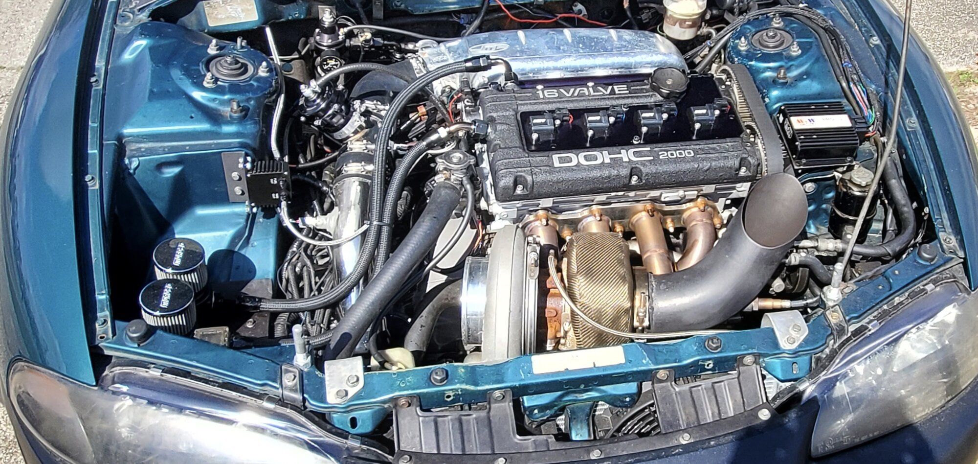

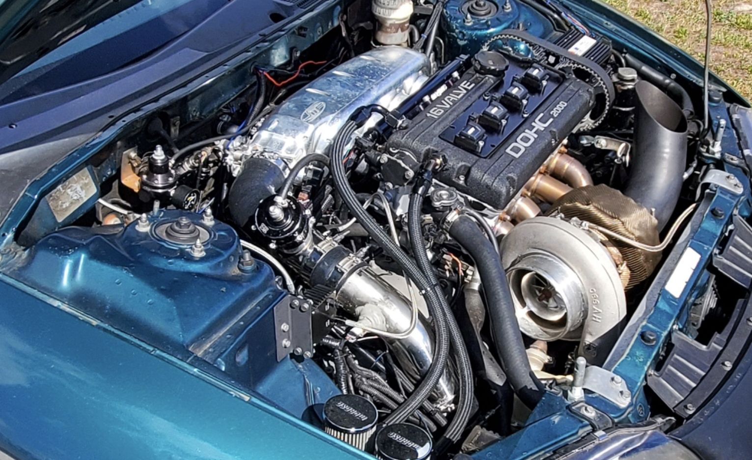

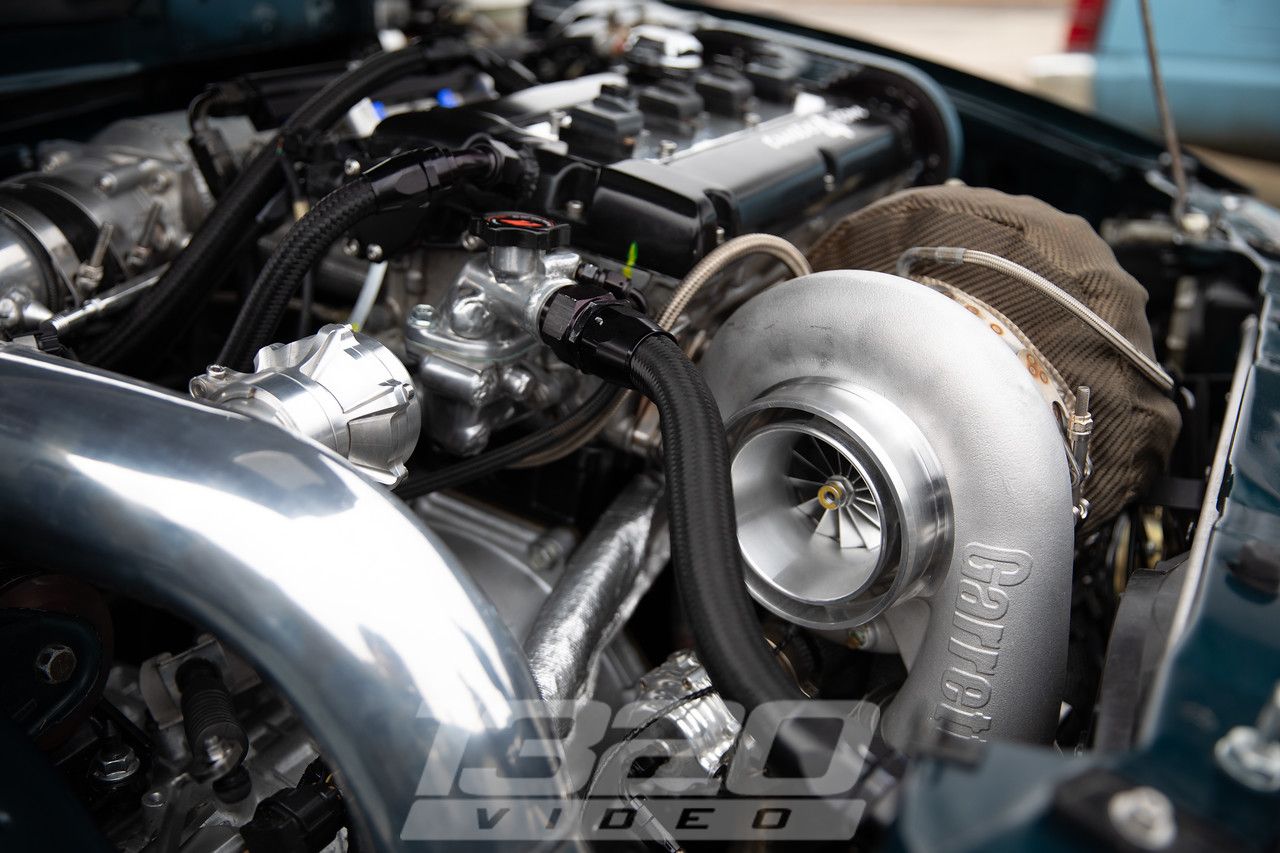

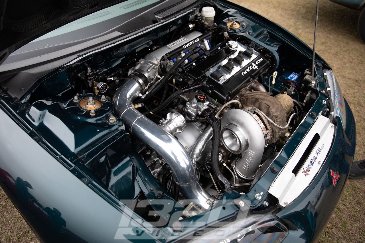

I've had two different turbos on the car this past year. For Drag Week and that 8.96 pass, I was on a Xona XR10568 which is an ultra compact 72mm. I had to run just over 50 PSI to get into the 8's with that. I borrowed a Garrett G45 72mm for Sick Week and it managed the 9.03 at 151 at only about 44 PSI average. The Garrett is a MUCH larger frame turbo though which made fitting it much more challenging.
Both turbos should be able to do quite a bit more than what I'm doing with them. The car is on the fuel system talked about earlier in this thread which is pump gas primaries with ethanol secondary injectors. The AFR's and timing are also ultra conservative in the name of living for thousands of miles and lots of pulls.
That looks like one of the bigger S400 Borgs on your car?

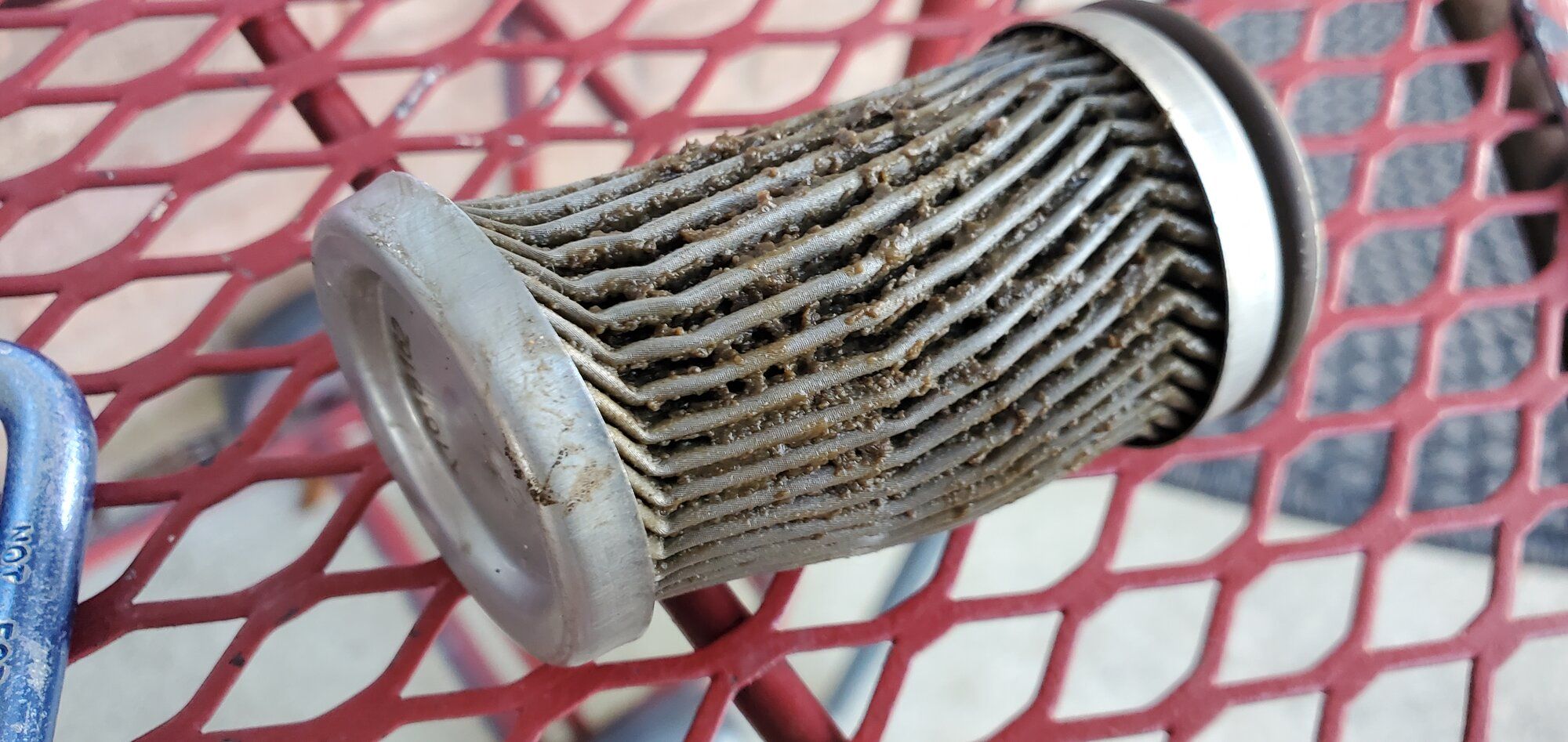

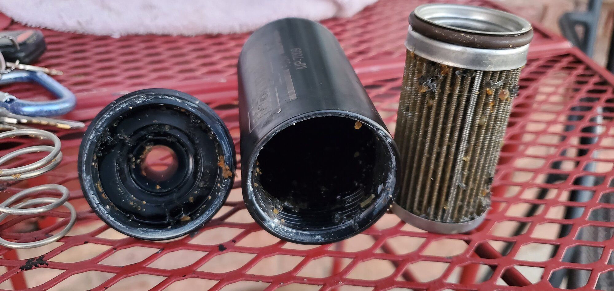

Thanks for the info. I'll check it out. Borg, S476 SXE on mine. Just waiting on a new fuel filter that was supposed to be here today. Apparently when the pre and post filters get gunked up with E85 crud, they don't like to run very well.
The 76mm SX-E is a pretty impressive turbo. I assume T4 with the 87mm turbine wheel? I went 6.52 at 206 MPH on that turbo in the dragster. That equates in that car to somewhere between 1400 and 1500hp and that was done at under 60 PSI. I think I could push it further still, but I started running a class without turbo restrictions and put the 80mm on the car. I have an 88mm SX-E here too that might have to get a try soon. :)

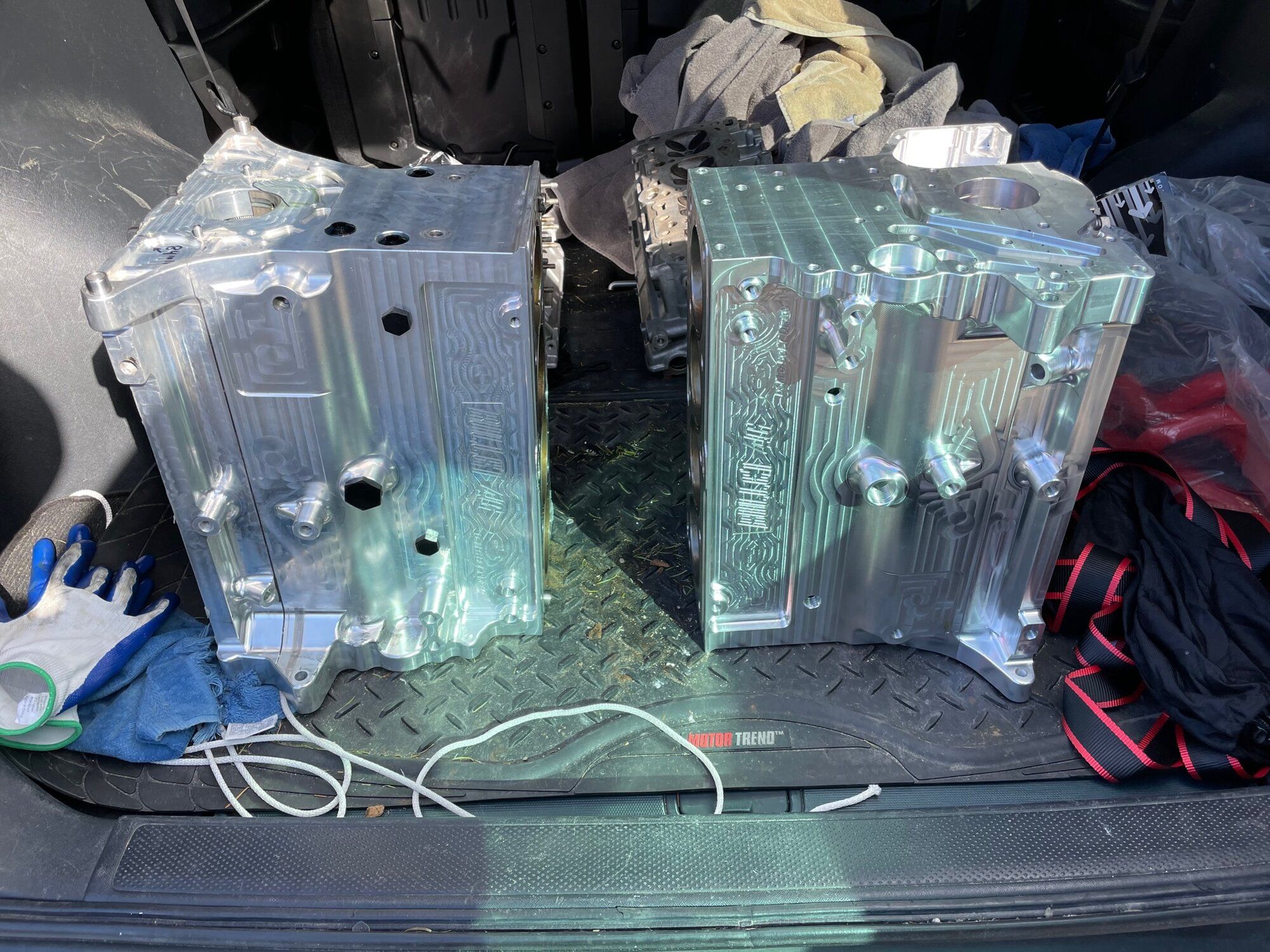

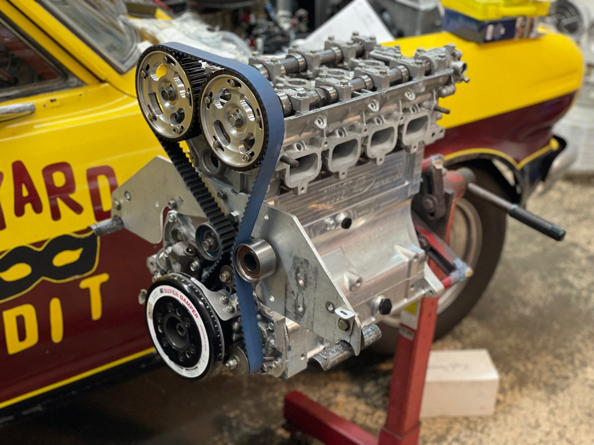

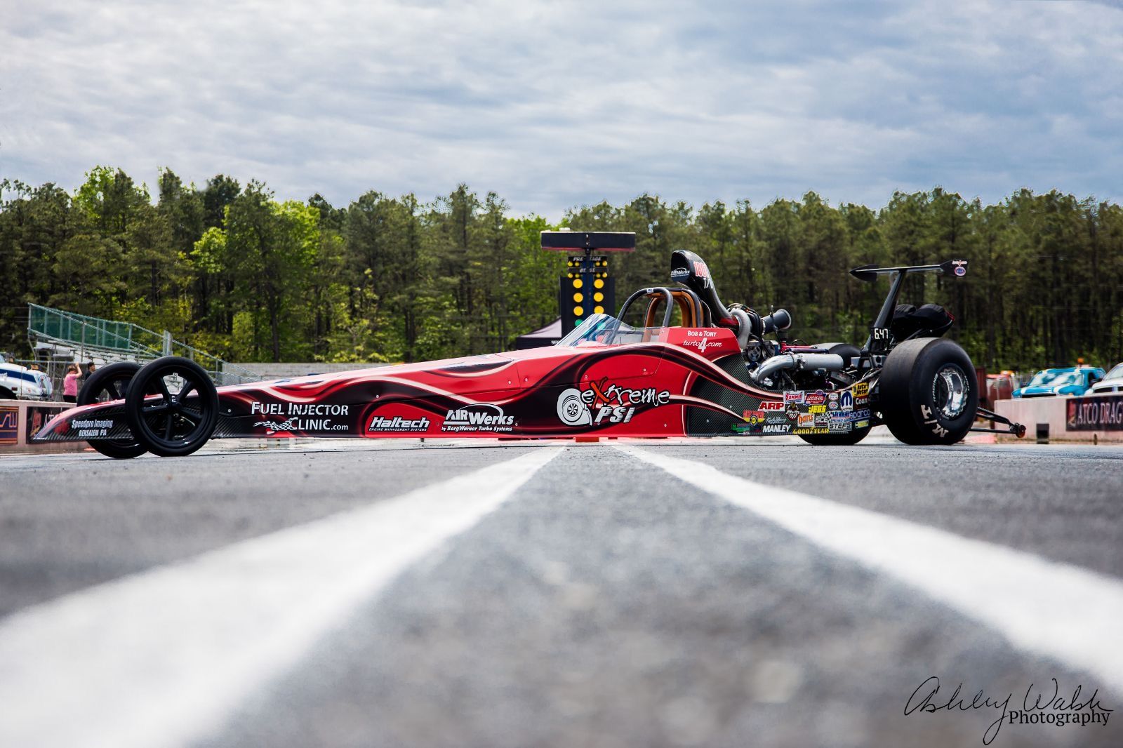

I figure I should share an update on my other projects too. The dragster is close to ready to go out with a whole host of changes. We have 2 billet blocks for it, some new transmission goodies and a couple turbos to try out. I'm excited to get back out in this thing once the weather breaks. I've learned a lot since we last raced it that I think can make things go much smoother, but it will take some time to creep up on things with the new setup. Maybe I should do a build thread on this with more details on the setup and what we've done so far? Thoughts Chris?

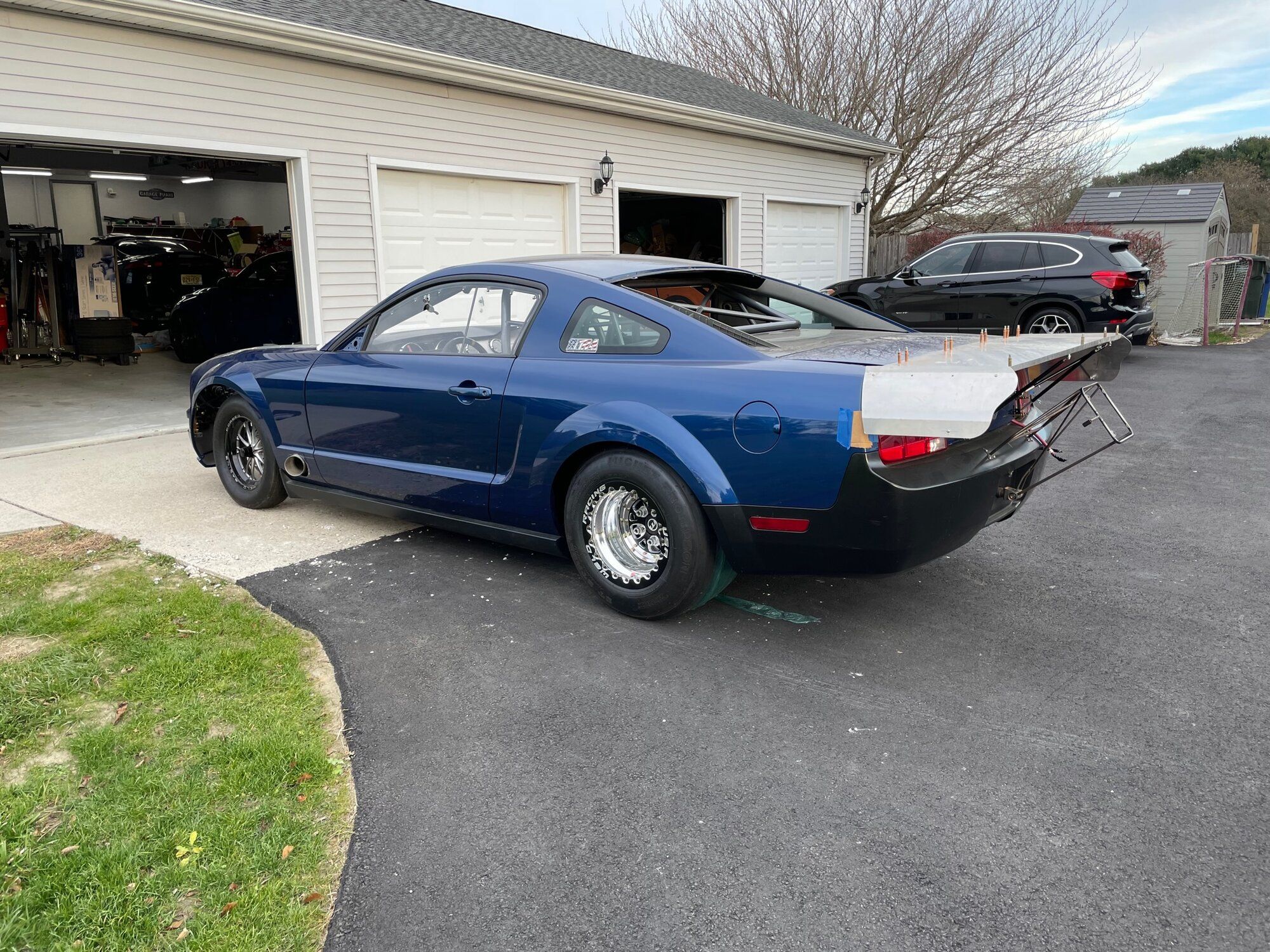

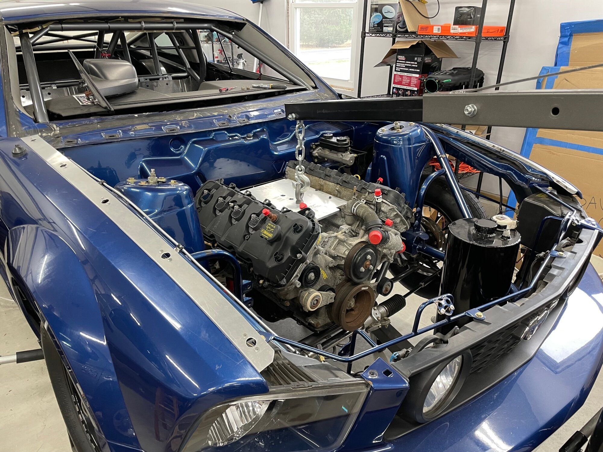

And as if I didn't have enough going on, an empty spot in my garage was screaming at me to be filled so I picked up a 6.50 certified radial tire Mustang roller. I'm putting a single turbo Coyote in it to eventually run Ultra Street I think. Progress has been super slow so far but I need to get back to this thing now that Sick Week is over.

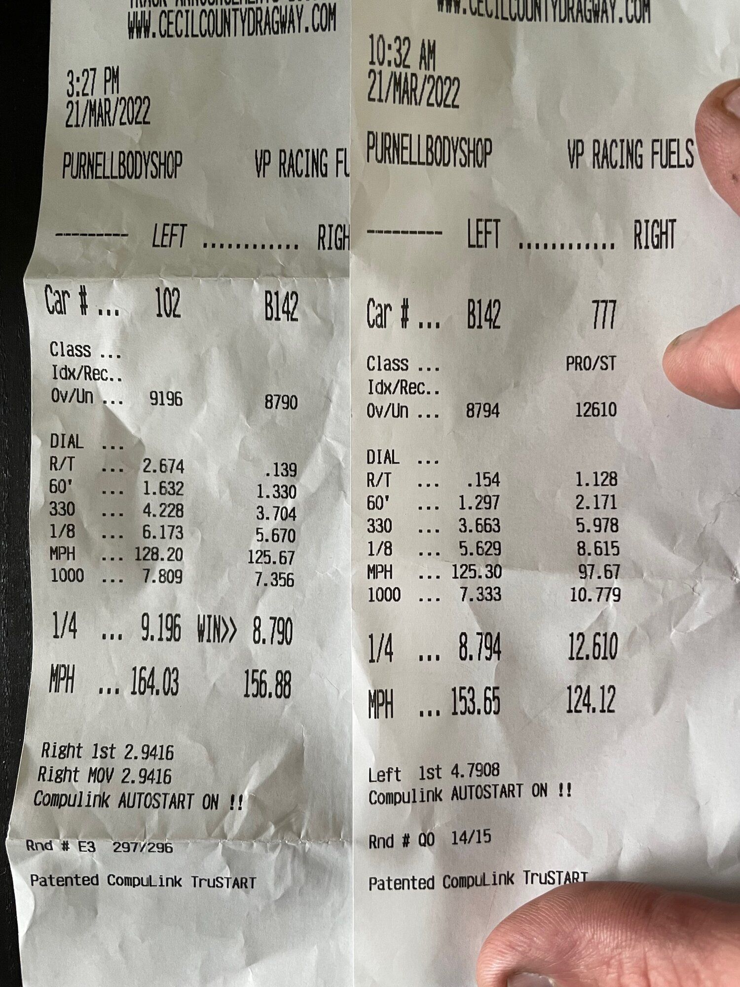

8.79 at 156 mph!

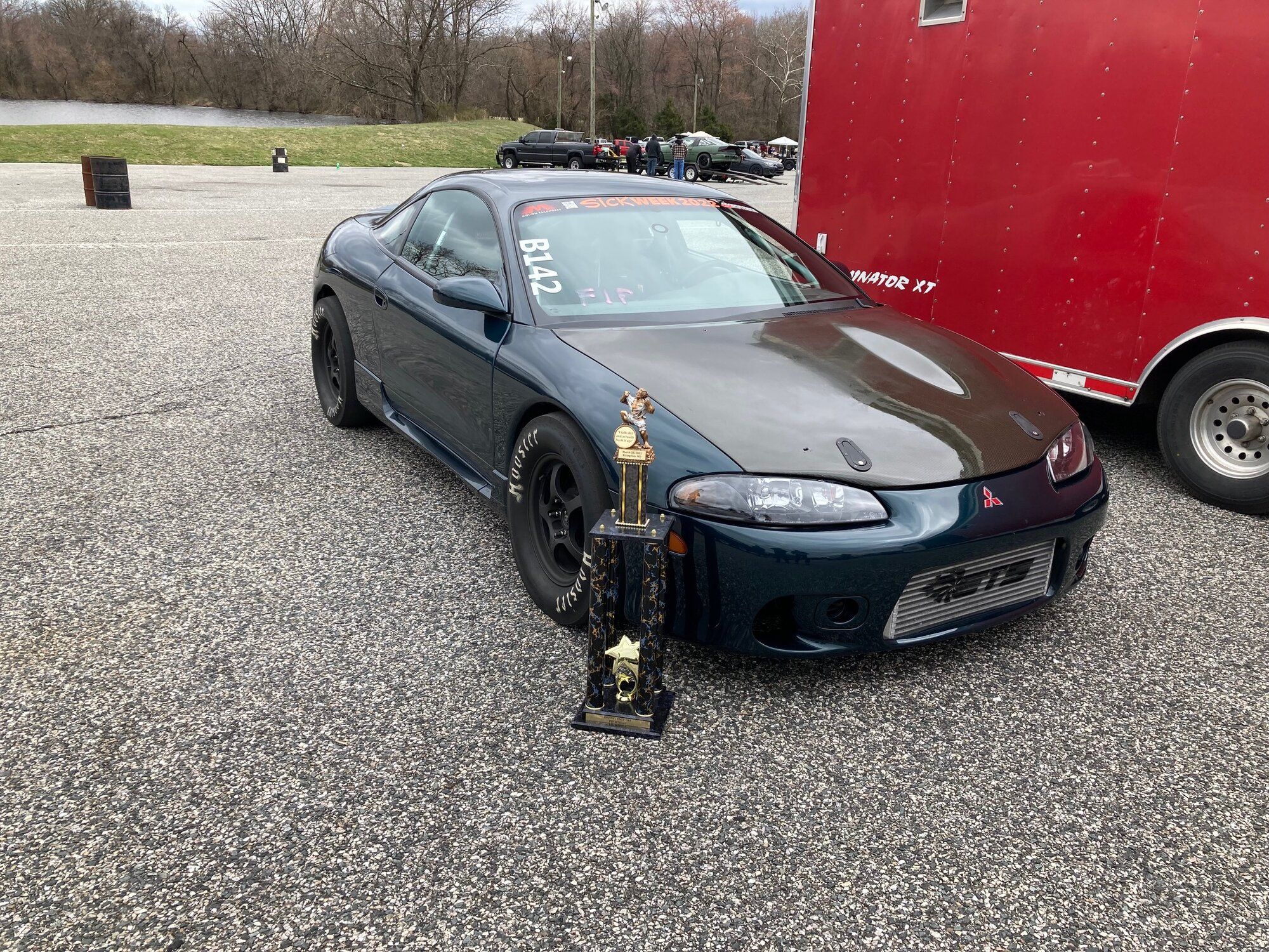

Still 100% street trim. I literally only changed the oil since Sick Week. And I won Import Face Off's Forced Induction Pro class at Cecil yesterday!

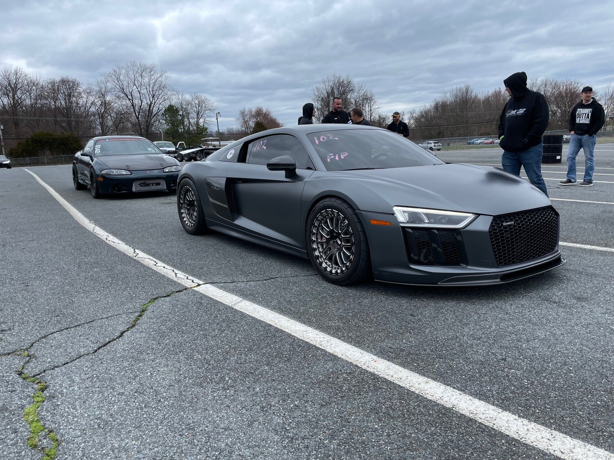

:dsm: Congrats man! That's awesome. What were you running against in that class?
There were 8 cars in FIP. Two 1G's (Tony Marx and Deric Dupey), another 2G (Martin Borton), an Evo 8/9, a civic, an Audi TT and a twin turbo Audi R8.
