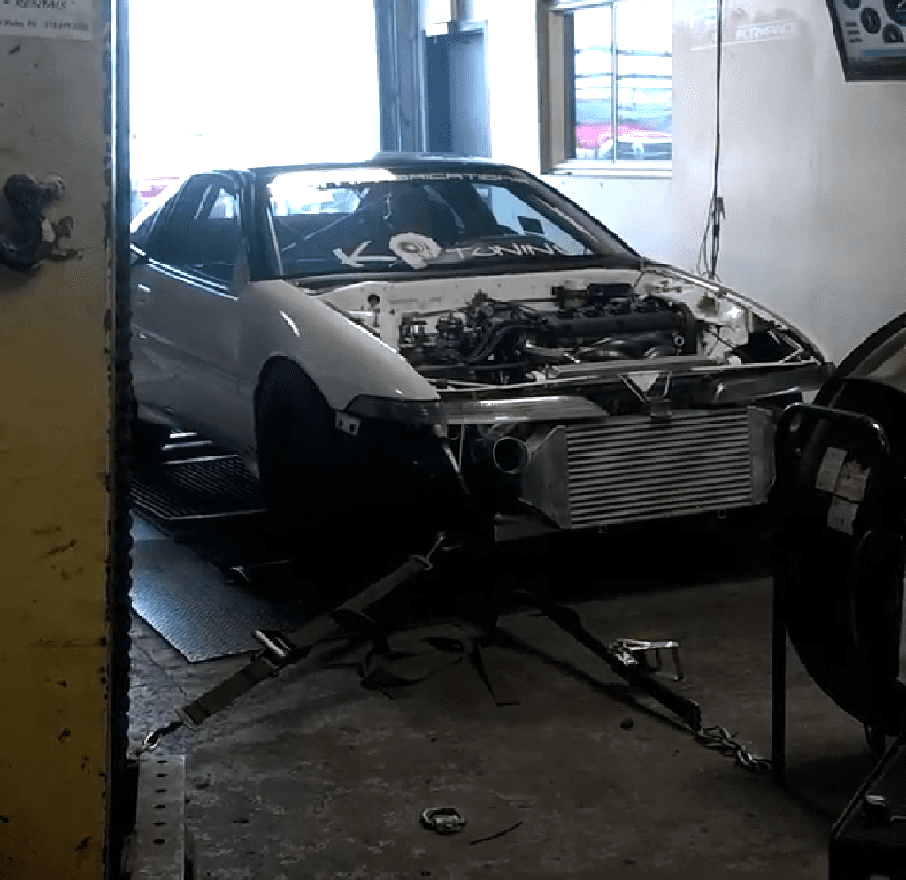

Is winter over yet? Sheesh. Been a while since I updated this thread. Been super busy with work so I barely get to touch the car. My buddy Karl from KP Tuning helped me out and came over to my garage while I was at worked and fired the car on the new AEM and is going to dyno tune it this Saturday...again, while i'm at work. Ugh.

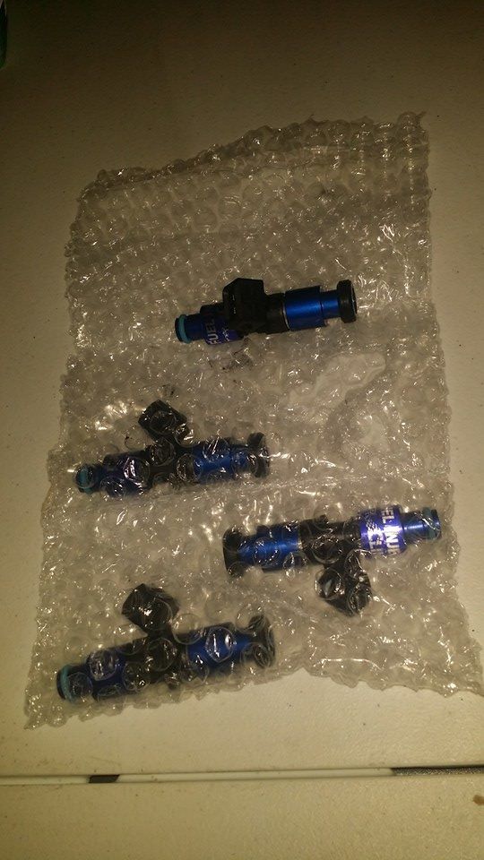

Switched to VP Import along with FICs new 1650cc injectors.

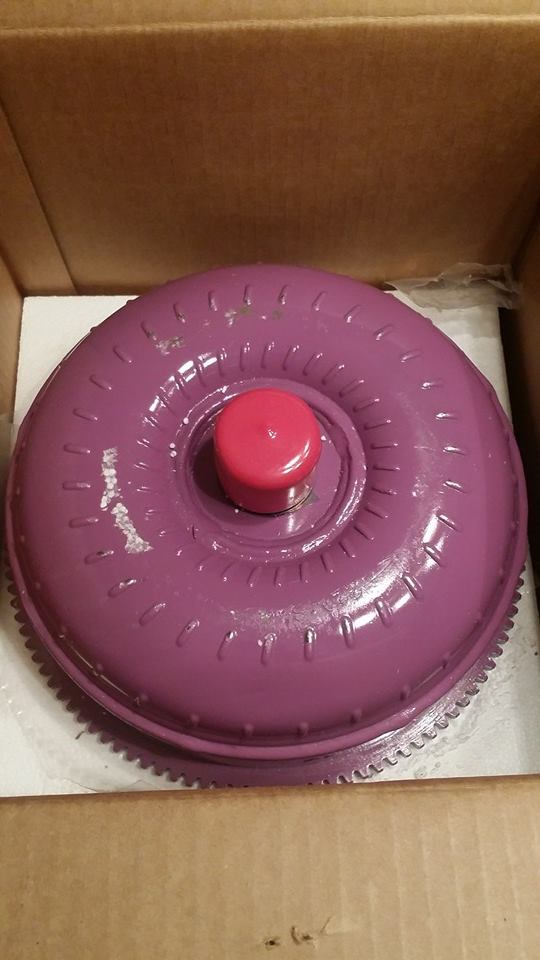

Switched to 2g auto trans built by me along with the straight cut transfer gears and a Precision converter.

Good choice on the VP Import and 2G auto setup and PI converter! What converter stall (level) did you get?
May I ask why you went down on injector? I have FIC's 2150 and kinda wanted the 1650's. What was your highest duty cycle with the 2150? I'll also be on Ethanol when the time comes
Went with there 4500 stall converter.

Thanks! I went down on injector because I wanted to go to an injector that was compatible with VP Import since I went away from Ethanol. The 2150s won't work with Import unfortunately.
Back to the backing out converter bolt issue, have you ever considered running safety wire through them like aircraft fasteners have? Or is there simply no room to work it in there?
Saftey wire won't help. A few people have tried it and it just broke it. The problem is that the bolts are loaded in tension and shear. Dowel pins or more fasteners is the only way to fix it.
We tried a bunch of things with no success. The 1/2" bolts on the Bradco were the only ones that lasted a while and even they started coming loose after several track sessions. Hoping that the 8 bolts on the Precision will do the trick but i'll be keeping my eye on them after every pass until I feel comfortable with them.
