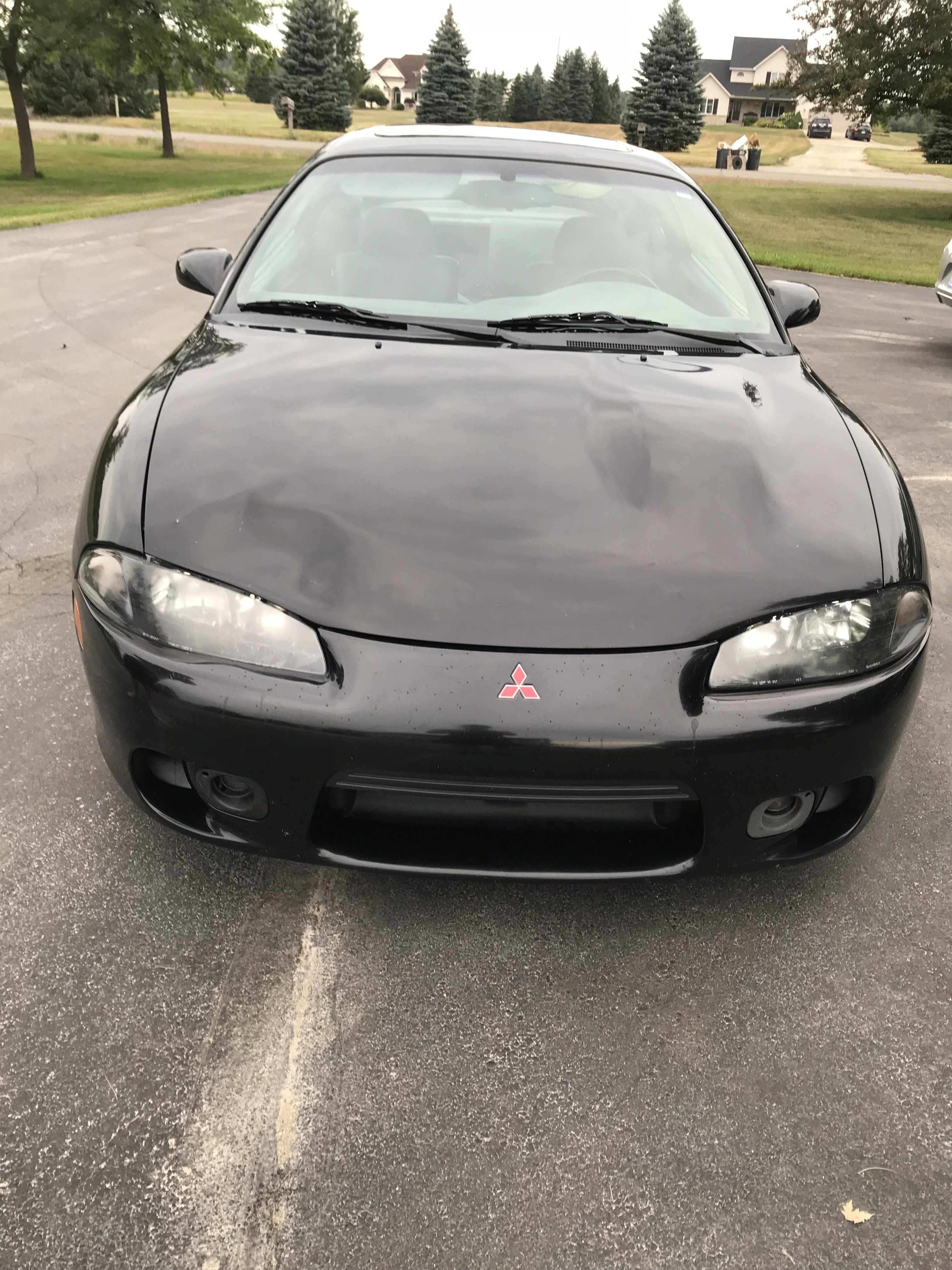

The car is a 97' GSX with an automatic transmission and 117k miles on it. It is literally completely stock and all maintenance was recently done on it by previous owner along with new tires. Absolutely zero strut tower rust and the car drives great. A lot of little issues with it but I am working on fixing them now. Also after getting it home I decided to check the rear diff and WOOOT I got lucky and it has the viscous LSD.

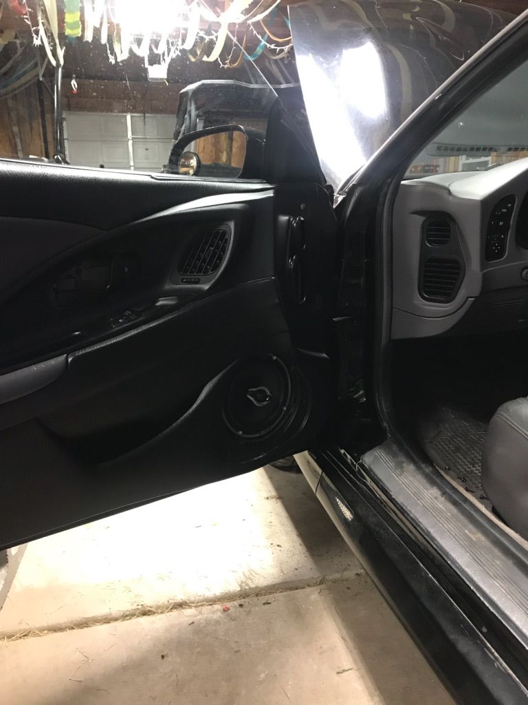

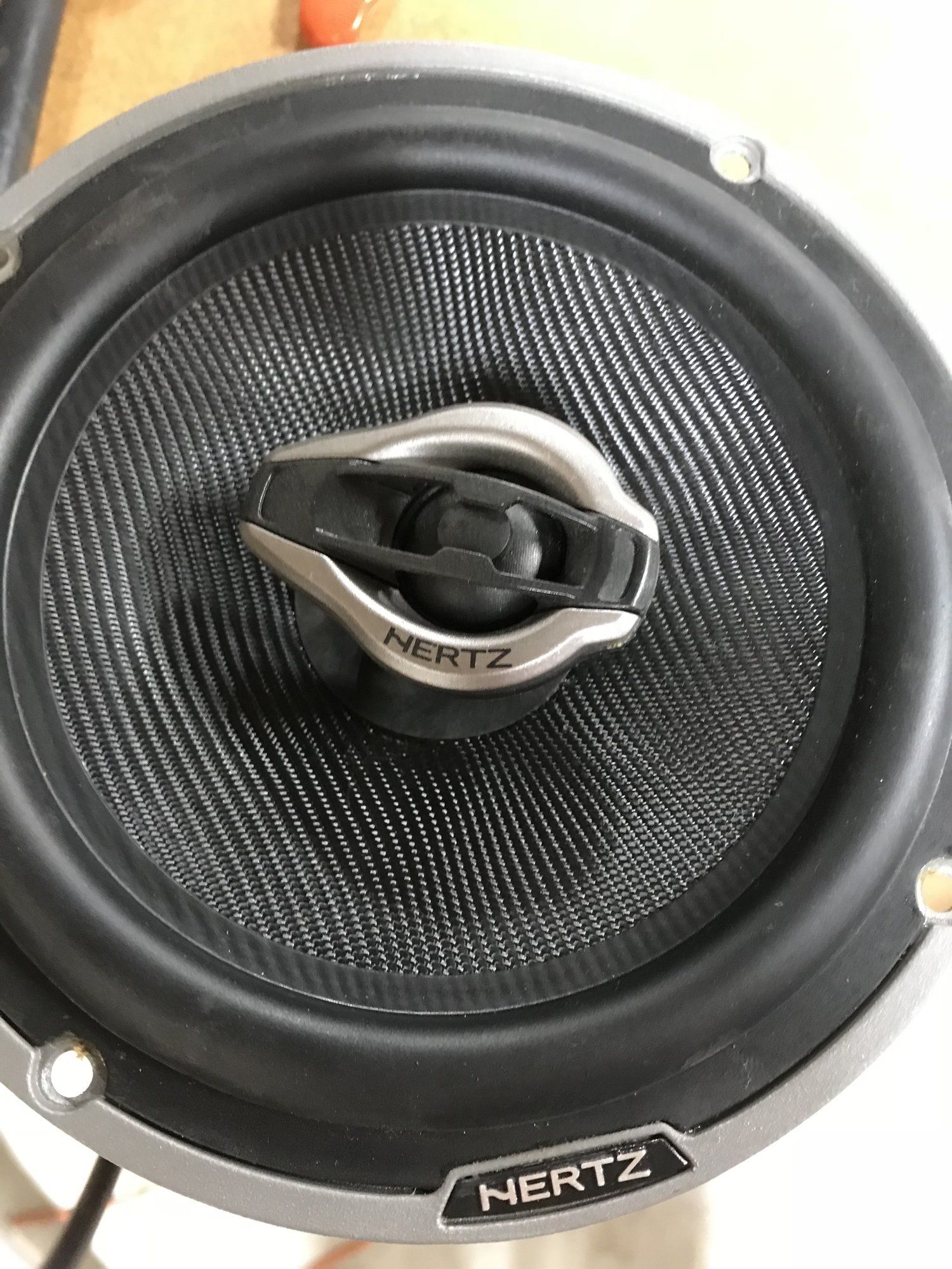

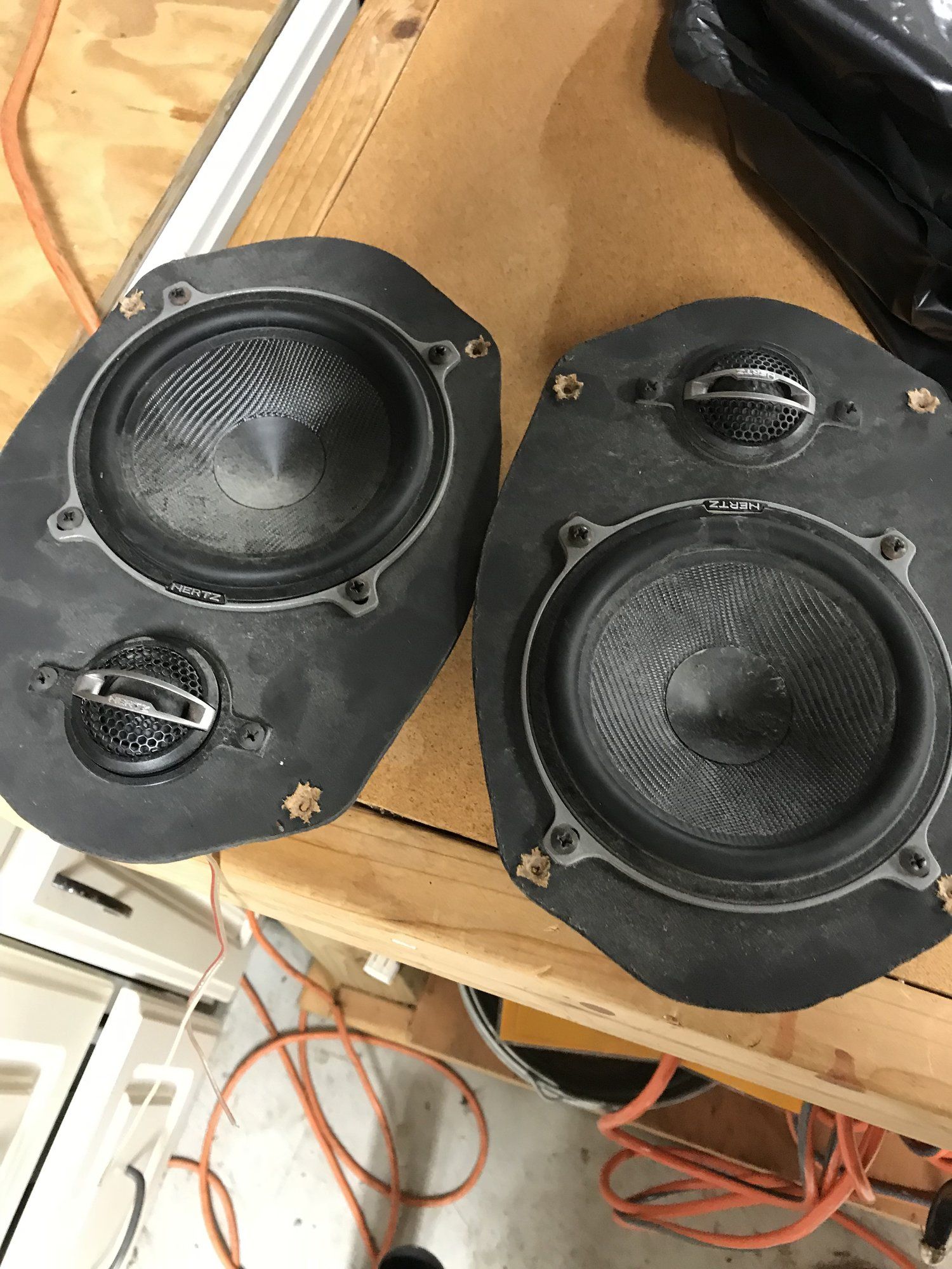

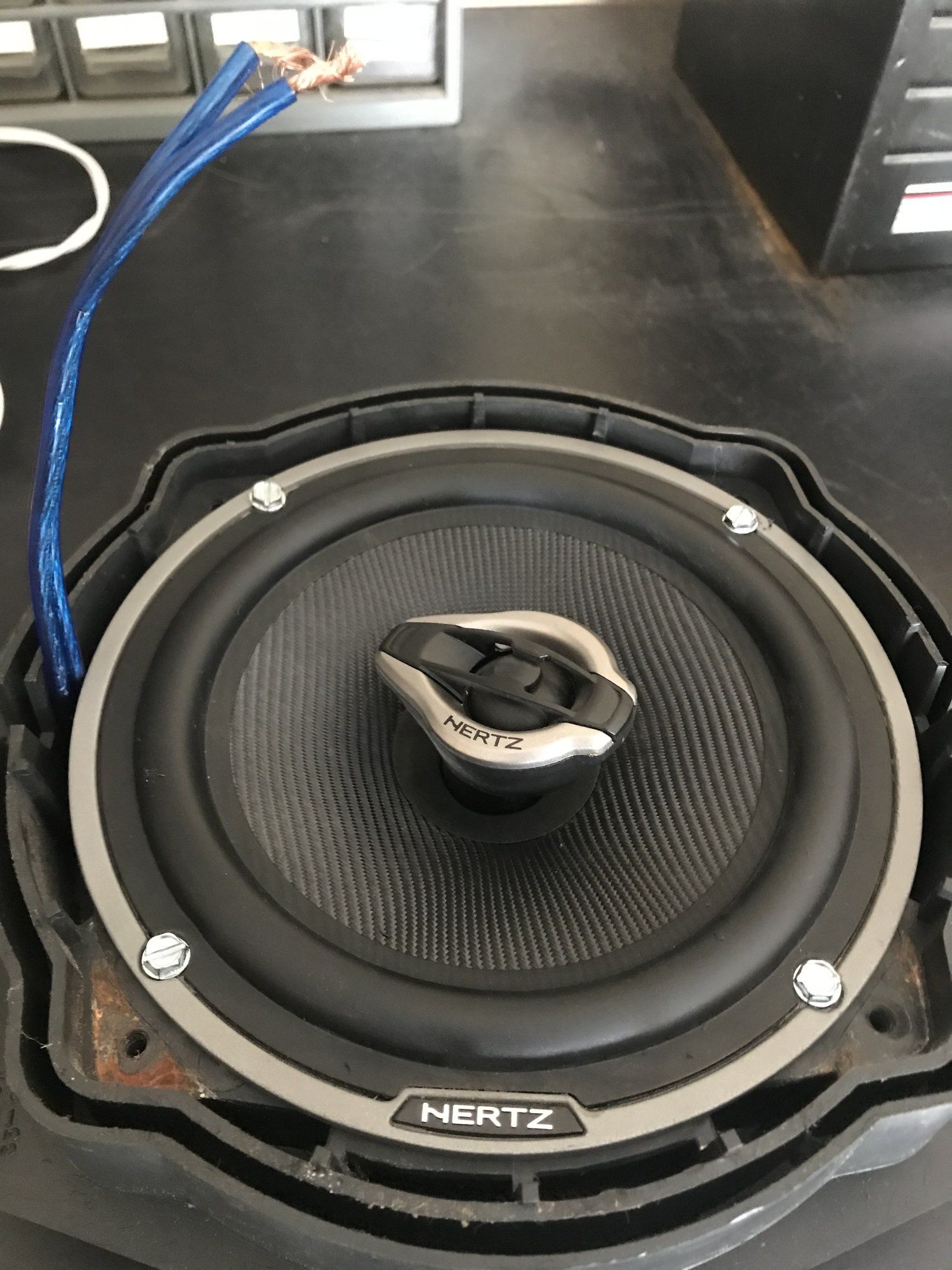

Installed the spoiler yesterday and started swapping the interior. Have to modify the stock speaker housing in the front to hold these speakers so a little hung up on that right now.

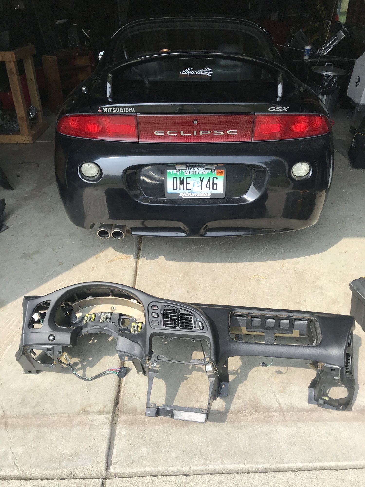

Today I removed the dashboard from the GST wasn’t too bad but some of the electrical clips are an absolute pain in the ass. Tomorrow I’ll take the dashboard out of my car and them Sunday hopefully have time to put the black dashboard in my car. Is there any maintance or maybe other things I should replace while the dashboard is off?
FA42EE2D-E7A2-4CEA-BFBA-F978E5BD0943.jpeg 2E3F3EB6-DE9F-4AAB-9DF6-B82C7873273E.jpeg

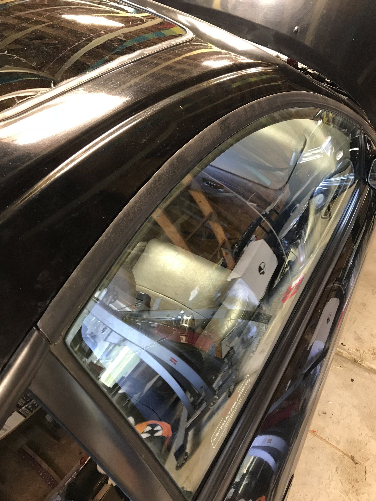

Took the dashboard out of the GST yesterday, this weekend I plan on finishing the interior. Have to take the dash out of the GSX still. Also I need to order the carpet this weekend.

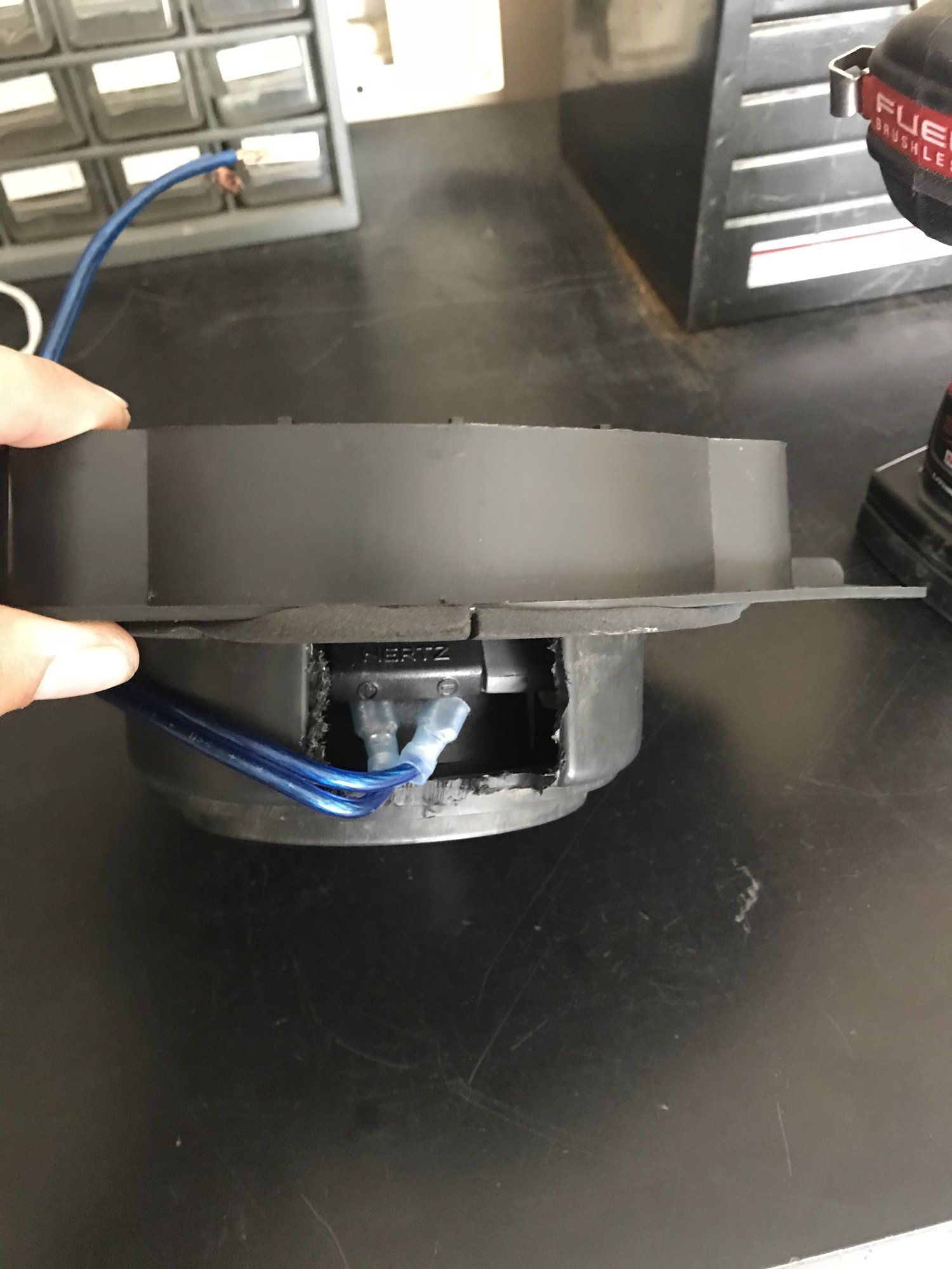

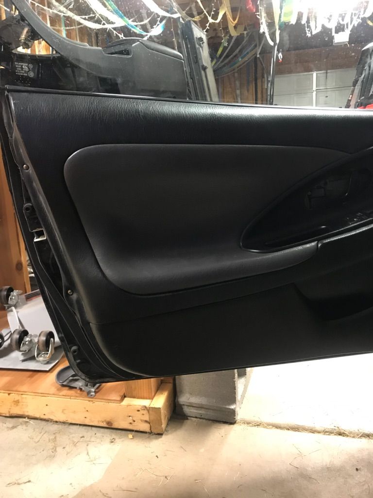

The carpet is pretty nasty in my car and has a lot of holes so I’m just going to replace it. Finally modified the OEM front speaker housing to hold my speakers and got the door panels put back together. Nothing special but will take a pic of it.

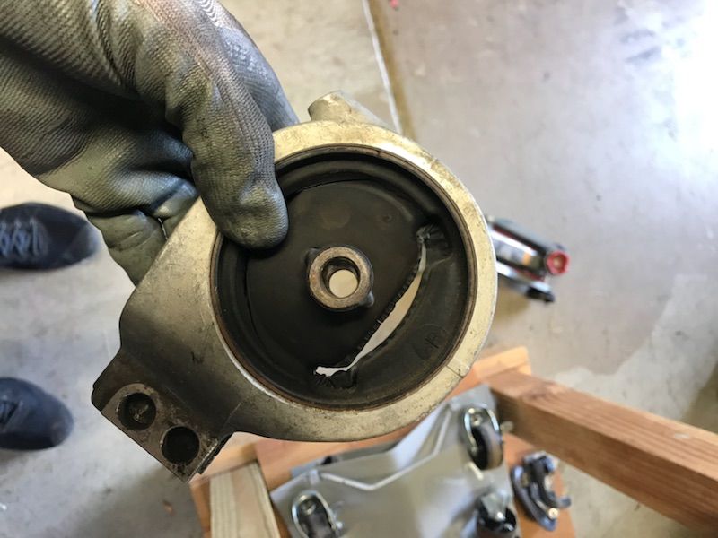

Not sure if I am missing anything important that I should do but this seems like a good start and about what I was wanting to spend on suspension upgrades. I did get a chance to install the new Front Motor Mount!
Finally had the chance to install the speakers and door panels. Really like how they look although the door panels aren't in perfect shape. I have a lot of plans for this car just attempting to do all the research seems like I might end up doing a 6-bolt swap seems the way most people go when they plan on making 600-700whp. We will see I have a lot to learn!

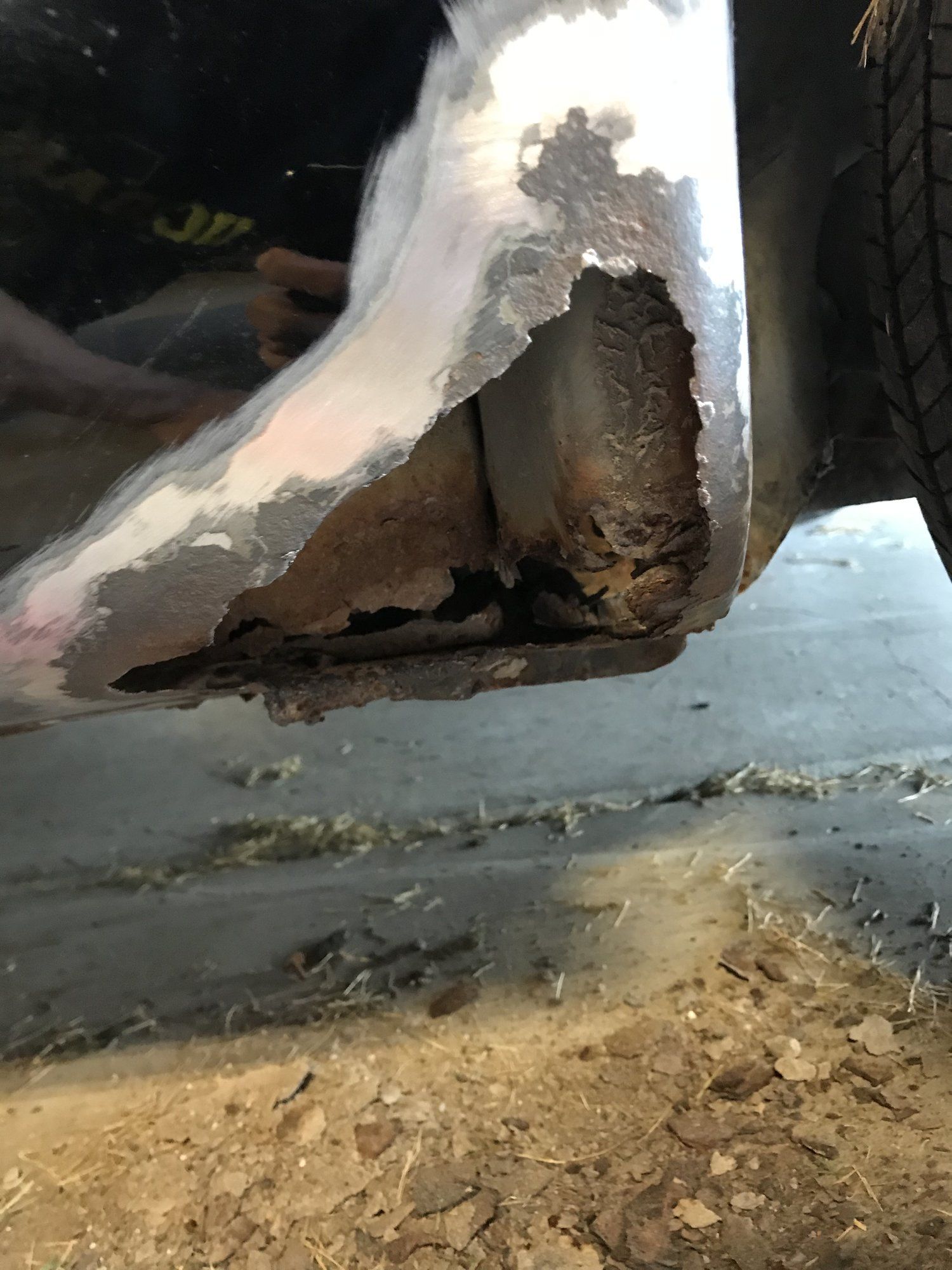

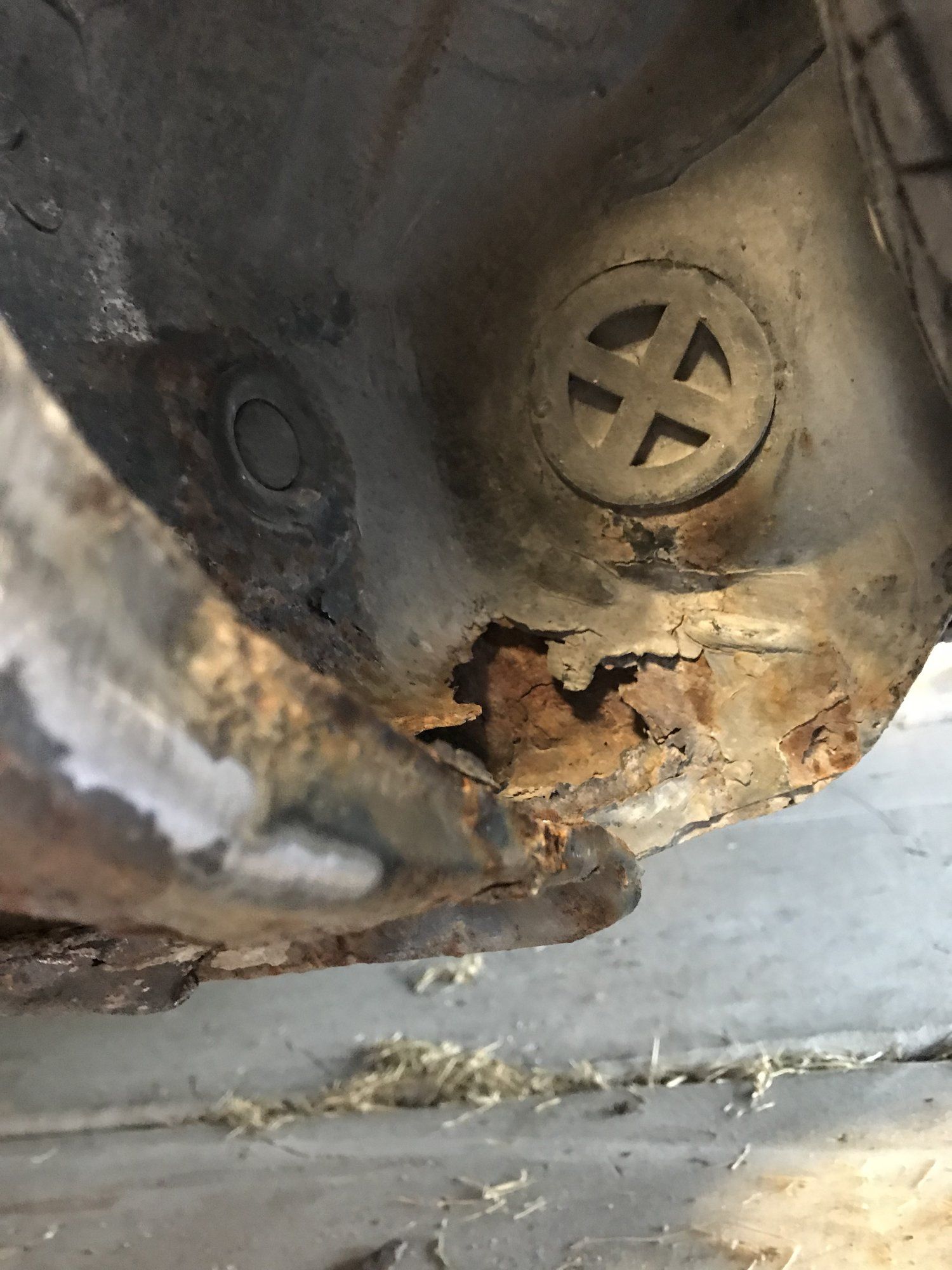

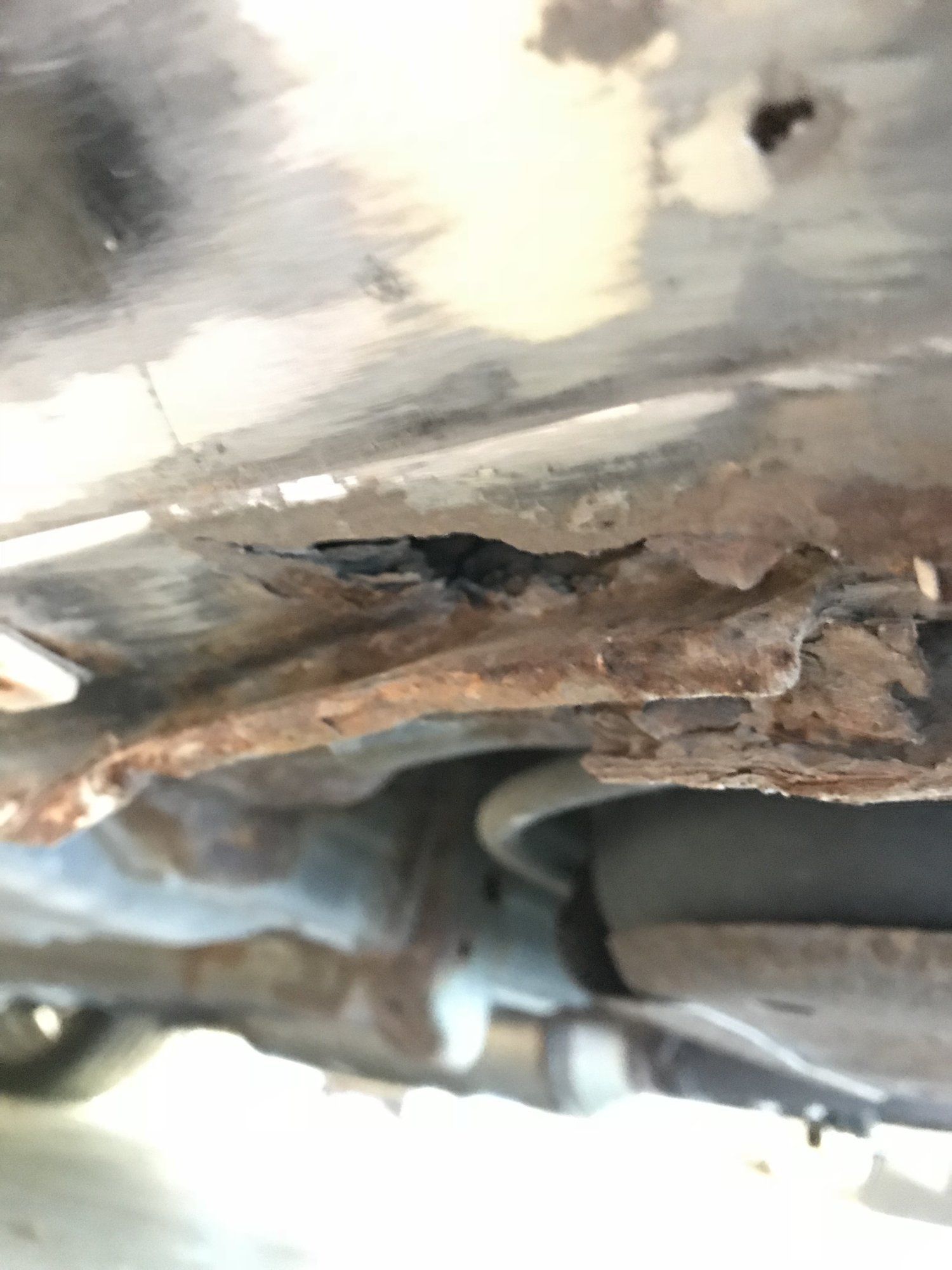

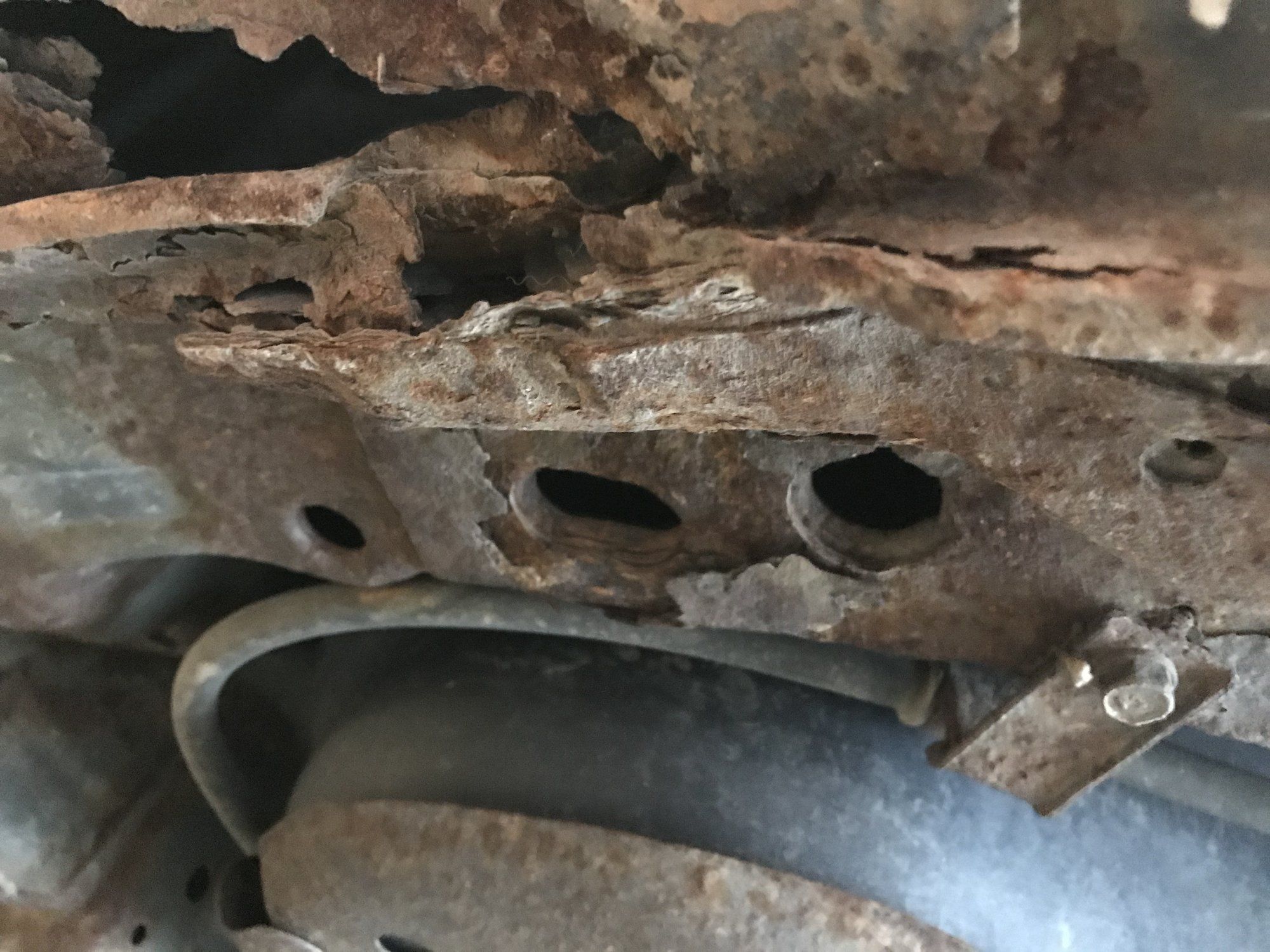

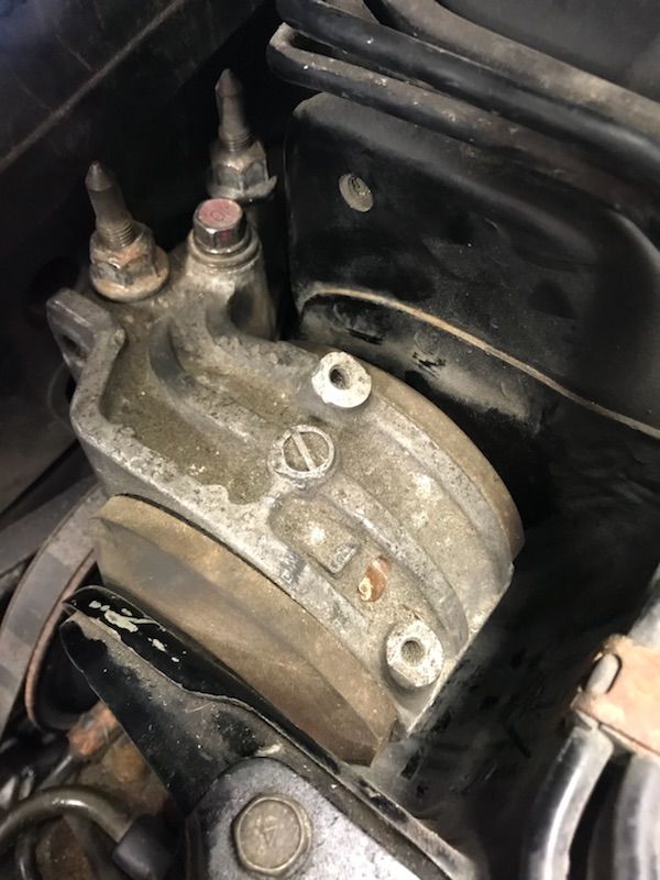

Did more work on the car and also found more work in the form of rust! Trying to find as much info as possible on rust repair what worries me is the pinch welds and whatever that piece is behind the rear side skirt area being rusted out. Going to take out the seats and carpet to make sure he floor pan is fine and not sure on the rest of the rust.

Yeah its sad I wish I would have noticed before I bought the car but I'll just have to fix it now which is fine, should be a good learning experience. And yeah I will be cutting it out and welding in new metal, going to try and find a donor to take it from.
If you can find a yard with a wrecked Spyder, they are likely going to have the best chance at good clean metal, as most of them are garaged in bad weather.

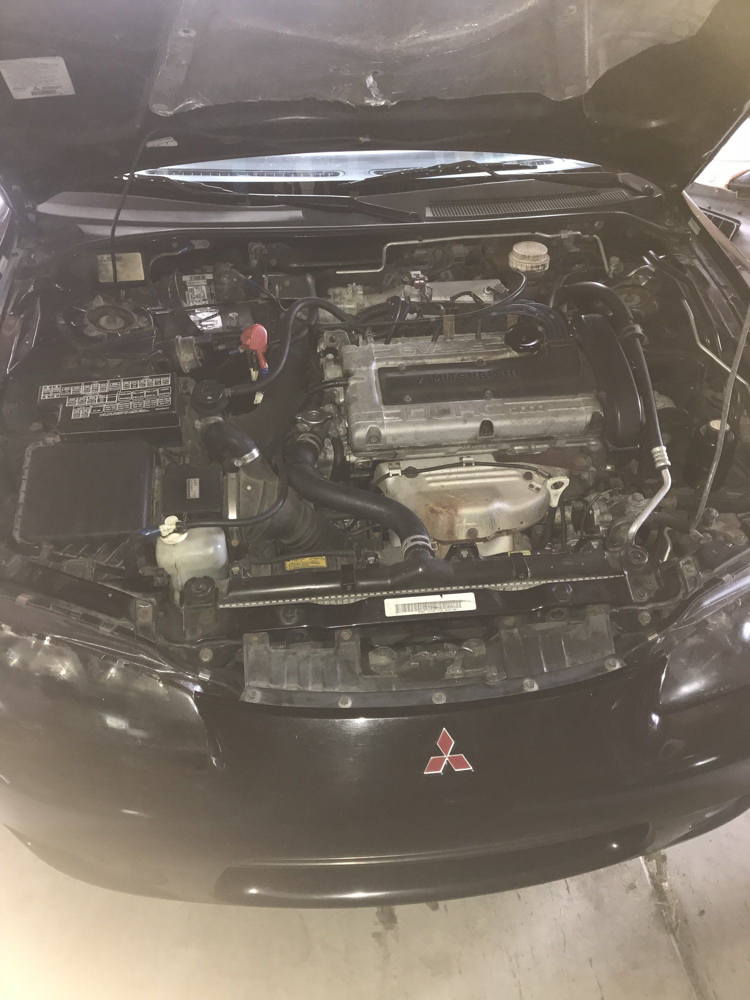

This will be my last update post without pictures or without any work being done. Bought a used rear wilwood rear drag kit, FIC 2150 Hi-z injectors and VRSF intercooler. Going to be attempting my first ever engine pull tomorrow starting at 10 am so should be interesting. Having a buddy come over and help me but he has only done this once and it was on a completely different car. Should be a good experience! Will be dropping motor off at Whalen to get rebuilt while I am gone at school. Debating on removing a/c and EGR/EVAP (I dont have to pass emissions) and also just put in an order for a Paul Volk Tubular Rear Subframe but that will be a couple months. By time school is finished everything should be in place and ordered to start putting together. Will post some pics of engine removal tomorrow, assuming it comes out.
