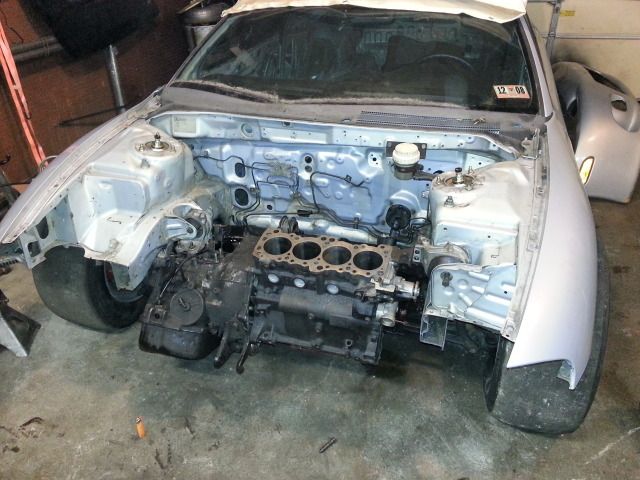

Here it is the night we started tearing into it
First things first, off with the front!
And here we have bumpers and fenders on getting a plan for the front end

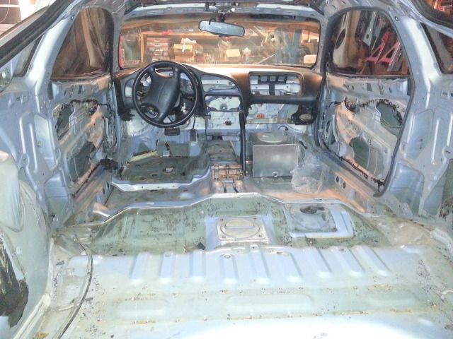

Next we started on the interior. Sound deadening, junk under dash, misc. panels all gone and dash sitting back in there
Out with the old...
In with the new
Took out the gas tank.....what a heavy pig!

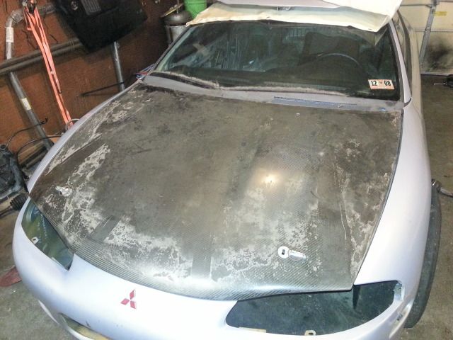

No major updates, but we got some stuff done. Was able to get the mock up motor with auto trans in the car. Now we will be able to tighten everything down and start fabbing up the the front end along with eventually doing to exhaust manifold. Also, picked up what I think was a steal, a $50 carbon hood (clear coming off, but going to be painted). Also borrowed some matching Weld wheels for the back to get an idea of what I need when I purchase them shortly.
Carbon hood in place
Mock motor/head bolted to auto trans

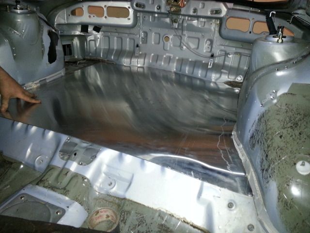

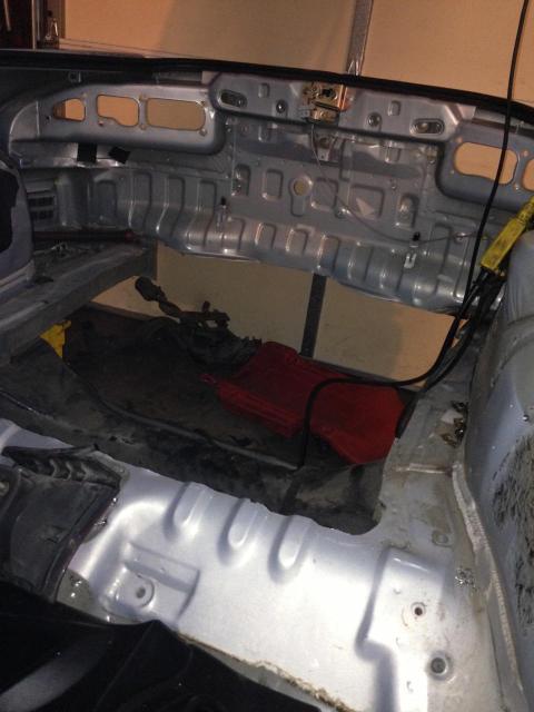

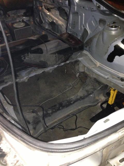

Little bit of work has been done. Between finals and work, been slow working lately. Cut out the rear floor/tire area and put in an aluminum insert. Rear crash bar has been removed and we got an idea for the parachute mount. Also got in my new seat. here are the most recent pics:
Rear cut out
New insert

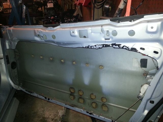

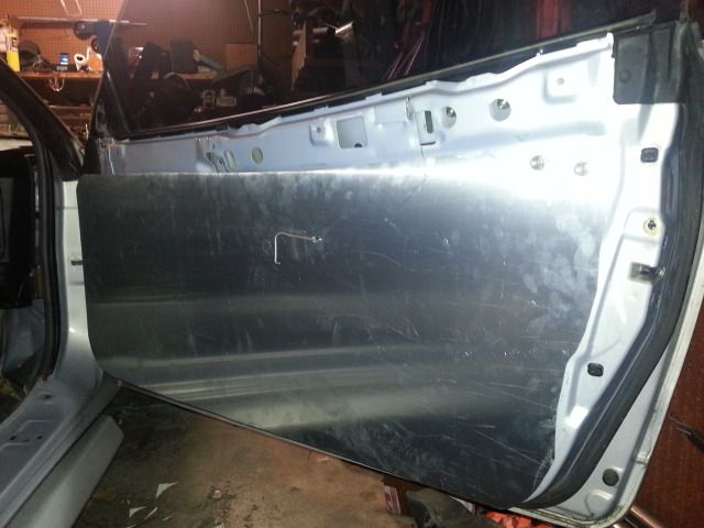

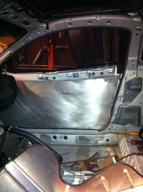

Made some more progress on the car. Cut up the passenger door to remove crash bar, window tracks, etc. Took aluminum and made some door panels for it. Had to start a couple inches lower than the top of the door because if the curvature of the door up top

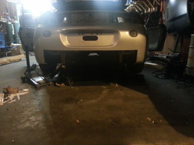

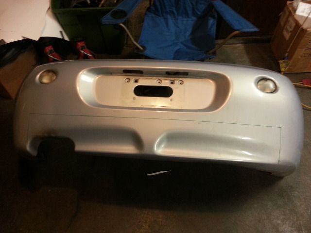

Next was the rear bumper. Took what Keith Kinowski did with his white 2g awd and applied it to mine. I didnt know how "speed holes" would look with a 2gb bumper so I went with how his was cut.

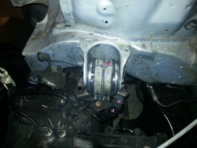

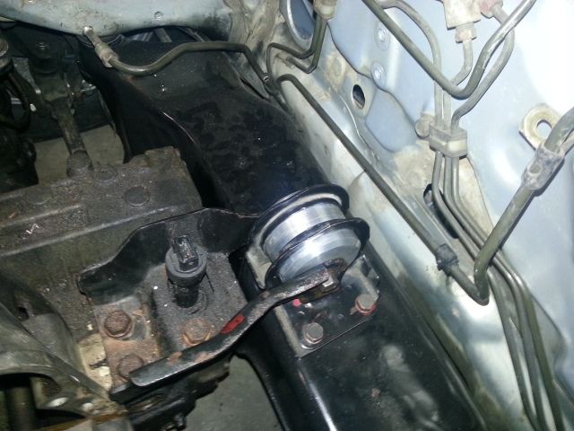

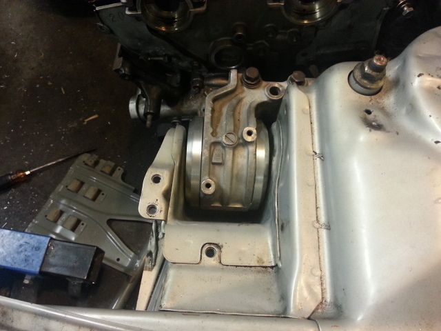

Been slow going on the car, but got the solid mounts done. In about the next week things will really be picking up. Manifold material is about to be purchased, cage will be done, and front end will be done.

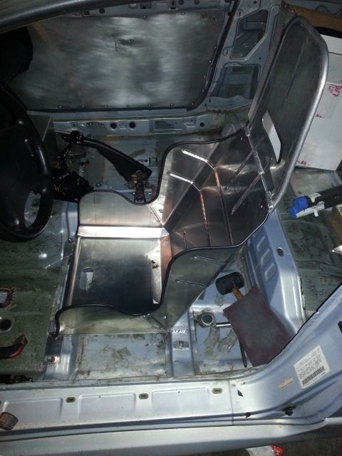

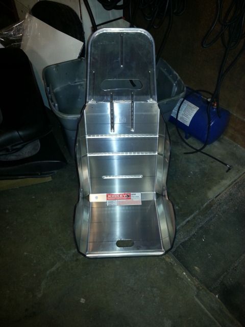

Got some more stuff in, along with the seat mounted. More to come!
Big box is the new radiator, little box is small battery and battery tray

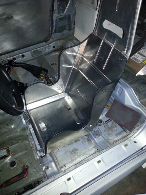

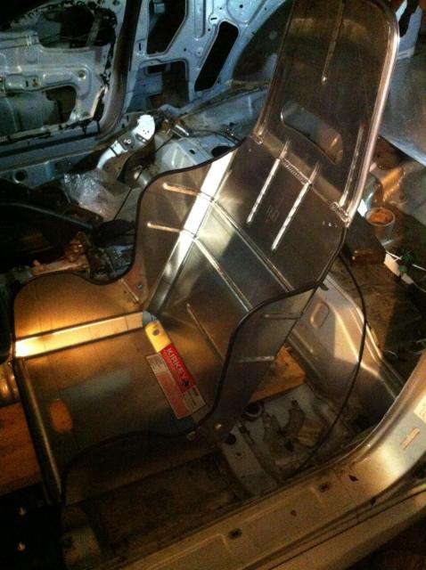

Got the Kirkey welded to custom brackets and then bolted in.

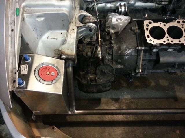

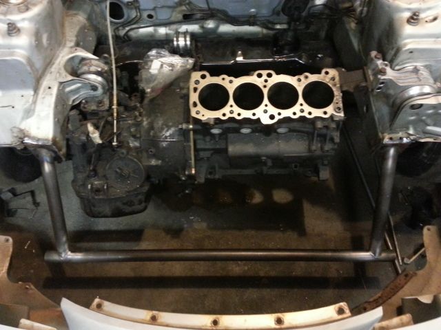

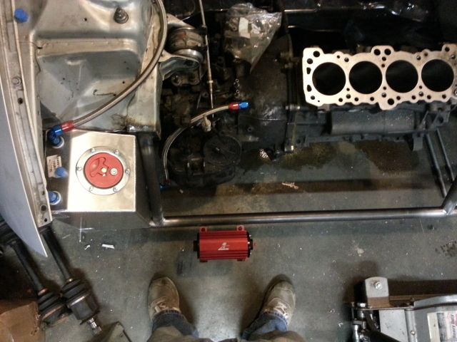

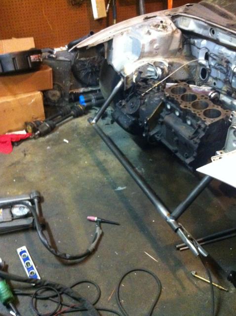

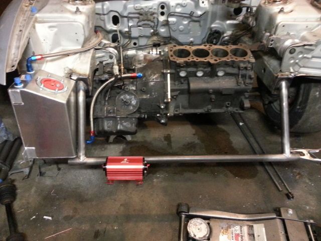

Getting the chromoly tube front done. It's a little different then you see from most, but this allows for easier mounting options for me.
Next up, we mounted the fuel cell. Sits snug in front of the passenger tire without worry of any rubbing at all.
Mounted the a1000

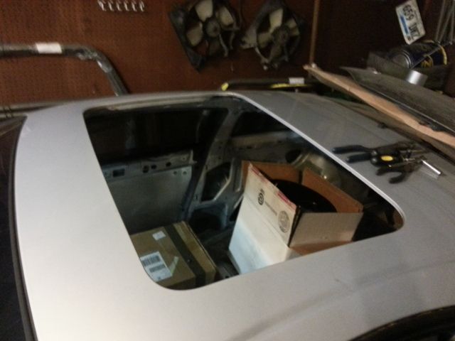

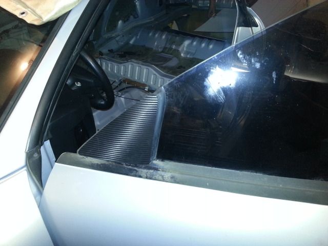

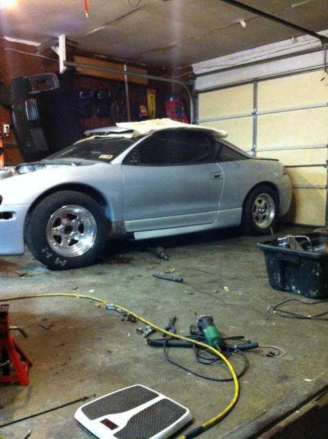

Lastly, for now, removed the sunroof....

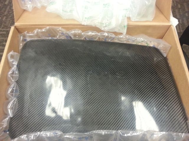

....to make room for my carbon fiber sunroof plug
