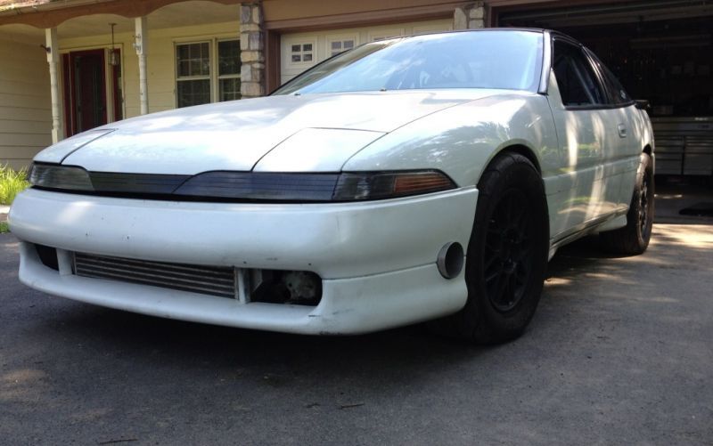

I picked this rust free '91 Eclipse GSX auto up earlier this year and it's pretty much been on the back burner until October due to a different build I was doing. I finally got my ass in gear and got the car back together. When I bought it, I didn't trust what the previous owner did so I tore the motor apart completely and did an OEM rebuild....all gaskets, timing components, water pump, etc, etc. I also installed an Evo III 16g, Walbro 400lph fuel pump, FIC Blue Max 1550cc injectors, and DSM Link V3 running speed density. I also found a good deal on some light 15" mesh wheels w/ MT ET Street drag radials as well as a single port wet nitrous kit (yet to be installed). The previous owner took care of the auto trans by installing an IPT modified valve body w/ Trans Lab shift kit as well as IPT end clutch.
With all said and done (including the car), I have $3970 into this build so far including the nitrous that I have yet to install.
So far the car has 2 track days under it's belt...Black Friday it got 2 passes and ran 12.3 @110 w/ 1.74 60' both runs. This was after a dyno session and tuning by Karl Pritz at KP Tuning...made 293whp through the auto.
We went back to Atco looking to hit some 11s on the setup a week later. I made a few tweaks trying to get it to hold more boost through the internal gate on the 16g, ramped in timing quicker at the line, installed a better FMIC core, as well as a few other things. 2nd pass out it ran 11.88 @ 113 with a 1.62 60'. This was the quickest and fastest run of the day...I did however see a 1.59 60'. Remember, this thing has a stock block, head, cams, and intake manifold. I later found out that this entire time I had a collapsed flex section in my downpipe...down to about 2" diameter. Damn chinese garbage! That's one of the only things I didn't take off from the previous owner.
This winter I'm going to throw in a Eagle rod / Ross piston block that I have at the shop, a Curt Brown built race head, Precision 6262 JB turbo, ERL T3 manifold, JM Fab drag SMIM, Tial wastegate and BOV as well as a few other things.
