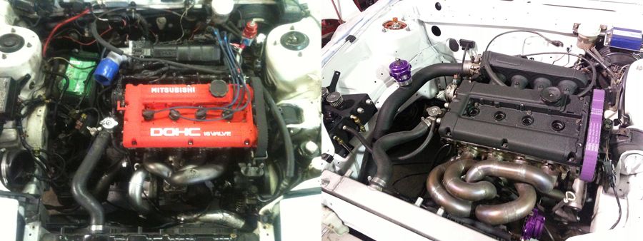

A quick before/after shot. I know it's not 100% done in the after pic, but you get the idea. I'll have to redo that pic once it's done...

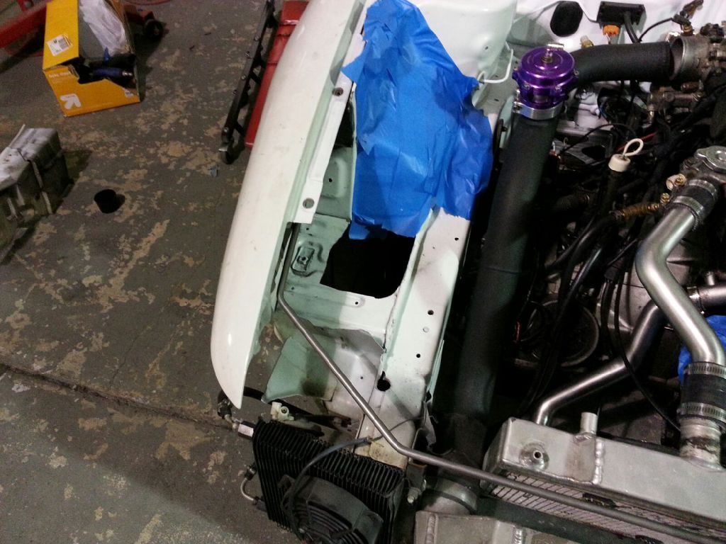

Finally got around to deleting the pop ups. Still have some finish work to do and then off to paint....

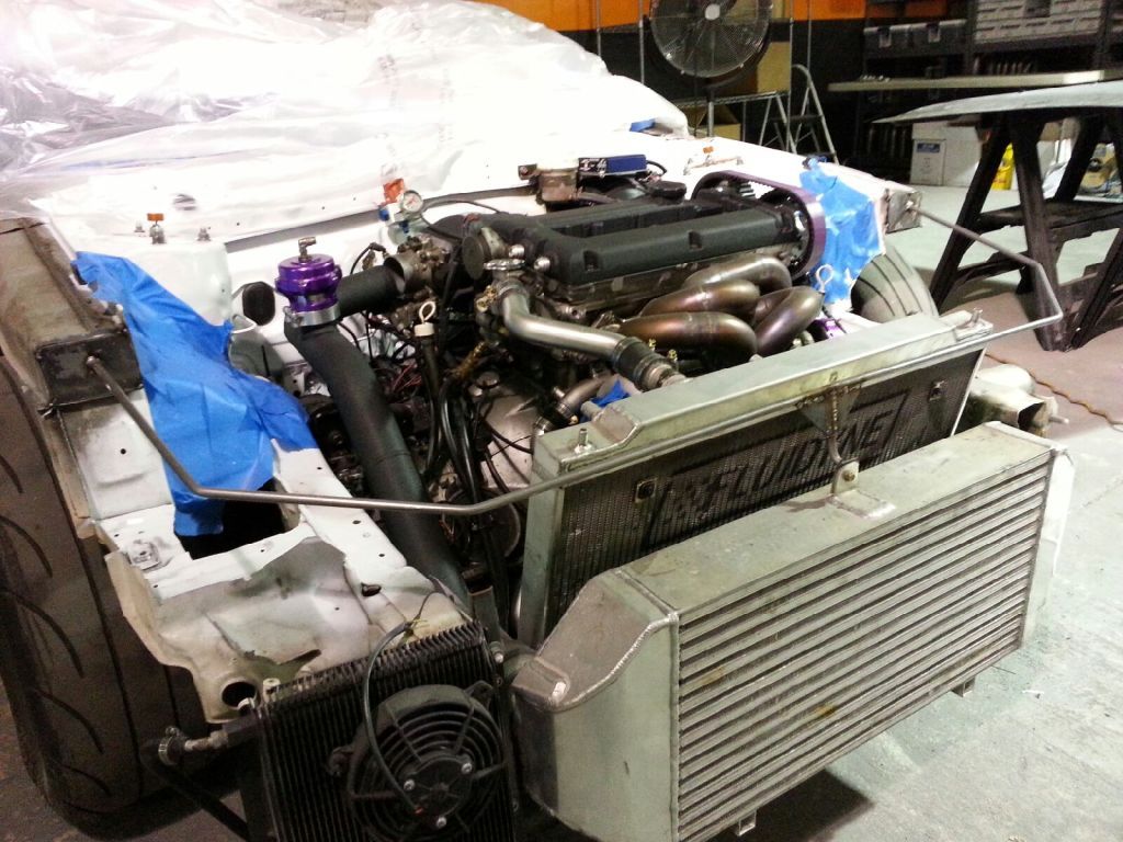

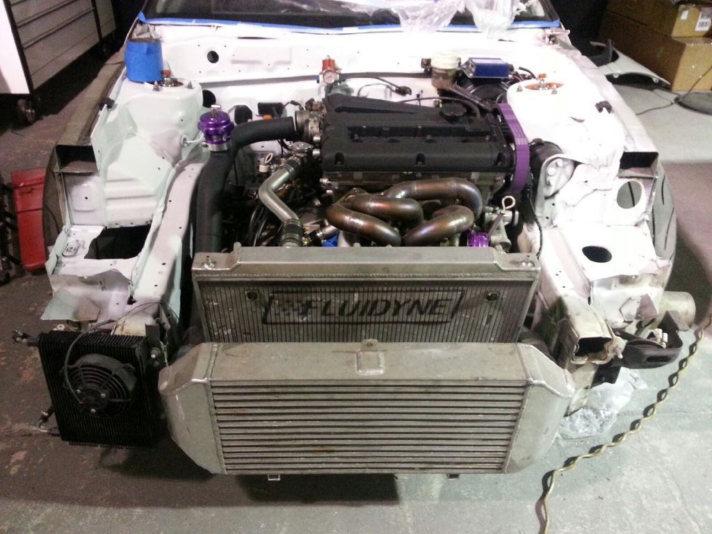

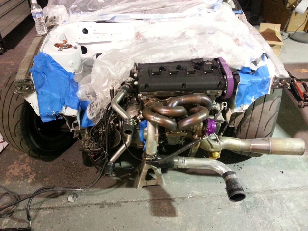

Broke out the sawzall for some fun. Started off by chopping the upper frame rail in front of the engine mounts as well as the upper rad support. Replaced it all w/ 3/8" round bar and remade all necessary mounts and tabs. The entire upper piece is removable which will make things nice and easy to work on in the future. Pretty much done with it now minus a few mounts but should have that wrapped up early tomorrow. From here i'll chop the lower frame rails and replace that with some chromoly tubing. Coming along nicely so far....

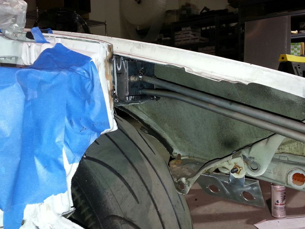

Finished up the last of the tabs on the upper piece today but still need to go back and finish weld everything. I needed to take some energy out on something so I moved on to the lower. Breaking out the sawzall again definitely helped. LOL The main hoop is bent and notched already (not in the pic), just need to weld it on and add all the mounts to it. Probably won't have time this weekend but will get back to it Monday.
