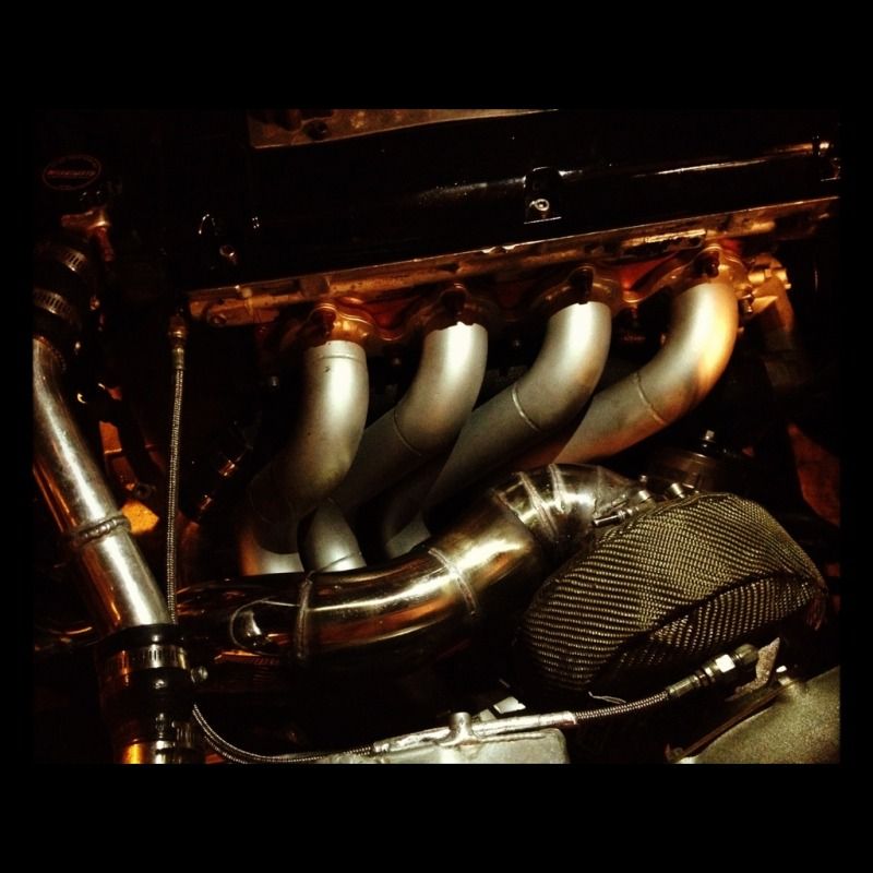

WEll got the car fired up. Storm rolled in a screwed up progress on getting it tuned in to idle. Have to make user defined setting for the 7 bar map sensor. Starter is making some noise when engaging so going to have to do some modifying on that. I'll post up some pics of the new downpipe. As soon as its nice out and car is idling on its own I'll post up a start up video.

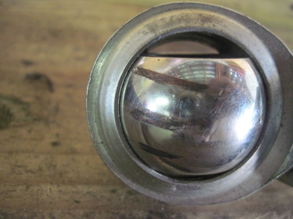

I also used the AFCO parts to make some adjustable upper control arms for my 1g. I found that after less than 300 miles, the rod end links had developed a considerable amount of play. If I grabbed the tire and wiggle, the heim joint would actually make an audible ticking noise.
I contacted AFCO to see what the "service limit" for play would be and they could not provide me with an answer. Instead they sent me new heim joints. I started by checking them for play and right out of the box, the joints had a considerable amount of play and would make an audible tick.
I ended up pulling these off of my car to check their condition and replace them with the stock uppers and some poly bushings. What I found was a little scary. The inner race had developed wear/heat marks and they would catch your nail when rubbing it over. The marks where mostly brown with a hint of blue. I do not know how long these would have lasted and I am glad that I did not find out.
I am only voicing this concern because I saw the pictures of the parts you where using and they are the exact same ones. There will be a video of the damage soon to come.

We will have to keep an eye on it. I appreciate the heads up. The car won't be on the street so hopefully it'll take awhile to put much wear on them
Mine hardly ever hits the streets. It only sees them when I am traveling to and from the track or tuning out an issue. I hope that you have better results than I did.
Best way I found to check it is raise rear off the ground, then grab the tire in all directions while pushing and pulling. I found what was making the noise with my handy automotive stethoscope. I set up a dial gauge to find .004 of play in one and .003 in the other. Let us know if you find anything.

I thought the same thing. I was hoping that I just got a bad batch, but after getting a set 4 months after the first set I can only guess that it is a design flaw. I only found the noise because I was chasing a growling noise in the rear. I was shaking everything and that is when I found it.
Here is a picture of the damage and like I said the videos are soon to come.
