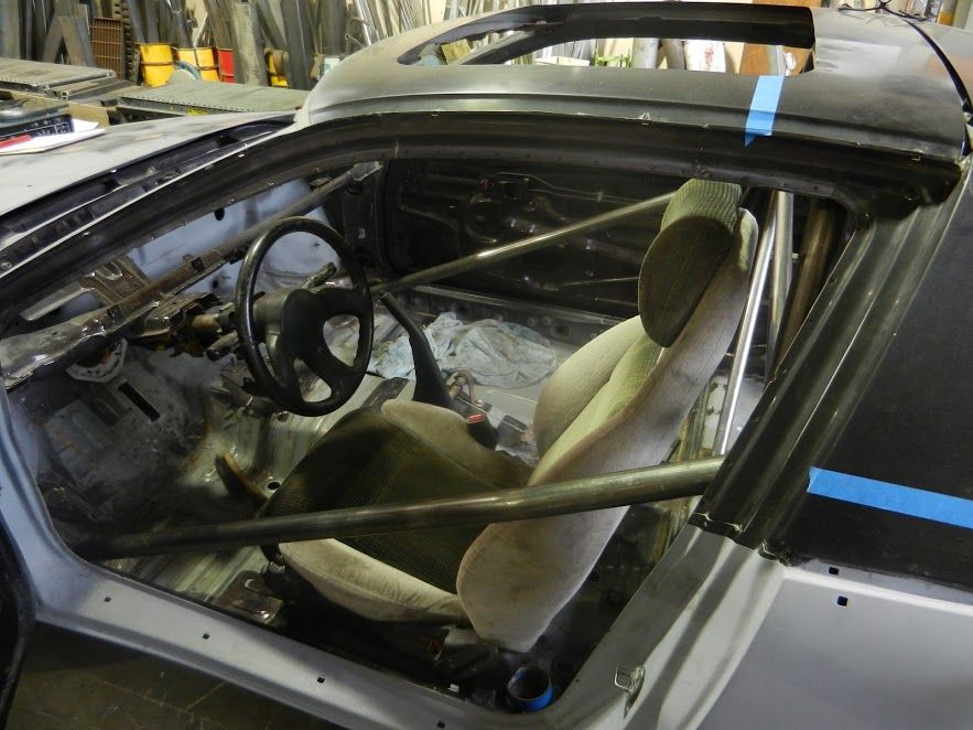

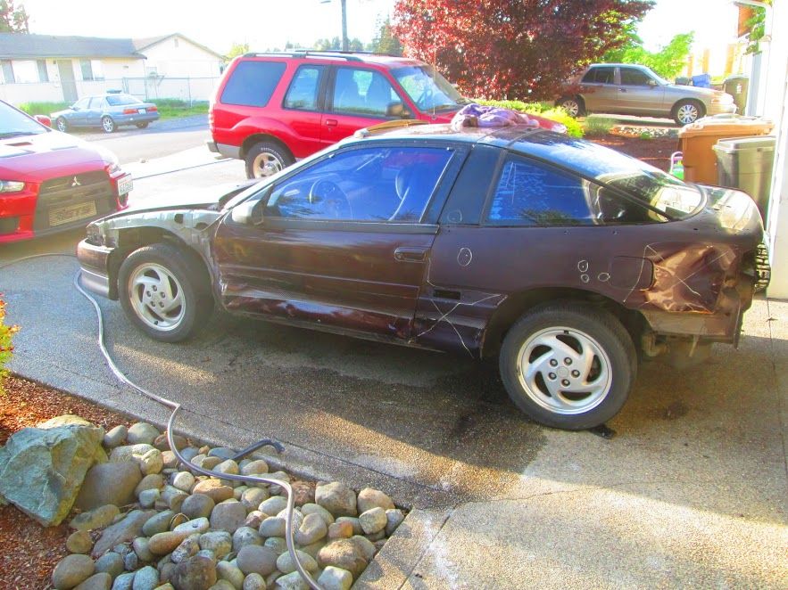

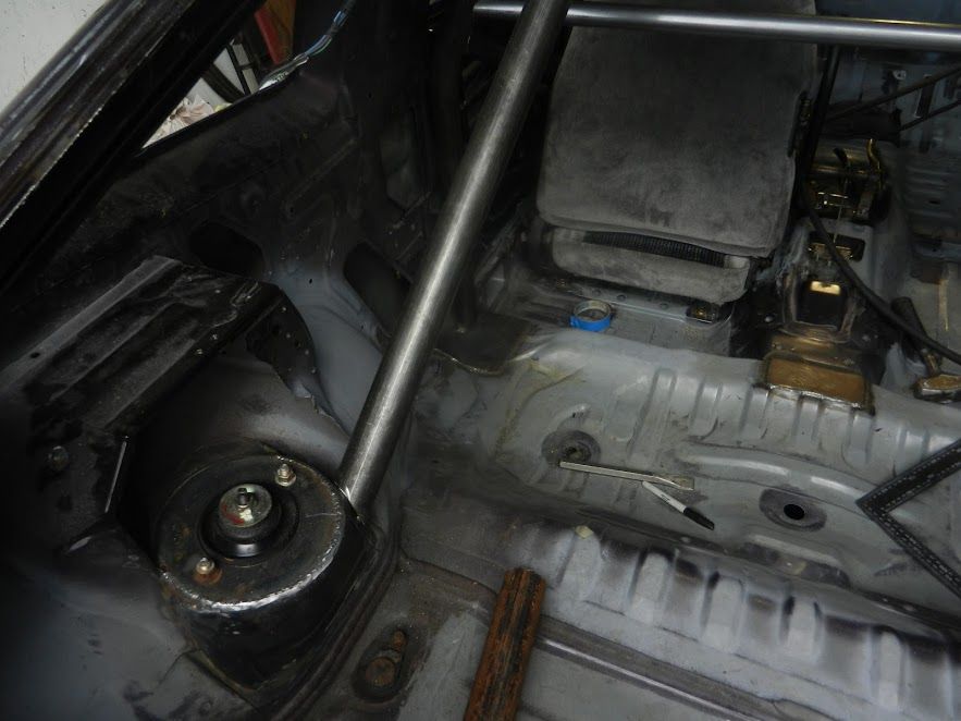

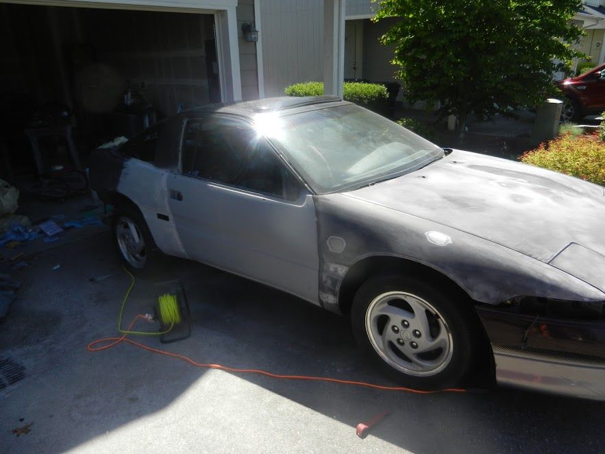

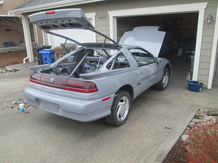

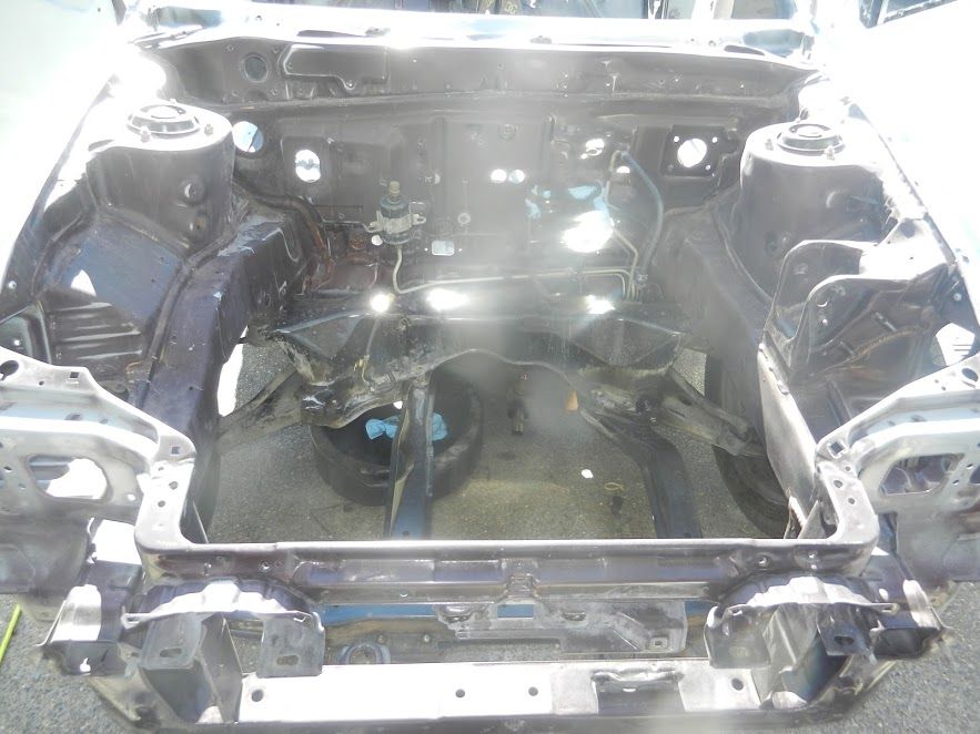

I had my first dsm in 2003 and have been hooked ever since, I picked up this Talon in 2008 for $700 with collision damage and drove it for several years stock, I decided to build my first drag oriented dsm and this was the canvas I had to work with.
I have always wanted a bolt-on Forced Performance turbo and Extreme Turbo Systems intercooler kit, back in the day on my first dsm I had a Dejon front mount that was basically two stock sidemounts welded to endtanks with a big gap in the middle of the cores. They called it toothy because it made the dsm look like it had two big front teeth! This time around I wanted to use parts that I had only dreamed of in the past, I also wanted to ditch the manual tansmission for an automatic, I'm old and was burned out on the dsm manual transmission that I always had problems with and never really enjoyed using. So an automatic swap was a must, and I have never been to the track so I just wanted to make everything as easy as I could to be somewhat consistent as a novice.

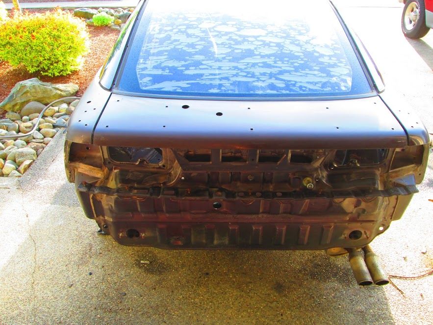

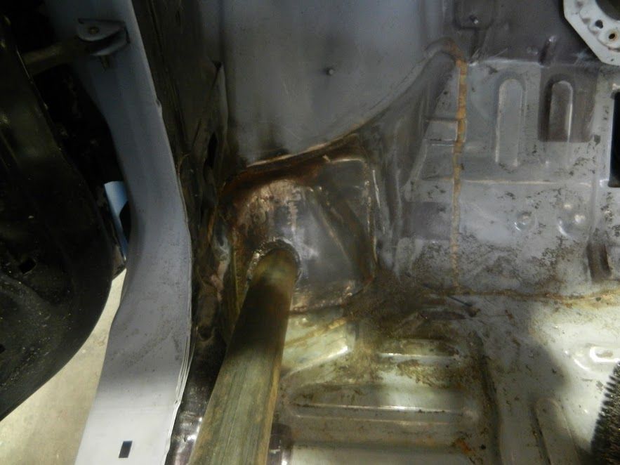

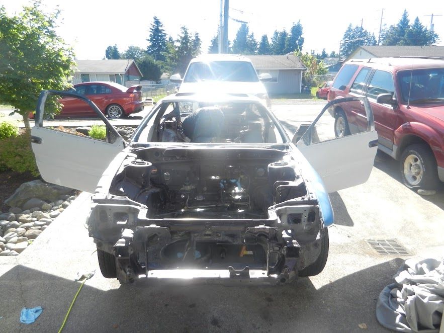

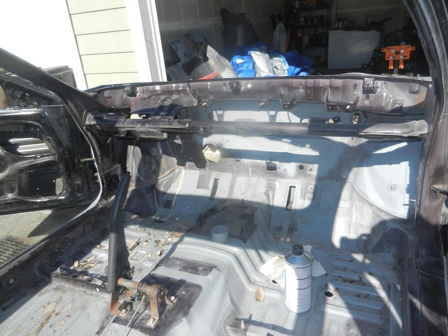

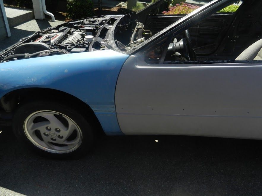

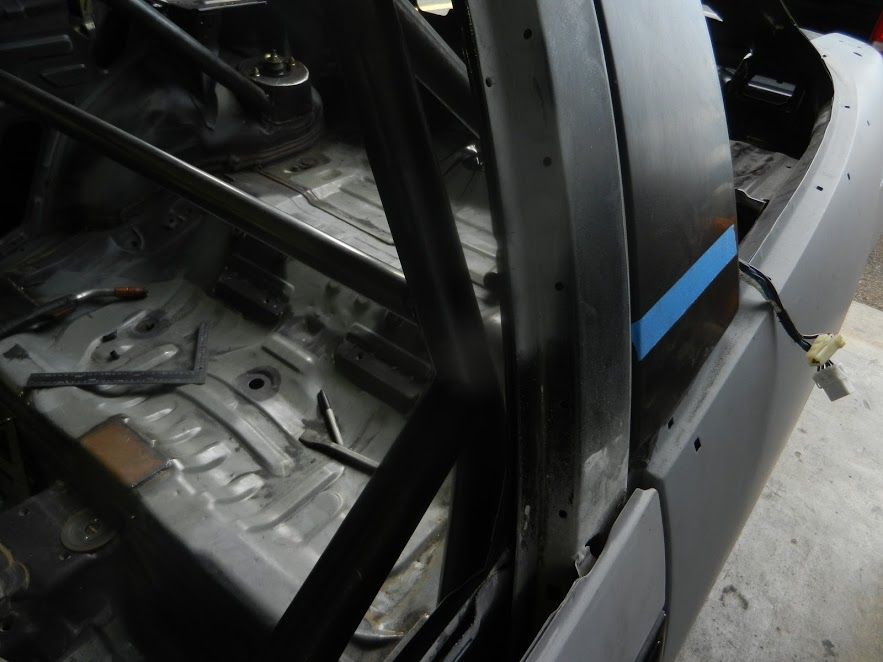

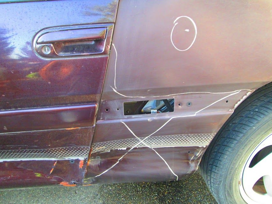

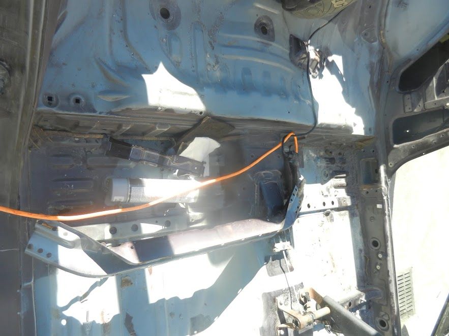

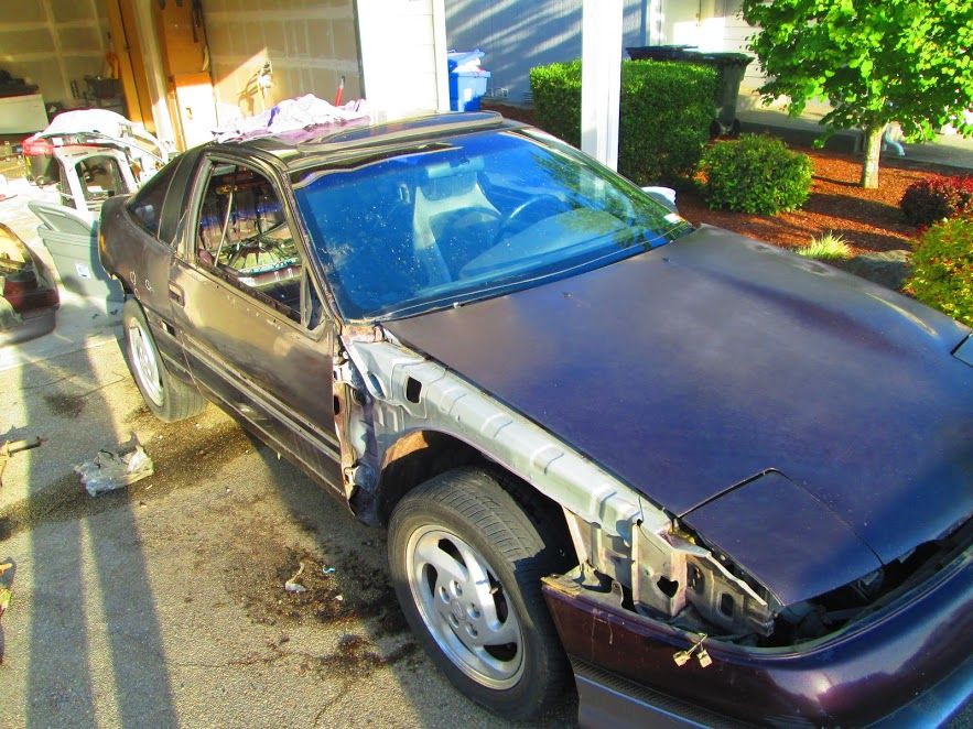

I first stripped everything down and repaired as much body damage as I could before sending it to the professionals and eventually having a cage fabricated for it prior to paint. As you can see this is one rough Eagle! But I am not one of those people that buy 13 cars in two years and go through them like toilet paper like these hipsters now. Dedicated and determined!

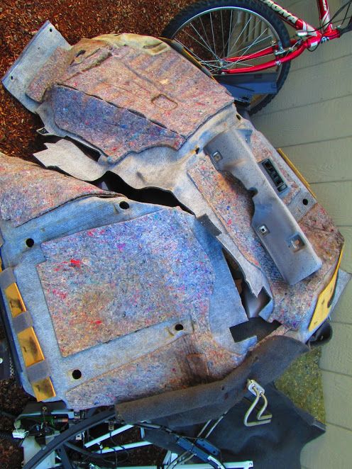

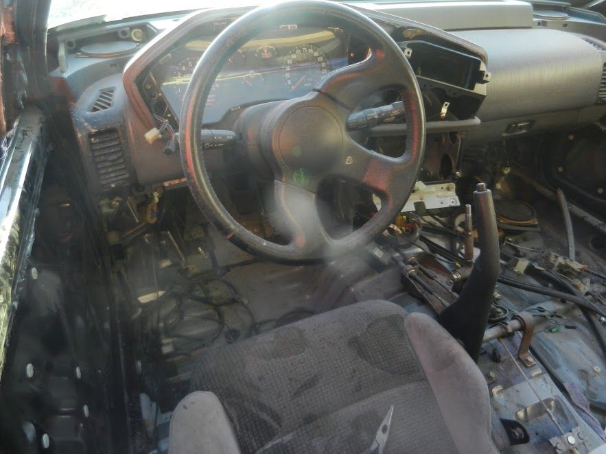

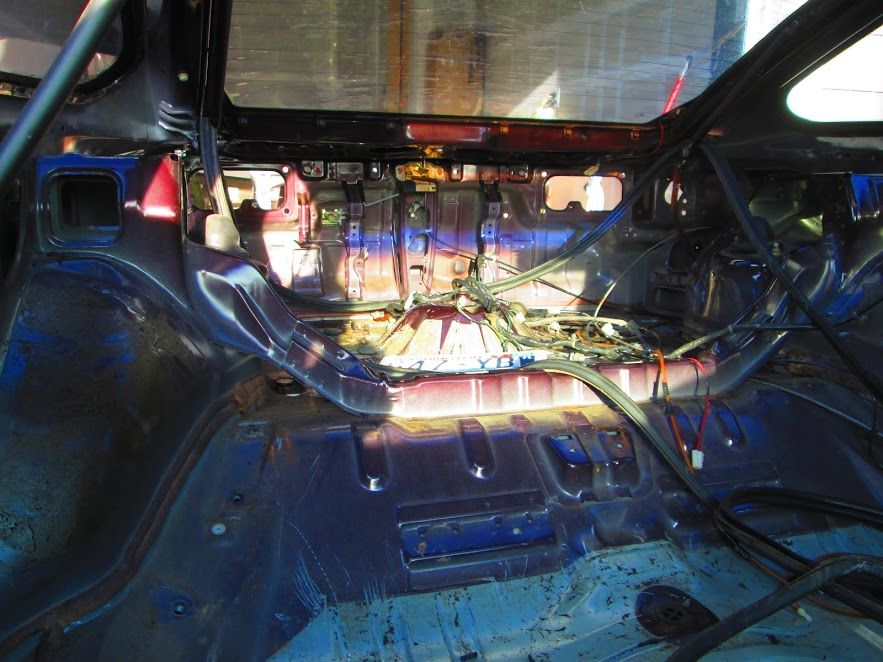

Here is some of the junk I removed! this interior was as bad as the exterior!
7Zb2OU0QFYISMLm0Wm0YPVu_908hf2fgmQZ8_PhqC7jB4kww4KpicU-FisMLaKgsMO7-lo3V0WczOXivW5B=w497-h662-no.jpg

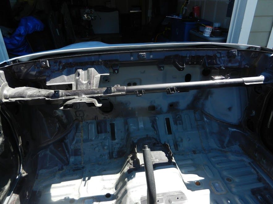

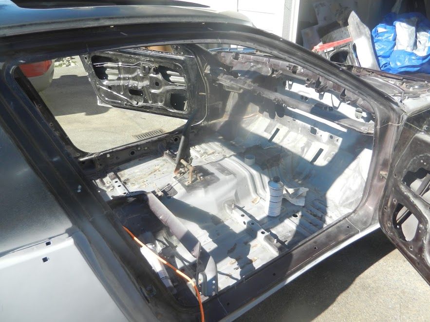

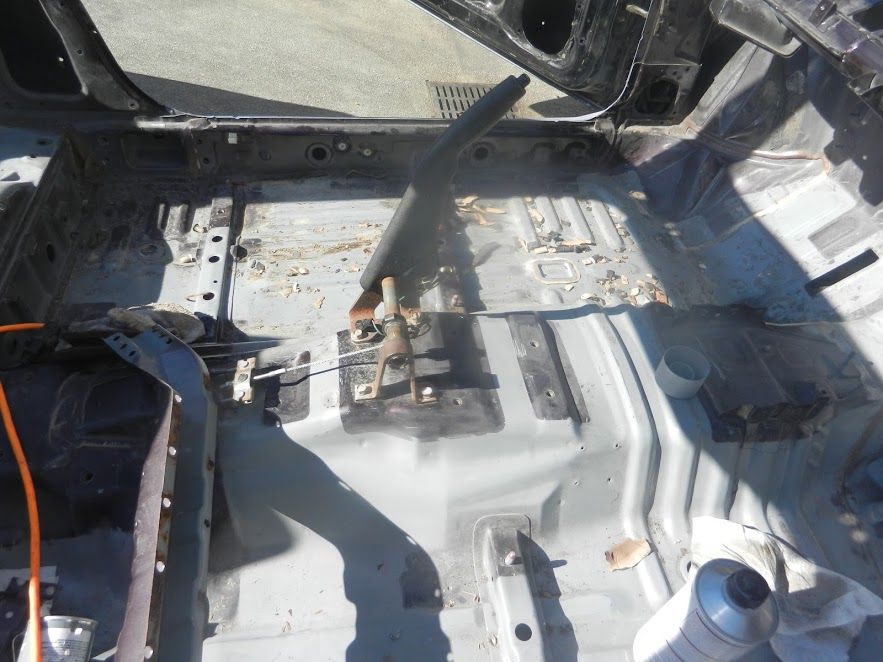

Removing all of the sound deadining and insulation with dry ice and a propane torche in some areas, I must say I was very surprised how well dry ice worked though!

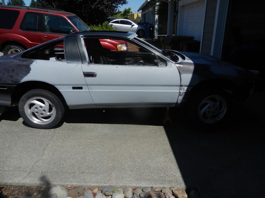

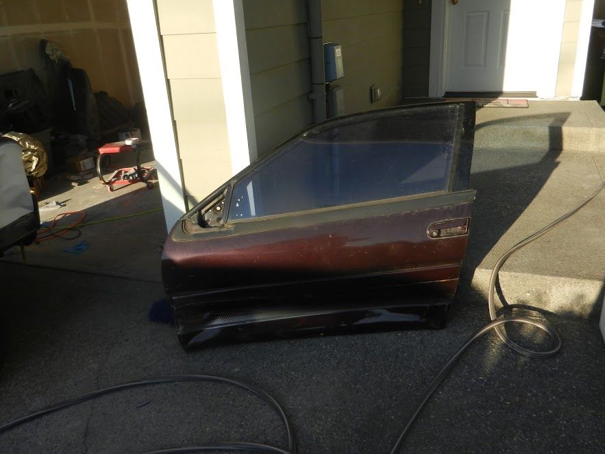

Pulled off the useless busted door, will find one at a wrecking yard
GoeBmfW1IokaME9jlCyyeJylDEnau8ygDhOdMqbk70AzXi1sRufTQxtPRqdnxrEAr8__3gKLdaHU-gxg5uj=w883-h662-no.jpg
Sanded all the rust off and coated with self etching primer until the body shop gets to it, I do not have the skill to repair this dent:(

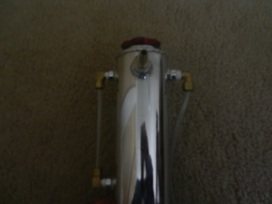

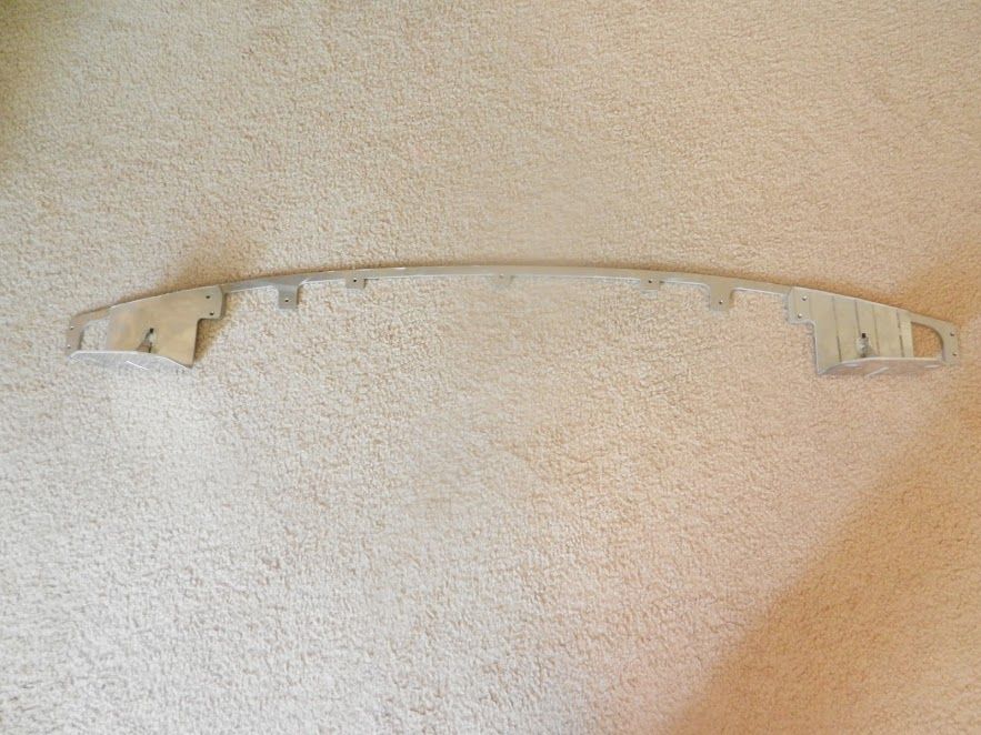

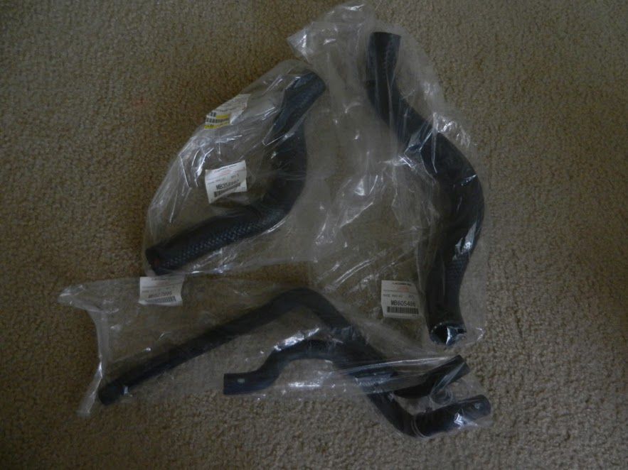

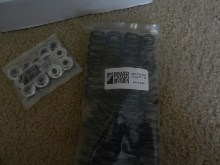

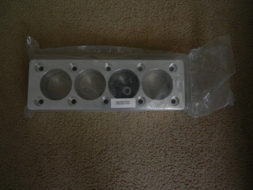

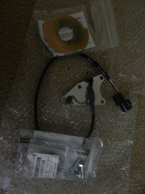

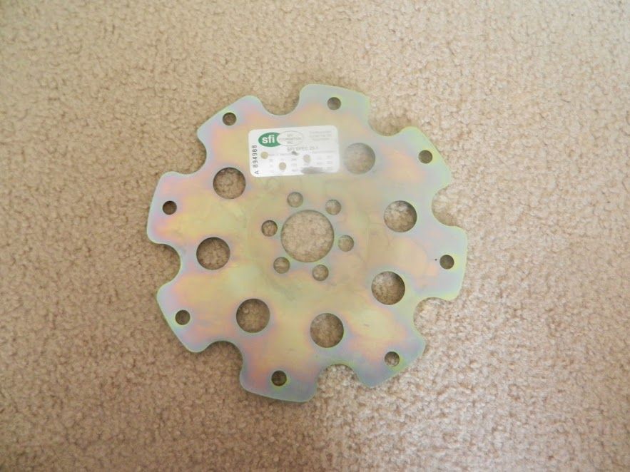

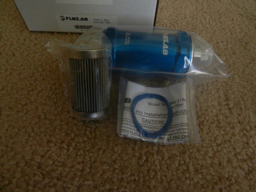

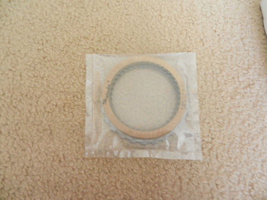

Some parts from the build.

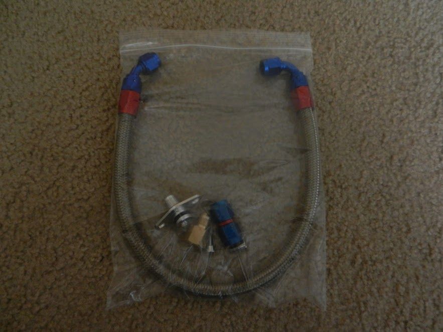

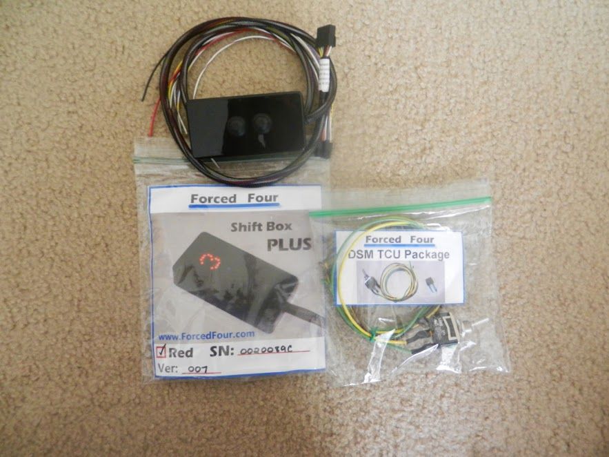

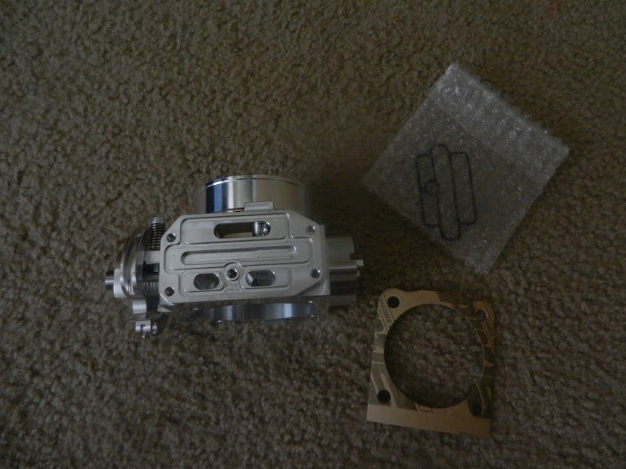

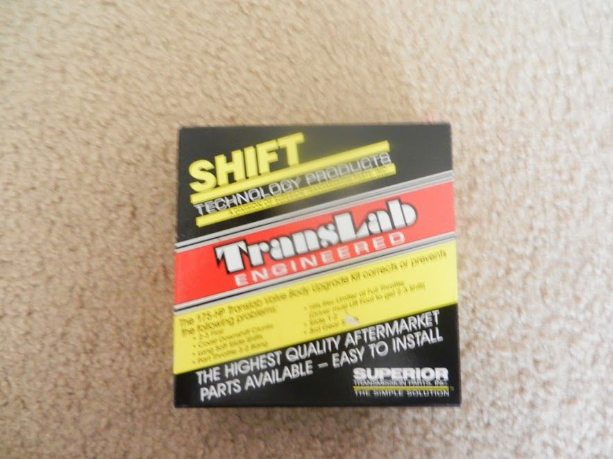

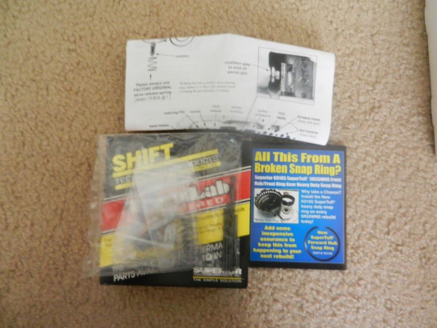

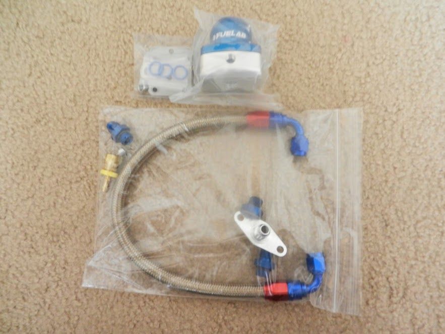

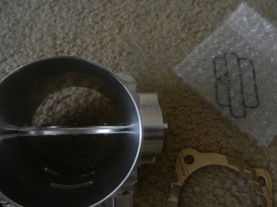

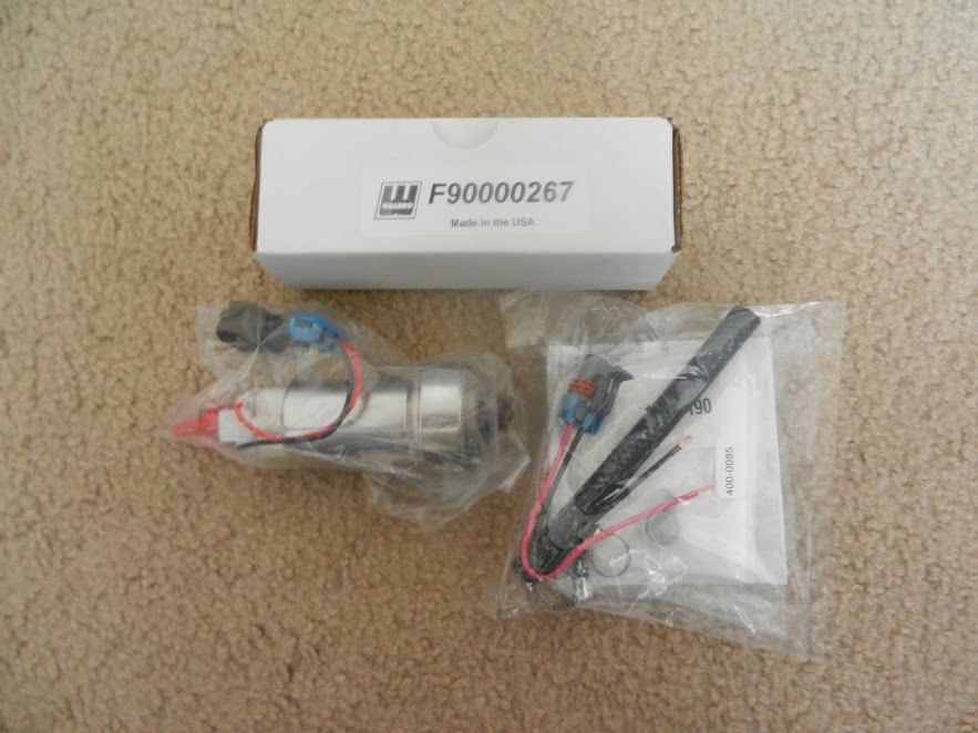

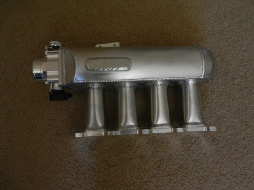

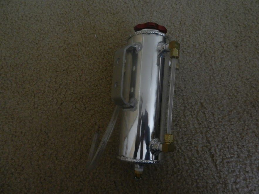

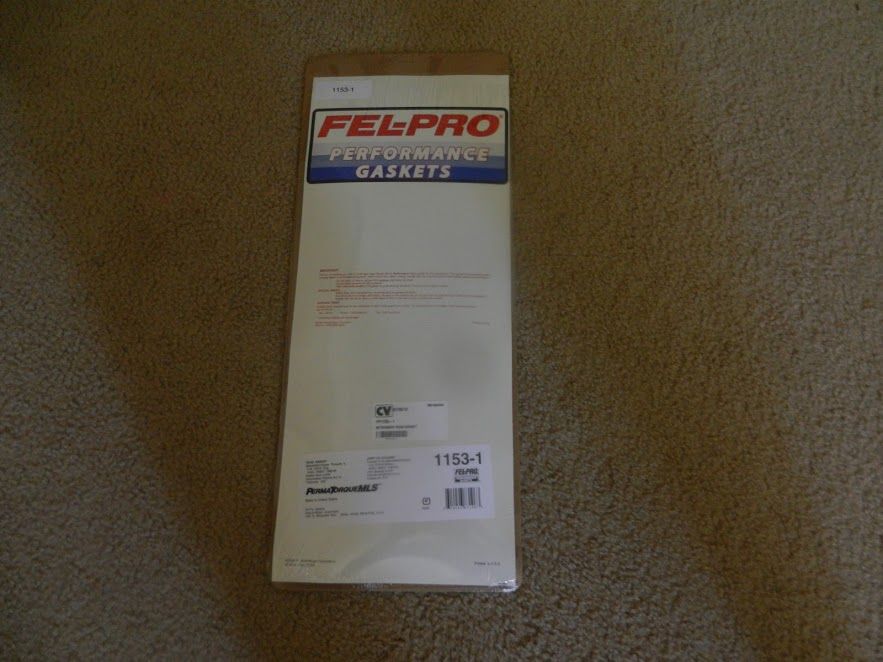

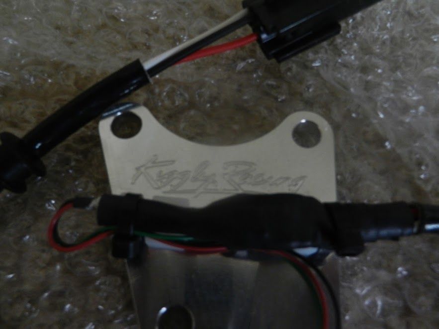

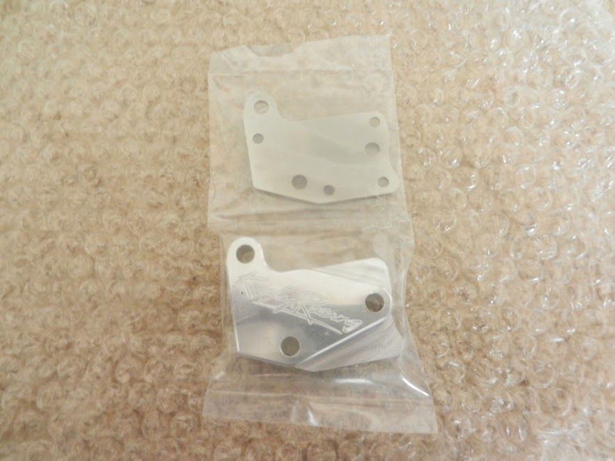

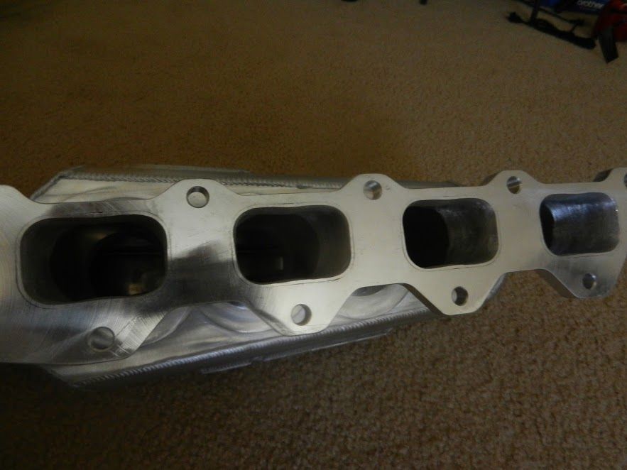

Gotta thank Kiggly Racing for making products available for us to use! Picked up an auto trans, t-case, rear differential etc... from a wrecking yard in Seattle, decided to pull the engine too while I was there that way I can drive it to the body shop etc.. and not need a tow and get the other block machined.
So my plan as the title states is to run an auto FP Black, with a 2.0 Liter on ethanol. Once I am used to being at the track and become a proficient driver I want to run a mid mount compound turbo setup, I do not want to use nitrous to stall whatever converter I end up with and I will hopefully be Kevin Jewers mini-me hahahha.
This is a first for me in just about every aspect, and my first build thread so please bare with my thread etiquette as I have never had one before, just lurked for a decade and some years. I do plan to have a torque plate for the machine work so I ordered one and I also have a Kiggly Girdle not pictured.

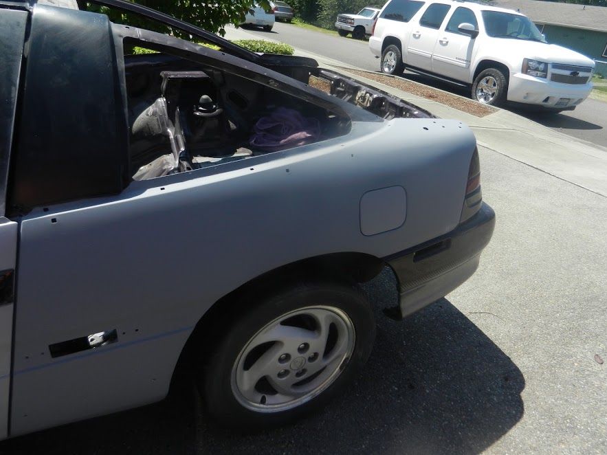

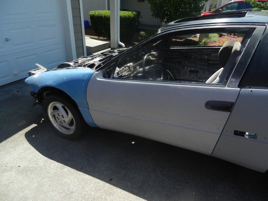

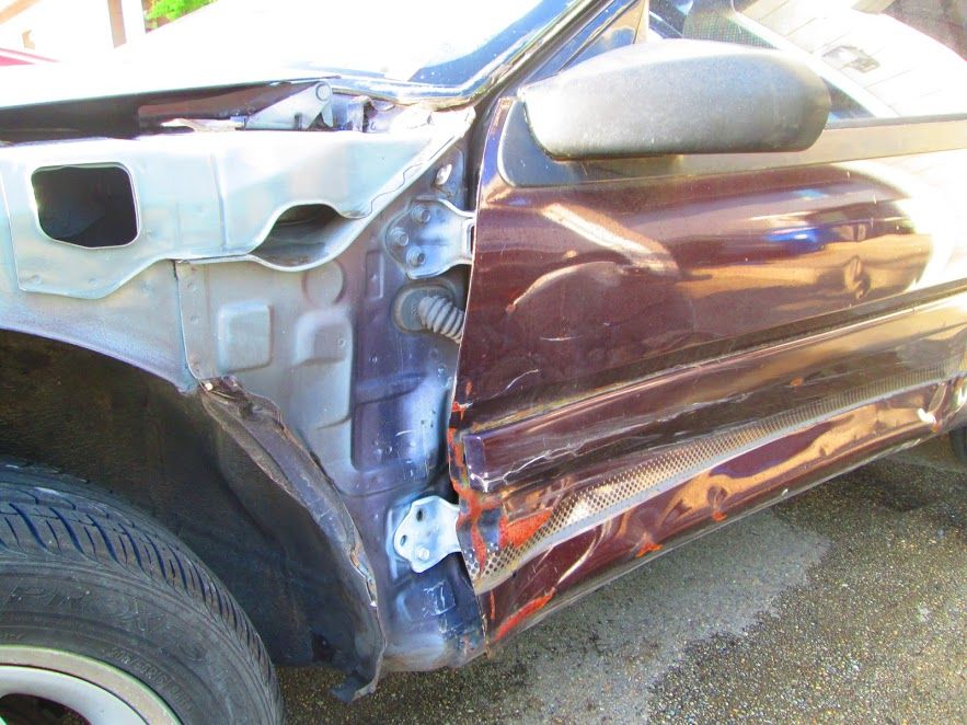

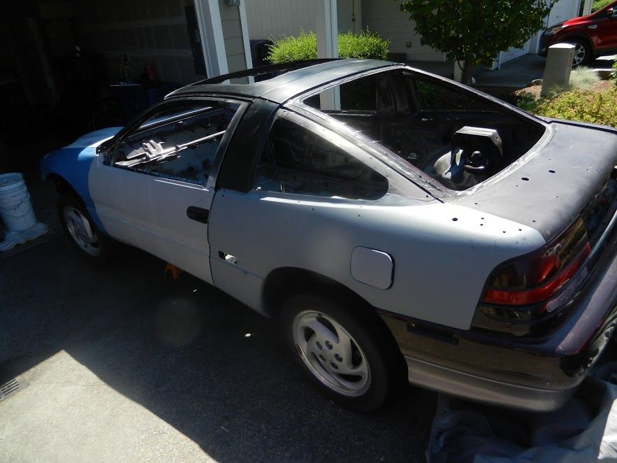

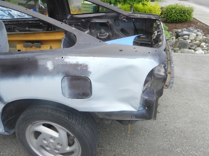

Repaired some minor damage on the passenger side and used some guide coat and wet sanded all the high spots down smooth.

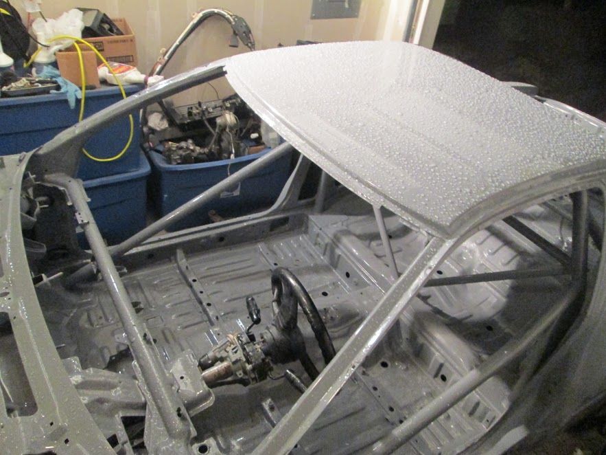

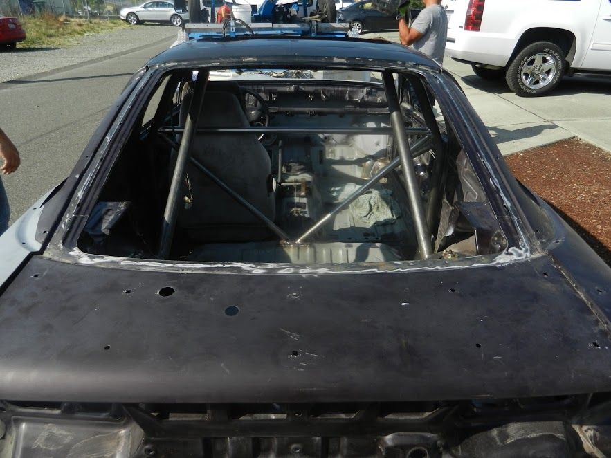

Pulled the sunroof, going to cut the roof off another dsm that does not have one so the body shop can make it right! Pulled the seats out so I could get out the dash easier, going to put the drivers back when I drive it to the body shop and the cluster etc. so it runs and drives. Its hard to believe I drove this for years and shipped it across the U.S. a few times!

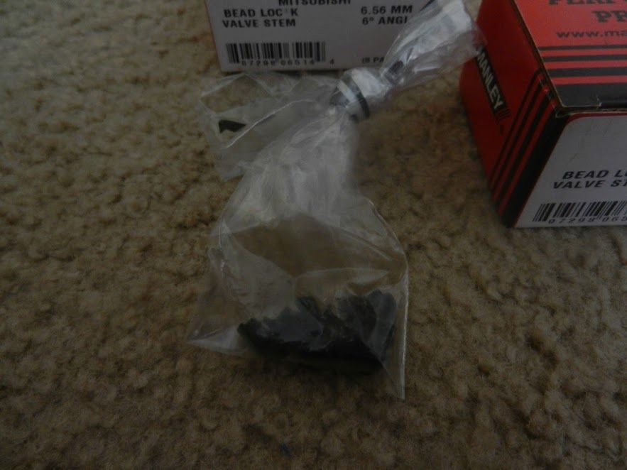

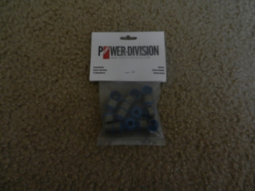

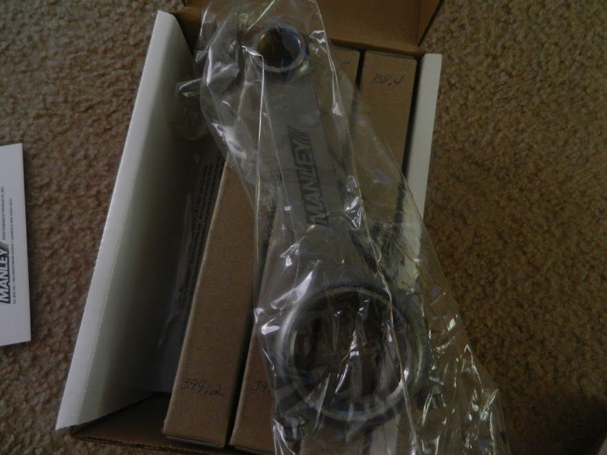

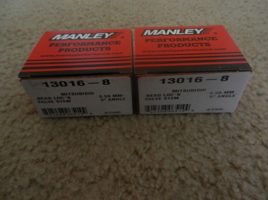

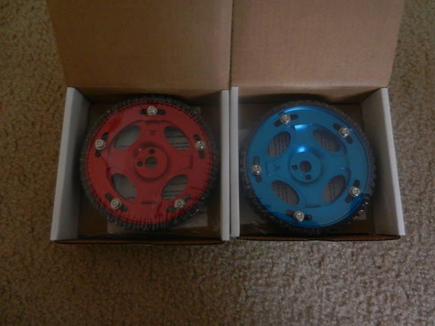

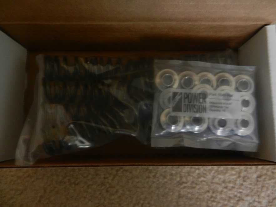

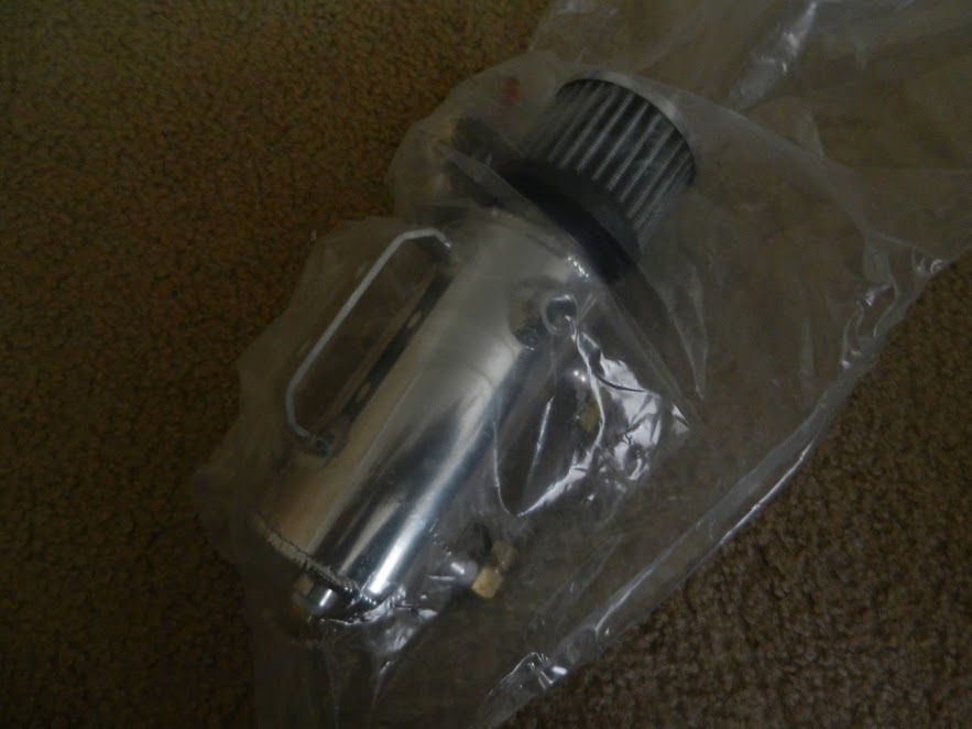

Some parts are here for viewing pleasure too!
IzqB852lh9q0UHHBUr2cWYNMh7D_fIGrgntmOVv1HYODax0EU6mUtMQUe1nQdetC6040kh2SGWthaMNAS7K=w883-h662-no.jpg

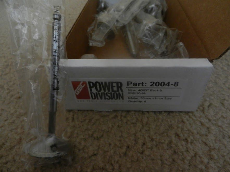

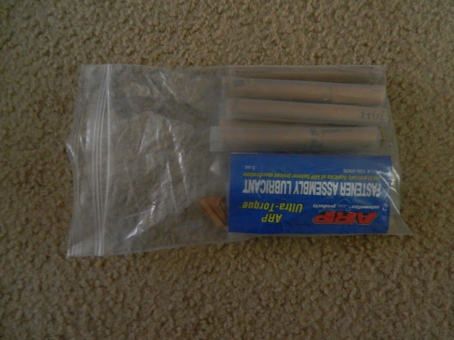

Trying these fancy gaskets for the first time, If the head comes off when the motor is done due to whatever I will likely go back to composite or oem MLS in the future.

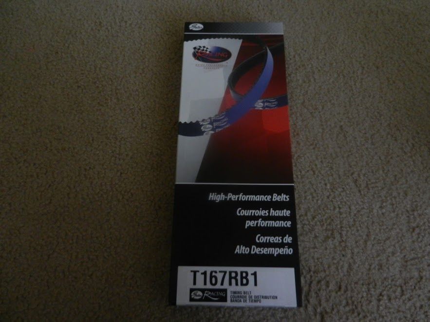

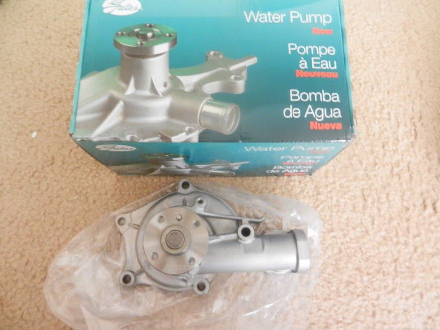

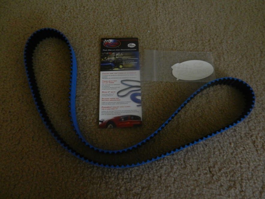

Gates Kevlar and water pump!

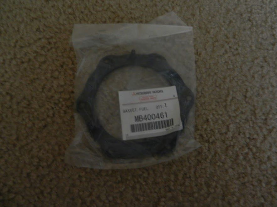

No way am I using the old crusty fuel pump hanger gasket!

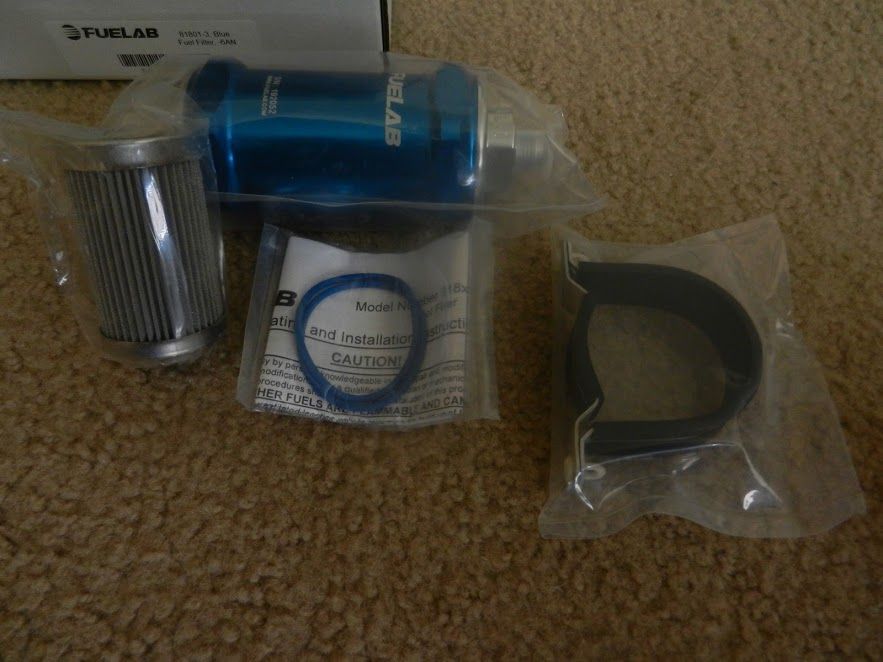

Simple -6 kit from Extremepsi makes it easy on me!
Walbro 450lph
BkVuR_vSWehrXyKFgYZTrvwe4HW2M1NvM4WQWEonehz_0zwNyWW9zm-EYxFZiaESgUrWdMxXsu-DUkwiayC=w883-h662-no.jpg

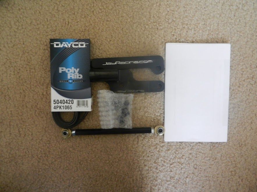

Jay Racing is awesome too! They picked up where taboo speed shop left off and make awesome parts for the 4G63!

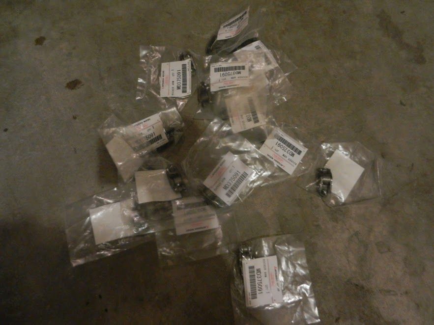

Went to the wrecking yard today and picked up some stuff! More updates to come.

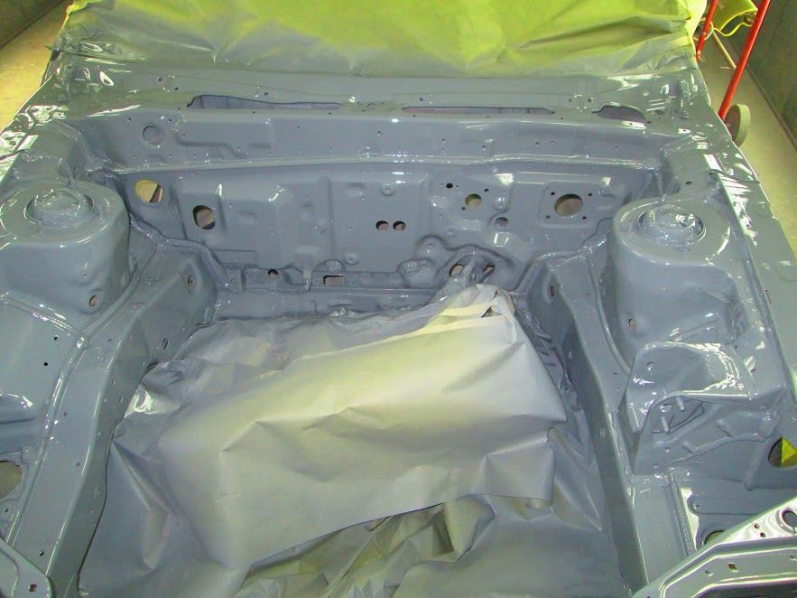

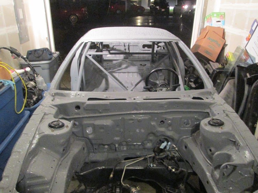

Back from the body shop, they repaired the major damage from the two collisions that the car had.
Srn3HjxWezbxWxAUNUeoxg6FaXYxal8BN-zuziVrTVT5vEi4mlp-3t3qq1u7hnsfdElkYiS0hTcUZMLshae=w883-h662-no.jpg
Or3AuxopUuu5WVeS34YBSv33emVnJ3LZzaWLAmCSBlut1lCFGpvEkiEuh8F6mIMnG62RZZtmlm6hZo8NpCa=w883-h662-no.jpg
G6d5R-YZEGI4qXr6Qhw0FLb-O6GG6GPE0SE3JbibQWRx1rS5PbnLRTVPcrmXHHiNV8ILXvnjA1jujxbqSaE=w883-h662-no.jpg
It was fun driving the car to the body shop with no glass, hood or fenders! Now I will be stripping it down further for the cage builder to be able to access what he needs and then it will go off to another body shop to have the roof removed and non sunroof welded in and finally the paint.

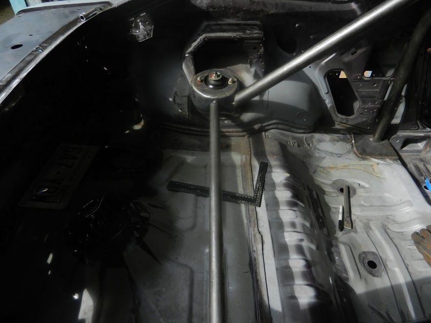

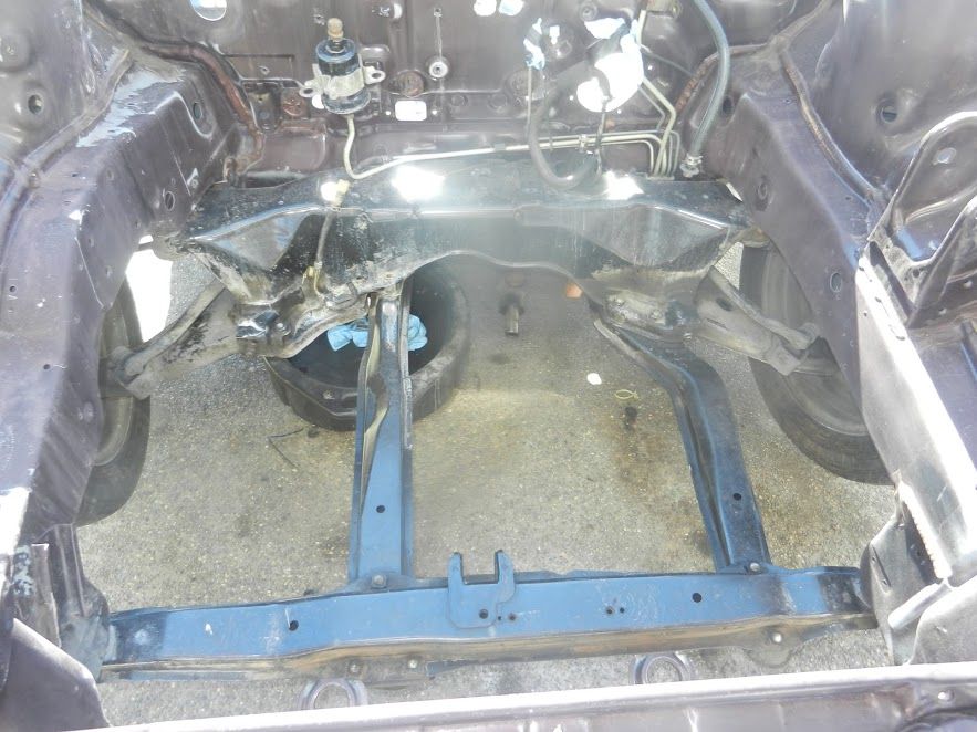

Pulled the engine and drivetrain.
ABtYQUi_IsUFzoIJXONEpNQJ_H36vmyvE30xJWWTR2nKyoDUKXO4iNMYpxLPY8II3cJFyCAn8ypUXR7gxvP=w883-h662-no.jpg
1pkXtOOWlvoewf75EWGxJ7lKlbZJFyBdGSNmTHJg28LRXhb8lFehqNvpMvhASQRLNwZ1qPgTdGdb-wo5blt=w883-h662-no.jpg
7Twynv_4qi2a_4lLRnlH_dDZiv_58a013-N77YhZ5WnhzW_ryBYJ9DiT6WySrmStDLATLbe4_QO_al3170b=w883-h662-no.jpg

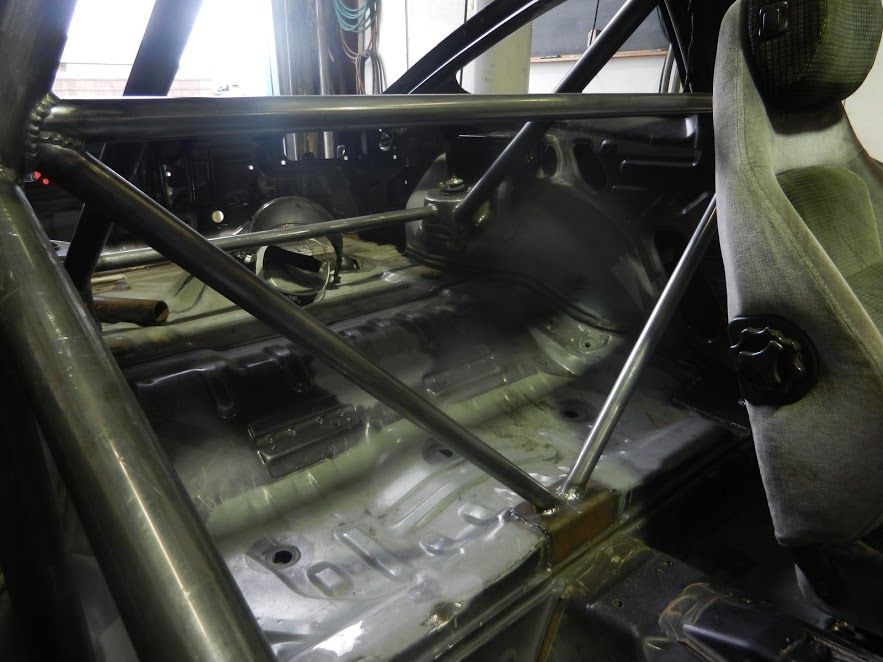

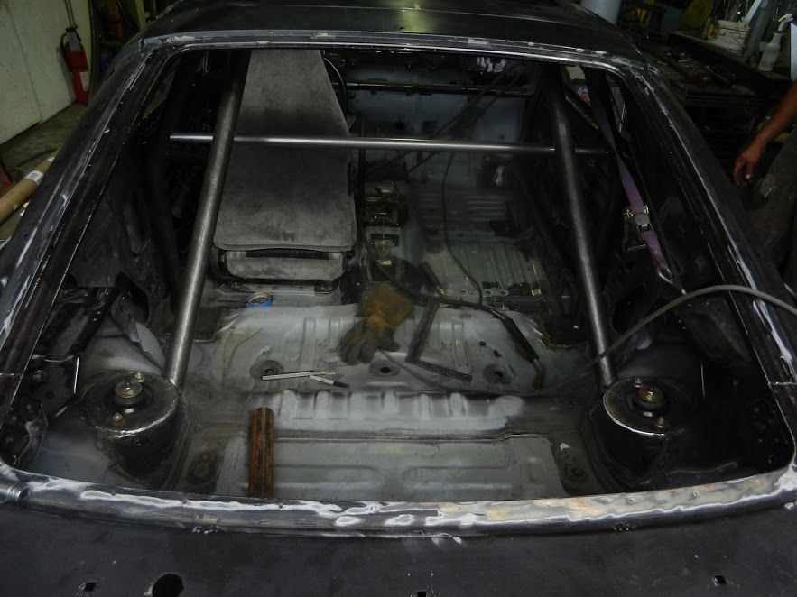

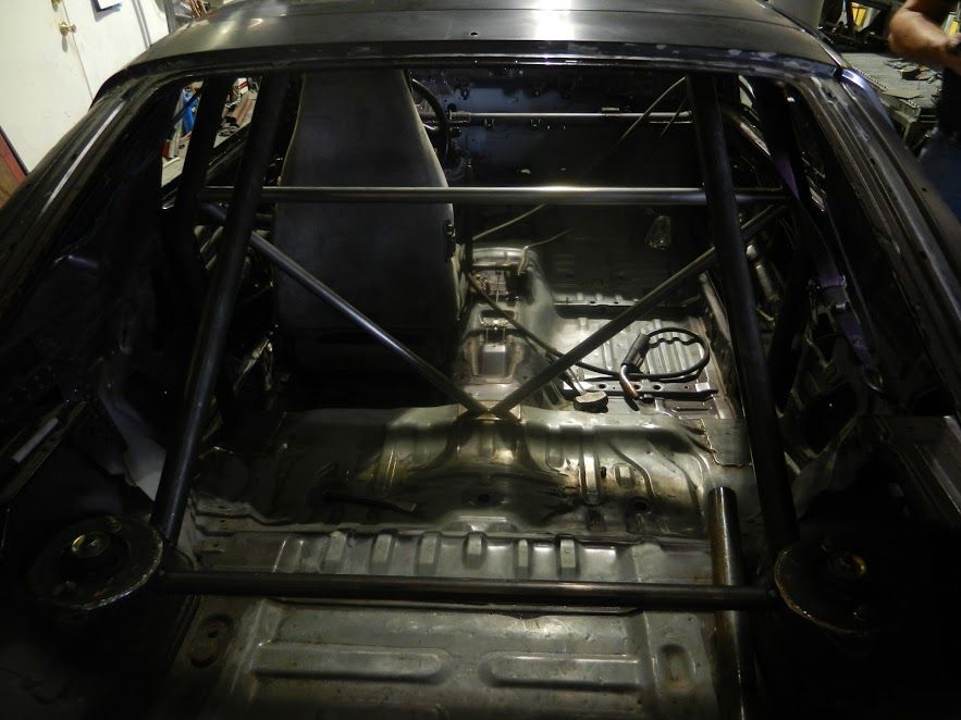

Next stop is the welders shop!

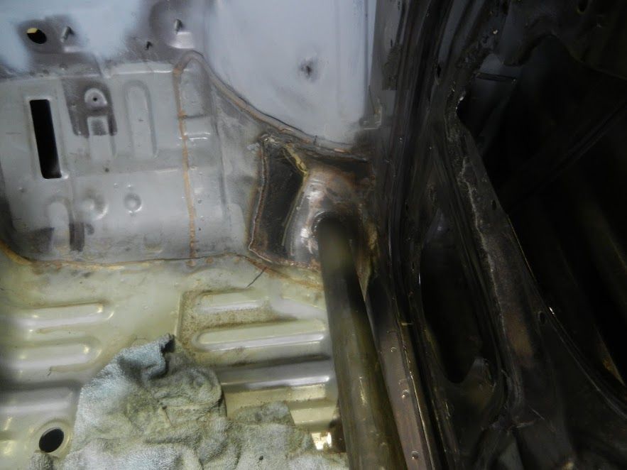

Before
2vMMbB0s7f1fp5hy9E-KR1bEBgtXSBq1Yk8GNePbrtZFH56NVh0lrABZkFVHphMaOMlofdz6TyiL7hqsO4j=w883-h662-no.jpg
After

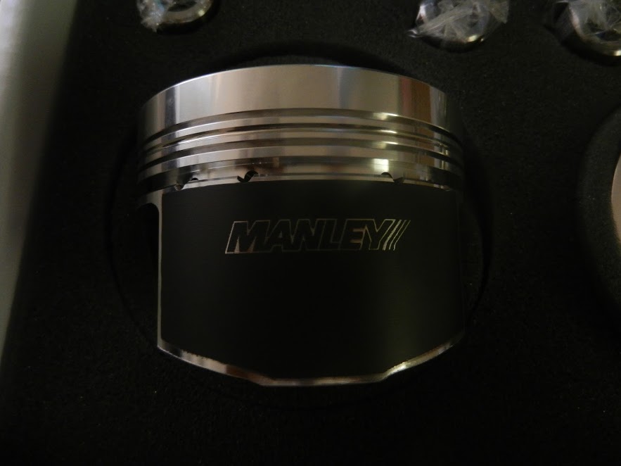

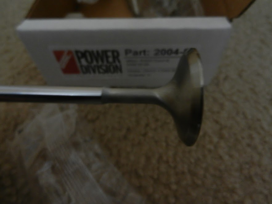

Some hard parts from the engine.

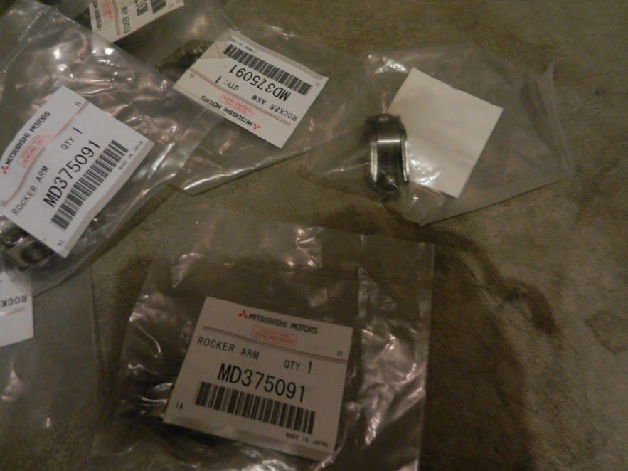

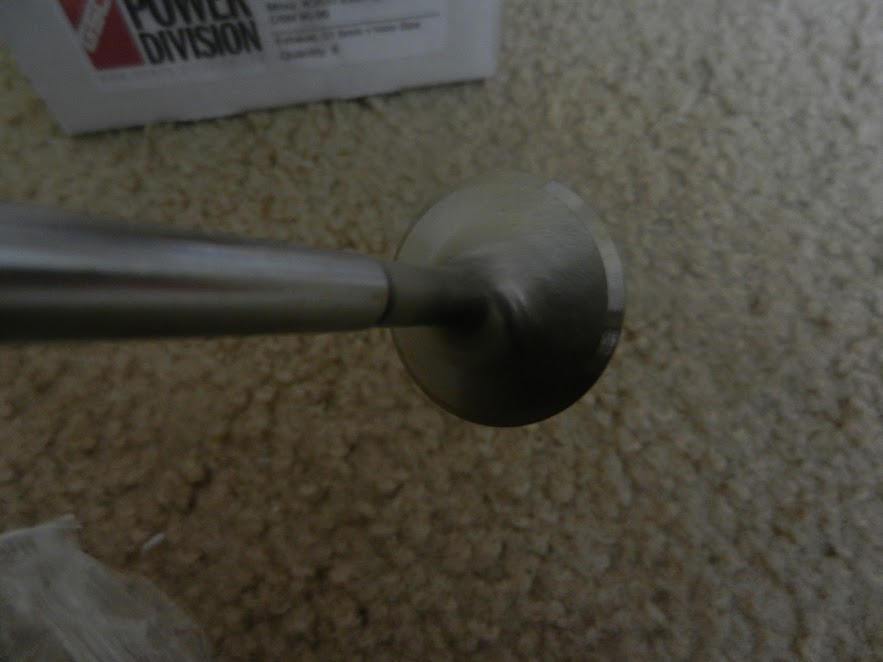

New OEM Rockers
GSC S2 and everything else

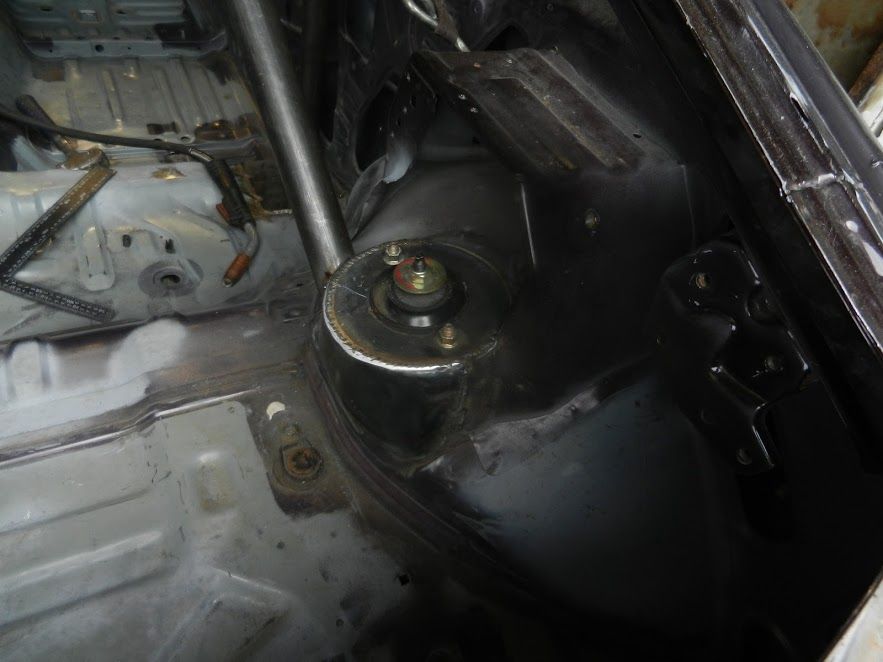

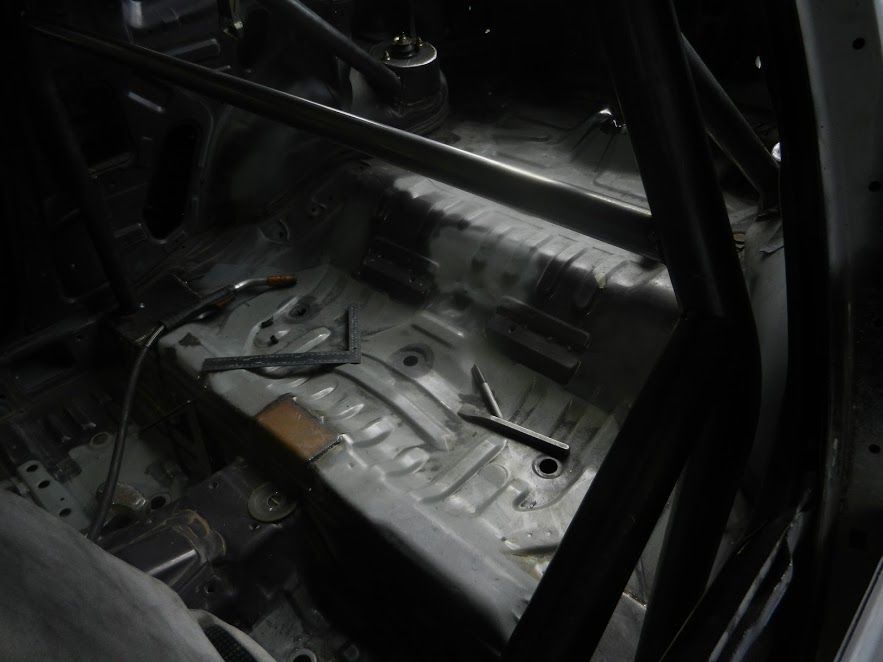

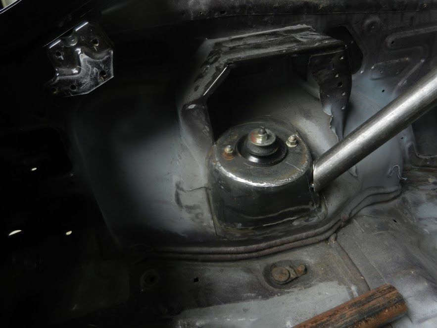

Cage Is In!
DtHuZoiNzMpQYtfheCgemo94cUxj4LuvKoX9ZLKEiErkjCb3BaW1Q65F4lz830uufNpJO7CW6j4e-ubzllG=w883-h662-no.jpg
P1aFcE2r4rGOqeYE-xV-baxzJGFdwymrPfd3GYK6Sh2Oi_V0iMMlNnHQQIkv20H6LNXUP2GgfhmoXswEcu1=w883-h662-no.jpg
EY7kjgdfuTBQfSgPqCOGGDvRNjTNoVpQpt_8jsxaVtFyW9wkzapxarPYHPyXH5cg4Z-lHfKkRPacHF8kois=w883-h662-no.jpg
HKxkTU9cdtppXZX7TxLNPNulwrdymM6yEFm5TwQDE7U_5pQi3W5gq1YNAKv-GFwDLTxXa71qdvRYlAUw07U=w883-h662-no.jpg
Rs_7vjR7tBMsomUwriXsX0jwhvSK9KeZAKsvFotghTe7cX2cRgR4nh8XVLNnl4zoccJPFjymyF8YZ6jHTcl=w883-h662-no.jpg
IQhQu5dspsZFzKltLY6rXeSSsJRyB1W6tHWrRD8vlD9EdfxOAVBp_eTetwvJTsGoPO7kGJKactuPlZMTc5B=w883-h662-no.jpg
edgyPLxfZqK0upQyj2npsgi6dSMO8PCrd1oQRbi1LoDmr2rGEF4QNSEkEGOGZEgn8DUzsuSpn4WiOhVGhxY=w883-h662-no.jpg
iNt5l4JaX0qJv7uyFtxoZY35oR-Dc39Bv7X55j9Lt3OafnNs5RmcaAF7yYUGH_L0PCT-FG3DmieZEXzy2hX=w883-h662-no.jpg
ML03Nxf_GC4iTazSUISTw2e06mnMsnjAJweWGvLFTbayFxiJh8xRfBrhXvKc_L4u_T57eUvpdTr1OuIodhs=w883-h662-no.jpg
d-dncpFh5CuqfgeSTDgWrCzTu1E-swa2It4CIPe5dLZ4sokYMu1pOw0RHCsHXc_eTSYKcbPKdaU5fKGLA6X=w883-h662-no.jpg
_Z1lwQ-DvmQsdSZUl2RN58tif5Y8YWMfQiQ3cn6crP9pRYCOAGpxnJM_pKwEeVc02zBwrSszc39FScL0ftt=w883-h662-no.jpg
7dVpbbhLbkuRTX6JlzwZCqHIP8QABLPtio3tQS47J0wUmtxRgxutmFzgw2WhbQ16sKDMifL92IsJat29wEV=w883-h662-no.jpg
riZb2lUDwJYs5G6CmZ2k07aOoPRhHI6cGfyxztt8XuZTbWHHjhX0-I-R1LJf2Us_KTGjfeHgYwCkAQfcV-5=w883-h662-no.jpg

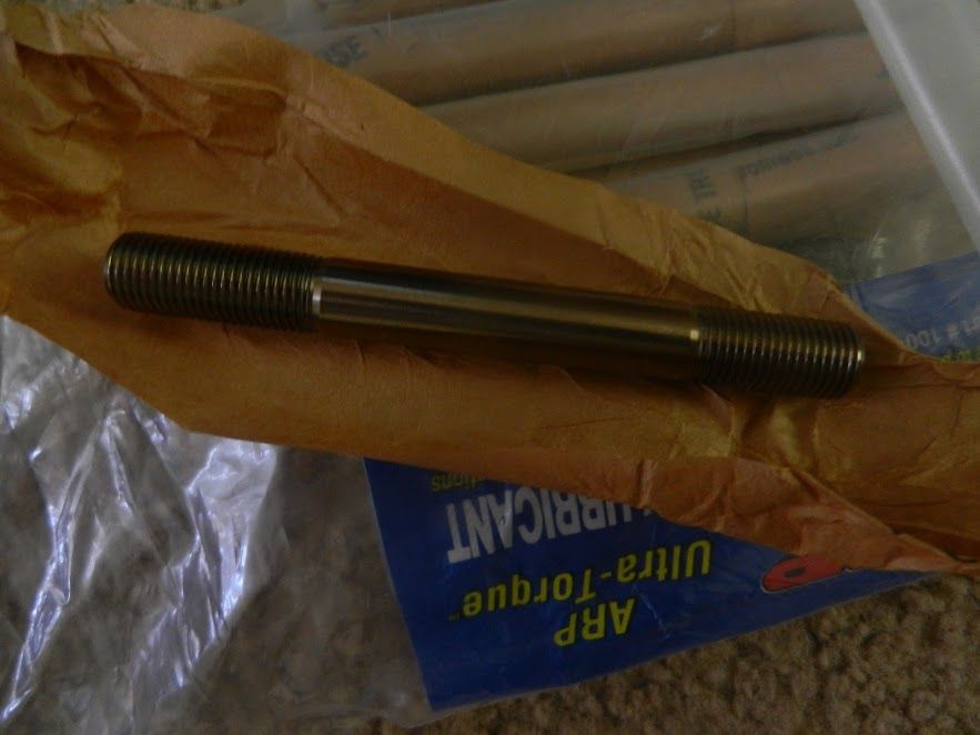

I am super pumped! Moar parts too!

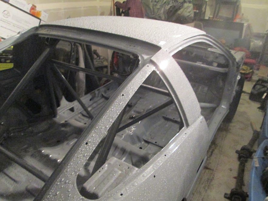

Short update I know, car will be off to paint soon and get a new roof skin, and now I can get some parts off to the machine shop!
Thanks fellas, more progress updates coming!
Zqlr6ptVuEh1NyC_nYxozGCXwtHsc4qHg15sgvQ3Fm0Ao-HUxA9zt_sX2zrR5WFT9NuOm7RP-Q=w883-h662-no.jpg
MPwbXalB7hqahf9KkbPuv4KrBllgcL-jHZNdmkE0ic3V5UeBpd4fwZ031WTxOSJE_U_pu40KP5TTdlhVFFs=w883-h662-no.jpg
9_Hz0g00jCykWUbOmR5tjaZgSP8eNhKvaoUxVEfKQZQSbSaG2hT-CfMogMkKDjb_OhukFCweqsUPi9CDJj8=w883-h662-no.jpg
GOudtSaj6BUULy7XJuN3vEifBkUt6fQ9edRmvJf_rR84_TcpmR5cfxEMRP4nrUVxaFxEhOJqfYEIVUXKLoE=w883-h662-no.jpg
KmclIeyhudWwatIJMmNK3CEZekMt8cHISH9-JYcqp0Bn4MQD01PEkZ5lY4vku5r2FMoIvWSkiQS0GyG97oI=w883-h662-no.jpg
The paint shop was right up the street from me so they towed it to my house after it was done, I put some components on to get some room in the garage it looks funny with the oem wheels but once it is all done it should look good, I do plan on wrapping the roof and side pillars with carbon fiber vinyl and eventually have some kind of awesome livery on the car.

Tial 50mm BOV and 44mm Wastegate.
FP Goodies!!

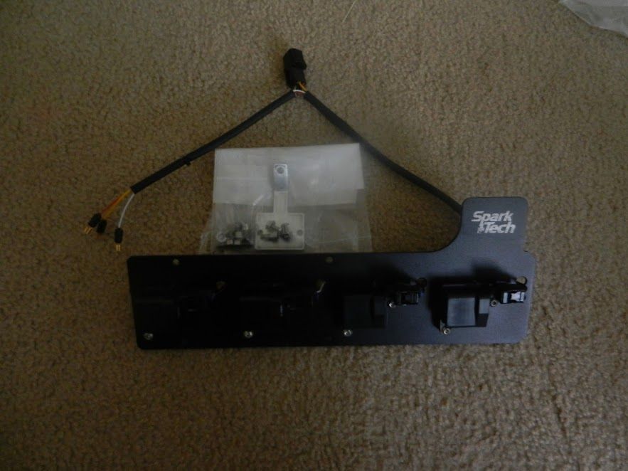

Gonna need this for making a new harness!

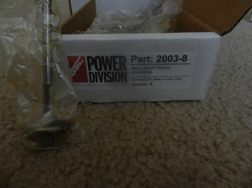

AAAAAAANNNNNNNDDD.... Block is machined, .20 over bore and honed with the JMF torque plate and L19's torqued to 90ftlbs and the Kiggly girdle with ARP studs and main caps were torqued for the bore and hone as well. Line honed the mains and decked the block, oem crank was balanced and polished with the rotating assembly etc..
JnzljDsJKvMhyiZM72AsSnfJ1niatQ8yvXVdoTw_flUqVuZtztMDujCbaLjM0fvvbP8CUvx3DApoEskf_yFuyPUIoBCAPv0GPA843ULnp0lCA1Uc5JsAur-4YvYVbL9sXRzlwzB1jJ2i4T0NOjWWL5zMkAvVgcA5fV7ITFxdGhxpzDKSH8Zy-FAc5BvR4zqM6NS3gSFtRpVKLcTQgEhNJ-FGZXKGpy_adOfvIJZGE7RPnrm7BLhQu08zn29yy0kjYX_yct0wo3k7TCwBElHCP8w8AHDad1f4JfIw6L3pXjiOCyT4b_dickyElt9PwVYNSD6ByR0eclNWxZF6E4dg96YsmW35Yzc-ASMOAVB9LJlszbxhGM5uSguaxUn5YddOgtrsV0Yw_X-nWzwsEExggtPv0Cwck5jGr0awbMkqyfJfBHOyhBpCPhyaZbmSj_tIJyQ6Z4NzkHkWQquti04BlU6sfImJjL51eQWMYK-Fuucna7Mh7k_rDHigDb5KnQyKj_b54dptv3cvl-Vs3NQrj7IT2FHZszd35miTggLz7T02_NGozyrmeXaCZ54Q6oGeTZU9MwdzVBqxJ2oiMBr4ZA4FhX9mvr2kjwcKR_kHHgbq1wgmnC5u=w934-h700-no
AzSGZLb2GHW3XWuvVaN-SV0oglrc3JjiLrYXrZ0xcta35aTC-7opMpzc5kXO66mkXK-y34b2M74ew6ytque6CJOOlLInG1FwfacC83oBoCTzzpj0qFUSjWvPYT0z-wCnnj1i_IL2b6WRqjjwtrj9j4lW-yy1cRz9GeNz-SlI9RHXZKkWDPR1GbxjxRaFYY4V4CYq7Ta-ts429_1dZW0Vnh88qo72R-88TeOSiqjxdgLC5dhUgI22QHPOwXADqagg6T2vEzMtu-wOF3hJE81aOXhpofCd8uRqoOIpSFRb-03Y2ygtVwzjb6ok-v2uL-5h59H87zZy2o2U8QKfVFKcZPyZN9Y6FYGJB3zUCNqD4dnycpr6U7XWe6AIq1FStueUYrK4Vq7jWi-ebafV8SeZUNsMeGM-hd6OAKGEjlfd4bPLjm9M8QM7HnJnElYS-cPv-WyLJTOgeTgdzO9gG20HLoYDMepqKUB8BIMiqTj8aoe2QhYJCrGl67qi9NcsIKIY8yNHeBpcTvRURXs6qaEC-xpUyTS9CIYHbHbMPeVD2QD5eX1YMcipkV1HAEFv_BVpym4dmjuKFGQFP7uae10oRGAtQ8clDqTRuoJXpCoQ6yMv5el5=w934-h700-no
s88AdLI8TnLoKCu6quDyOqZd5nugBRdfaVVFiOQnC8BP3TzcCKUbpbxvLTBmkPQlNKOyecbr-3HReesIPTb5Jb2H8vQ-H_YghXzOBSLNz-BimGGDC_ZwQO_BJFJFmwmOxrZer7Lofquf1qgzJKPuKgT7ejCrGbVxEF82xOMwSa08Iv16NUoaaTNAoeGlIvgyYcbON0AadQADTorFtO--wbeAtj1KBV7v_6p6PMww-toUrGi3LAys5qZTy9EkrE4Ur0XVc9OZPXE2CleC1Zt_NHxqJrgqK8dKl6B134c8oDf5mNO2m9q-LBD2SK4-Jkr2802faDNcRgQX43WIuO_W8KnLEyGq3SlTq_sN5u6RR3IQEyJxOa4Az41lvl_v-2hGWizoGDpd-qo32iGy-xApb_e1q5a5FiiTTUYD31XQ8Oz2NGR3Y8HTFsIjhjiO3jjM4egdBPe5Jx0rfYh4wi2MhPNAby_szZcb5pHURVWh85yAEYtk2bdg6ijI4LxvZ6x-DxDgfsi_Ev5lFzmpslIALJrf1HMqx4SIfgCBtft1LgWjm4HxyWWsEuo2wgB7nrWhXH_FVRBtg_ZL6ar-yfRd9Be3nnGer6-XRTS1cIjT3FjYd0vh9dTO=w934-h700-no
HwL17k8xOEyNMj3DZ0vlFA_bLTrEZ337PztYyt6J4uWCGkJWl1lp-vHYW0J4bK48Y6T1__XaHXJrEJm9yDymzzcMiTjoin5X4Z_R6DE7zdLggAEyf0sQjk9cCVtYHGtXohOcV4QnFBFx-ERf9W-s90IepWoXKmIXl3KnVqJgxgZZVAeiWyXXw0sAHgpjF4rJtlg1WHrnEDU2ta-j7H51QHHD3Vm1GZAlTEXqgZtYdv6hW6BNqg8aKW_51X9ZyPmgMoKhlghb0FGtzFXPC9qAxRHG6qBZyfvCKBNwMAle0frrKEqEm0a8WsIkhP6Z1TALrgxKDG8oimLtTCum4k_Uw5R5mcTd8iR87mFIW5ILbGHn18TO-a7GFUJTQixnhfOmQsvVrE6CQuY71Dp4SZ1EmJSQDn2GidYY2qR_LmrSPbtyFP4BMtbkLF0JGBLgdpgDU11fB86-ZhtViwG6Owb-PJUq3mxXRJCANzNC9UI01lxPBSgpWmx05kPak-_lYftnHK4iUBdWzcDYbp39z1XXiYcEOvDDIz3128VBFR1mLN_x3Wq7wVFPTuk2874Nay1OJ3HKt8R9-qN_YZM0qTEAeIgk4ry46KL5HfGZna9Ia7MPPYJc=w934-h700-no
