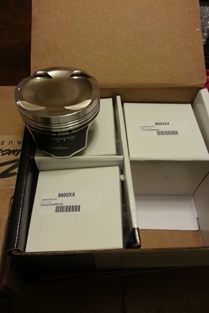

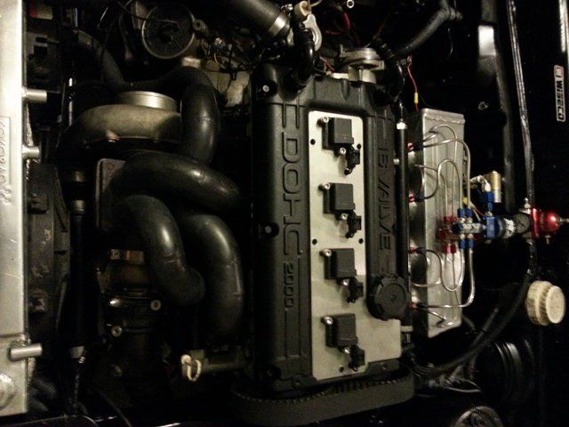

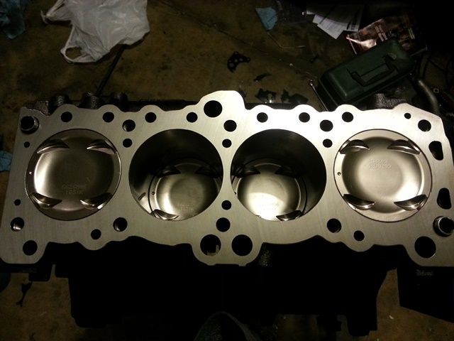

Well I guess it's about time I started posting my drag build. I have been working on my 91 talon for about 2 years now. It is a awd auto with a 2.0L half filled block wiesco 8.5:1 pistons R&R aluminum rods with the L19 rod bolts that I built. The head was built by Darren Thomas Racing it has a set of kiggly race beehive springs, ferrea 1mm over valves, and it was also O-ringed no port work. I'm running a set of H11 head studs with a Mitsu MLS gasket. JMF intake with a direct port set up and Q45 throttle body. For the fuel system I'm running a set of FIC 2150s with -10 feed and a -6 return into a 5 gal fuel cell Summit Racing brand with a Weldon fuel pump. The turbo set is a PTE 6766 T4 with a SLS exhaust manifold tial 44mm wastegate 3in SS bumper exhaust built by me. As far as the ECU goes I'm using a AEM series 2. BR COP with a dynatek arc 2. The car has a 10 point cage built by me lexan glass all around it also has a carbon fiber hood. The car is setting on a set of 24.5 M&H 15in slicks on a set of Rota wheels. The tranny is also fully built by Wilson Racing and it's running on a sinister 9in converter. The car will be tuned @Titanmotorsports on E85. If I forgot some things I'll post them up later.
I'll post more pics when I get home.
