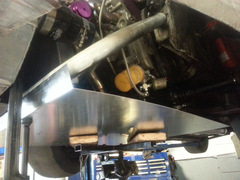

The car will be in Super Street due to nitrous (and now turbo size). We finished up the new exhaust today and just started on the catch pan but should have it wrapped up tomorrow. Here's a pic in the very early stages just to show you how much area it covers. Goes from under the rad all the way back to the firewall w/ 2" lips on all 4 sides.

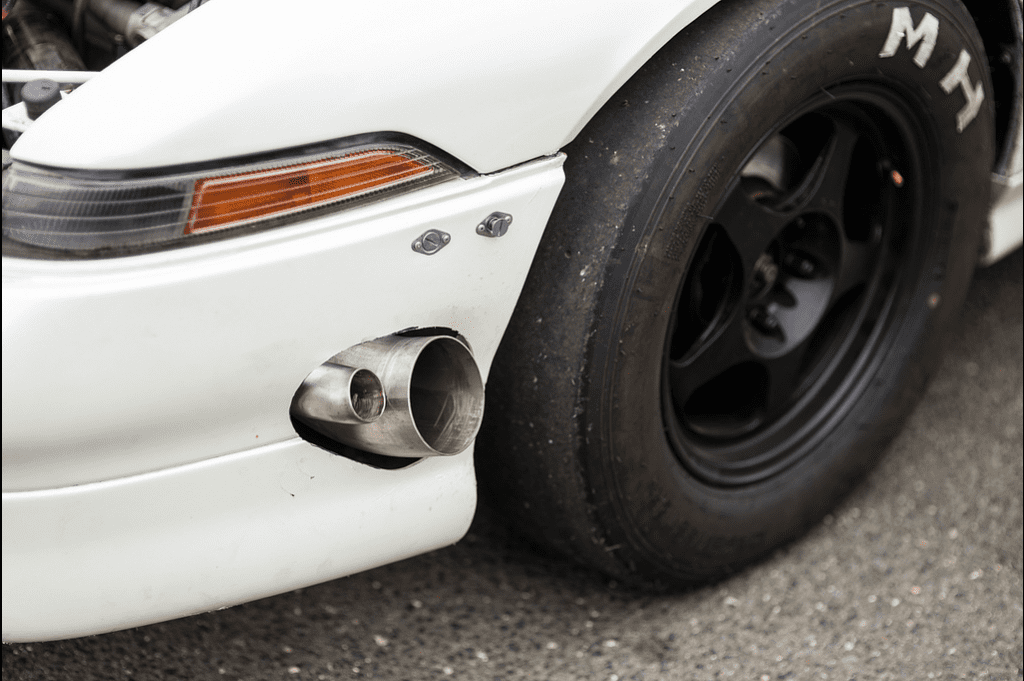

The catch pan is all done so we're good to go for Mitsu vs Subie day at E-town as well as WCF at MIR. Also finished up the mount for the chute release handle as well as the new exhaust and dump tube. Still need to fab up a trim ring for the exhaust on the bumper but other than that it's all set.

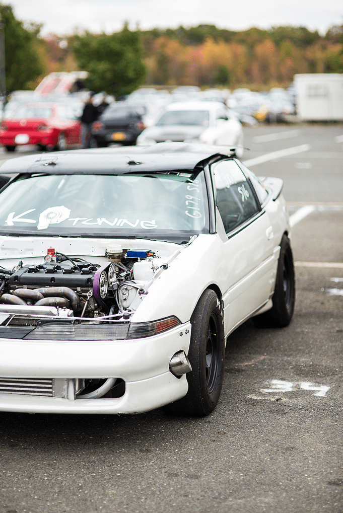

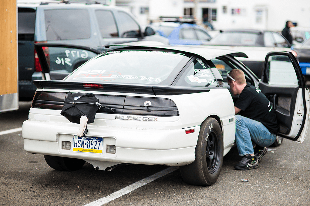

Found some pics from Saturday floating around...
