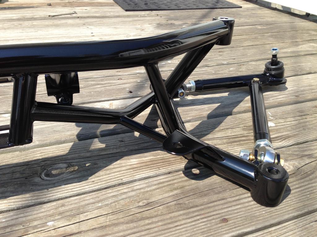

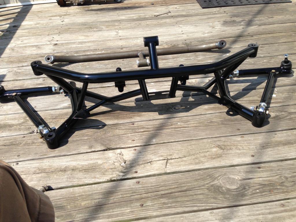

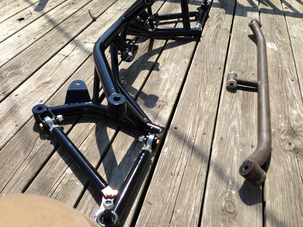

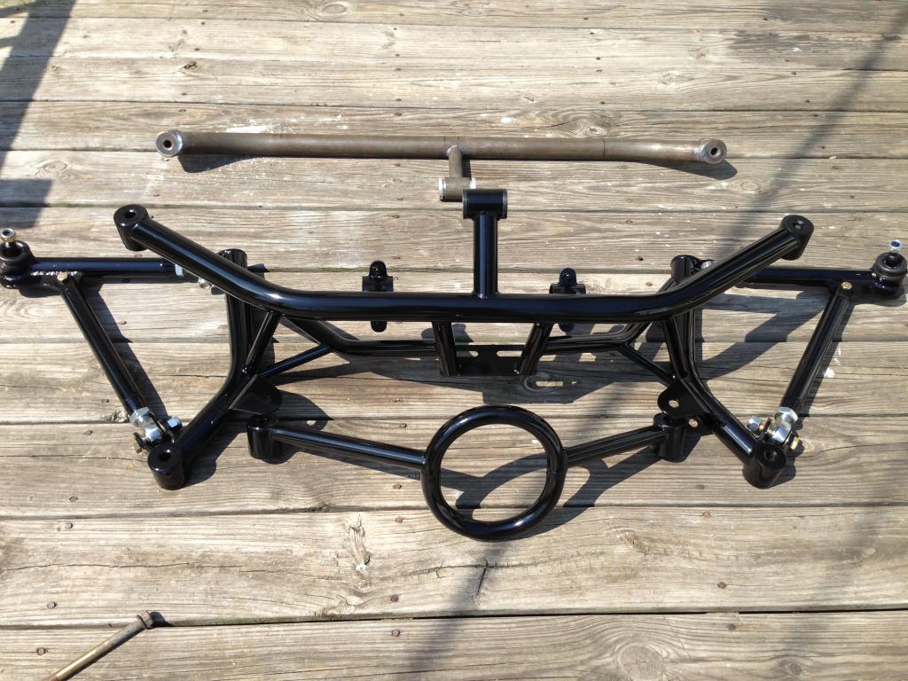

I forgot to mention I ordered up a tubular K-member for the car. Here are some pics of the 1st one built for a guy I know from MD. Integrated DS loop, heavy duty tubing ends, and a great design.
So jealous! And who did you get this from? I didn't know anyone was currently making them and listing them for sale. Can you give us weight?
Weighs 24lbs from what I was told. 40lb weight drop. He had 10 of them built and has them ready to ship in an auto/manual rack/no sway bar setup. Pretty sure power rack could easily be made to work and the 5spd mount could be changed too. These are made in MD by a big domestic fab shop. The guy I know has them ready to go.
