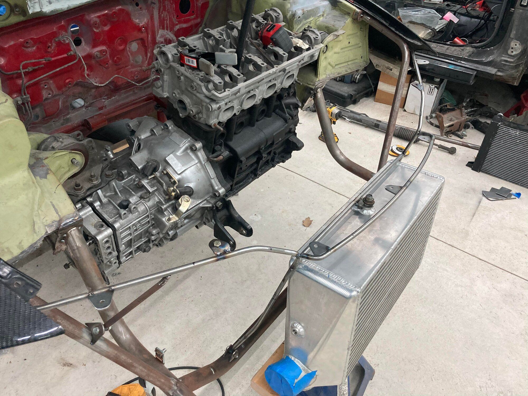

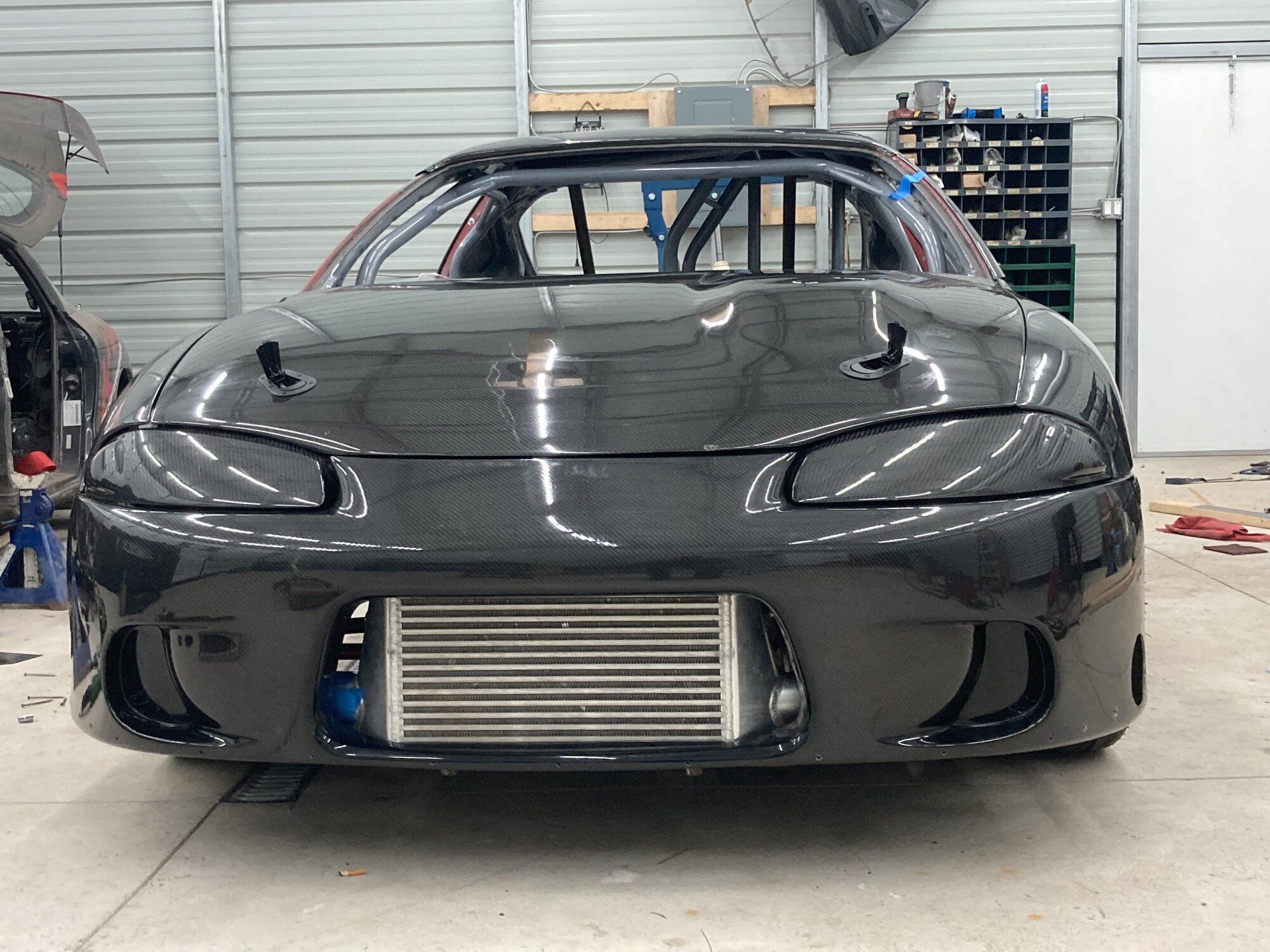

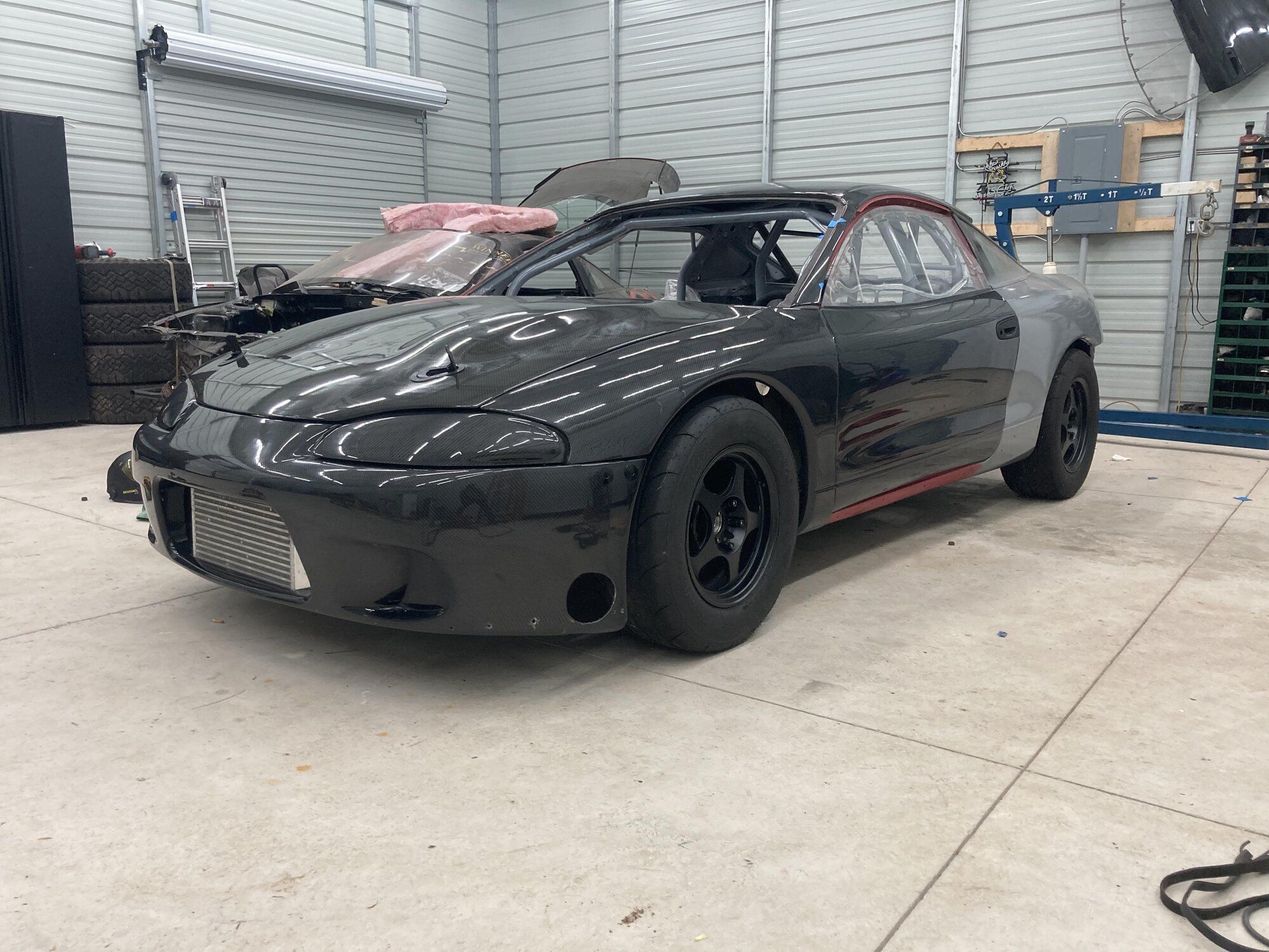

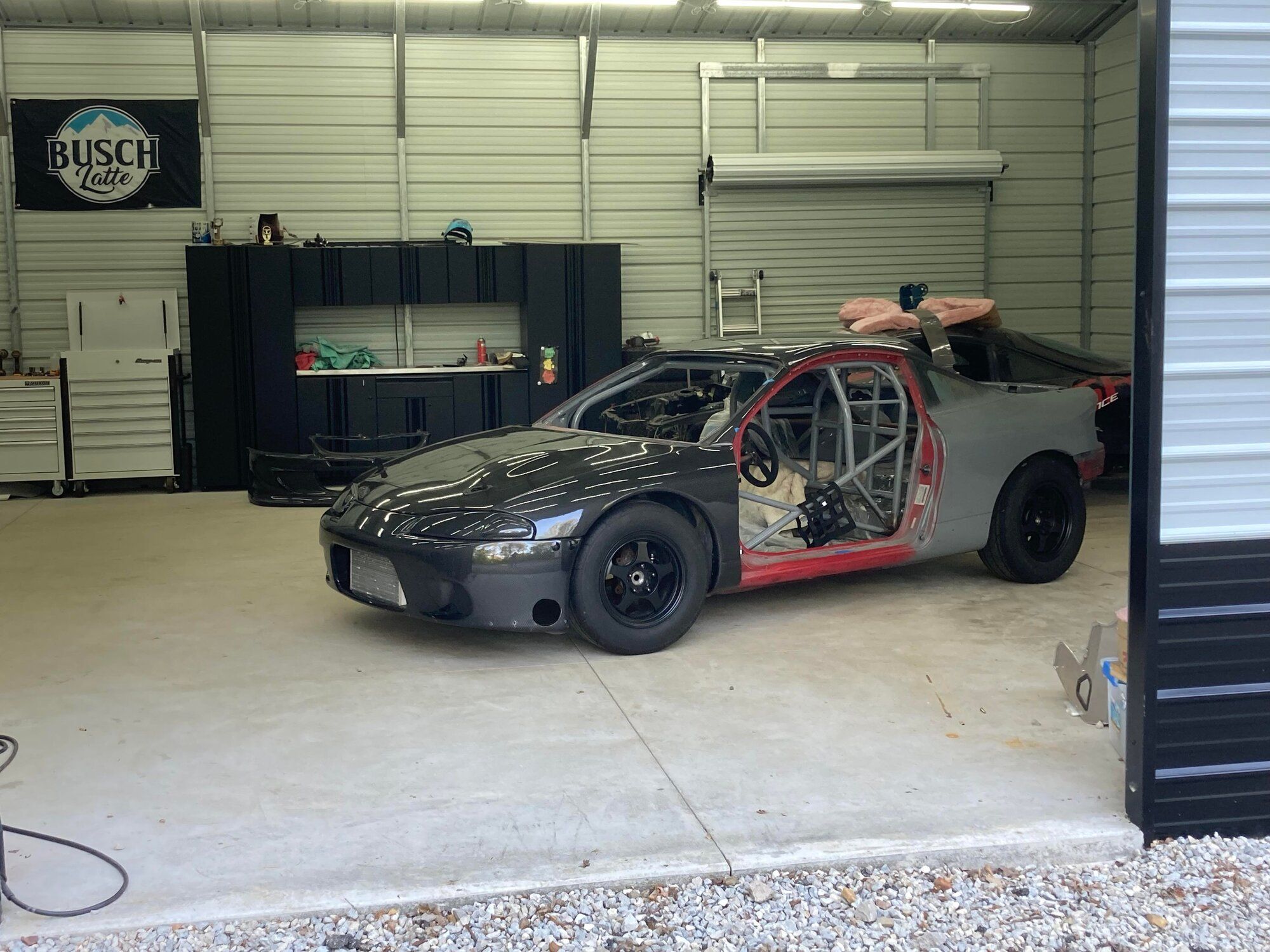

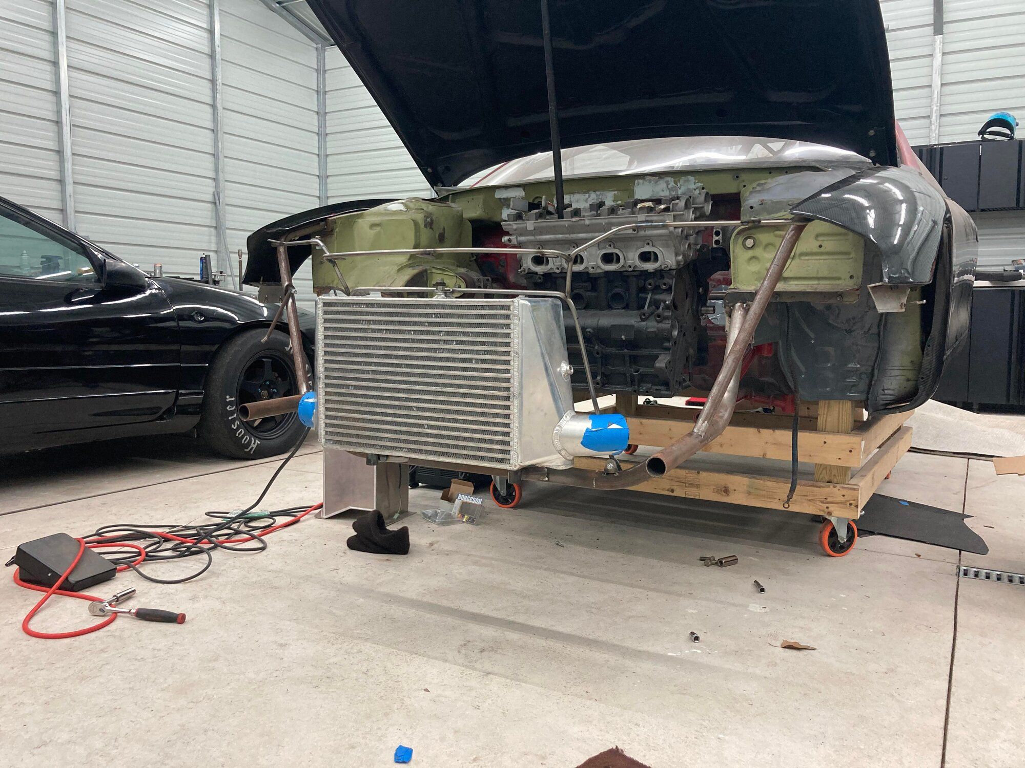

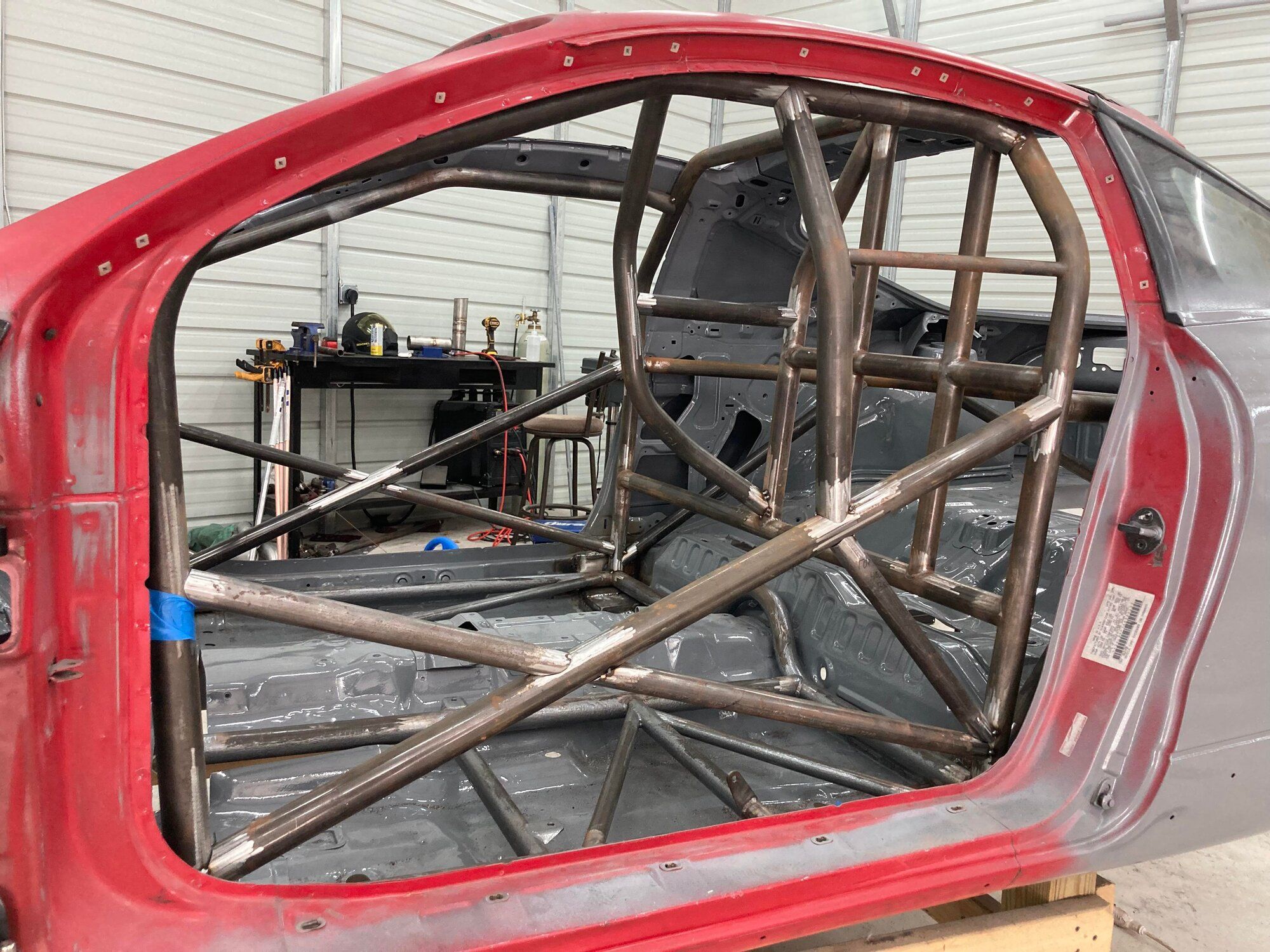

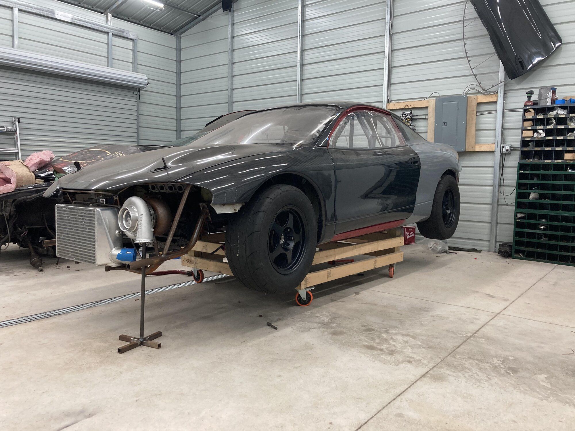

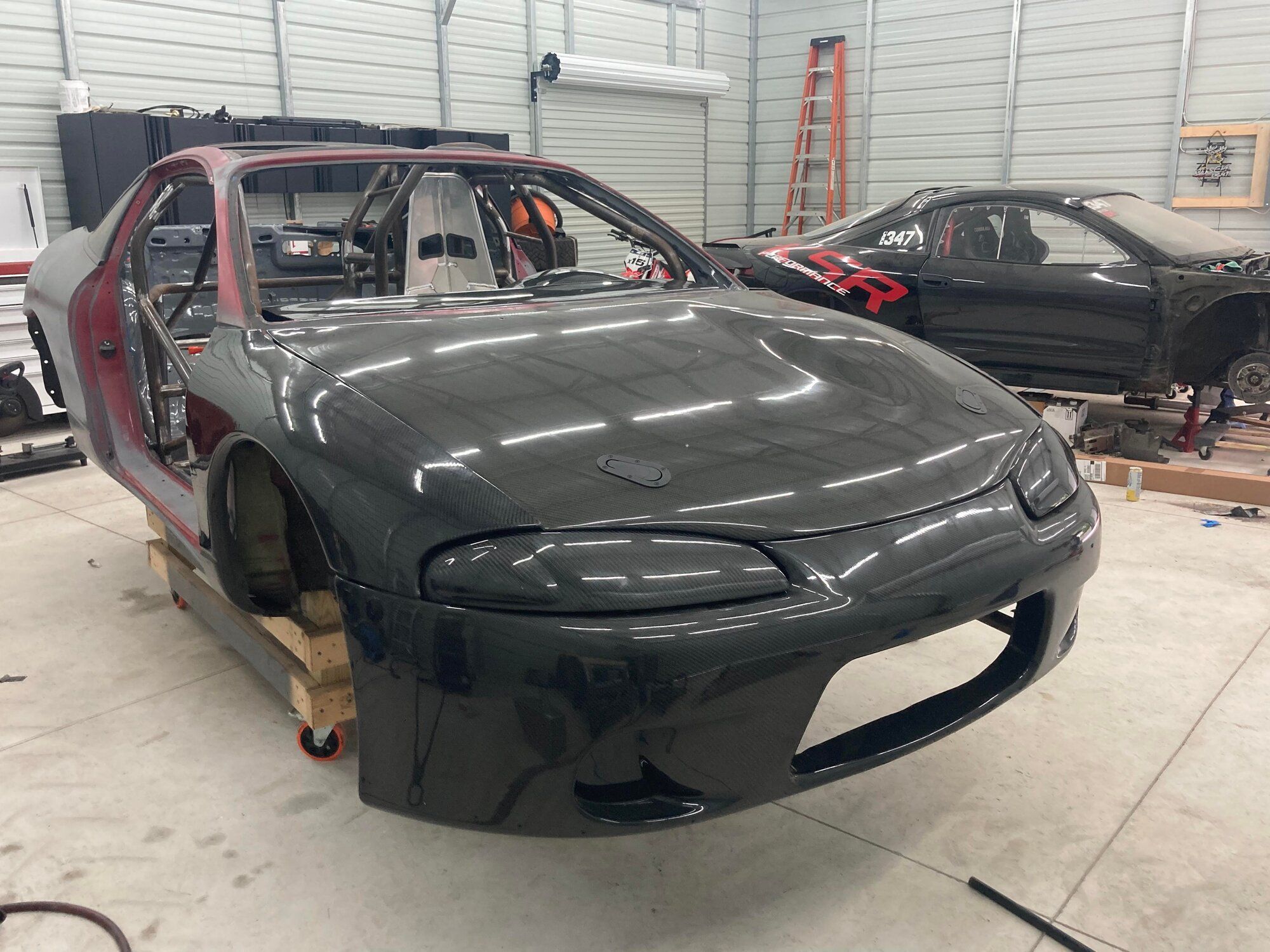

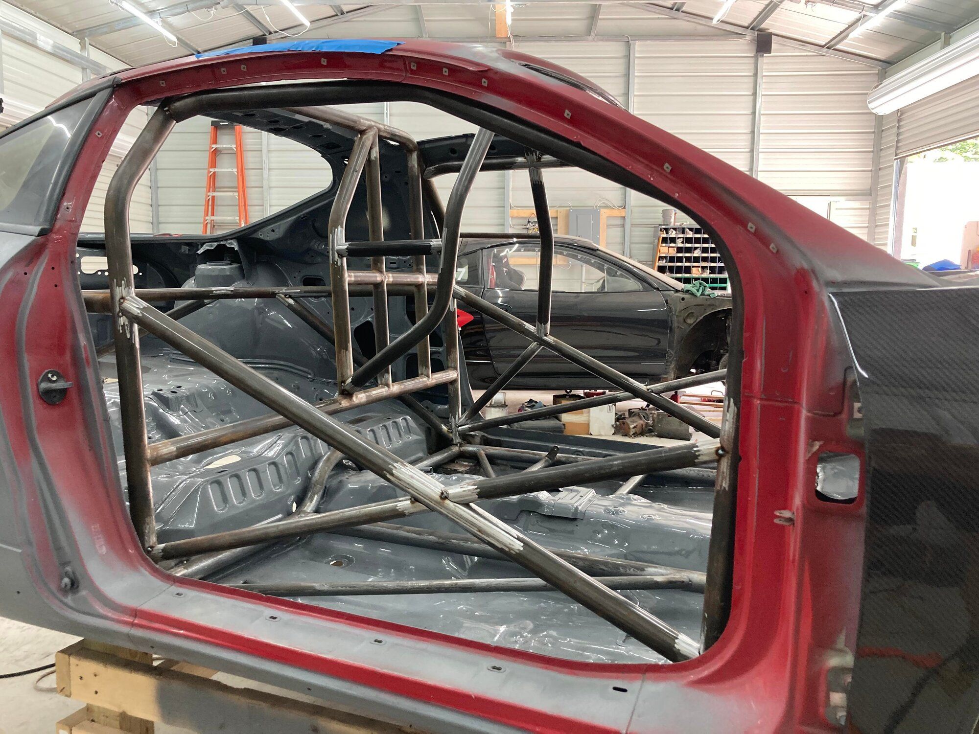

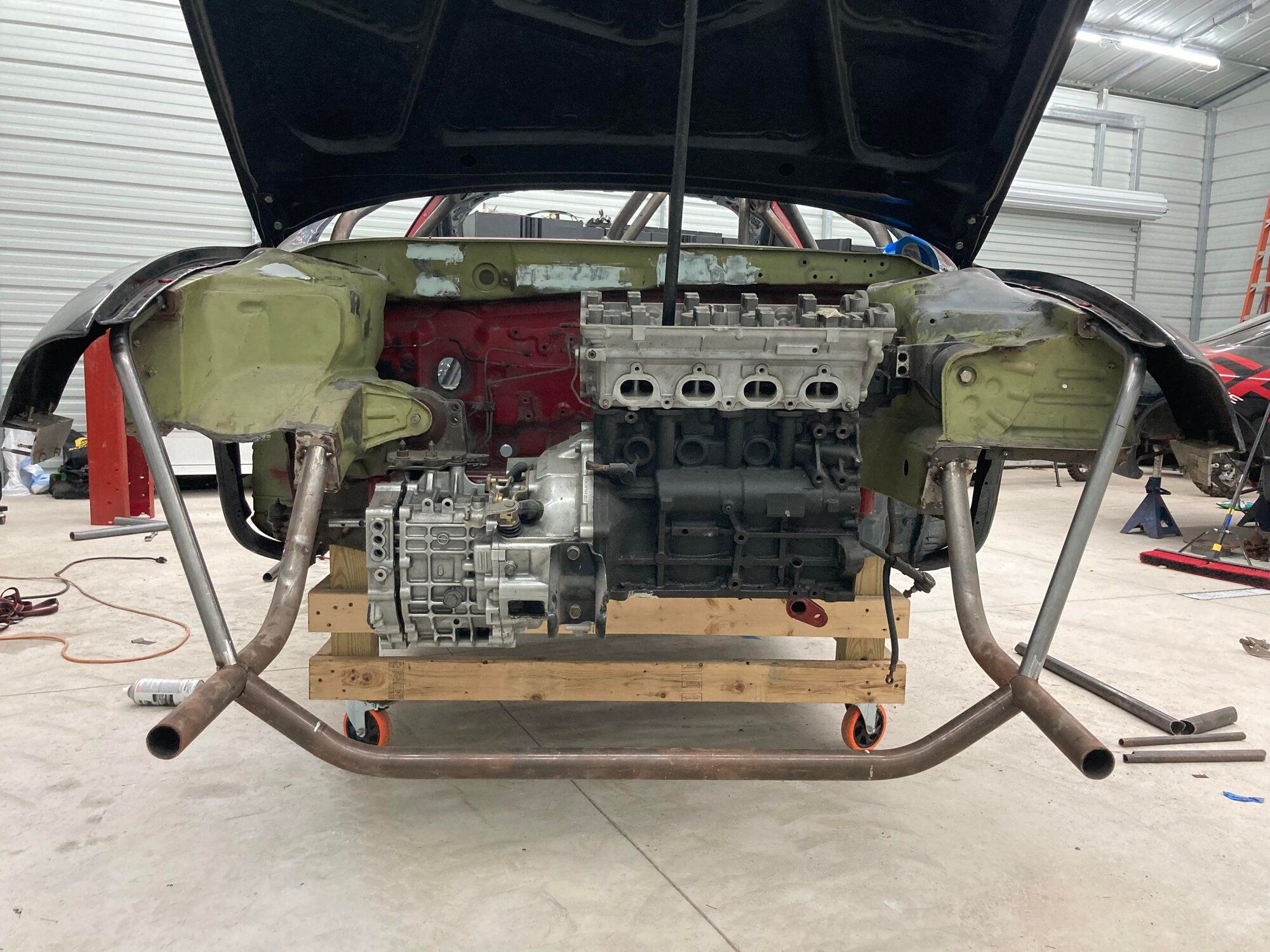

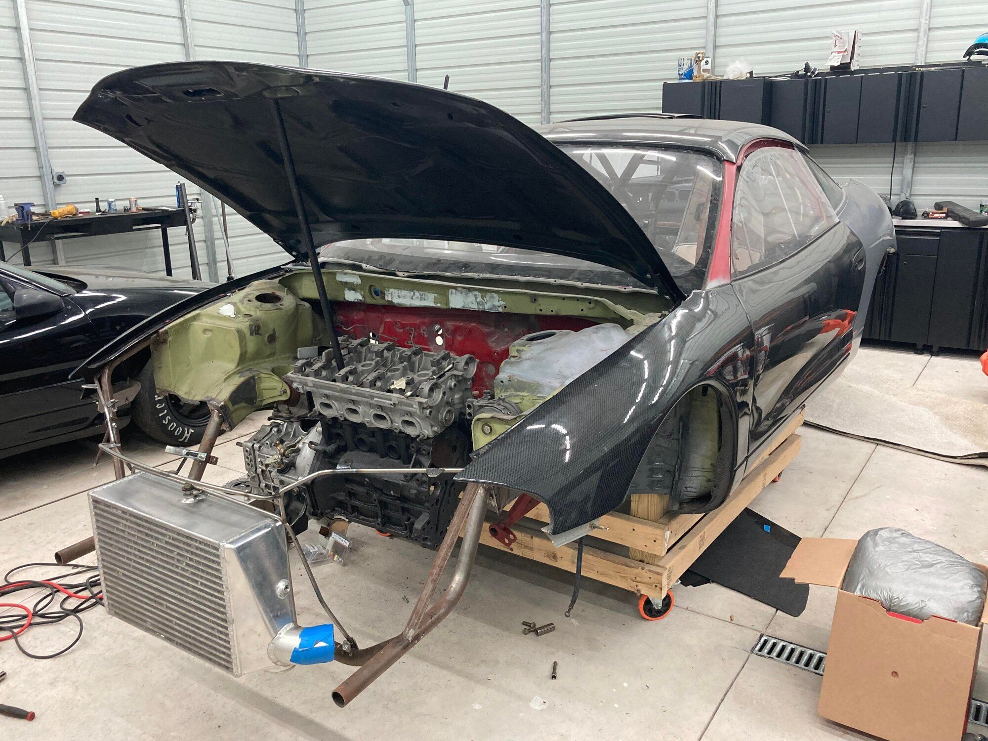

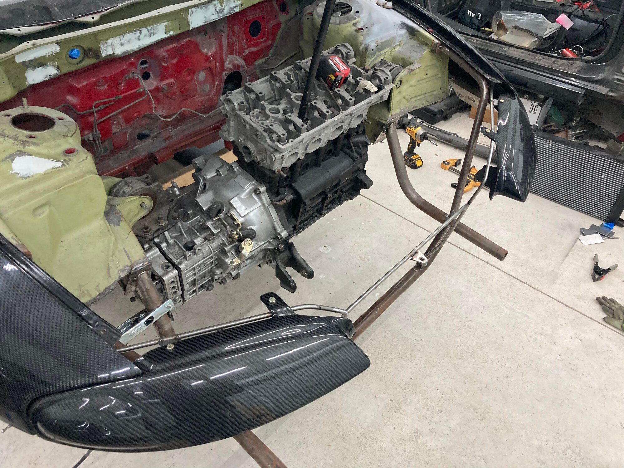

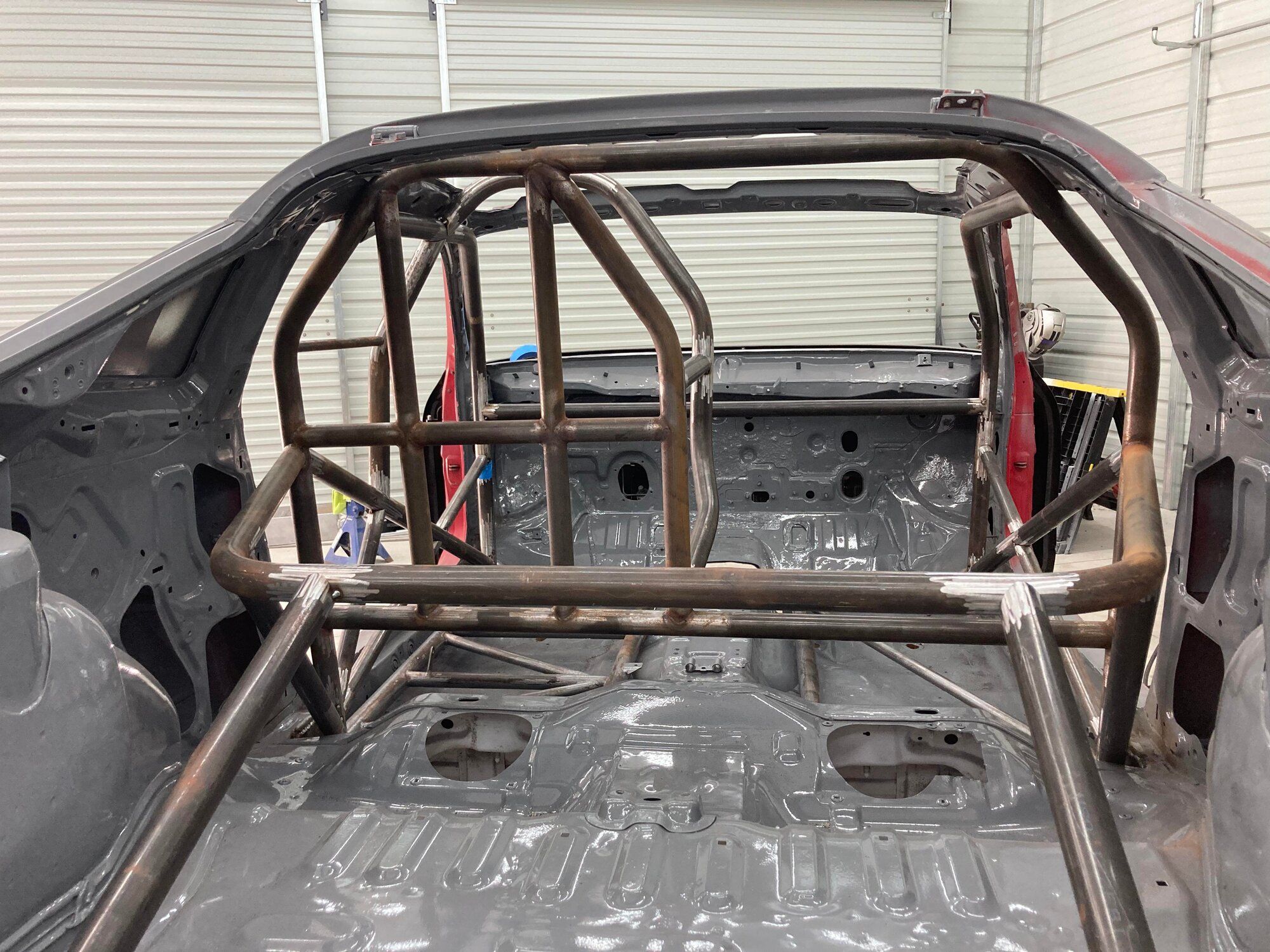

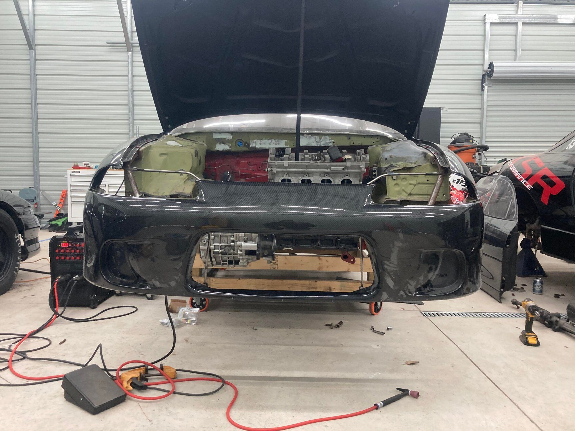

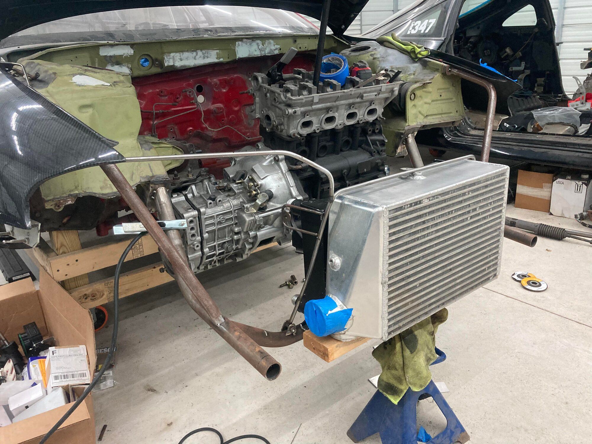

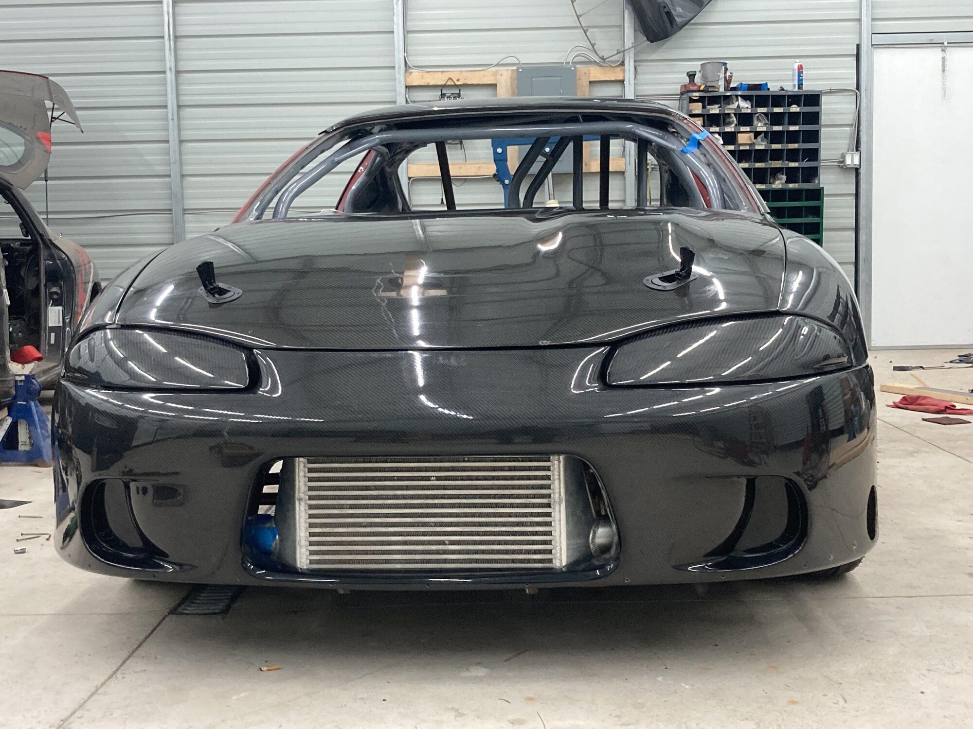

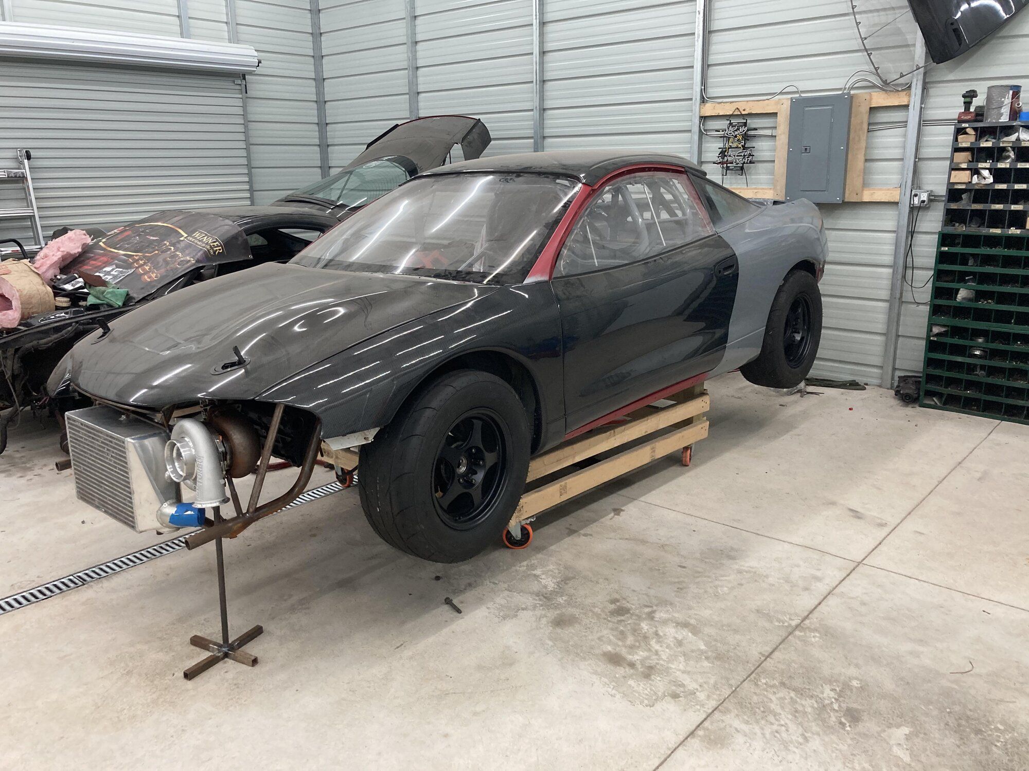

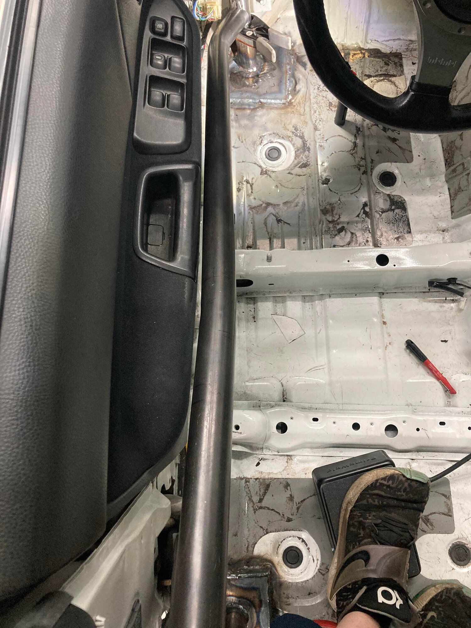

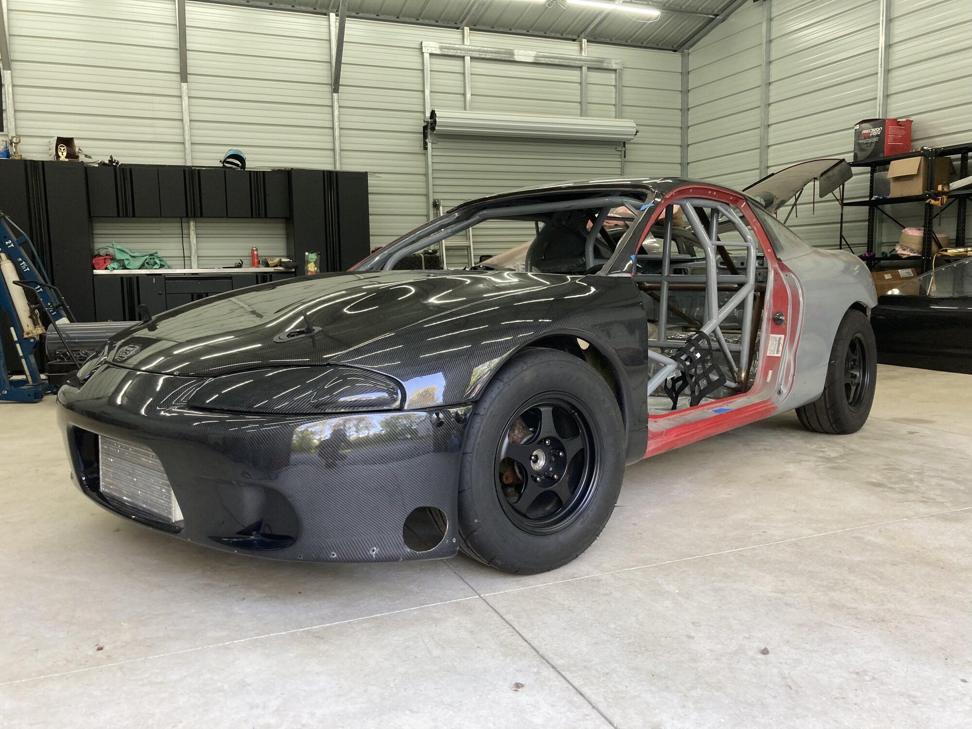

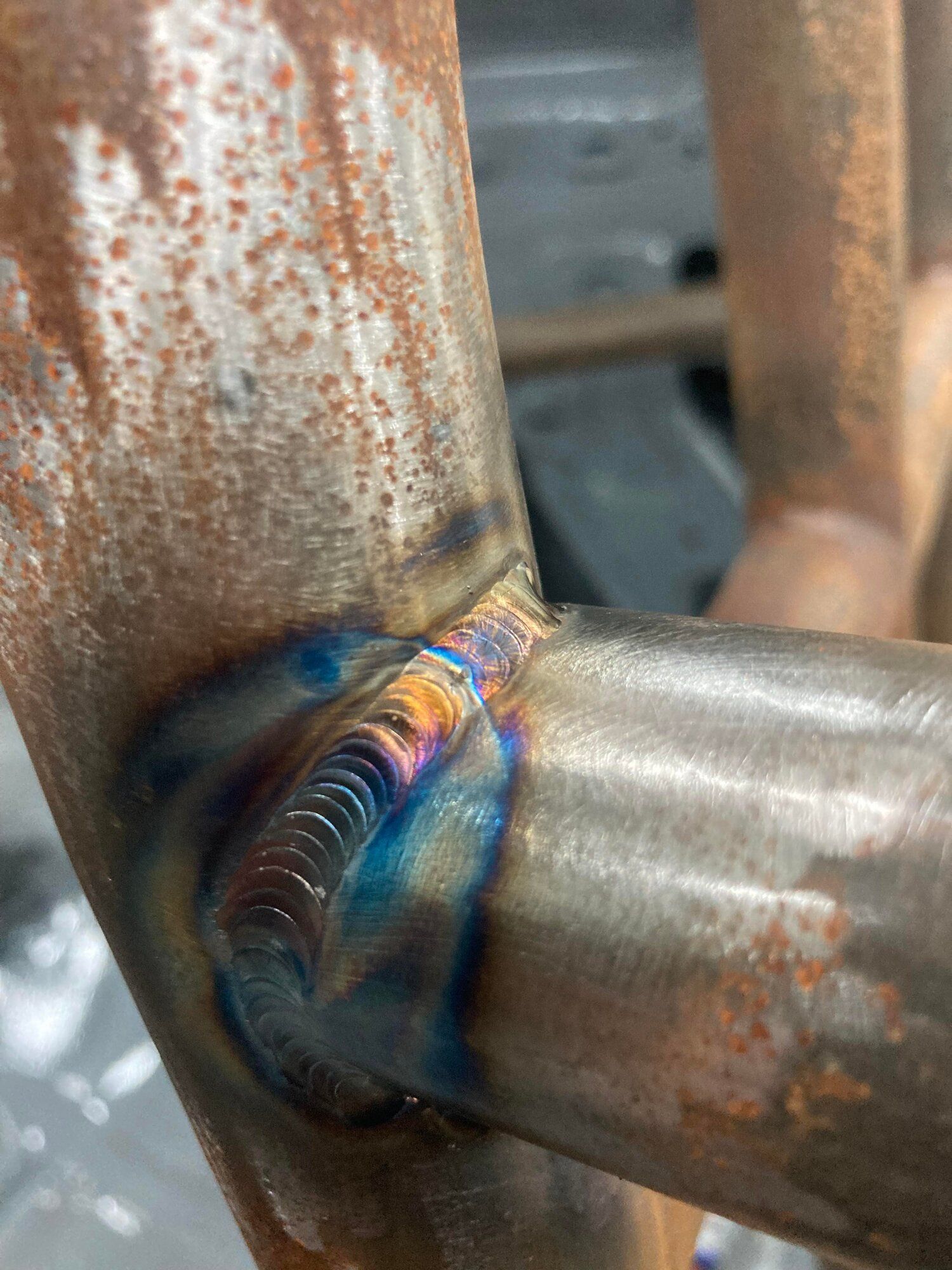

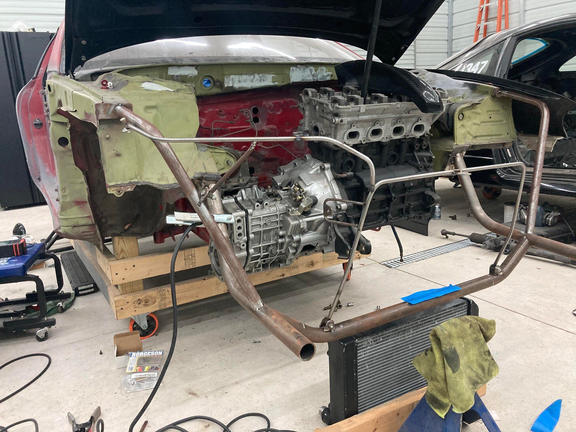

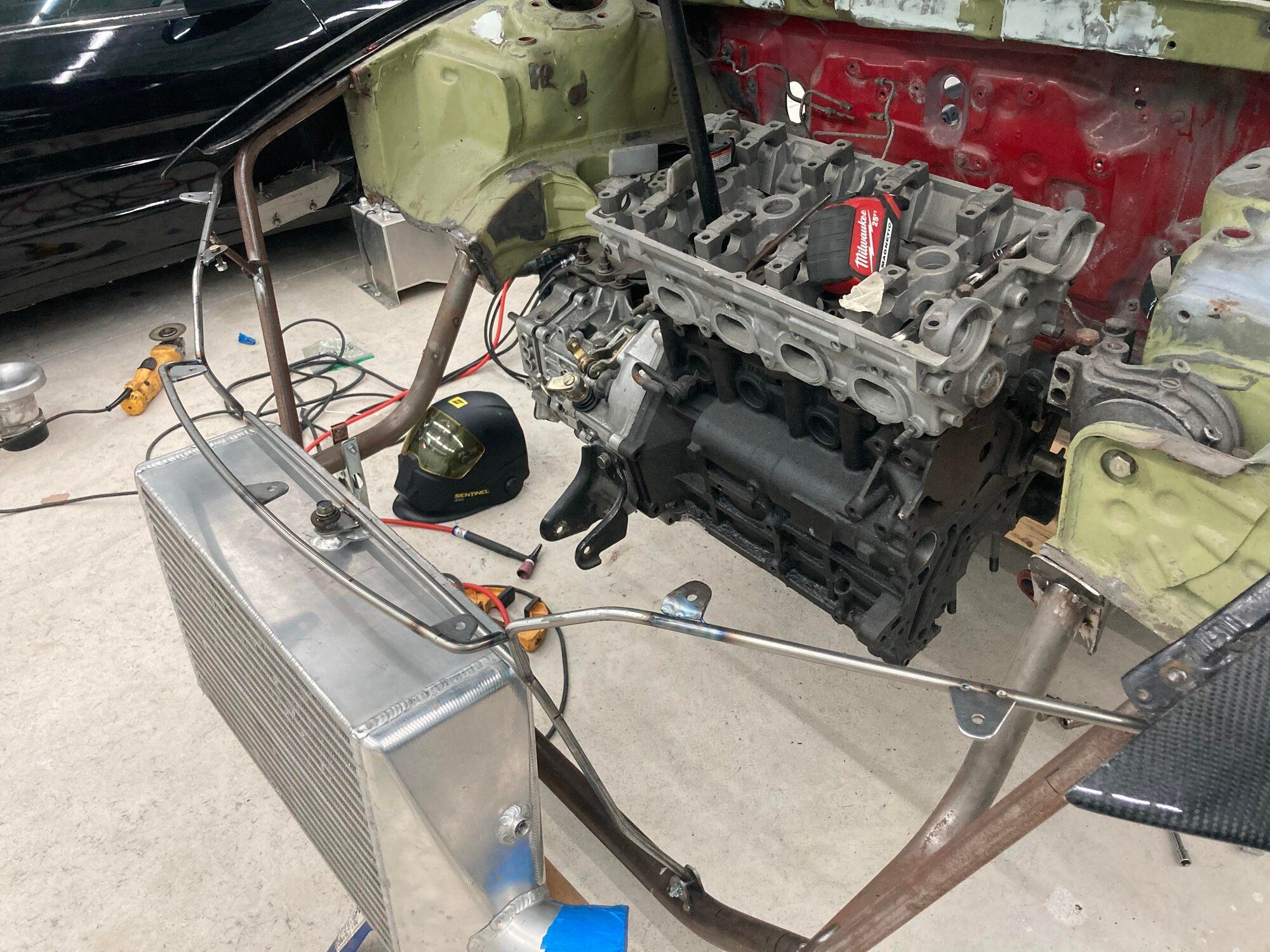

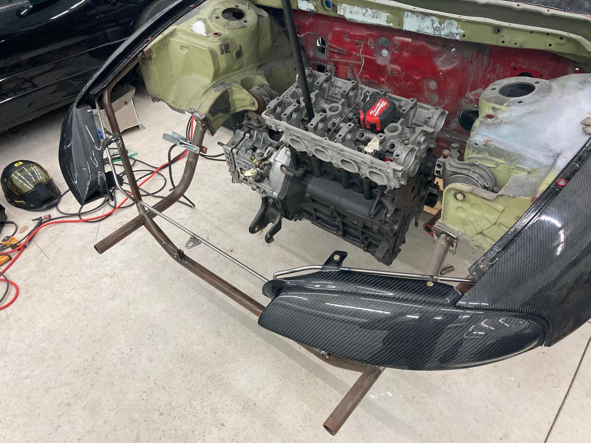

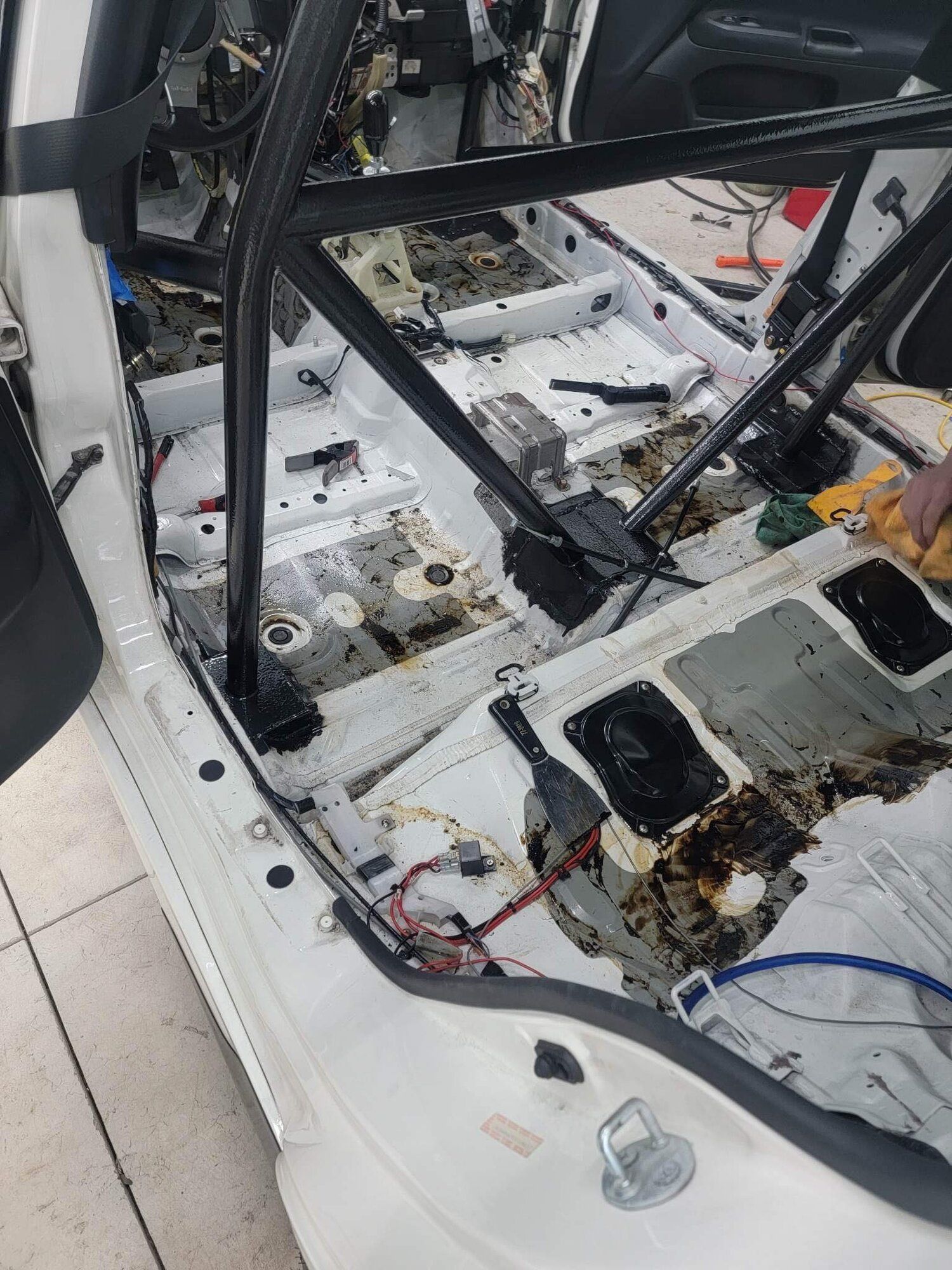

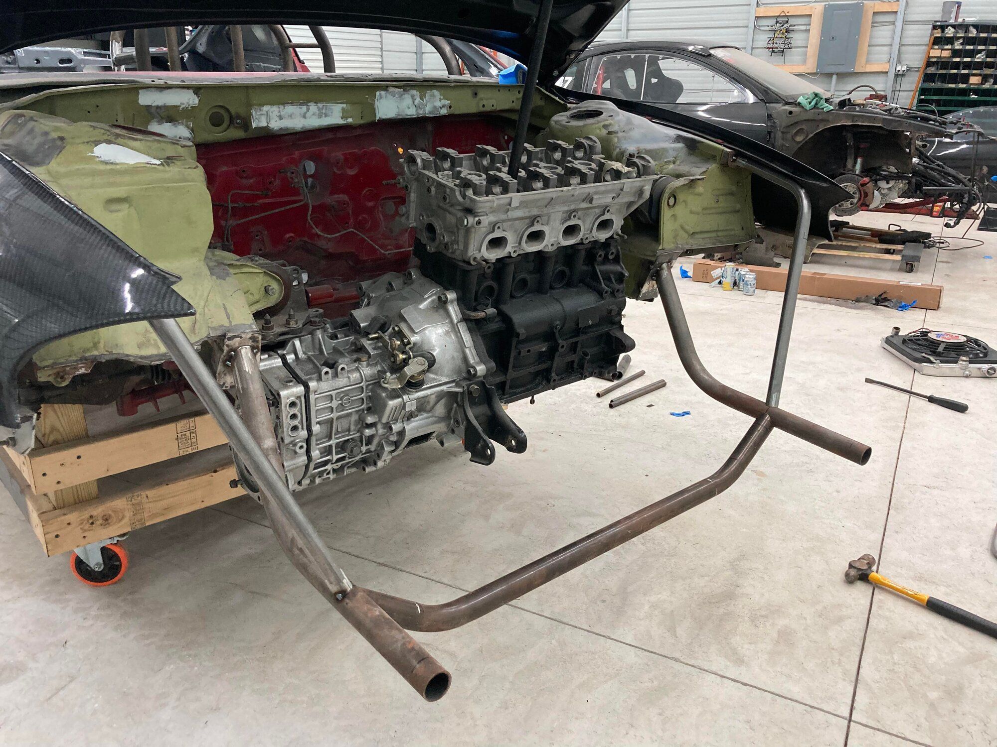

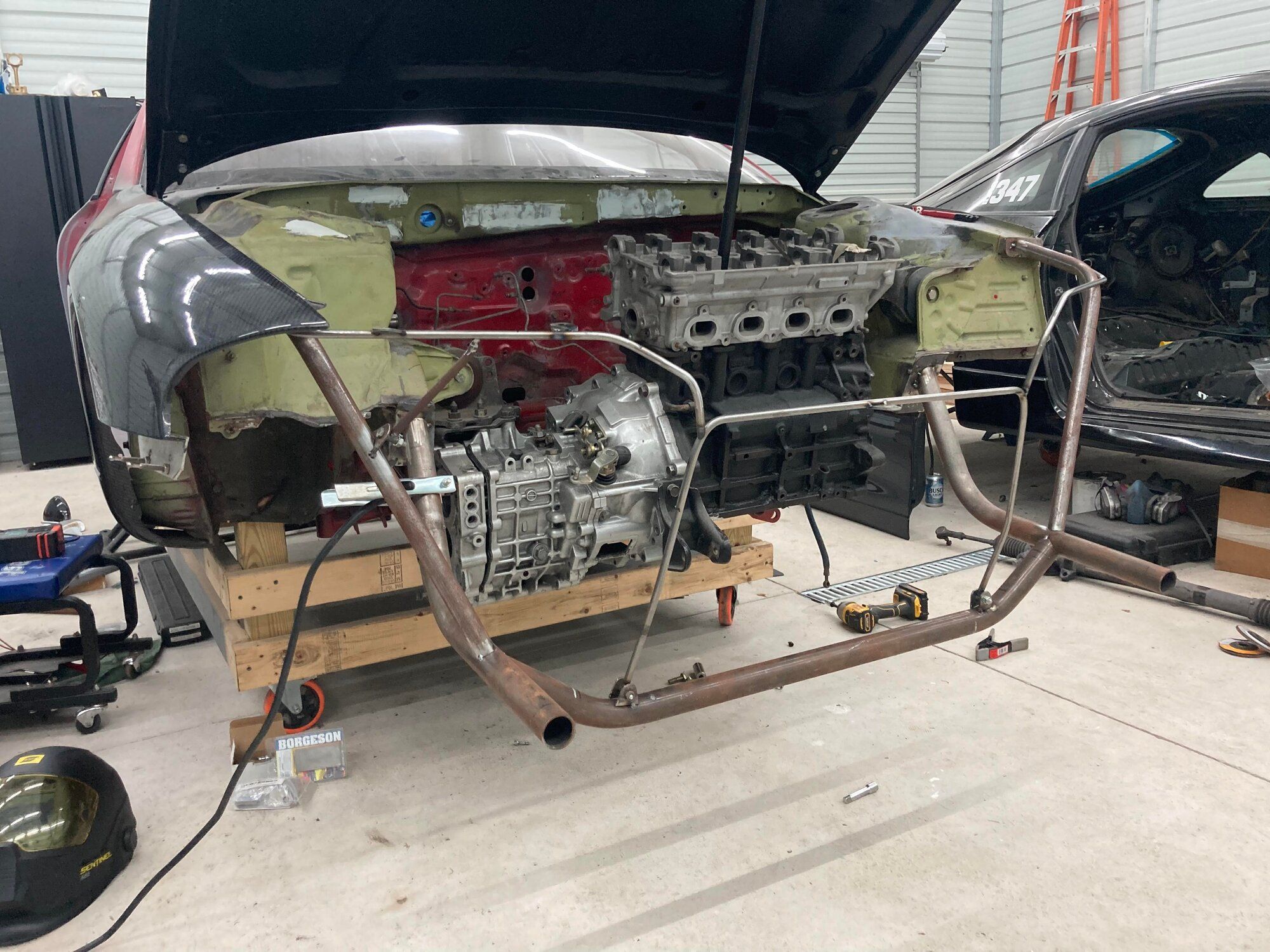

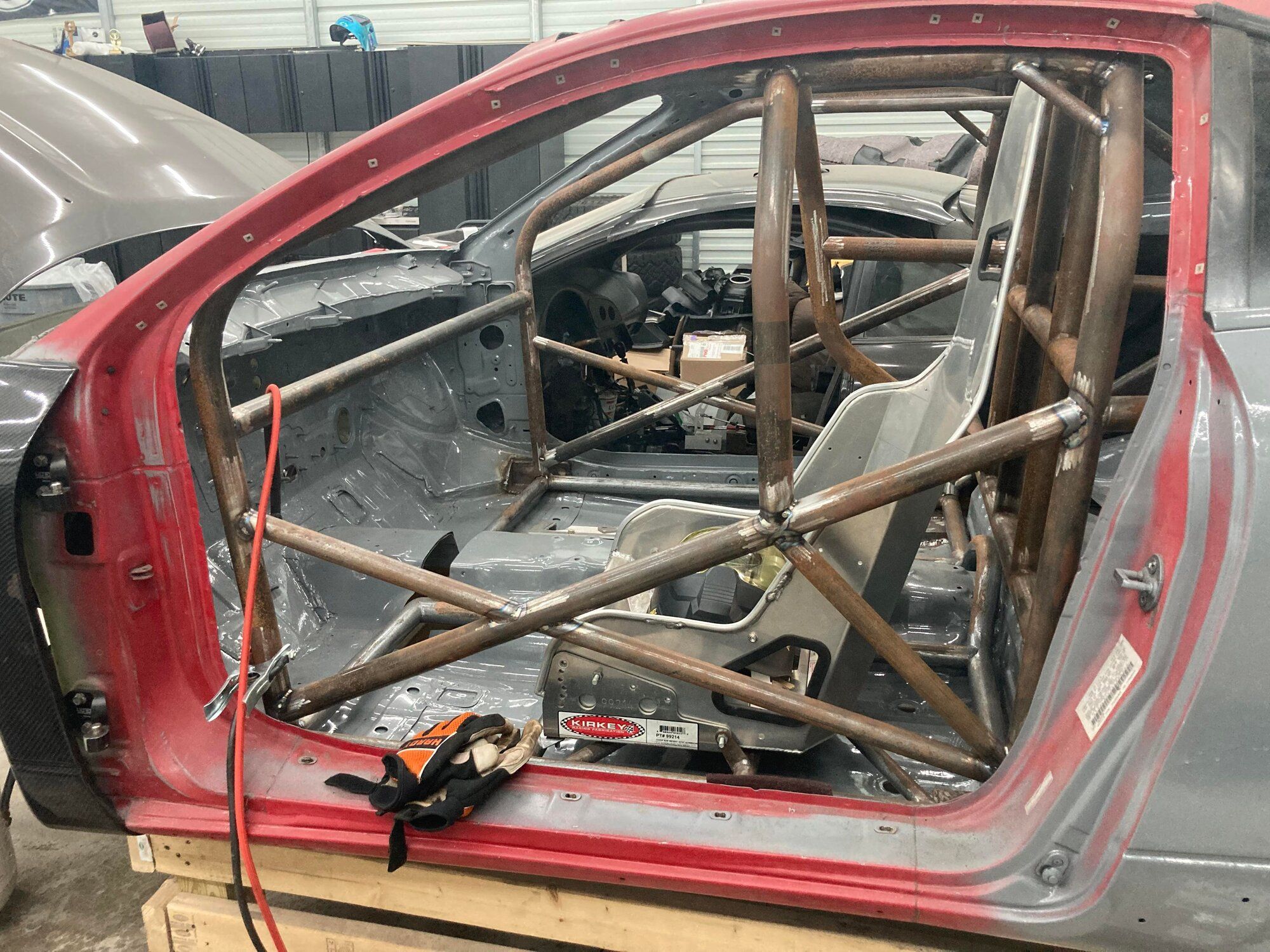

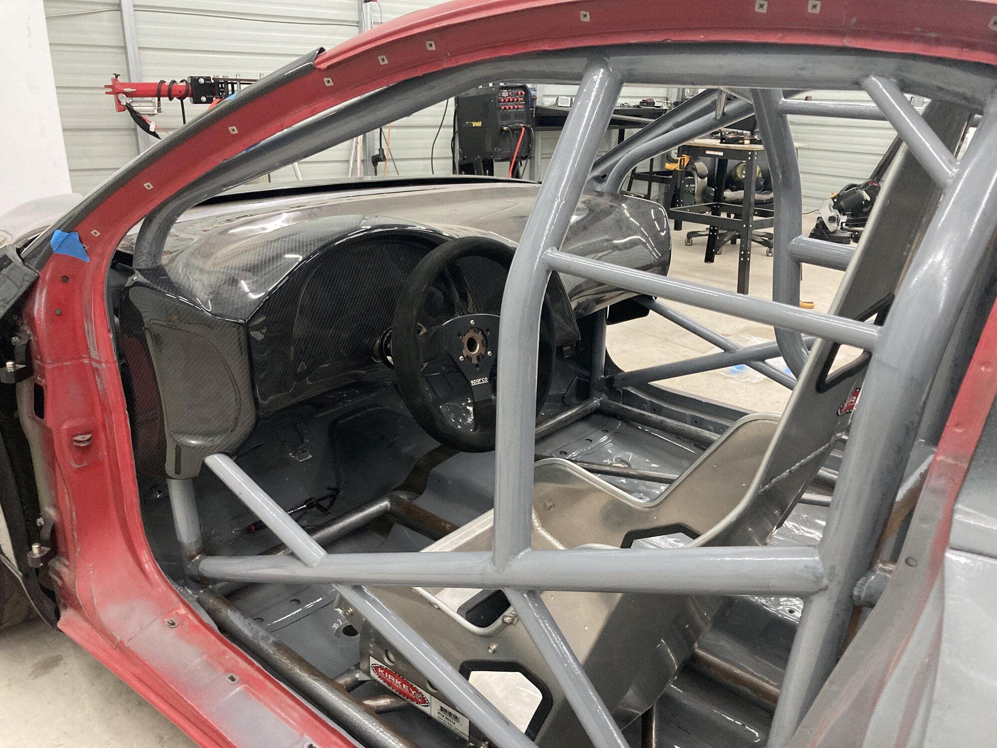

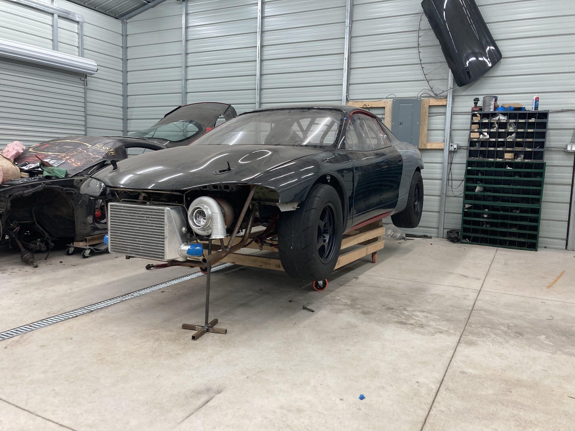

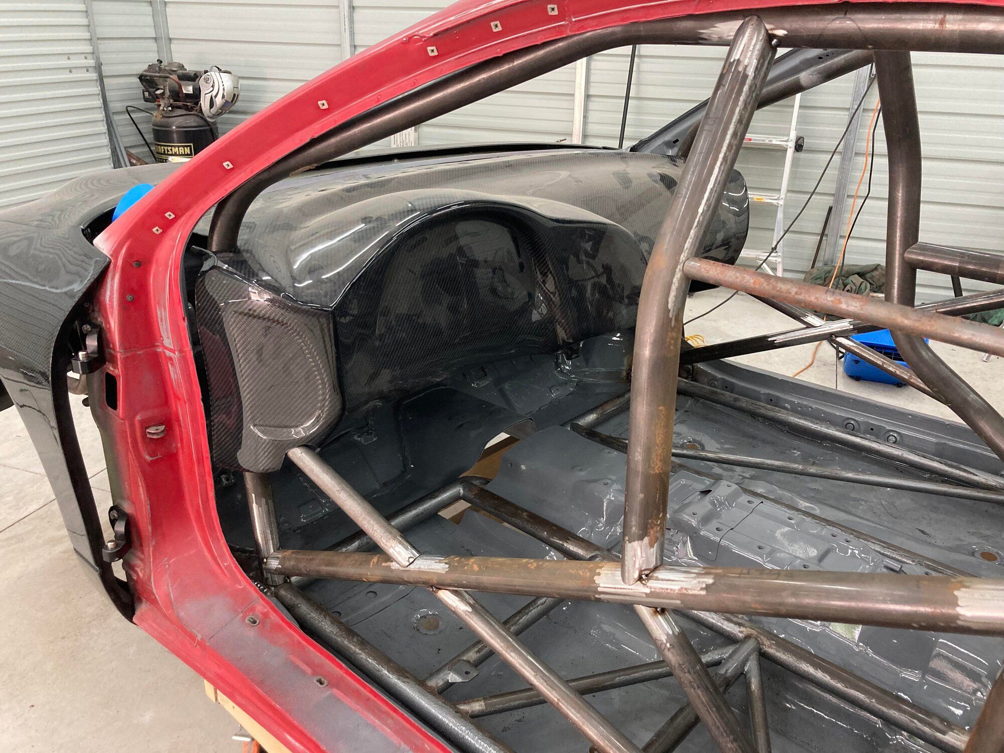

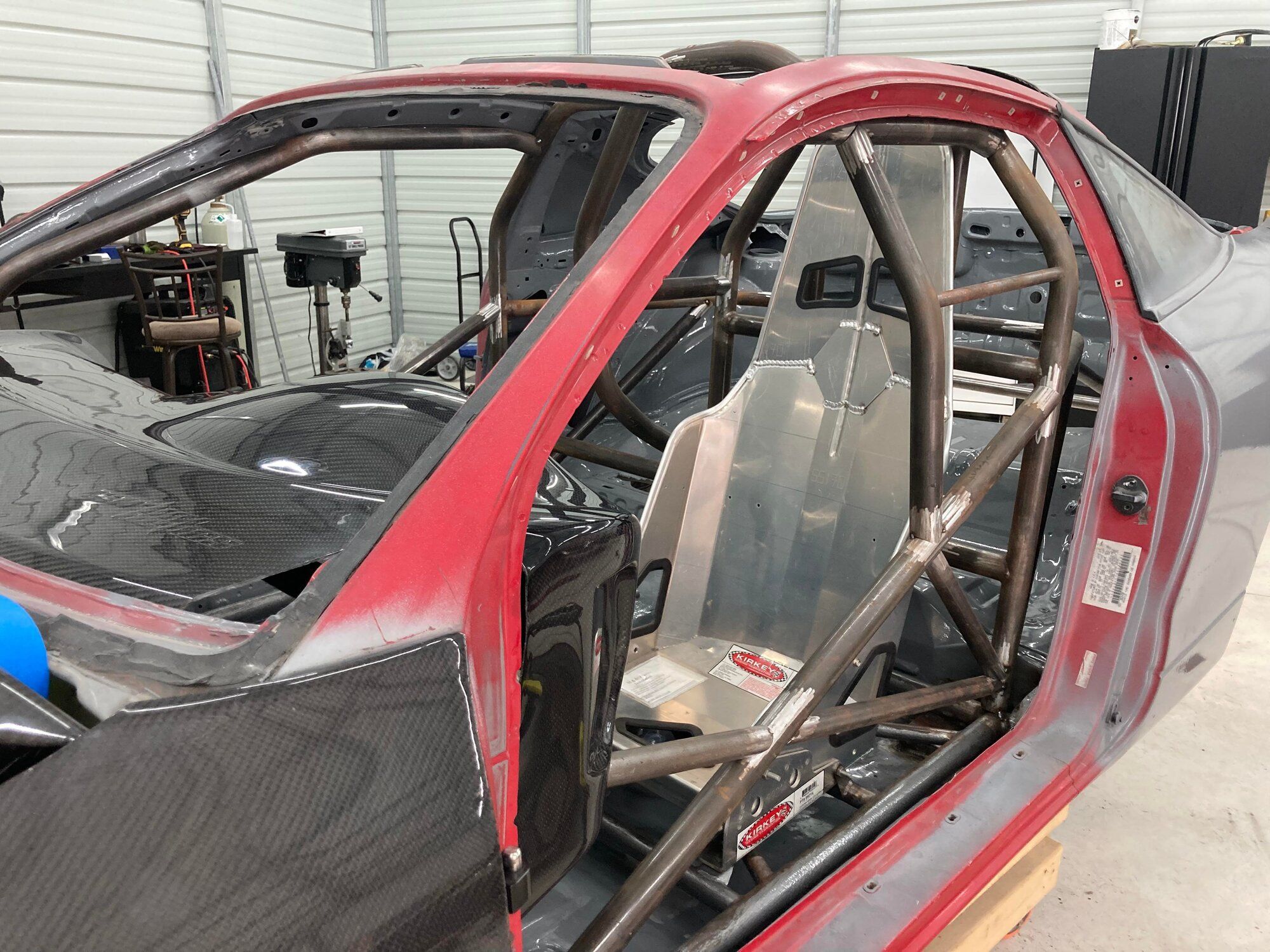

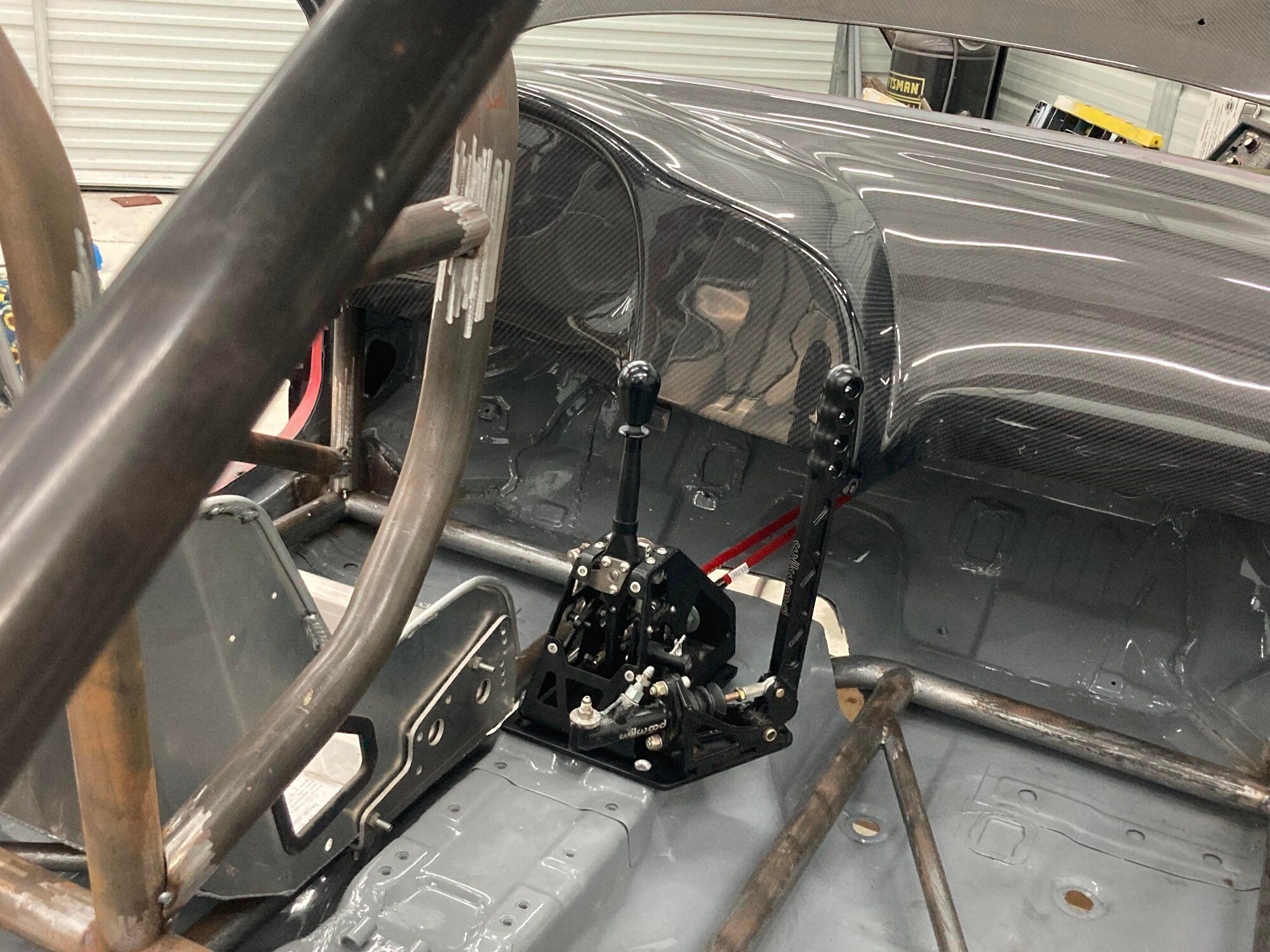

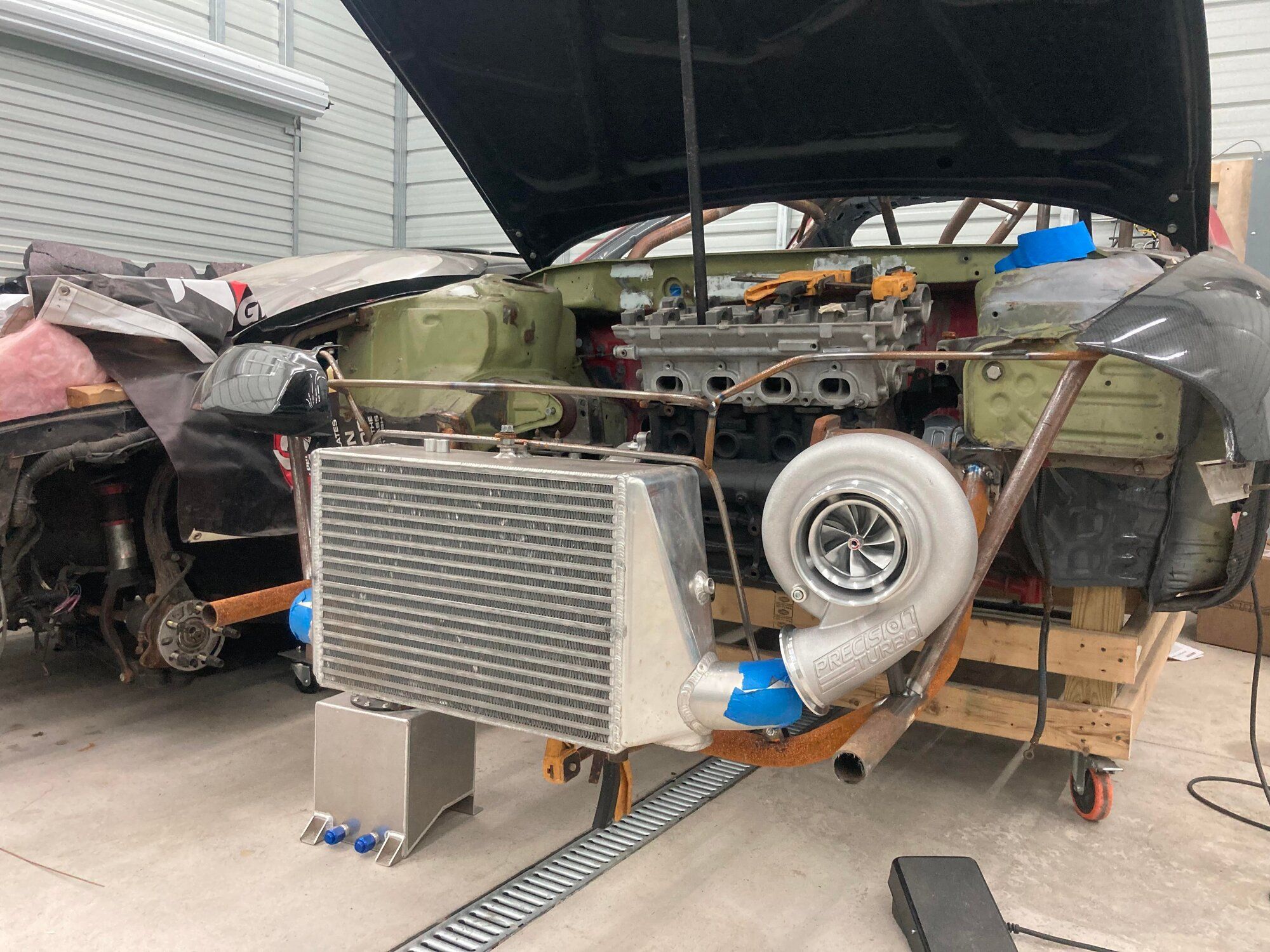

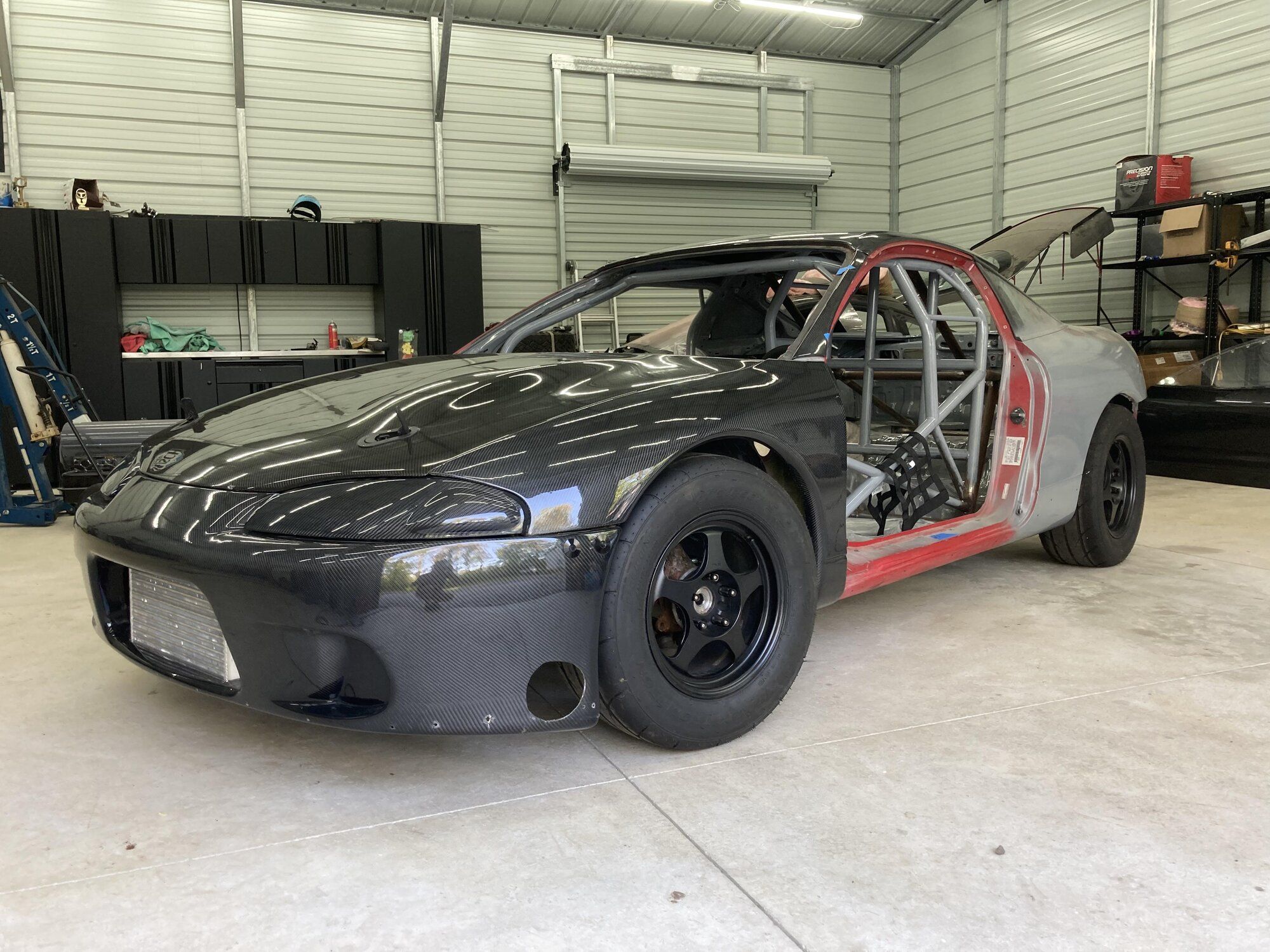

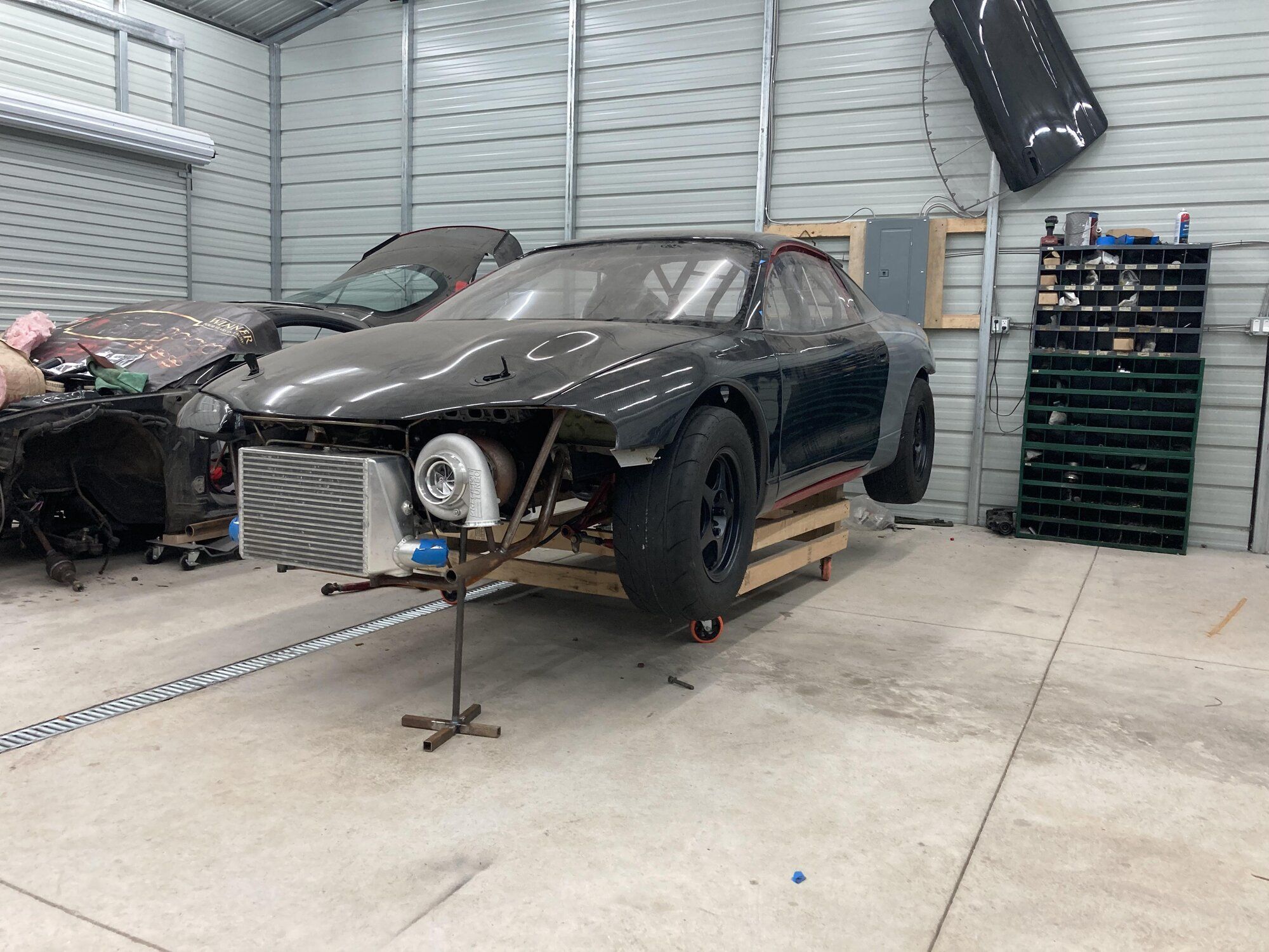

Getting that front end matched up to the OEM positioning must have been a little tricky. Not that it has to be exact, but I've always been fascinated how people get the bumper cover positioning right when they do tubular front ends like this.I FINALLY worked on the car this weekendmanaged to get a lot done. The floor bars are officially welded into the car and I got 90% of the 25.5 tacked back in. The last few pieces I need to make are a new windshield bar, roof bar and 4 gusset bars. This needs to be 100% tacked in by Saturday as the cars getting shipped off to Mikes house and he will be the contortionist to weld this whole thing up. Also changed how I am doing the front end so it can be symmetrical.
View attachment 671192View attachment 671193View attachment 671191
View attachment 671189View attachment 671190View attachment 671196View attachment 671194View attachment 671195
