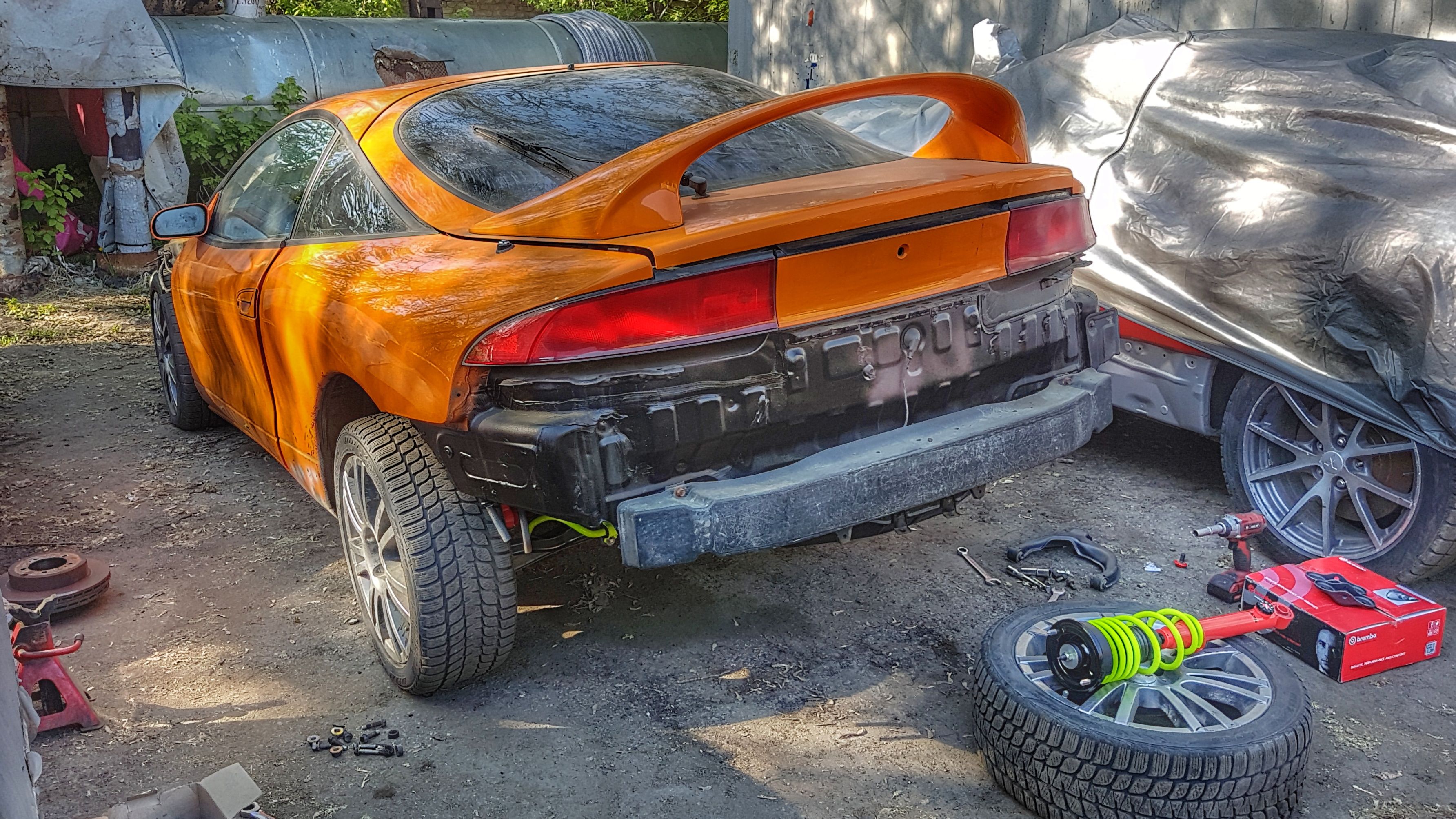

Mitsubishi Eclipse which is dissassembled at all will arrive to me on the tow truck. I will build it again. I will build it as factory stock and also tune it. I will recover 20th years old body of this car. I will share the experience of swaps and alterations to all-wheel drive for these cars.

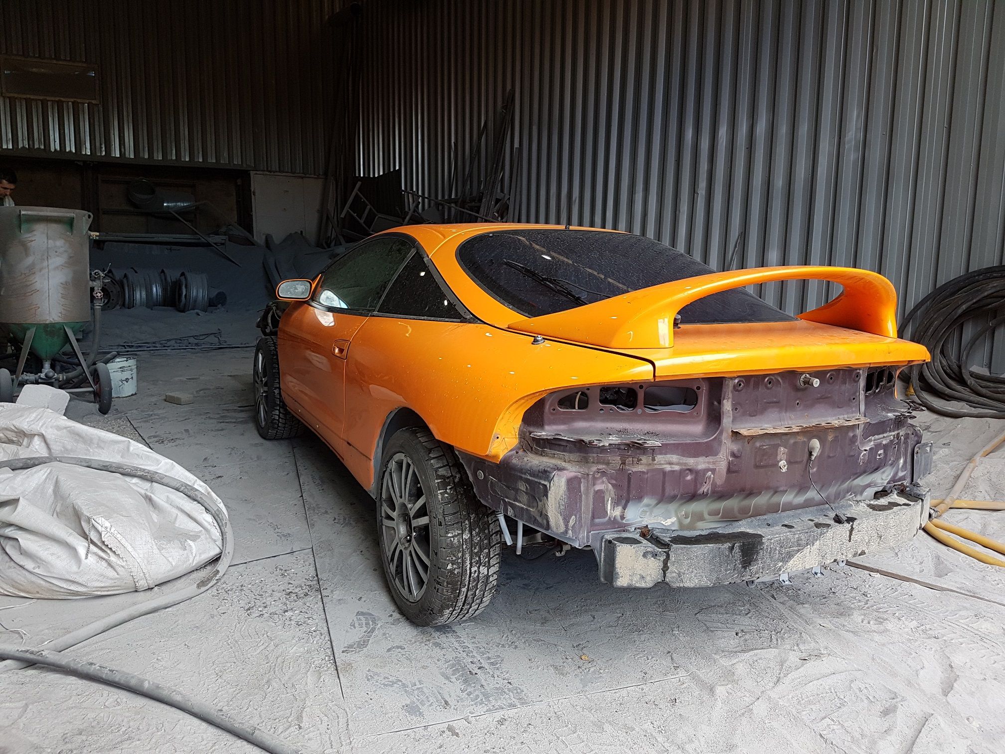

Day 3. I delivered the body of Mitsubishi Eclipse 2G 1999 to sandblasting work shop. There it was cleaned from rust and covered by acidic primer.
What's happened with the body after the treatment? What will be next step?
