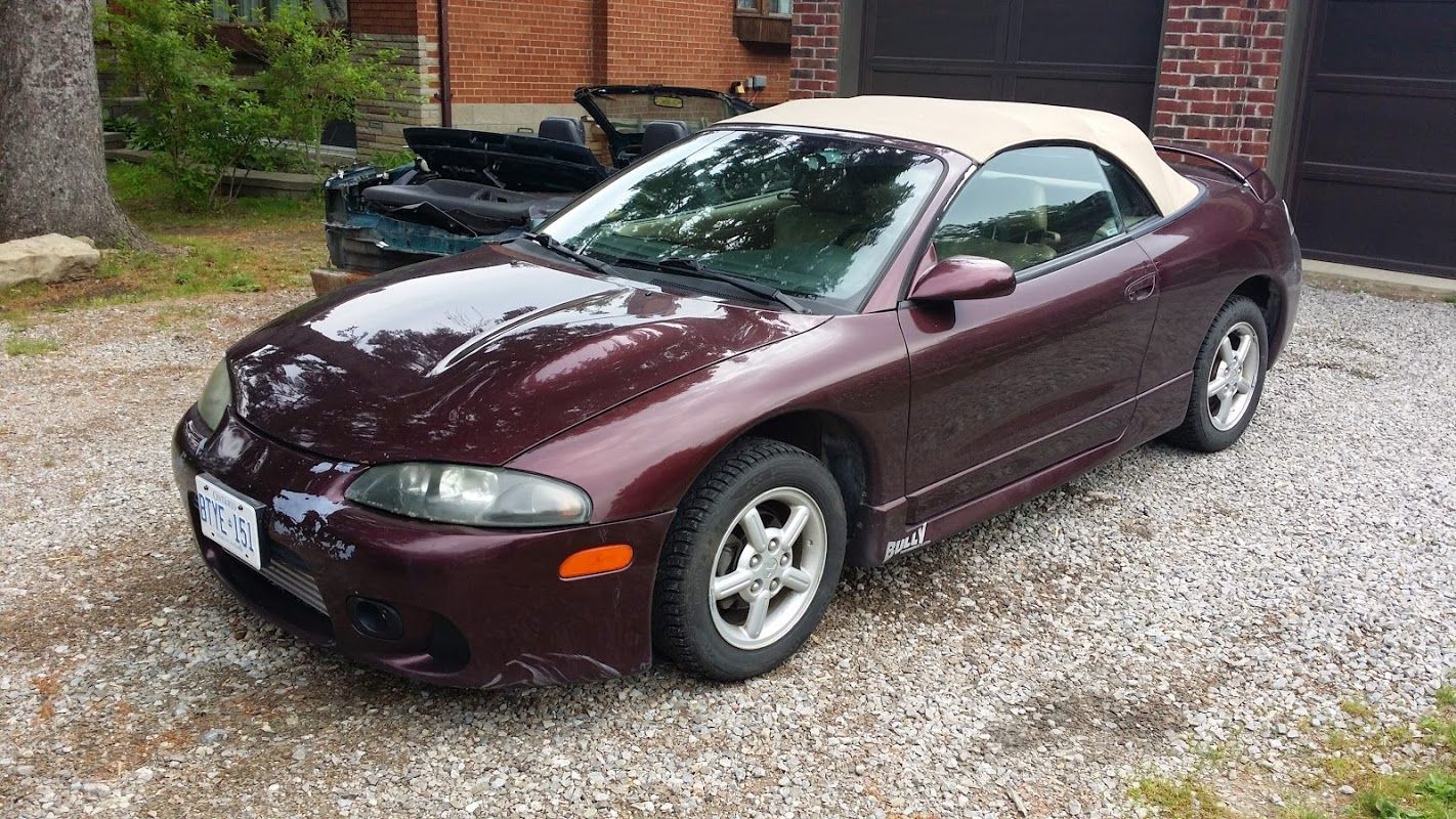

98 Spyder GST (AWD swap)
Daily Driver

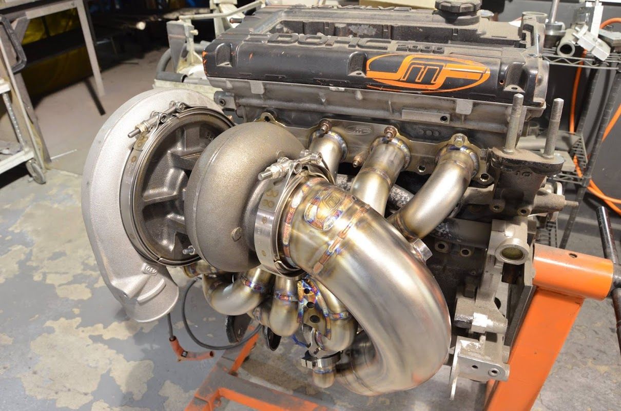

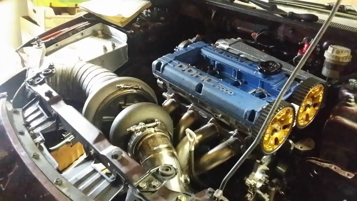

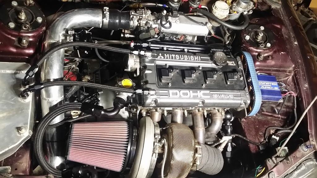

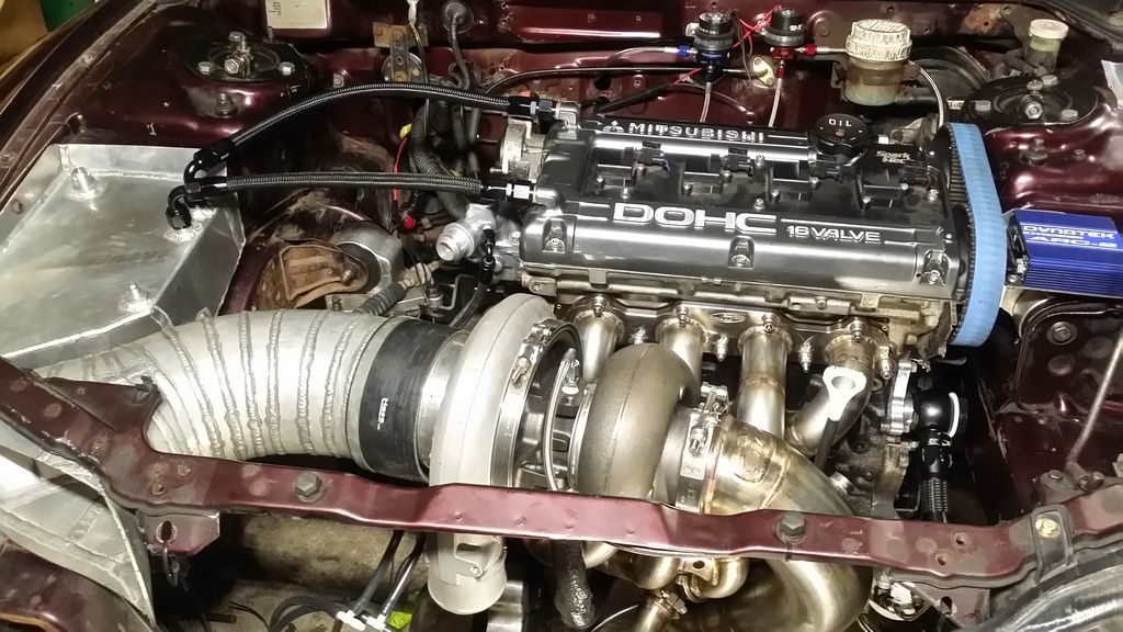

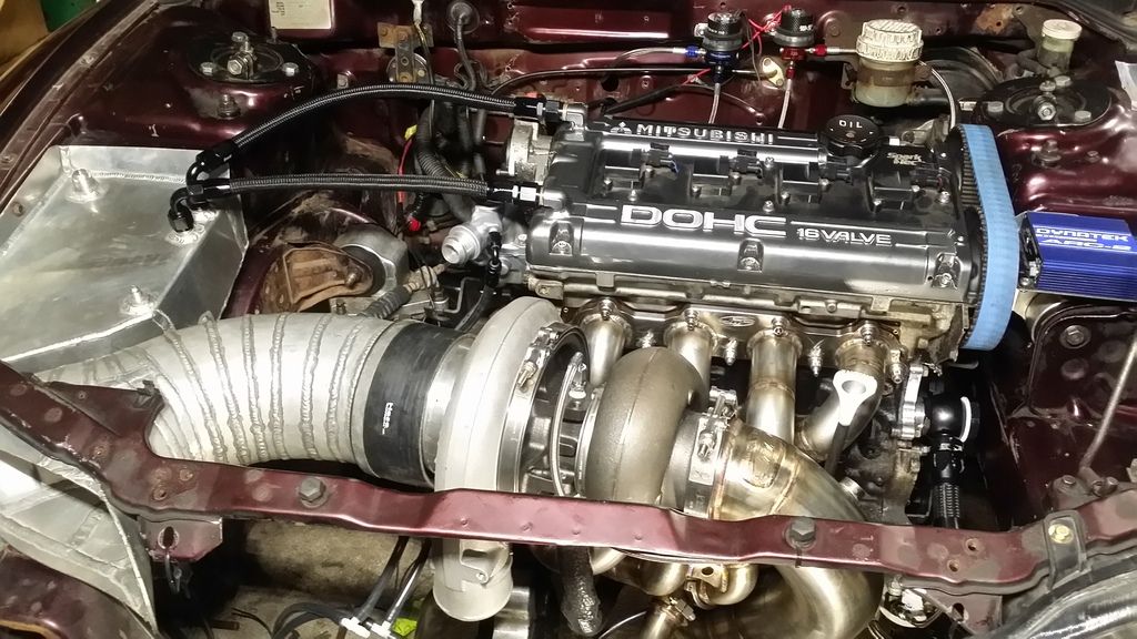

Big thanks to the guys over at JMF for making a manifold for this thing that fit without needing any cutting or grinding. Couldn't be happier with the quality of their work!
With parts coming in every day and being busy with other cars, its tough to choose a day of when to upload an update, but here's the new heart of the beast. Can't wait for the warmer weather!

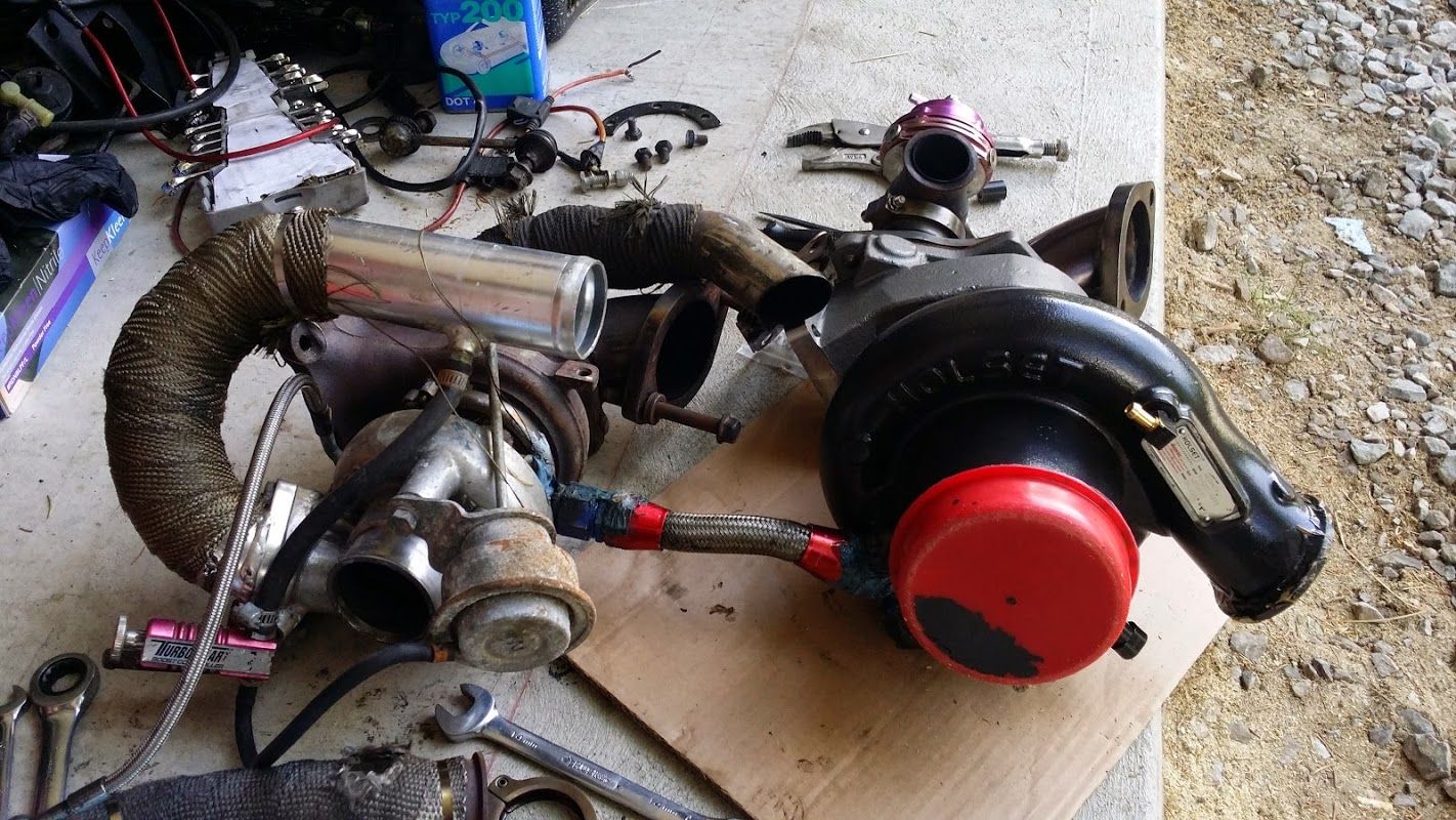

Suppose theres no reason for me to chase the awd spyder record on a holset any more!

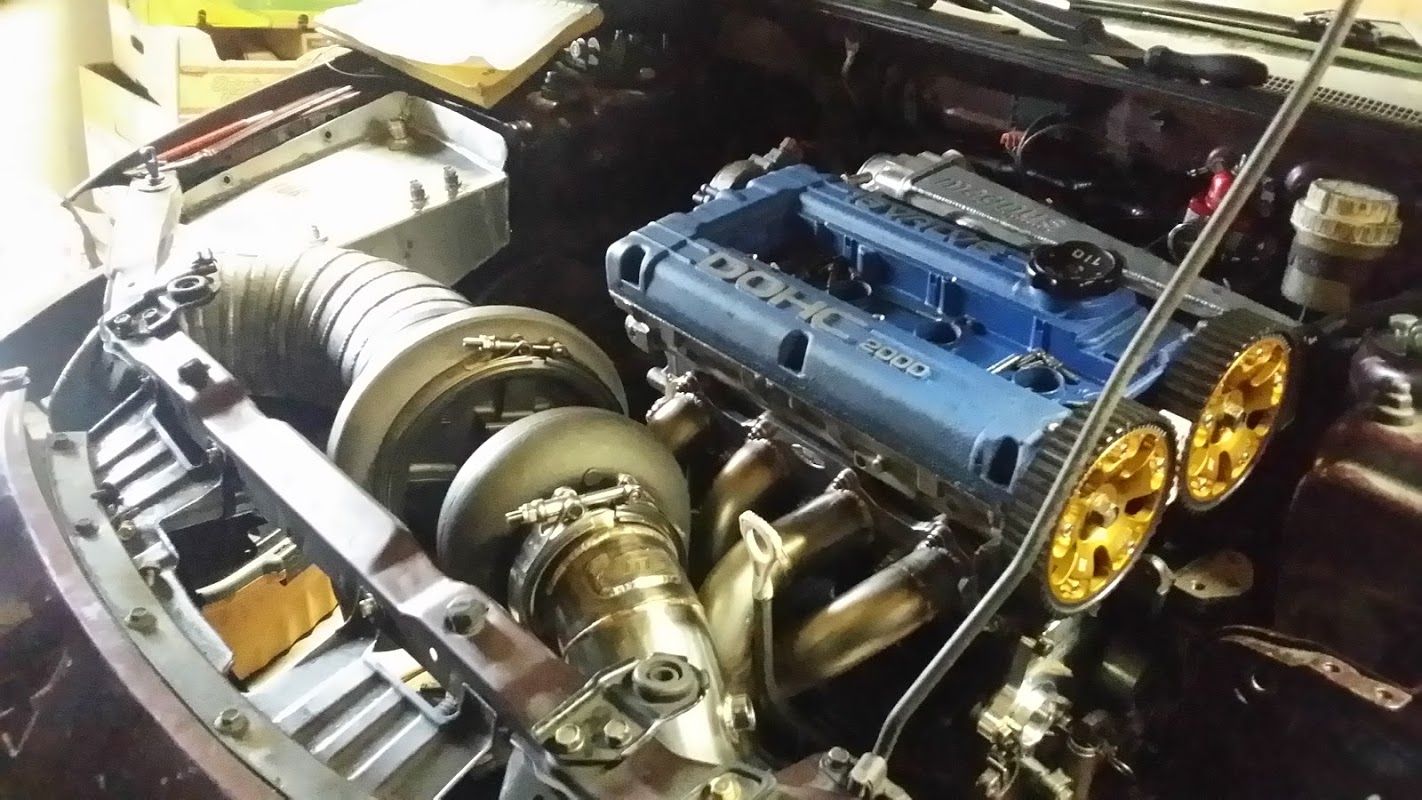

Got the beast started today. Drives amazingly. So far no regrets going auto.
Here's a video. Burnt off the header wrap, so it doesnt smoke any more. Now to see if it can last a 6 hour drive to the shootout!

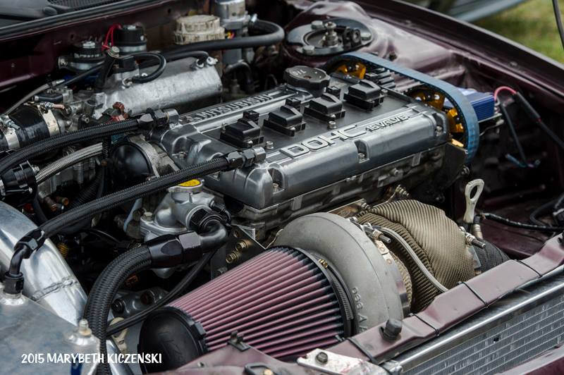

I did manage to squeeze in one street pull though. The log corrupted though, but if I recall correctly, it was reading 30psi below 6krpm. Once that BW builds past 10psi, it rockets right up to peak boost and moves!

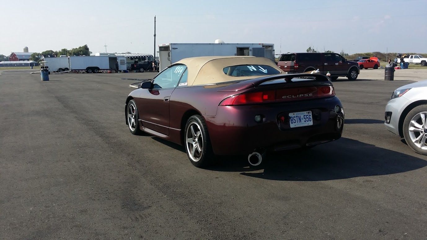

Zeroed out the cam gears as it was spooling much too quick, then I worked out most of the bugs. Still have lots of tuning to do, but now with the injectors dialed in, she's a blast to drive. Even at just 30 PSI on pump gas, this thing hauls. During her first pull, that I drove down to Mexico to do, I let off early as both how hard it pulled and the shear sound it makes up top is absolutely surreal.
Went to the track, about 20 min away, my alternator decided it didn't want to make power, so I boosted the car from my friends car. Terrible idea? Yes. But I was dead set on logging one pass. Made 2 passes(after the first, my computer overheated and didn't save the log), both were trash, but here's some in car footage of the second. Voltage was at around 9-10v and the pumps wont make pressure at low 9v, which I found out when the gauge read 8.7v, at which point I shut it off to prevent damaging anything and towed it home, with a terrible 12.6. Going to swap in a GM alternator, better brake pads and will be back for more this year.

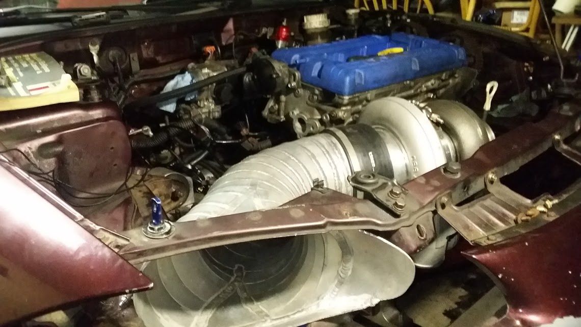

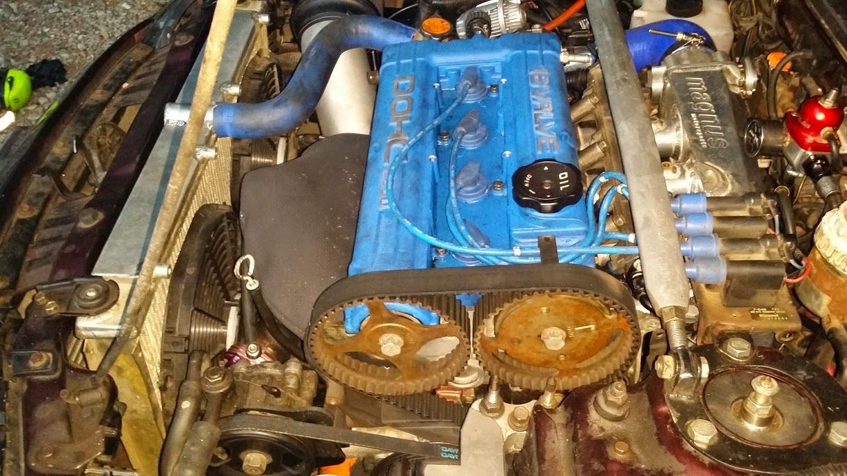

So I've started working on the changes for the winter, seem's like when I set the CAS at the shootout, I never put loctite on bolts, because one of them was missing and the other was very loose! It would explain why I was having issues suddenly at the track on the last day.

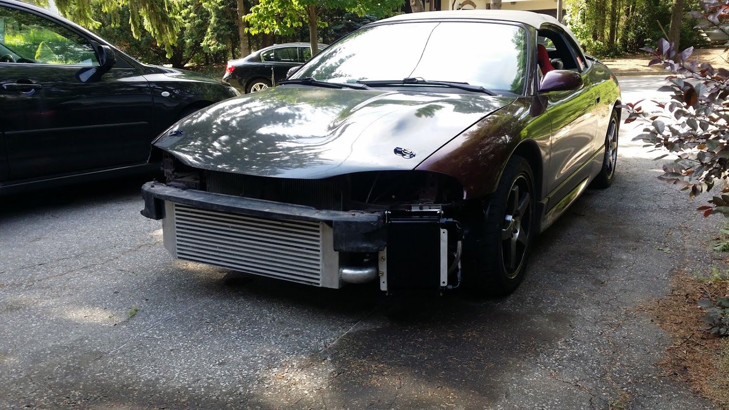

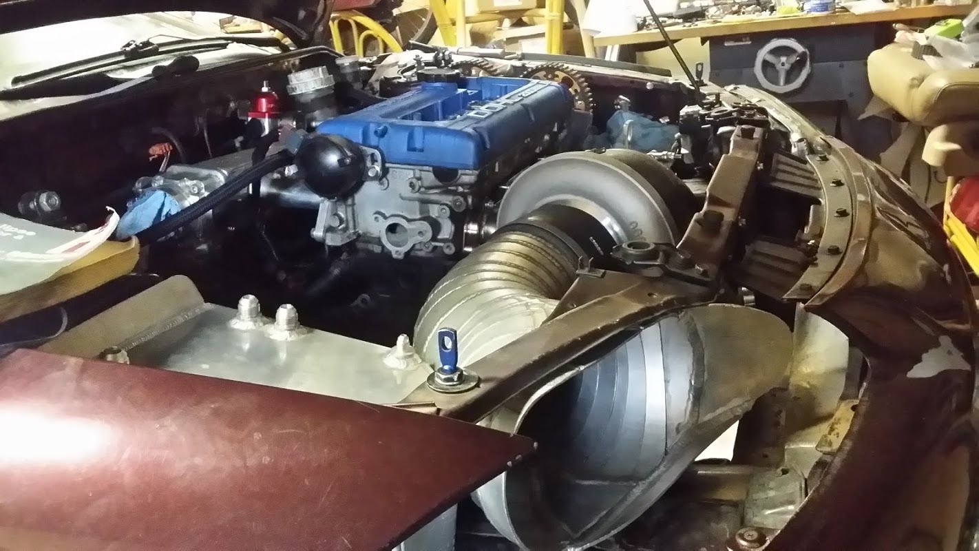

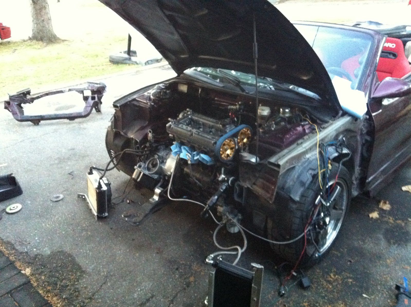

The engine wiring harness was pulled, and now, I've started the tubular rad support, cutting it wasn't as bad as I thought. I covered the area with a fire blanket so the engine didn't get hit with any sparks and went to town.
