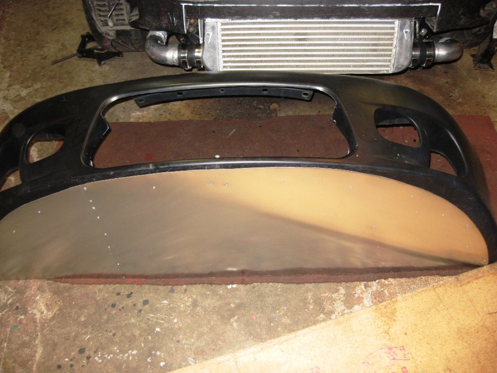

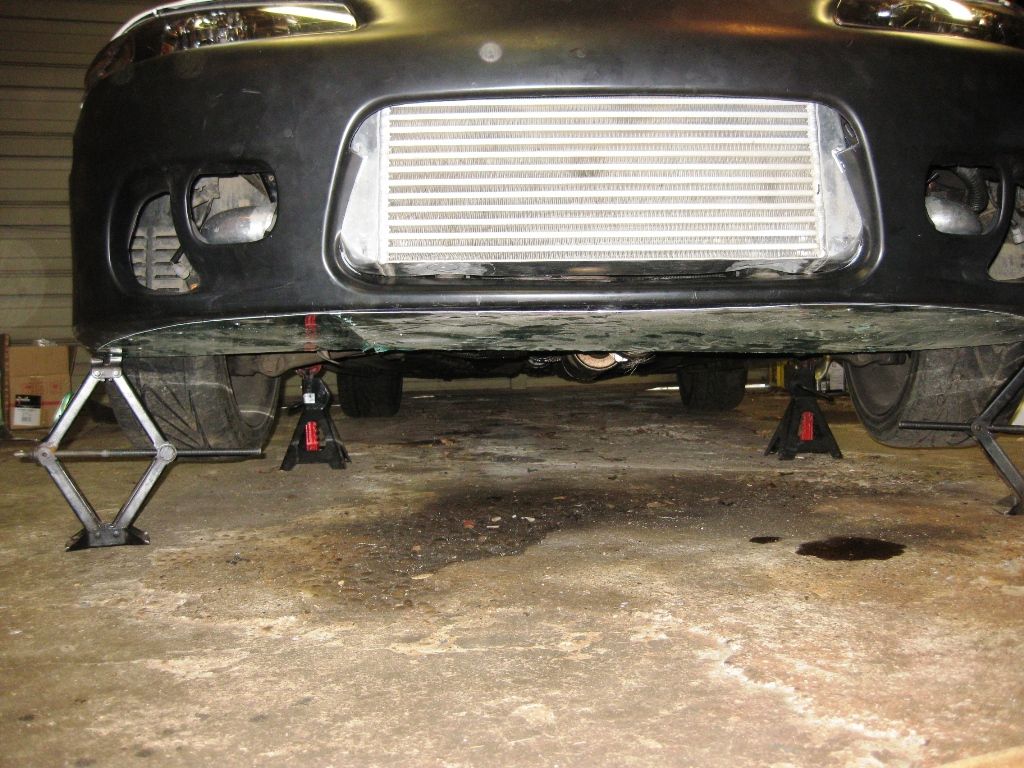

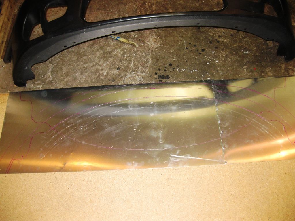

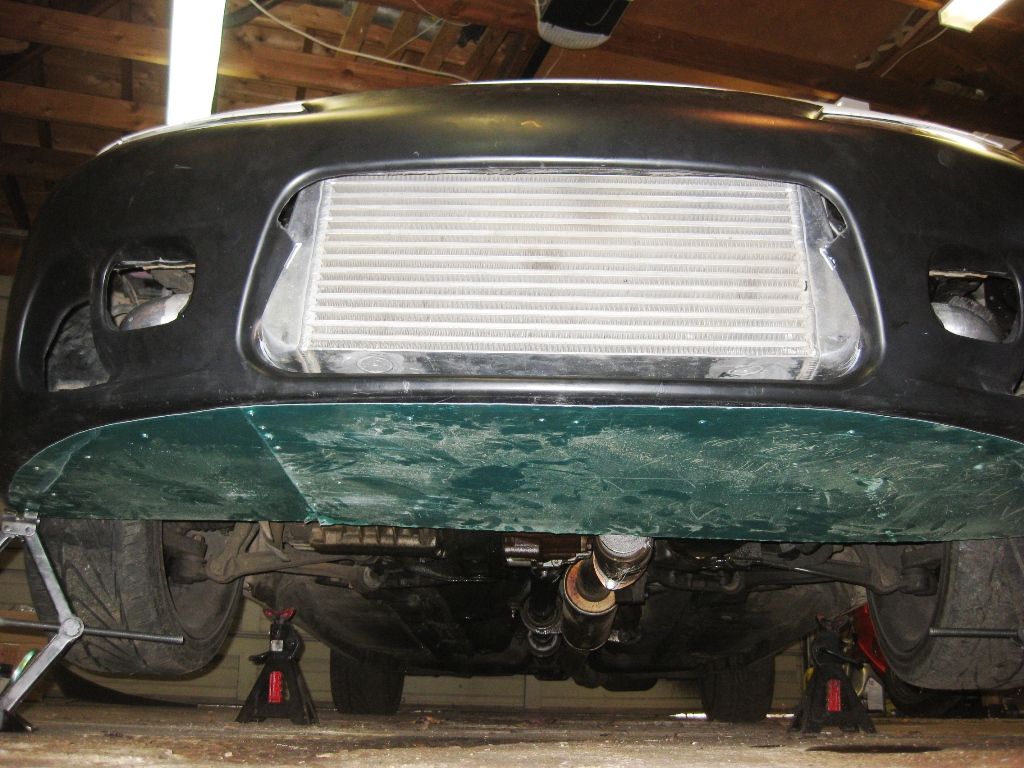

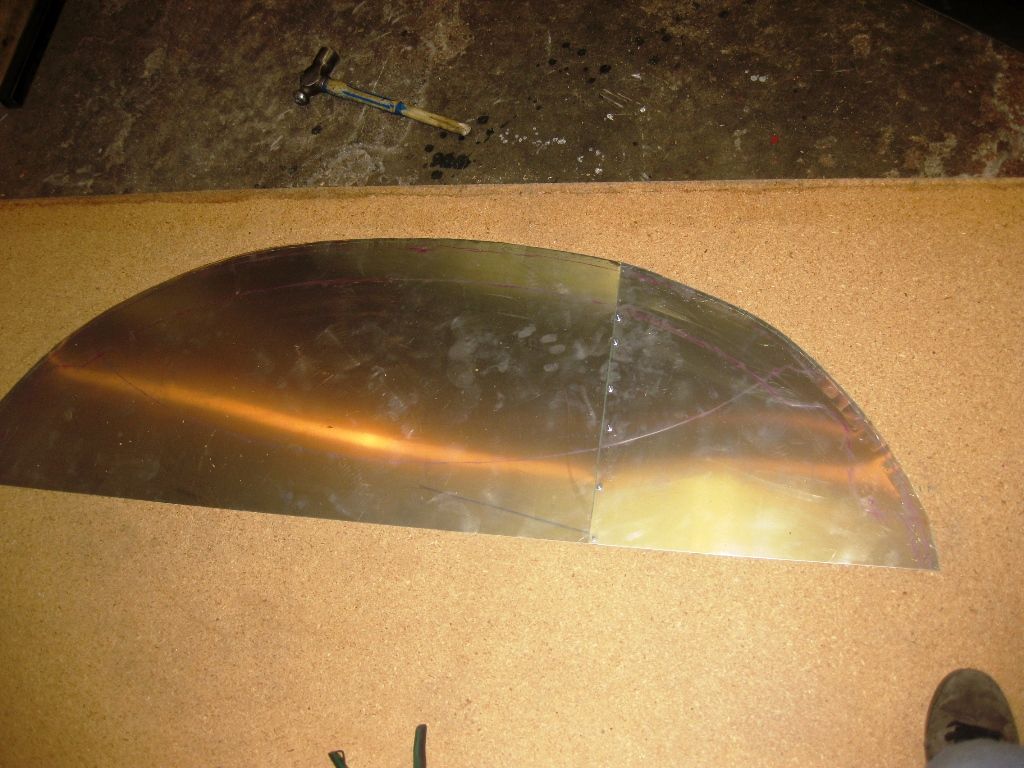

Next up I decided I needed an under tray to again help flow. Bought a little scrap cutoff stainless pieces on the cheap and built a quick one in about an hour.
Looks way more flowie to me! Hahhaah. :)

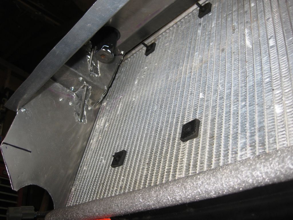

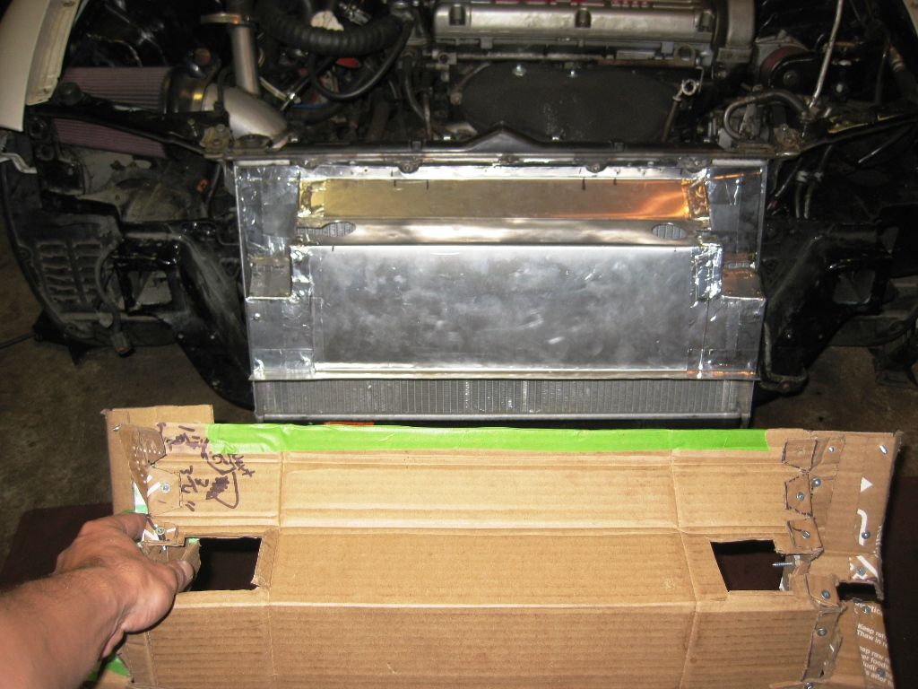

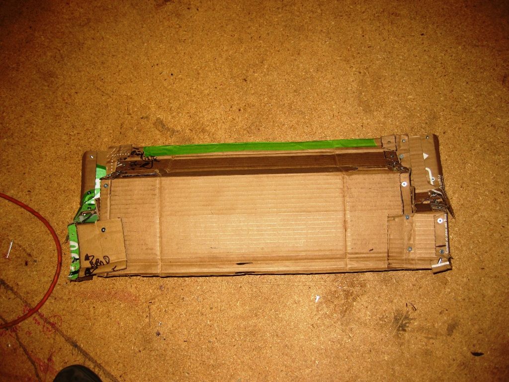

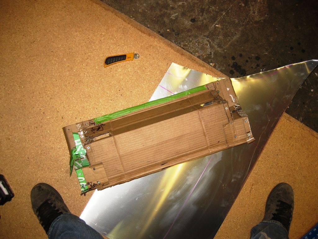

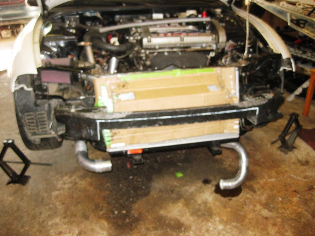

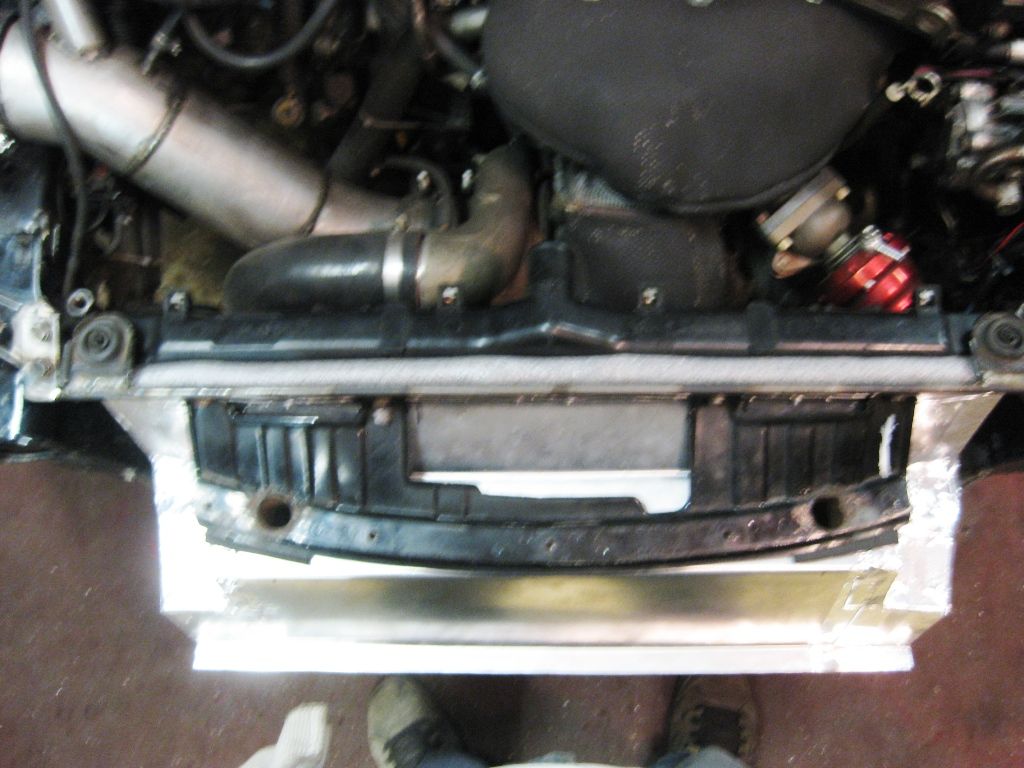

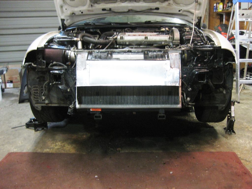

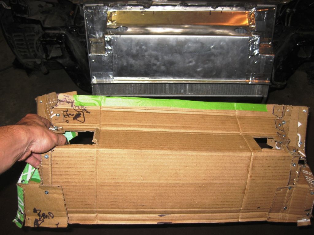

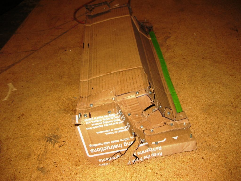

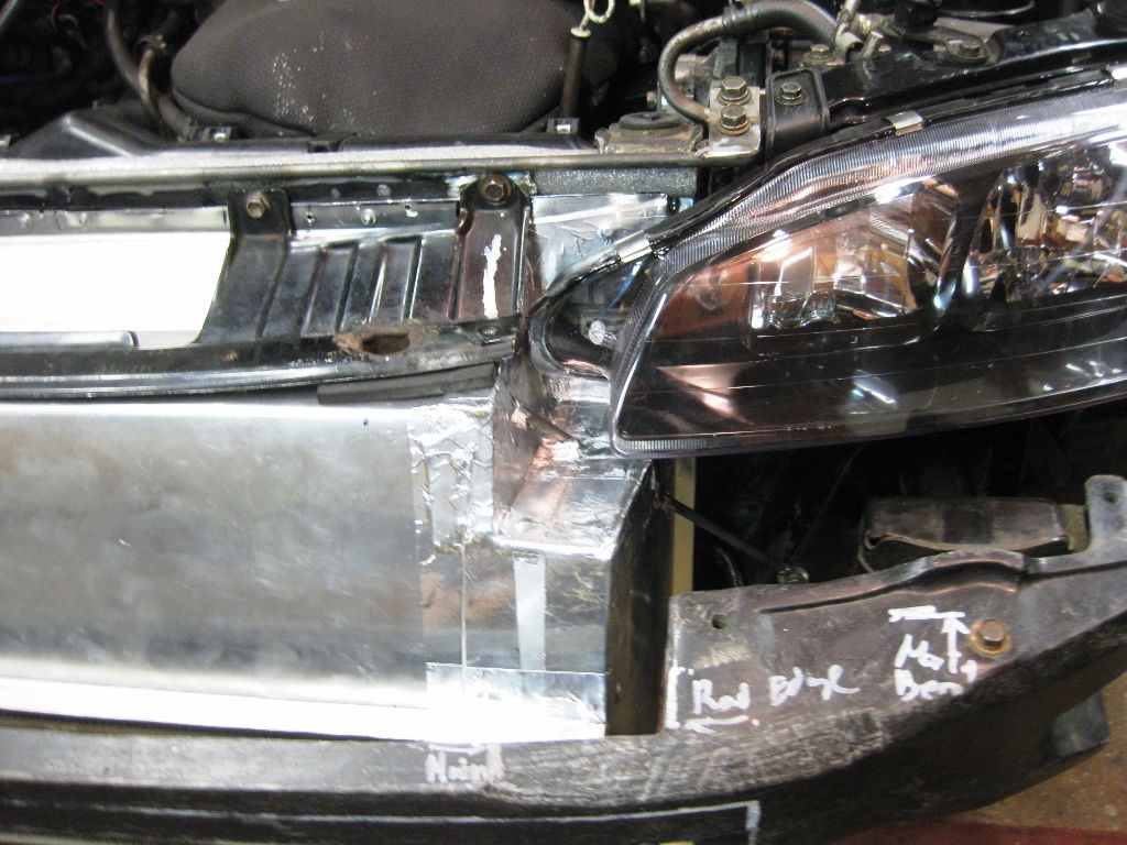

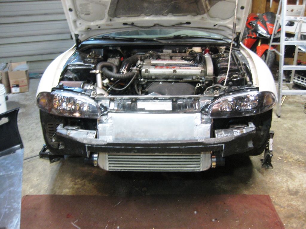

Now for the ducting. Started with a cardboard template and quickly moved to the stainless. Got a bender at Princess Auto on sale for $40 too. Love a good sale. :)
Template was daaamn close to the final product.

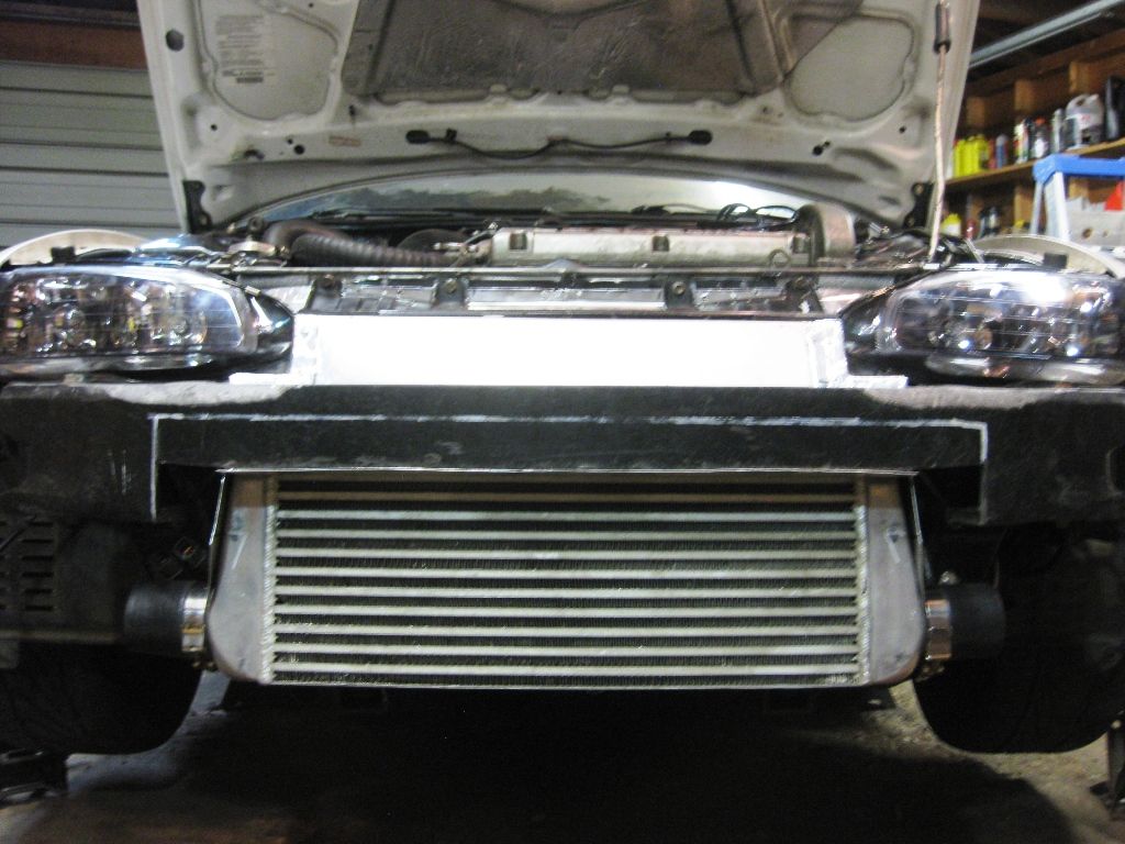

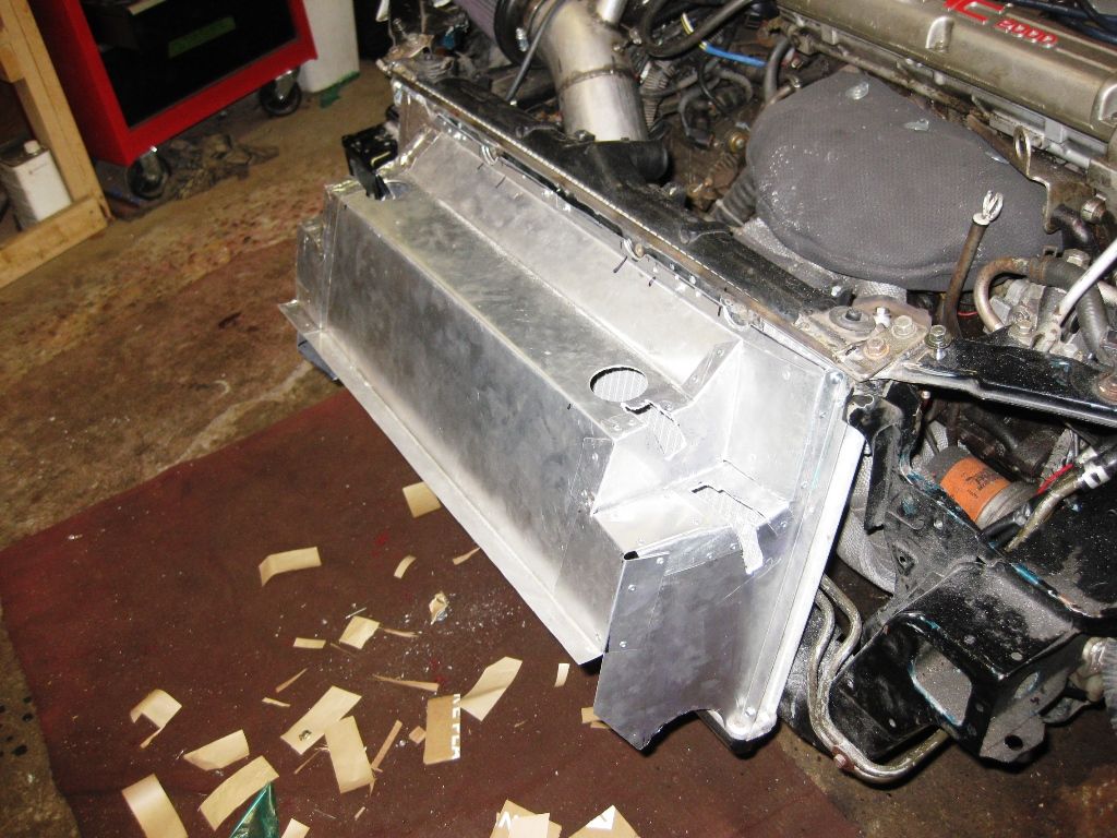

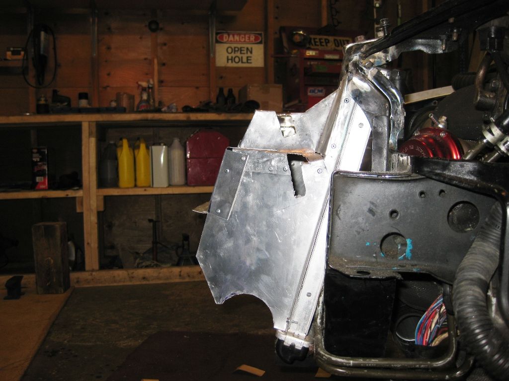

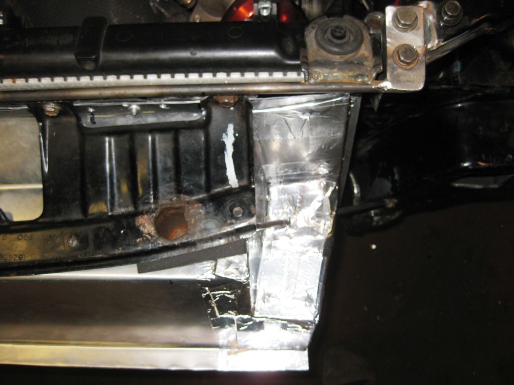

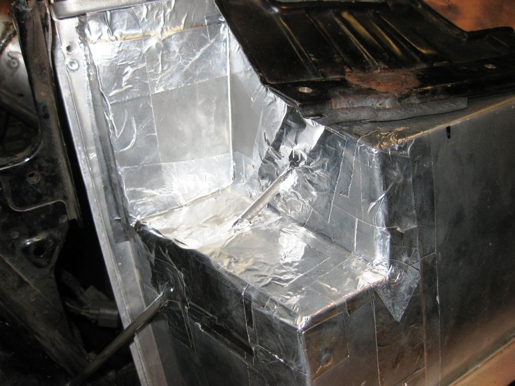

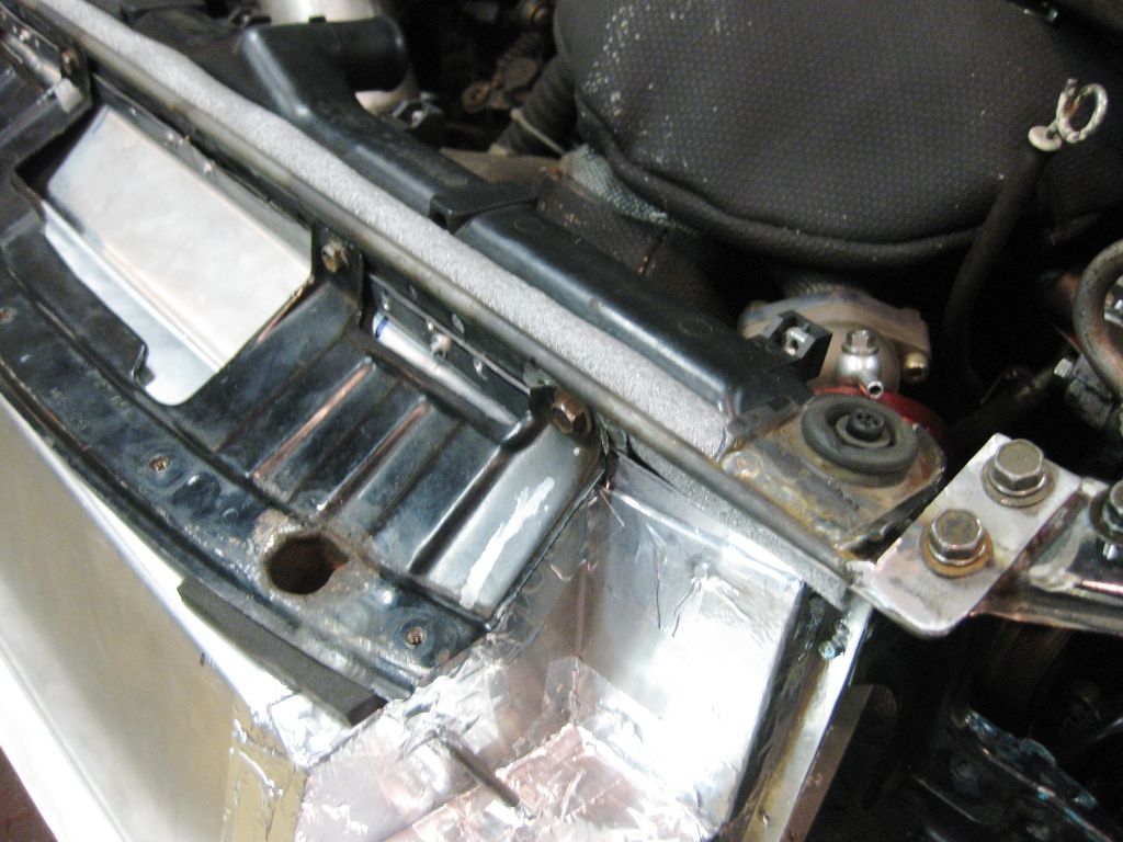

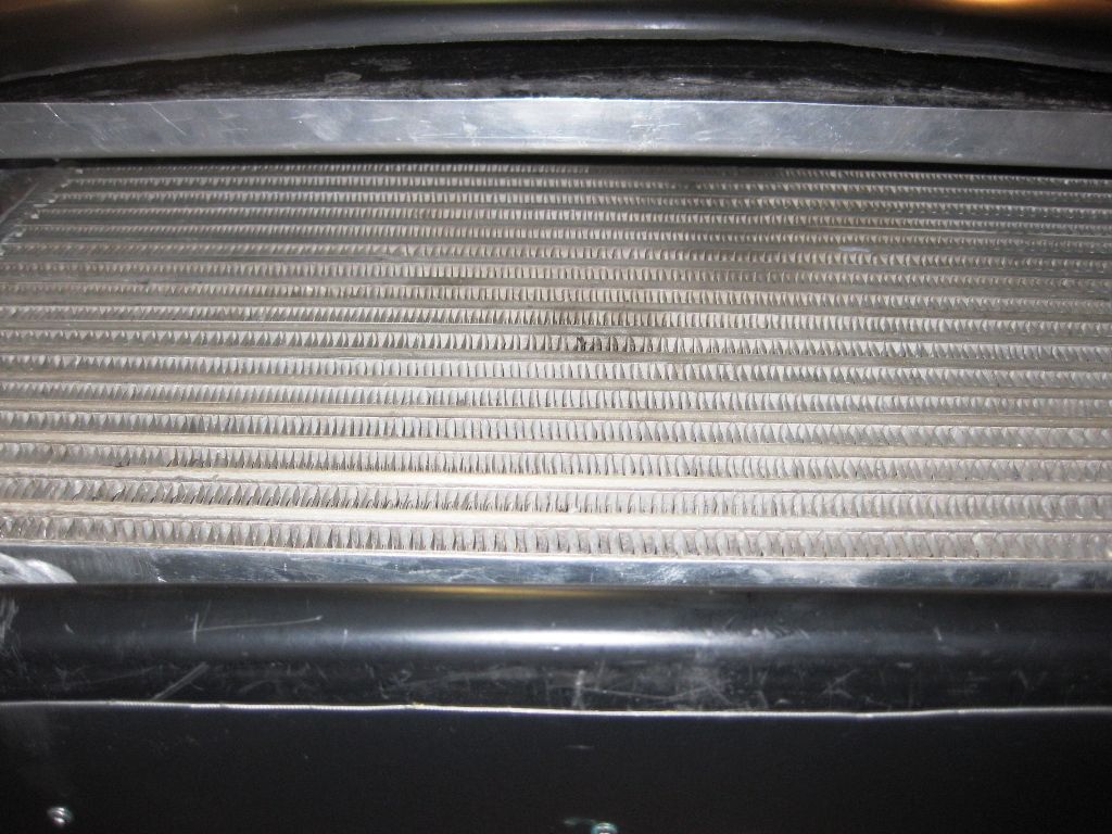

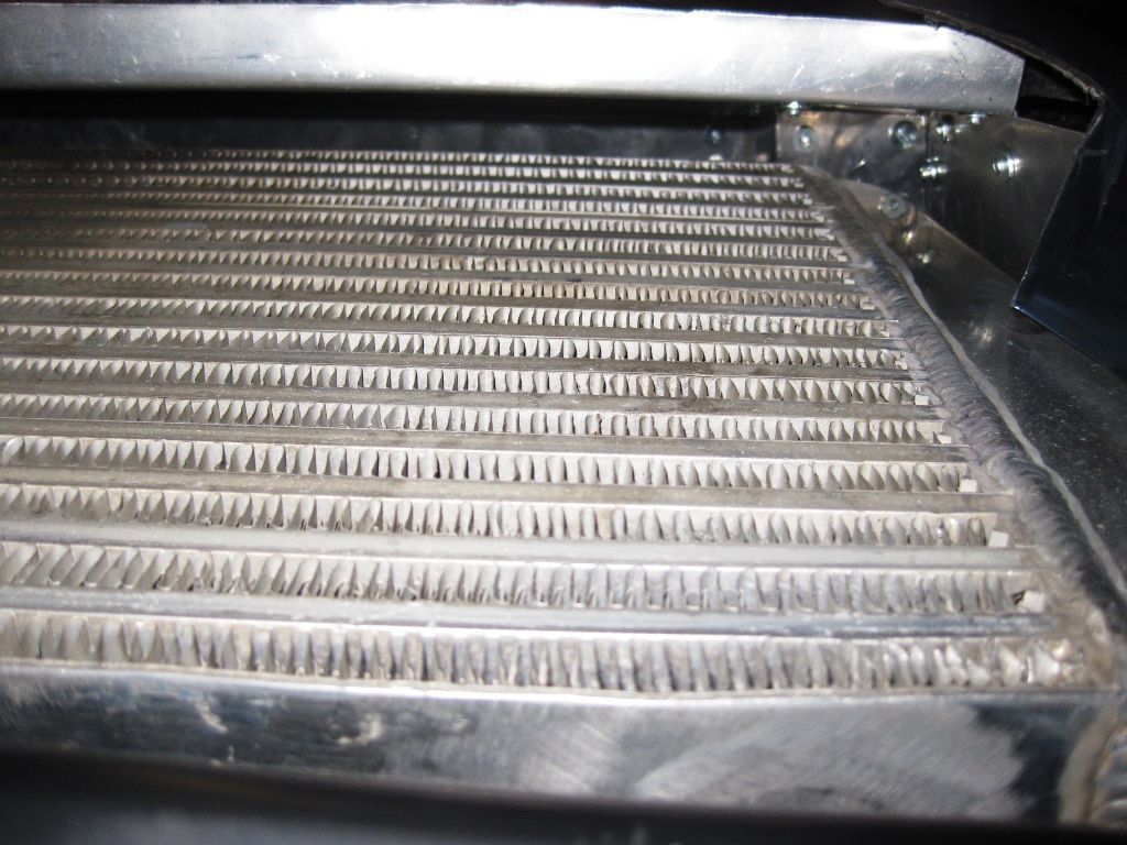

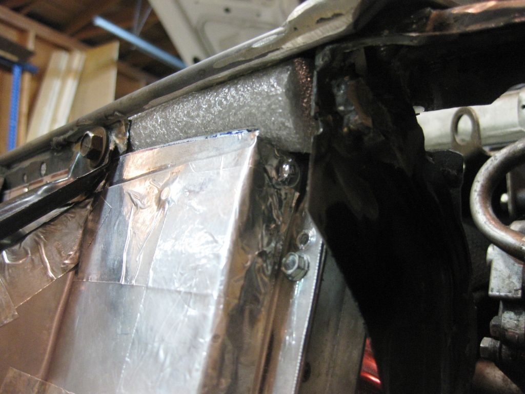

Coped in the ends around the intercooler and secured it right to the rad itself.

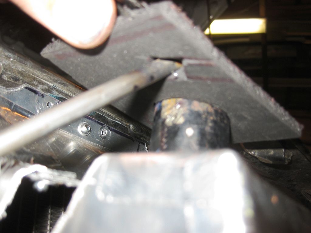

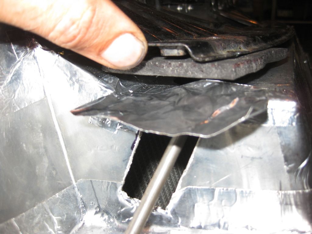

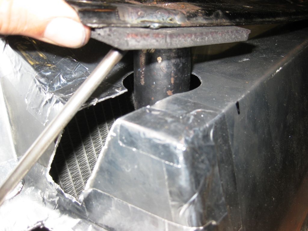

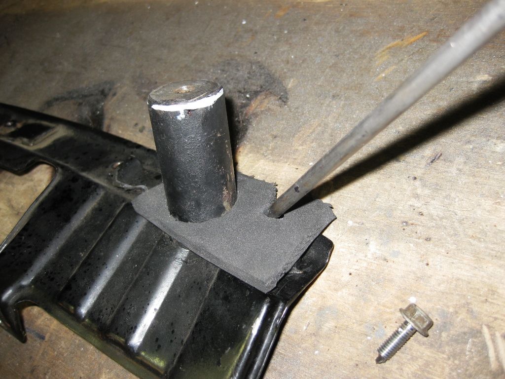

Some holes for the intercooler/bumper bracket in the duct....

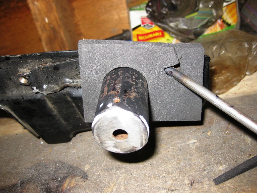

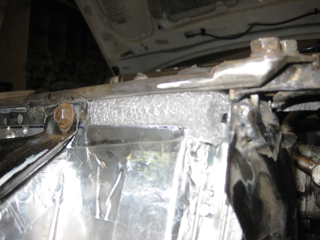

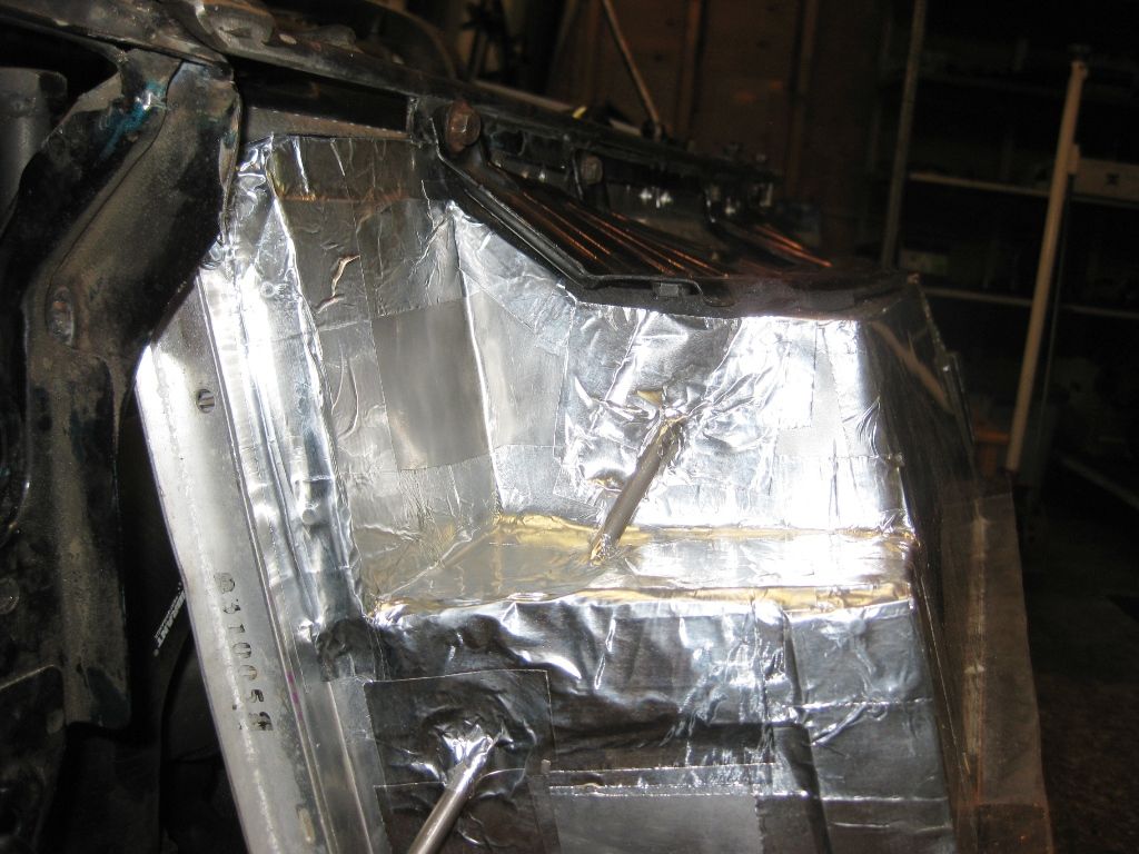

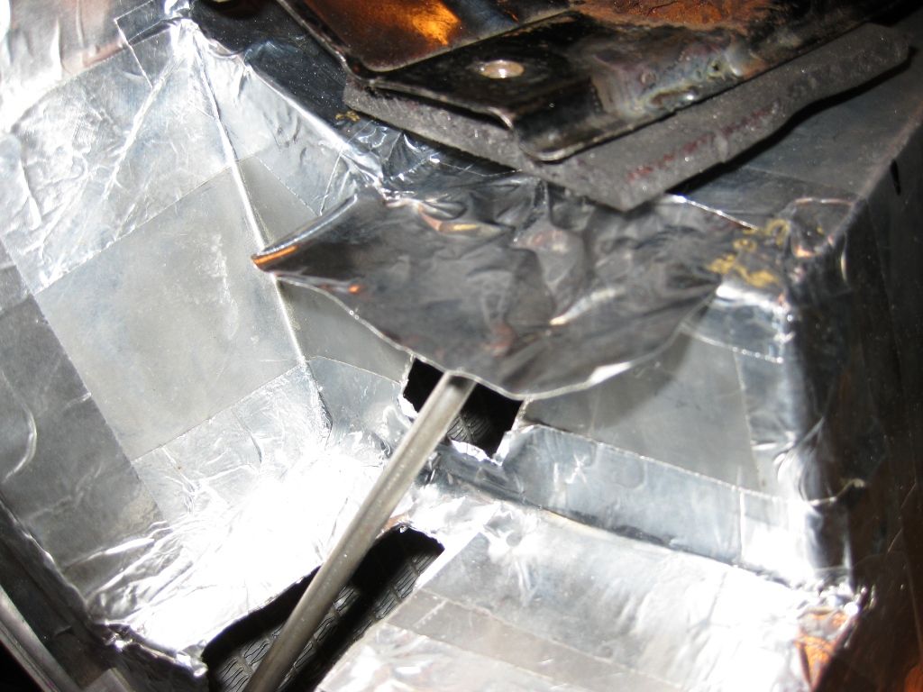

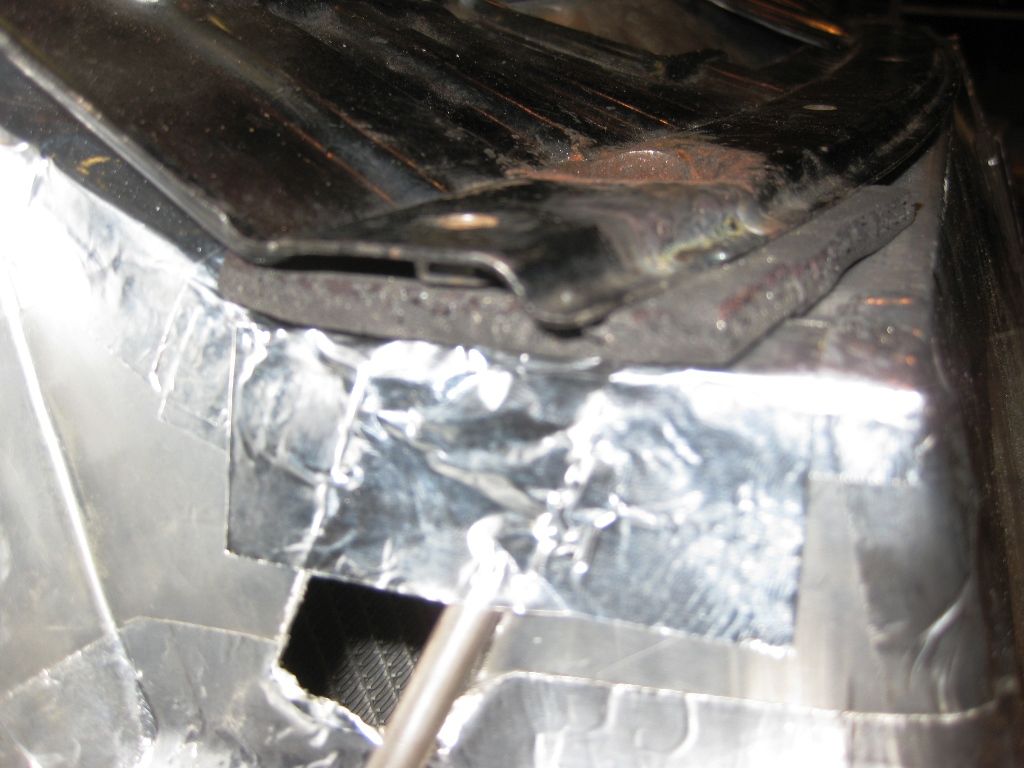

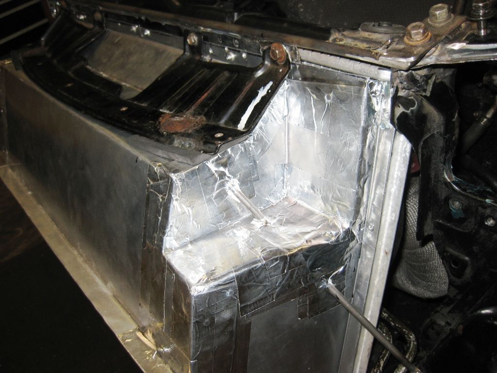

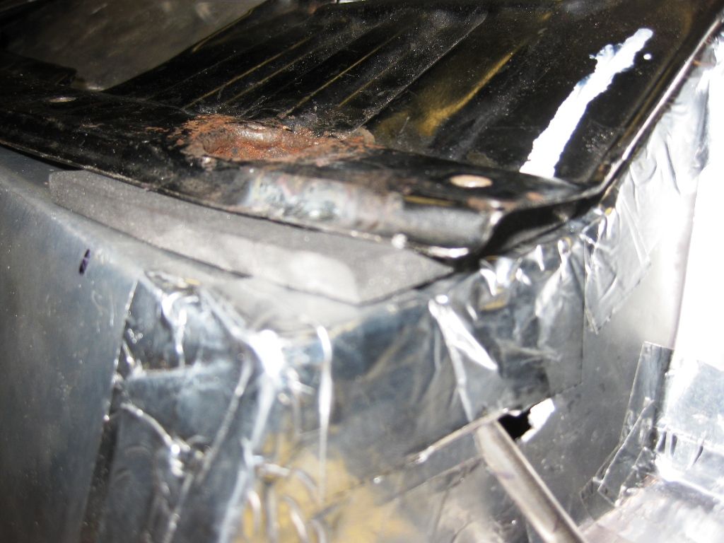

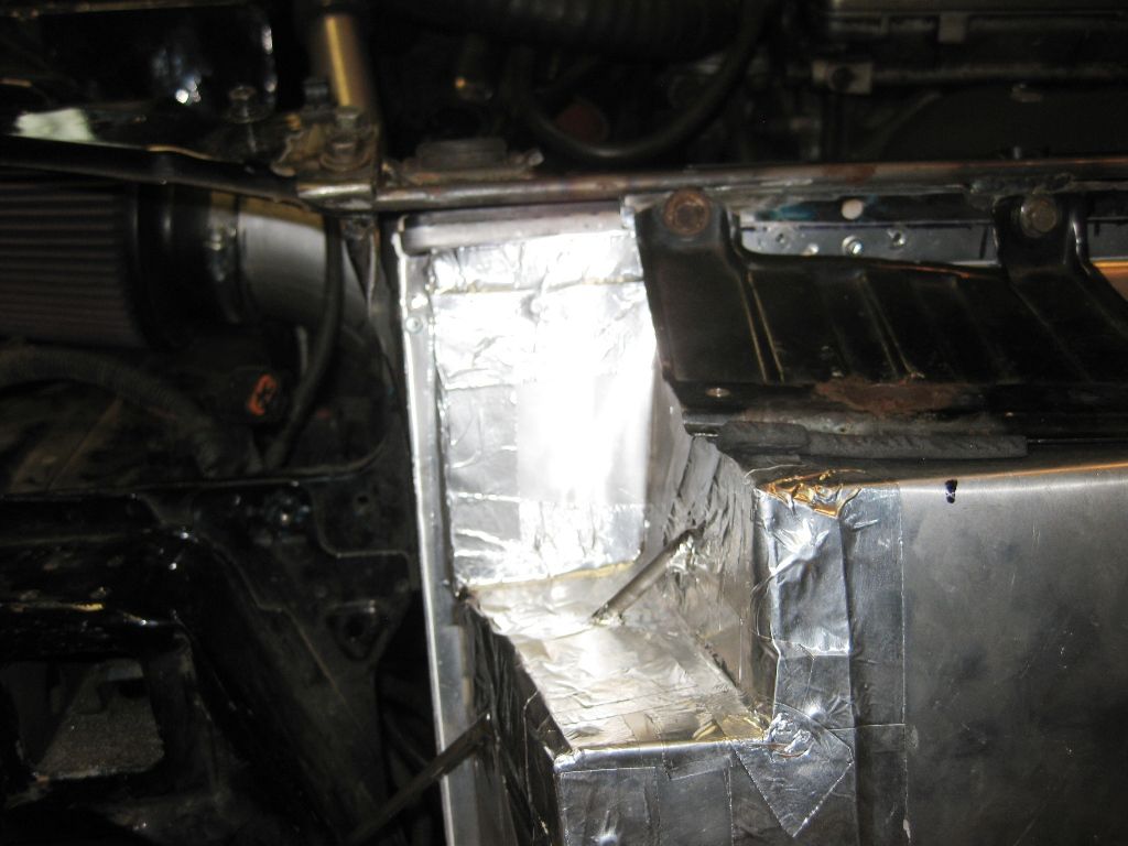

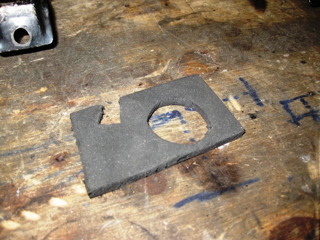

And some sweet little foam pieces I coped in around the bracket to seal it up against the ducting...

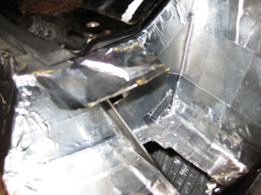

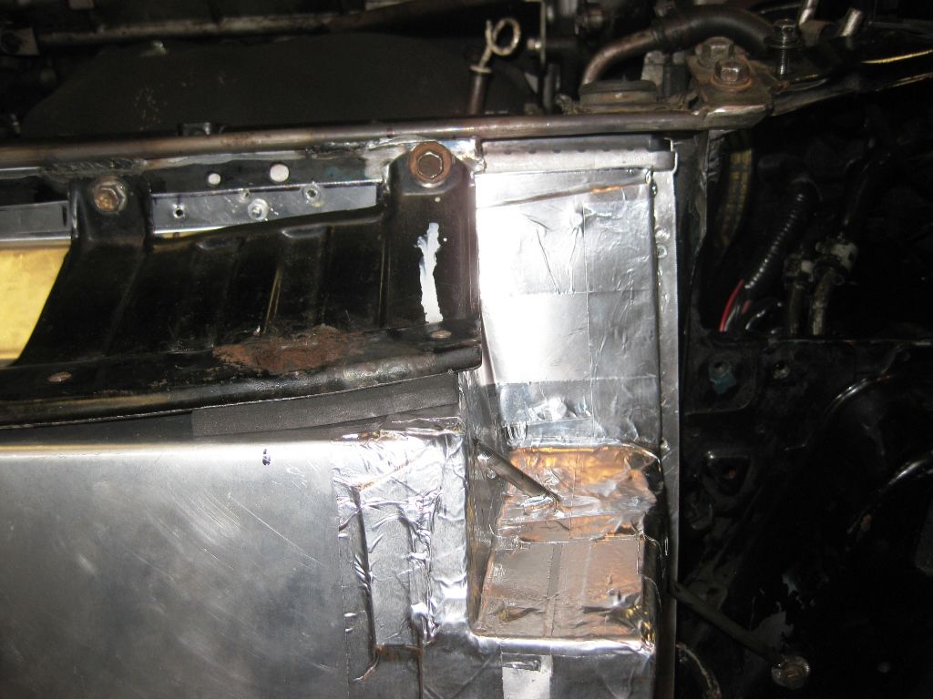

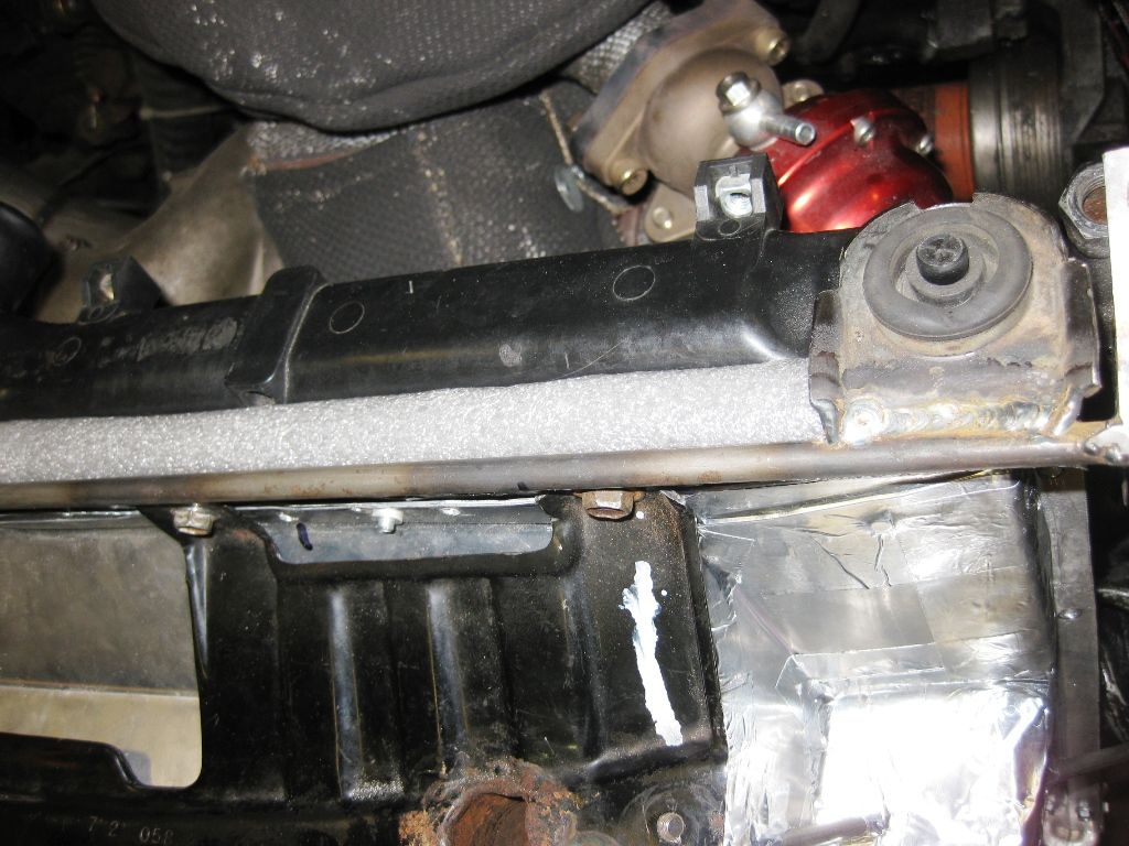

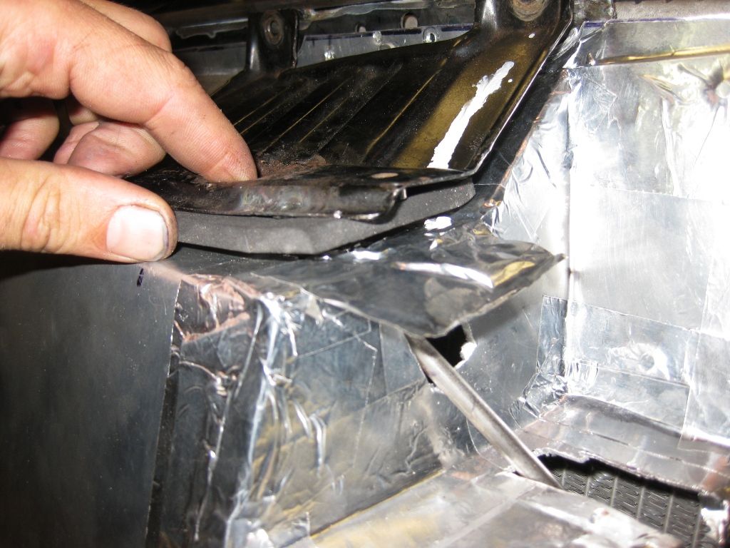

Used some foil tape to seal it up under the foam seal and around the bracket....

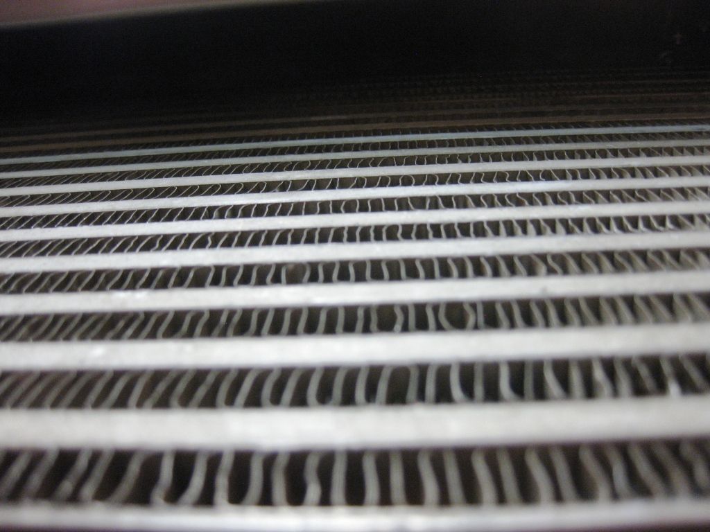

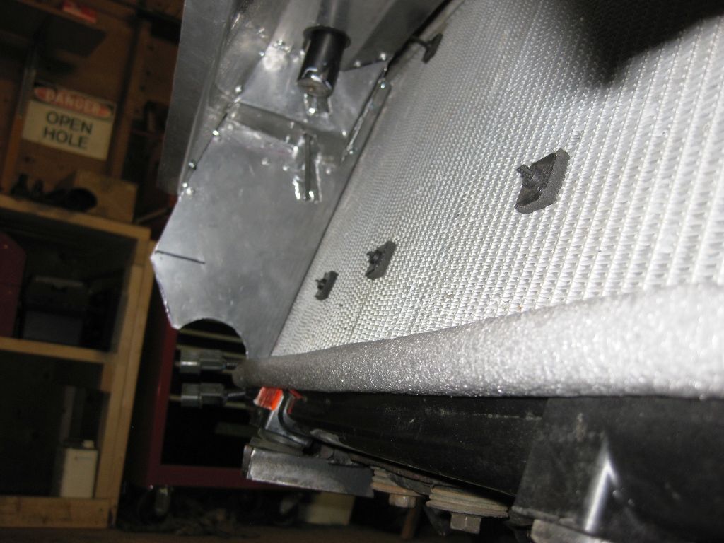

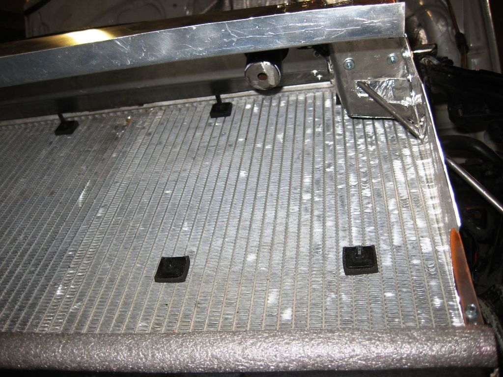

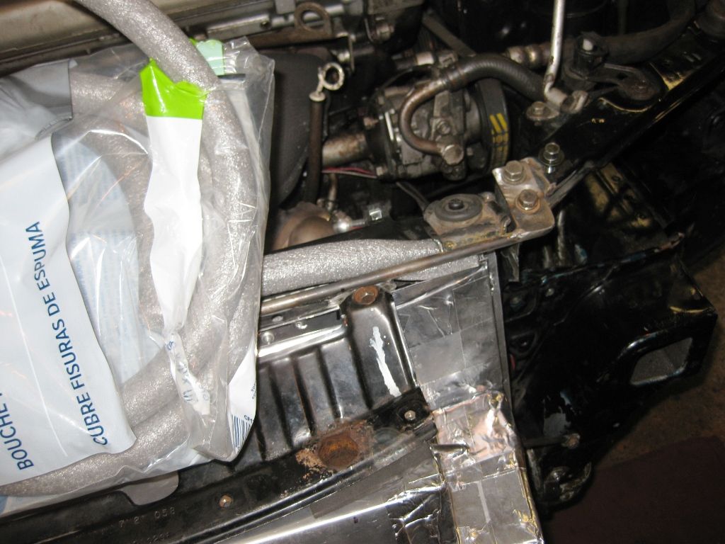

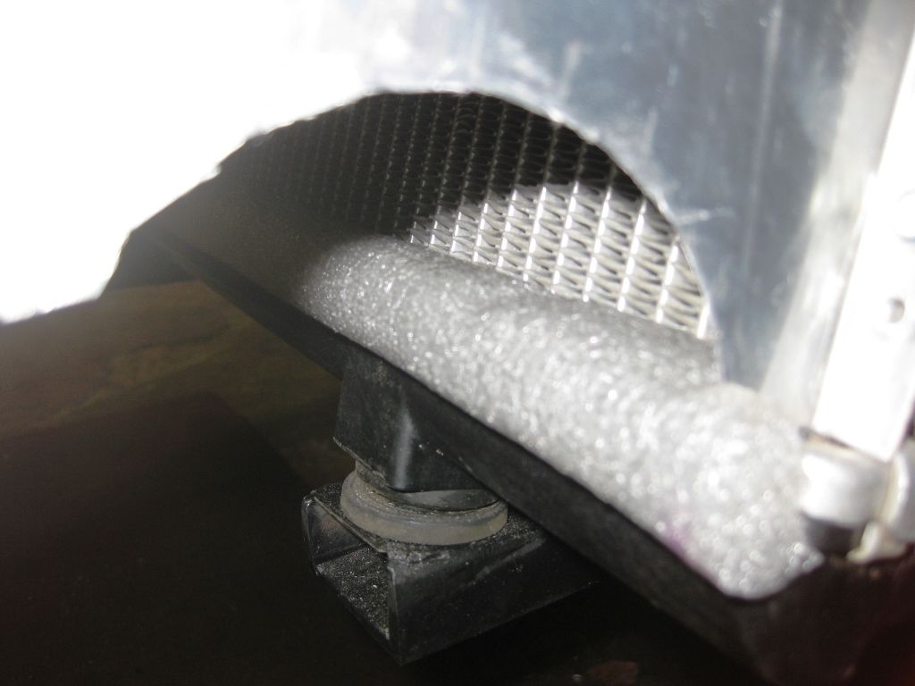

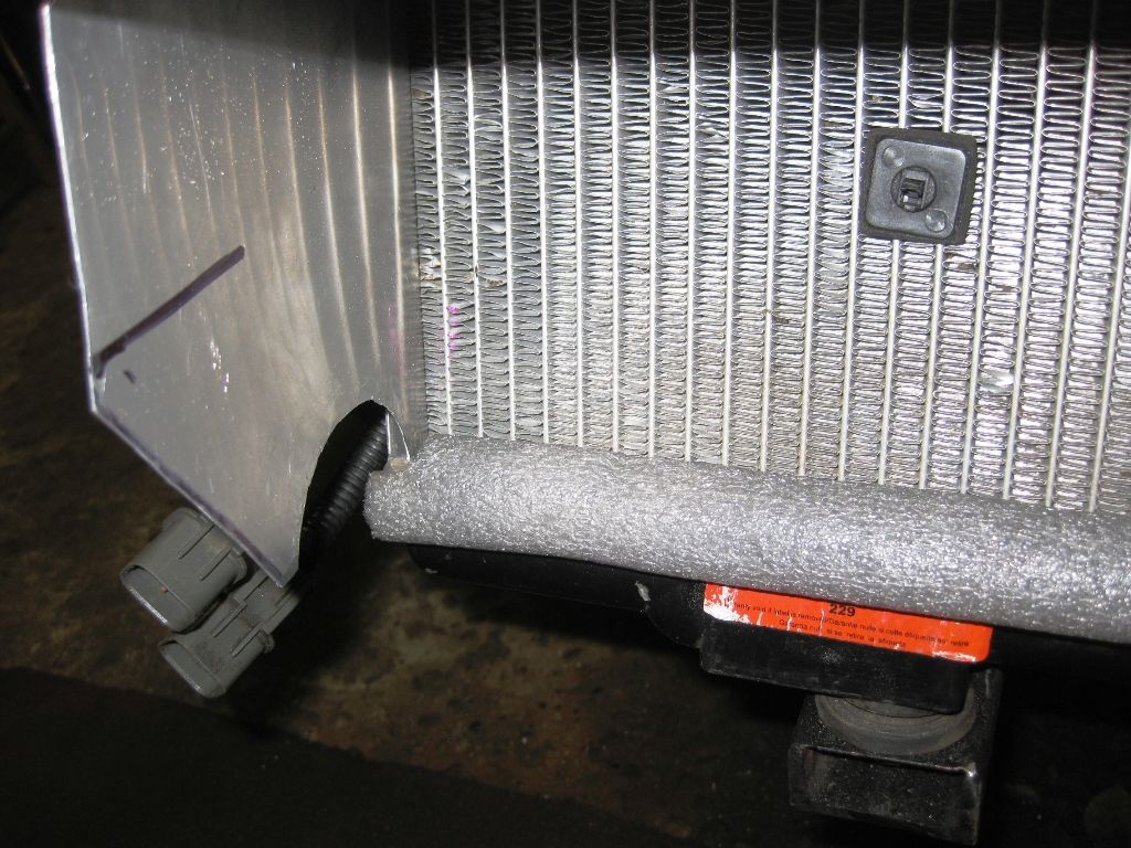

Foam to seal up the bottom of the rad to the intercooler....
Foam to seal up the top of the ducting to the rad....

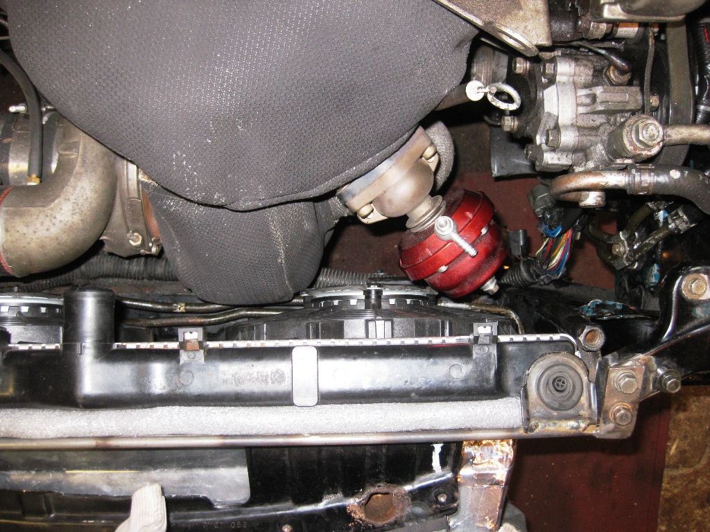

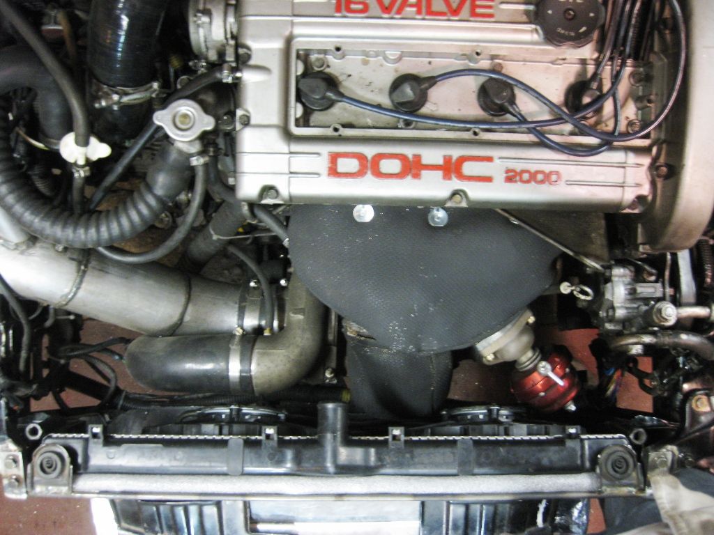

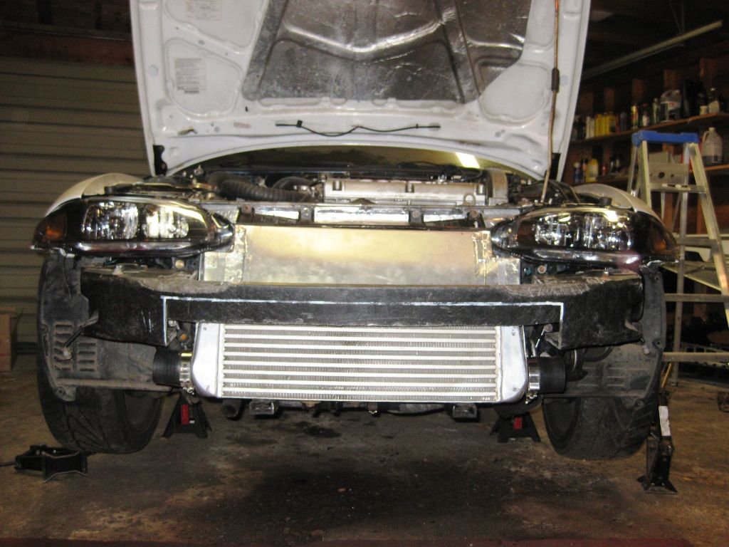

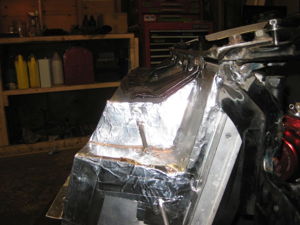

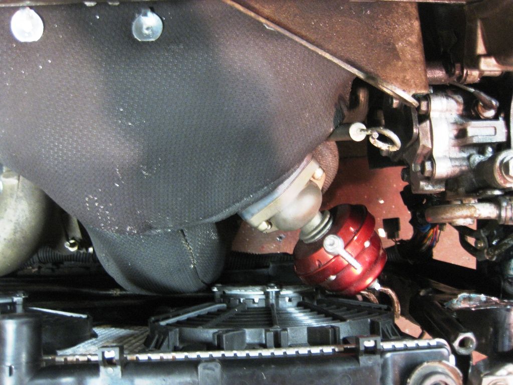

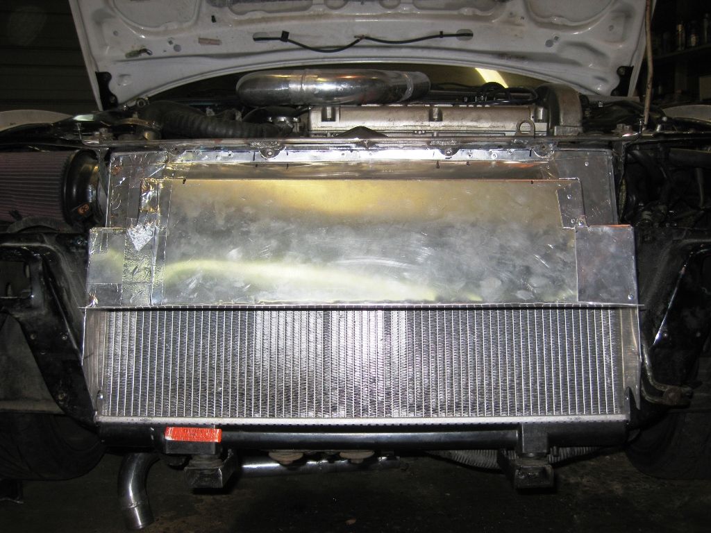

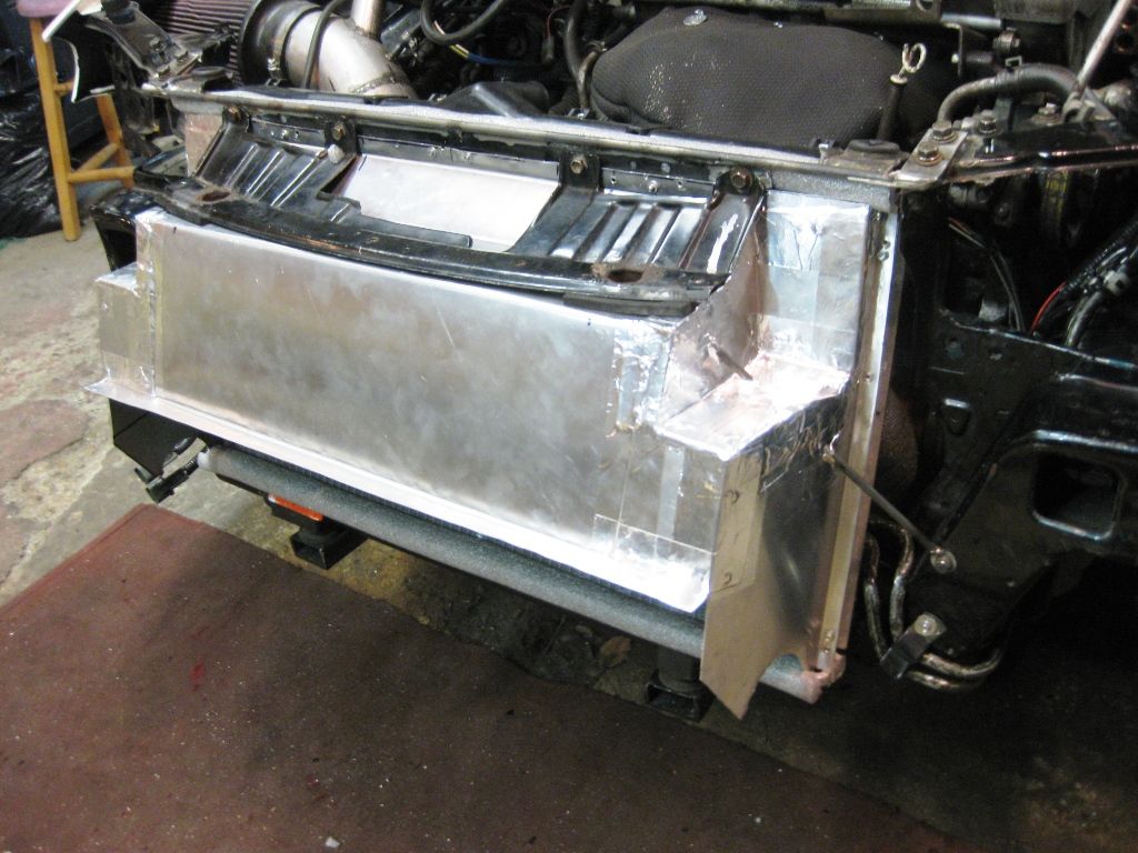

Fans back in with lots of room to flow all that flowieness...

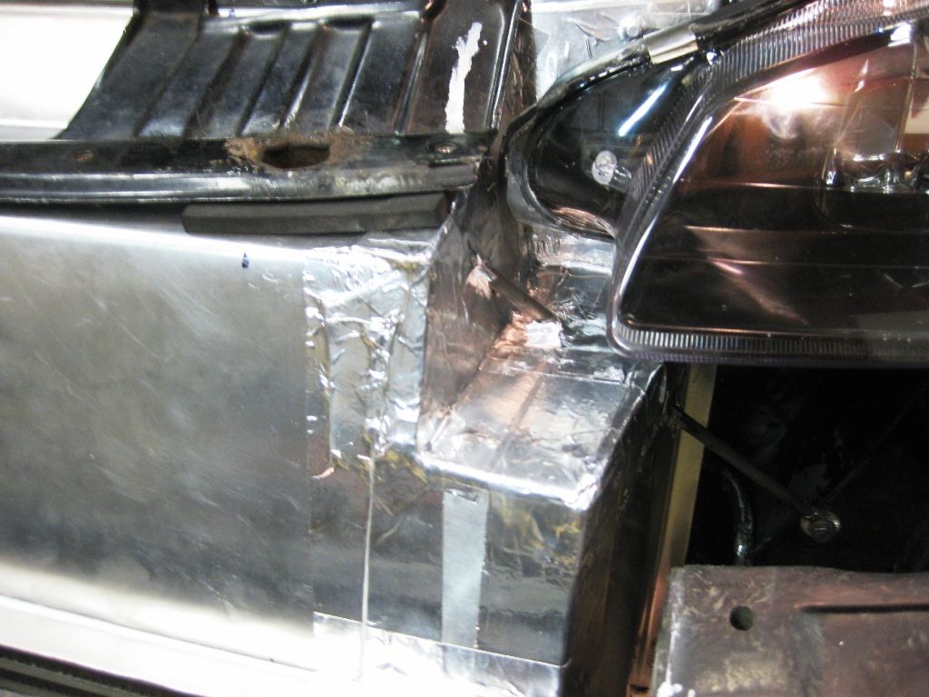

Full ducting looking gooooooooooOOOOOOOOODDD....

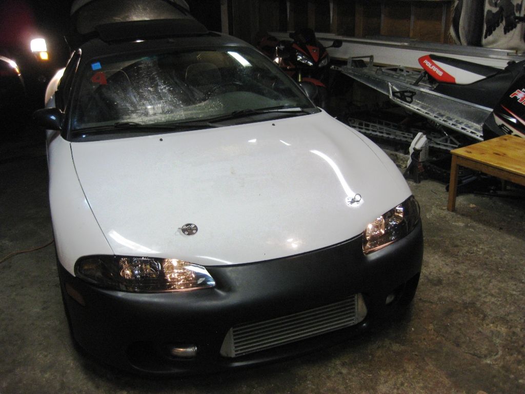

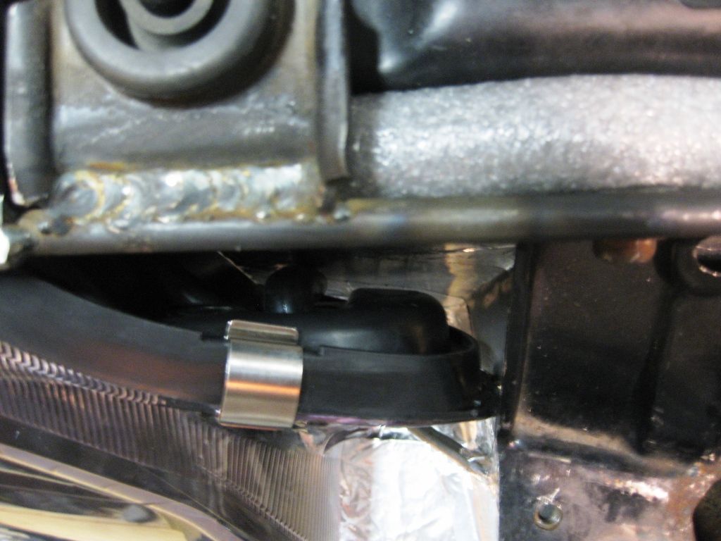

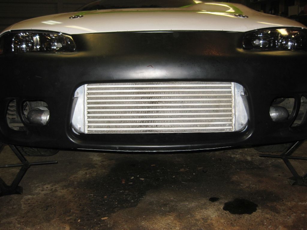

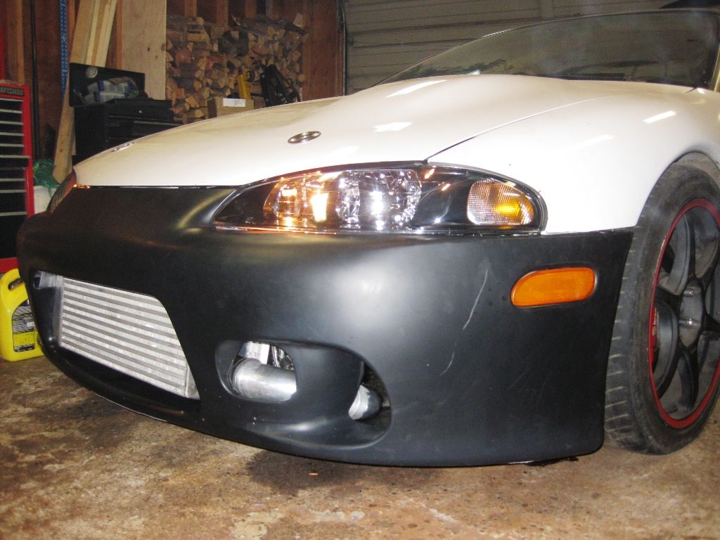

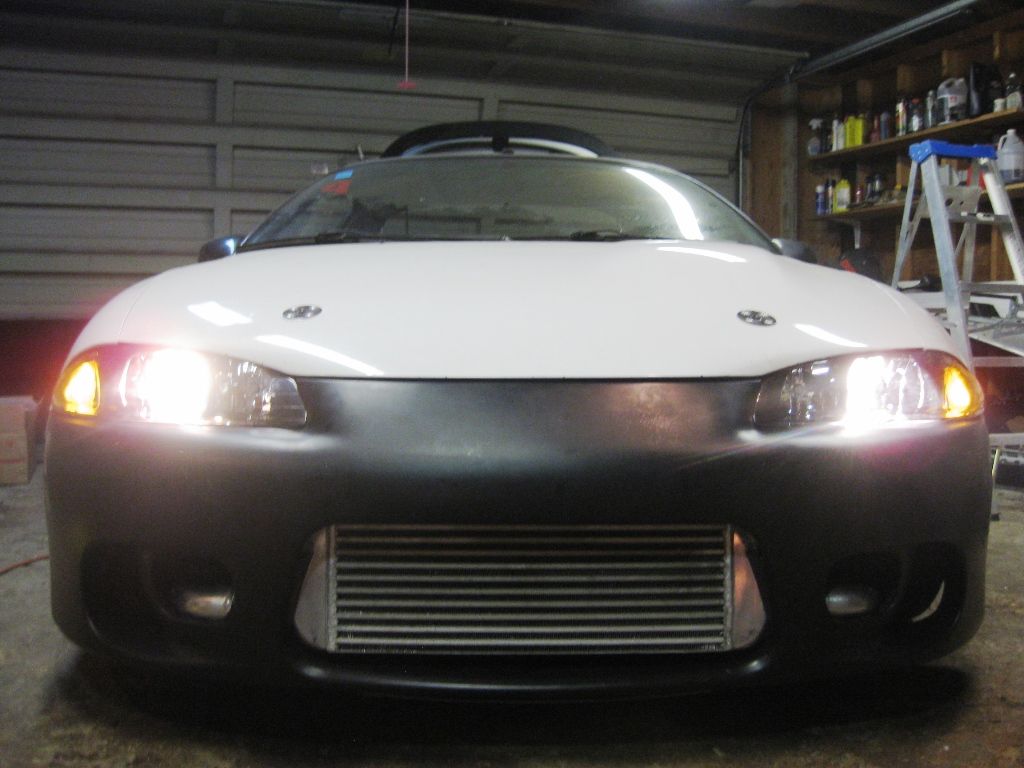

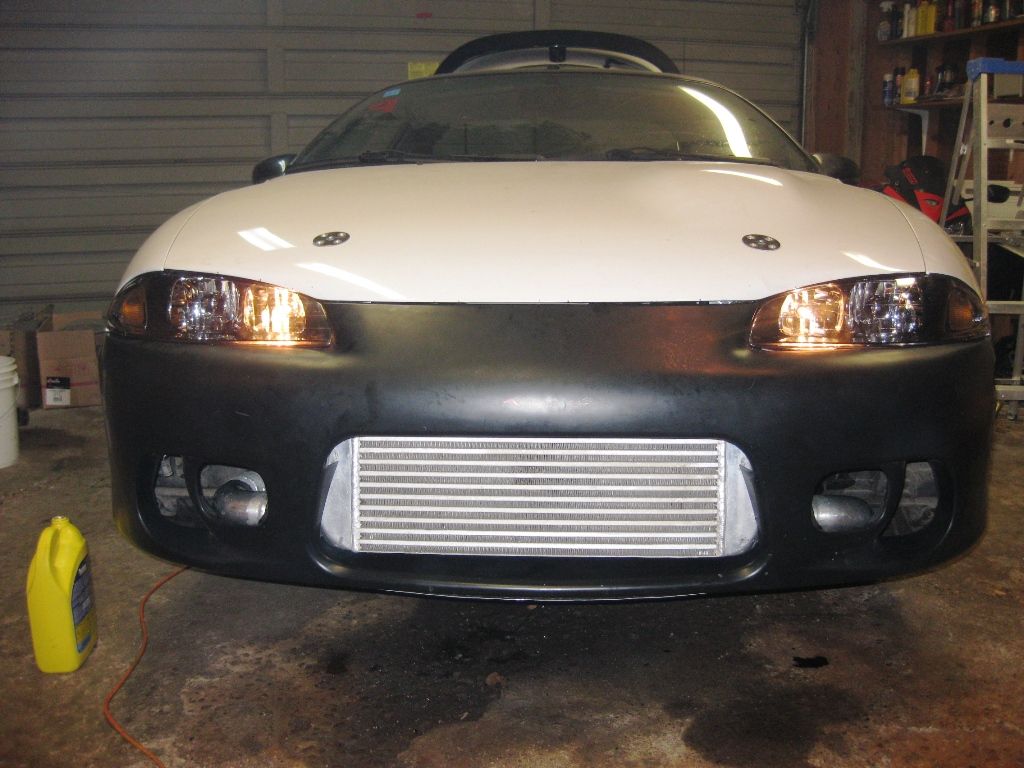

Bumper back in and coped....new 2Gb headlights in as well....
The ducting JUST fits in and behind the headlights. It doesn't look like much but there is a 1 1/8" tall channel in the duct behind the headlight that is about 3" wide by 5" long and seems adequate to flow at least a little airflow.

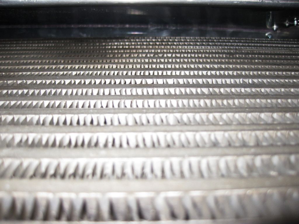

Final upper intercooler gap. Loooooooooots of space for air to move now....

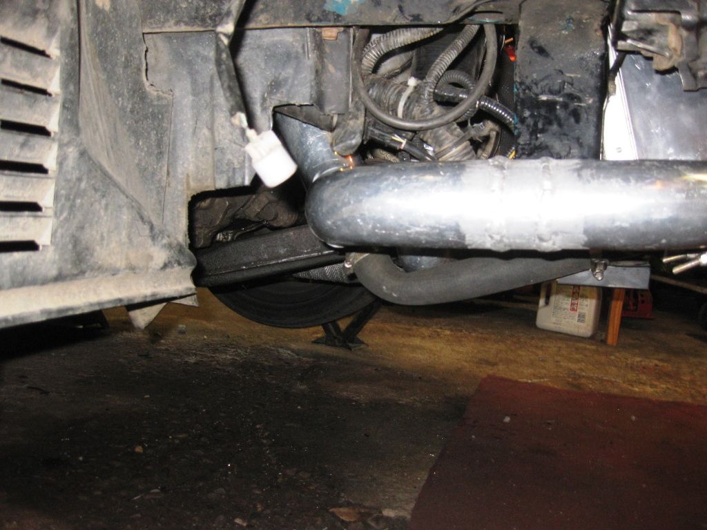

Shiny new undertray....

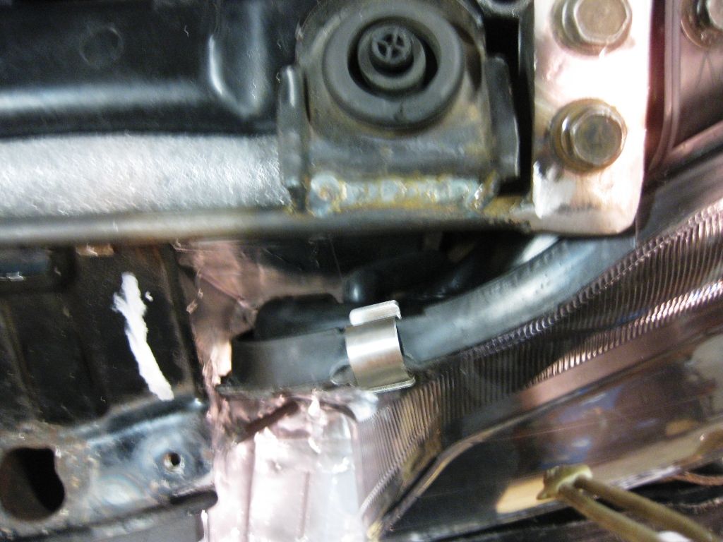

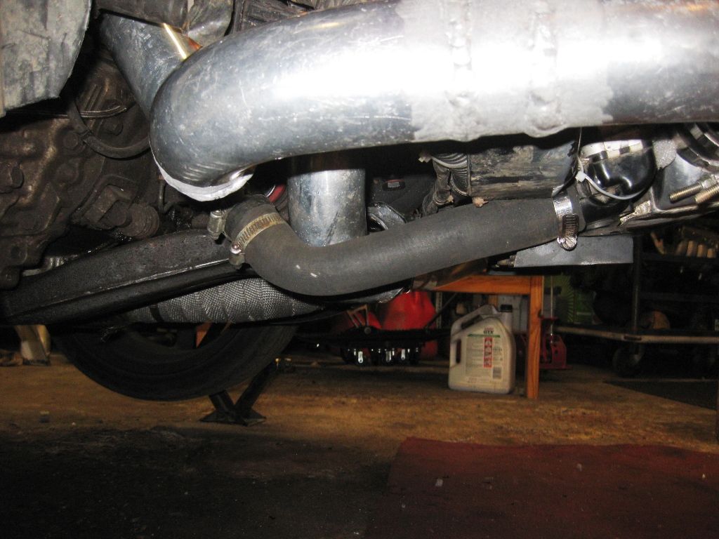

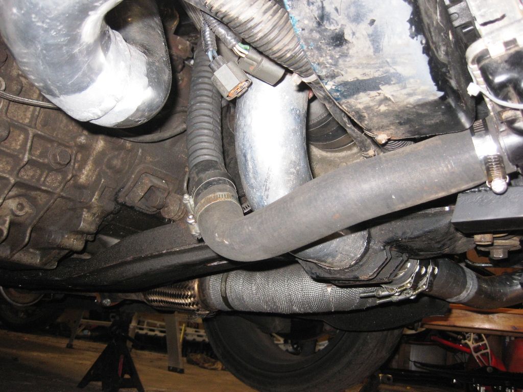

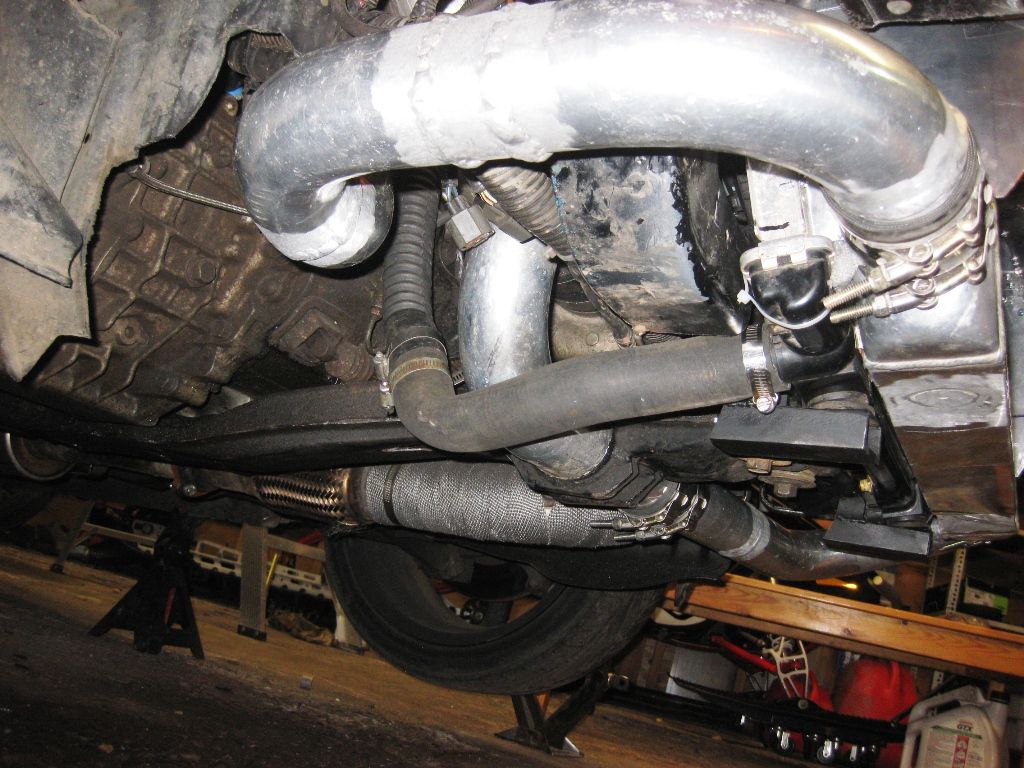

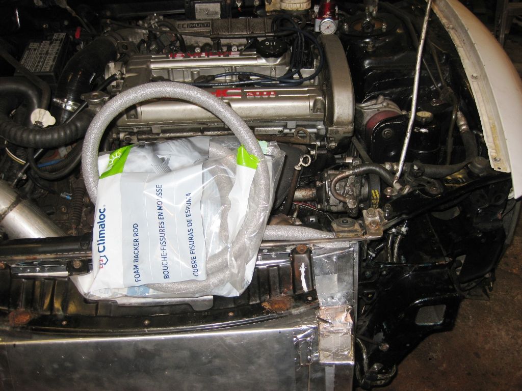

Had to lengthen the lower rad hose a little bit....its just angled right to be just above the lower bumper plane. Shouldn't have any issue with draggin at all. Was a bit worried about this part but in the end worked out perfectly. The pics don't do it justice but it really is up and out of the way.
All bolted up, cleaned up, topped up, and started up. :D

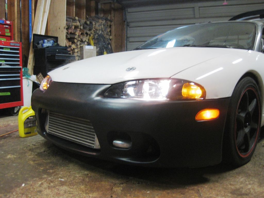

The FINAL results:
HUGE improvement!
My cruising temps were about 108*C and my "20 secs of boosting temps" were a block melting 112-115*. Waaaaaaaay to fcukin hot man. Just sooooooooo hot all the time.
Now I'm at 85-88* cruising and my "boosting like I stole it" for many many many minutes straight.... I didn't see more than 98*. A solid +20*C reduction in cruising temps and NOW I can throw as much WOT as I want at it for as long as I want.
When the fans first came on when I was warming it up, I did the "hand" test with my hand in the opening and it flows a shiiit TOOOON of air now. Before it was anemic compared to now. With your hand up and inside where the opening is up and over the intercooler you can feel the majority of the air going up and over it. If I had to throw a dart at a number I would say 60-70% of the air is moving up and around it with the fans on. At speed who know, but I'd imagine similar.
I was also worried that it would be too far the other way with flow and the intercooler either would be still blocking too much and coolant temps would be too high (which proved to be false thankfully) or it would open it up too much and IAT would start to climb.
Upon testing the coolant temps were very nice now and after many many minutes straight of boosting it around my IAT never rose higher than 28*C. Outside temps were ~22*C so I'd hazard to say the opening is just perfectly sized.
Hood vent addition with ducting makes it work even better I found and keeps temps under hood Cool. Which is another plus plus. The ducting is now creating more pressure under the hood. With my ducting and the hood vent the cruising temps are very consistent nice and cool in 90F plus degrees at idle.I can feel the fans pulling the air through the hood vent also as a result. You will be surprised how much heat gets released especially under boost. A must if you plan on road racing your car.

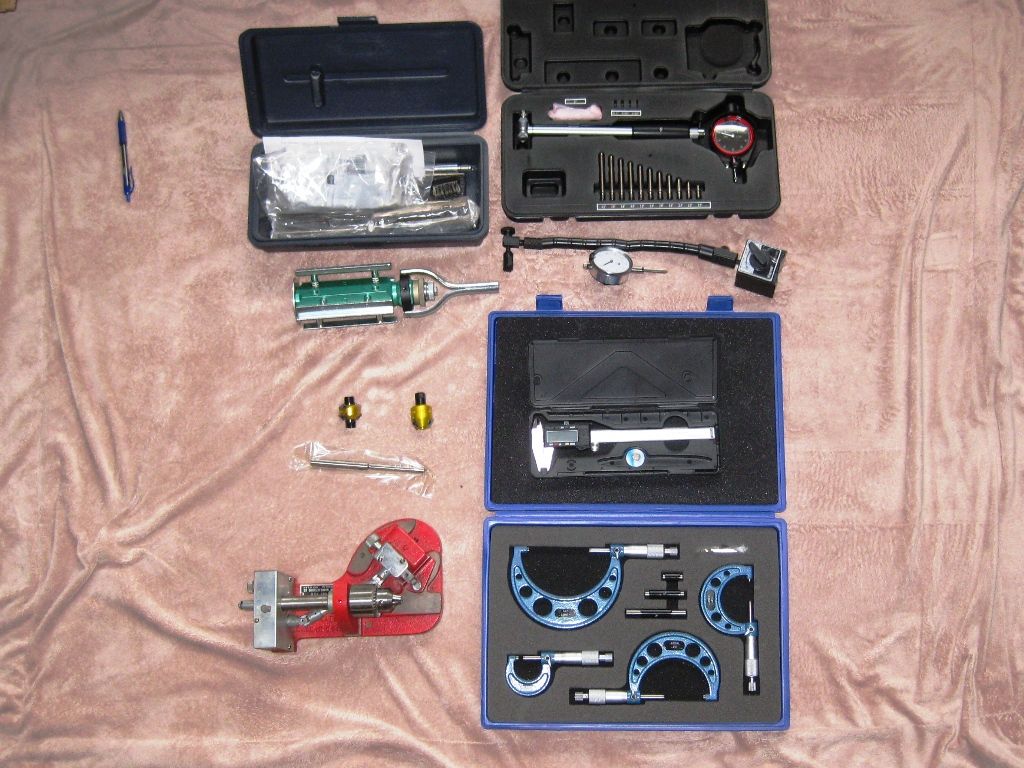

Got the rest of my measuring tools today. I am now ready to tear the motor down....which begins as soon as I'm caffeinated here. So. fcuking. pumped. :D
Also picked up an old school (1975) valve hand lathe (for 90% off) and some Neway valve seat cutters. I did a LOT of research on doing your own valve job and TBH I don't think its rocket surgery so I am going to try and do a FULL DIY valve job. From what I have read on the vintage bike, vintage car, motorcross, and sledding/ATV forums....there are a lot of folks out there who have be doing their valves themselves for decades. While I was looking into the DIY valve job what sold me on it was the ability to control my seat width and also the back cut on the valve. From what I could gather, most machine shops have a "3 angle" cutter that is setup already so if you wanted a custom valve seat width they could do it but $$$. Since it is (apparently) quite common to do your own valves and I get better control of the outcome I said fcuk it lets give it a go.
While I was on the aforementioned forums, I stumbled across a thread where they were talking about using a cylinder hone stone (lisle 150000 style) for DIY honing and a several guys were boring over 0.020. Looking into it more, I found it again quite common in the vintage car/bike/sled circles. I'm skeptical of how well it will turn out but for the prices of the hone and 5 sets of stones @ $190 I again said fcuk it lets give it a go. I have the tools to measure it all in the end so we'll see how that turns out.
