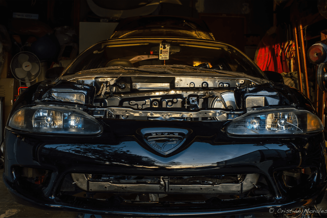

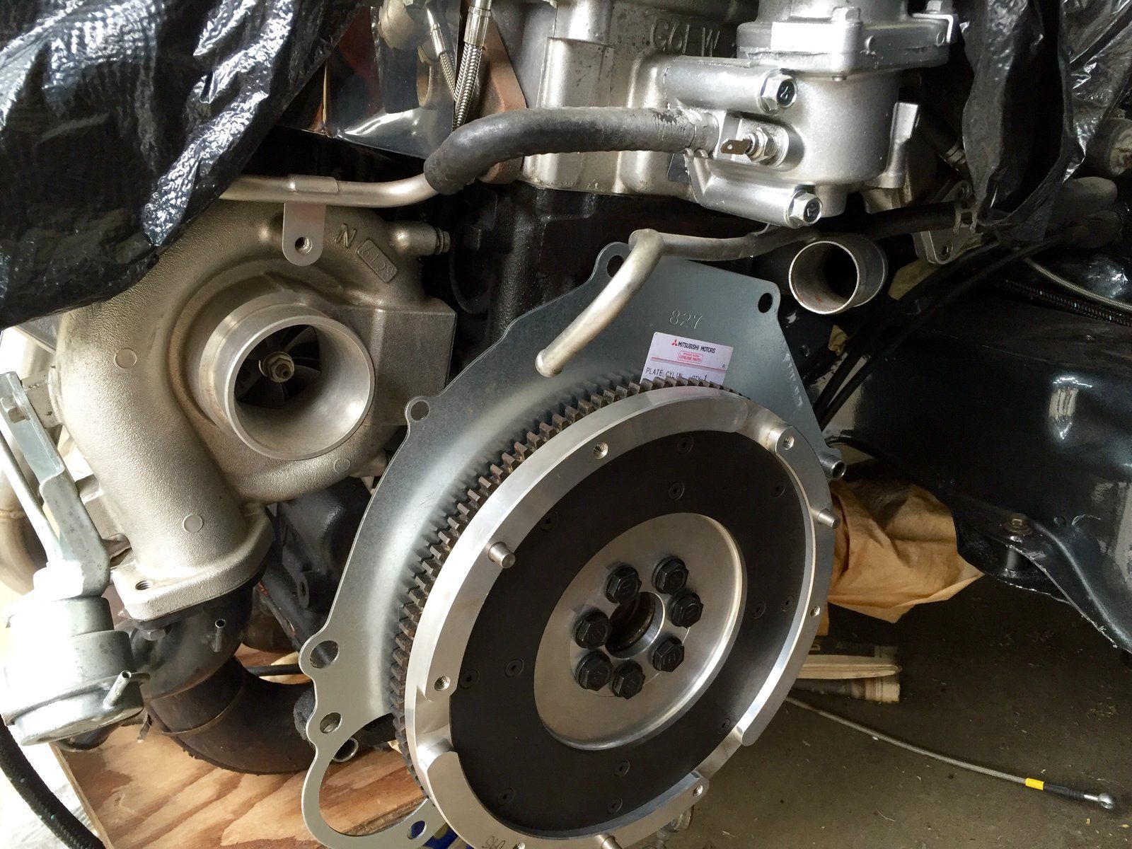

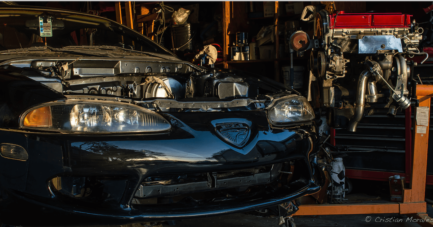

I haven't been here in a while so here goes nothing. Talon is in the garage, thanks to another dsm buddy who helped get her inside. Engine will be going in soon, maybe in a week or two. I want to finish up the engine bay with new ss brake lines. Remember I'm not made of money so this takes time.

It's nice and clean man, got to say I admire all the detail on this build, you clearly put in the effort here:thumb:.
I wish one day my dsm could be half as clean. :rolleyes:oh well keeping my eye on the prize will keep me on the right path for now, if nothing else, threads like this are good motivation to tackle my own little projects always a pleasure to see updates on this man:thumb:.
Thanks man! i appreciate the positive input. There shall be big update in a week or two. I just ordered some more parts that i wasn't going to until next month.

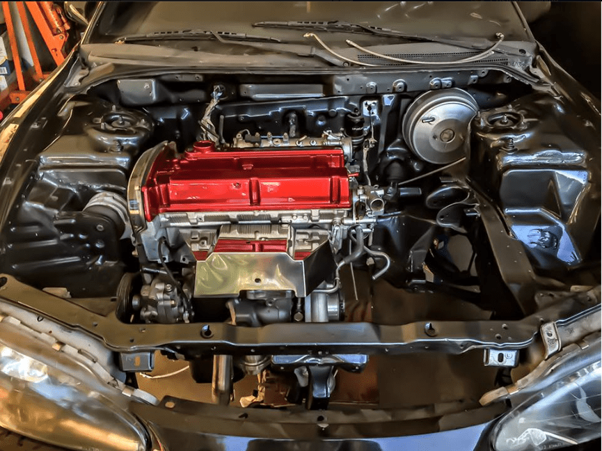

You don't understand how long I have been waiting for this. Wow! That looks spectacular, please post a bunch of pictures of different angles. Please go into detail as well. Phenomenal job man congrats!
What ecu are you going to run? I know most evo guys just run the stock ecu and get a 1.3 tactrix cable with tephramod or something.
