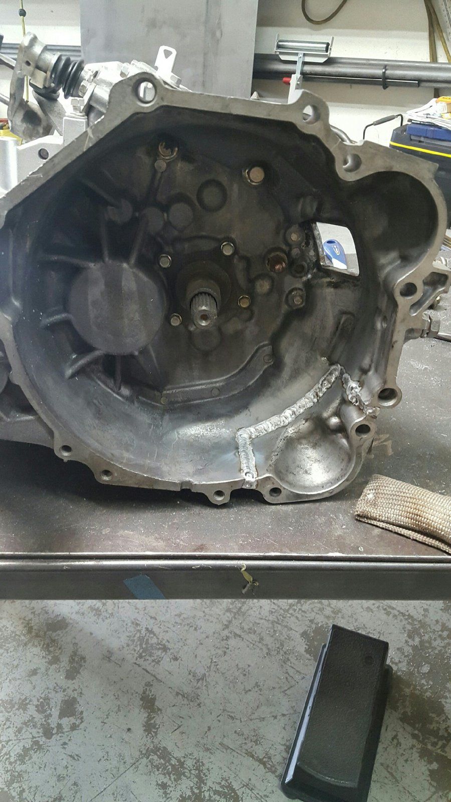

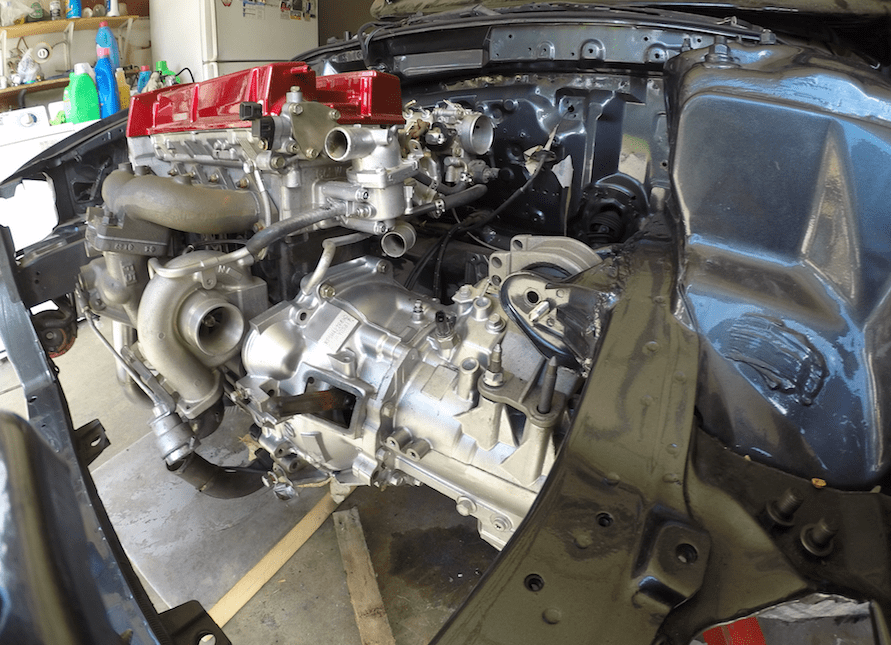

When you find an evo 8 transmission for $50. There's a crack on it. I just need it to change the starter mounting points on my 3g trans

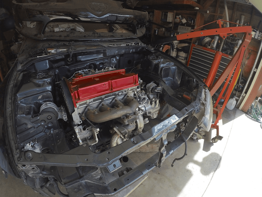

WOW! What an awesome build, man! Your car is super clean; like it just came off the assembly line! Subscribed!
I know in the begining you were meet w/ some resistance, but just realize there opinion counts as much as fly's shit worth on a scale. I am glad to see NOT just another DSM build. Refreshing and worth watching .... I do have one question concerning the trans choice, was it chose out of easy of the swap or is it more along the lines of doing something a little different ..
I know in the begining you were meet w/ some resistance, but just realize there opinion counts as much as fly's sh** worth on a scale. I am glad to see NOT just another DSM build. Refreshing and worth watching .... I do have one question concerning the trans choice, was it chose out of easy of the swap or is it more along the lines of doing something a little different ..
I went with the 3g trans just because it would be less expenisve. Remember a working evo 8/9 trans range from $600-2,000 dollars plus the transfer case which is another $1k. Maybe if i run into another evo 8 trans that is cracked at a different point i'll save it and swap it in. In the mean time.. looking for a tig welder in LA area. RRE already directed me to a shop but I'm open to different locations rn.
Had to revive my old Dsmtuners account to get in here and help out with the swap progress!

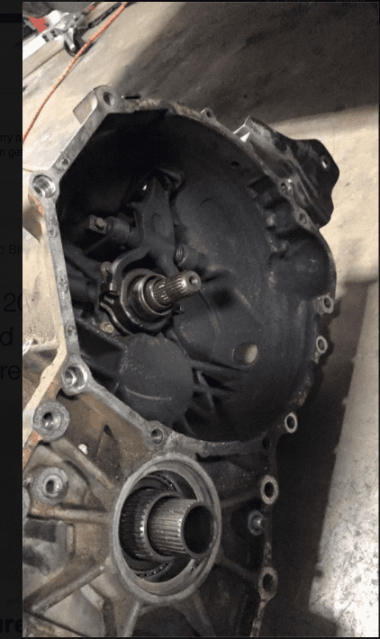

Tranmission mount location will need to be moved up around 6" forward for the 3g transmission to fit accordingly. The other three mounts fit with the 420a motor mounts.
As far as clearing the starter, 3g guys have been working around it for years. You can do what Cristian is doing and mess with the housing or you can get an RRE 1/2' manifold spacer and have it milled down to angle the turbo. Keep in mind you will need extended studs (2g extended studs work fine) to have enough room for the spacer to fit.

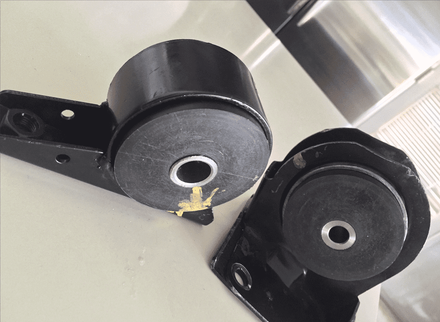

Poly mounts have been ordered.

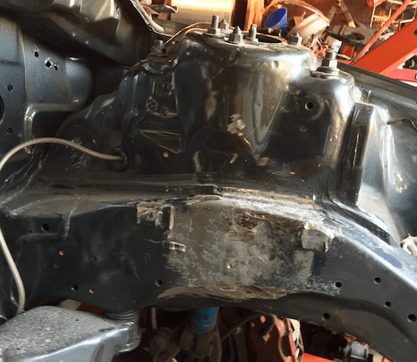

Just waiting for the poly mounts to get here to weld up the bracket and paint the bay again.
Looks like your getting this project going again man, If someone were to do this swap I think the best advice would be to tell swap guys/gals to get an evo 7-9 half cut from a jdm parts supplier, with the full engine harness ecu, motor trans, axles, rear end, etc you'd have the majority of the swap right there only problem is [for most cheep skates] they cost anywhere from $1500-$5000 of course another option is to find a salvaged evo, but both options would give you most of the swap parts needed.
of course if you slowly part it together, you may end up hitting evo part-outs to find other obscure bits but that takes time out of your swap I guess LOL
Glad you didnt let the idiots in the beggining get you down... Even back when you started this, a quick google search would have showed them the evo 4g63 fits very nicely in the 420a engine bay... If I ever find a nice 5 speed 420a 2gb talon, Ima buy it, just to do a swap like this.

poly mounts have been pressed in and i can finally mess with alignment of the engine/trans.
