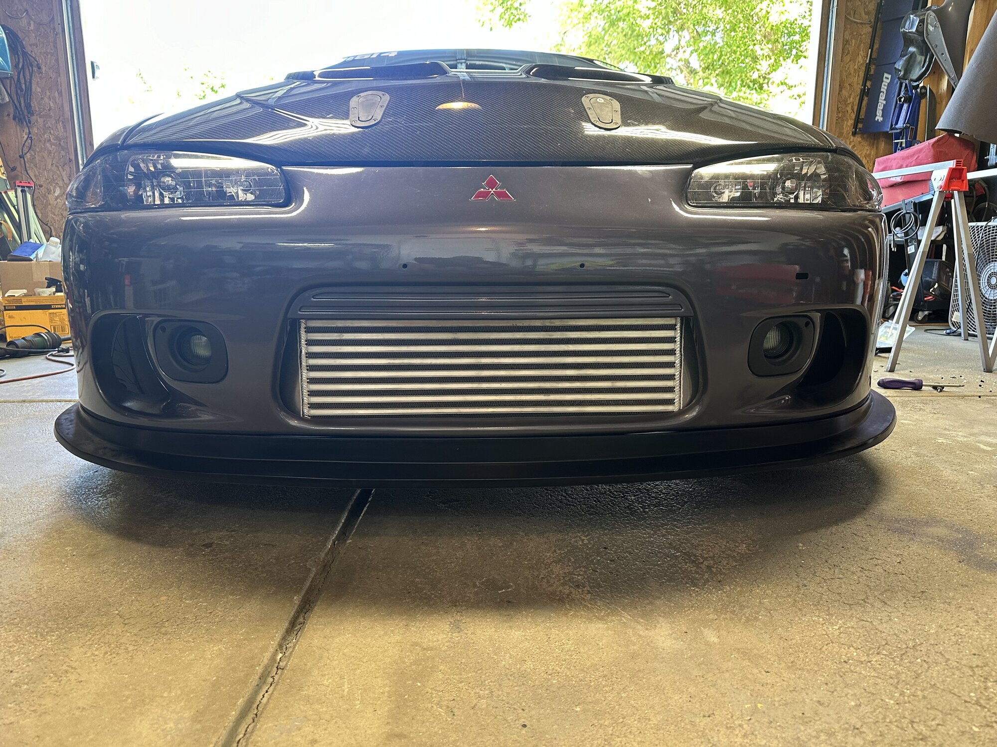

Small update, I was not able to get the lip on in time for shootout and finally got it on today. Took a few to decompress from the race and now starting to work on little things here and there. Still need to put more miles on the clutch but that will come soon. For now just did the lip and re-treated the vent box filter.
Debating on cutting the rest of the bumper out in the front for the large front mount. More to come soon.

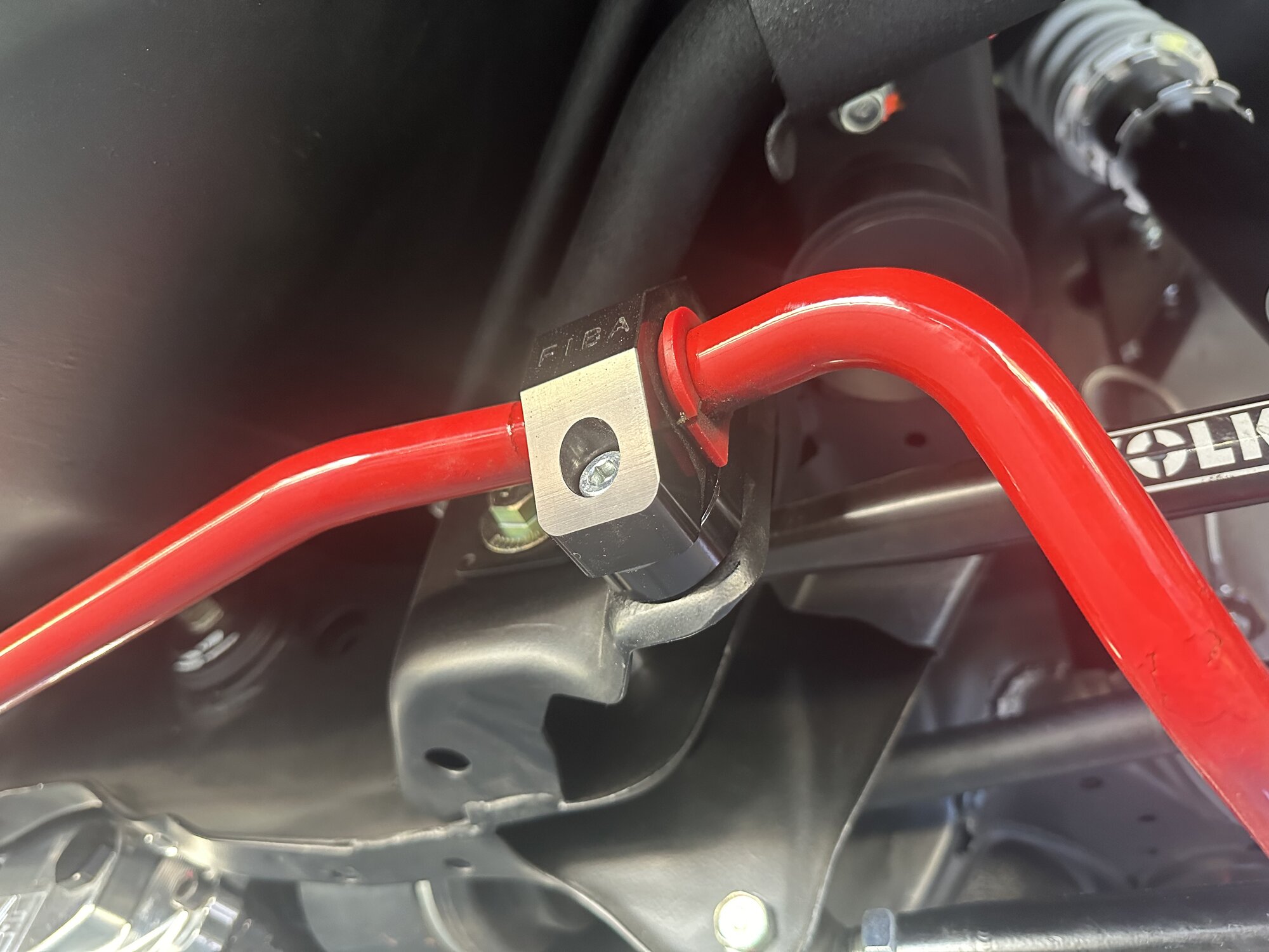

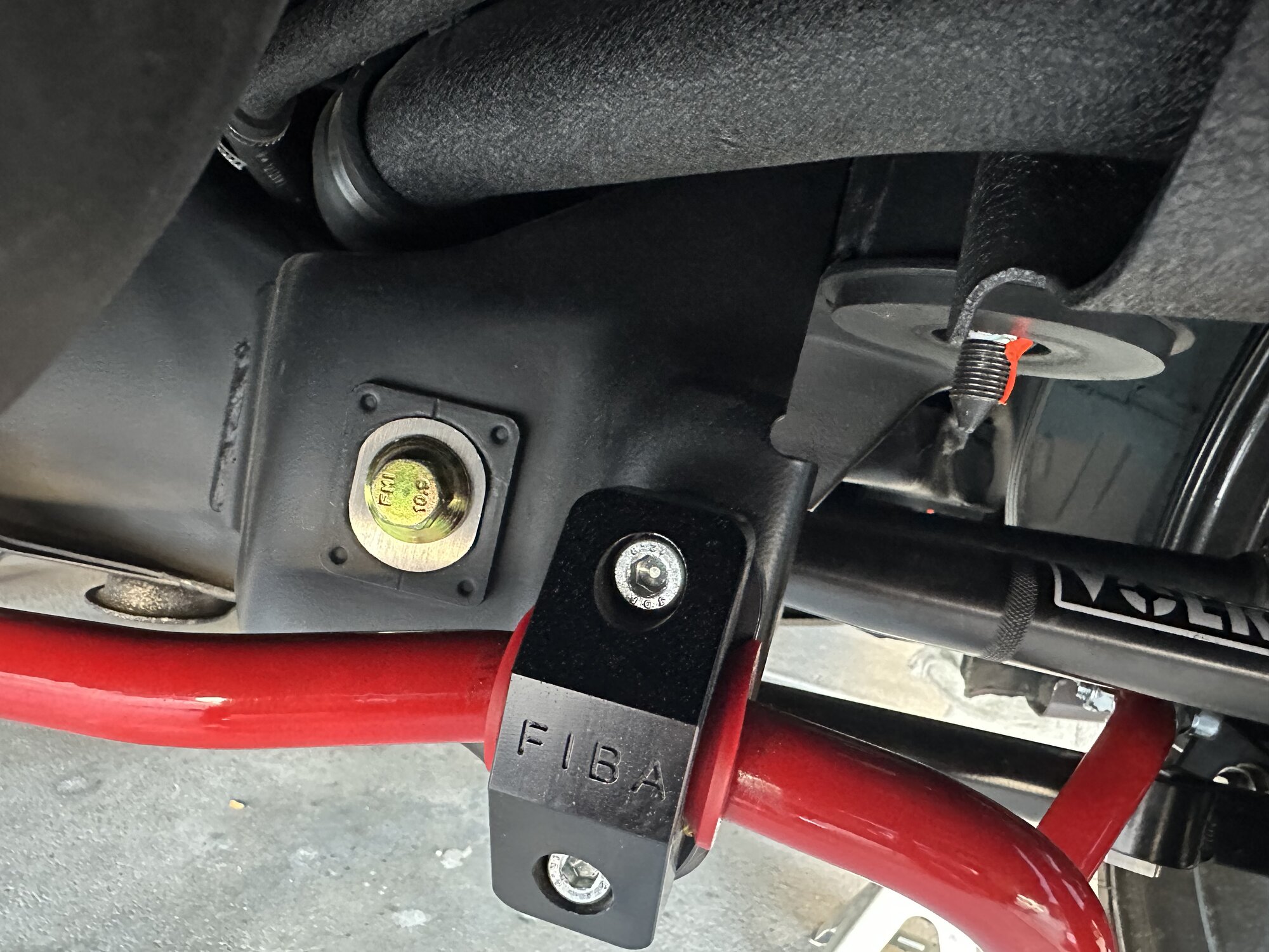

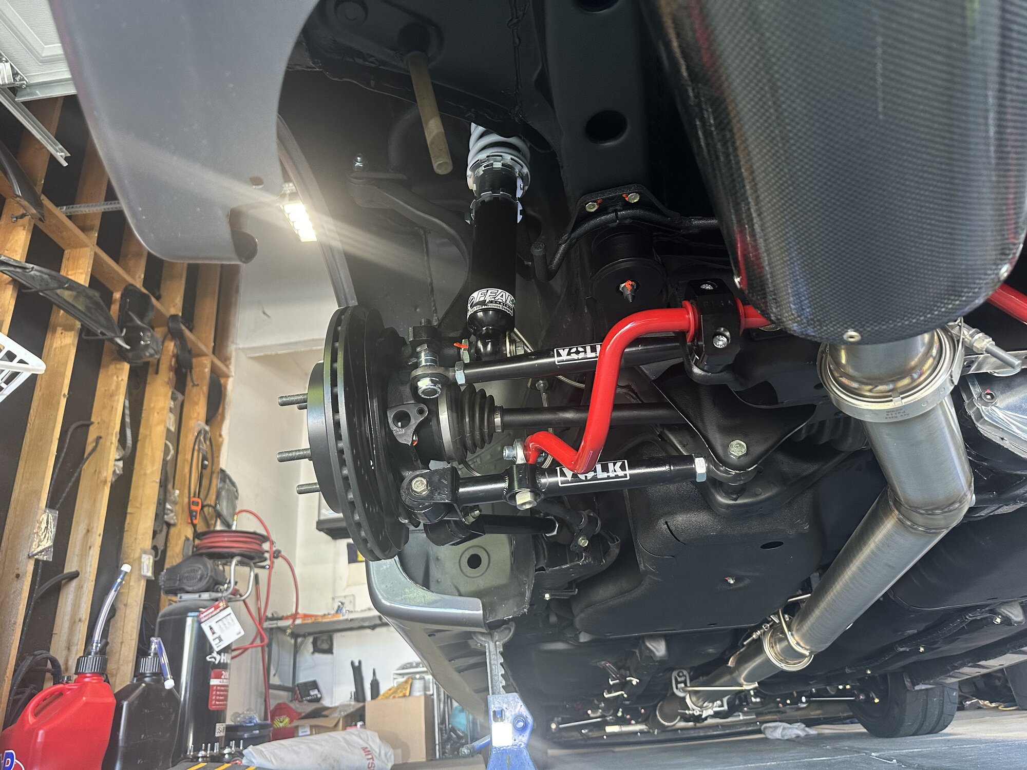

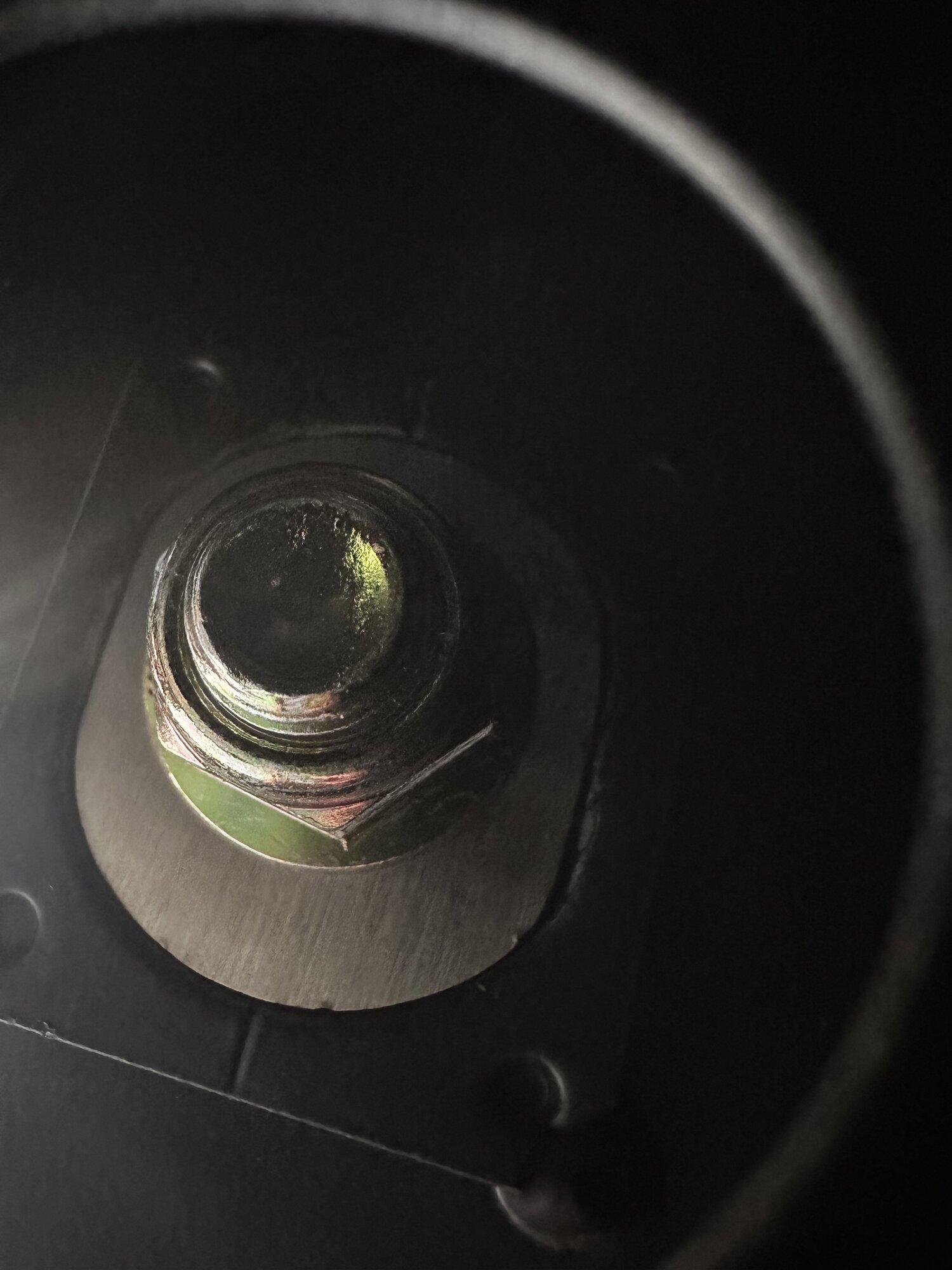

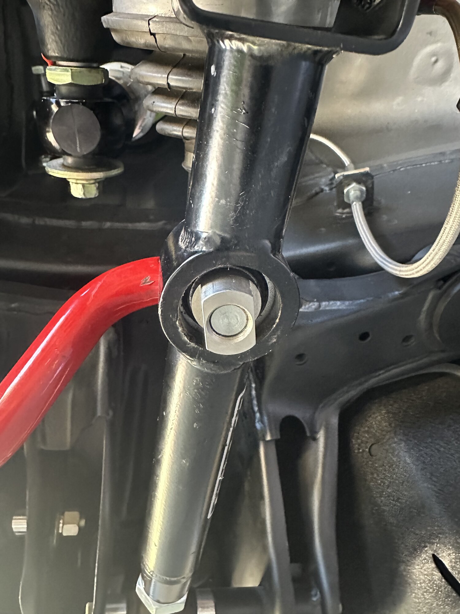

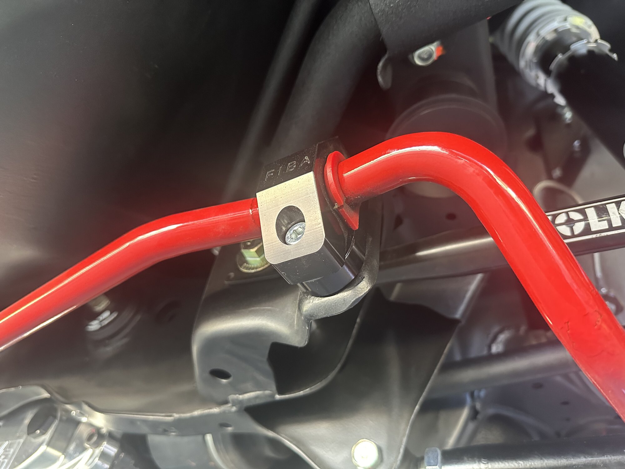

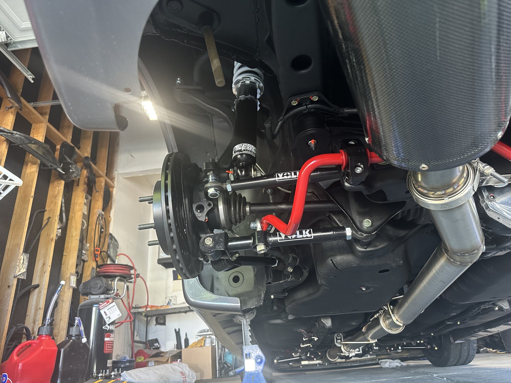

More “small” things here and there. Got the new volk metalcraft sway bar spacers installed so the sway bar fits straight in the toe arm. Also got the dss rear axles and upgraded hubs installed finally.

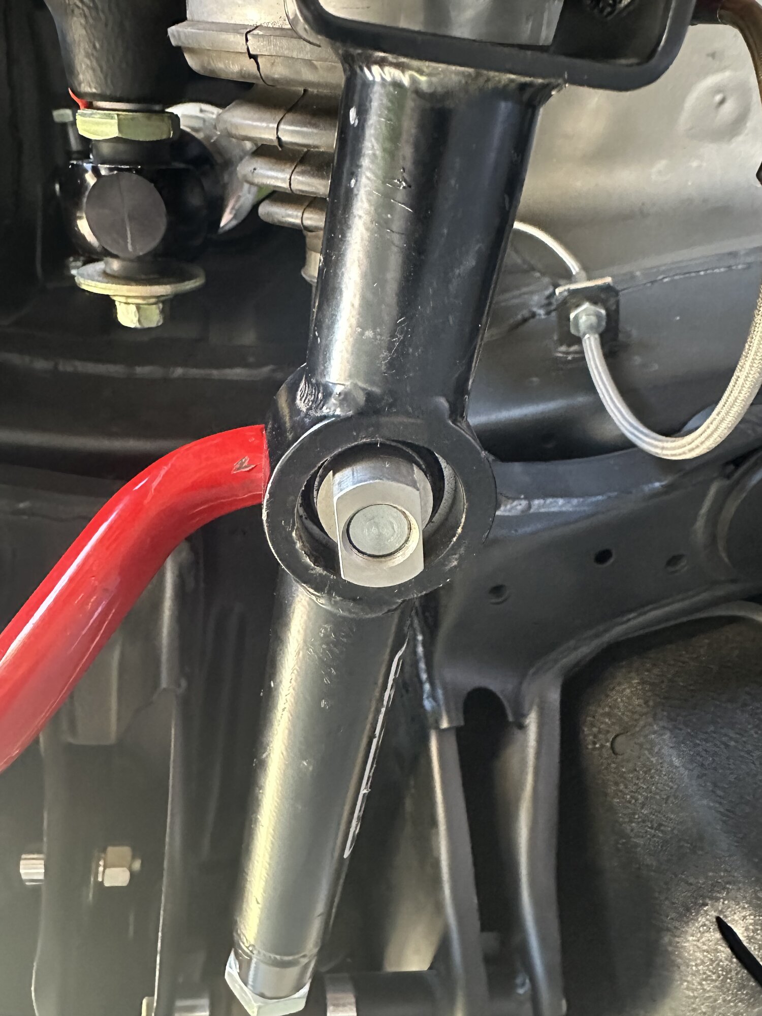

So with the move and bad weather I have not really been able to do much on the car. Finally got around to installing the toe lock bolts/brackets in preparation for a professional suspension tune. Buuuut then it snowed its butt off again so she is still stored in the garage. Hoping to knock out the new clutch once the move is finished and the weather breaks. Move to come soon.

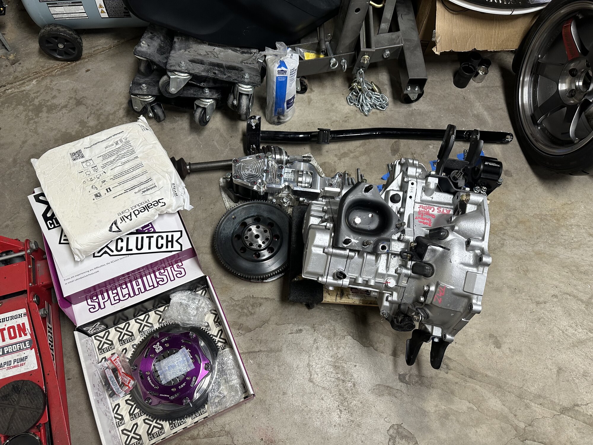

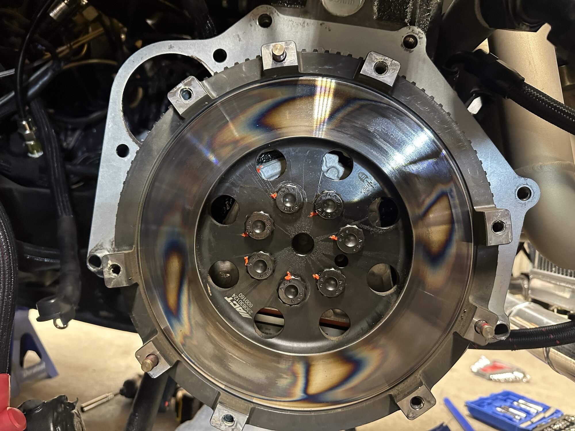

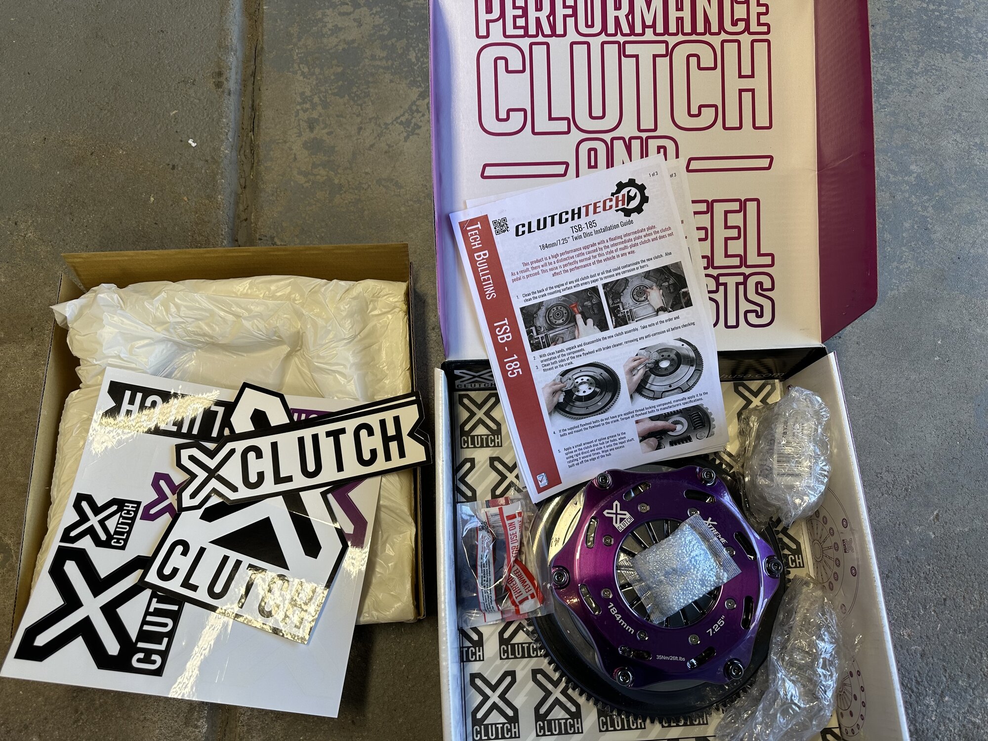

Biggest change was swapping out the clutch/flywheel. Found why I was still slipping above 7-8k rpm that’s for sure.
Think it got hot?

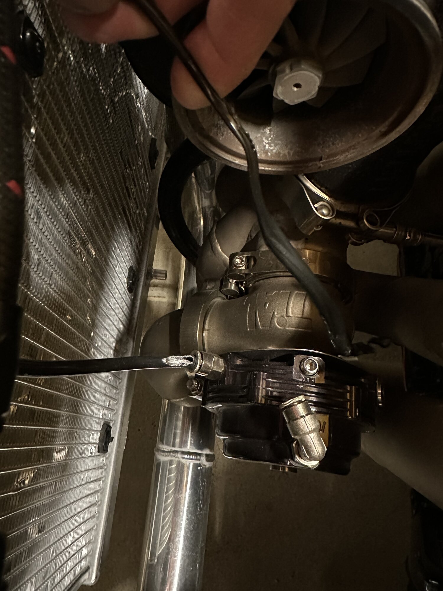

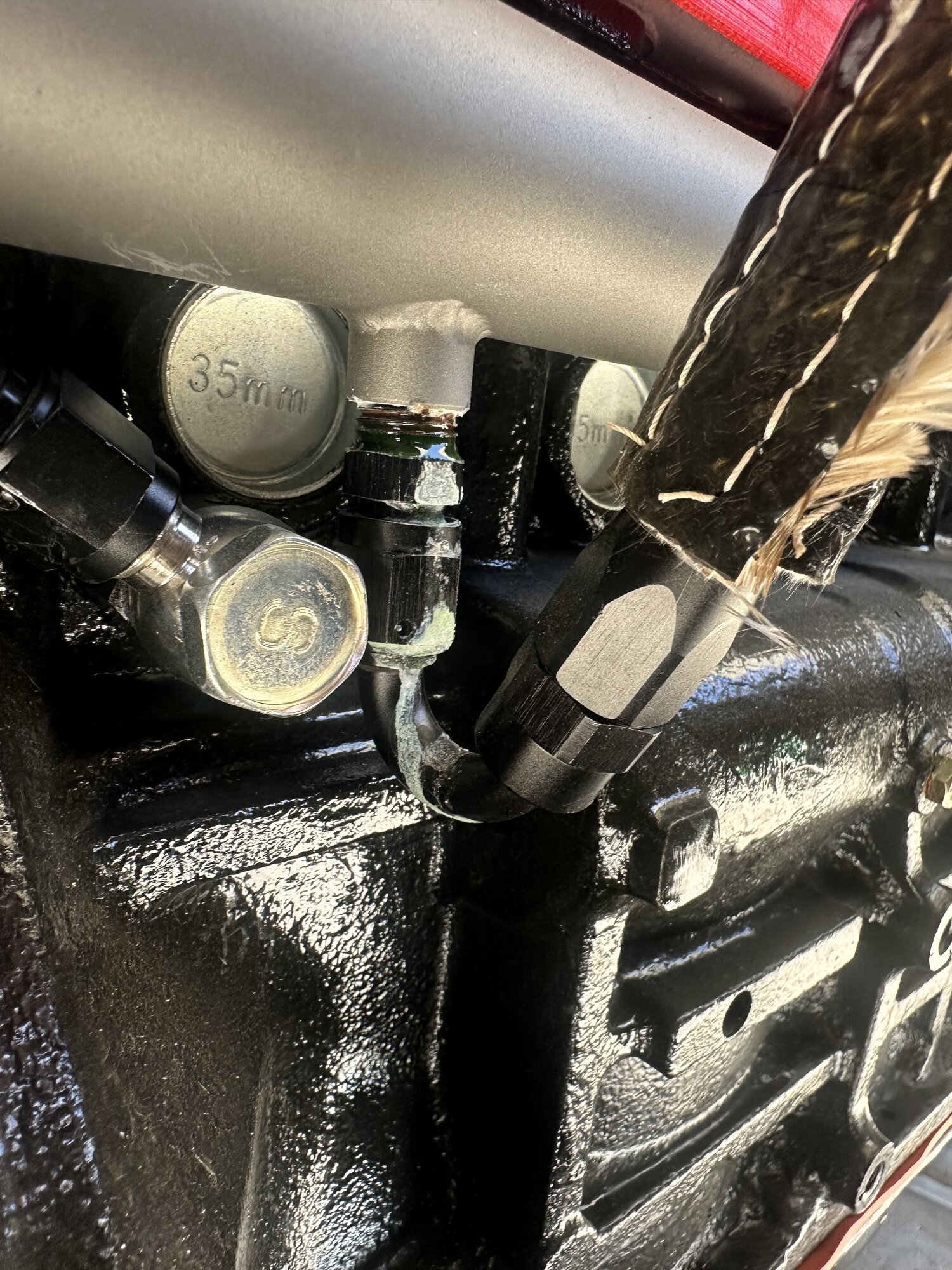

Also, found why I was not able to boost past 27ish psi which is gate pressure.. so ordered all AN line and fittings to heat sleeve as well.
One line is burned through and the one in my hand is gate pressure and it’s not even connected and burned all the way to a shriveled little guy.
ALSO, while everything was off found this tiny leak that never dropped but was still leaking. SLOWLY working out all the little things from a new build, but realized I brought a total turd to shootout last year hahaha.

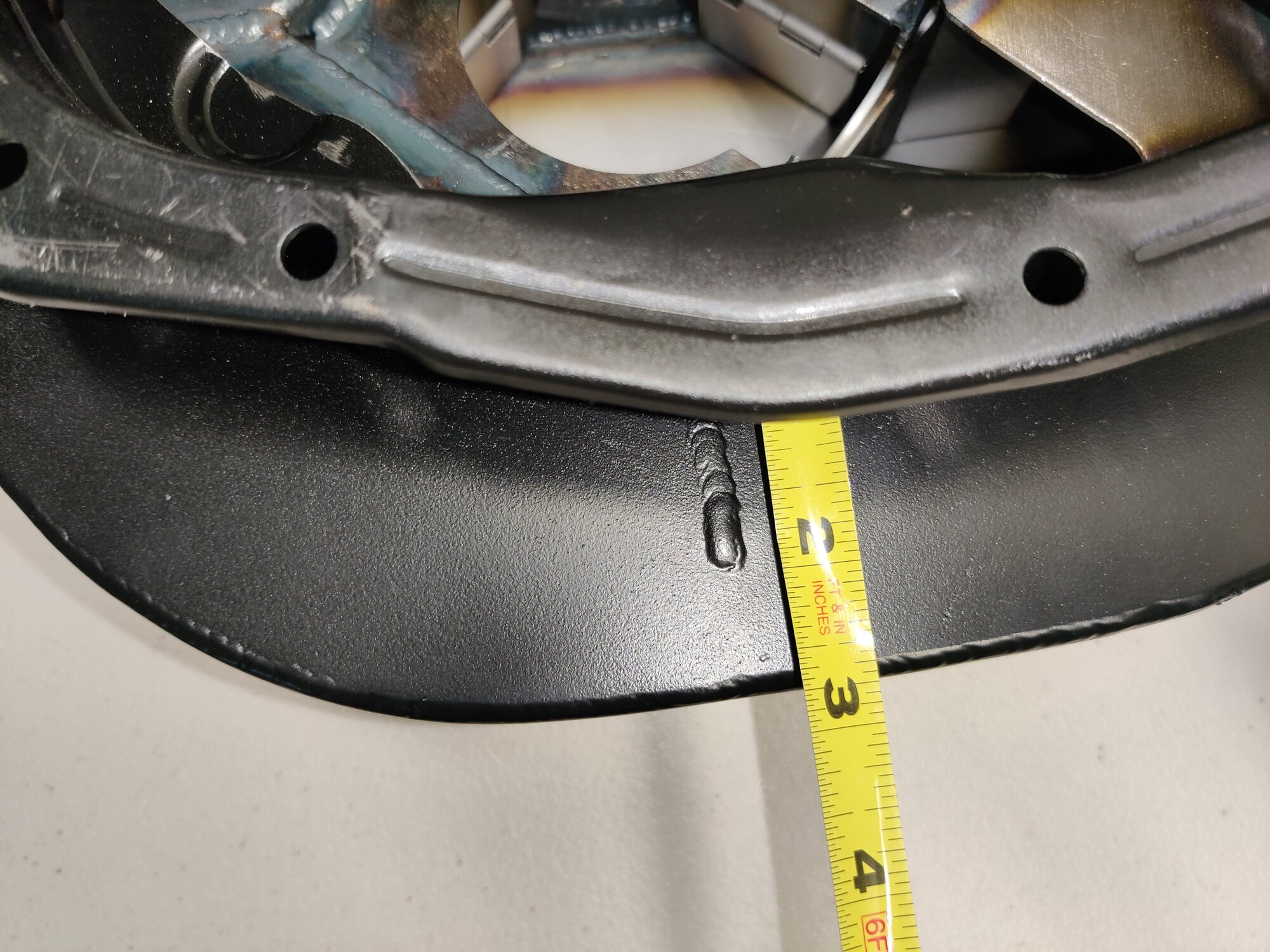

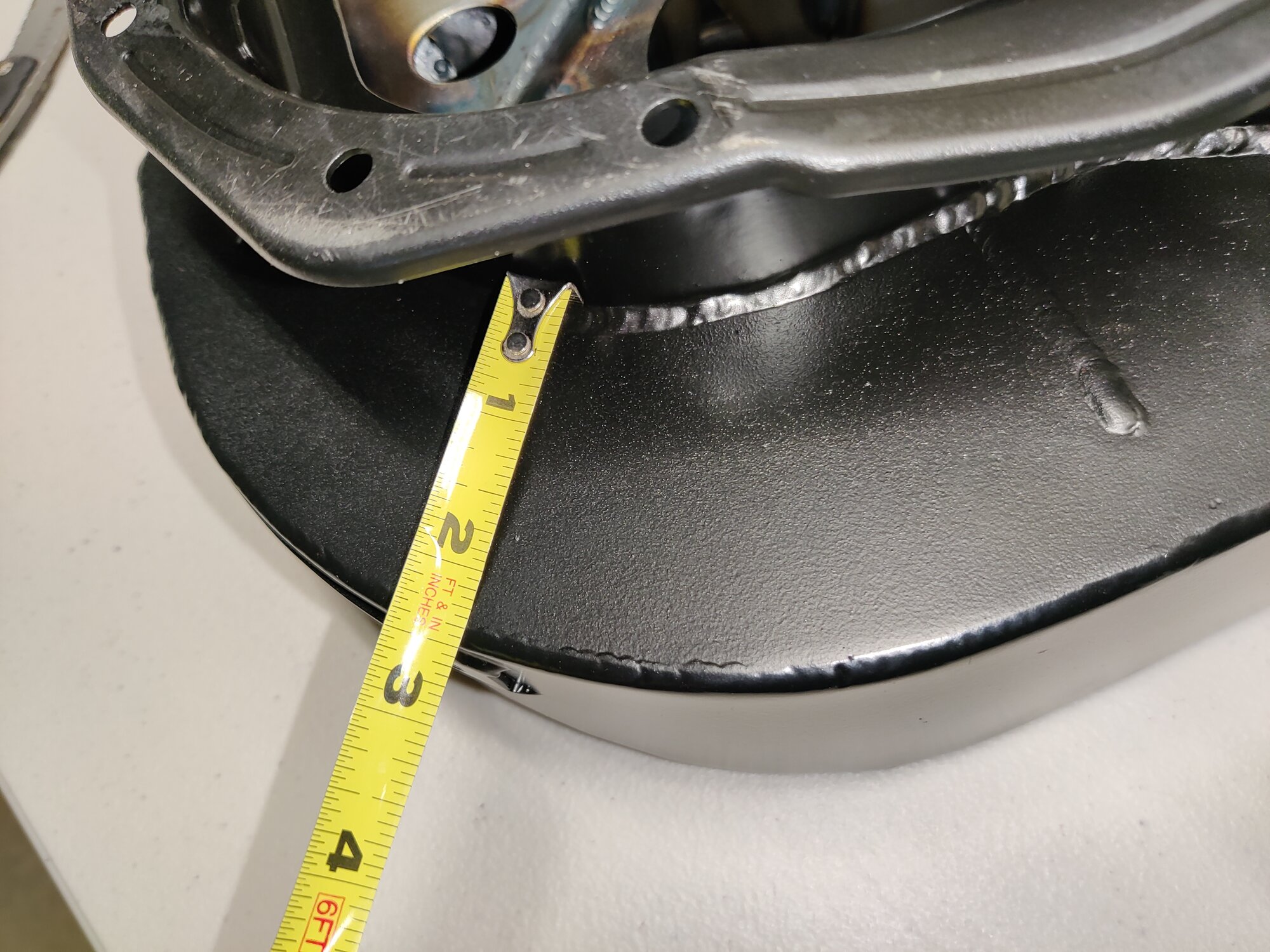

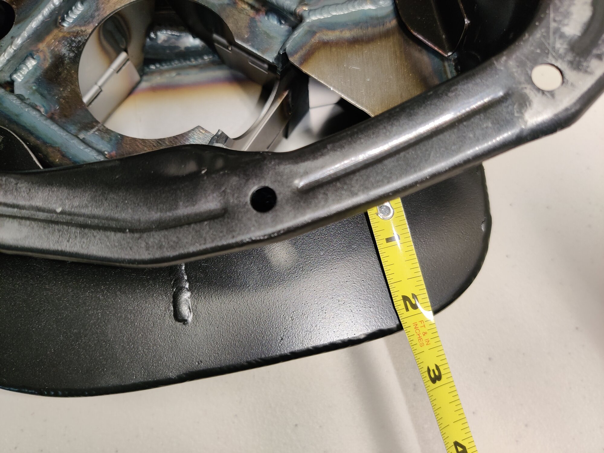

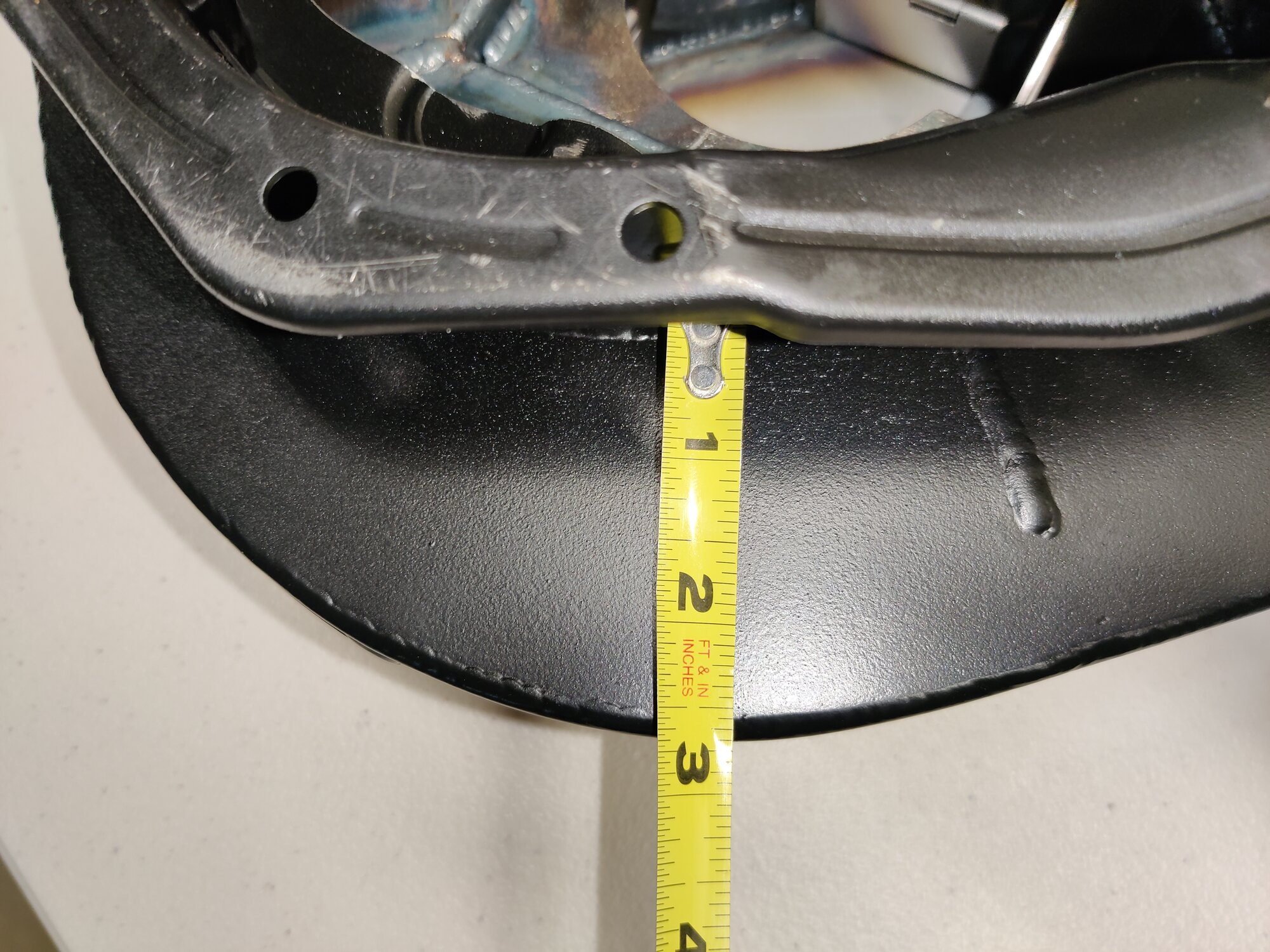

Nice. Can you do me a favor if possible? Can you measure the distance from the oil pan to the filter for me if possible? Trying to see if that filter housing will clear my Racefab pan. Thank you.
Sorry I missed this post! Yeah I will 100% get you a measurement tonight after work.
So from the closest part (the hump) of the oil pan to the edge of the oil filter is approx 2.5". Hope this helps man.
Yes, thank you. I don't think it's gonna fit unfortunately. Damn it.

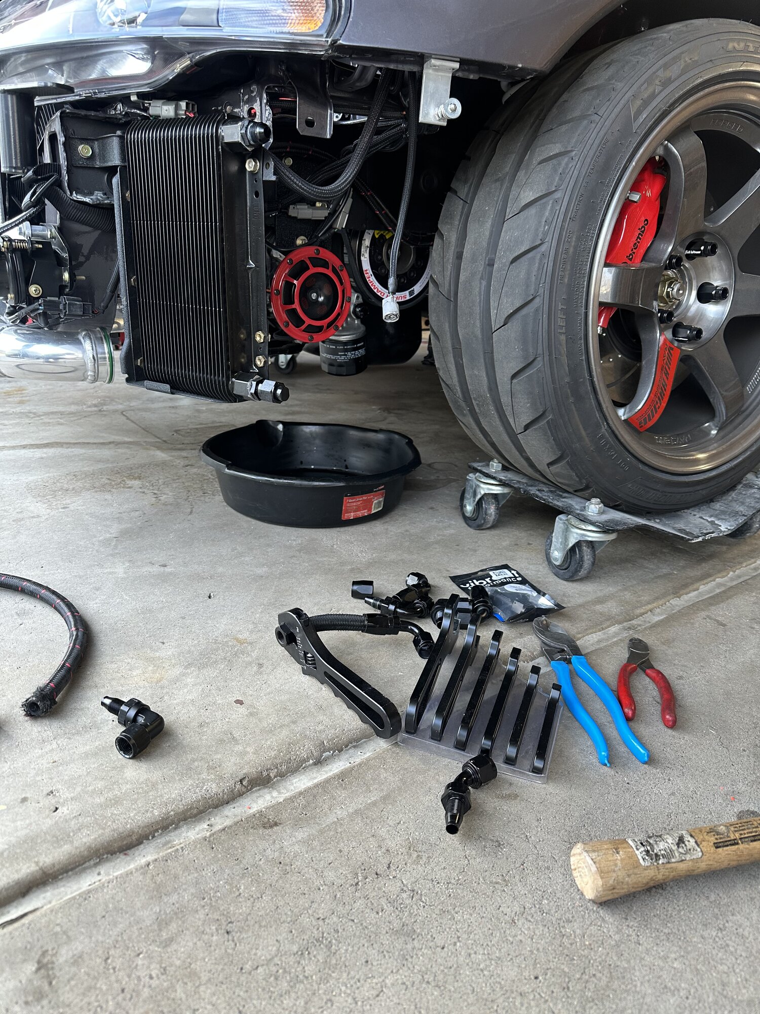

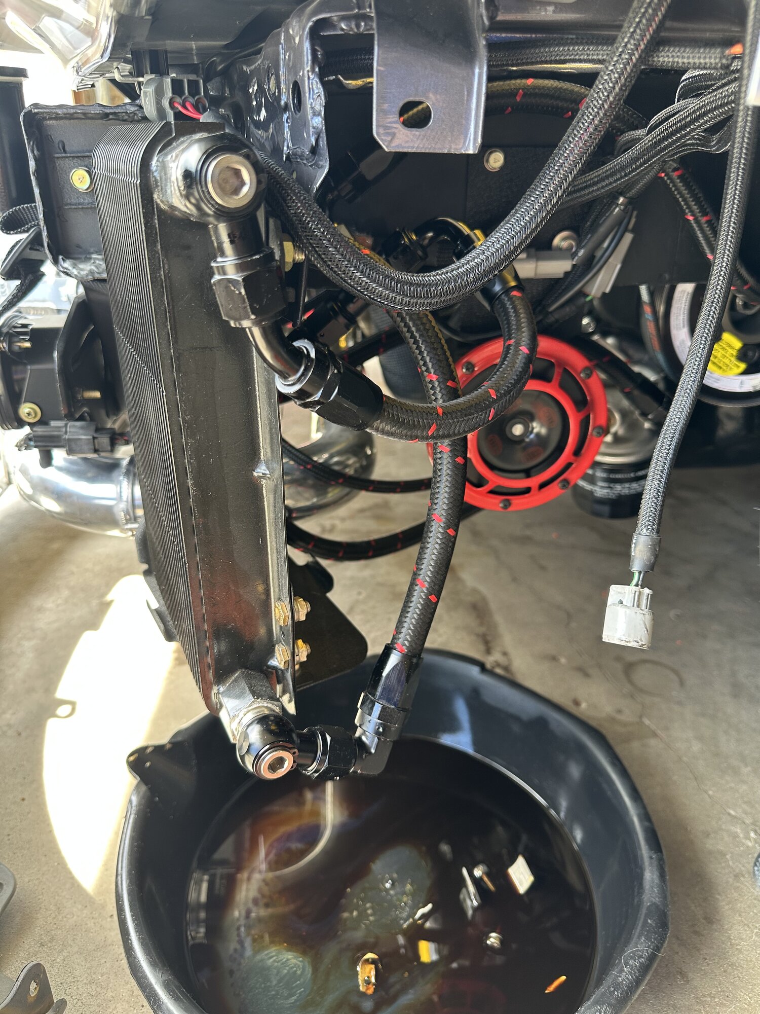

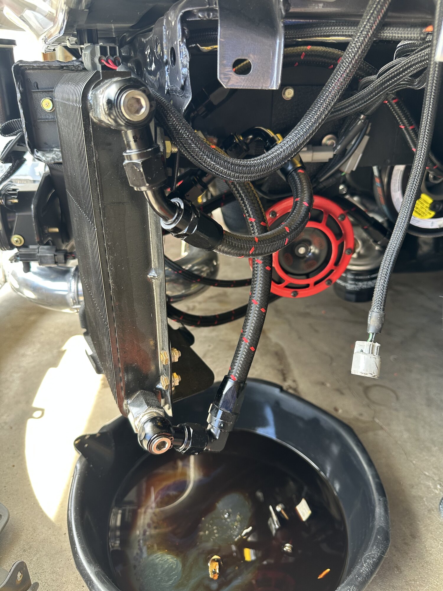

Well, it’s been a slow summer for updates but have finally been finishing up small things here and there I have been putting off. Changed the oil for the third time on the break in and tied in the oil cooler and accumulator. Not excited about having to use 8qts for every oil change now, but hoping the accumulator does it job and never have an oil pressure issue.

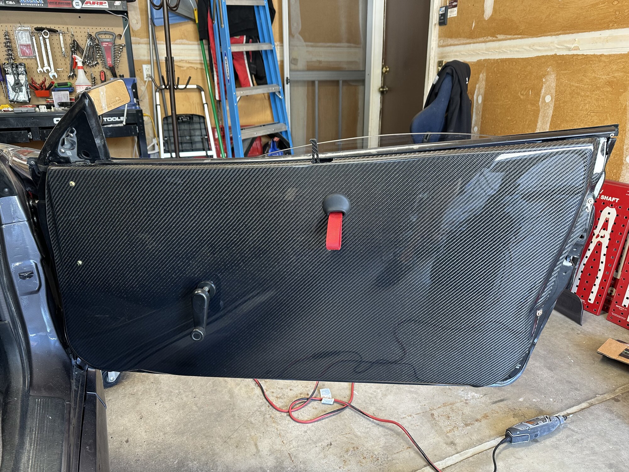

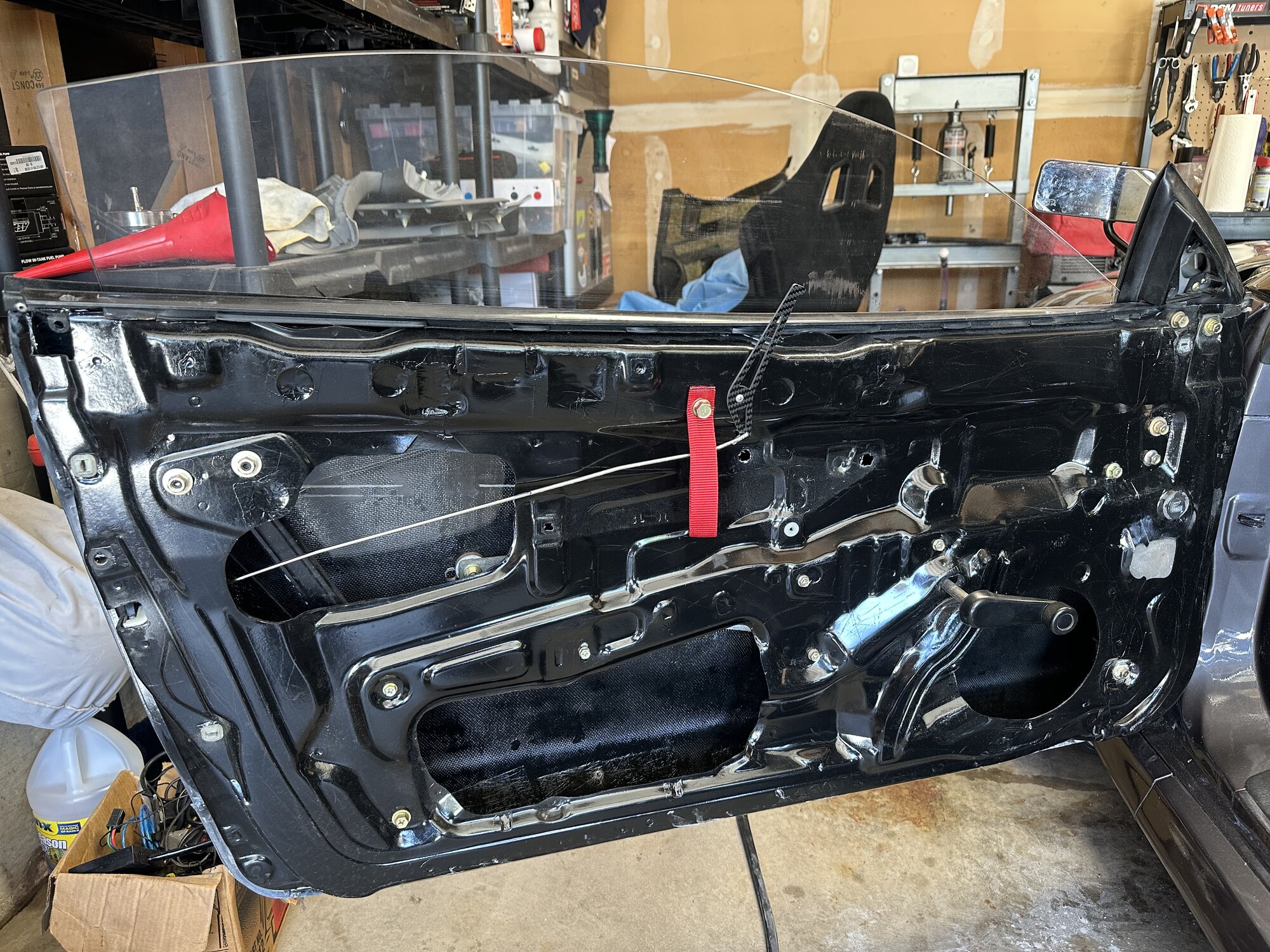

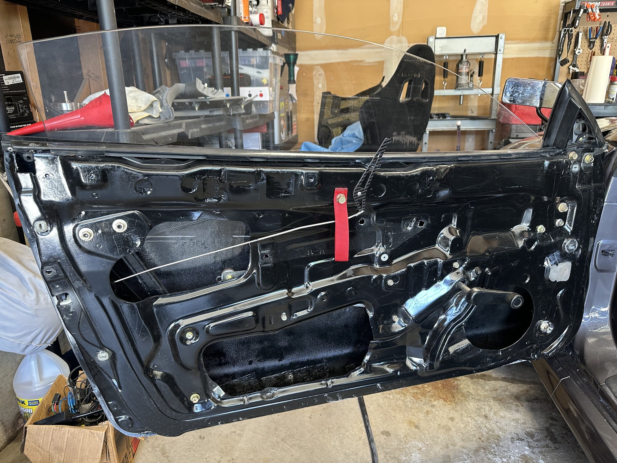

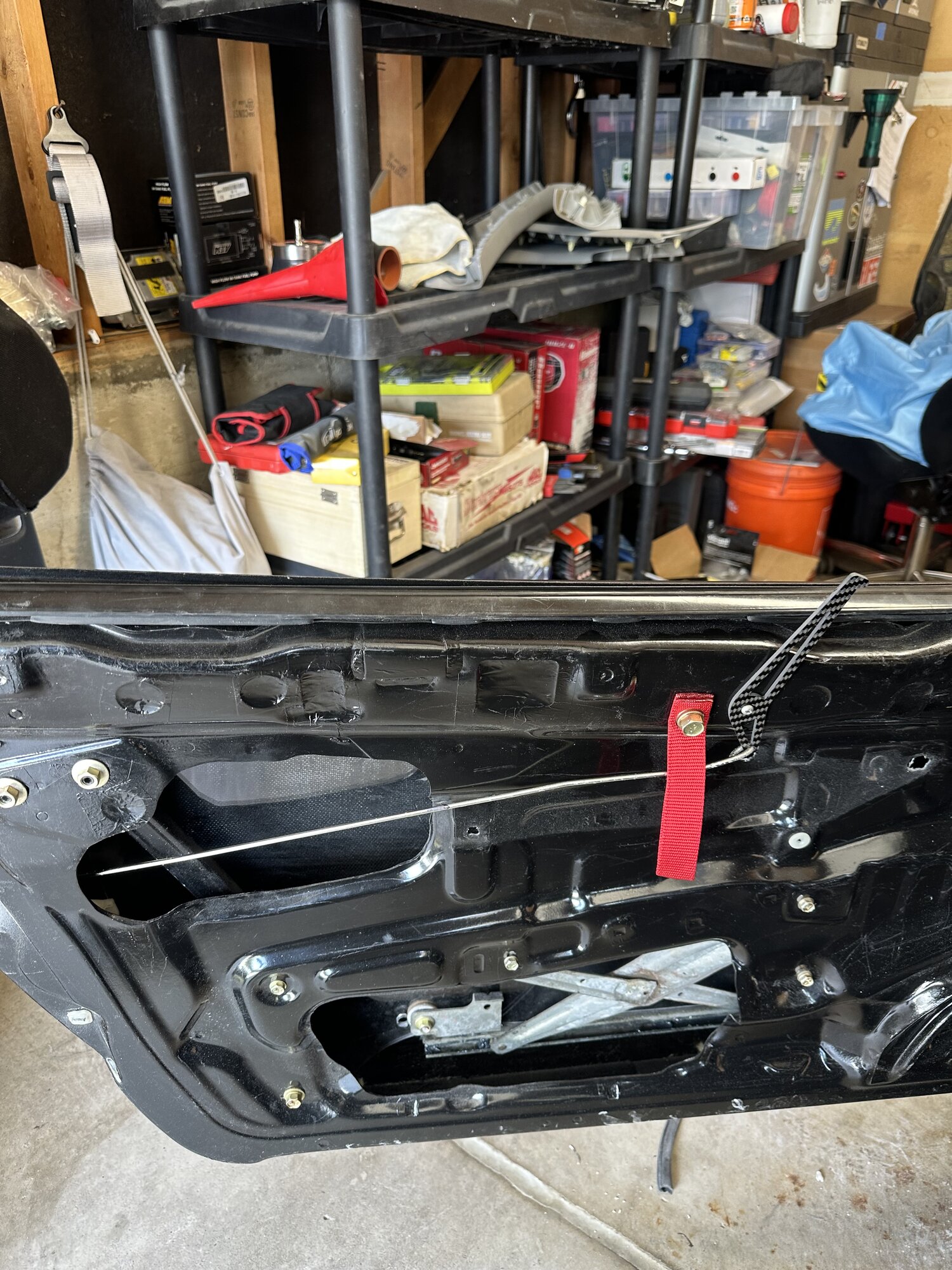

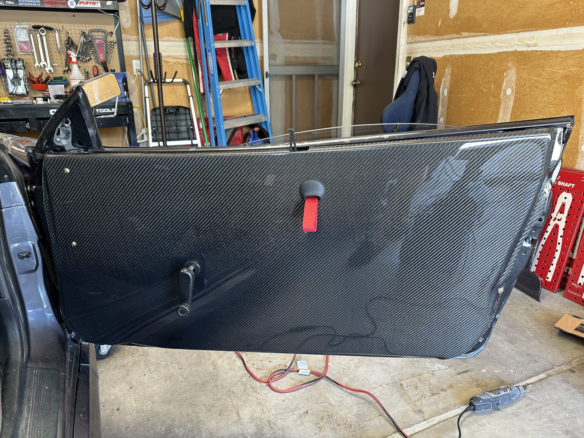

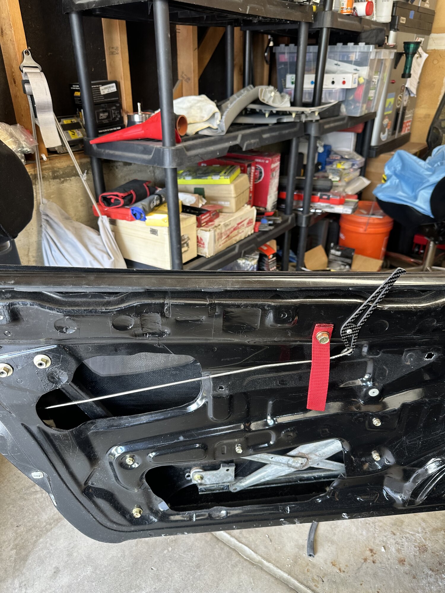

Also got off my butt and installed the carbon door panels. Now this was a pain LOL. They of course are not direct bolt on and of course using them with a carbon door that’s not a perfect fit makes it even more challenging, BUT got it wrapped up.
Still needs a slight bit of trimming and tweaking but the hard part is done.
Race car!!! Looks good buddy
Get your pull fan on! and you can switch to a streight hose end, and eliminate that low hanging 90deg fitting.
