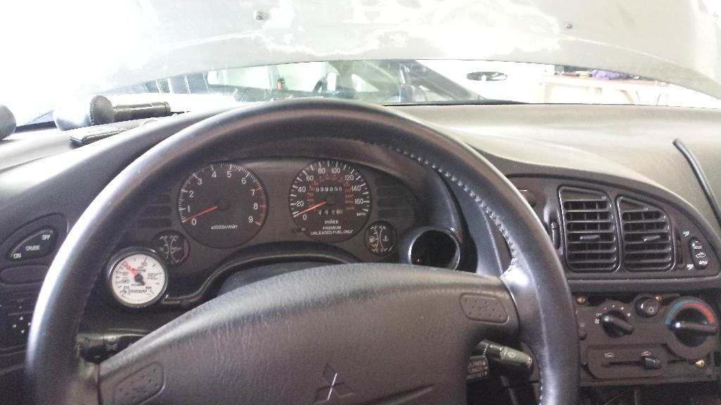

Got my frog pod installed a bit ago and installed my autometer phantom boost gauge. (Empty spot will be for wideband)

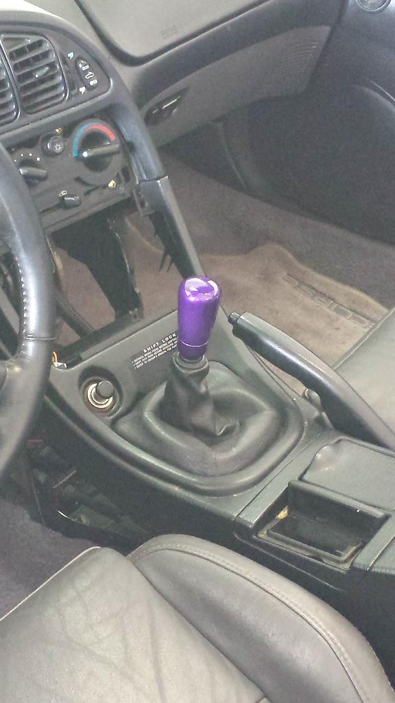

Got my momo shift knob installed as well.

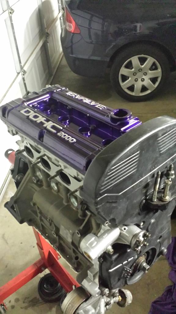

Also a friend helped me assemble the motor and get it pretty damn close to being ready to drop in
I'm hoping to have it mated to the trans and ready to drop in within the next week or two then get everything plugged in and start her up. I'm getting excited to hear her run.

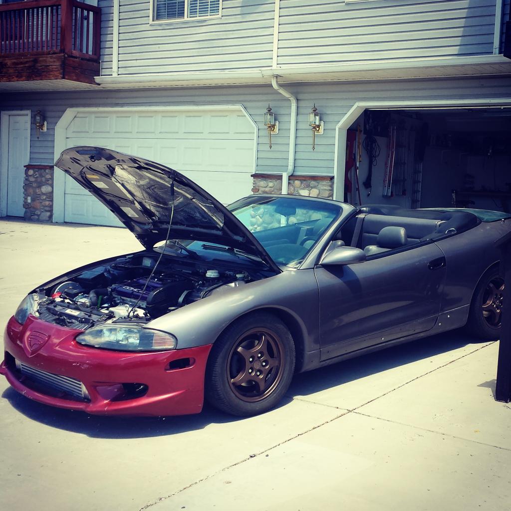

Got everything plugged in, oil filled, trans and tcase filled, coolant filled. Tried fire her up yesterday but couldn't get the starter to do anything. I'm leaning towards a bad starter I'll try and jump it directly to power and if that doesn't work, new one coming in.
She lives!!!!!
Fuel pump worked great, There just wasn't enough gas in the tank LOL Two gallons from a bone dry tank just isn't enough to get it to the rail. Tossed in a few more gallons, checked for spark and found out that the plug to the crank and coil pack are exactly the same, switched those, fired right up! So damn happy, Going to let her run for a little bit change the oil, fresh oil and filter then get her moving

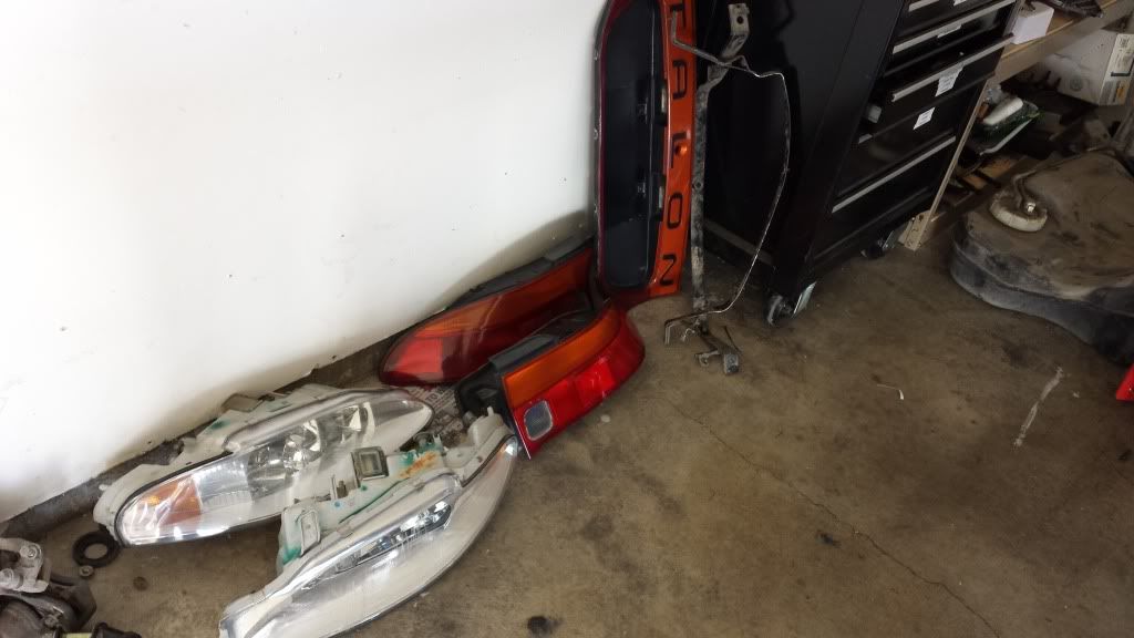

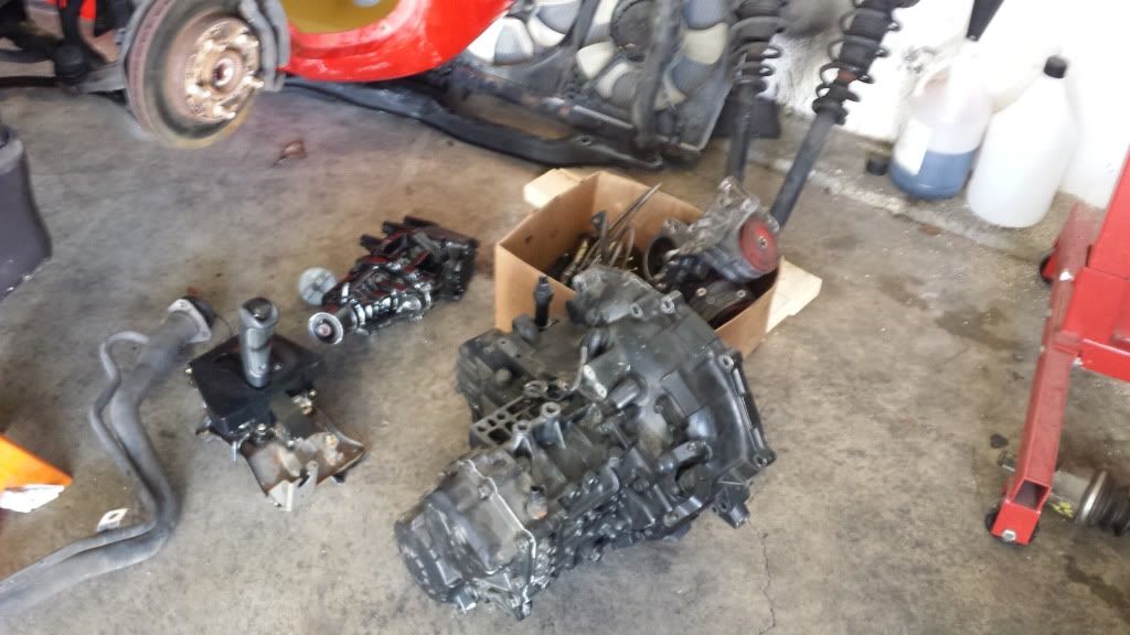

Well I got a little bit done recently, Last week I went and picked up the majority of the parts I would need for the Awd swap, Manual swap, and the talon swap.
(Ignore the auto shifter)

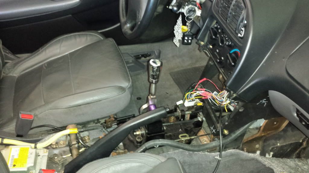

I got a little bored so I decided to remove my TCU and install my shifter assembly and cables. (B&M short shifter and a MOMO shift knob)
I also temporarily installed the rear subframe and driveline so I could line up where the rear carrier mount would need to be welded.
That's it for now, I also picked up my rear 2ga bumper but it's in front of the car and I forgot to take a picture. I also decided to do an energy suspensions poly bushing kit in the rear since I have it all out right now and one of the bushings was toast. Hoping to have the whole rear end including gas tank and subframe mounted in the next few weeks before winter really sets in.

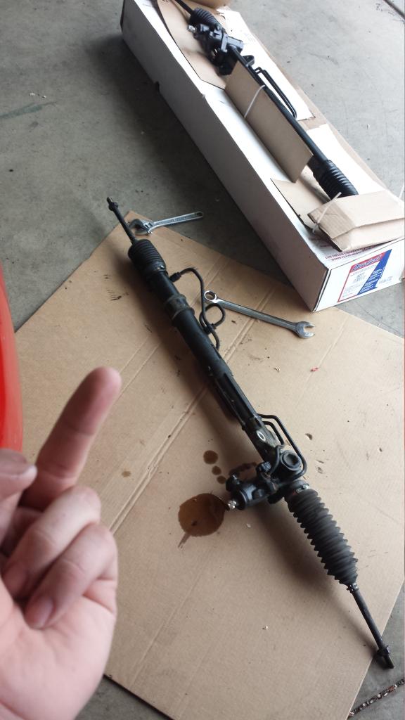

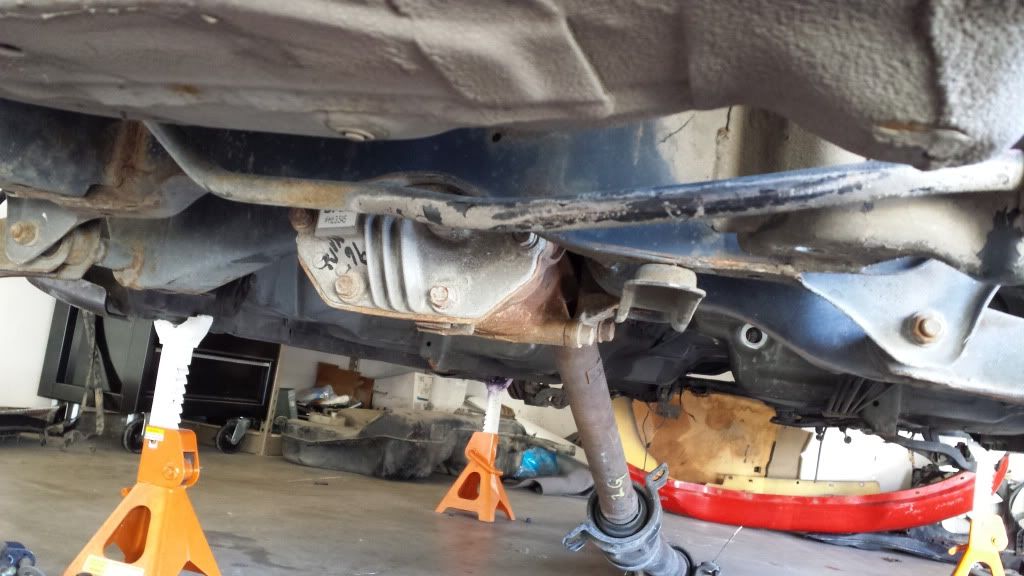

Back to wrenching on the ol gal. I thought I had a bad axle seal, turned out my rack and pinion was completely toast, got her torn out yesterday.
Got the remand unit installed just need to bleed her today :)
Also cleaned up the under carriage it seemed this thing had been leaking for a longgg time everything was caked with grease dirt and whatever else could stick to it.

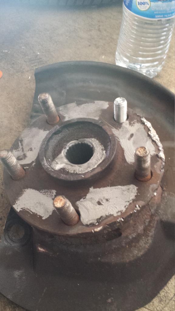

Got a little more work done, finished up the rack and pinion job, bled the rack and got the fluid filled. Installed new outer tie rods and Installed a new drivers side wheel bearing/hub assembly. Old one was garbage

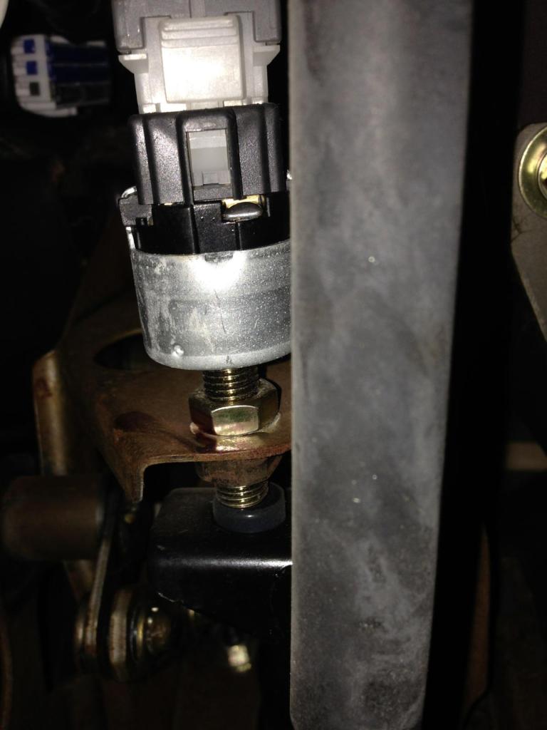

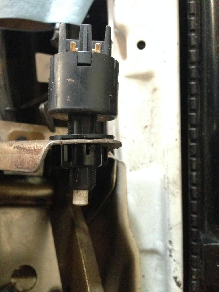

Decided to show just how retarded Mitsubishi went towards the end of the Dsm era. I couldn't figure out why my brake lights wouldn't come on, looked under the dash on the brake pedal and found it didn't have a light switch, easy enough, go to O'Reilly, purchase one come back try installing it and I find out it's the wrong style. 95 - 98 are supposed to use the same switch, my Spyder is a 98 and I couldn't figure out why I had a different plug. Well my Spyder must have been one of the last 98's made because I have the bastard 99 brake light switch plug. I ended up needing a whole new brake pedal assembly because the mount is different, the switch is different and the clip is different. The only reason I could come up with is they changed the style to save money as the 99 switch is all plastic and the 95 - 98 switch is metal. Really stupid thing to change but whatever. My friend who will be swapping his wife's Auto Gs-t had acquired the pedals from a partout and that just happen to be from a 99, his wife's Gs-t is a 98 (like my Spyder) and has the early switch so we traded brake pedal assemblies and all is well. He sent me these pictures and I'd like to show everyone the differences.
95-98 Style
Bastard 99 Style

I just couldn't believe it. I got super lucky that Tyler had picked off a 99 manual dsm or I'd still be looking or have to wire in the older style.

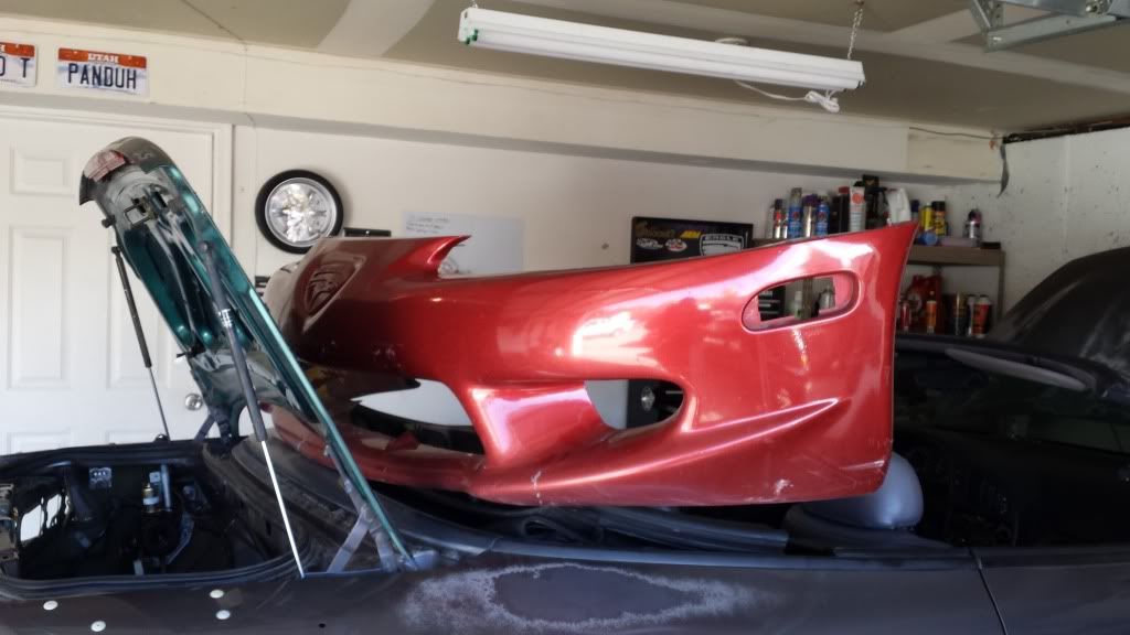

Wish I could run down a 2g talon bumper for my car, I have the twisties, just need the front.
And "B" from 4g63 shop is a bad ass! Come fall I will have him help me set up link in my ride as well.
Great work man..love it, mine was swapped to awd over the winter. I have all my talon pieces ready to go, but things just keep coming up and I haven't had time to get to it. My driveway in steep (I scrape) and I plan to move out by next summer so I think I might wait to put on my freshly painted Talon bumper. :cry:
