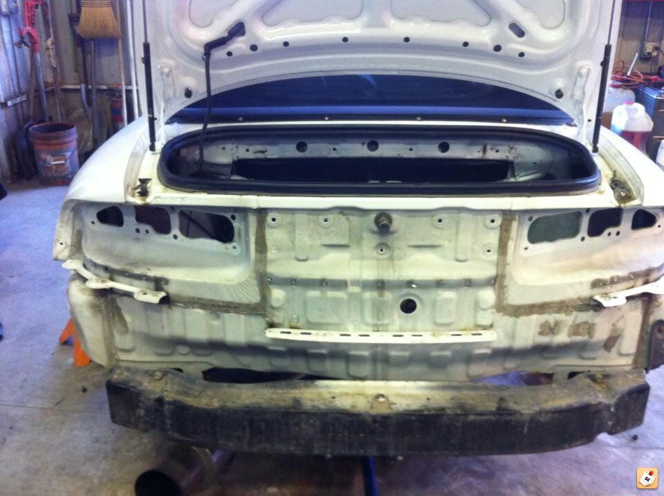

Relocated the oem ones. They are just spot welded on.I don't have one of mine but Here's a picture of Crashs spyder he sent me to help with the spotting. Much appreciated Crash!
Not a problem man!!
For those who cant see or dont know what you're looking at, notice in the pic above that the center bracket is moved down ~roughly 6 or 7 inches? And the sides are down about 2". What I did to measure these was I put the center tail light section in, bolted the brackets to the bumper then held the bumper in place until the gap was how I wanted it. Marked where I wanted the side mounts to be then put a couple tack welds. Then with the center out I could mark the center mount.
Once they were all tack welded in I put all of the lights in to check the gaps. If they were off I removed the bumper and repositioned the bracket until I got the gaps how I wanted them! I probably mounted and removed the bumper and lights at least 10 times that night.
Yup took me a good 10 attempts as well! Glad thats over with LOL.

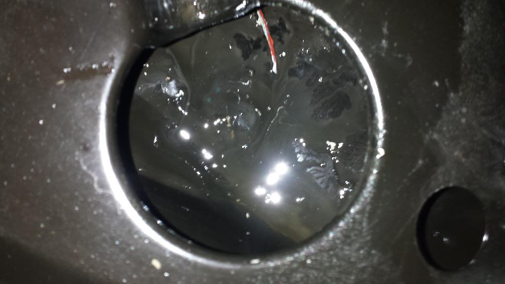

Not so good news....
Pulled off the oil filter and a silver lining was in the oil along with multiple little bits of who knows what. Looks like I'm in for a rebuild :-(
Definitely not giving up, my buddy that did the welding before is coming over next week to finish welding the holes and the x brace. Then I'll be ready to put her on the ground and be able to move her around.
