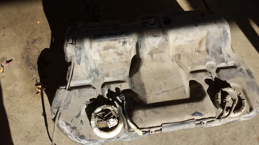

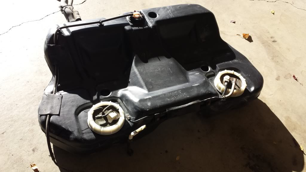

I got bored and cleaned the AWD gas tank I had acquired
Before
After

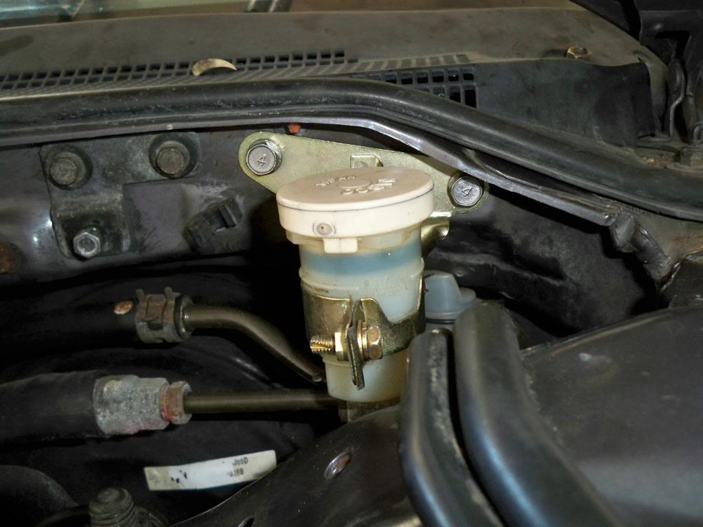

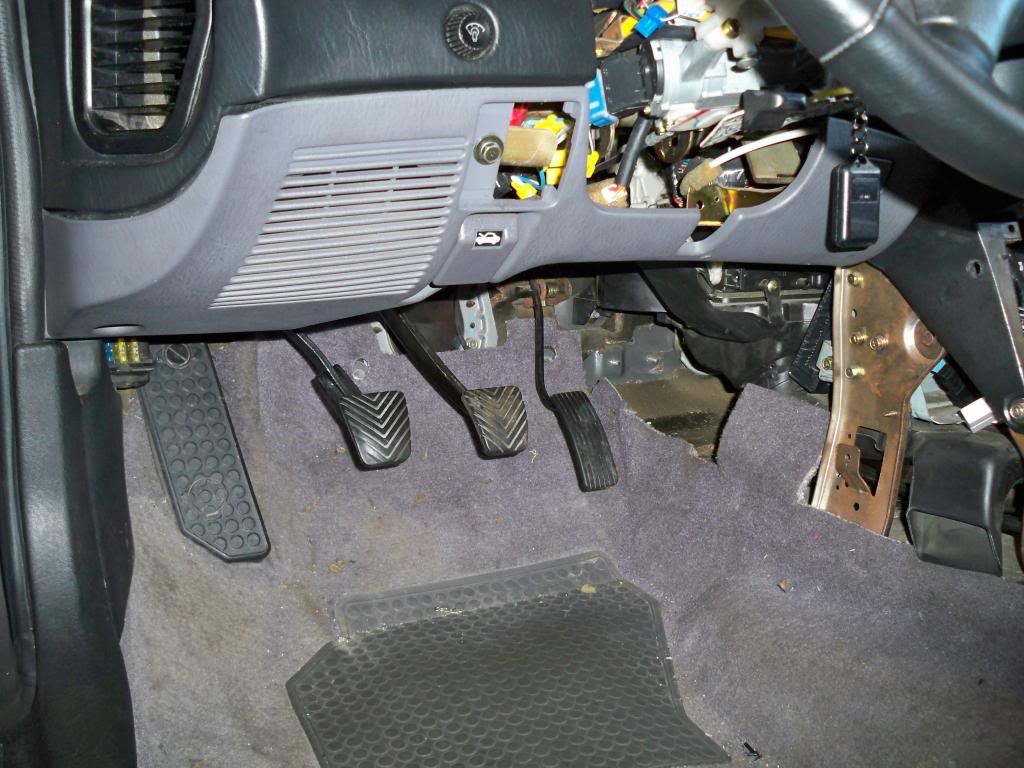

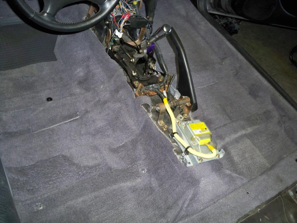

I also finished up the Manual swap including pedals and the clutch master and reservoir

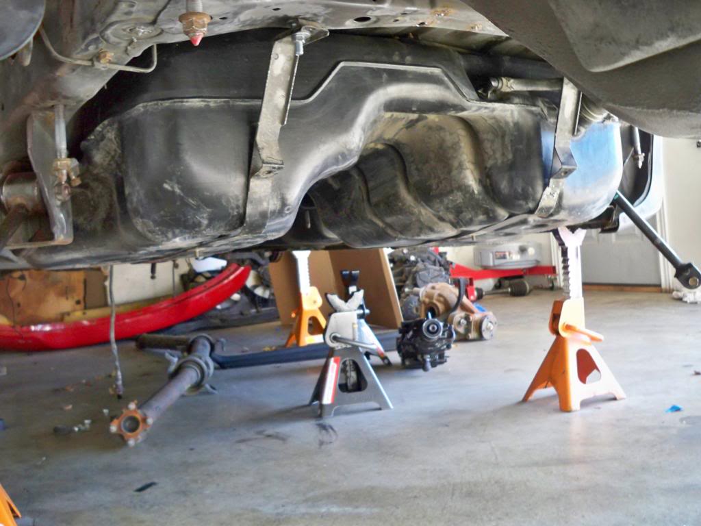

Came back to work and got a little more done. Got the bracket painted up and mounted the AWD gas tank as well as the fuel neck.
Also got advised by a good friend that has also done an AWD swap on his Gs-t that I should cut an access hole for the second sending unit incase that ever goes out, You wouldn't want to drop the whole rear end and tank to fix it. I didn't have access to the stock 2g AWD plate so I went to my local junk yard and pulled another main one off a fwd 2g and use that, looks pretty good IMO

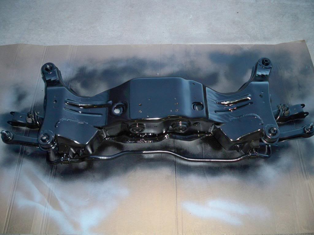

I also cleaned up and wire wheeled my rear subframe and laid down some primer and gloss black rustoleum, I think it turned out pretty good, I forgot to take before pictures :ohdamn:

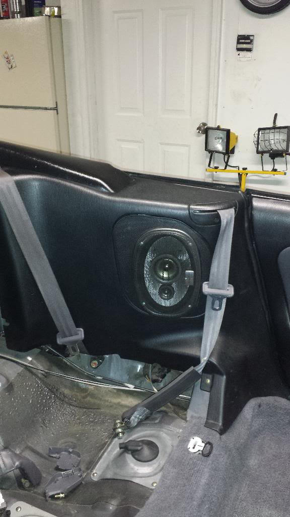

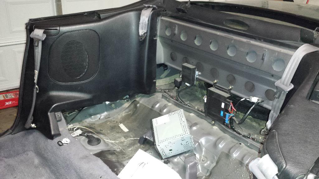

I couldn't stand to look at these rear quarter panels anymore
I'm not really sure why someone would do this but they did here's what the damage was after removing the panels and speakers (Sorry for the blurry picture)
Yes, those are 3" long wood screws and there were little wood blocks behind the speaker frame where the screw went into :/
I found the reason they decided to cut up the interior was because the aftermarket Kenwood speakers hard too large of a magnet to fit properly behind the cover, I decided to make a few calls and had luck that a local dsmr had some OEM infinity rear speakers sitting around (Thanks again Tyler B. )
I was very lucky to find a Spyder in a local junk yard that was barley even touched, So I grabbed the stock rear speaker covers (They were tan) and bought some interior vinyl and trim paint from the local parts store, They match the OEM covers PERFECTLY have a look for yourself :)

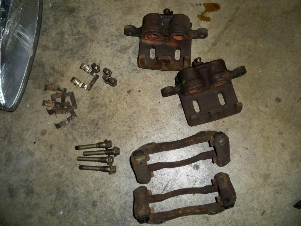

After I buttoned those up, I started working on a pair of front dual piston GSX calipers I picked up from a very generous dsmr from back east. This is what they looked like when I got them
I scrubbed them down with some purple power and elbow grease and they turned into this
Finally I picked up some Rustoleum flat black enamel and laid down a few generous coats to each bracket and caliper, They turned out pretty good If I do say so myself :)

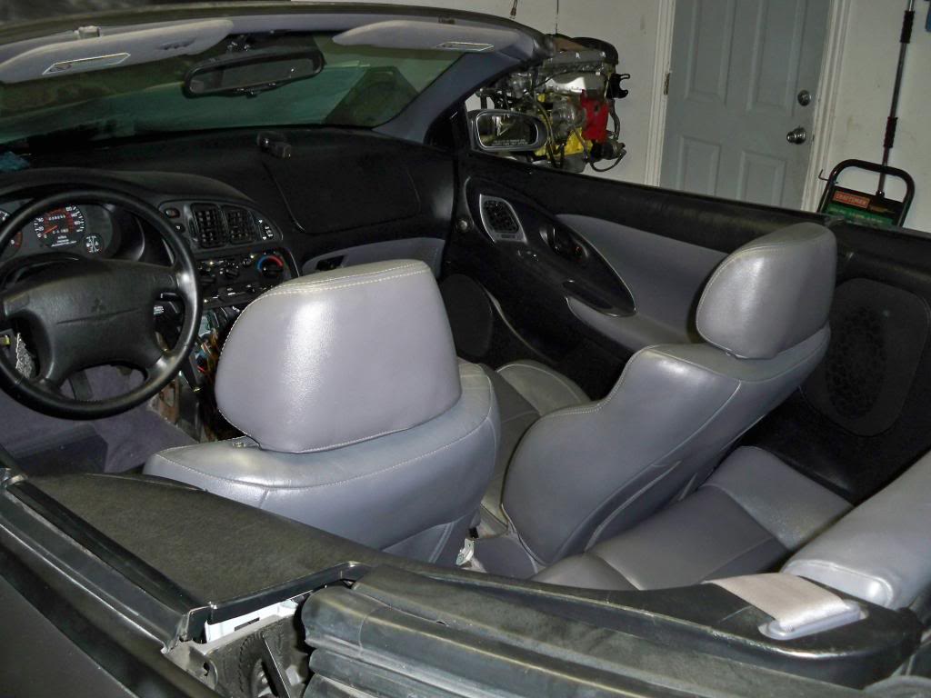

I then proceed to install all my interior trim back into the vehicle (besides the center console) and gave everything a go around with the vacuum and some Meguiars leather cleaner

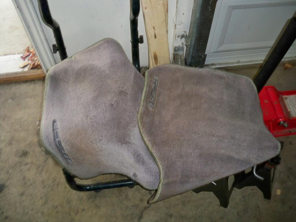

I'm not sure If I ever posted a picture of these OEM eclipse floor mats after I cleaned them but they turned out pretty nice, The stains you see weren't coming out after an hour of deep scrubbing so I left them alone.

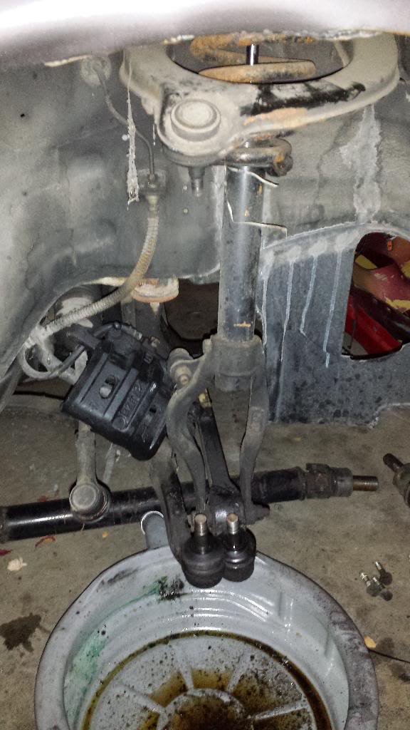

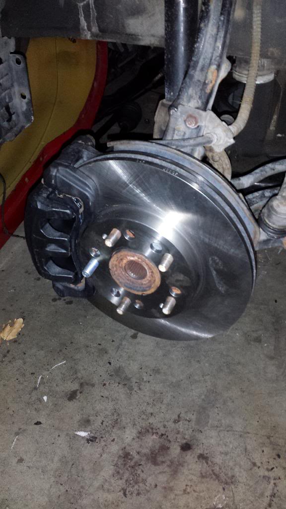

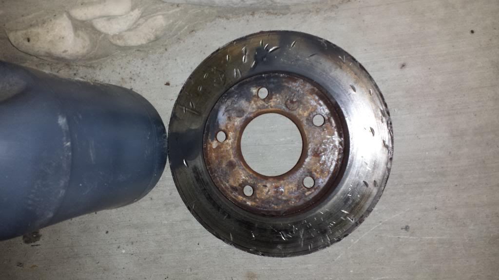

Small update, I felt like working on the car this weekend, so it was time to install the new calipers, rotors, and brake pads. I don't remember having this much trouble with rotors ever!
I was smacking the rotor as much as I could with my hammer and finally got the drivers side off, new components on and turned out nice
The passenger side was a whole different story :-\
I started out by removing the old caliper and installing the new one. Next I started wacking the rotor with my hammer, didn't budge this continued for about 40 minutes, using heat, pb blaster and my hammer. Finally I decided to take the knuckle off
After doing this I could feel considerable play in the wheel bearing so that now had to come out as well.
Rotor came off after more hard wacking
Then I un-bolted the wheel bearing and got that out
I cleaned up the surface where the bearing goes into the knuckle
I ordered the wheel bearing from rockauto best price I found on the one I wanted. So now I play the waiting game.
Thanks for looking :)

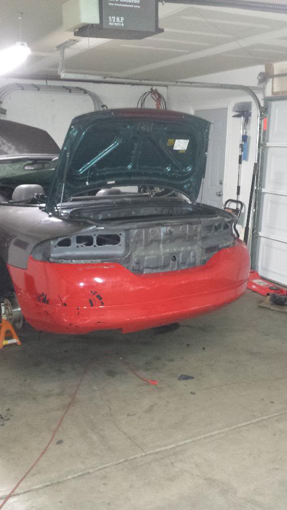

Got off work a little early and did some test fitting and mounted the support brackets for the rear bumper :)
