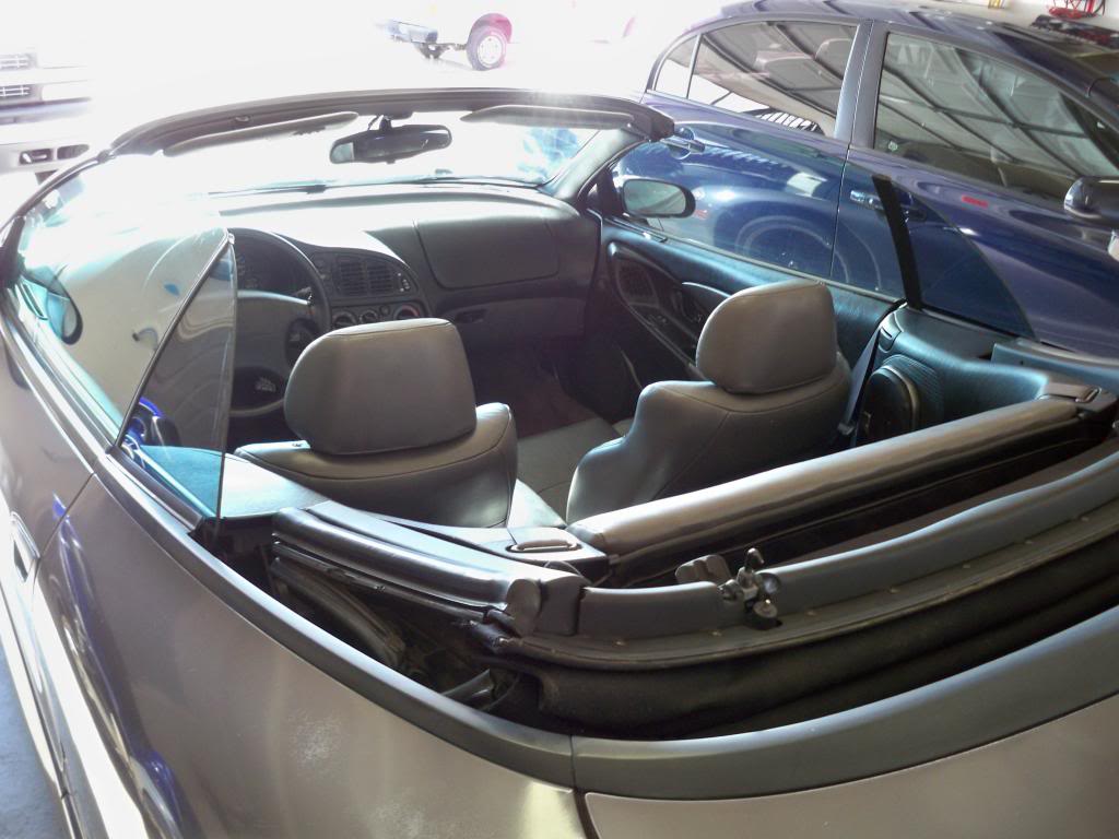

-Trunk plastics are messed up and one of the previous owners cut the Manual top switch out for god knows what reason (Already found another and wired it in, Also found a full set of tan plastics in perfect condition at the junkyard)
-Something is wrong with the starter, torque converter, and/or flex plate (Makes a god awful grinding sound when starting it, but once it starts it idles and drives)

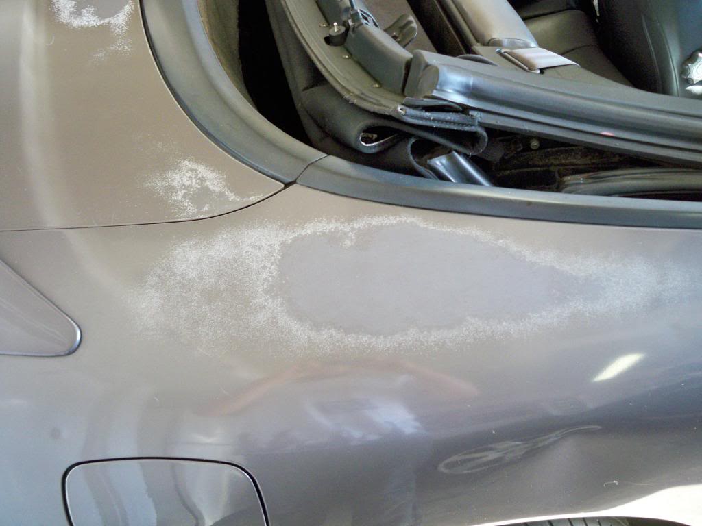

-Needs to be painted, usual sun fading
- Top is actually in pretty good shape except for the where the glass is sewn into the top the stitching is coming out, shouldn't be hard to get that redone.
-Dents and dings around the car nothing horrible

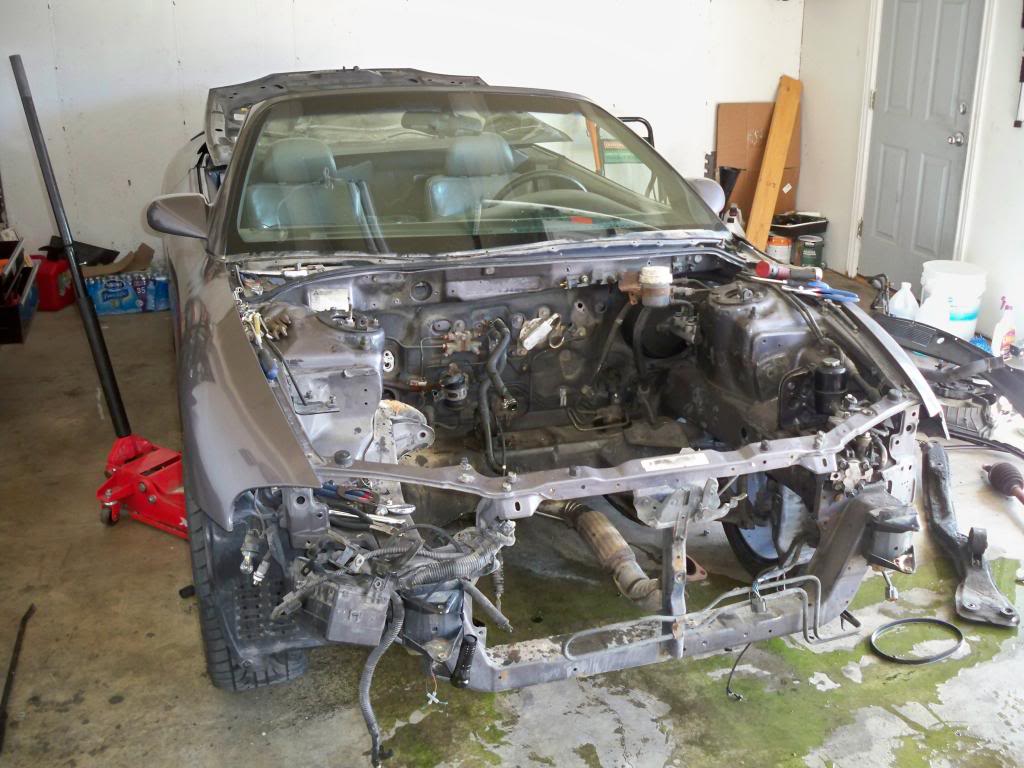

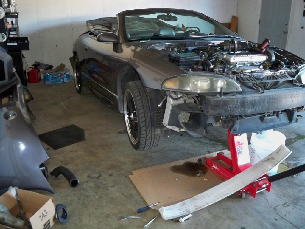

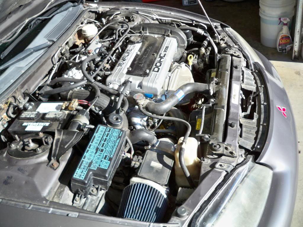

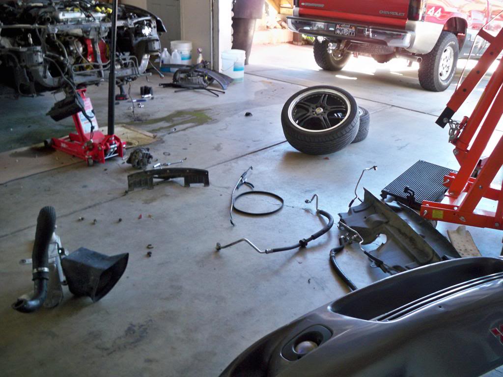

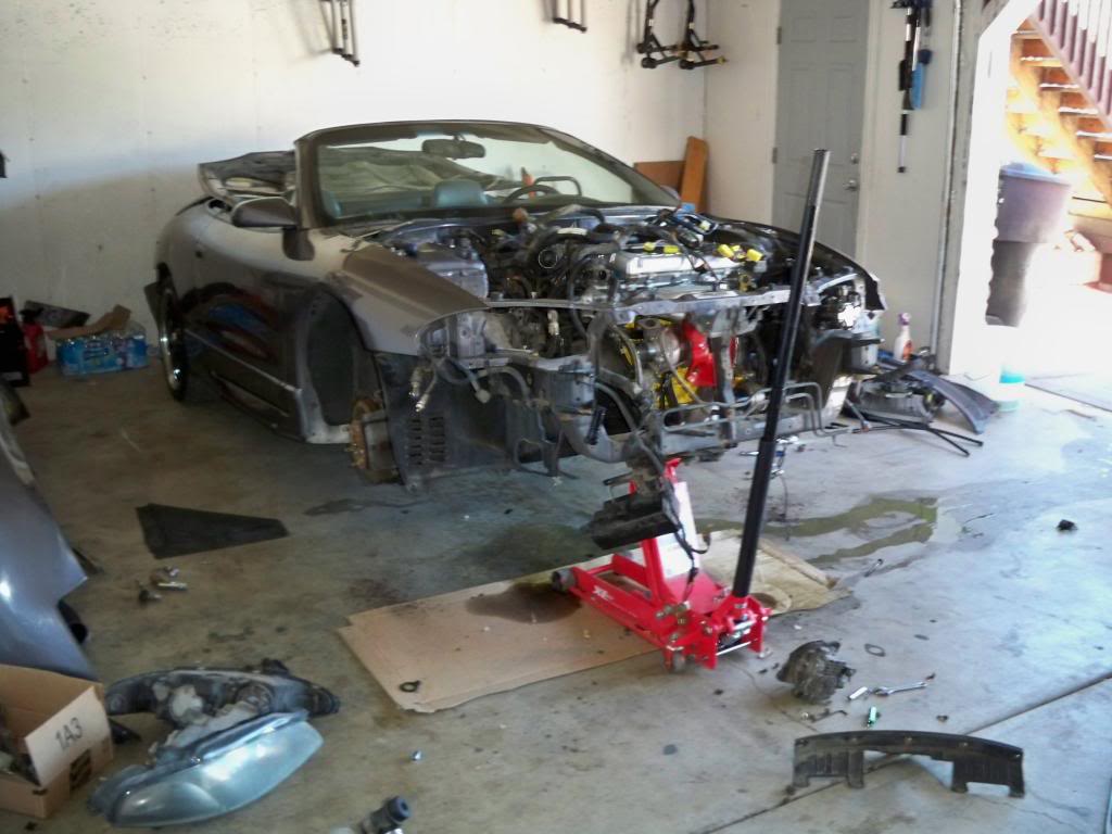

Had a buddy come over this past Saturday and we got to work on this bi***. Started by taking off the front bumper and draining the coolant. He seems really excited.

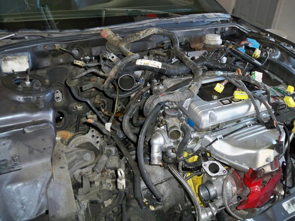

We got all the fun stuff out of the way started unplugging stuff from the engine and moving things around.

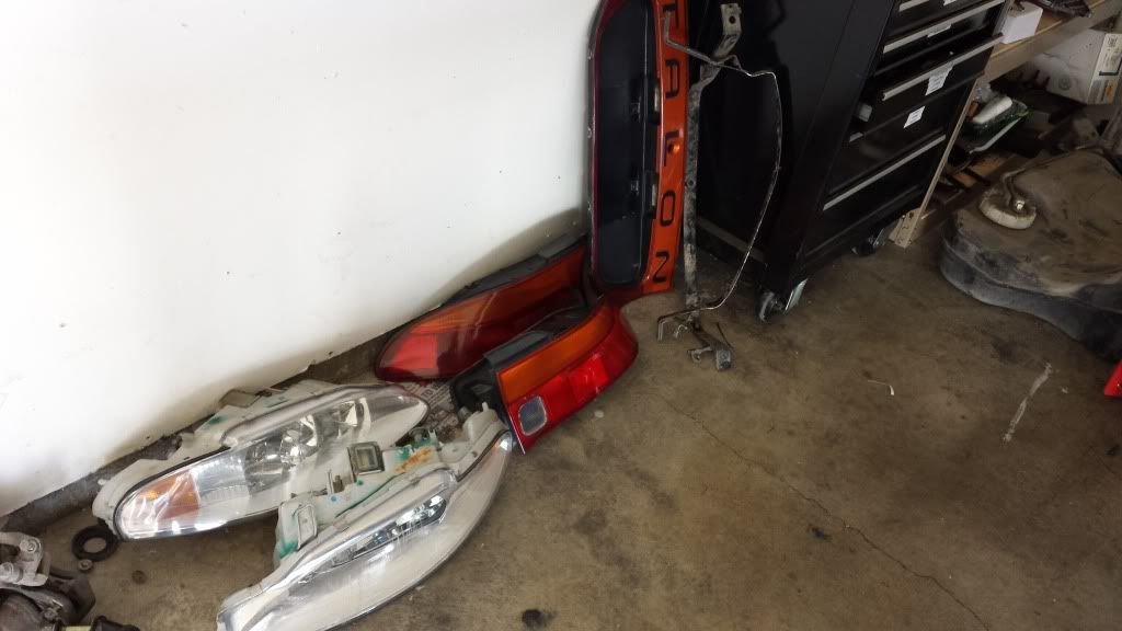

Tore out the headlights, smic and stock piping
I also decided I'm going without ac in this car. So I tore all the lines out
Harness unplugged from the interior and wrapped onto the motor

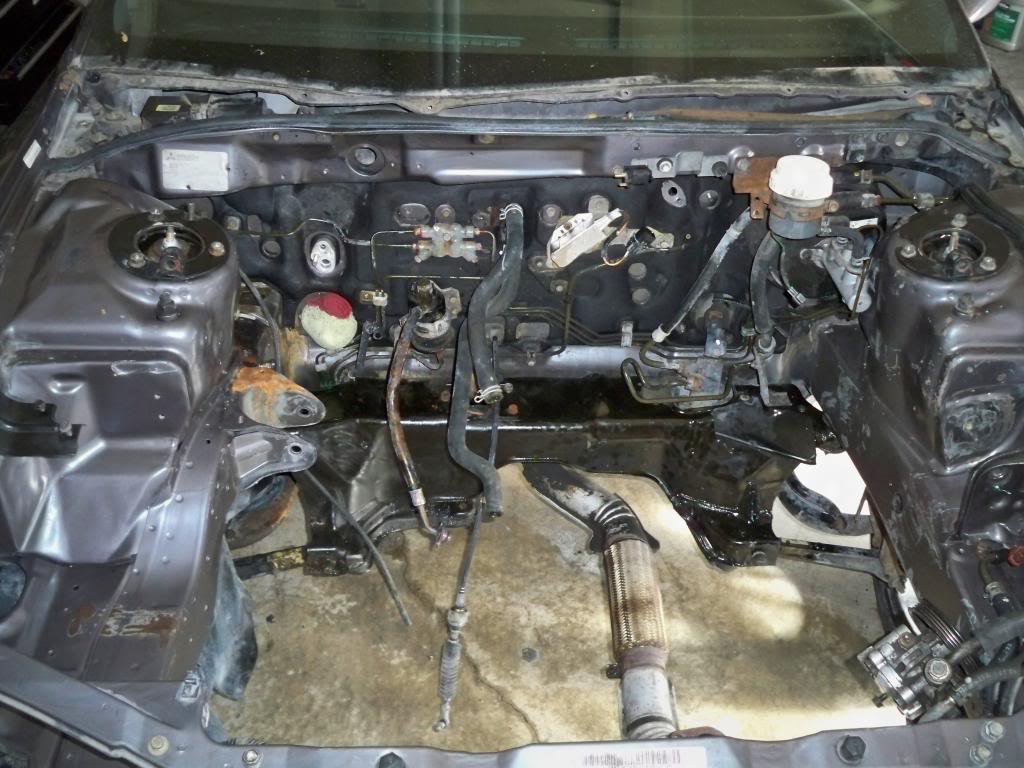

Motor and trans out, coolant pissed everywhere

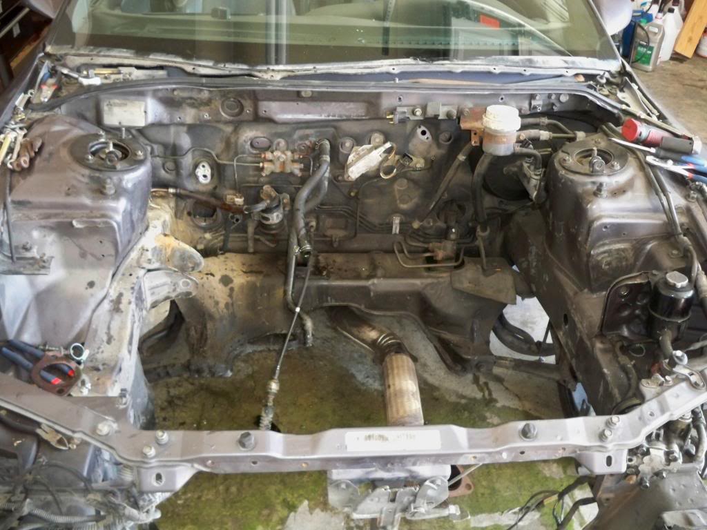

The bay was filthy

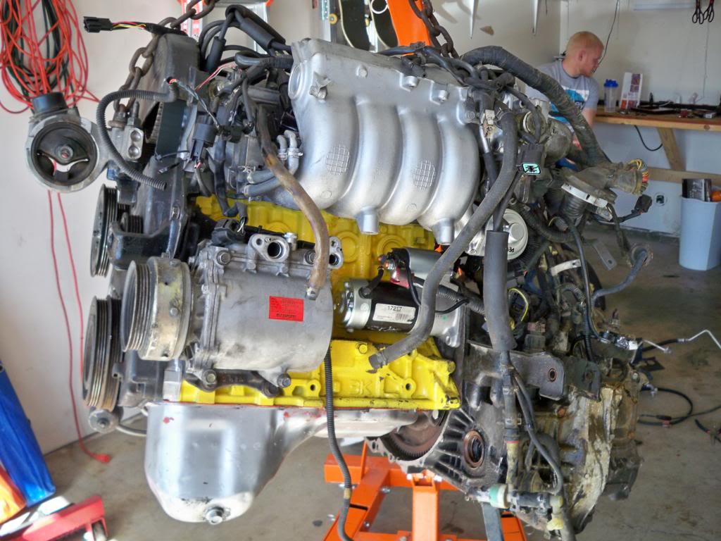

of all the colors a previous owner thought yellow was the way to go on the block LOL
Also decided red was a good color for a heat shield
Dirty bay pics, thing probably sat for a while before I got ahold of her.

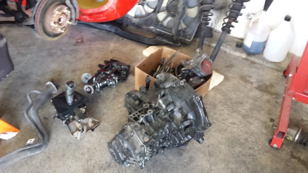

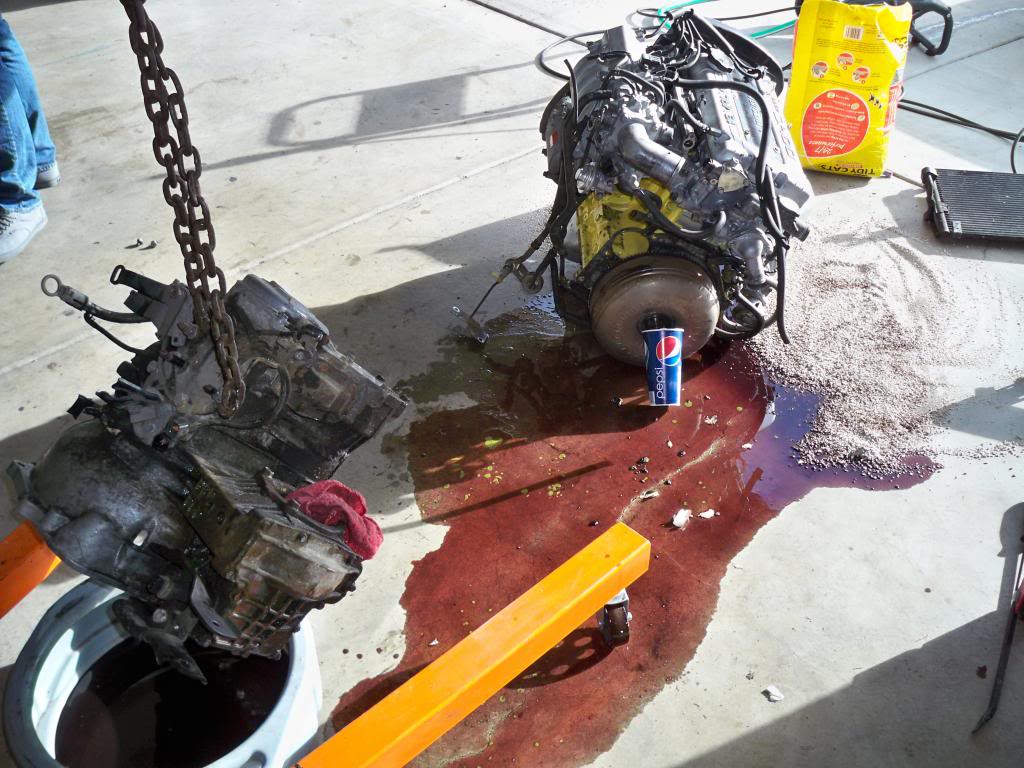

Got the motor and trans seperated but not before I found out that timing was off on the engine and we couldn't rotate it. We got two of the bolts that connect thw flywheel to the converter easily,# the other two not so much.
Also forgot how much trans fluid the converter can hold so it pissed it out on my garage floor.
Drained the remaining fluid the transmission had
Purple powered the crap out of the engine bay and scrubbed her down.
cleaned up for the night because of prior dinner plans we had.

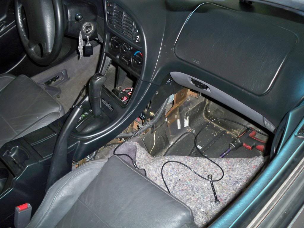

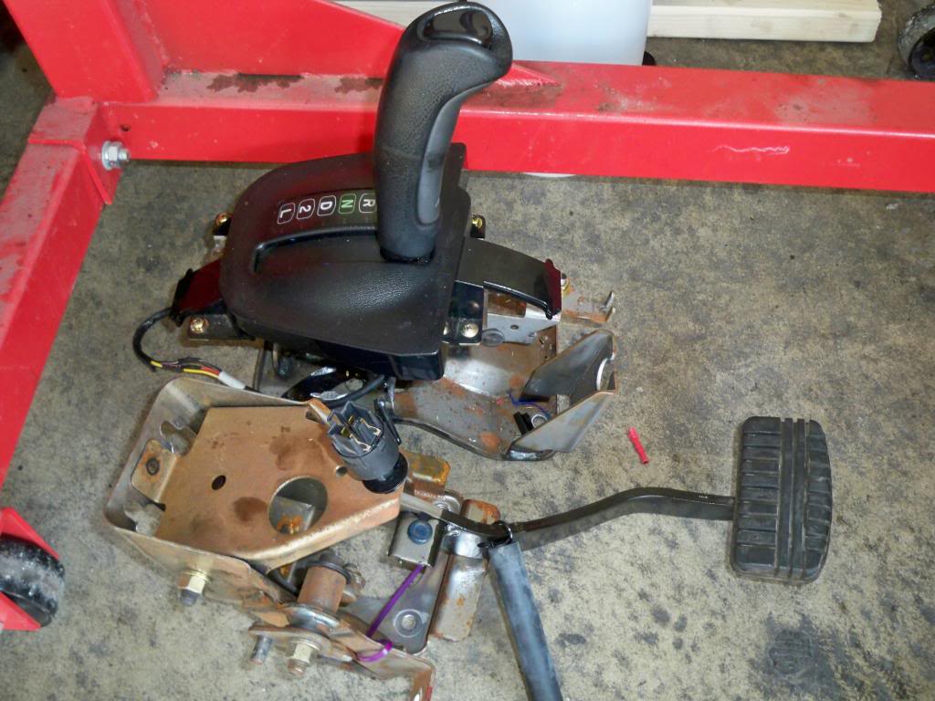

Came back on Sunday morning cleaned a little more and got back to work. A/T shifter, cables and ppedal assembly removed.
That's where I'm at now. Going to shoot for this weekend to drop the fwd rear subframe and gas tank. Thanks for looking!

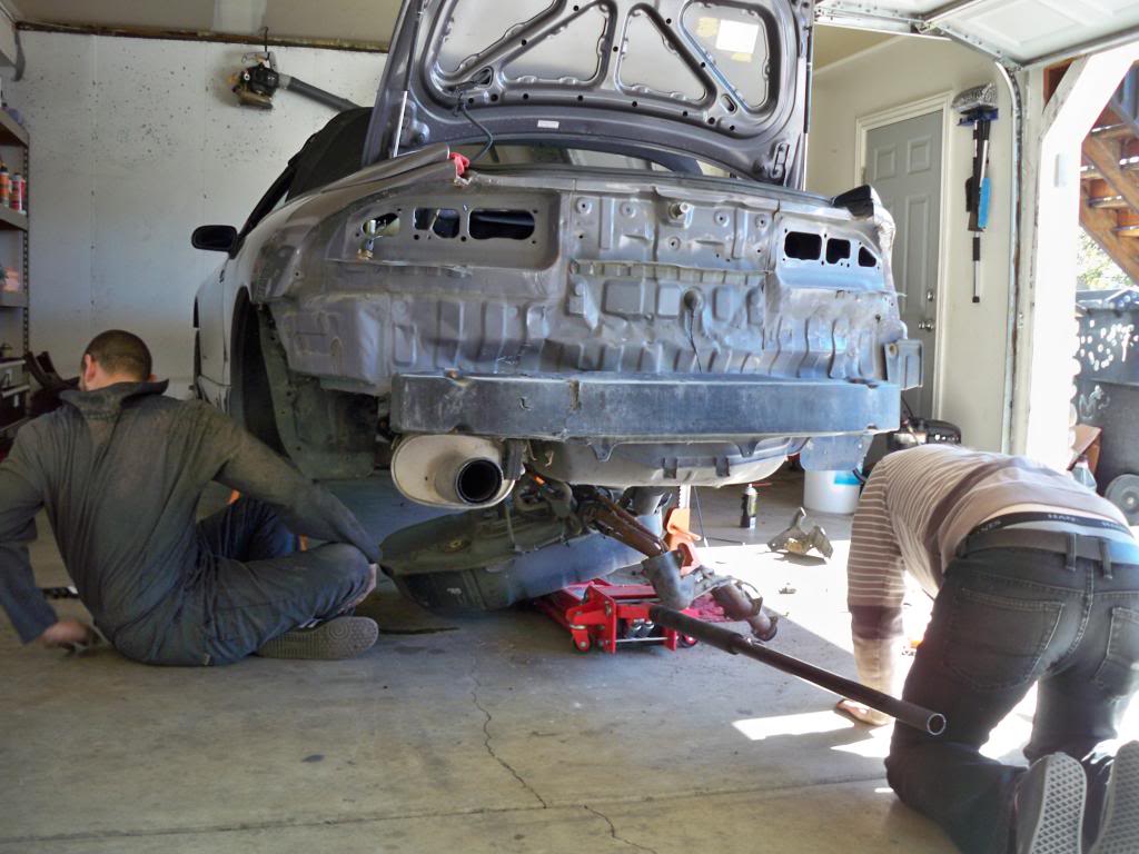

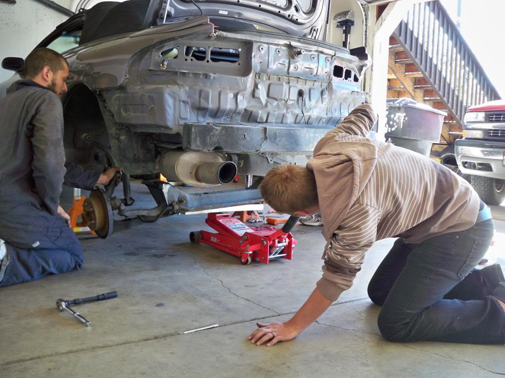

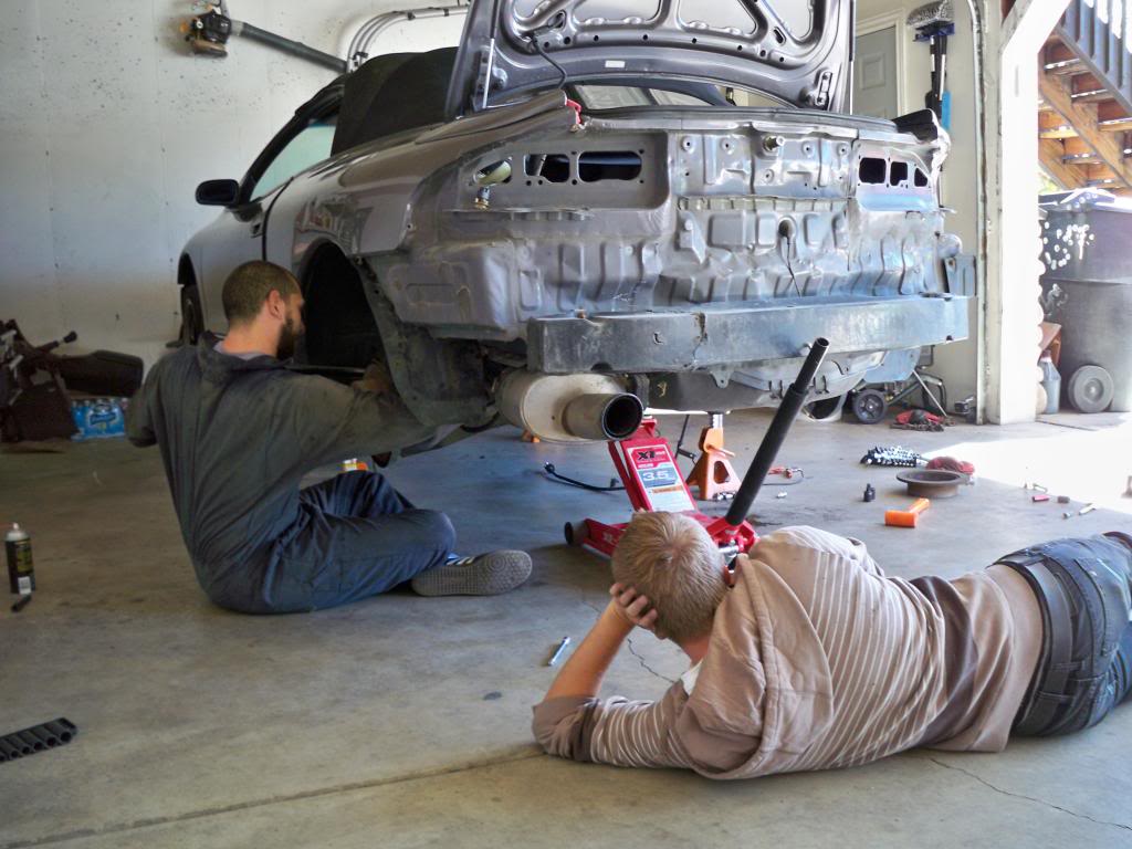

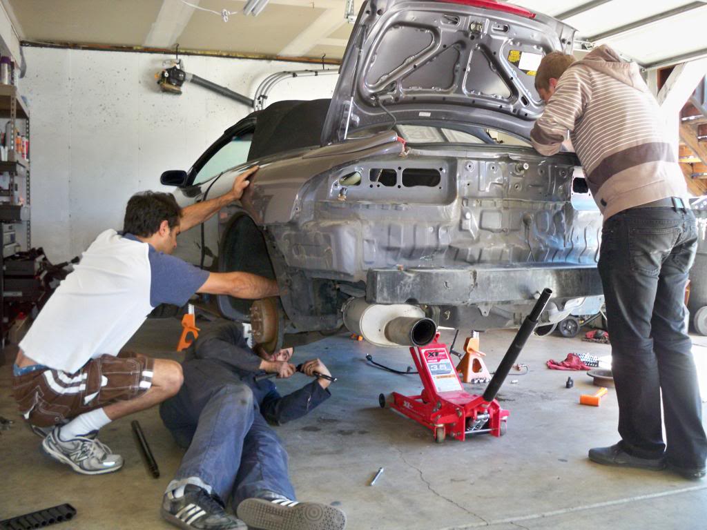

Got started on the spyder today around noon and a half (12:30 genius)
Started disconnecting things, Moving things around. Got around to taking the subframe bolts out
Tyler doing some hard labor
Subframe coming out
All out :)

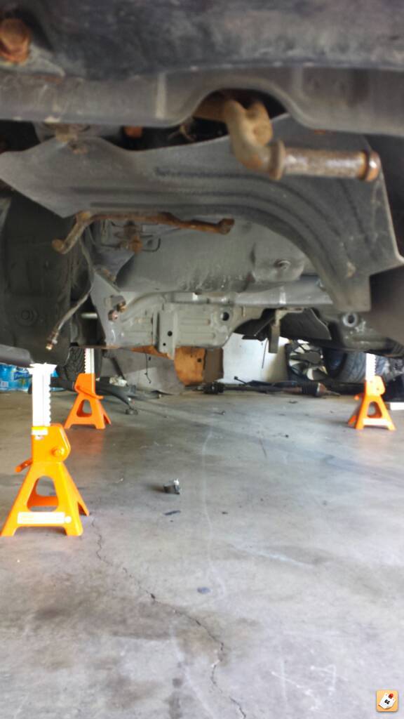

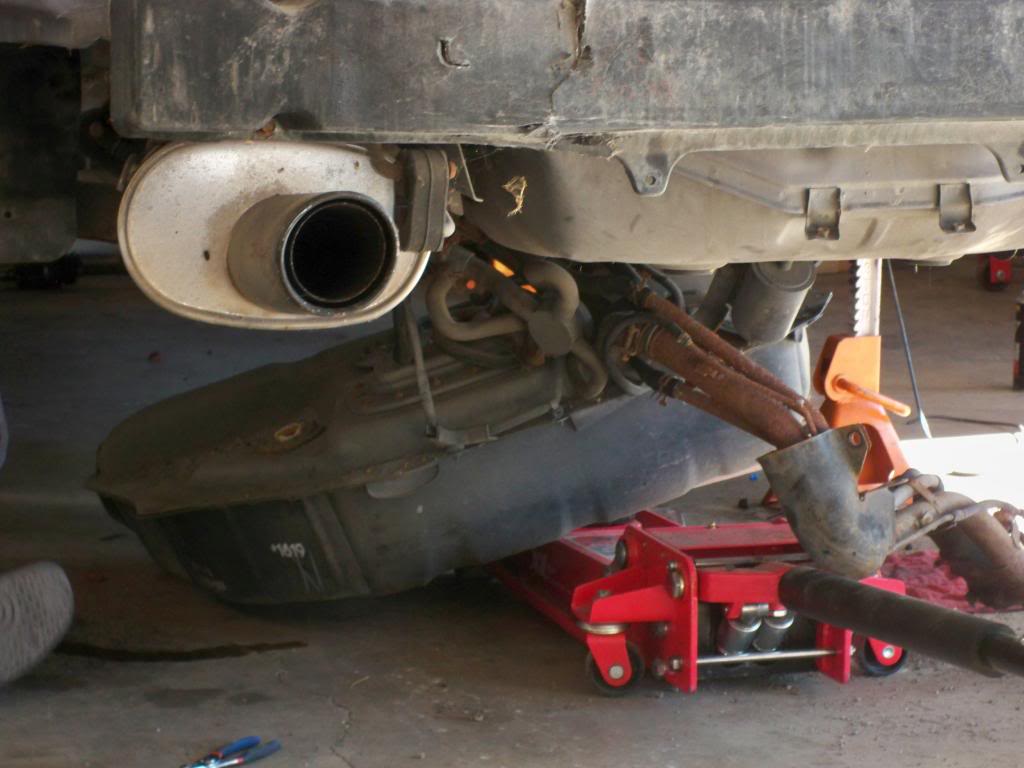

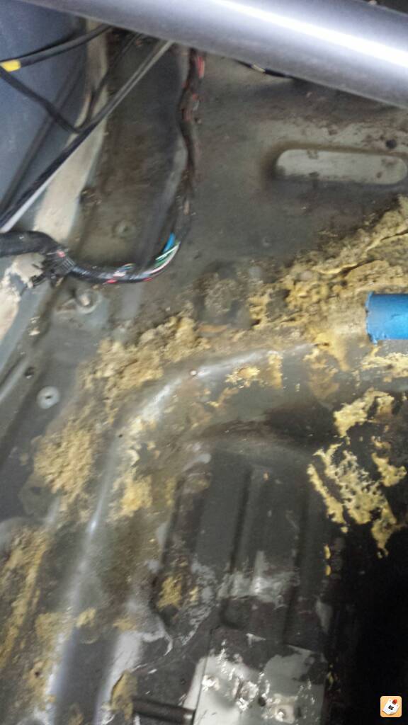

Started disconnecting lines and bolts for the fuel tank and filler neck
Slowly lowering it down, Has probably half a tank of gas in it still, Didn't realize these damn tanks don't have a drain plug.
So much emissions bullshit on the 98-99's
All out broke the one side didn't even realize it was still attached till it was too late.
All empty down here
Tomorrow I'll get the exhaust out and start cutting the subframe bolts out, That should be fun...:)
Thanks for all the support everyone! Big thanks to Tyler, Fernando, and Pjon for coming over and helping out!

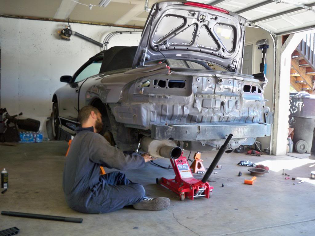

Got a little more done today was kinda tired still and didnt sleep that great.

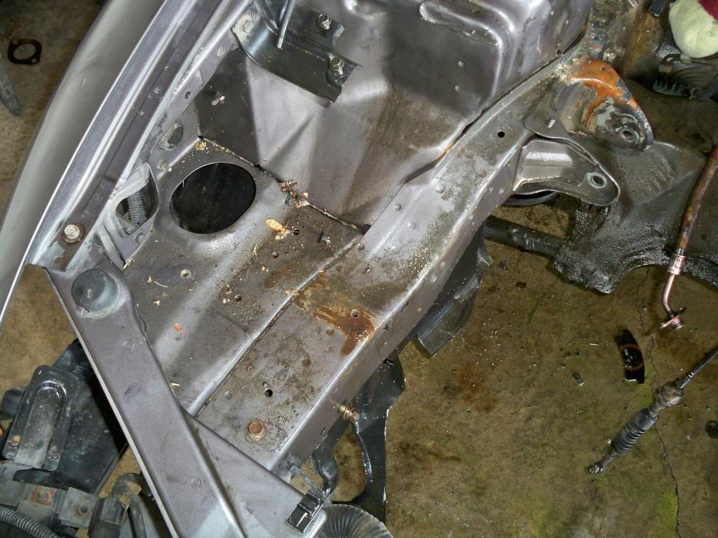

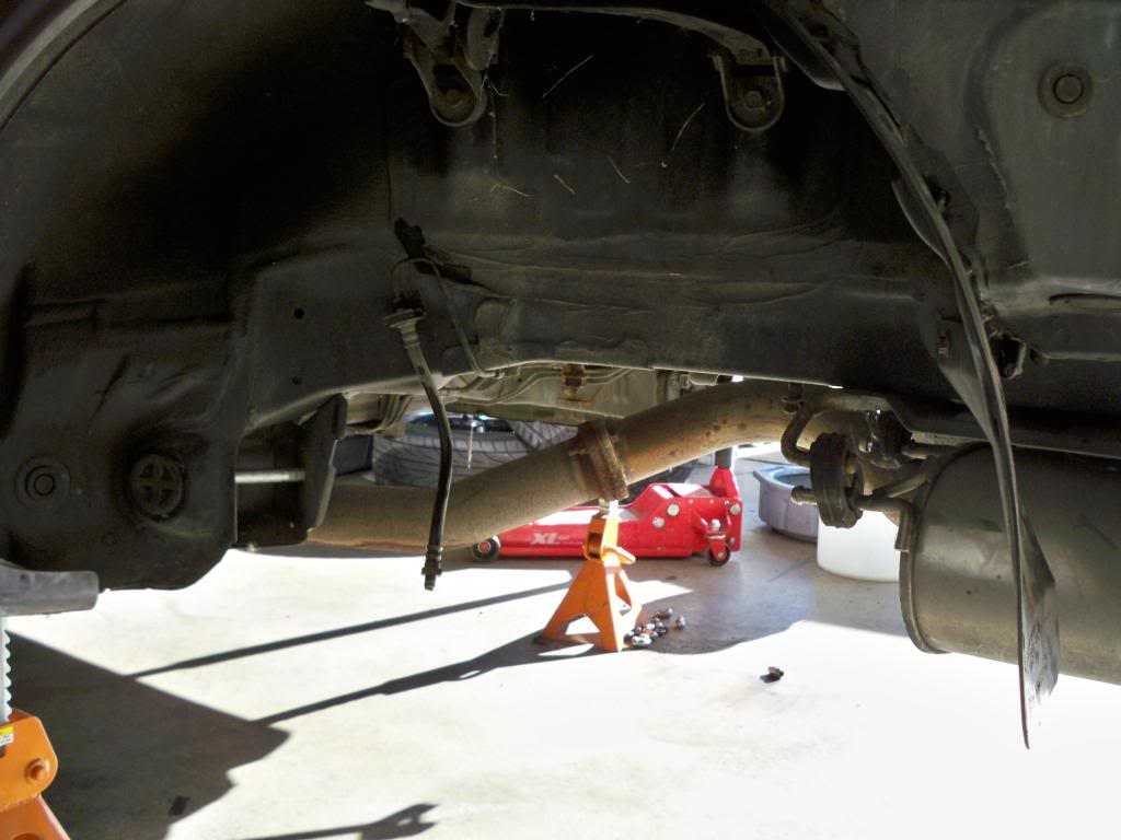

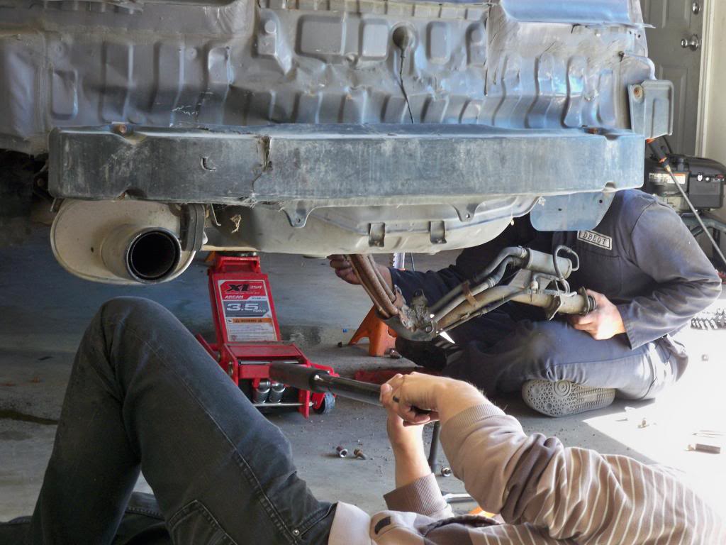

Exhaust is out
Cut the piece of the xbrace to get the subframe bolts out
Next will be to get the holes cut and the subframe bolts out.

Looking good. There is a better way to do it with out cutting the x brace out. Just make sure to weld it back into the car.
I picked up a 2nd awd spyder last fall for the new black top on it. The shop that did the swap cut the x brace out and I could flex the shell by my self in the back.
Thanks guys, I plan on re welding the xbrace back up. I'm actually going use the 2ga rear, 2gb front, and I'm still undecided of using the 2ga swirly talon skirts or keeping the 2gb eclipse skirts.

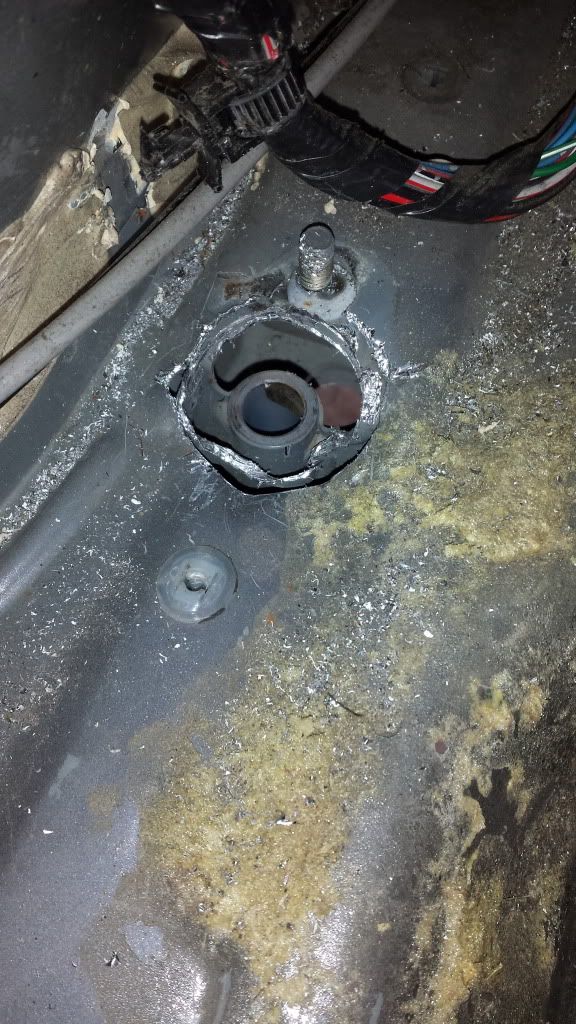

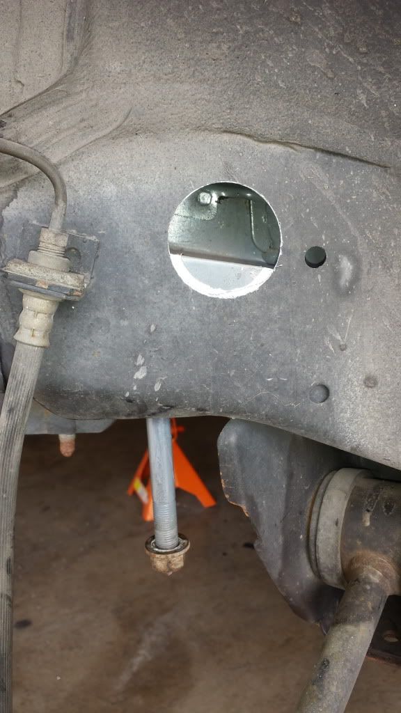

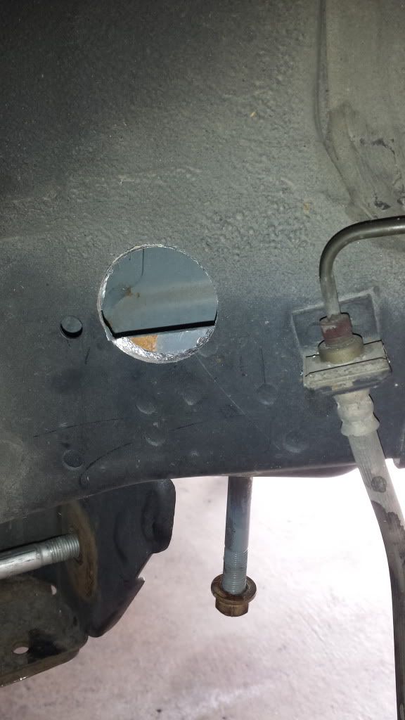

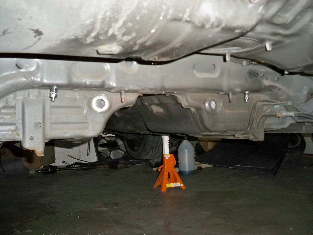

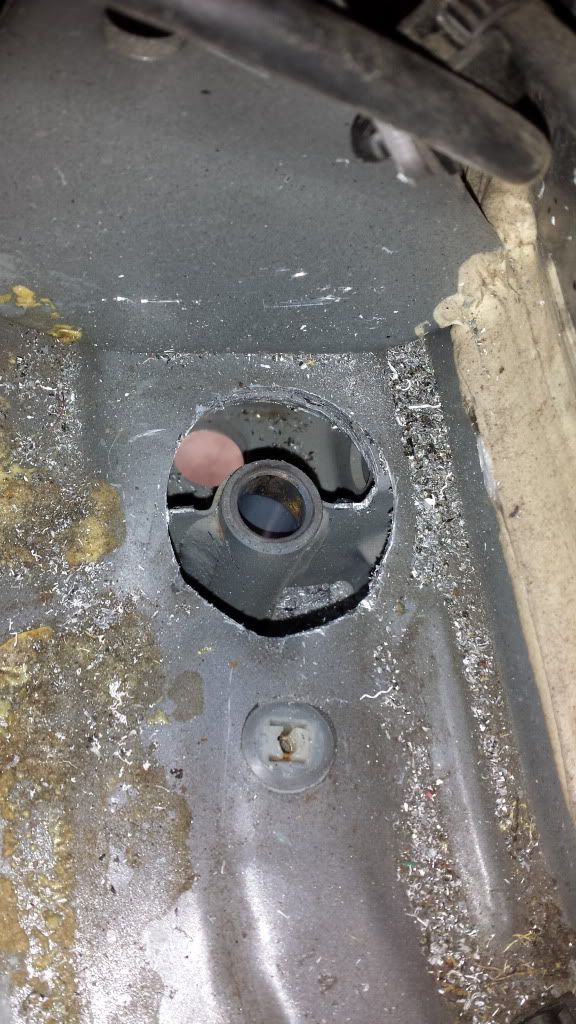

Got the rear subframe bolts drilled out

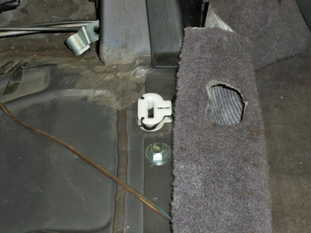

There's two ways to get into the forward subframe mounting spot, Drill threw inside the frame or drill threw the wheel well, I chose the wheel well because incase the bolt spins for some reason, I can put something in there to hold it while we bolt the subframe up into place.
(BTW the hole saw made very easy work of this, Would highly recommend it)

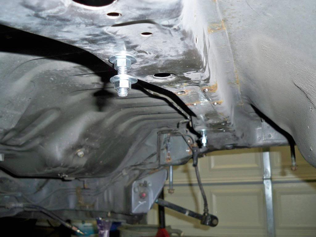

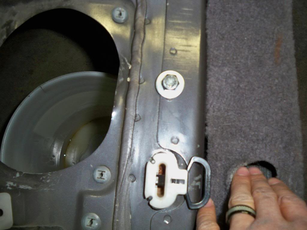

I also got the bolts for the tank straps ready to go, Some people cut from right above the hole location under the car, Jason (JDXNC) showed me his method, SO much cleaner big thanks to him!
For the rear strap bolts, I used a magnet and some finessing and got the bolts threw the larger holes around them without much trouble.

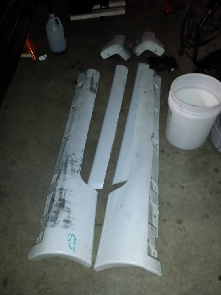

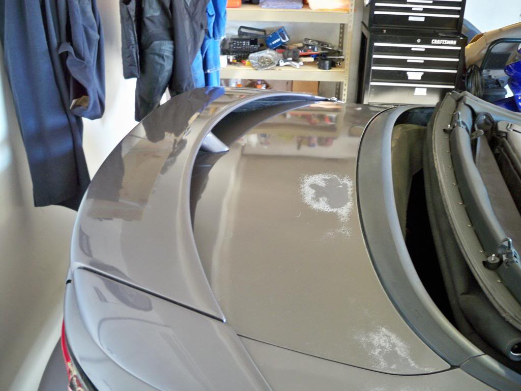

Also if anyone is interested in the 2gb eclipse side skirts or the spyder spoilers PM me with offers as I will be taking them off the car.

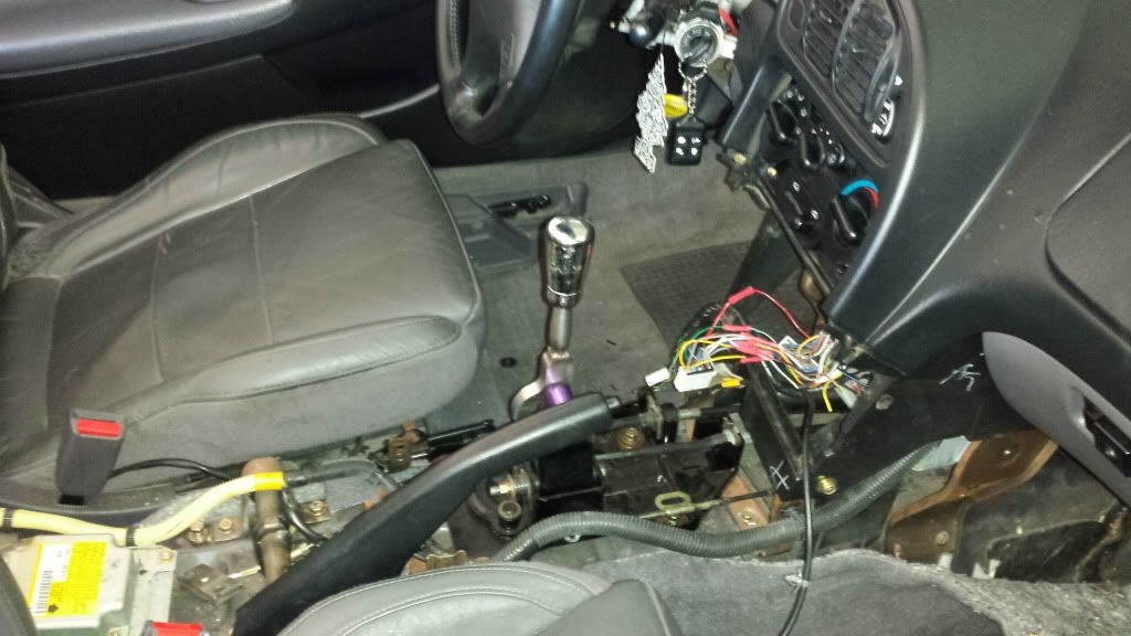

Well I got a little bit done recently, Last week I went and picked up the majority of the parts I would need for the Awd swap, Manual swap, and the talon swap.
(Ignore the auto shifter)

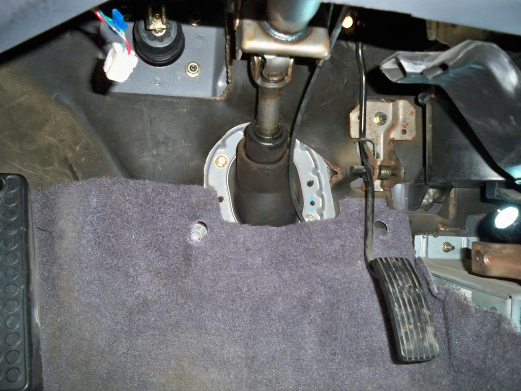

I got a little bored so I decided to remove my TCU and install my shifter assembly and cables. (B&M short shifter and a MOMO shift knob)

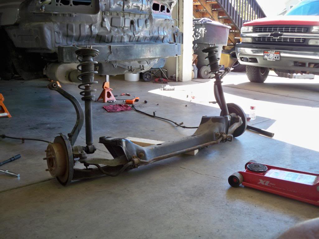

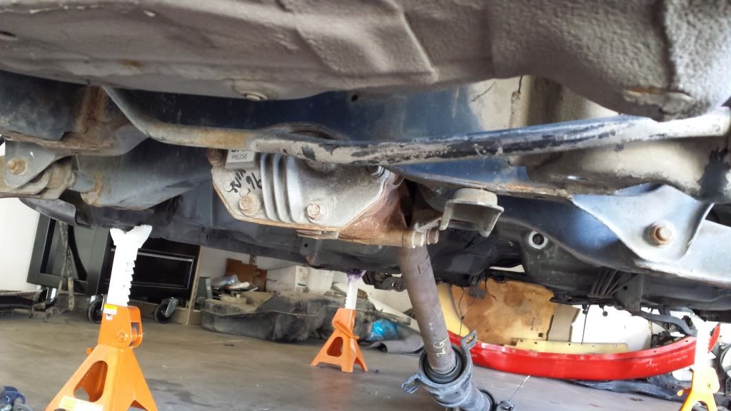

I also temporarily installed the rear subframe and driveline so I could line up where the rear carrier mount would need to be welded.
That's it for now, I also picked up my rear 2ga bumper but it's in front of the car and I forgot to take a picture. I also decided to do an energy suspensions poly bushing kit in the rear since I have it all out right now and one of the bushings was toast. Hoping to have the whole rear end including gas tank and subframe mounted in the next few weeks before winter really sets in.
