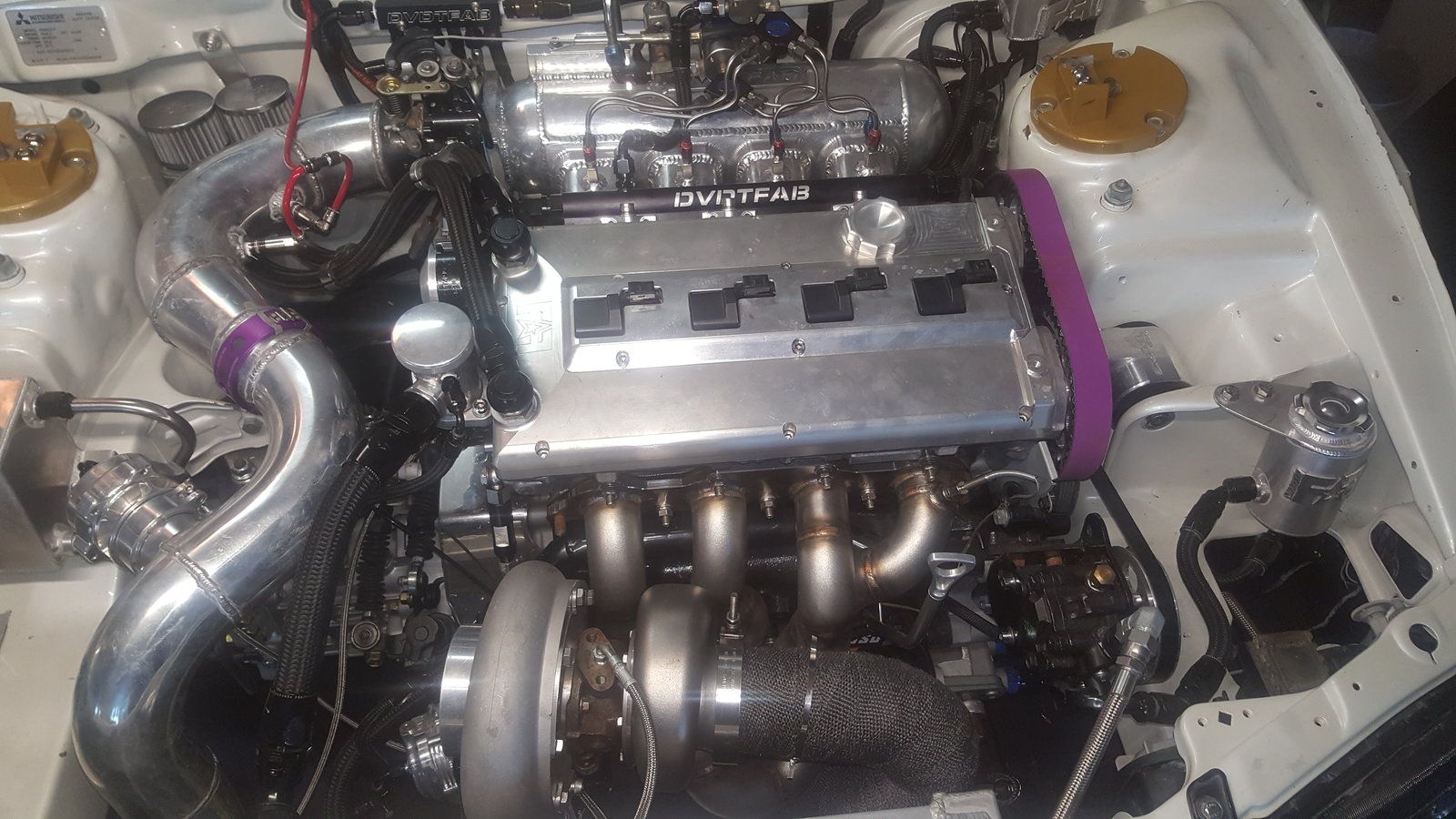

I got my Jay Racing timing tool in today. It made the job of timing the dreaded 4g63 a breeze. I'll be starting her up again tomorrow continuing to work out the bugs.

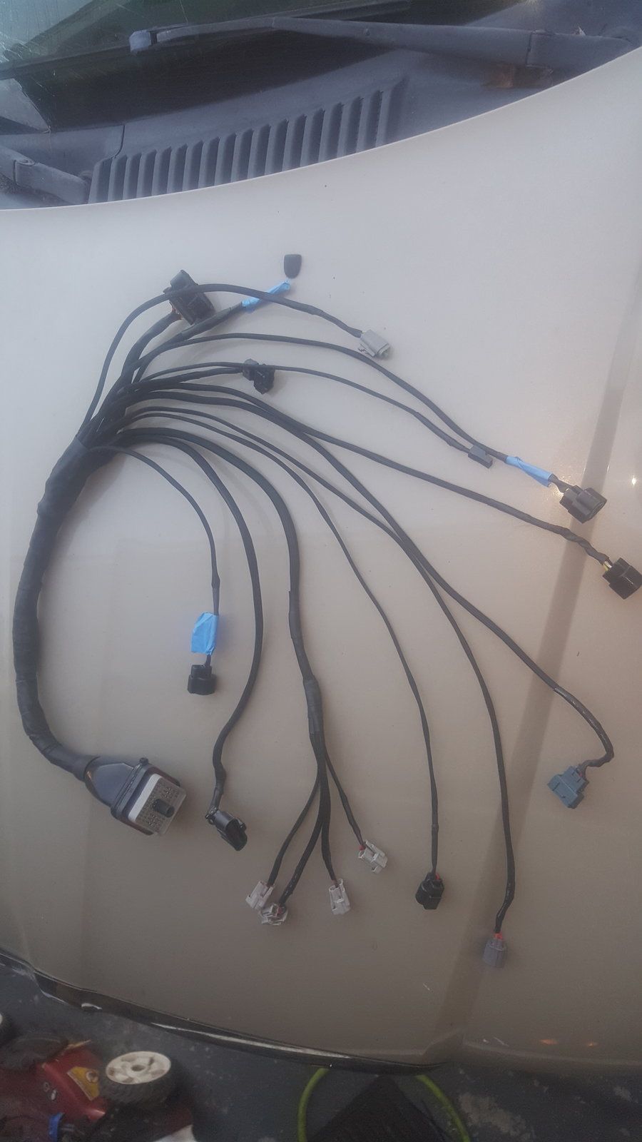

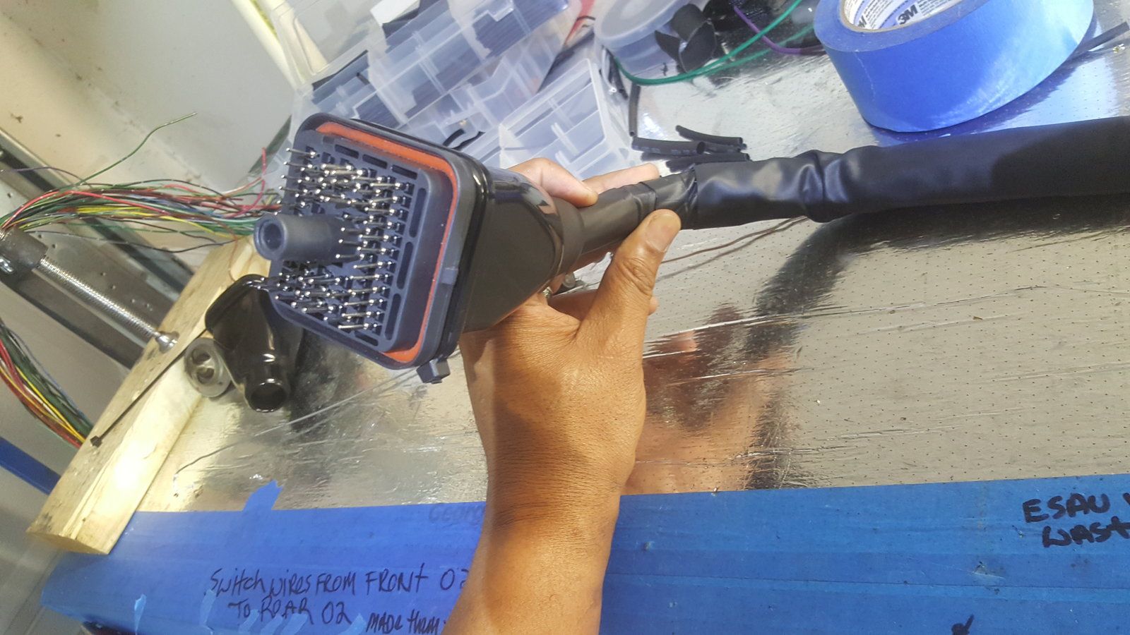

So I will document my woahs and accomplishments. There has been much I've encountered while trying to get her running. Also doing the wiring and different issues.

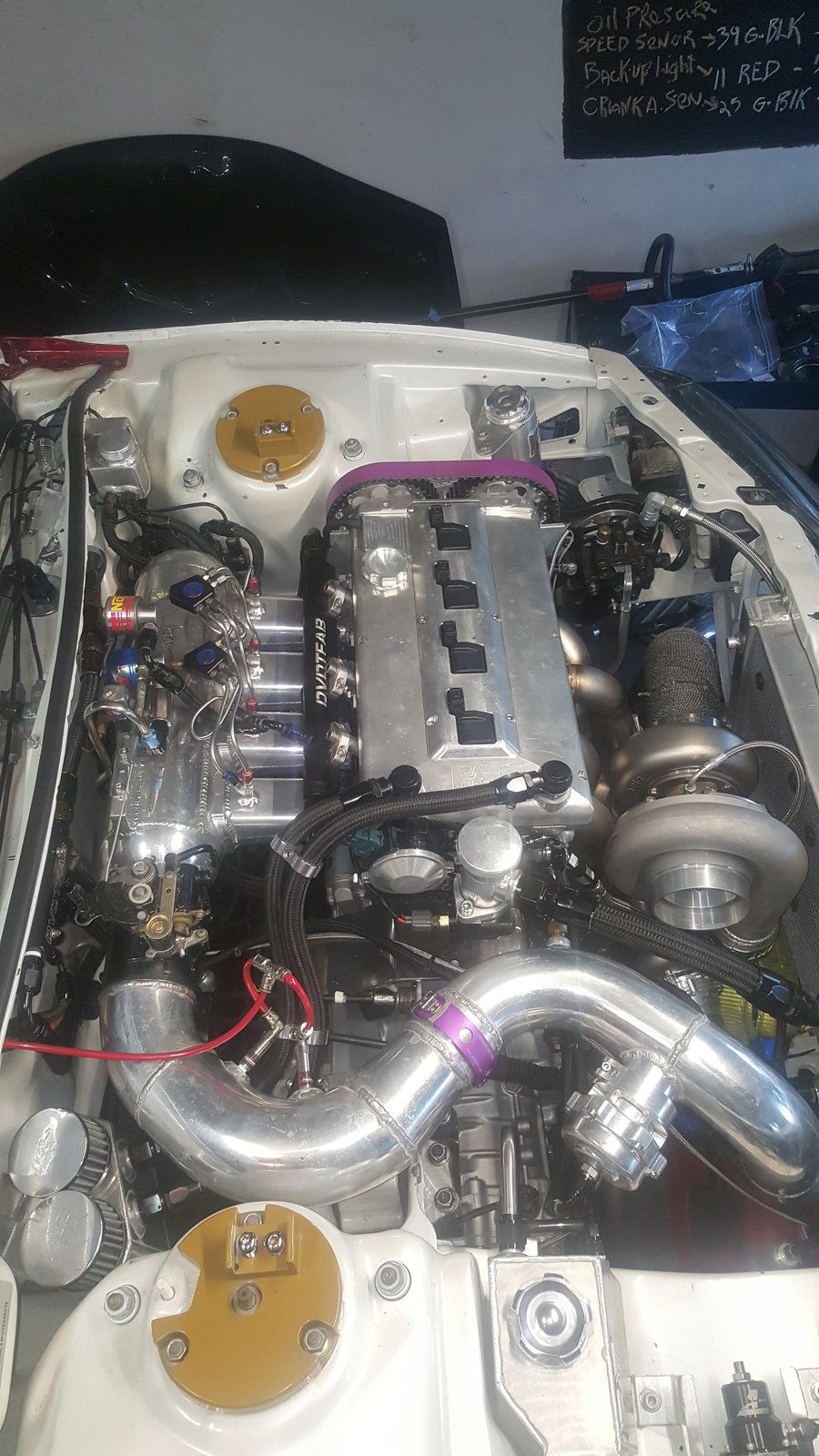

Ok I installed the aem 5 bar. She started right up. I've got some air. Leaks so I'll be doing a boost leak test tomorrow to see where I'm getting air in. Then I'll do dBase timing.

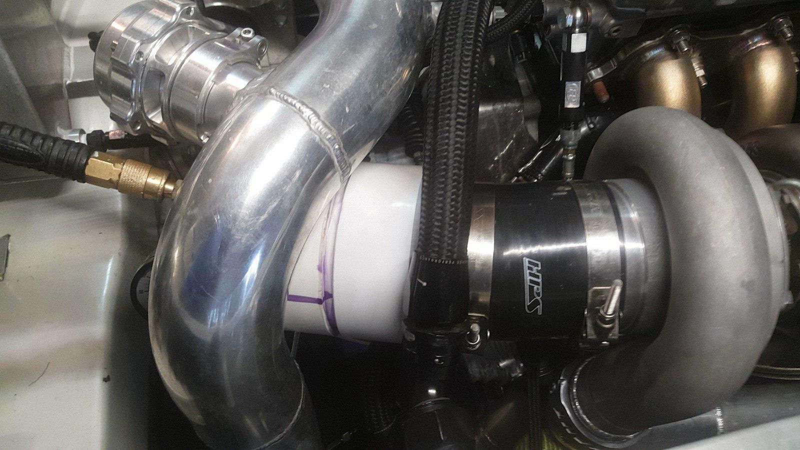

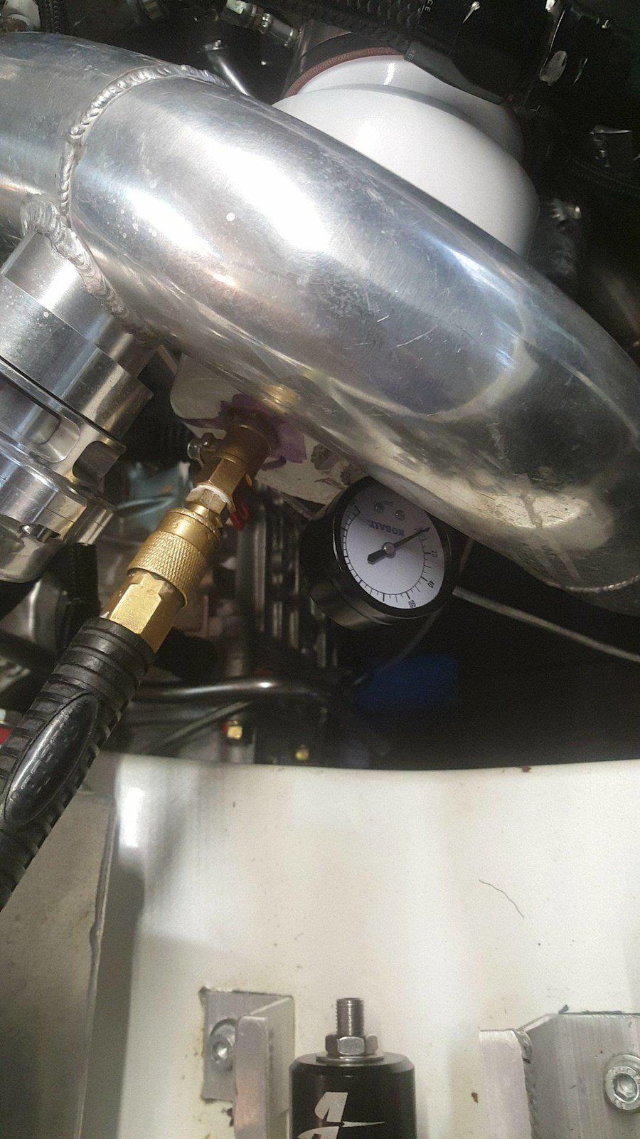

Look what I built. It has been so helpful. I have been able to track down leaks. I had one from my vibrant clamp on the intercooler. Fixed that. I found three leaks on my nitrous lines. I'll be head to get new nuts and couplings tomorrow.

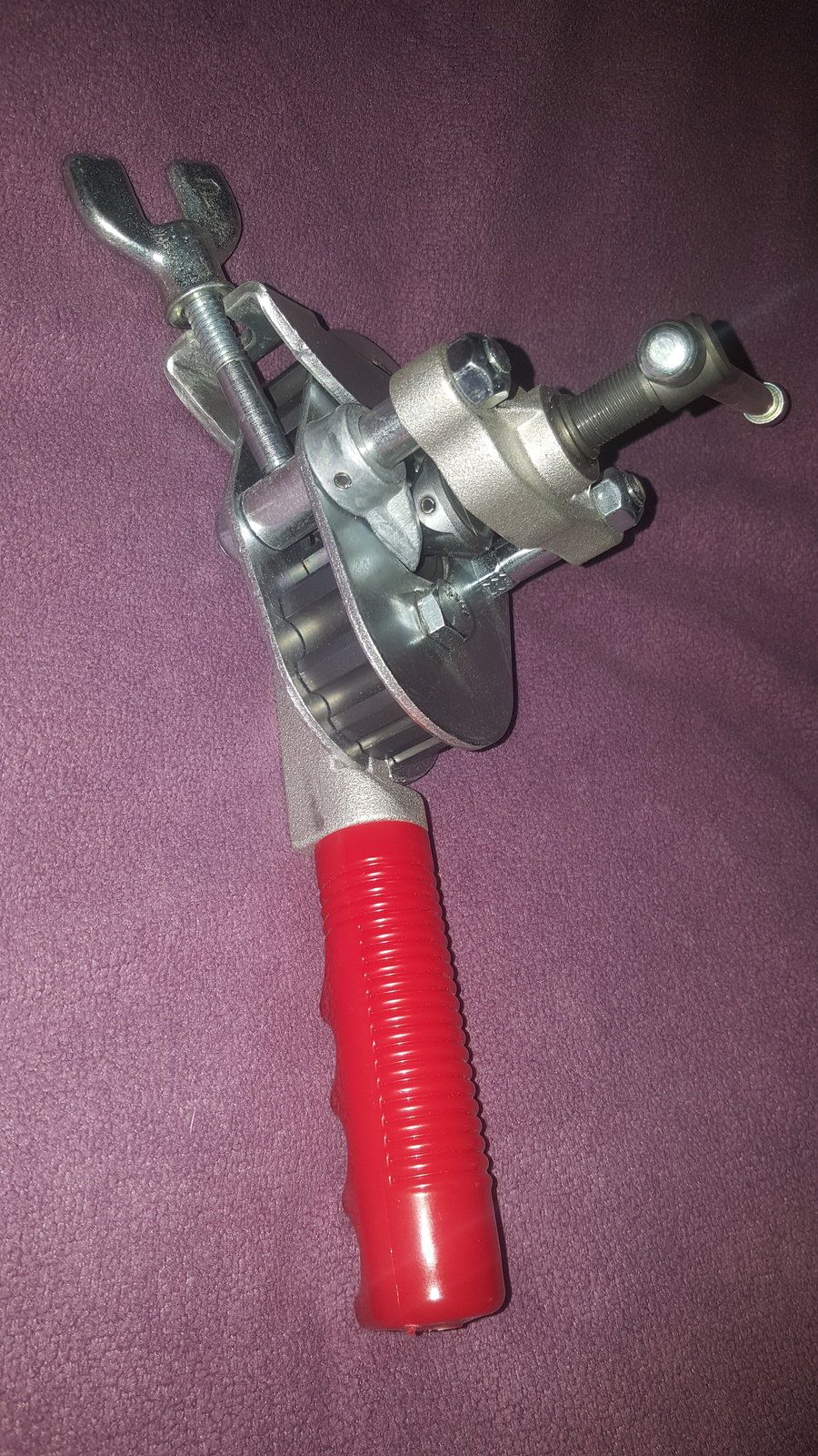

I received my nitrous express flaring tool in today. Time to get those lines re-ran. I've learned quite a bit since I first did them so this time it will be done more efficient. I may also replace some. Of the braided lines with hard lines. We will see.
I got the largest leaks fixed, now its just the little ones. I think I'g to hard-line all of them.
