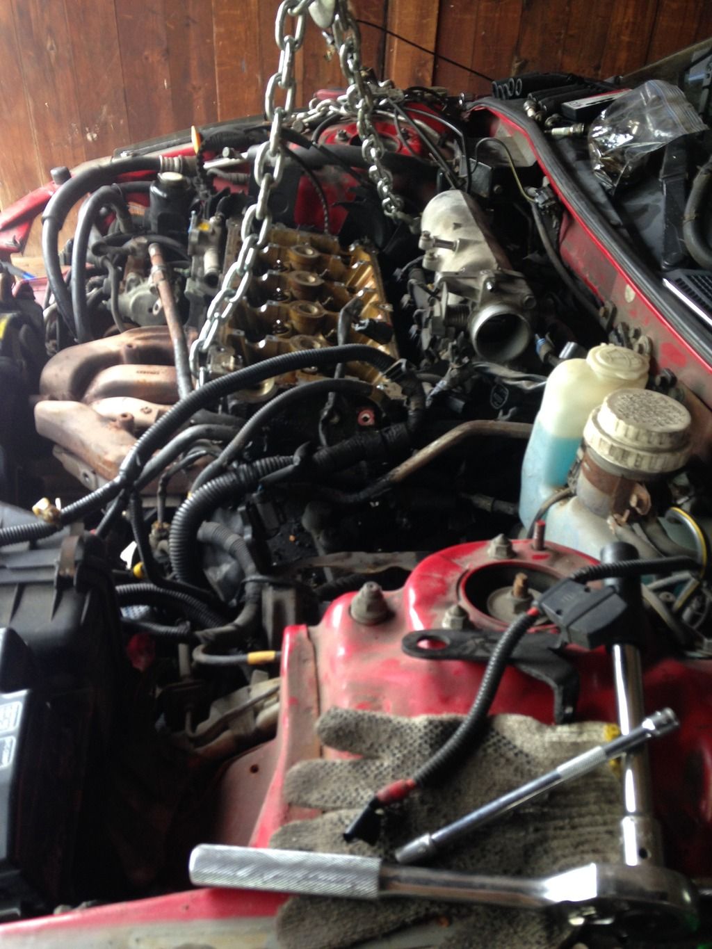

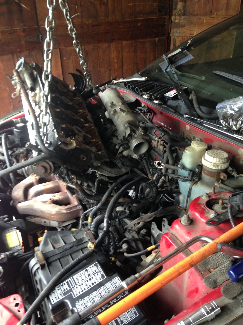

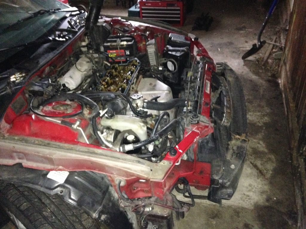

The idler for the timing belt exploded and I feared the worst.
I pulled the cyl head and ALL OF THE VALVES ARE CLOSED! There are no impact marks on the pistons and the valves look good.
THAT was a HUGE bullet to dodge.

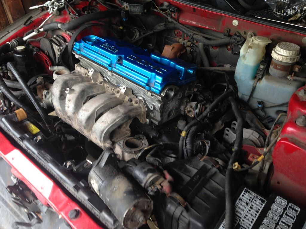

The starter solenoid is in the way of the intake. That can be fixed with a different starter. Or it may clear it with the taller 2.4 block.
The exhaust has about 3" between the axle and cross member.
A bit of cutting for more clearance and some welding reinforcement and that should be clear, too.

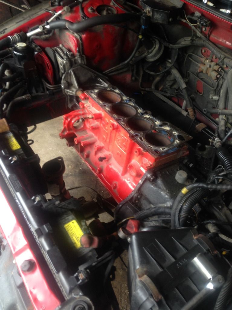

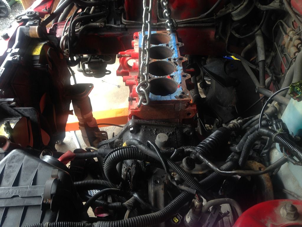

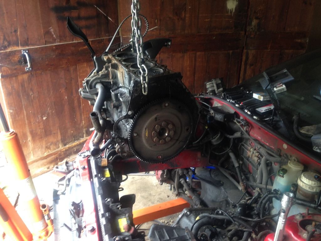

What a PITA. Ive never pulled JUST a FWD engine without the trans. Never again. I had to remove all of the accessories to have enough room to get the flex plate to clear the trans. I unbolted the flywheel/clutch from the flex plate, which was fun... I bought the crysler crank pully puller which made removing the pully so much easier.
Testing the fitment of the 2.4 block so I can see what needs worked on.

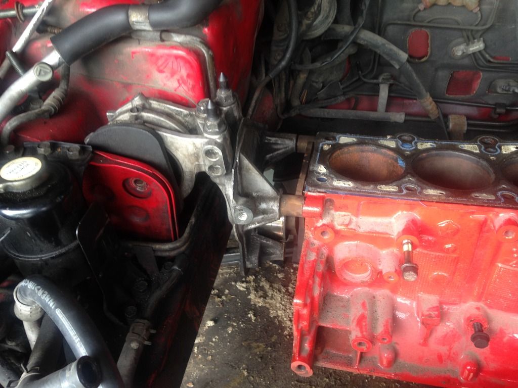

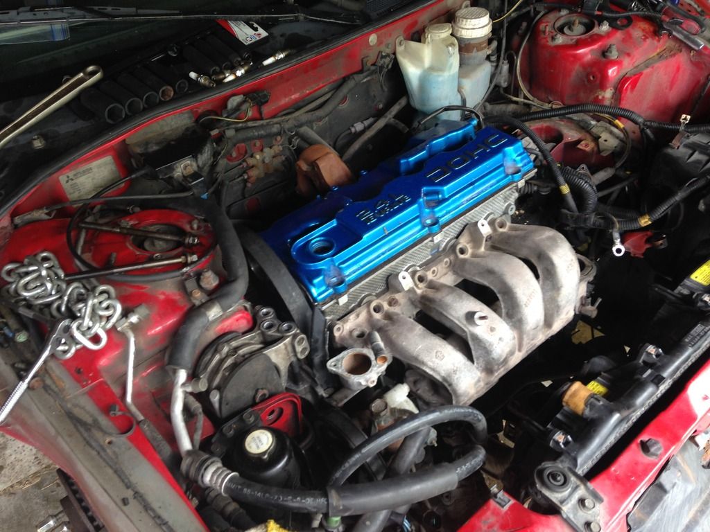

The 2.0 mount fits? I thought this was supposed to require a custom solution..
It fits.. And bolted in place...

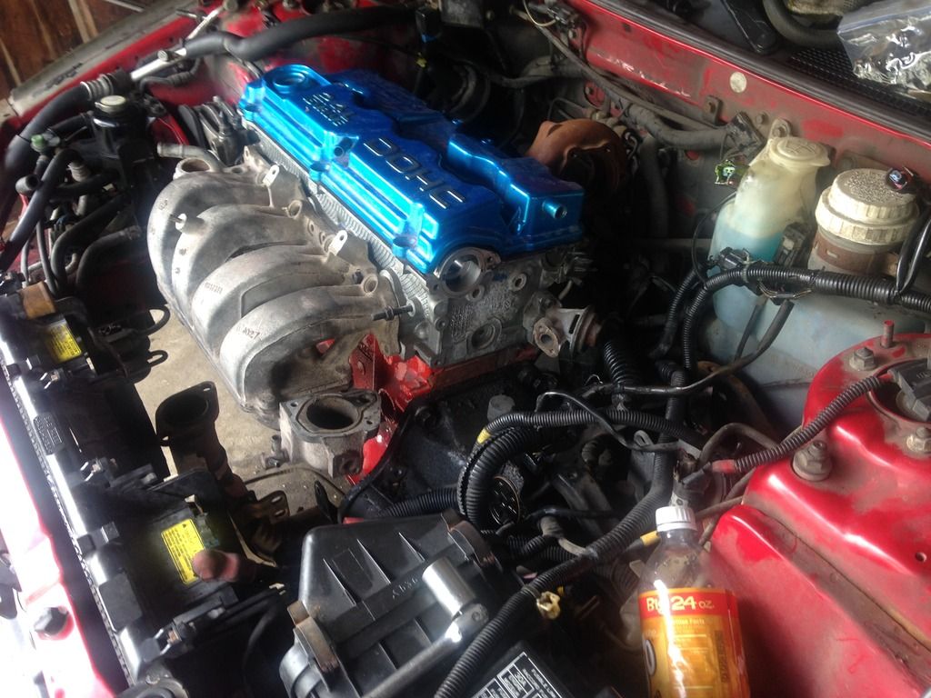

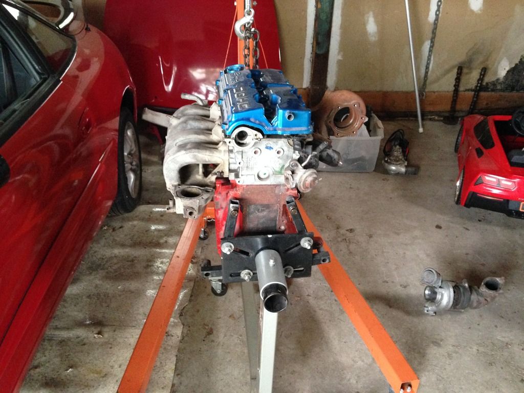

Dropped the regular 2.4 front intake head on the block.

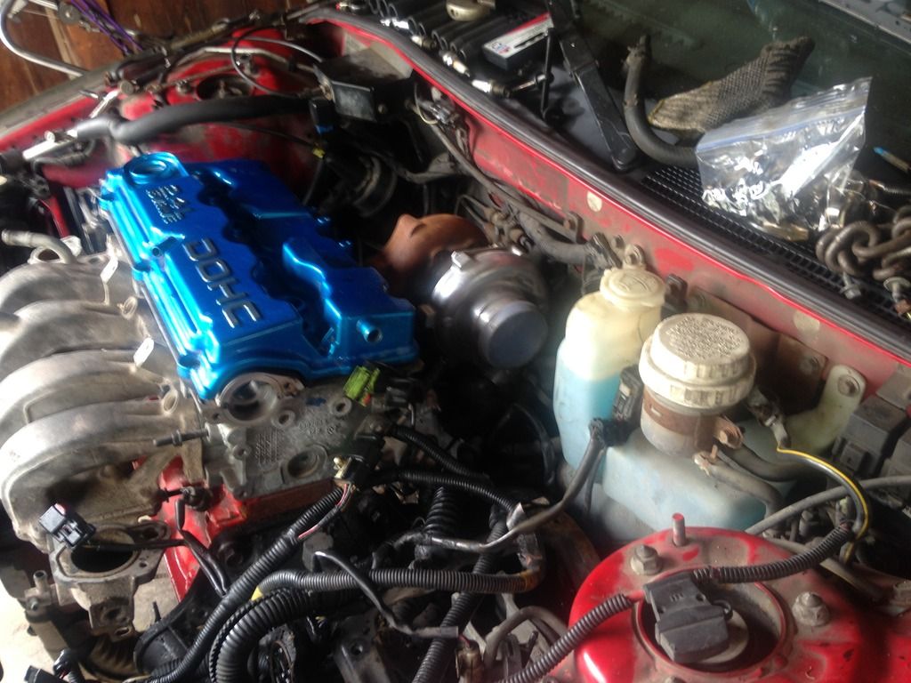

Testing clearance for the T3/T4 turbo.

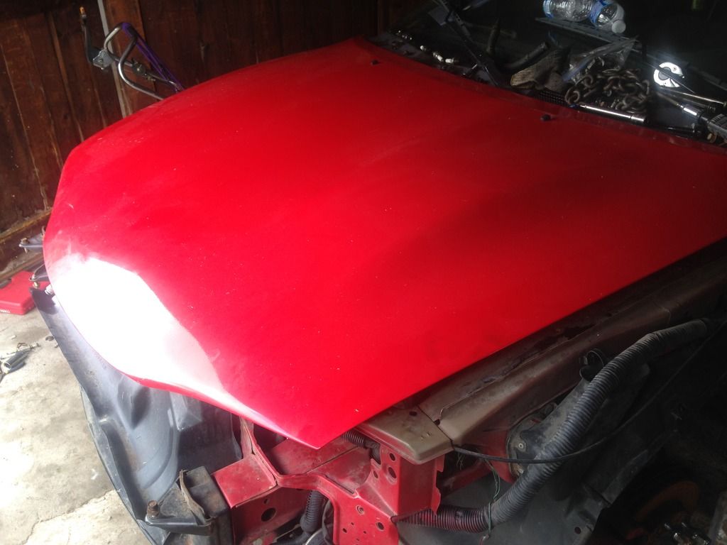

Checking hood clearance. The valve cover hits the hood pad just as the hood is latched. I may need to get a bit creative with clearancing the hood braces, but the hood is latched in the photo.
