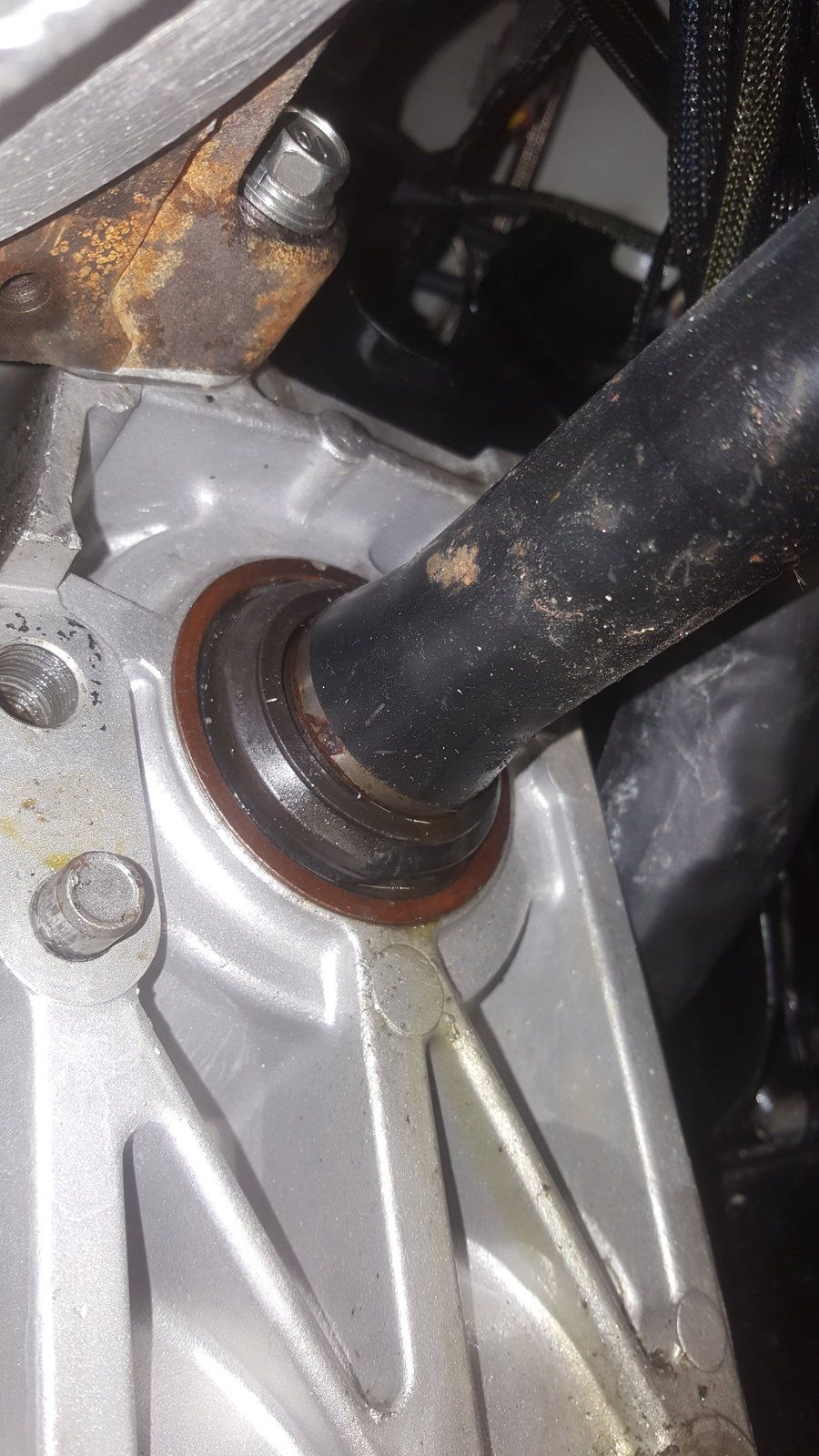

Found my leak. Is this the one that I need to pull the tranny for to get to it from the inside? Or pull it from here? Also what part do i ask for at the parts store?

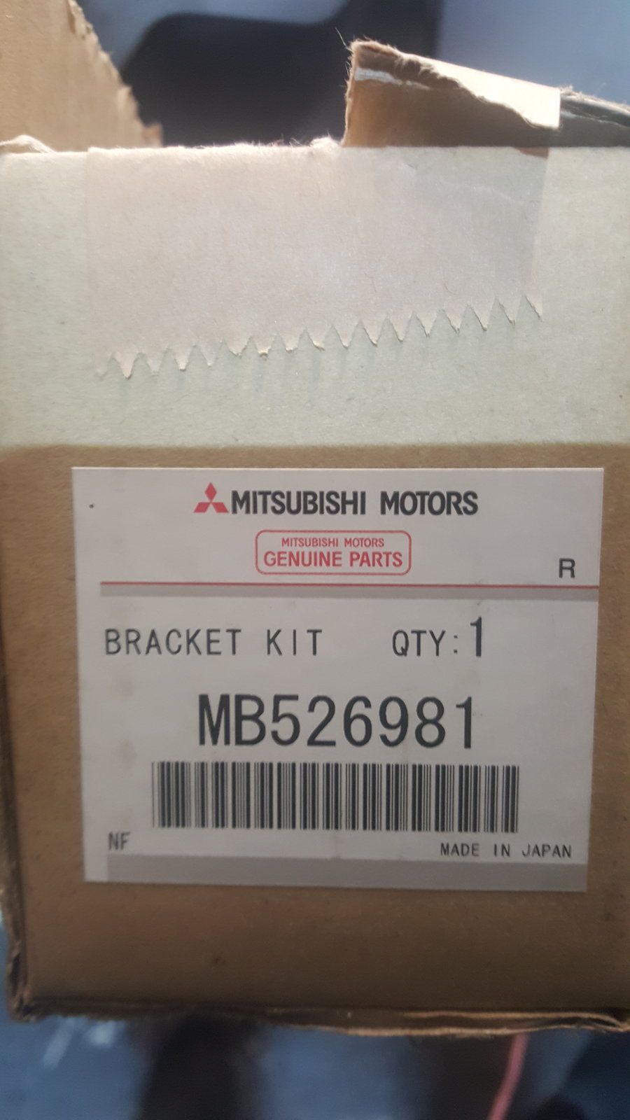

Hey guys, I figured out my issue with my seal leak. I was using an auto bracket. The part number for the one you need is,
Bearing Support MB526981. This is the bracket for 95-96 manual. They look exactly alike. I measured them and they came to the same measurements. You cannot tell by looking at them. However, when I bolted it up, it was perfectly centered in the seal. I wanted to post this here so those after me would know.
I
here you area Again this is the manual 2g bracket. It is to be used with Jay racing alternator relocation kits . I have a 6bolt swap . Hope that helps

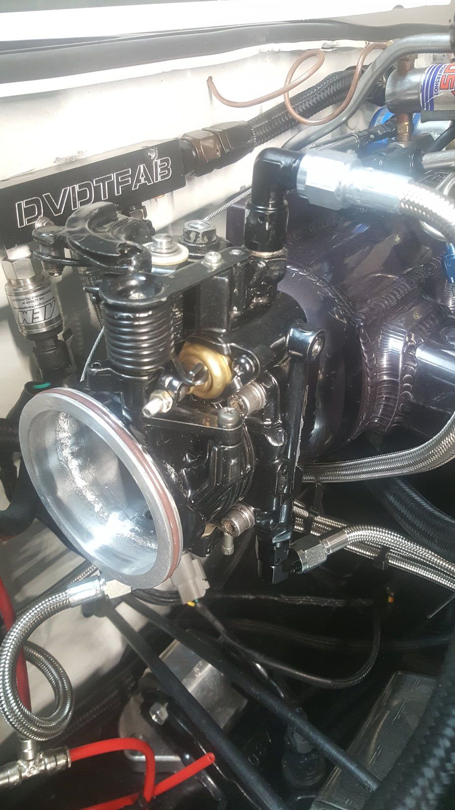

Cold start hooked up. Got tired of holding the throttle down for an eternity.

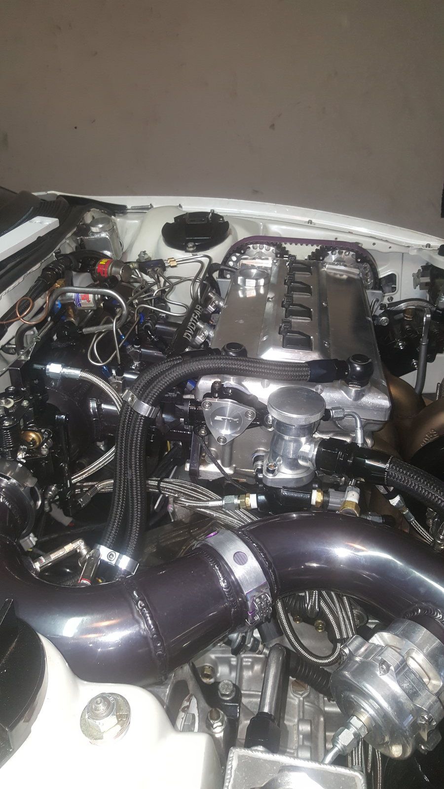

So as you can see, I had to go back with a 2g cas. I was previously using a black top. My question is, do I now have to switch my firing order back as well as uncheck the non 95-96 cas box in link?

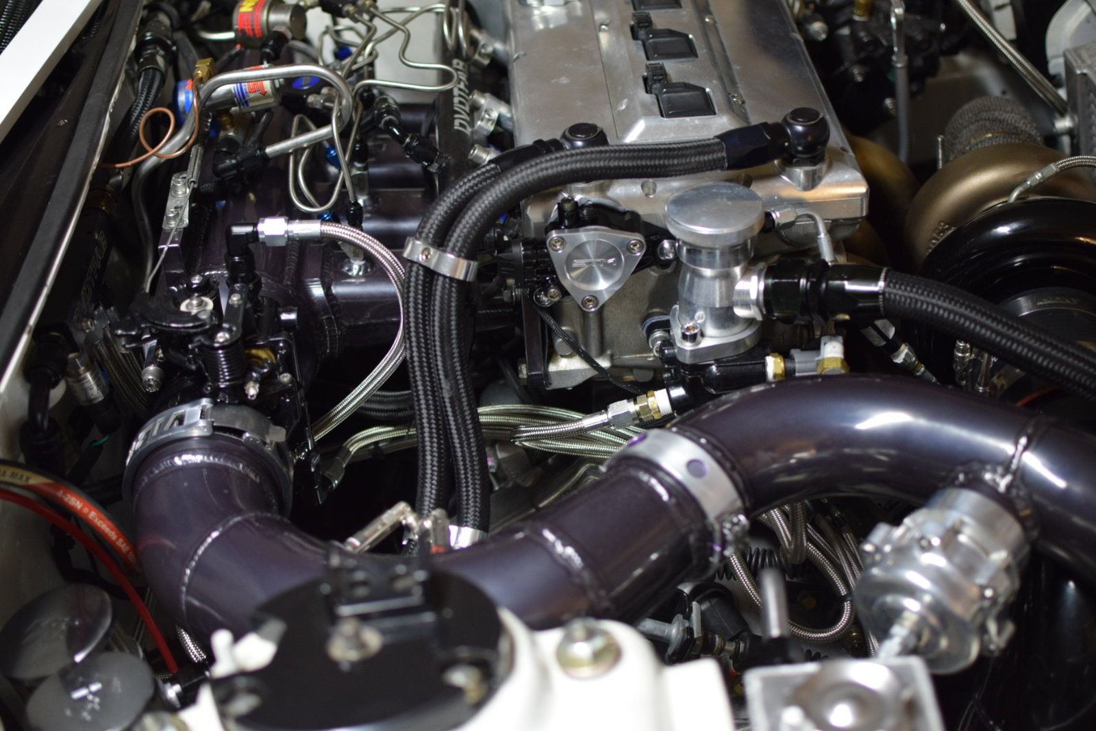

Better pic. I also got the turbo powdercoated. Fixed the trans leak and small exhaust leak at turbo.

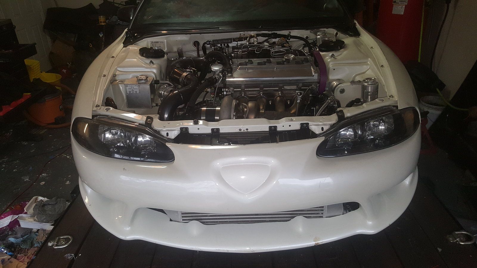

Well I got Gracey dropped off at Tractime Performance to get the suspension dialed in. Cant wait to get her back. She has only been gon for a day.
