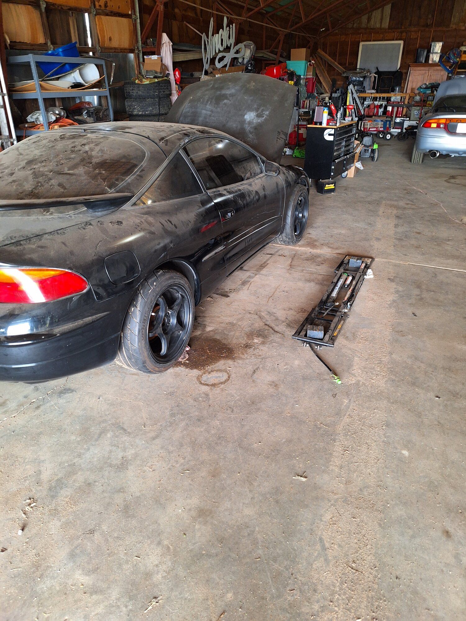

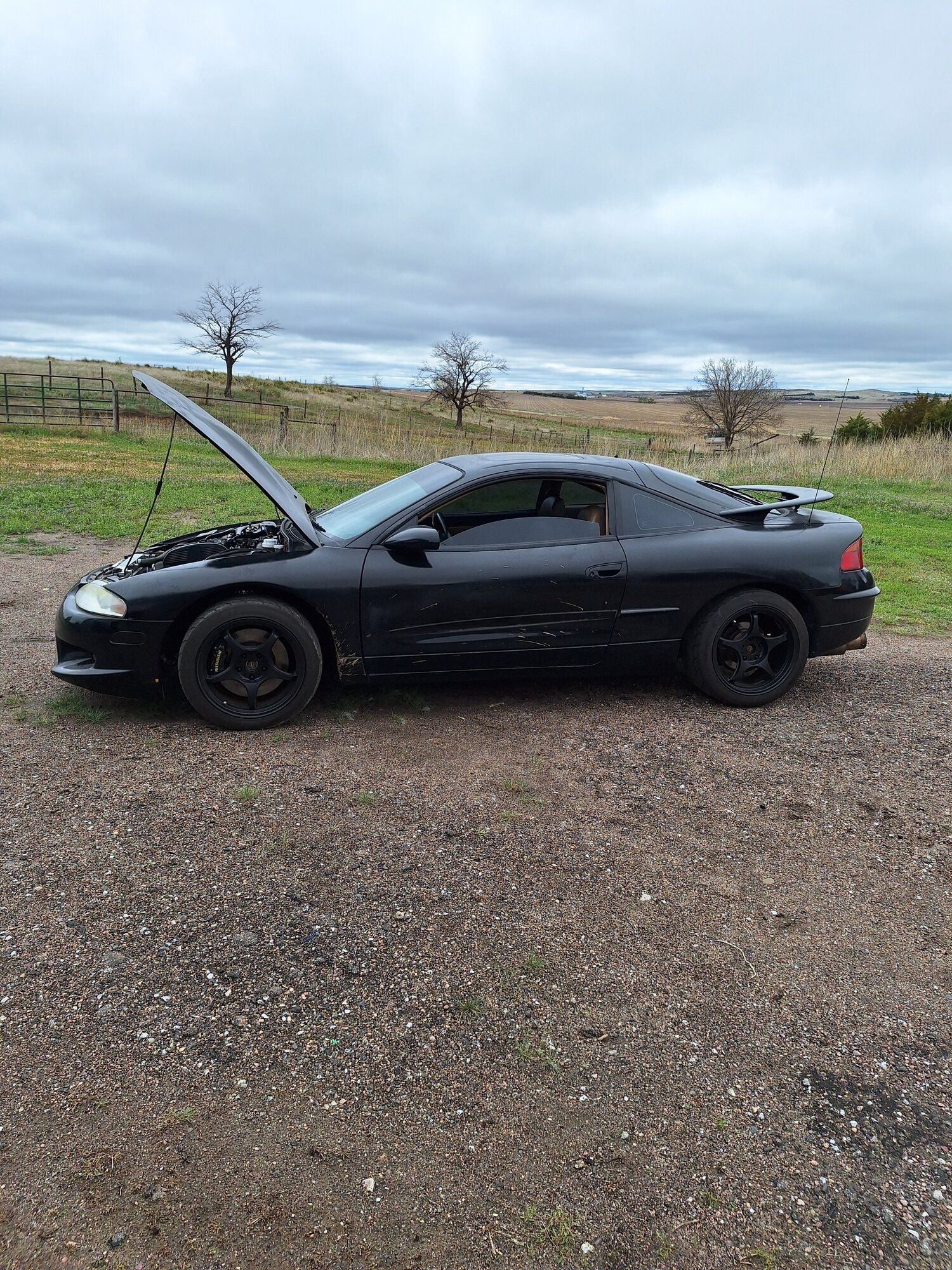

It's about time I've updated this thread after 12 years of hiatus.
I parked the car 12 years ago because I was having problems with it passing Colorado emissions. Then life happened, met a girl moved states and got into other hobbies. I finally got the DSM bug again and I got this thing back up and running.

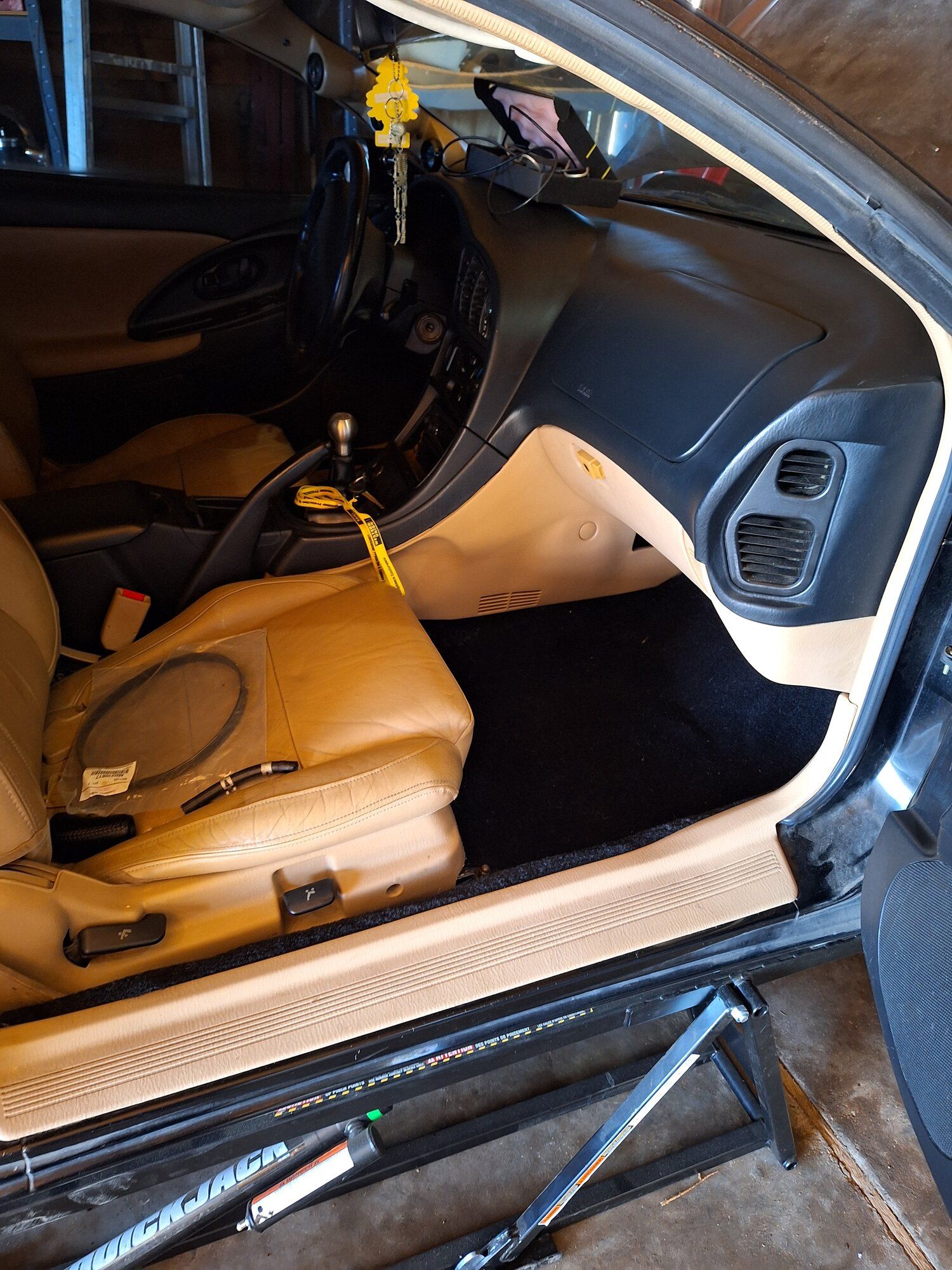

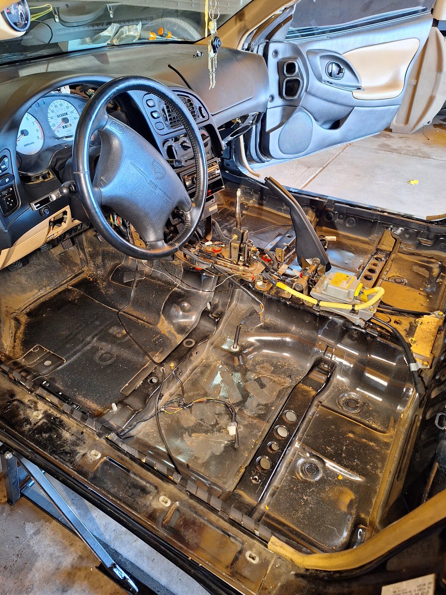

First thing first, I stripped the interior to clean it after some new residents moved in. Deep cleaned everything, carpet cleaned the carpet ect. It smells amazing inside now.

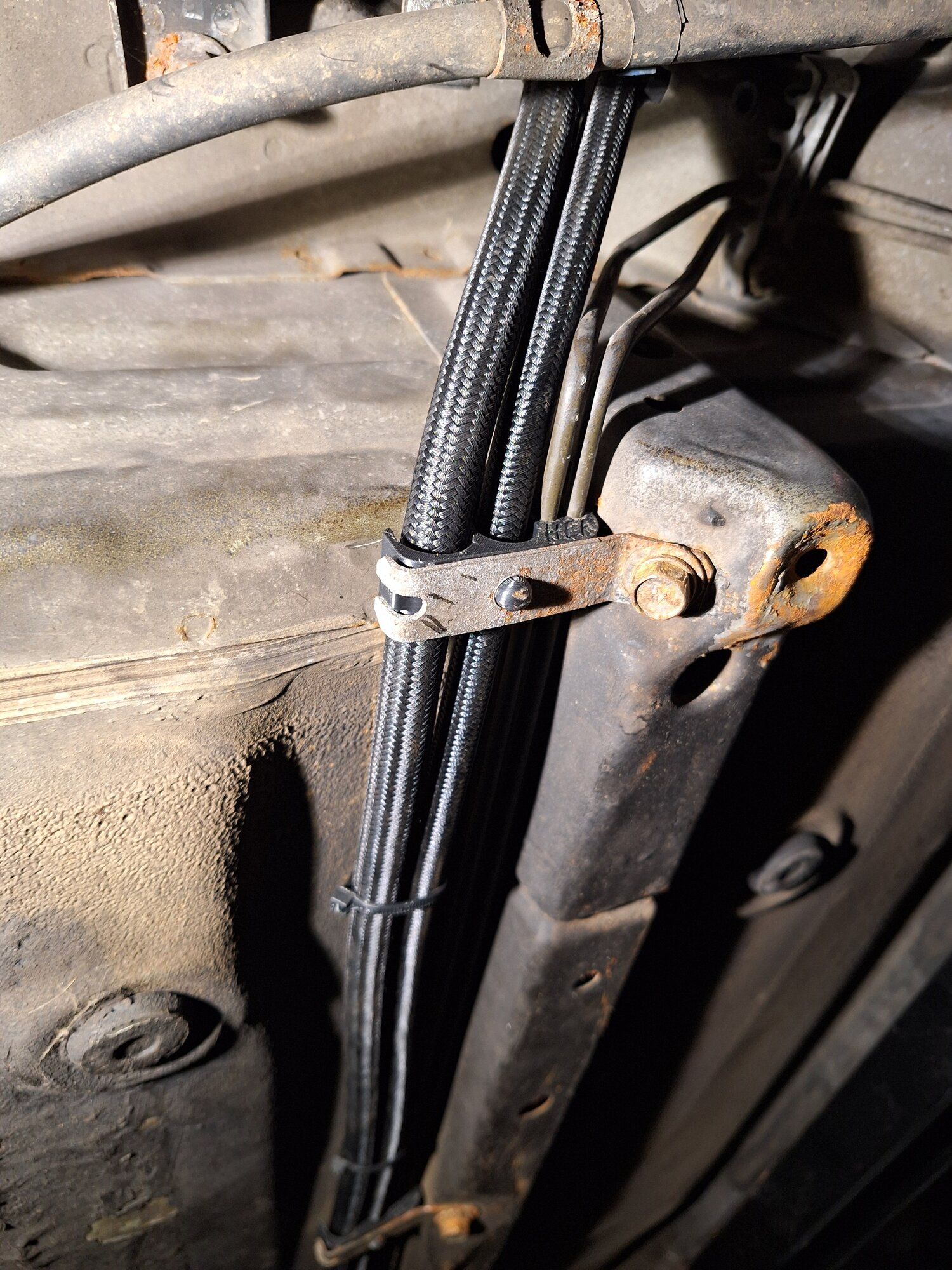

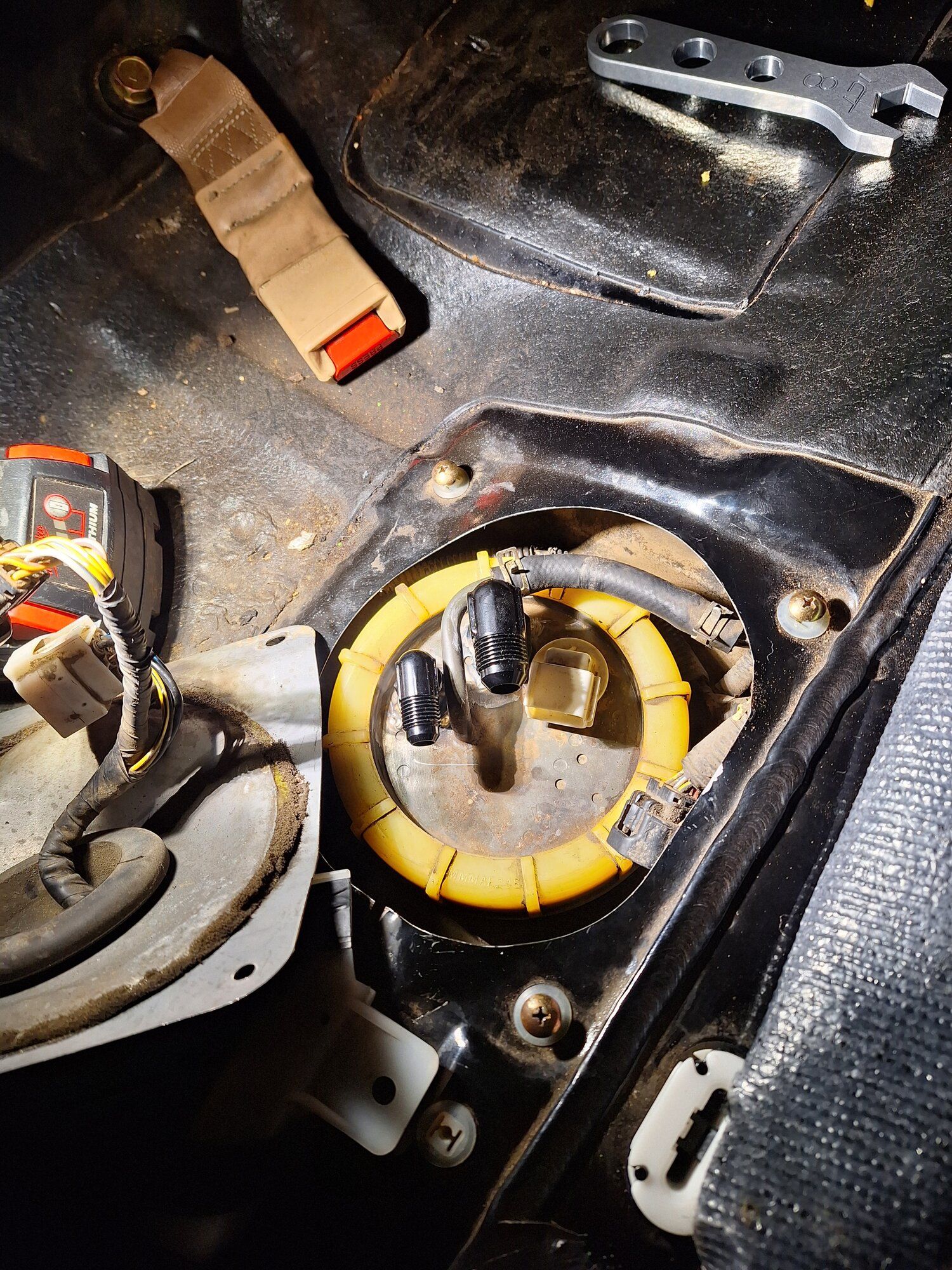

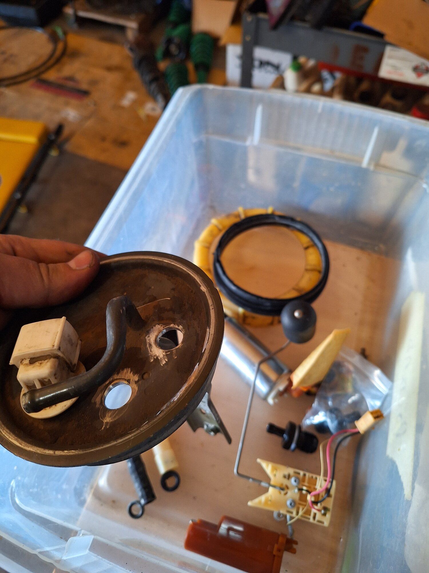

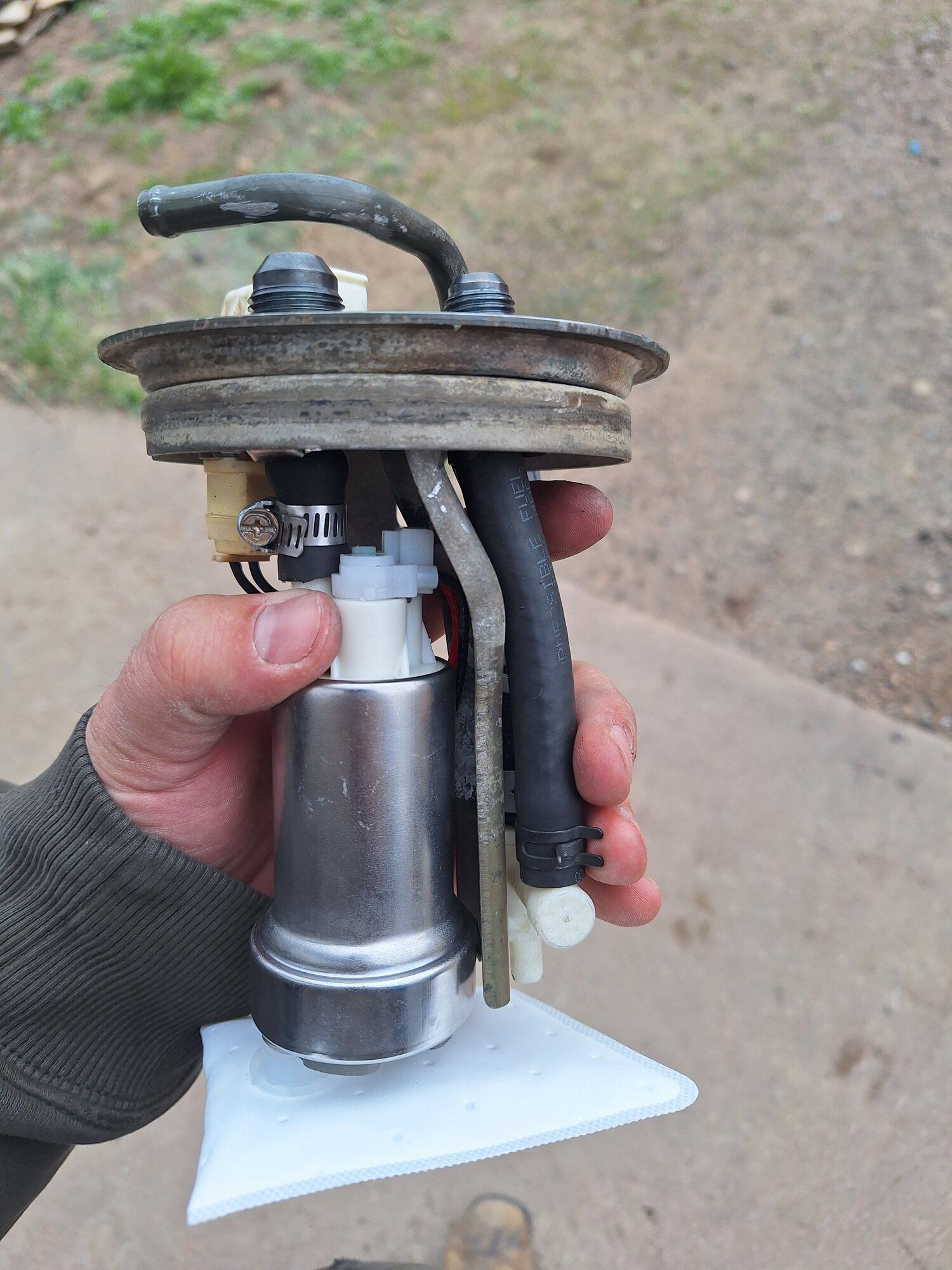

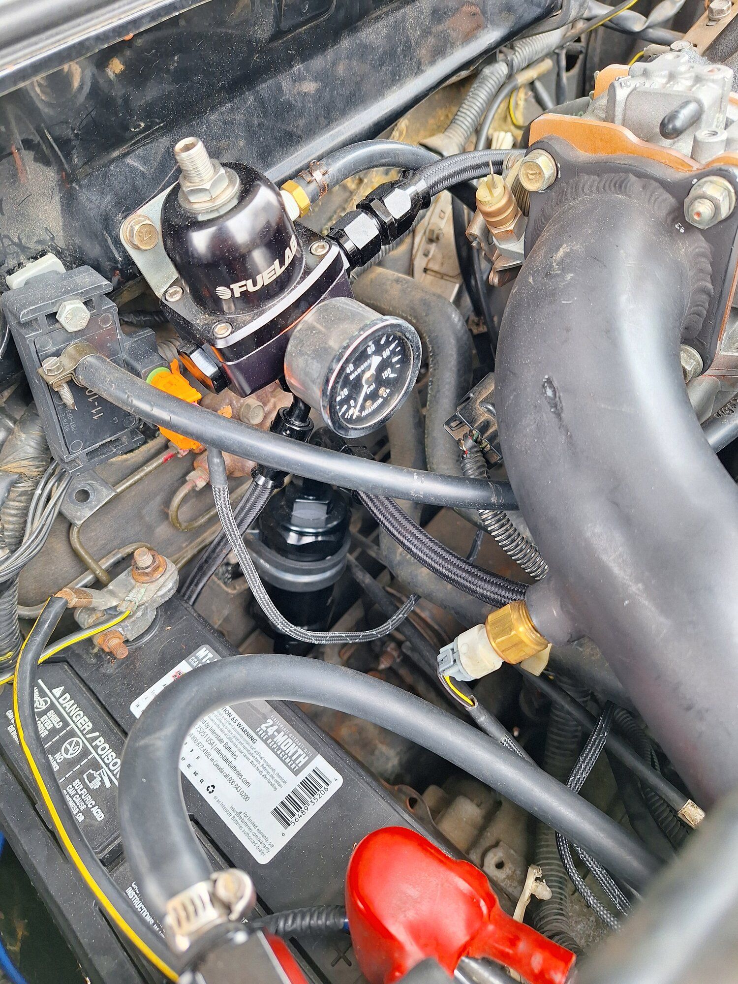

Next was to tackle the fuel system. I had left e85 in the tank/system that entire time. Good reason to start fresh. I cleaned out the fuel tank completely, and had my brother weld some AN fittings on the sending unit. Went 8An feed and 6an return with a Walbro 450.
I also did a fuelab filter with fiberglass element and a new FIC fuelrail. Sent my FIC 1350's in to get cleaned. 3 of the 4 were stuck shut, and they improved on flow afterwards too.

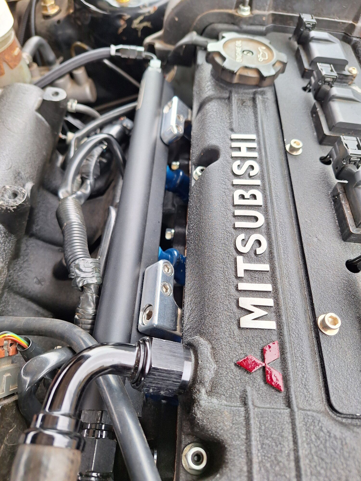

I obviously upgraded my valve cover. I liked the Hal breather cap, but fittings on the VC are much preferred.

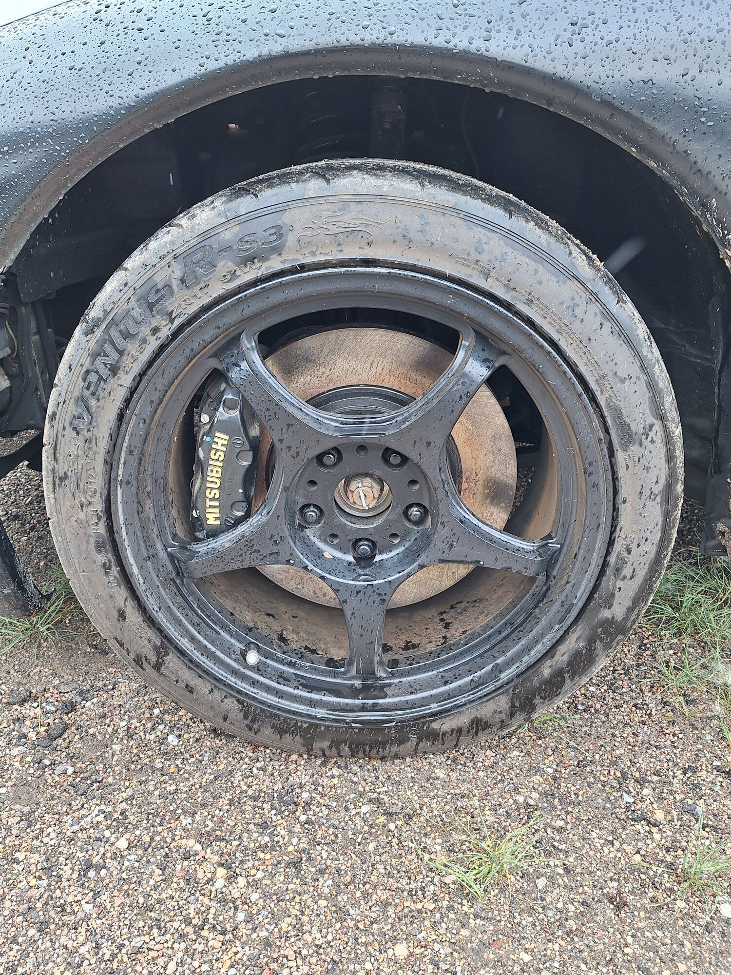

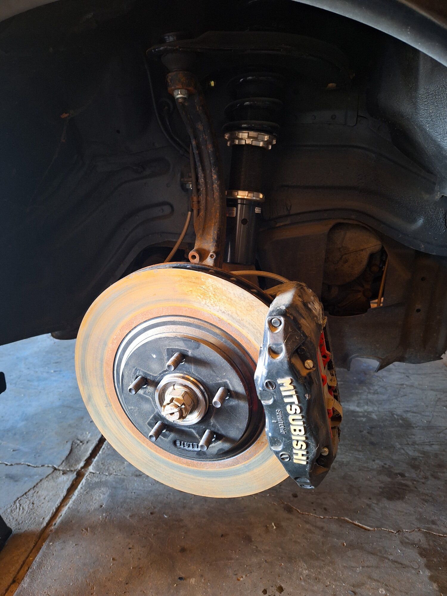

Also finished the VR4 front break swap. I got them all torqued and blead.

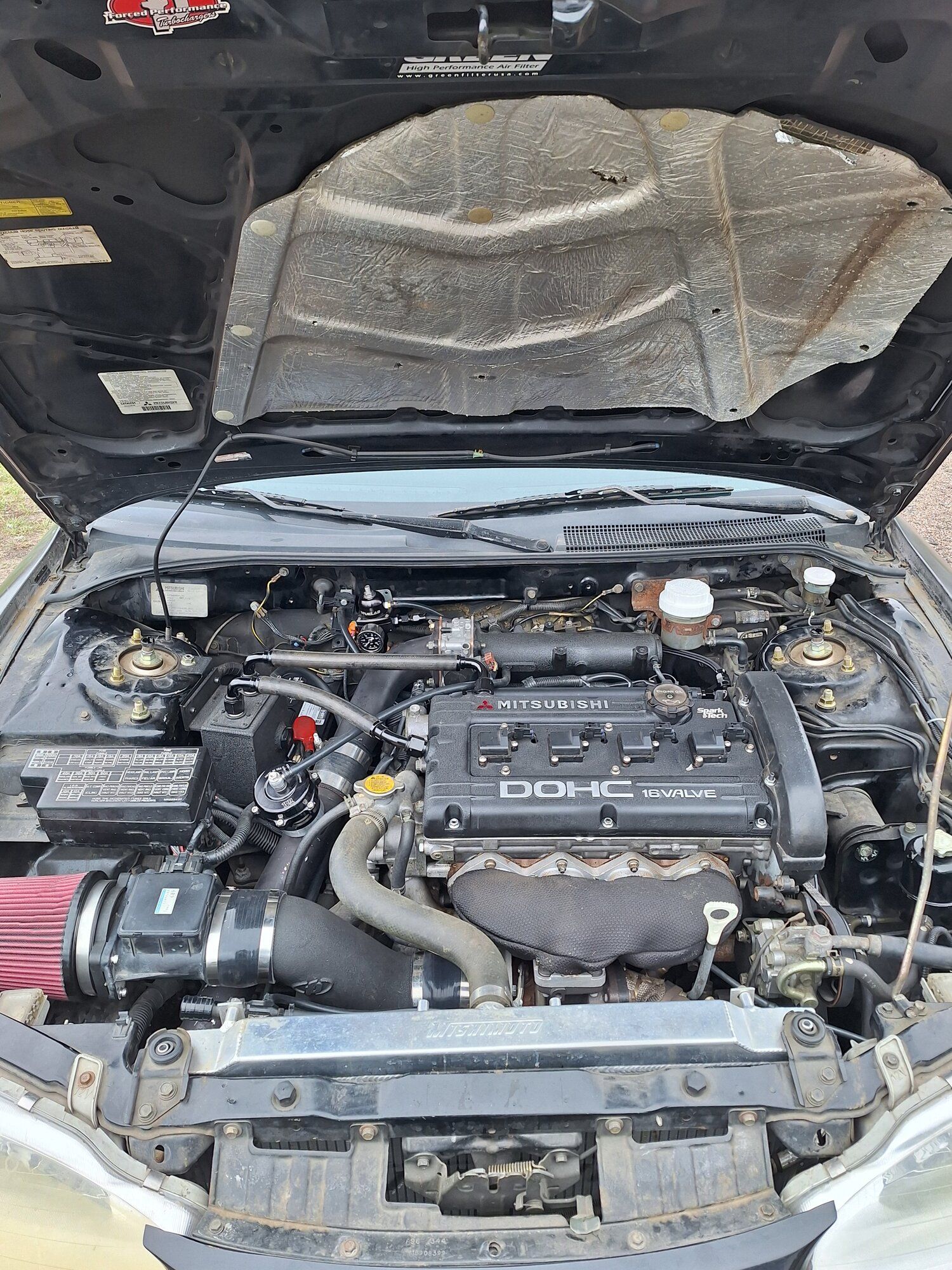

I filled her up with some fresh E85 and tried to start it. I'm so rusty with ECMlink. I tried to get it to run on speed density, but I failed miserably. I swapped the MAF from my other talon and changed some settings and it fired right up. I took her for a few drives today and it went amazing.
Finally off the lift after so long!
I can't express how good it feels to have something finally running after so long. I'm starting the remote tune process now. I'm sure there will be a few bugs here and there, but it's almost done. For now at least...
