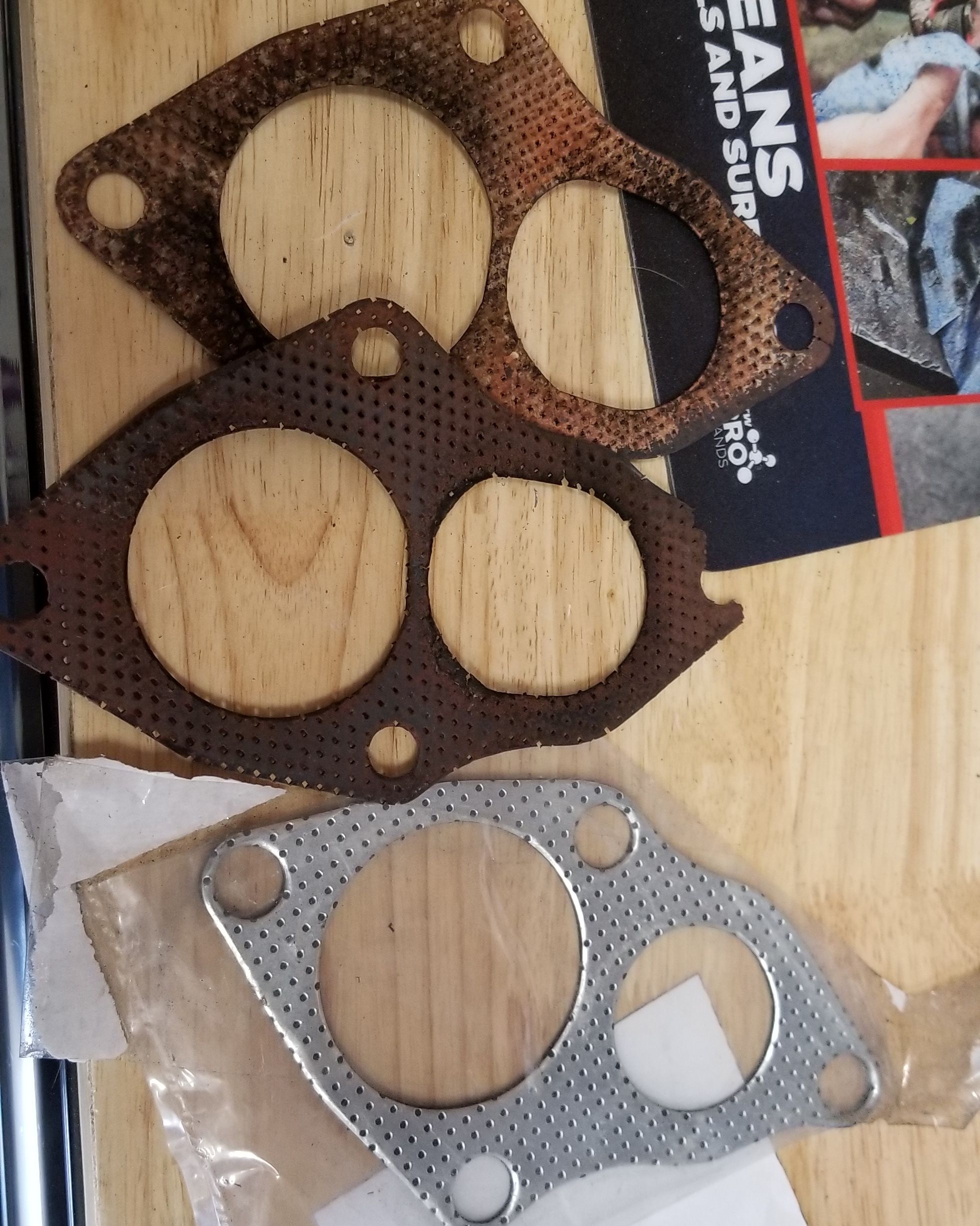

Finally got around to fixing my exhaust leak and installing my ss o2 housing! This wasn't as easy as I remember it being but it came out after I found my issue.
For some reason I installed the lower most bolt I used one with a 17mm head instead of 14mm. That made it a challenge but I ground down a spare 17mm socket and removed my oil dipstick to get it on there.
Here's how the gasket looked, never use these they always fall apart like this is live and learn
I replaced it with the STM gasket and she purrs like a kitten.

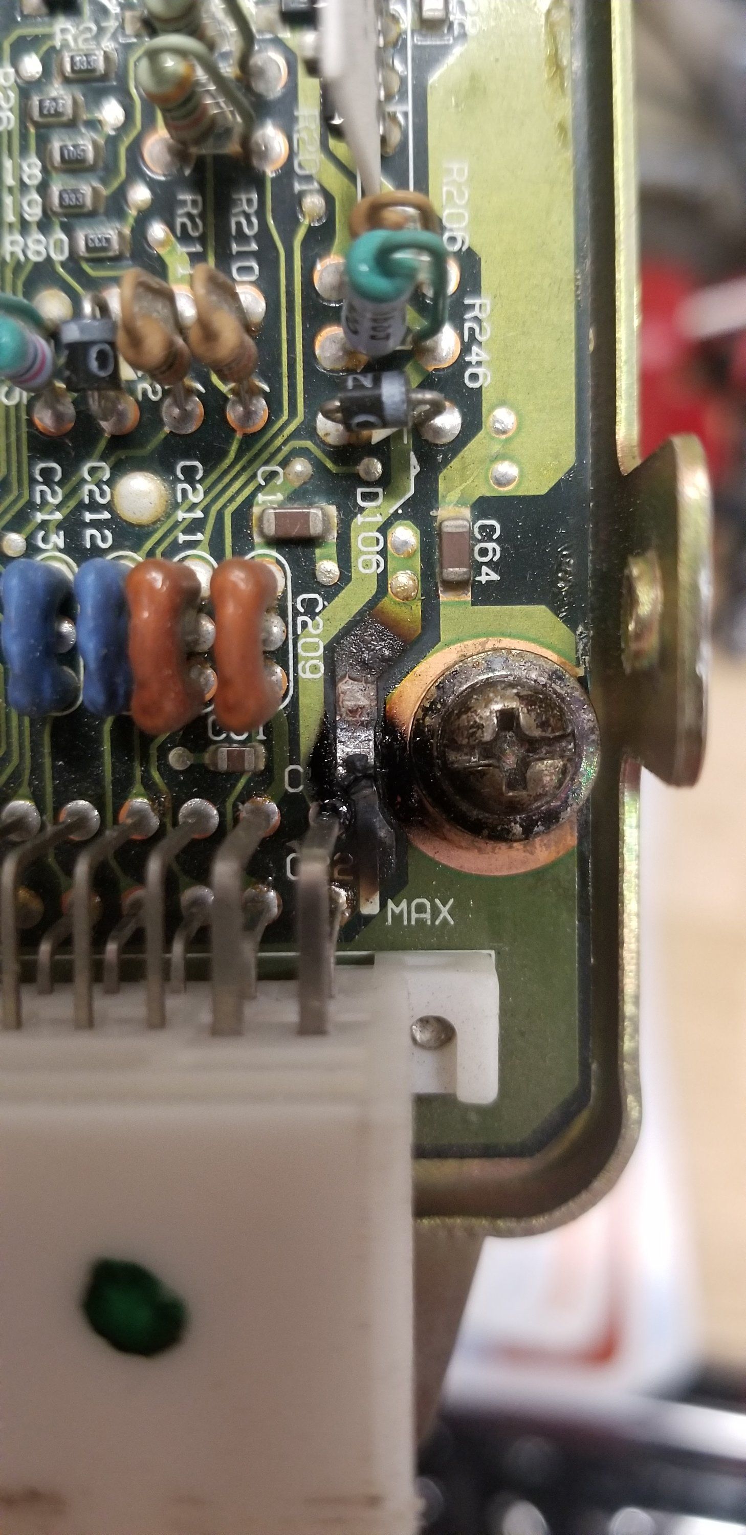

Hey guys and gals I have an update that kinda stinks.
I went to turn the car on last Tuesday and it just wouldn't run, checked everything as far as sensors and battery no issues there.
Pulled the ECU and this is what I found
I shipped it out the next day to ECMlink and Thomas and Dave have recieved and are going to repair it for me. Turns out it's a blown sensor ground.
I went back and looked at my logs and my damn alternator has been spiking to 15.2V once in a while. That is getting switched out and asap.
Do not hesitate to support ECMlink they are such a great company and these guys do this for our platform for what seems like pennies on the dollar. Couldn't be happier with the communication and detail on my repair order.
Stay tuned kids!
Hey guys and gals! I'm back with some good news!
The spyder is fixed and it was a dumb mistake on my part LOL I ended up having to extend the wires to reach the plug and wired the 5v ground to the heater circuit wire :D

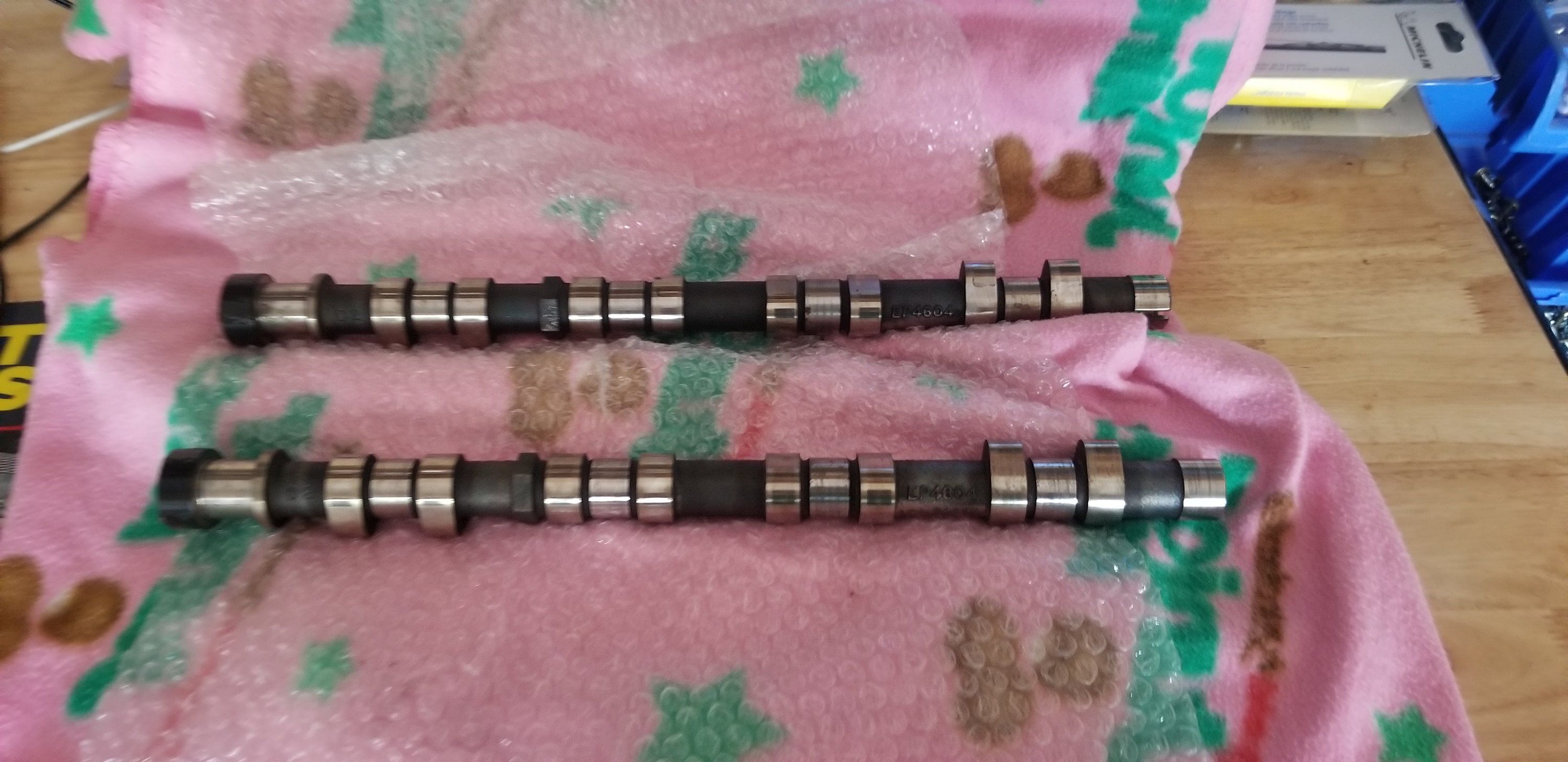

Comp 272 cams! I'm going to start gathering some parts and getting my spare head ready to do a swap over and see how these do!

What's up guys! Here for a decent update!

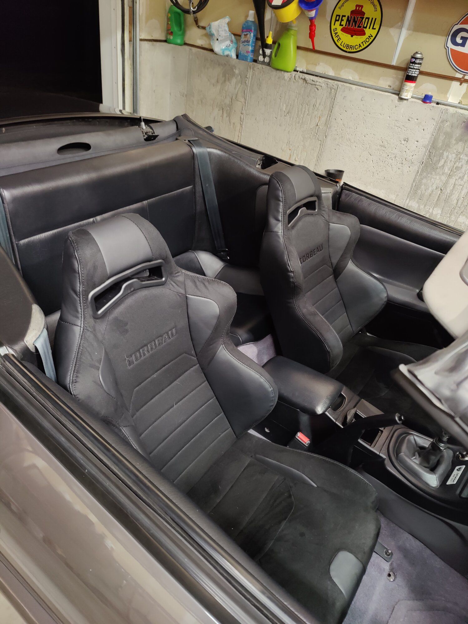

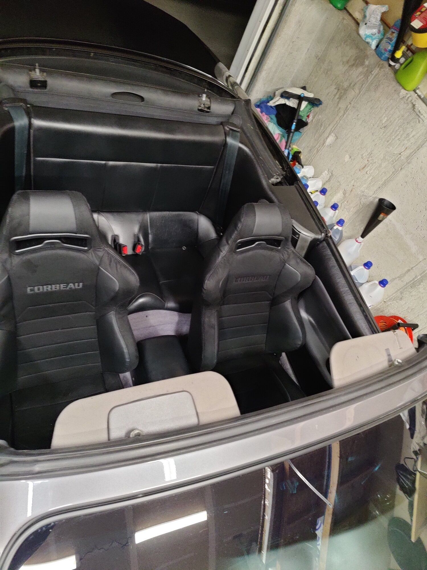

Hey guys! I got some seats :D

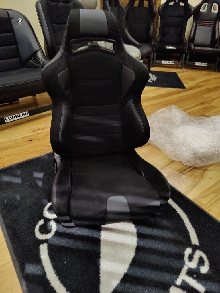

Ended up at Corbeau this past Friday as they are local and willing to take an appointment so I can test out a few different seat models I was interested in. After trying a few he brought this one out.
LG1 Suede
At first I wasn't the biggest fan of the Suede but after sitting in the seat for about 10 minutes It was by far the most comfortable of the three models I was interested in.
I decided to buy these as they were ready and in stock! I also purchased the seat bracket and rails from them so I could be one and done stop.

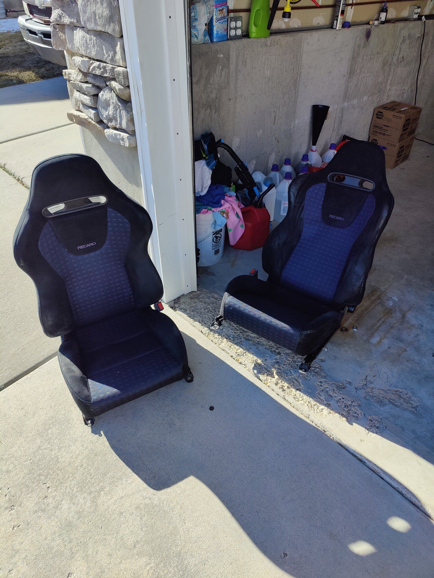

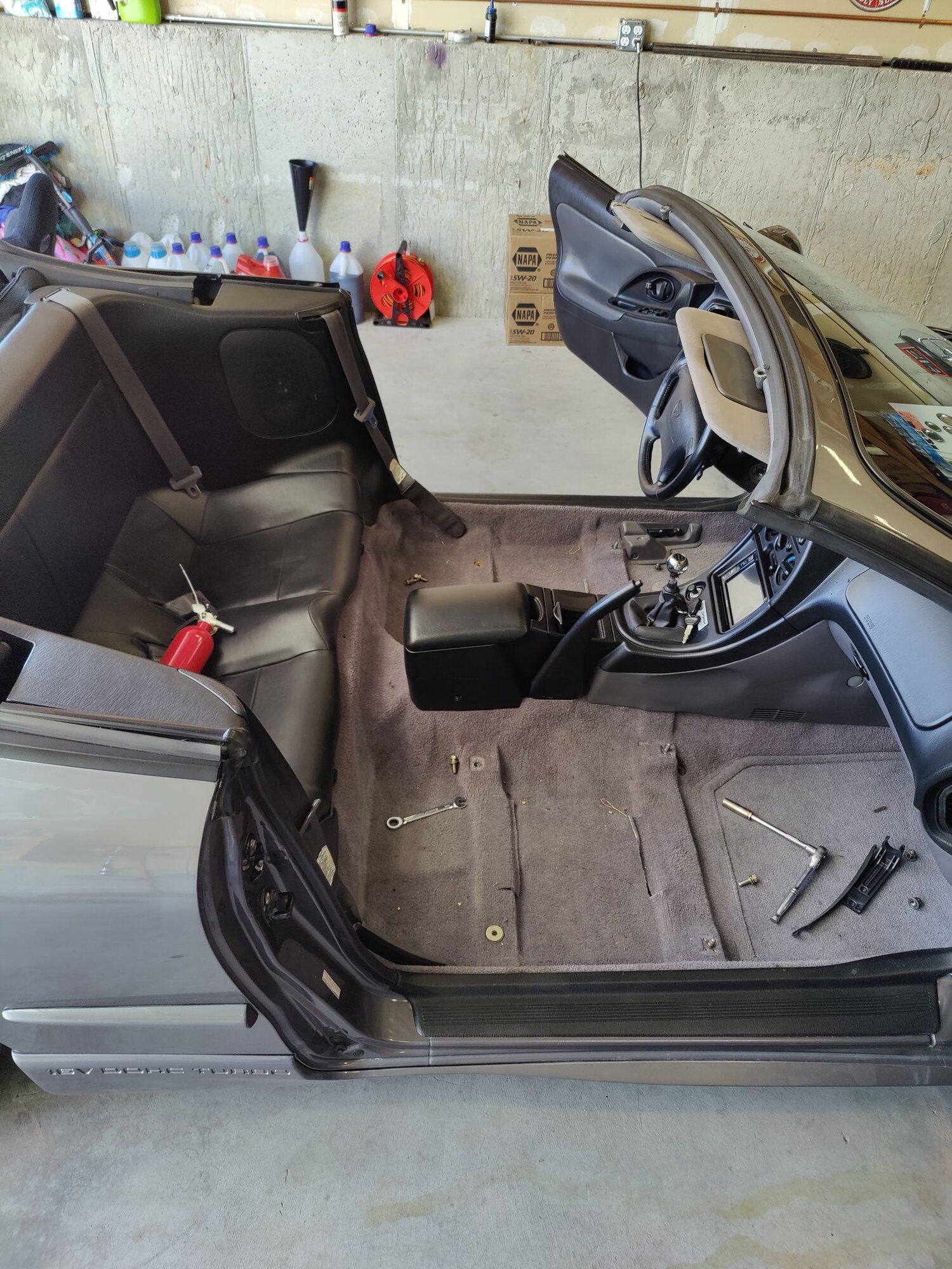

I ran a few more errands that day and when I finally got back home I started taking my old Recaro seats out and installing these :)
While I was in there I decided to install my black seatbelts and buckles I've had for probably 4 years in a box on my shelf, Took a little longer but I'm glad I did, I forgot to take some close up pictures of them but they look so much better than the grey in the interior. I also vacuumed the whole interior and underneath the rear seats while everything was taken apart.
And finally, The seats installed :D :D :D
It got dark or I would have taken pictures outside in the day light.
They sit maybe an inch taller than OEM seats but guys, These seats are so comfortable! They are square and fit so nicely I seriously am so happy! The upper bolsters are just hugging you. I'm 6'1" about 200lbs and these are very nice, If you're a bigger person I'd suggest the wide version of this seat as it adds a few inches in width.
Let me know what you guys thing! Stay Tuned :)
