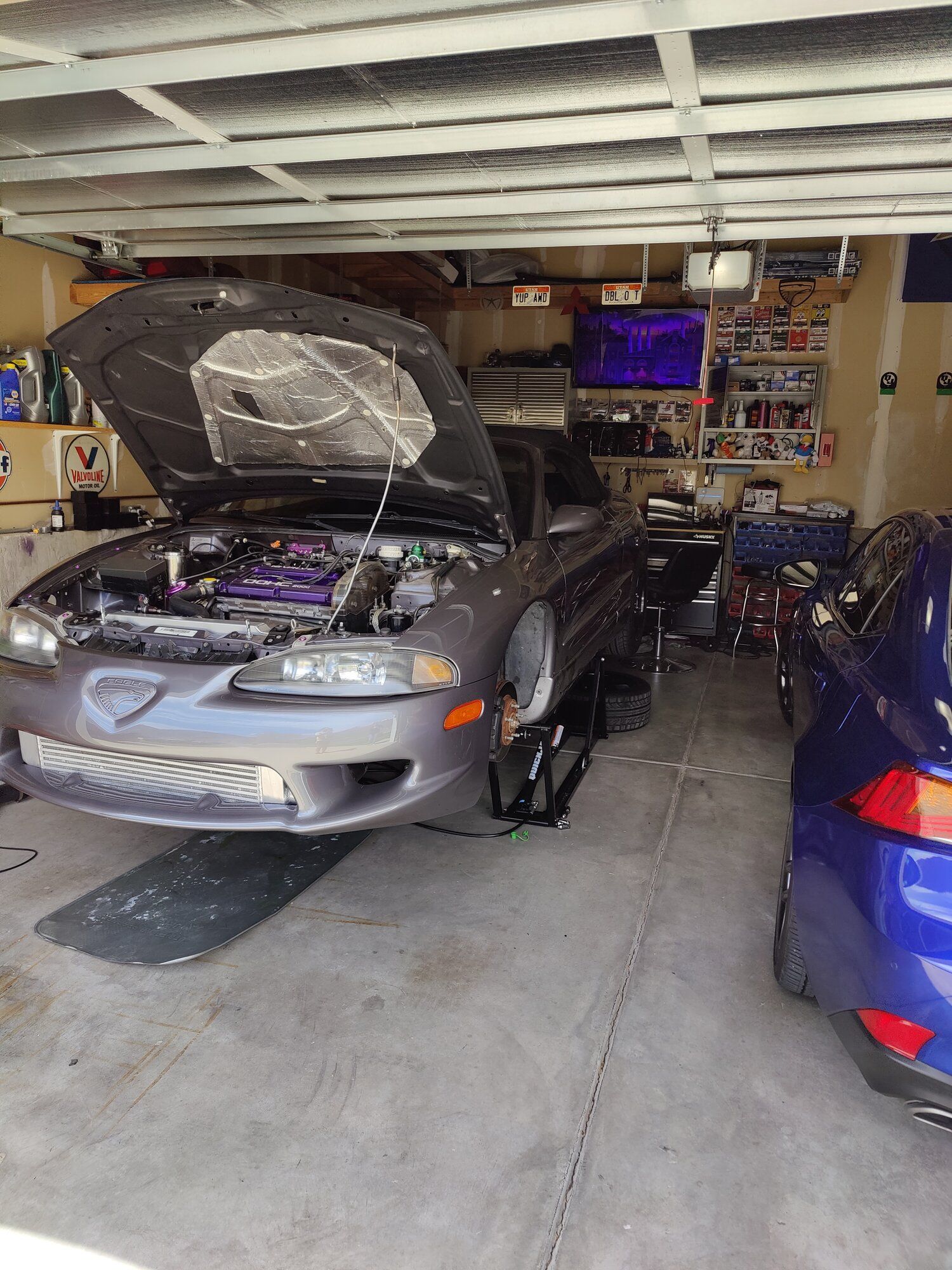

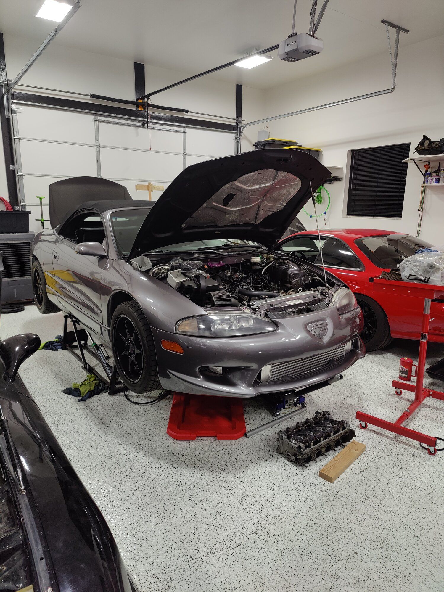

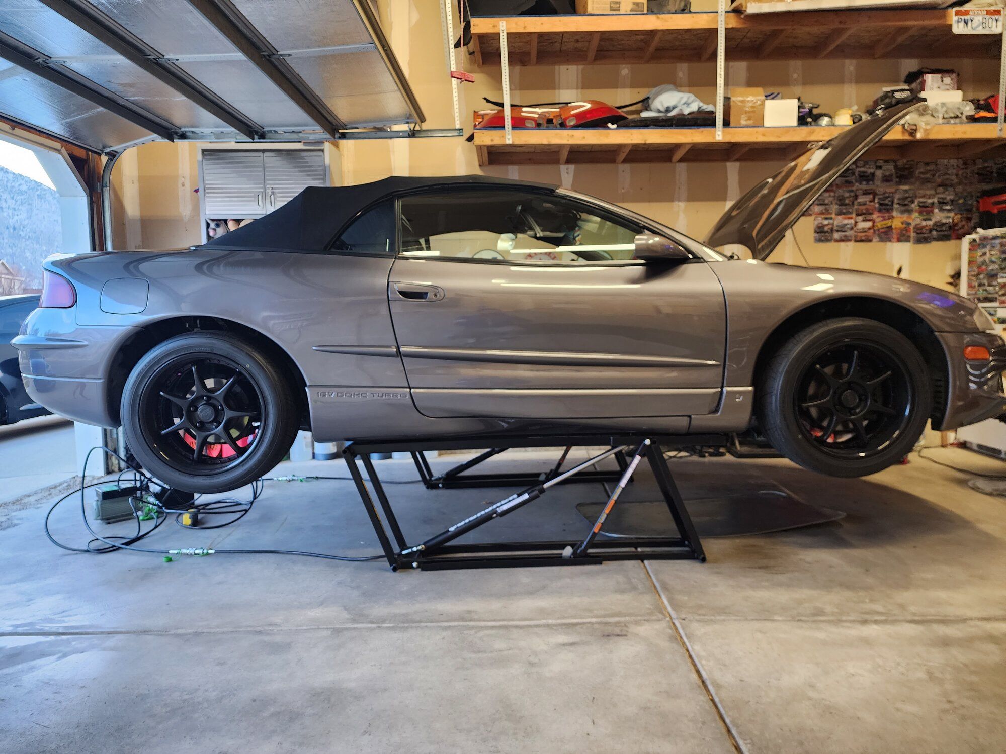

Got a little work done this weekend! Drove the spyder over to my friend's house where he has this insane garage :sneaky:
He has an in ground lift but his roomate's rx7 is on it currently getting some work done. So we got his quick jacks out! These things are so nice and convenient I ordered some for my house haha
As you can see the purpose of this trip was getting my semi built head swapped in and fixing a few leaks I've been having, Luckily the leaks were simply coming from the valve cover gasket so it was an easy fix. We also ported my OFH while everything was torn apart. My buddy has a mill and did it really nice and smooth worked like a charm but unfortunately didn't take any pictures :(
This was a progress picture before pulling the head off, I just realized how few pictures I actually did take, Oh well.

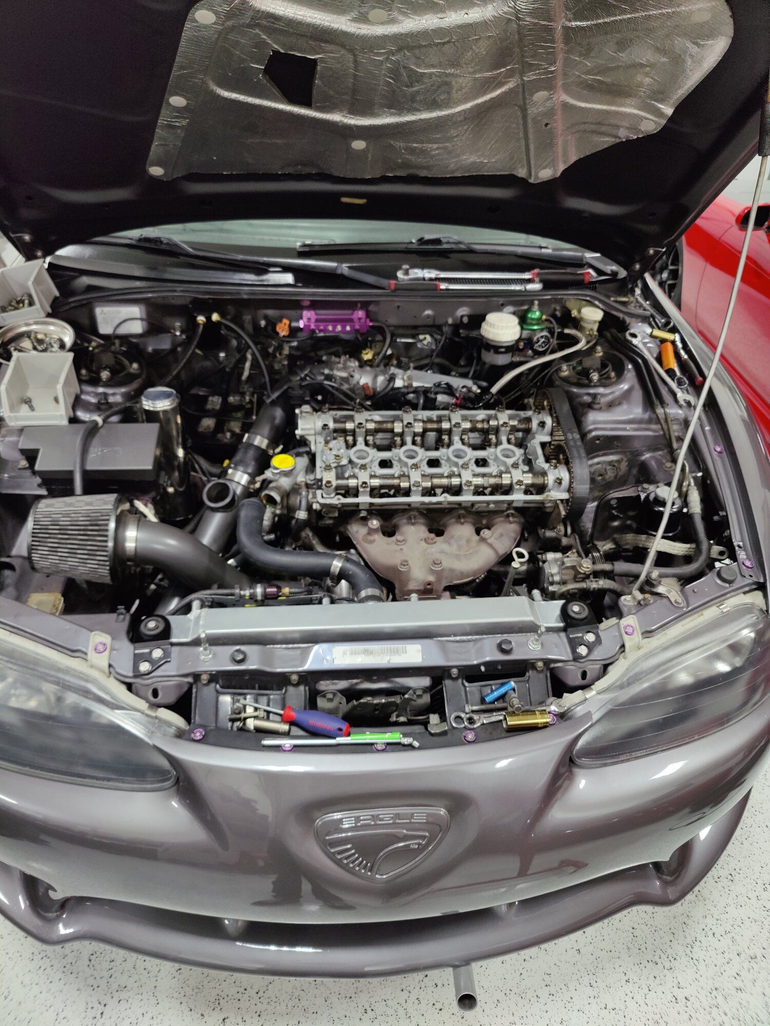

We had a busy effing weekend, we have the new head on, torqued down all the intake and exhaust manifolds installed and torqued. Coolant system and fuel system plugged in and installed. All that's left is to install the timing belt, time everything and put the pulleys and accessory belts back on and see how she fires up :) My other buddy is going to come help me tune it once it's running so we can get a decent base map after the changes and new cams.

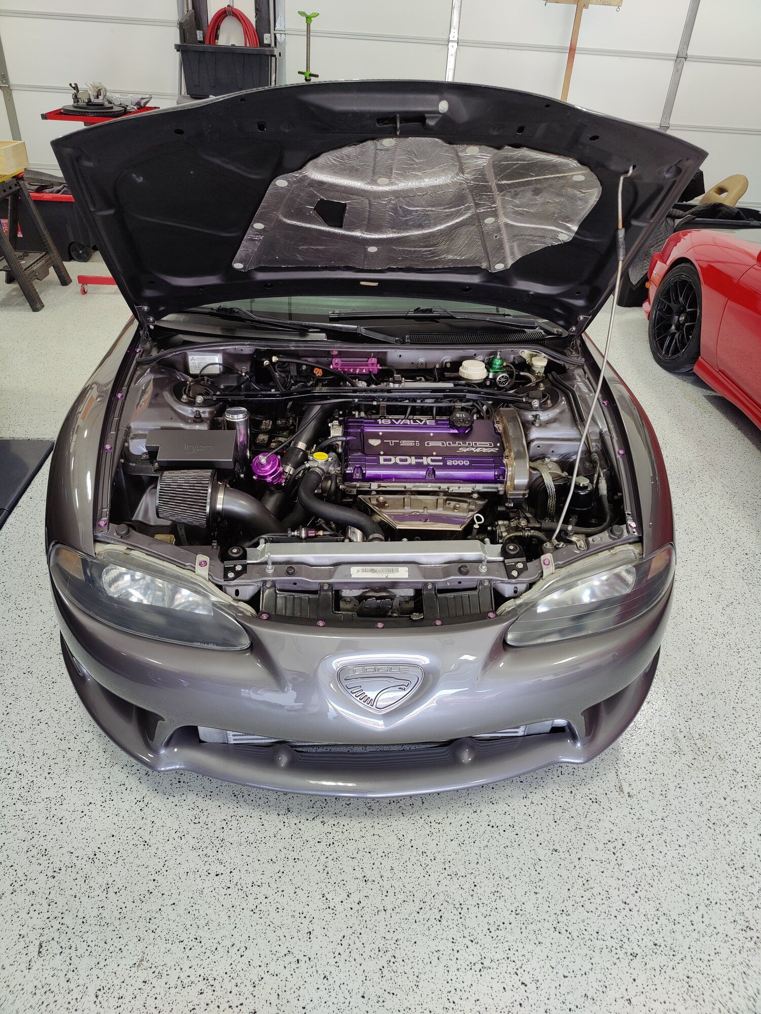

So I got the car all back together and am having an issue,
First the ignition switch went bad, Fixed that
The battery took a dump, Got a new one
Cam angle sensor light came on, Got a new one
Started right up and sounded good and healthy, Now we can't get it started again. Plugs are soaked with fuel, no check engine light, everything is correctly plugged in.
Checked
coil pack - good
Injectors - good
Cam sensor - good
Timing - good
fuel pump - Good
fuel pressure - good
Only other thing I can think of is a crank position sensor and that's what my next step is once I get home. Does anyone have any ideas?
Might be a stupid suggestion, but happened to me and caused months of head scratching. Had a tear in my FPR diaphragm that made the car very hard to start and when it did it ran very rich. Worth checking the vac line to the FPR to make sure there isnt fuel in there getting sucked into the engine.
Guys!! Got it all figured out, long story short, I installed the metal cam sensor inside the housing 180 out haha, Installed it the correct way and bam right on the money, Fires up like a champ!

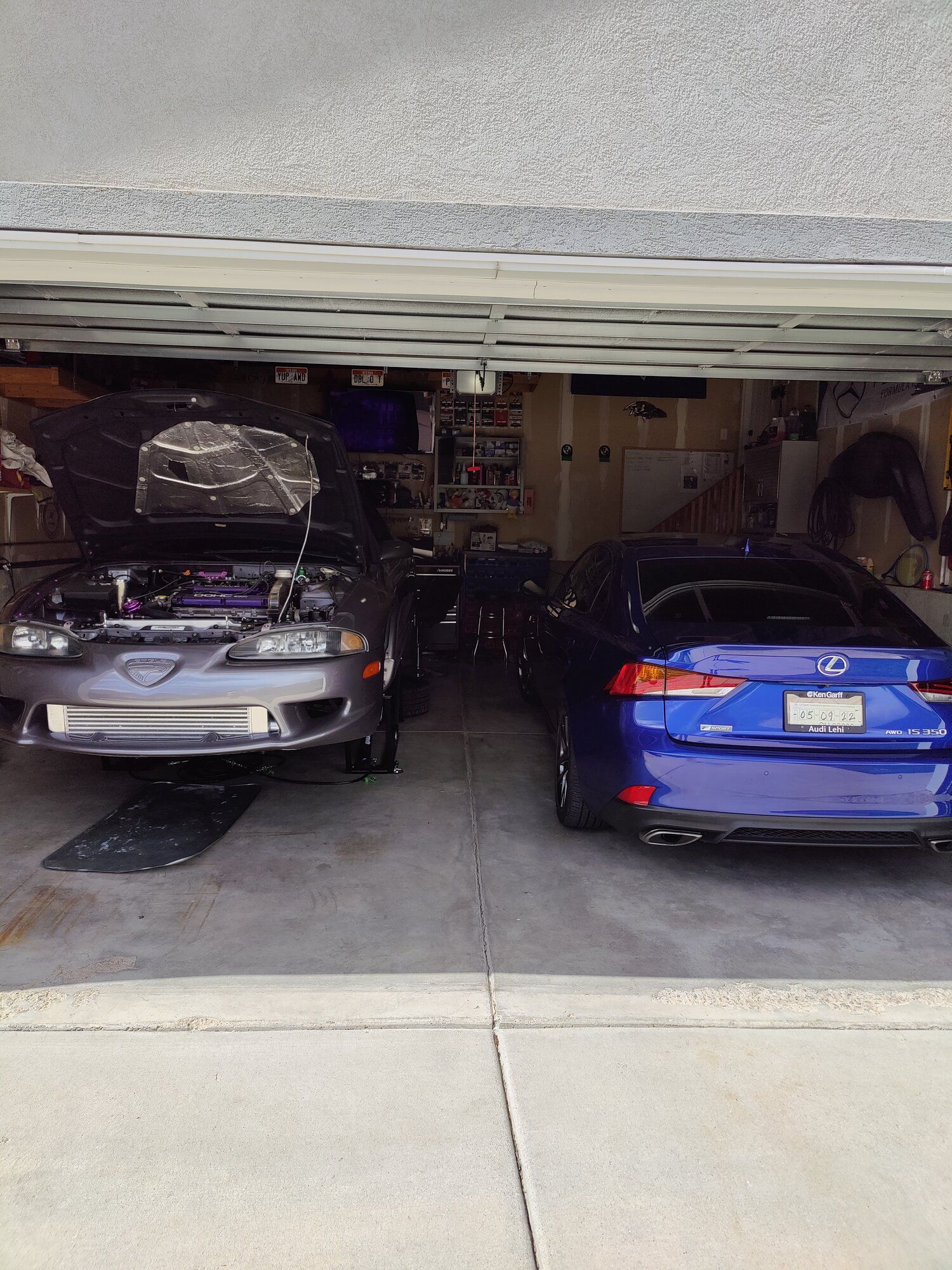

Here she is back at home on my new set of quick jacks (Highly, Highly recommend) Next to my wife's Lexus IS350 Fsport AWD (It's stupid nice)

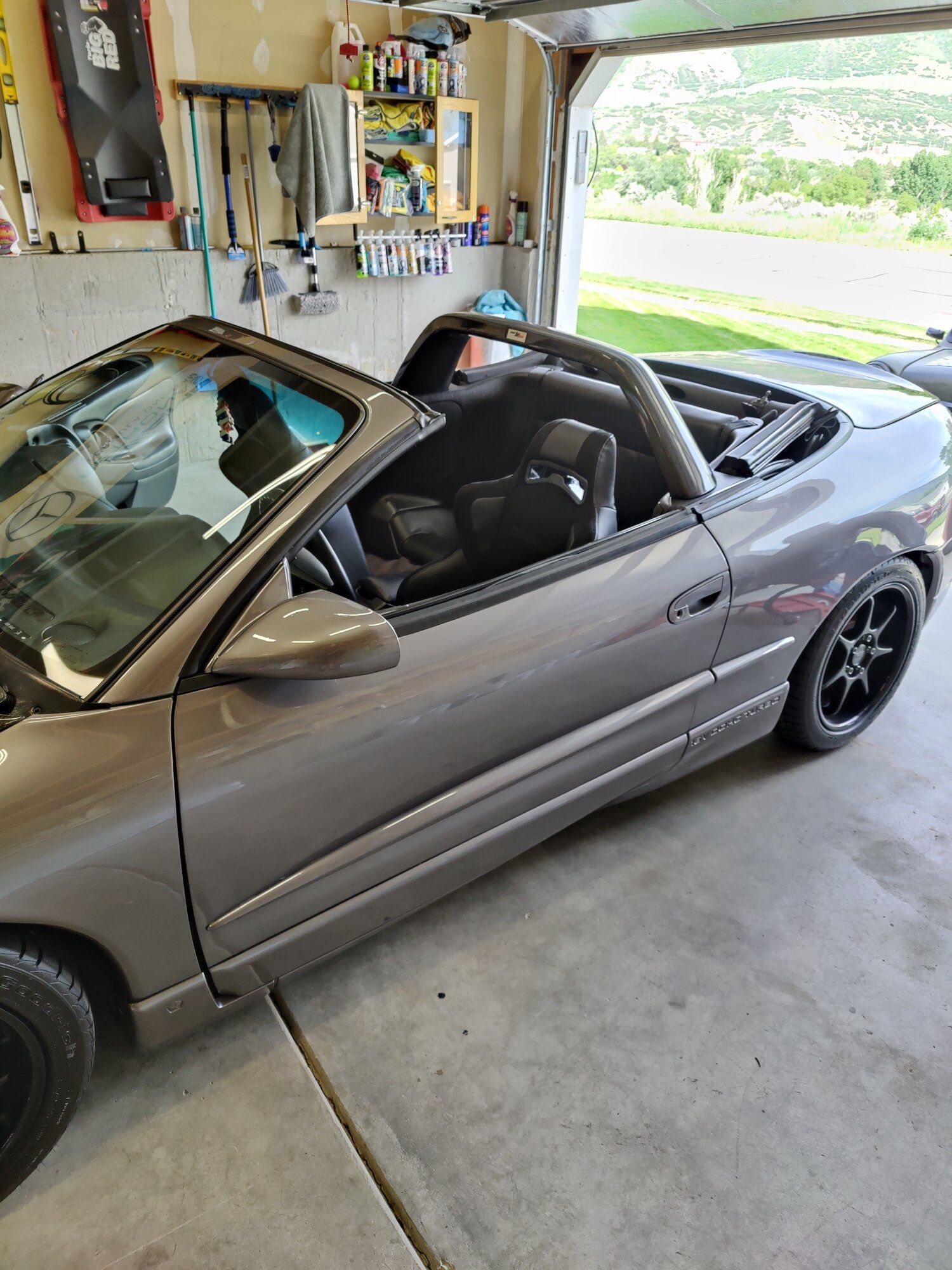

More recently I scored a Carbon Fiber Parade Bar from Sergio at Carbonetics
I really think it made the car POP! I'm so happy with it and it adds so much character :)

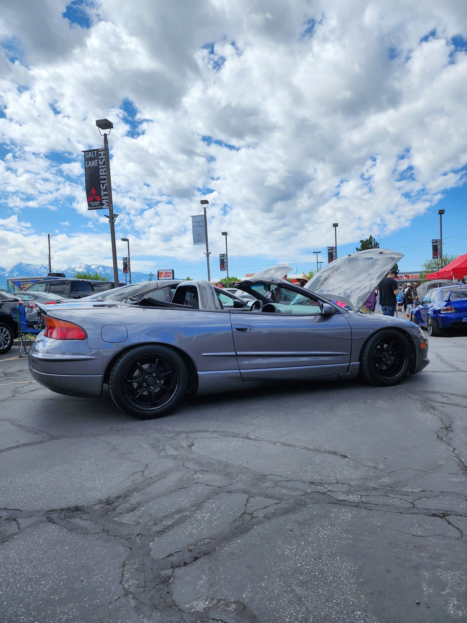

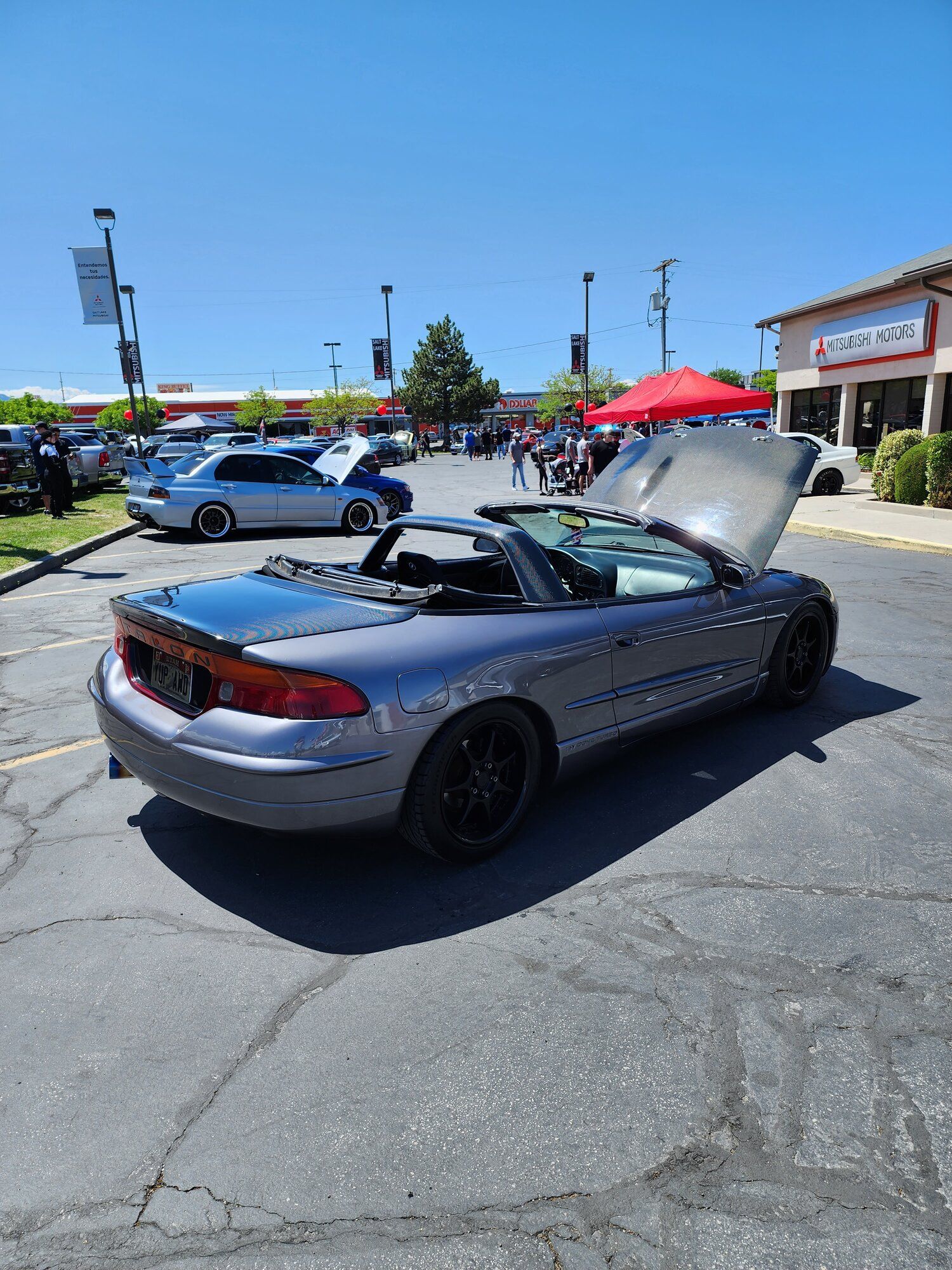

Just recently this past Sunday I went to the first Mitsubishi Owners Day in Salt Lake City Utah and it was amazing!
Parked here with a couple of my friends, we've all been in the DSM game for over 15 years which really makes me feel old LOL

The light/parade car from Carbonetics is cosmetic just looks cool and I've always wanted one since I first saw the OEM one years and years ago. Top closes with it no issues at all. Just need to be careful when Installing and measure 100x times before drilling the holes. It has probably an inch on each side with the top closed but it doesn't move so it will never get snagged or touched by the top.

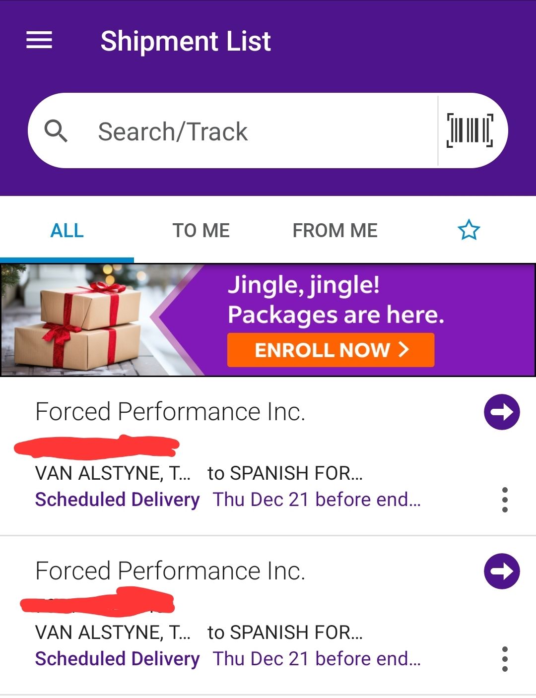

Small updates!

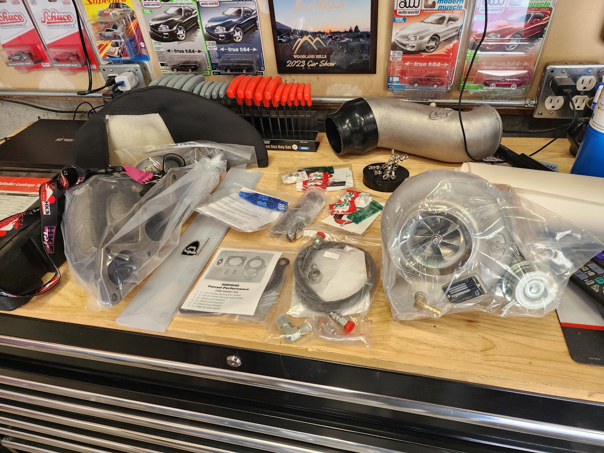

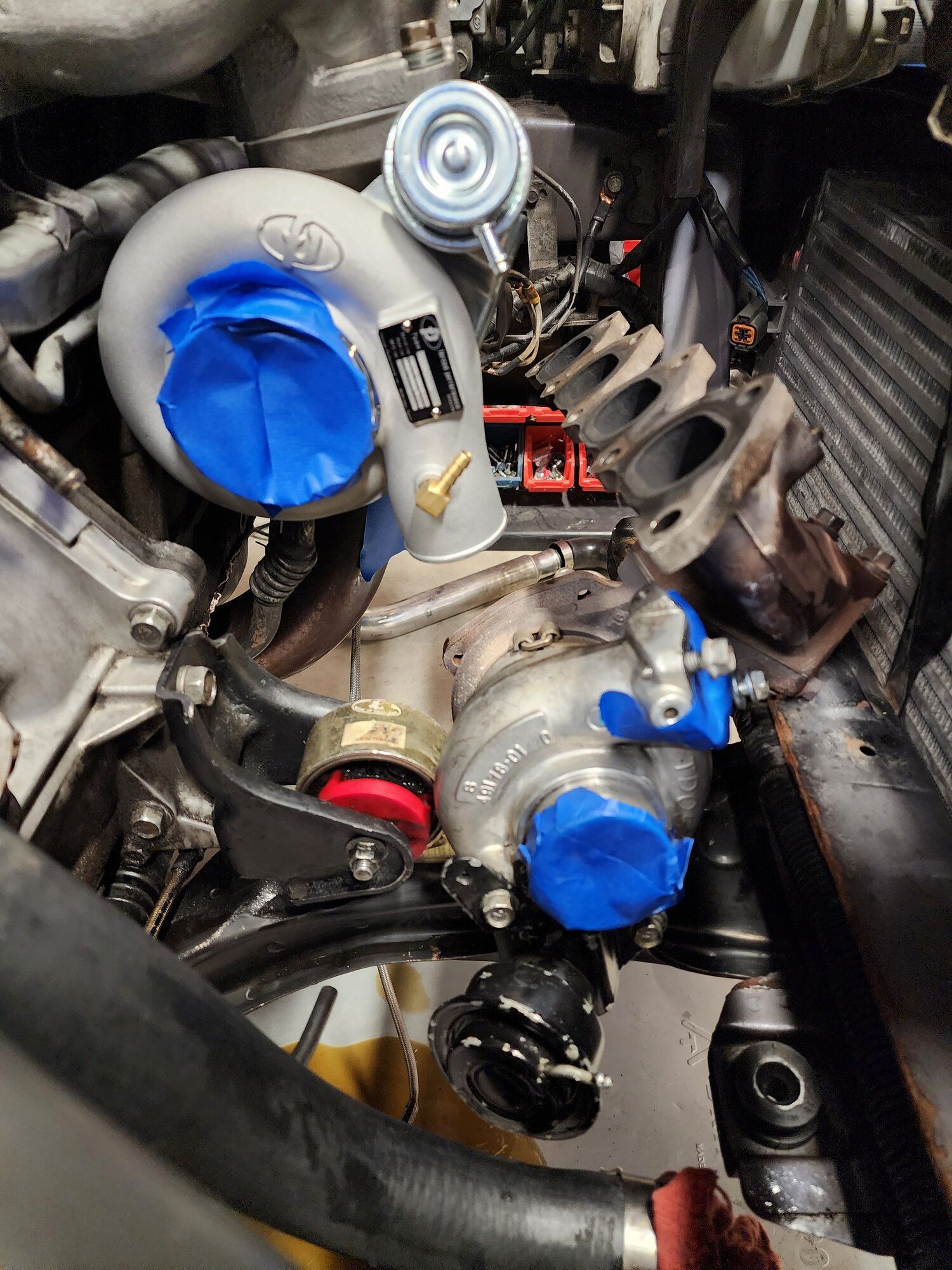

Turbo came in!! Went with the Forced Performance FP Green ball bearing L.O.P.E and manifold 🤘
Car came apart very smoothly also highly recommend these Quick jacks 🤘
Here's a rough mockup with the new FP Green L.O.P.E Ball bearing compared to my Evo 3 16G

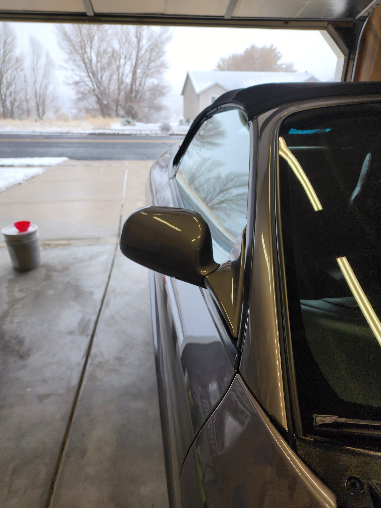

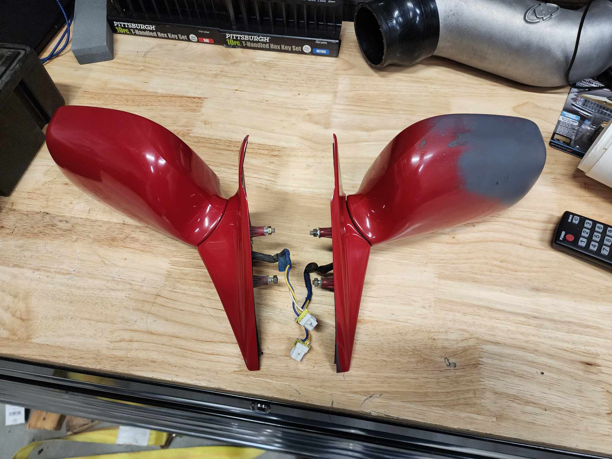

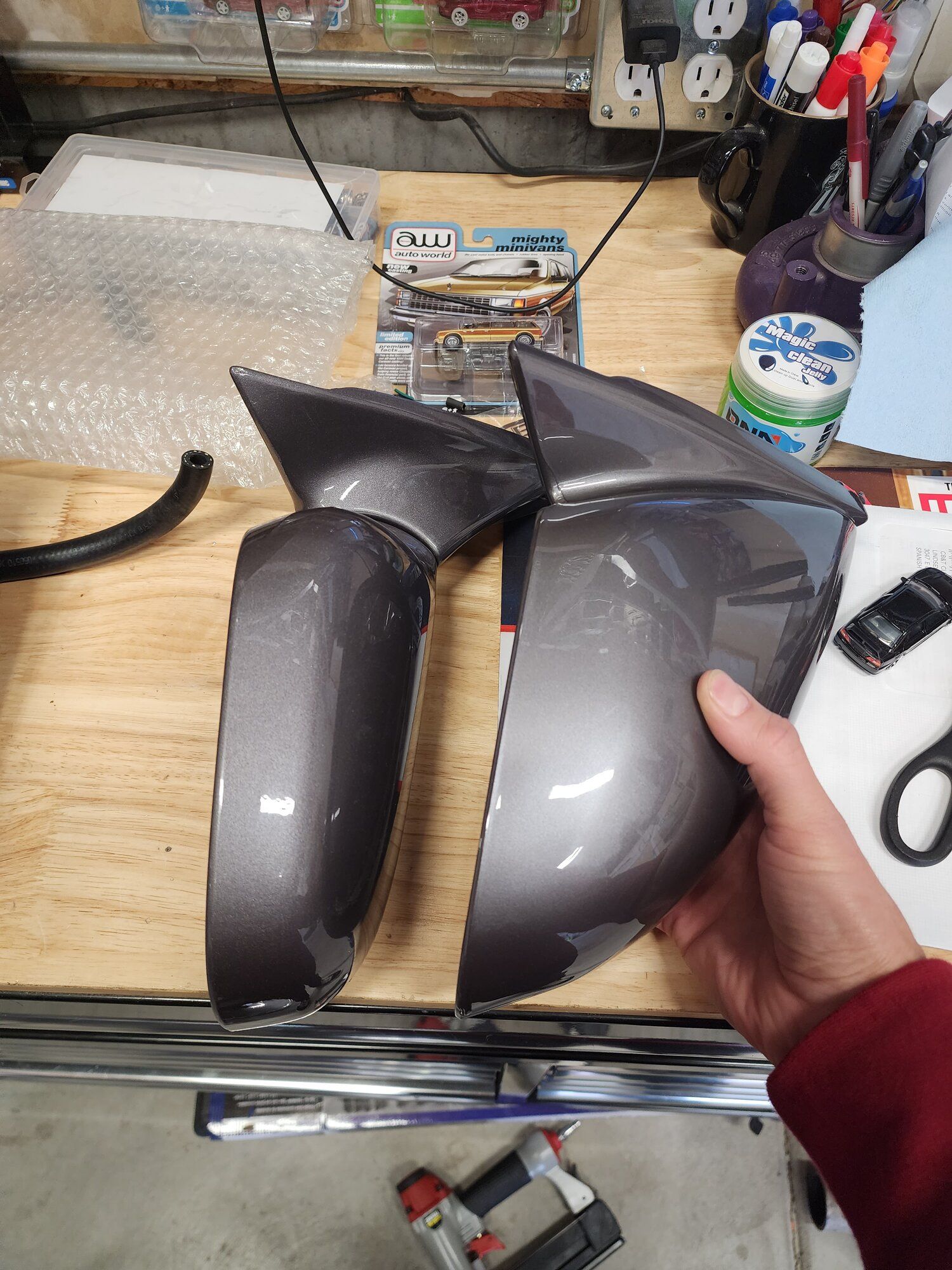

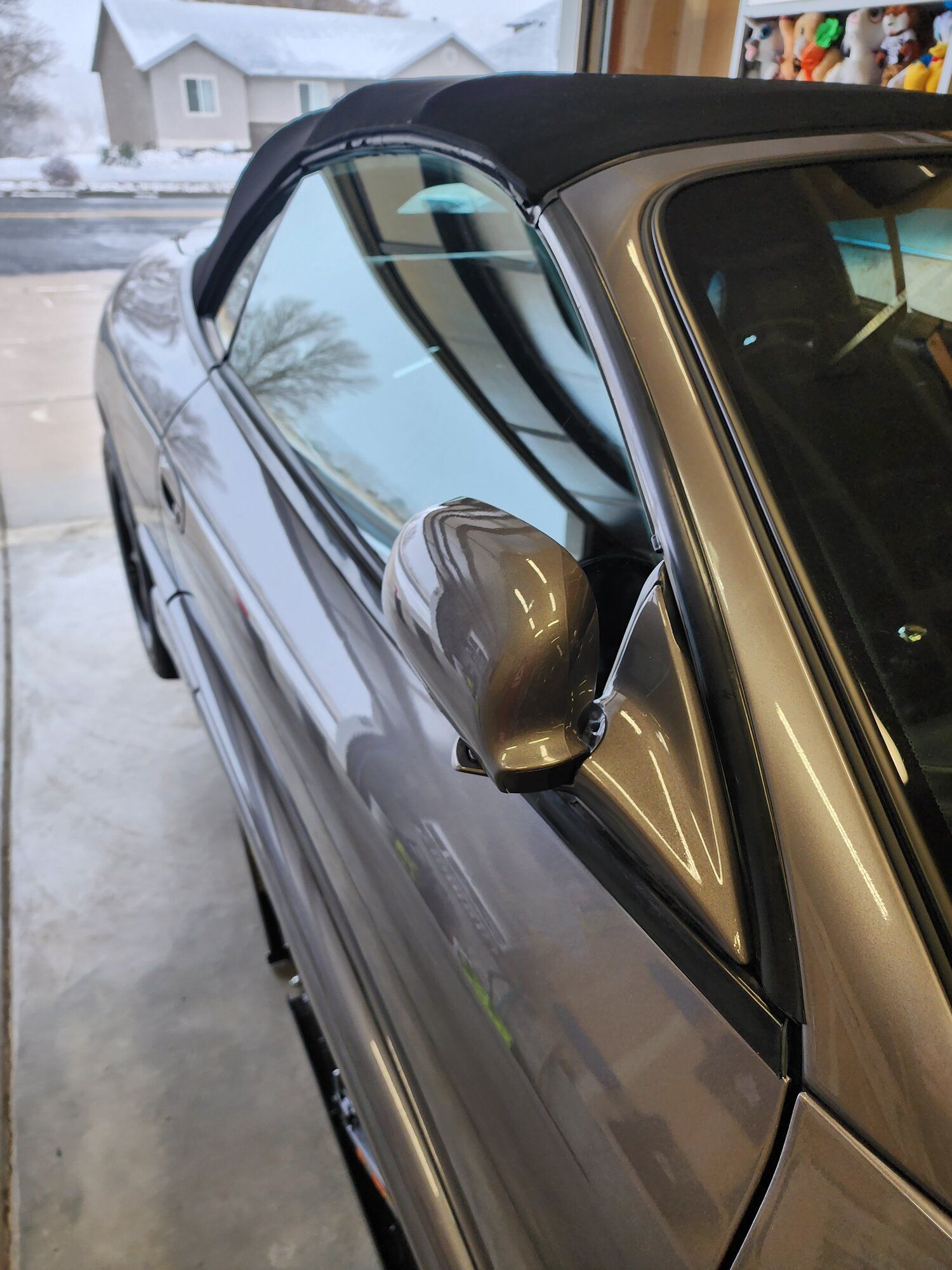

Also got these EDM mirrors as a gift from the wife for my birthday!
Had my friend paint match em and I took this comparison between USDM and EDM
Absolutely love them! So much sleeker than the US OEM mirrors.

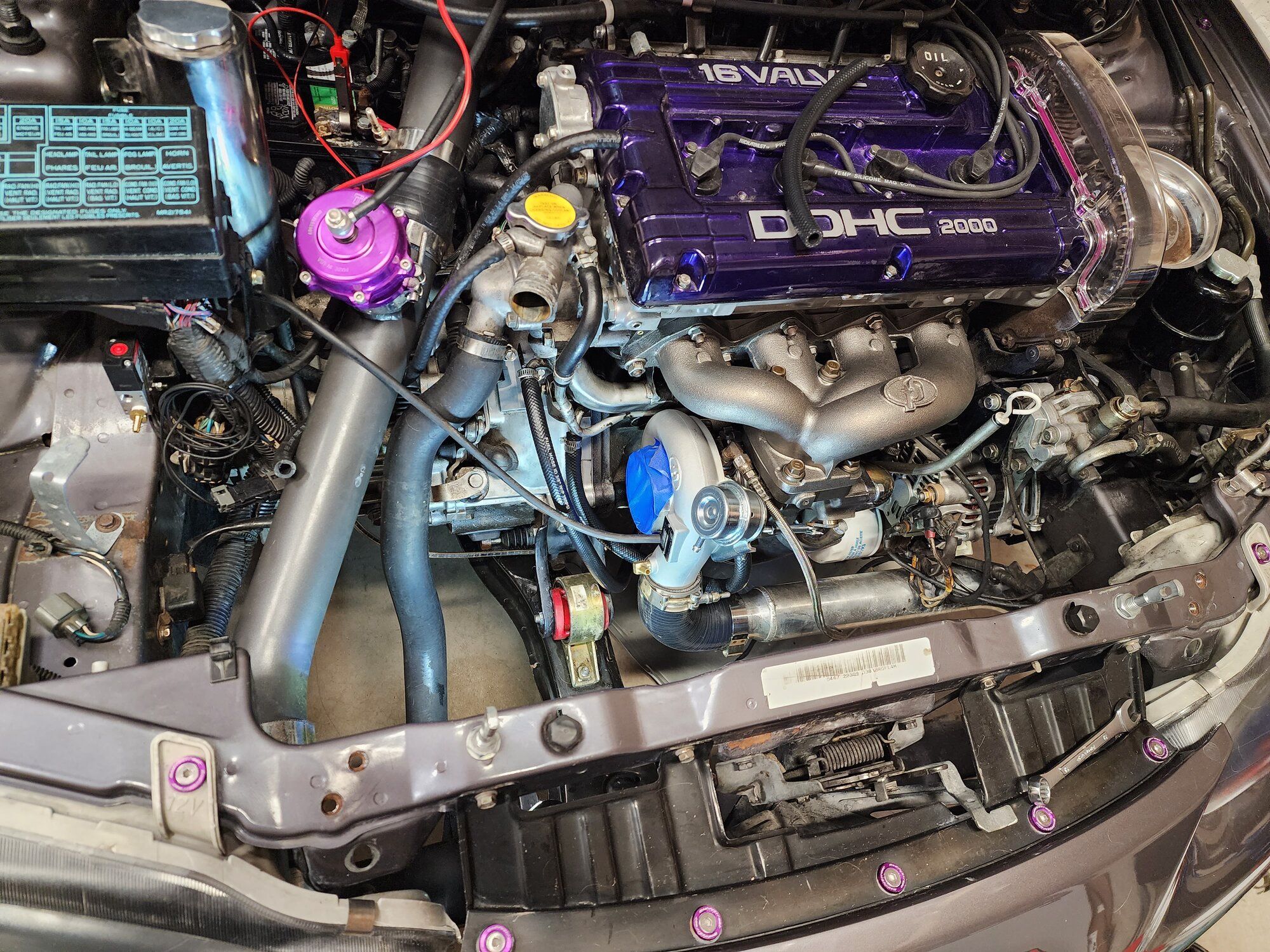

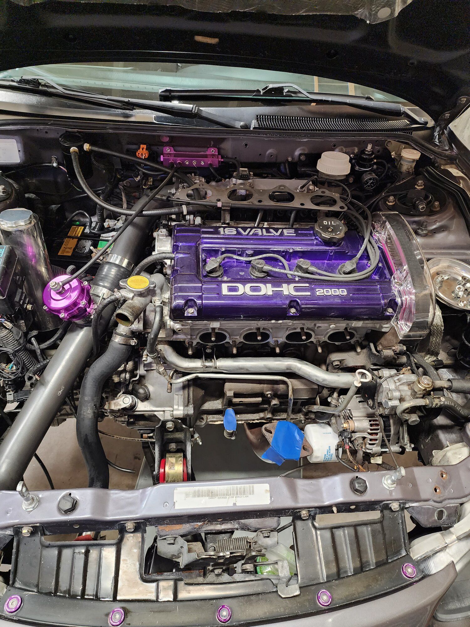

Had some time yesterday to get some work done! The turbo is all mounted plumed and has the downpipe hooked up. Just waiting for a few fittings for the boost controller to adapt the larger fittings on the new turbo and wastegaste and I'll be able to drop the radiator in.
Only picture I took unfortunately 😞 waiting on a few parts from the powder coater also 😬
