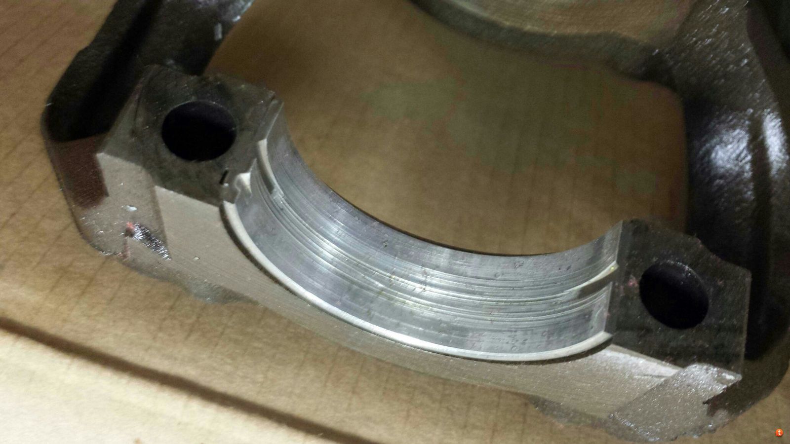

I got the motor torn down and this is what I found
The grooves are pretty deep, surprisingly the crank has no scarring or grooves anywhere.
I'm going to drop everything off at the machine shop next week and have them give everything a look over.

I heard back today, everything but the main bearings looked fine, the head was cleaned and leak checked and was perfect, the crank was perfect and had only needed to be polished. He said there was some odd wear on the pistons and recommended I do a .20 overbore and get new pistons.
So my rebuild will consist of stock .20 over pistons, rings, ARP rod bolts, ARP headstuds, new main bearings, rod bearings, polished crank, bored and honed block and a 4 layer Felpro or Mitsu headgasket, new front case with BSE, and new gaskets everywhere.

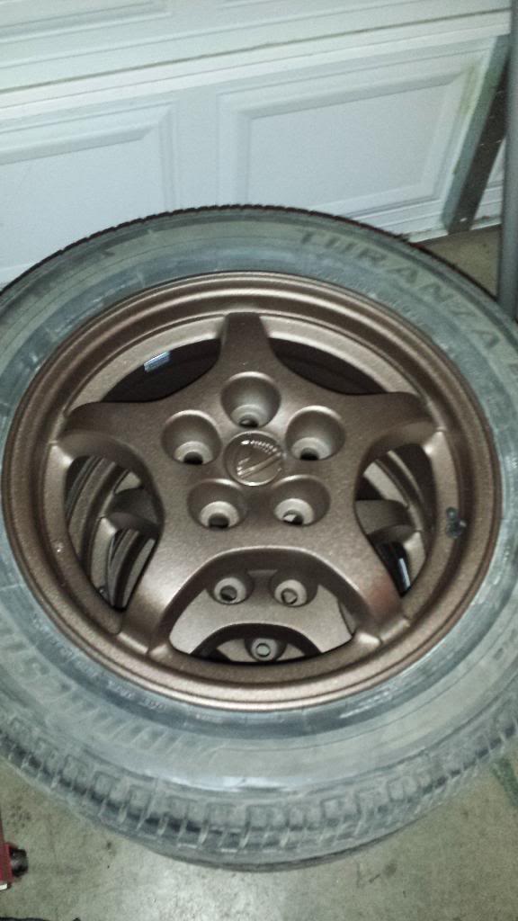

Also got my wheels powdercoated a while back and got some tires mounted

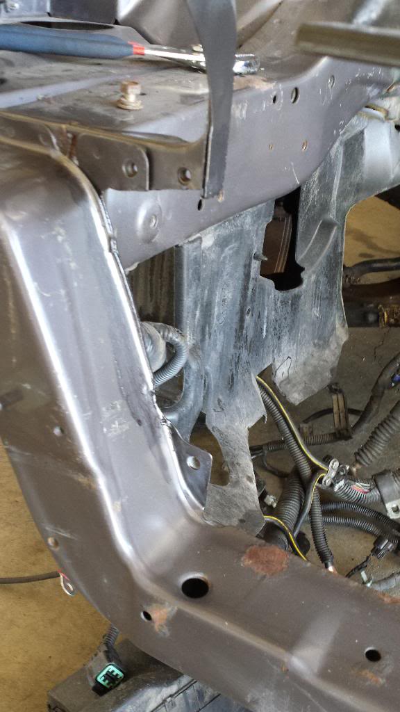

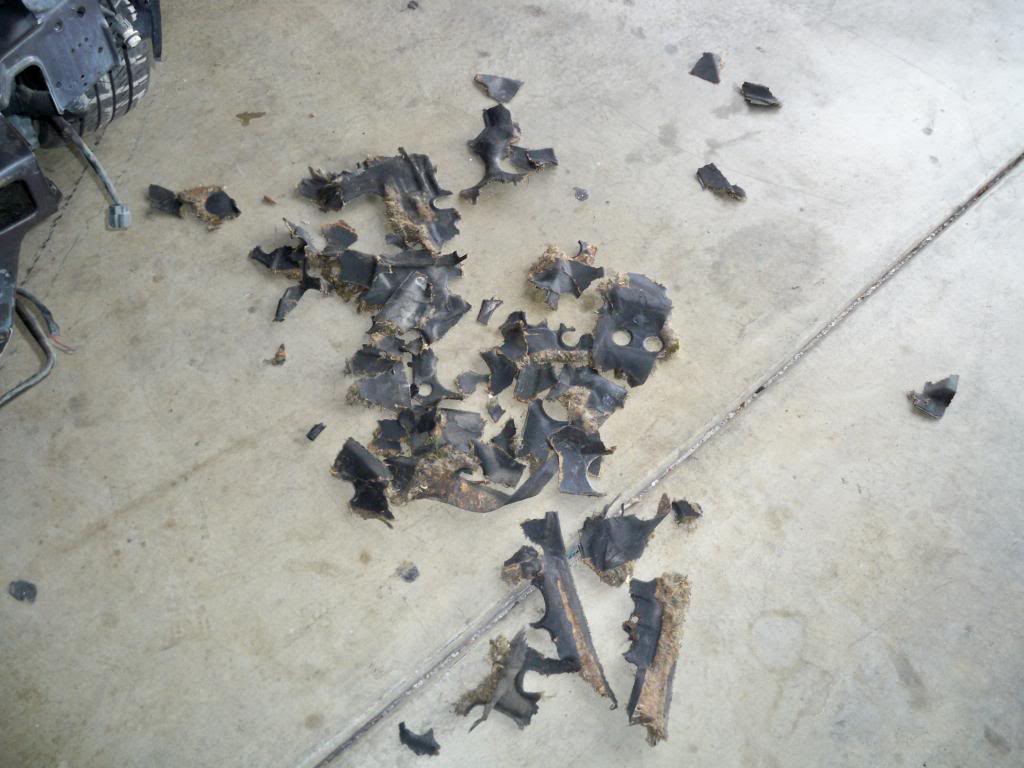

Started working on the engine bay a little bit, started by taking the firewall material off, it was flaking and I have always hated how it looks on these cars

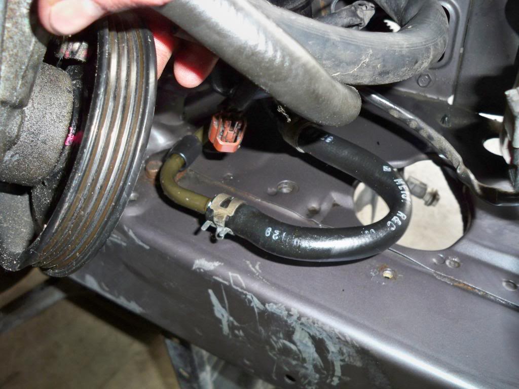

Next I deleted my powder steering cooler and looped the lines, pretty simple and self explanatory

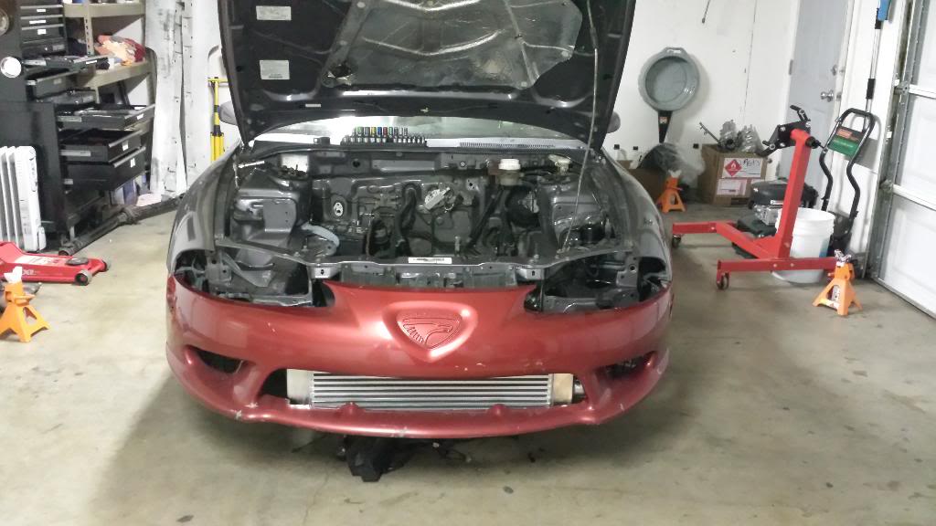

I started to get the car ready for the VRSF IC Kit
Cut the radiator support corner out and laid down some primer after grinding the metal down and making sure it wasn't sharp (so it doesn't tear the coupler)
Painted
Drilled and tapped the stock fog light mounting holes to 8x1.25mm and mounted the core to make sure it fit correctly
And a teaser with the 2gb talon bumper hanging on :D

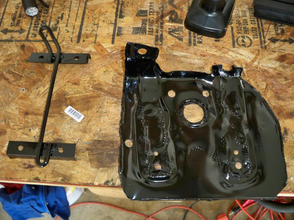

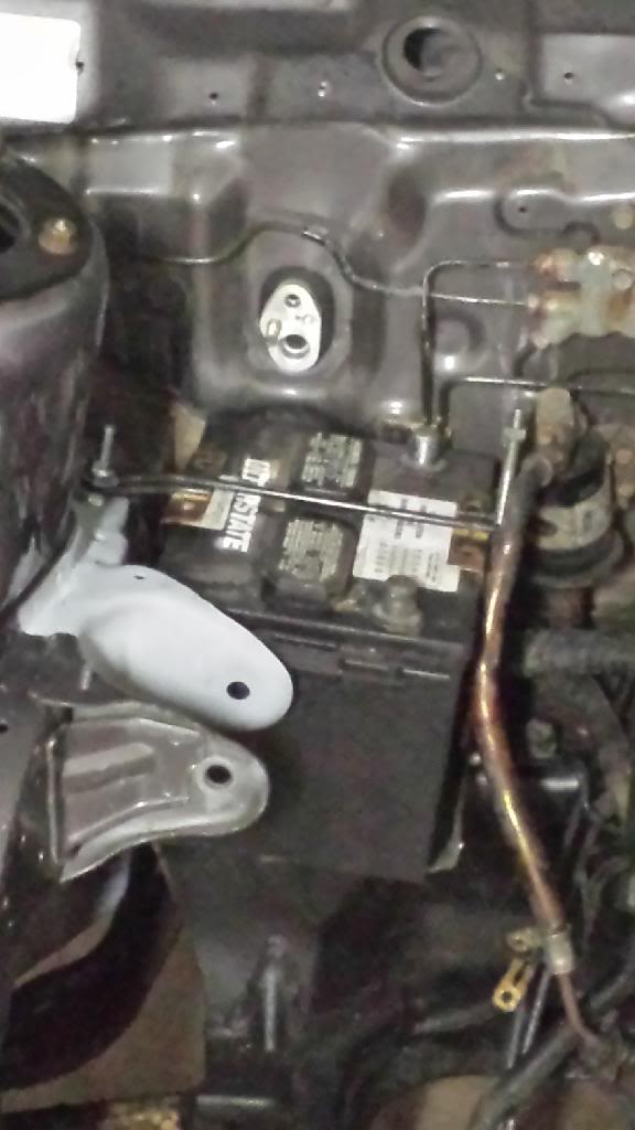

Next I started to do the battery drop onto the subframe as per Gofers thread. I did this previously on my old 2g and it's 100x easier with the motor and transmission out of the engine bay LOL
I did some cleaning of that area as it had some surface rust, primered it and laid down some mixed up OEM paint by my local Jones paint shop. It looks decent enough I just laid it down with a brush and used some engine enamel clear coat, did the same for the radiator support area. (Will update with pictures later)
I also cleaned, wire wheeled, and painted the battery bracket and tray with some rustoleum
