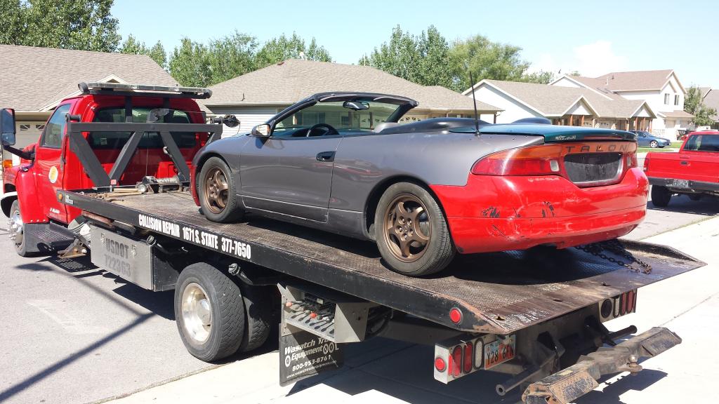

1998 Gs-t Spyder Auto.I did a manual swap and while I was at it did the awd swap. Fun little project so far.

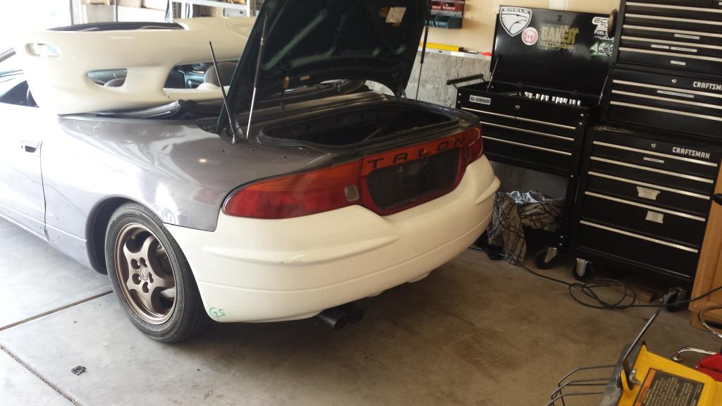

I had originally decided to use the 2ga talon rear bumper, but decided to just go full 2gb swap instead so I pulled off the 2ga bumper, had a few friends come over with a welder and help me re align the brackets and weld them into place, I'm very happy with the fitment now as it's less then a 1/16th of an inch all the way across the bottom of the tail lights and the bumper

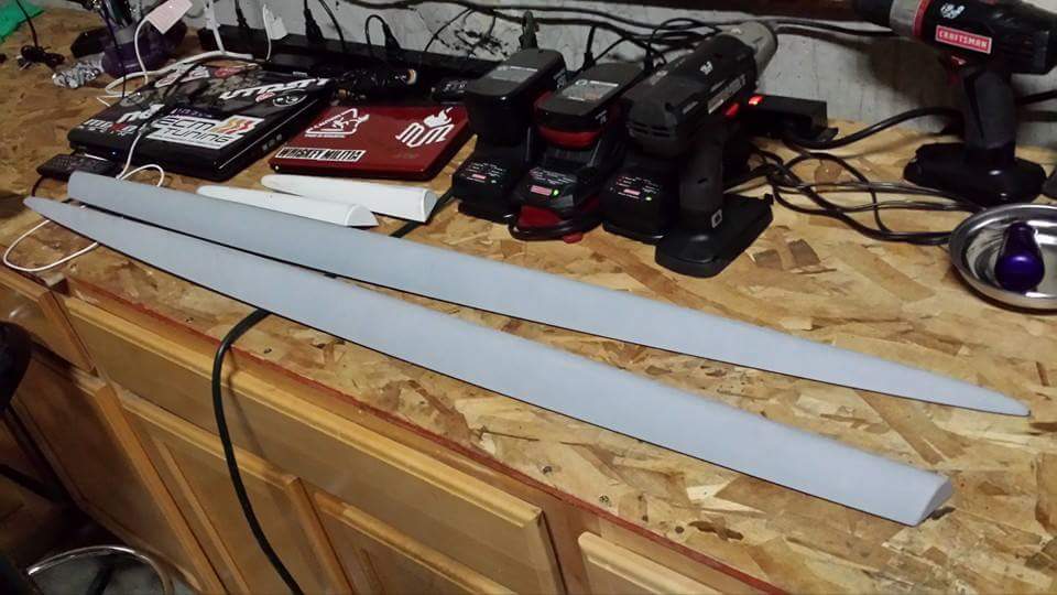

I've also been very lucky to pick these 2gb door strakes up from a very nice guy on the ECMlink forums he also gave me an amazing deal on them and they are already prepped for paint, I still need to mock these up and drill into the body which makes me a little nervous but it'll work out and they should really make the whole car pop!

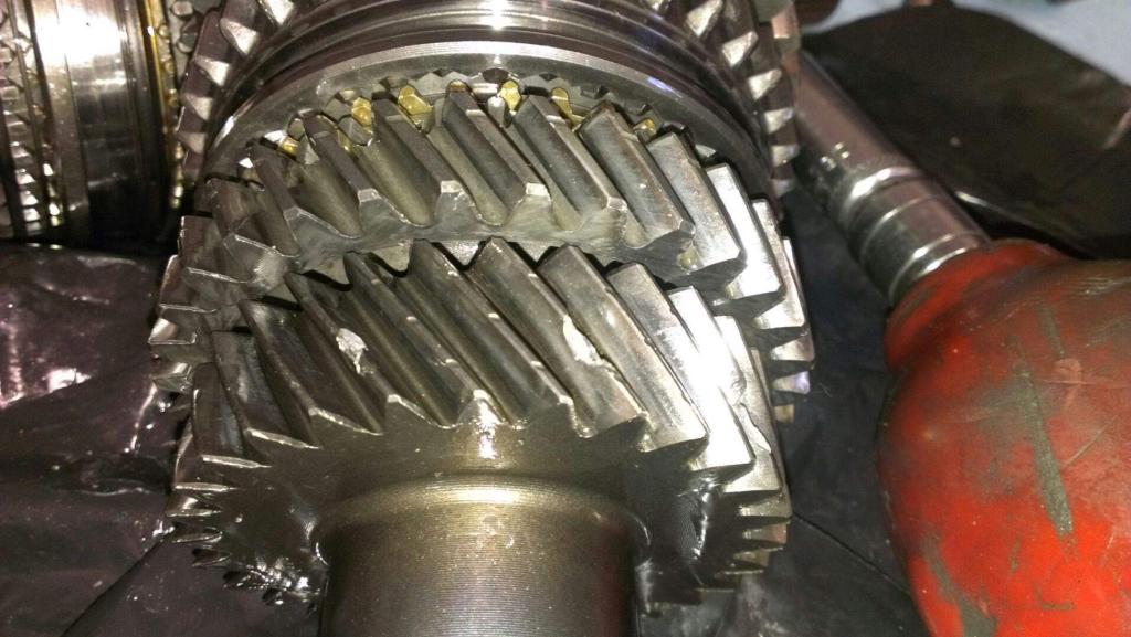

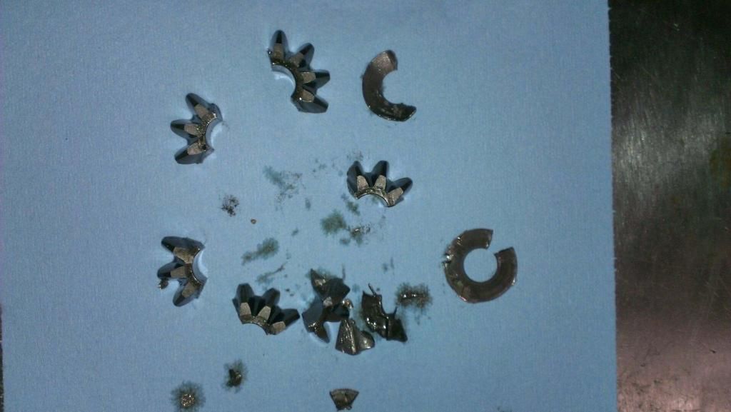

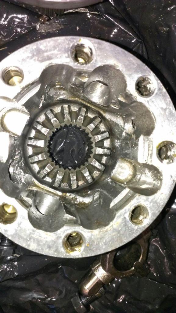

I dropped off the transmission to the builders house on Saturday night at 7pm, He had already tore it down and found my issues by 8am Sunday morning.

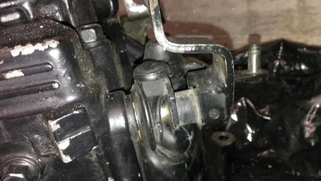

First, This transmission had been taken apart previously by someone and the gear selector bracket was installed wrong, Which is why I had never been able to get into 5th gear.

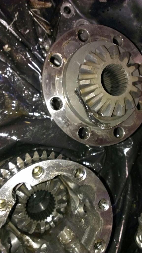

Second and worse of all, The center differential was completely shattered, into multiple pieces. That means the transmission was sold to me this way, The couple I bought it from had no idea were very sorry and took care of the situation very well.
While this happened, It also took out the intermediate shaft

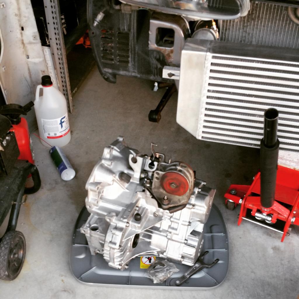

Crappy situation but overall at least I now know what was causing my issues and I'm having the transmission rebuilt better then OEM here's what the builder will be doing for me
New:
1-2 Hub & Slider
1-2 Keys and springs
1st Synchro
2nd double Synchro
1-2 Shift fork
3-4 Shift fork
3rd & 4th Synchro's
Shaft Nuts
Roll Pins
Input shaft seal
T-Case output seal
Both CV Axle Seals
Case will be hot tanked and sand blasted
All preloads setup correctly
