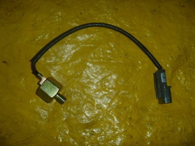

I got around to installing the Mirage knock sensor in my talon. So far it appears to be working. No CEL and i still get random knock events around 2500rpm in vacuum like my OE sensor would pick up, though they happen much less frequently.
Here are a few comparison pictures. As you can see it has the Mitsu tag even though it's NTK. It plugs right in, though the wire is about 1" shorter. You can't clip the connector to the intake manifold brace due to that, but oh well.
